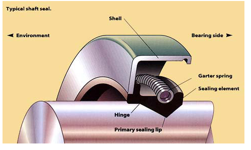

    I wanna make sure this is right or wrong. I’m replacing the front crank seal and it looks like the outer lip of the seal doesn’t sit flush against the crank. Is this right? It doesn’t feel like it should be. It’s an elring seal.
      #453
      Thats fine, and on older engines it is preferable for the lip seals to ride deeper or shallower than normal to avoid riding in the minute groove that is formed on the shaft surface
        #454
        That outer lip doesn’t even touch the crank. The inner seal do for sure, just not the outer one. That’s okay?
          #455
          The actual sealing lip is further back like so.
          Trust your gut, if you feel funny about it, redo it with a new seal and also check to make sure the aluminum seal housing is sitting flush on the block. Kind of a dumb suggestion but its the only thing im coming up with off the top of my head that could physically affect the seal position
            #456
            That picture helps. It’s weird to me that this one would have that gap around the outer lip but the others wouldn’t. That’s why it’s throwing me off.
                theres like 100 types of shaft seals, this should not be weird to you.
                  #459
                  This is the first time I’ve seen one that was “open” on the face like that. It’s the only seal on the m20 like that and I’ve never seen one on all of the Volvo’s I’ve owned.
                    #460
                    It's pretty common. A lot of hondas and aftermarket seals are like that.
