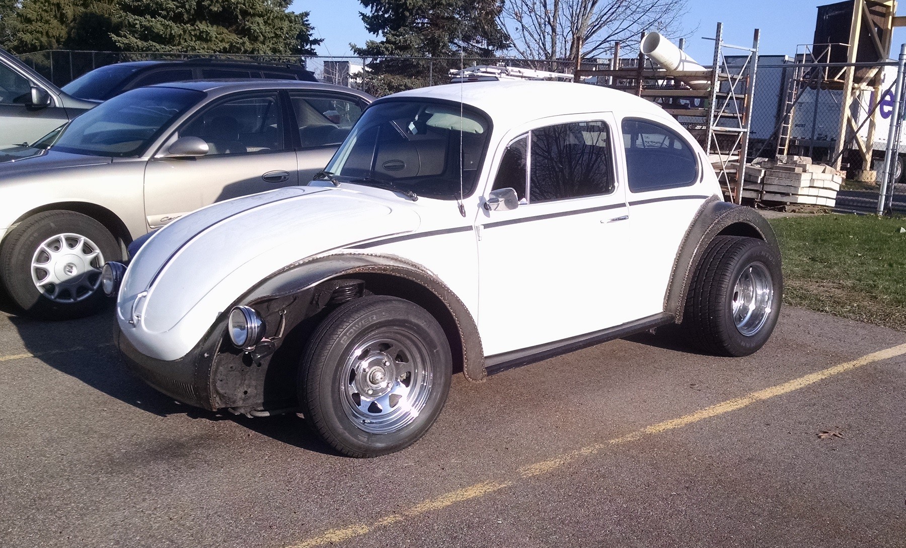

    One of our assemblers at work pulled in with this. Just bought it yesterday. Definitely not something I was expecting to see today.
