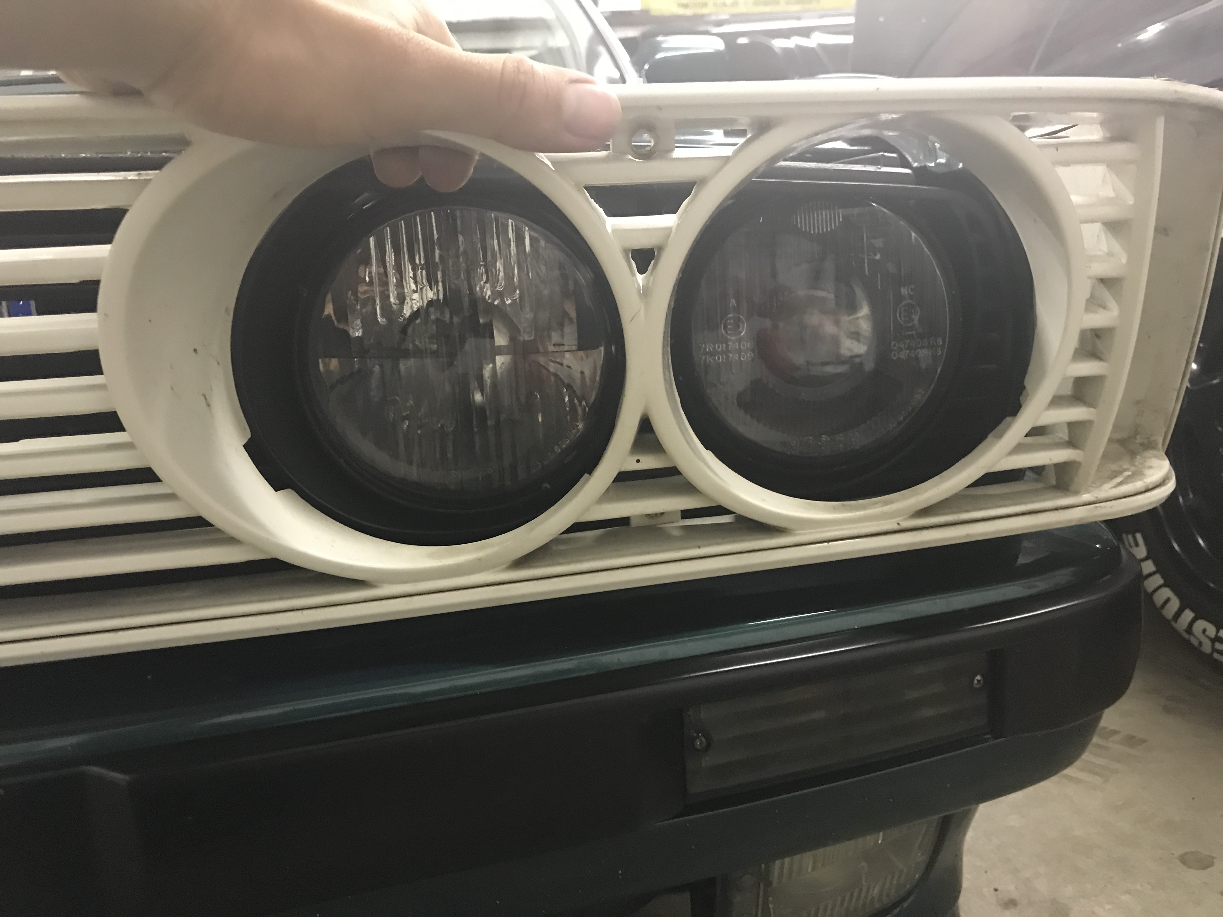

    I would say yes, but it would take some modification. Here is a e24 trim ring over my e30 lights. They are the same diameter, but the spacing between the lights isn't the same. *note the light holes seem larger in the e24 grills because of the chrome trim rings.
    Thanks for the photos, now sell me your headlights.

    Do you know if the e30 lights fit the e24? I want to get some new headlights. Maybe euro ellipsoid's

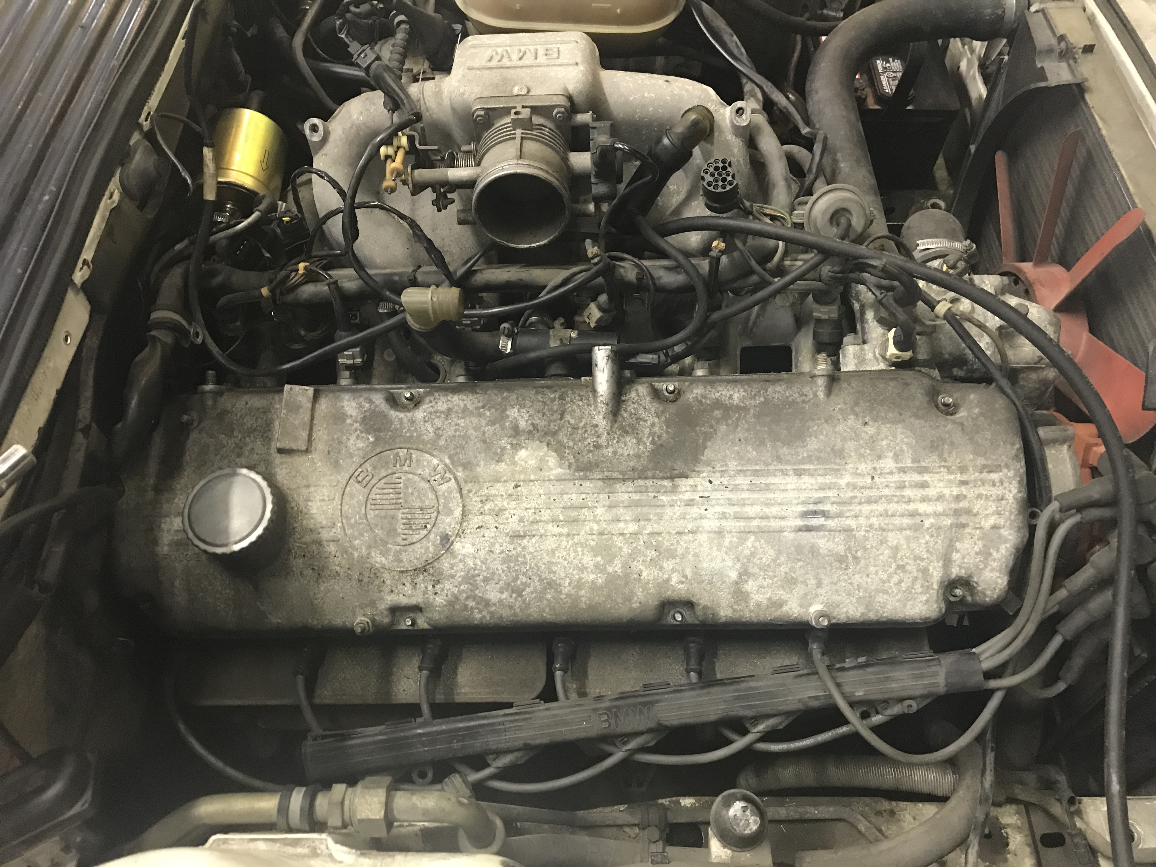

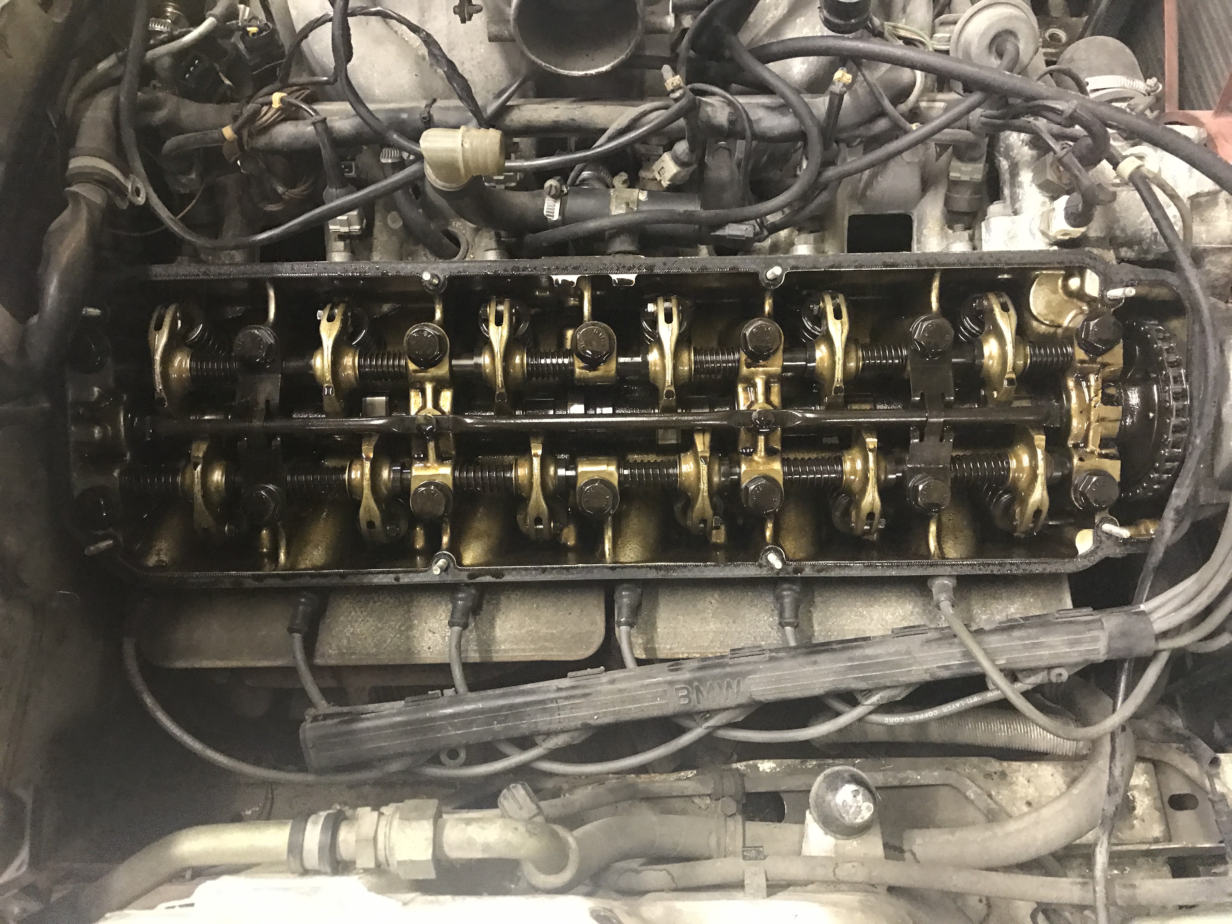

    More progress. I pulled the valve cover off to replace the gasket, paint the cover, paint the air box and AFS, replace the breather hose, and do the oil tube update @YoungCRmentioned earlier.

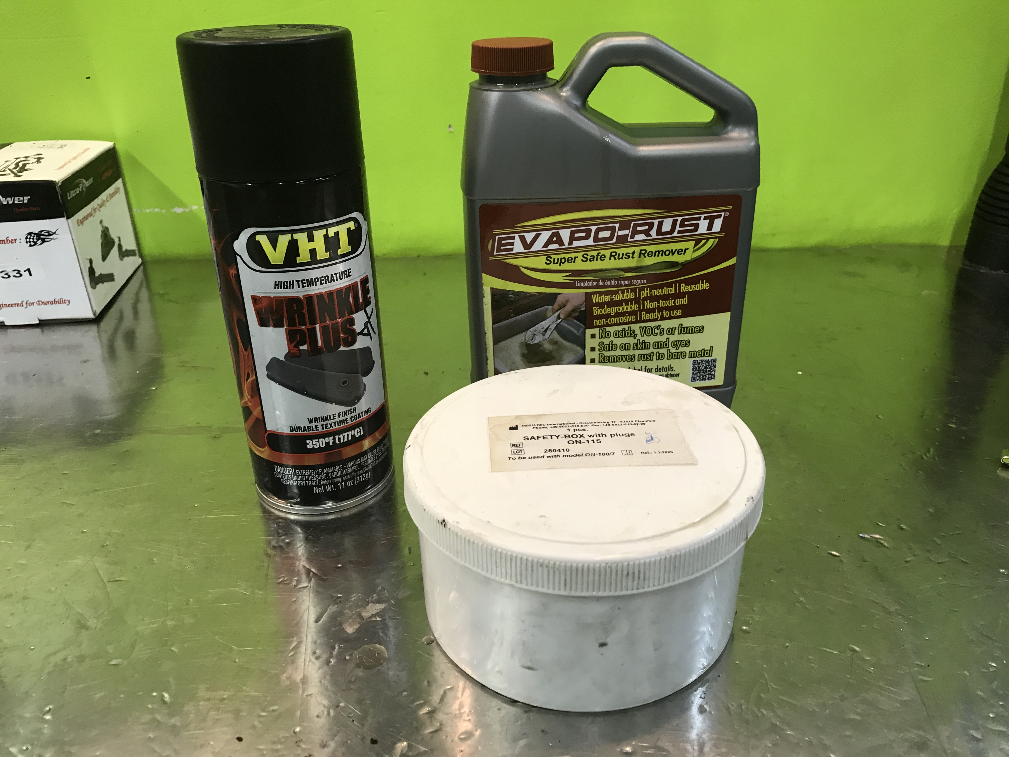

    I used the Evapor-rust to clean the clips and bolts holding stuff together while I strip and paint stuff and bake it on the oven with VHT.

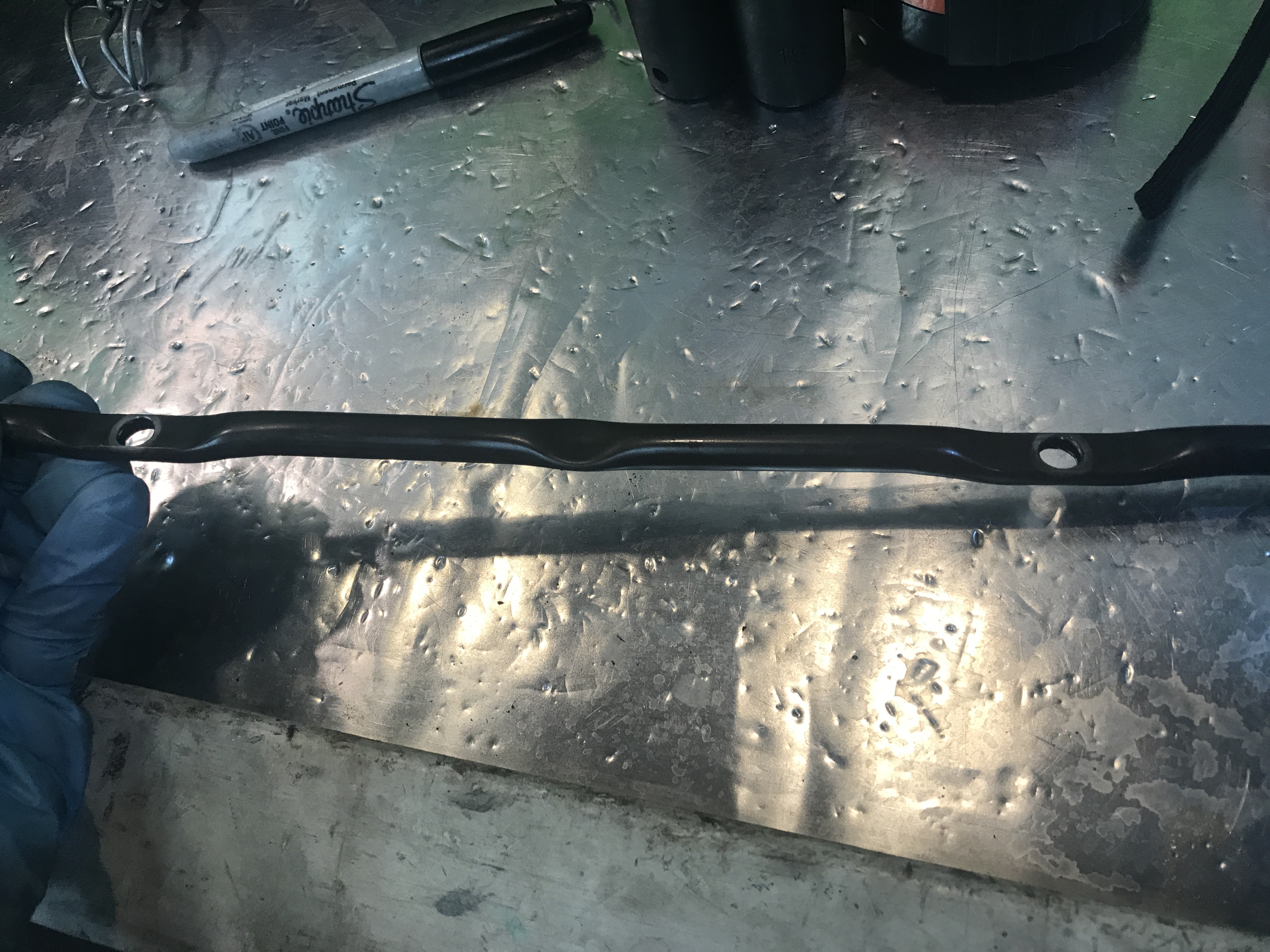

    Before the modified oil squirter looked like this( when I finally got it out)

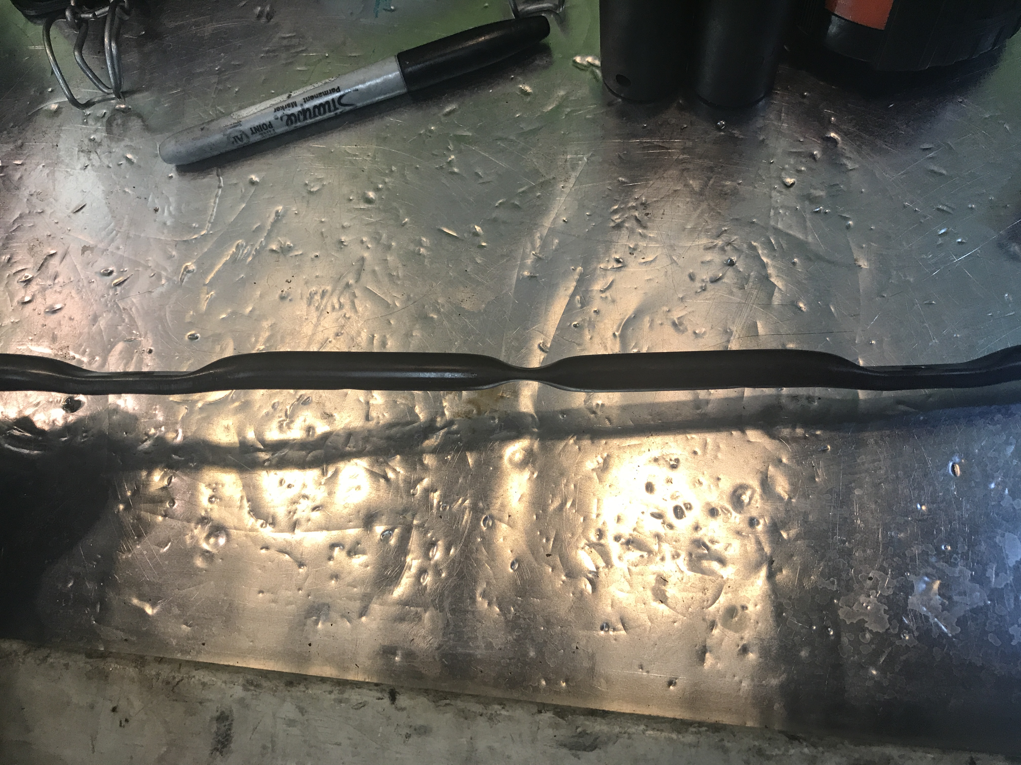

    And after I compressed the center. This is a common fix to help add oil pressure to lubricate the front rocker arms during low RPM driving. IMG3949.JPGIMG3948.JPG
    I want to do this mod to mine!
