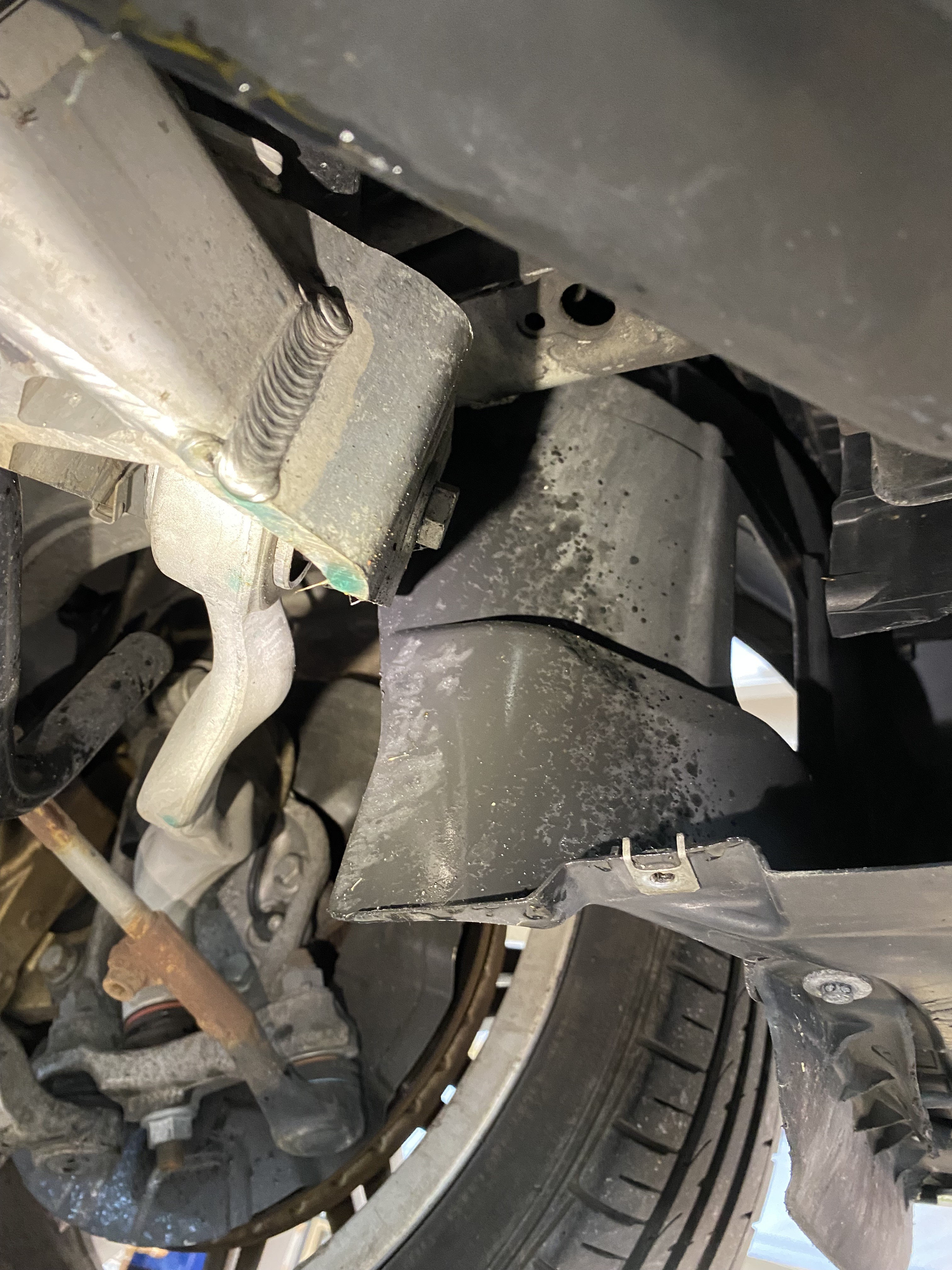

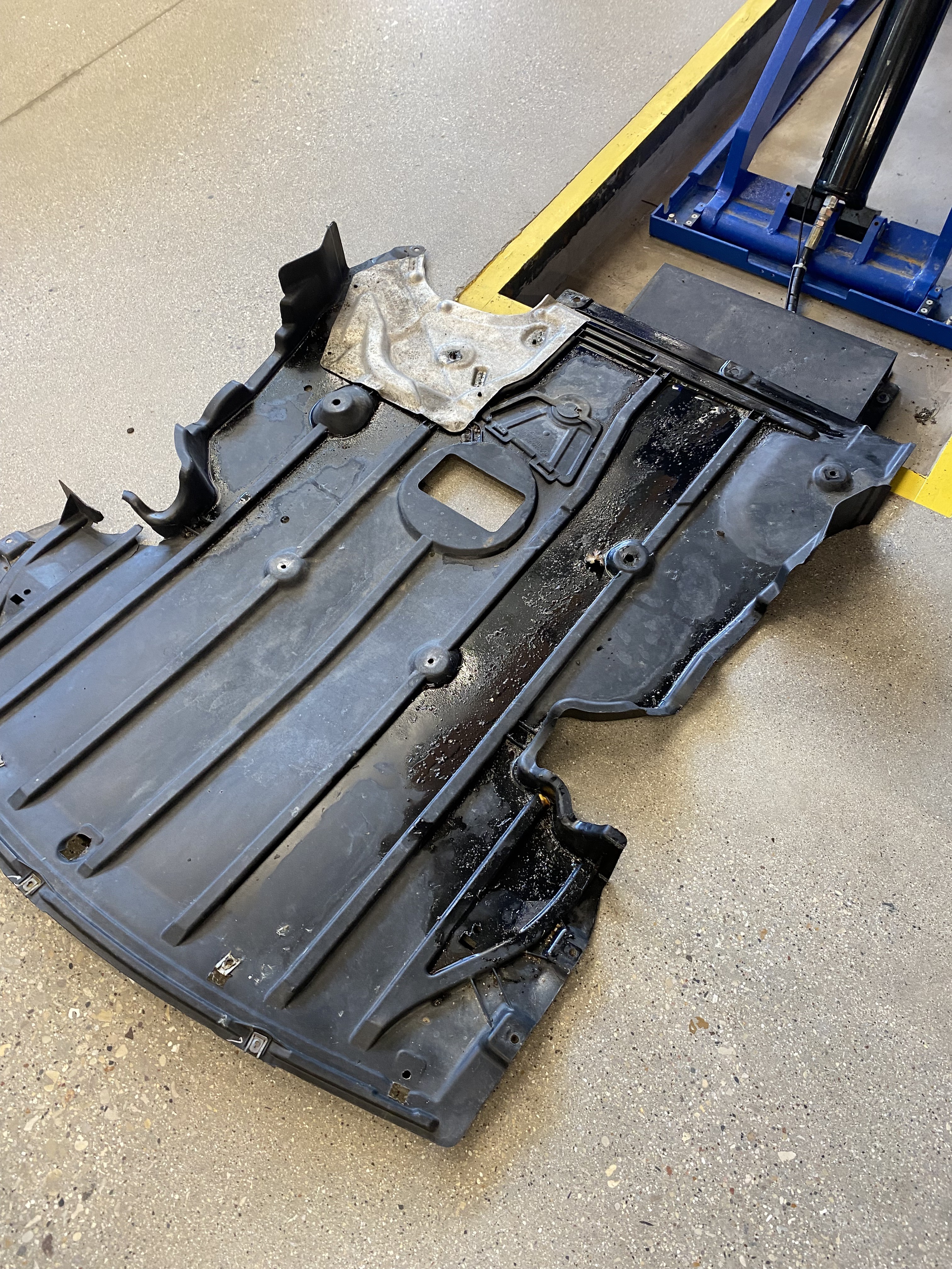

    M3 control arms are installed! This car has been a joy to work on so far with how clean it is underneath. I really should fluid film it this year to keep it that way…
    Found that the drivers side was leaking fluid from the bushing (that’s an odd sentence, brought to you by none other than German engineers), and both driver and passenger side had some cracking/were soft. Ball joints still seemed tight.
    The first side took a little over an hour by the time I figured out where all the screws were on the fender liner and that the wheel had to be pointing straight ahead for the bushing side to install nicely. The second side took maybe 40 minutes tops. An easy job overall, and WELL worth the effort.
    Almost completely solved the shudder under braking (what’s left is barely noticeable and is likely actually from the brakes themselves, or maybe another bad bushing), quieted down the ride, smoothed out the ride, and made the thing handle like a go-kart. Seriously, a car like this has no right to feel as planted and flat as this does. Night and day in the corners, highly recommend doing it if your bushings are getting old. I’d guess it’s a combo of the stiffer m3 bushings and just not having roached ones, but hey, either way I’m not complaining.

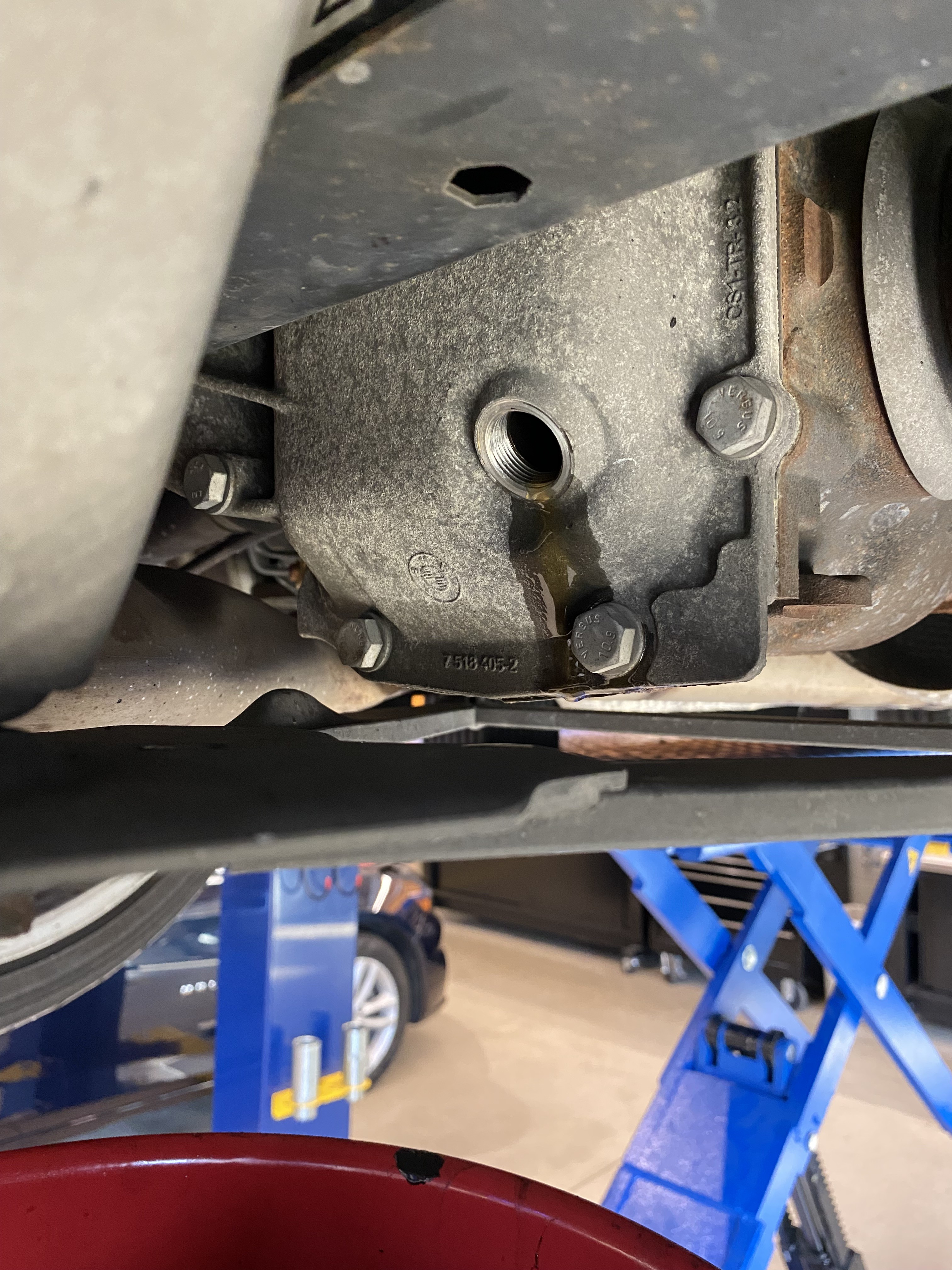

    PS flush up next, along with that diff oil change and the headlight restoration. Beyond that, I found the drivers side strut is leaking so those are definitely due for replacement, along with the front upper control arms. I’d like to do rear subframe inserts before digging into rear bushings, there’s so many damned arms and linkages back there.

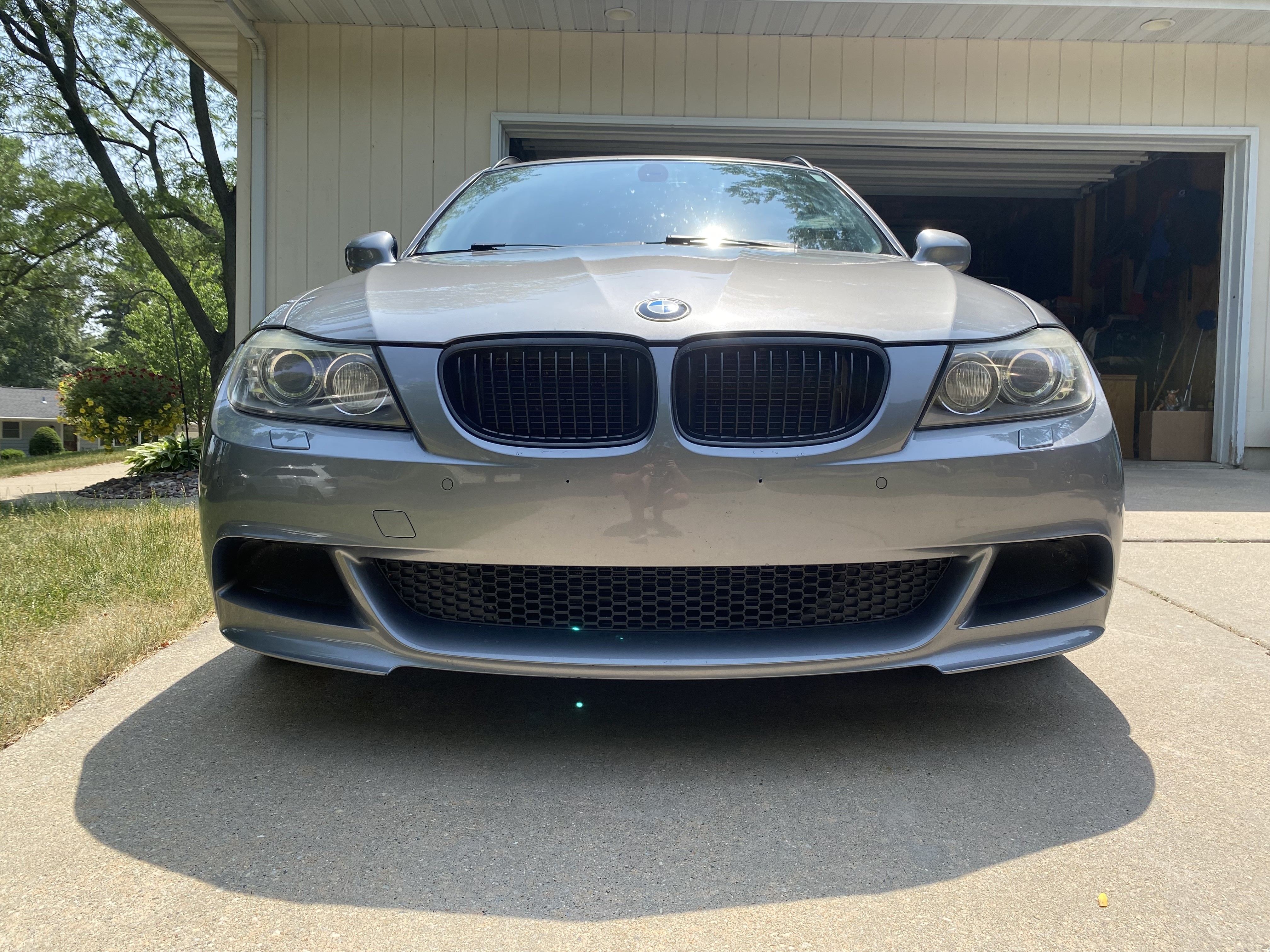

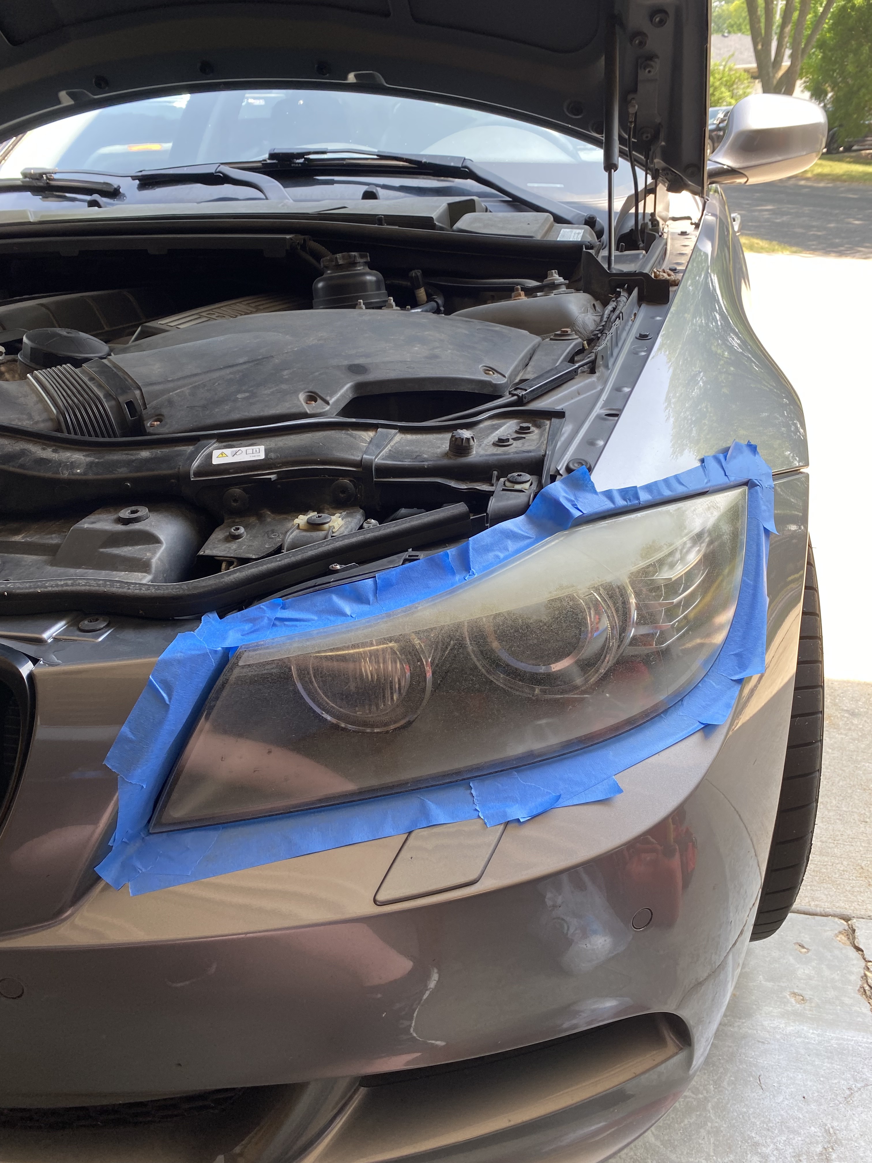

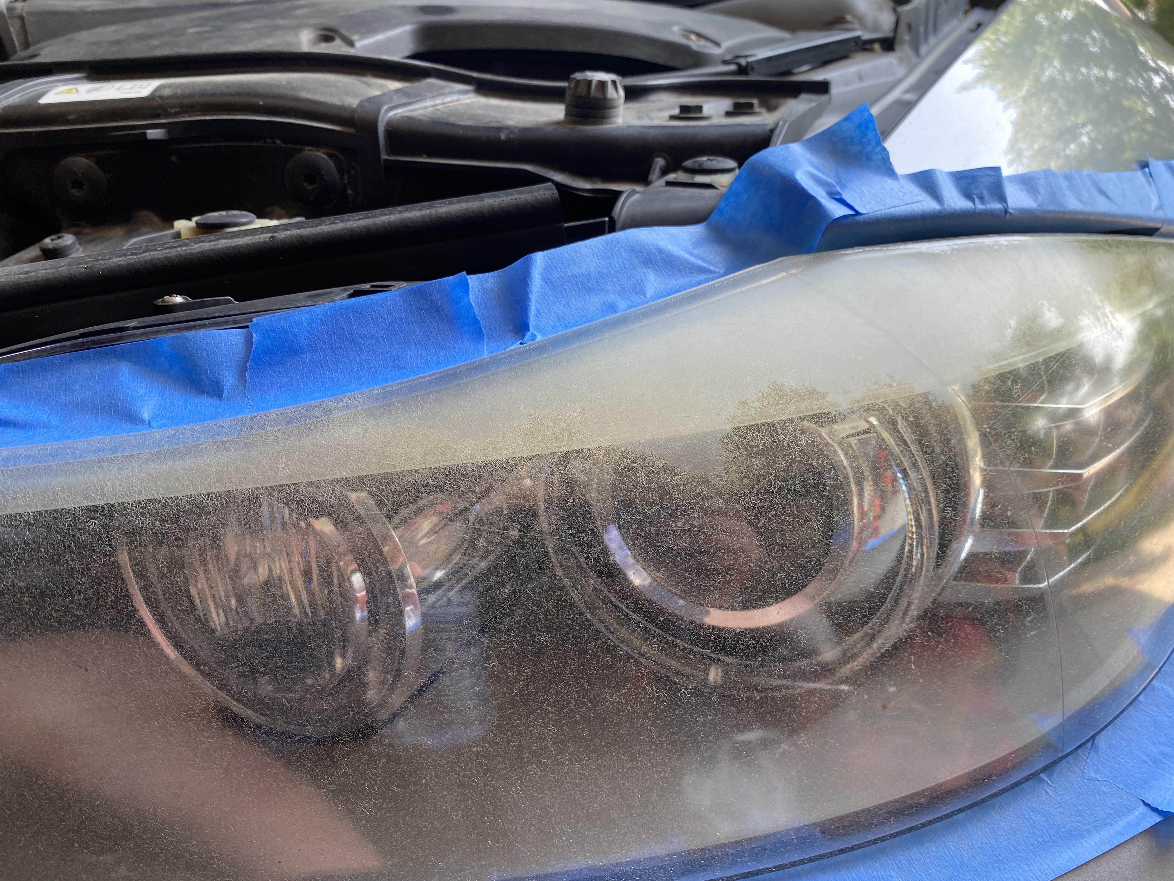

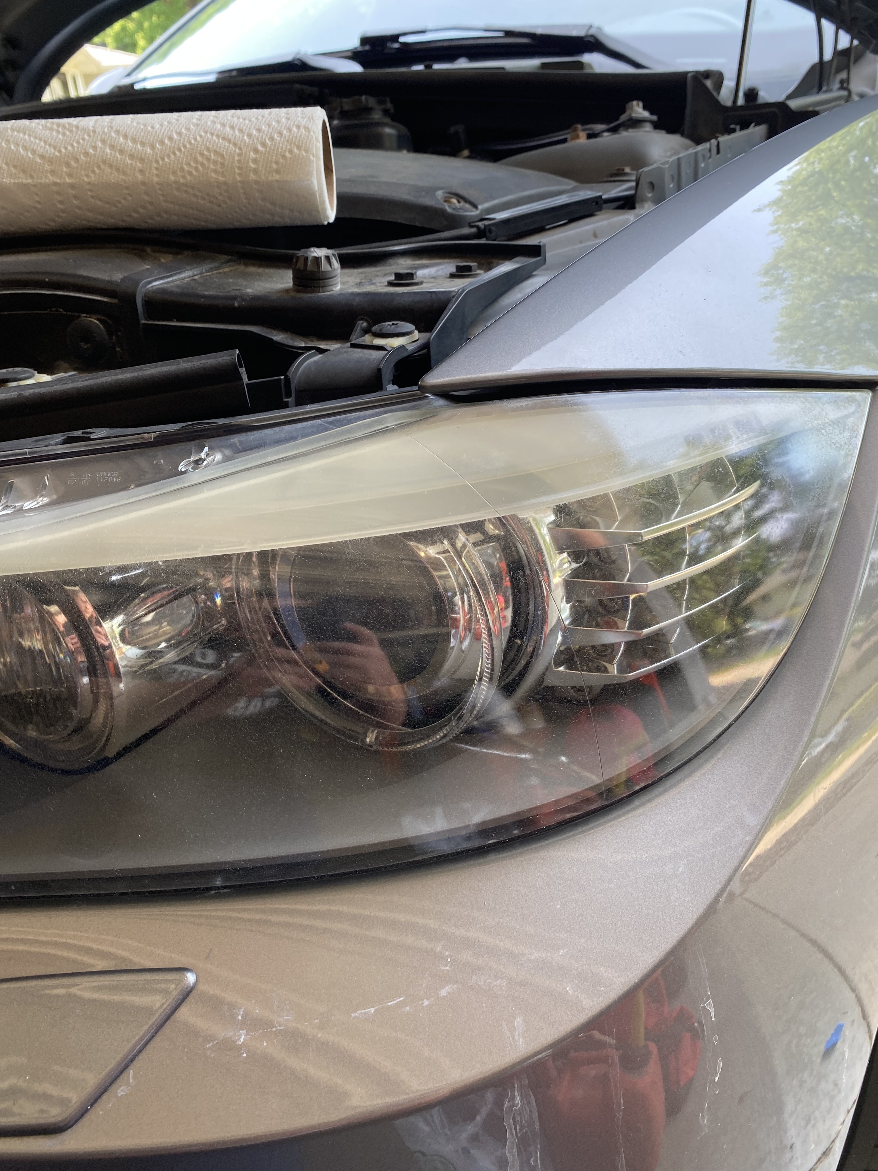

                Refinished the headlights this weekend!
                Went with a box kit instead of the 2k clear this time, I decided to see how long it lasts and make a decision from there. Initial impressions are that it turned out great though!
                Before:
                After:
                I will note, I wet sanded from 1200 up to 3500 grit on the passenger side light instead of starting at 2400 on the drivers side, and it turned out way better. Highly recommend getting some extra paper in coarser grits if you use a kit like this, it really makes it turn out much nicer.

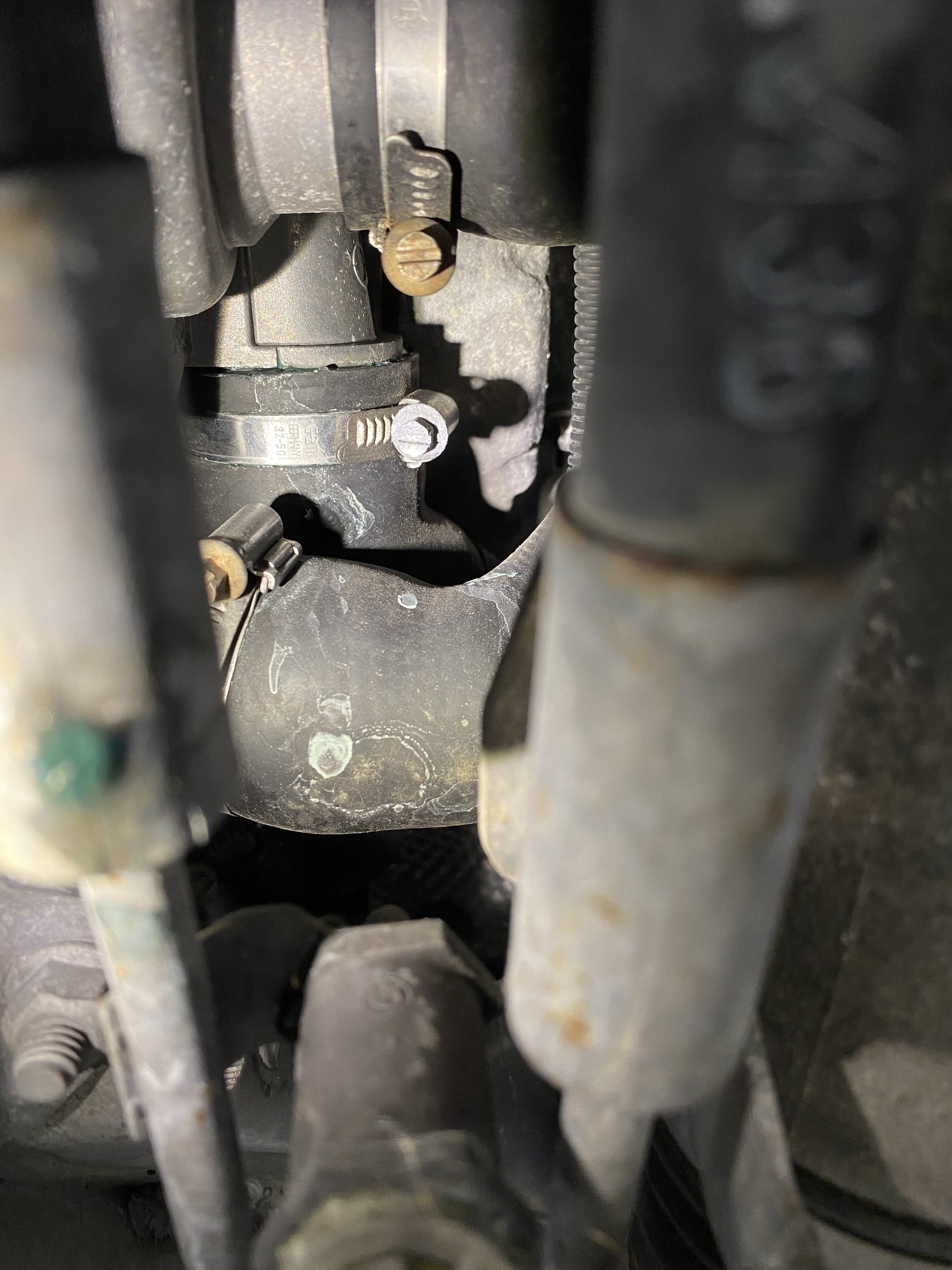

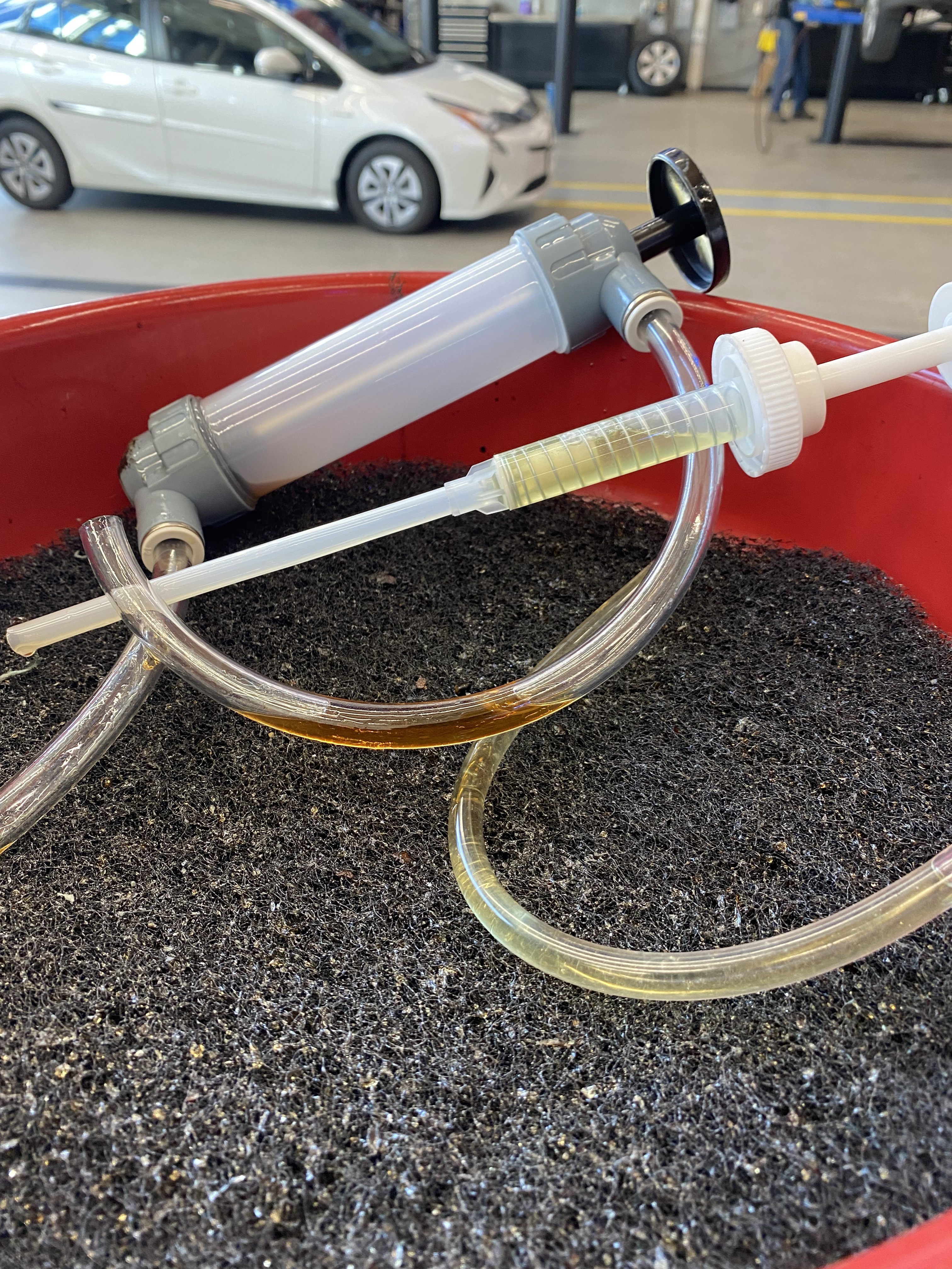

                  Power steering fluid flush completed. I initially tried to flush by disconnecting the return line and directing into a catch bottle, capping the reservoir nipple, and filling as I turn the wheel back and forth, but stopped when I couldn’t get the hose off of the reservoir. It was stuck on there pretty good and I didn’t feel like cracking the reservoir wrestling with it.
                  I’ll try that method again when I buy a replacement reservoir; until then, I just drained and refilled the reservoir 6ish times with a quick drive around and some lock to lock turns in between each. It took the fluid from “used motor oil” to “slightly dirty green pentosin” so I’ll call it a win. Not going to let perfect get in the way of improvement. I have a spare liter still so I’ll probably burn that at the next oil change with a few more drain and fills.

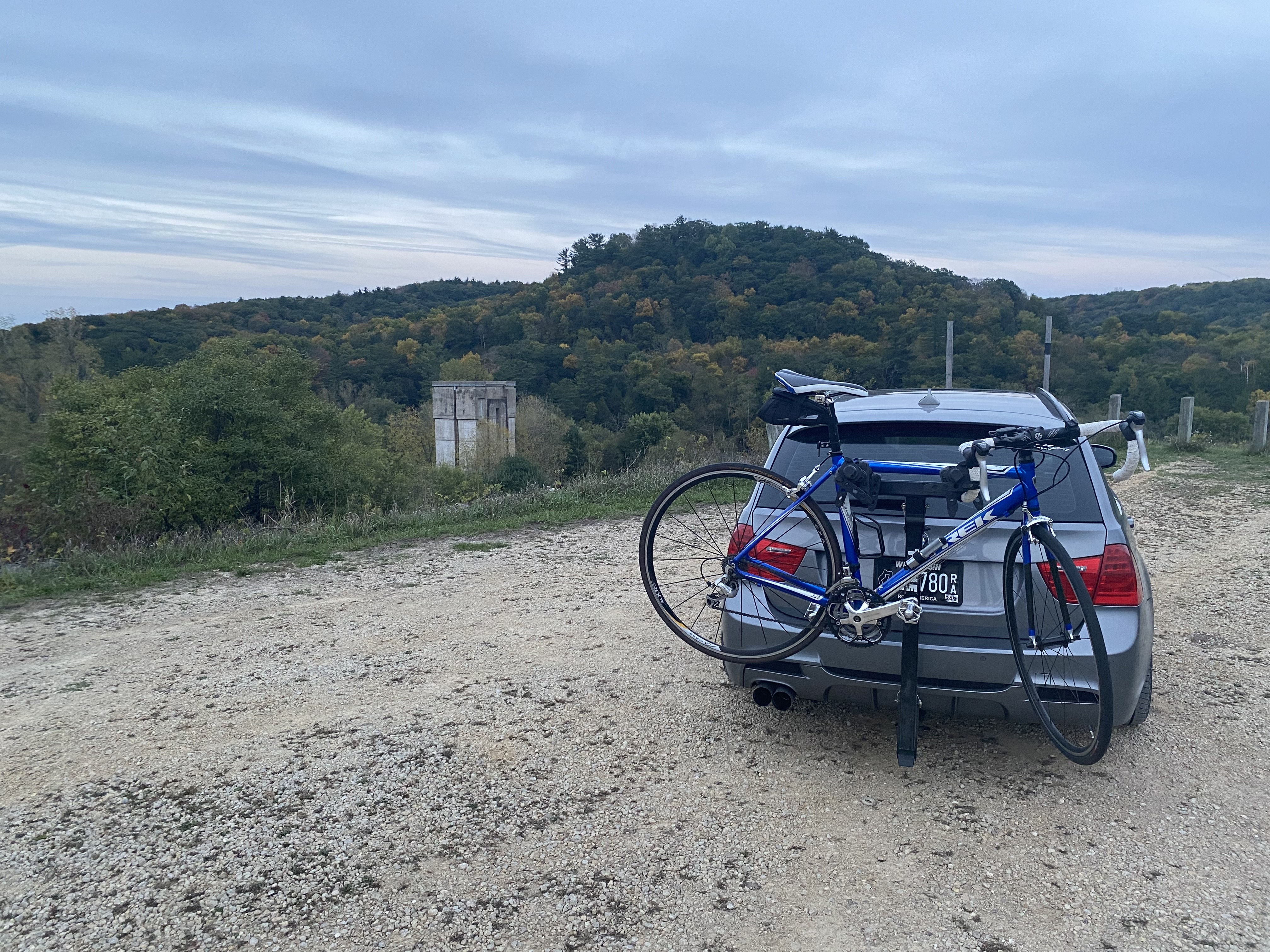

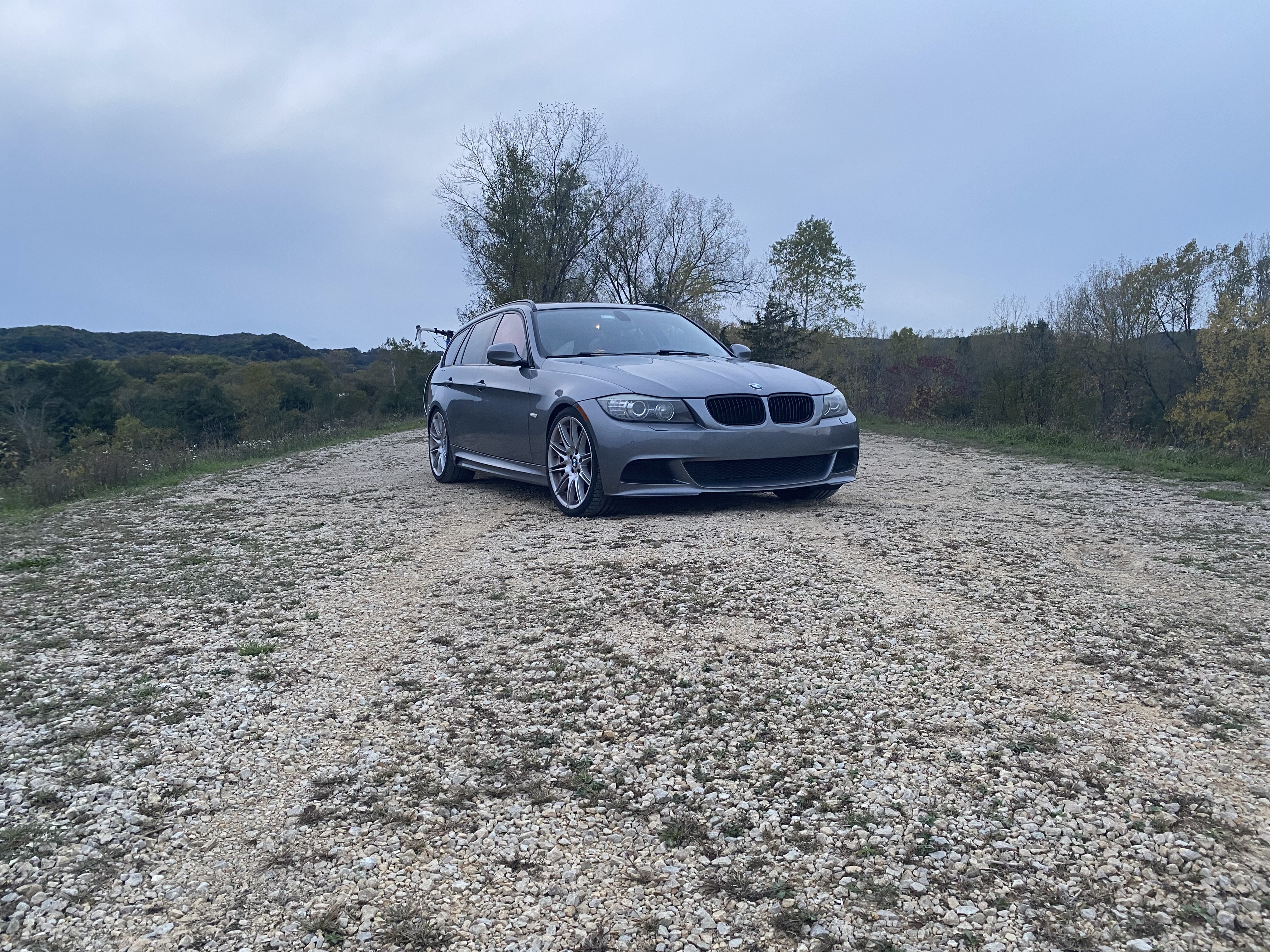

                    Did a sorta-kinda triathlon this weekend near La Farge - paddled in lieu of the swim. Did about how I expected, 5/8 in my class and 71/138 overall. Considering I haven’t competed in anything similar ever, I feel pretty happy with it and definitely identified some spots for improvement.
                    In addition, I did some backroad bombing and snagged some photos of the car while I was there. It played the role of camping rig beautifully, and had zero hiccups. The adaptive headlights are seriously incredible for driving after dark in the country, I wish all my cars had them.

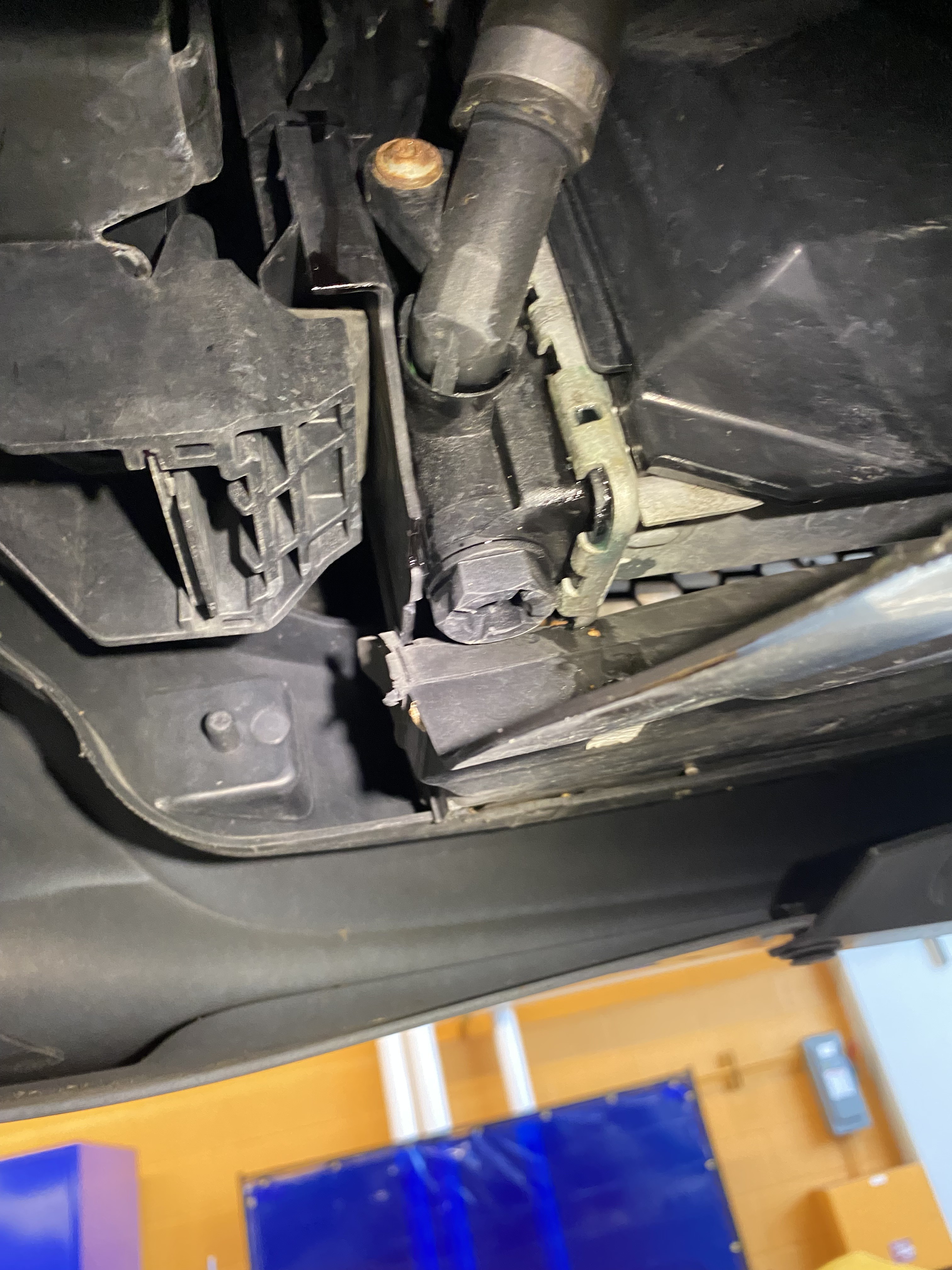

                              I went with the method of removing the blower motor and spraying directly onto the evaporator; my first attempt I missed with the hose and didn’t get it all the way there. The second try, I got the hose sufficiently far over and hit the evaporator square; it foamed up nicely and drained thru the evap drain hoses along the trans tunnel.
                              I waited 20ish minutes, put the blower back in (so much easier than the e30), and ran the fan on high for 10ish minutes to dry it all out. I’ll report back in a week or two on the results!

                                  Smell is still there. I’m going to try it again I think (maybe spraying some down the hvac air intake as well) to see if that helps. It’s definitely better, it’s almost gone once the hvac has run for a few seconds, but it definitely still there.
                                  The blower motor had the same smell as the air I’ve been getting out of it, so I’m wondering if the smell and gunk is in the ducting too. I haven’t replaced the cabin air filters either, so might do that. They’re almost external though so it’d be a bit odd if that was the culprit.
