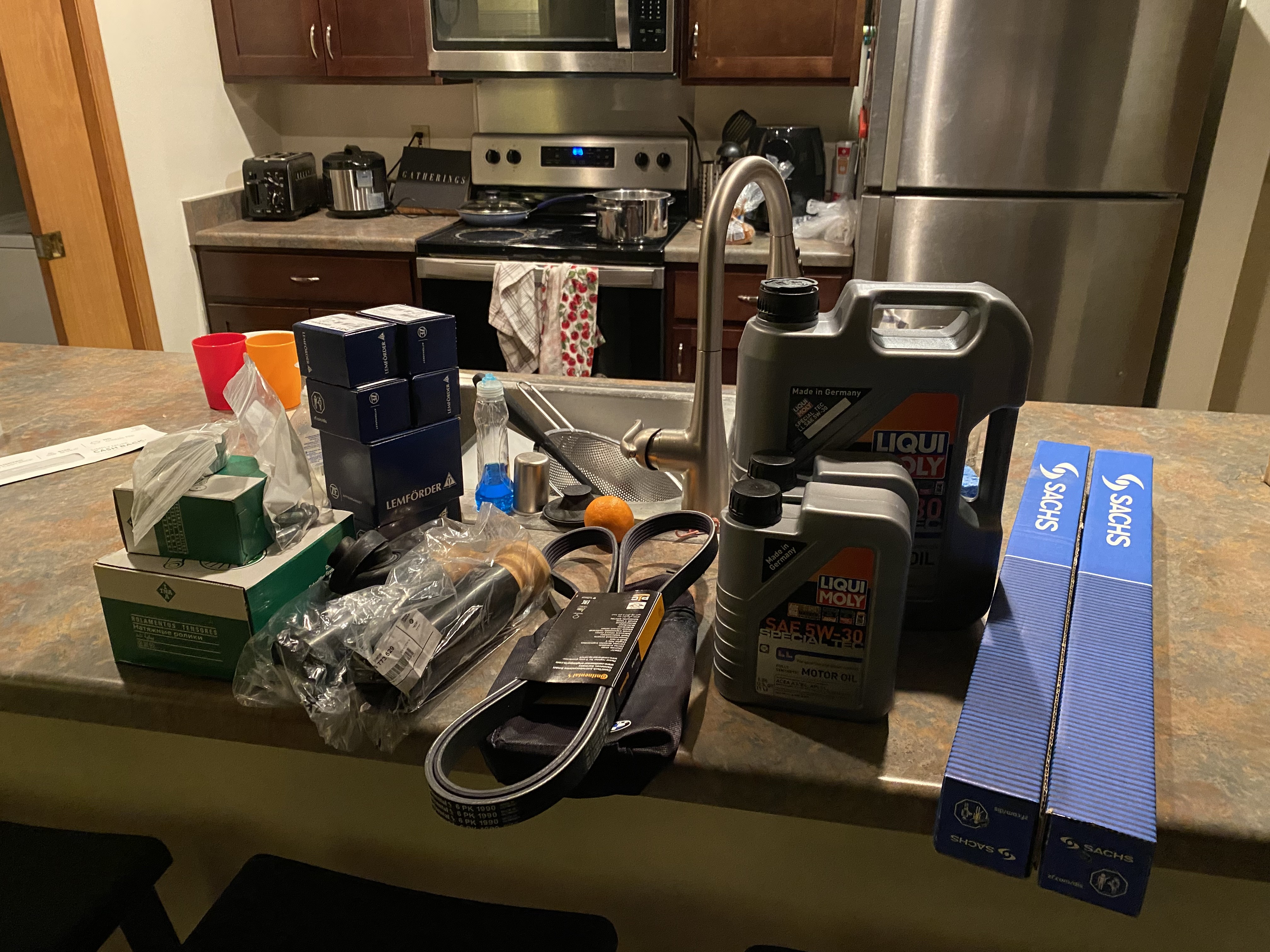

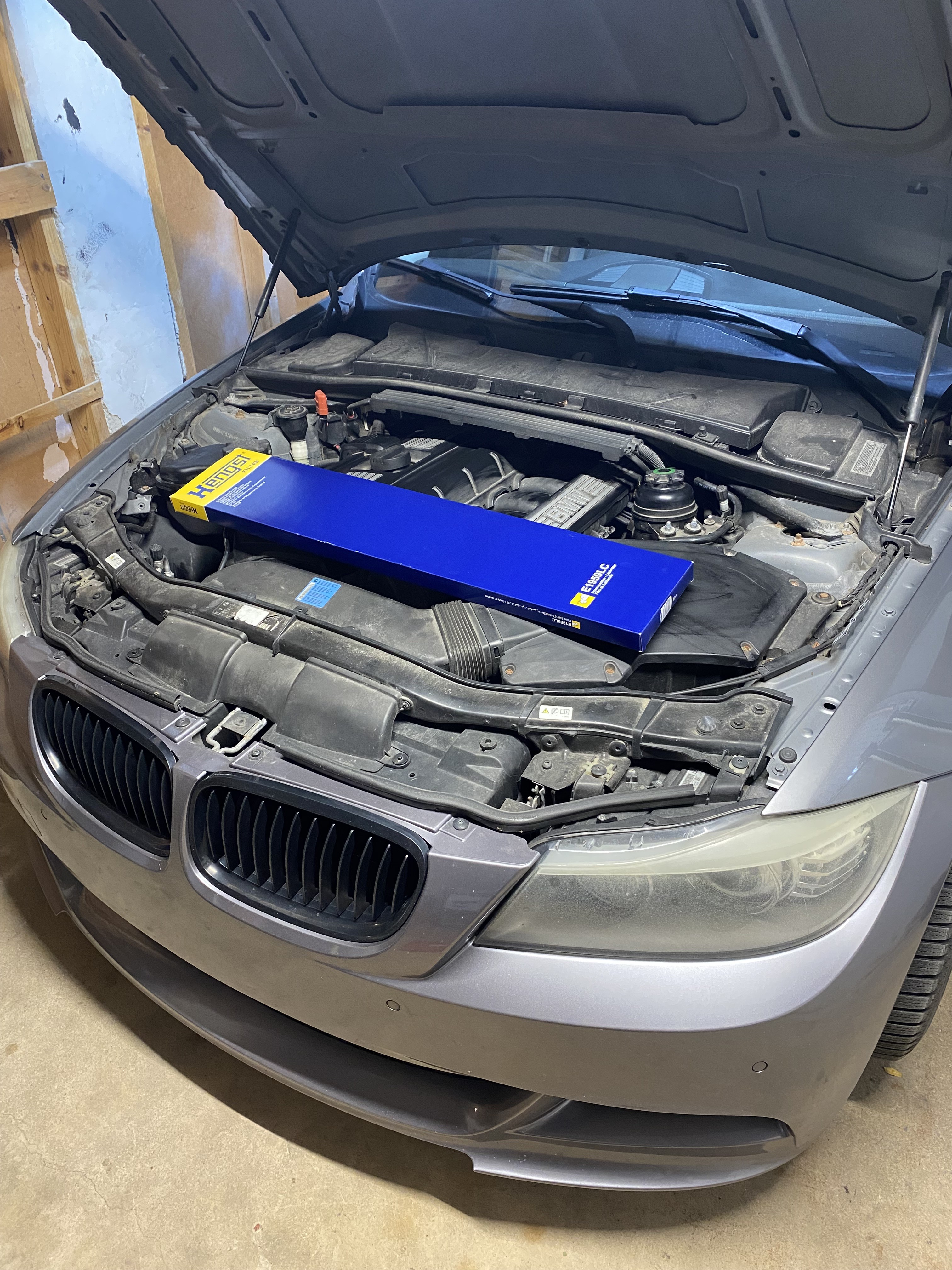

            First parts ordered. Taking care of the oil change, serpentine belt, and rear shocks (including the mount kit) with this batch of parts. Damping when the car is loaded is… not quite what I want to keep things from going flying, so I’m going to take care of the rear shocks sooner than I initially planned and then doing front struts this spring/summer when it’s warmer. Ordered the Continental kit for the serpentine and OE M Sport Sachs dampers for the rear.

                First batch of parts has arrived!
                Hoping to find time this weekend or next to get the shocks installed, oil changed, and serpentine belt/pulley/tensioner replaced. It’ll go in fairly soon for the wheels to be re-balanced, and it’ll be aligned in the spring when I’m done replacing some other suspension bits. At this point, planning for:

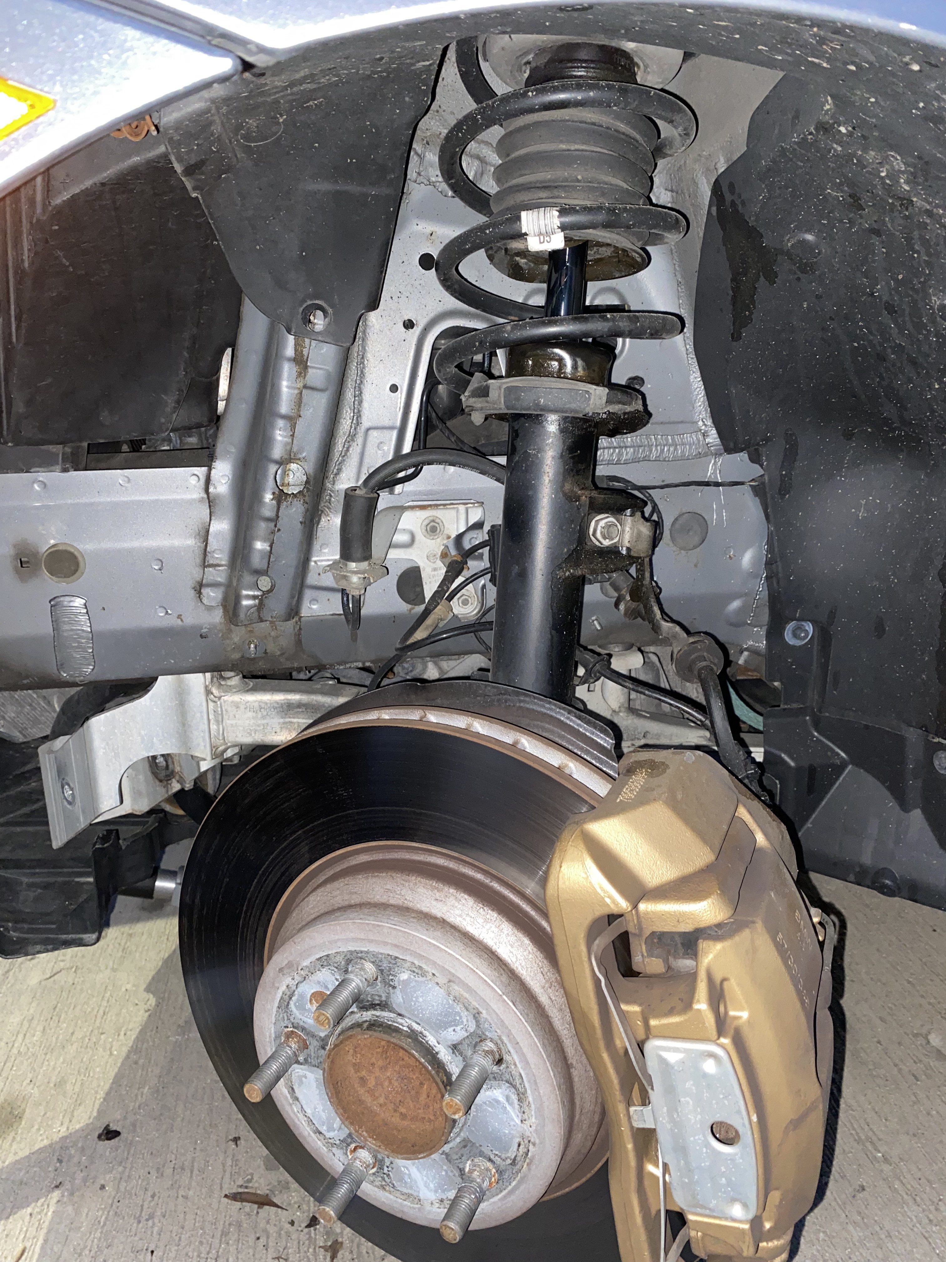

                - Front shocks
                - Front upper and lower control arms (replacing with the TRW M3 parts)
                - Rear subframe bushing inserts. I know full bushing replacement is ideal but I don’t care to jump in that far just yet.
                - Any other rear bushings the shop notes as torched. Anyone who has done rear end work on an e90, are there any bushings or ball joints in particular that tend to go earlier than others? Ideally I’d like to not have to replace everything at oncoming the entire car, so if I can do a few things on the rear and the whole front this year, and other rear bushings later, that would be ideal.

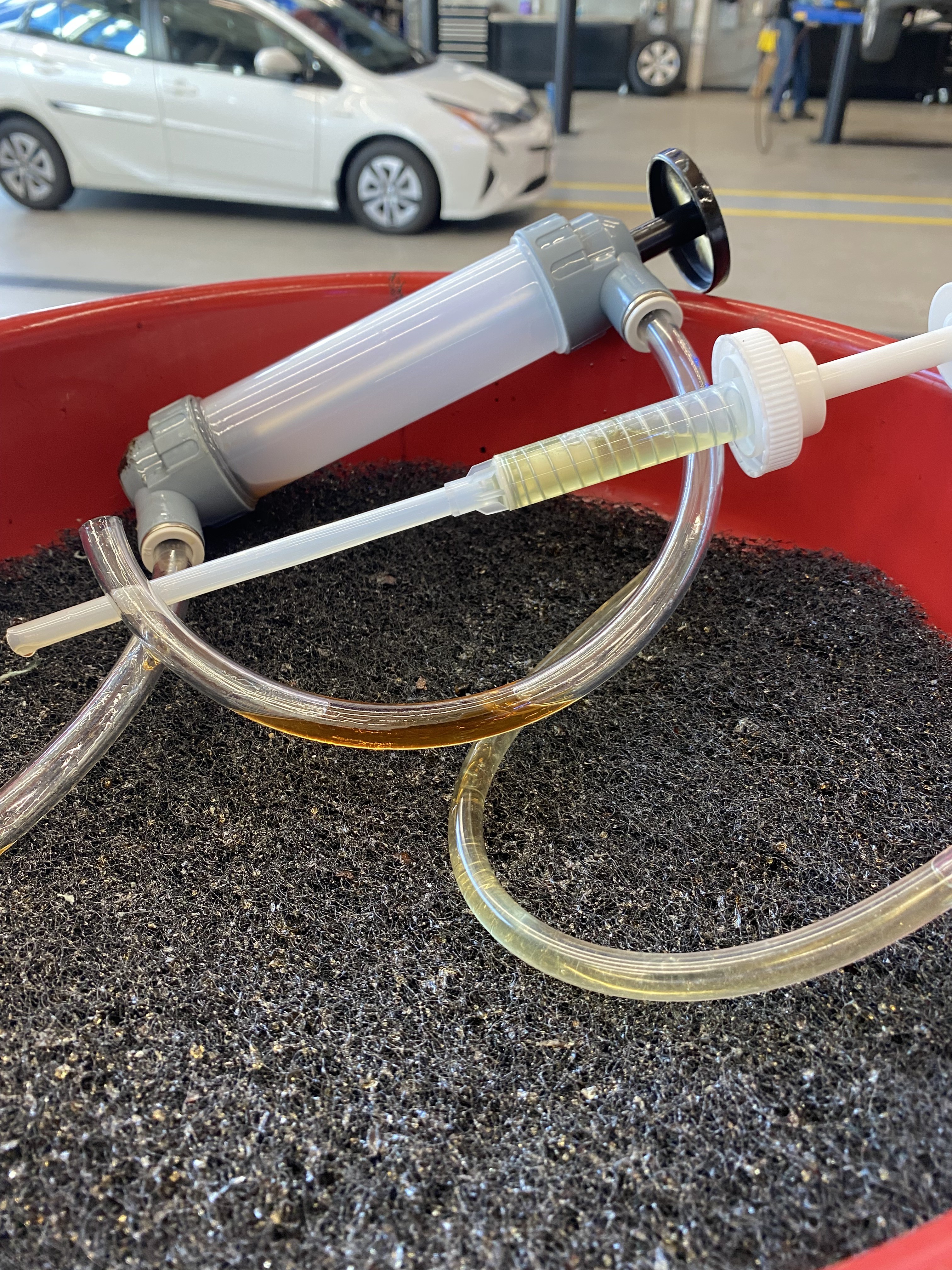

                            Drained and refilled transmission using Liqui-Moly Top Tec 1800 (Dexron 6), replaced the trans filter and gasket, and all new hardware. I forgot to take photos because I suck at forums.
                            Old fluid was definitely very dark and this was definitely the factory fill, but better late than never I suppose. From some research, 130-150k is getting to the range of where it might not be worth it to risk, but the number of success stories with 120-130k gave me some confidence. I wasn’t getting trans slip before doing it but it was starting to shift a little jerkier when cold so I wanted to try to get ahead of any issues before it was too late. Magnet had metal on it but didn’t seem much worse than the magnets I’ve seen on cars with it changed at 60-80k; it seems that a lot of that debris is from initial break-in.
                            Don’t want to jump the gun, but it definitely seems to shift smoother now. We’ll see how it goes the next few days and I’ll report back.

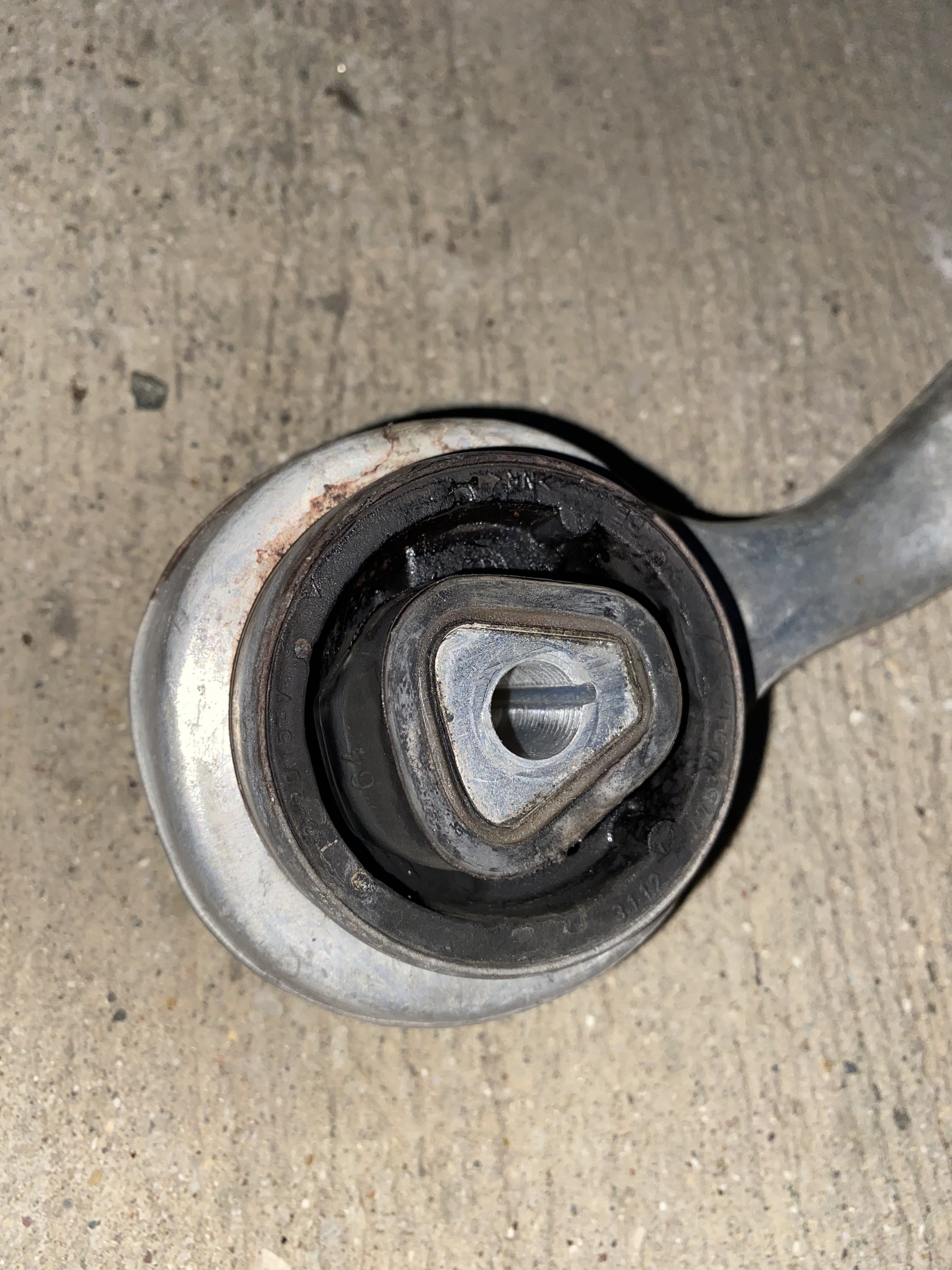

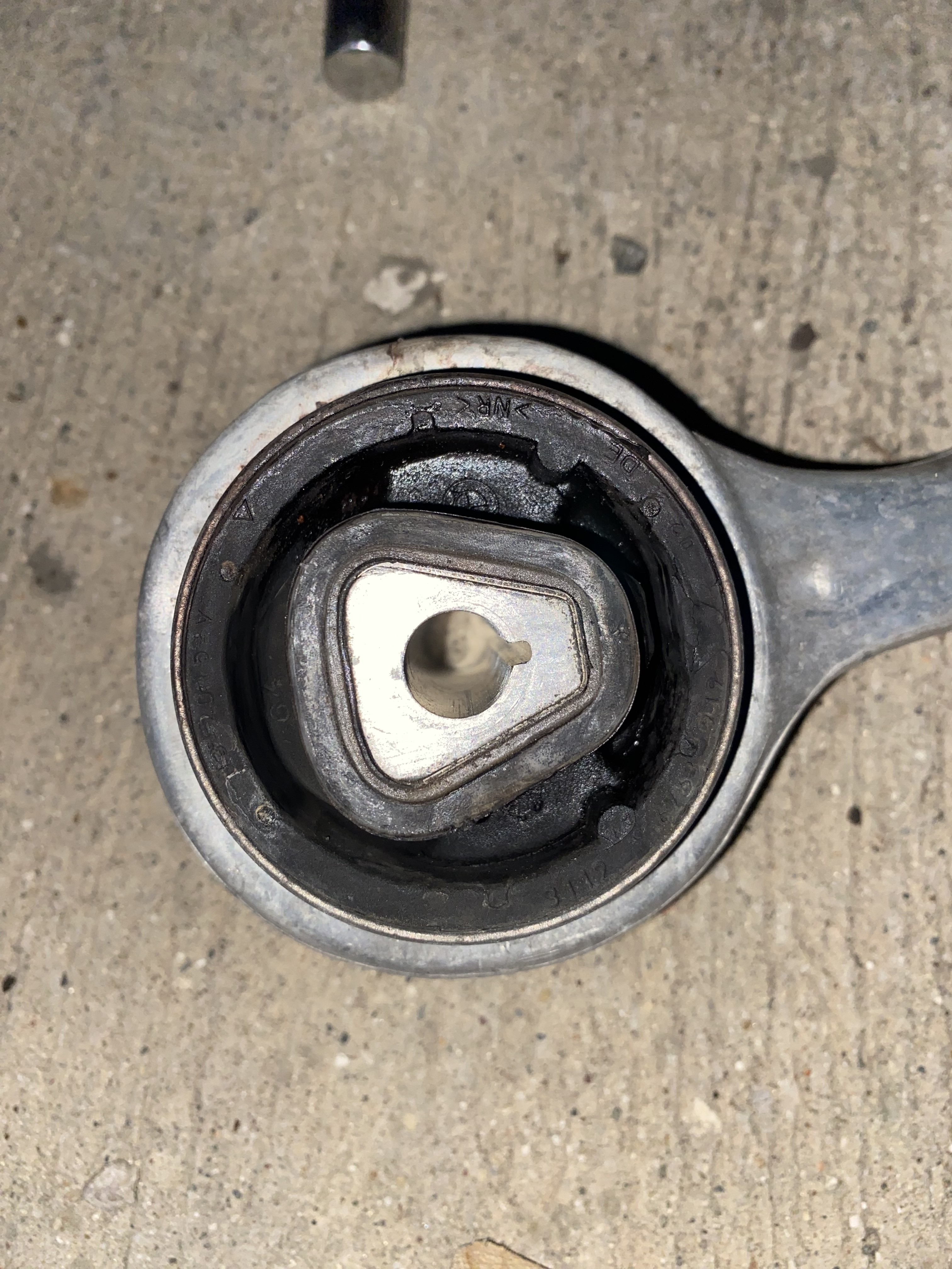

                            Going to order power steering fluid to do a flush there, change out the diff oil, and probably replace the front tension arms with M3 parts as I’m sure they’re toasted by now. I also have a brake vibration that was worsened lately so diagnosing that with a temp gun to see if one is hanging or has some nasty deposits is also on the list.

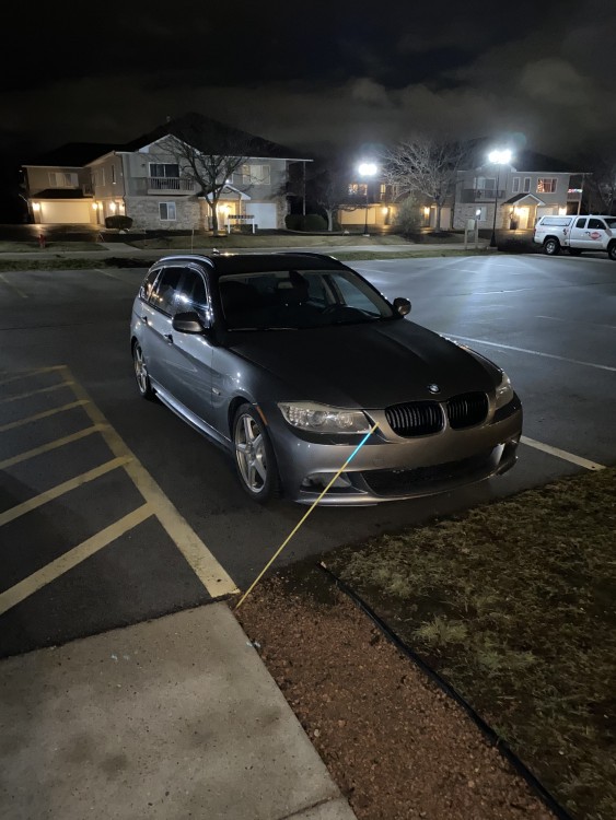

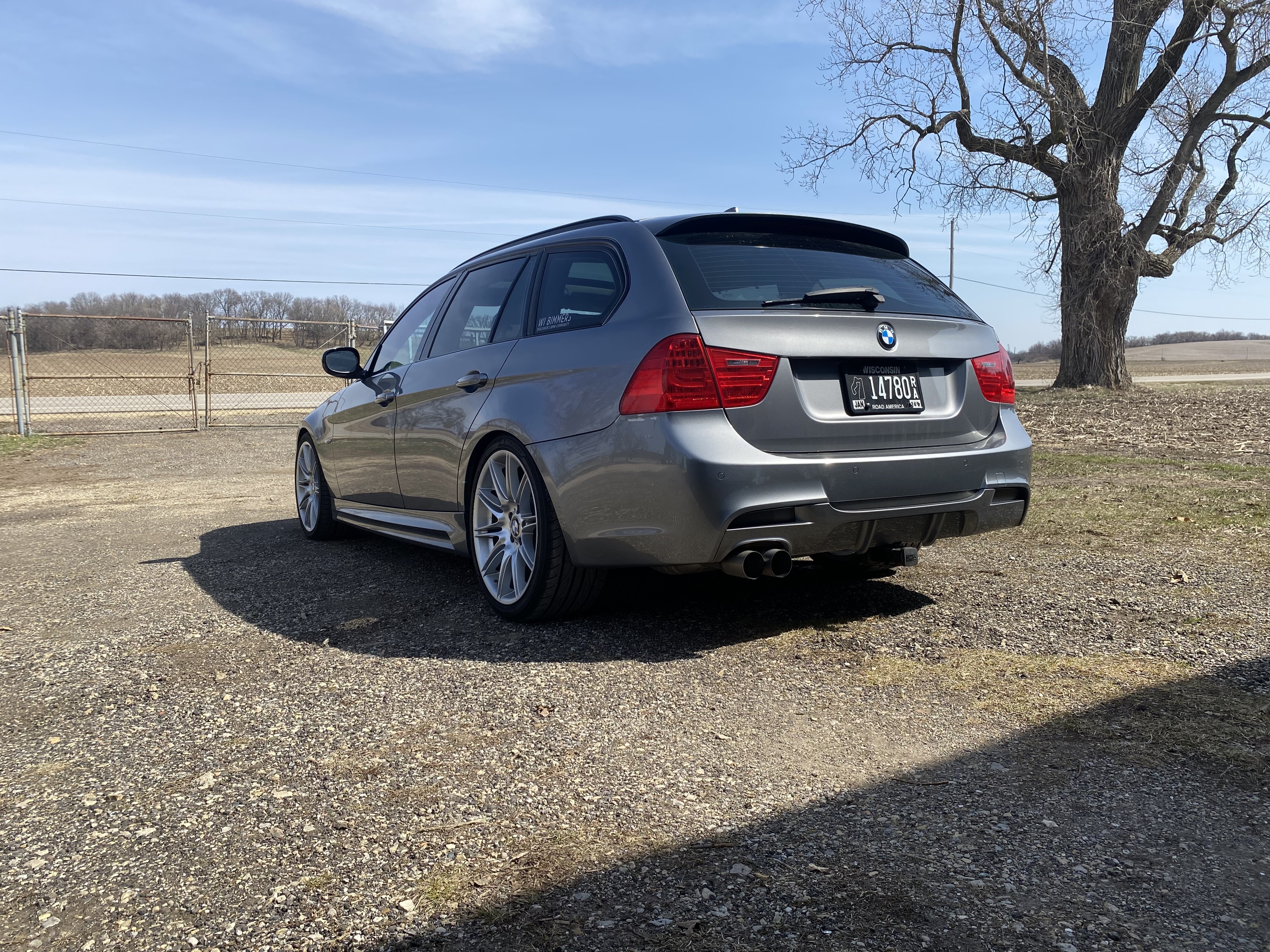

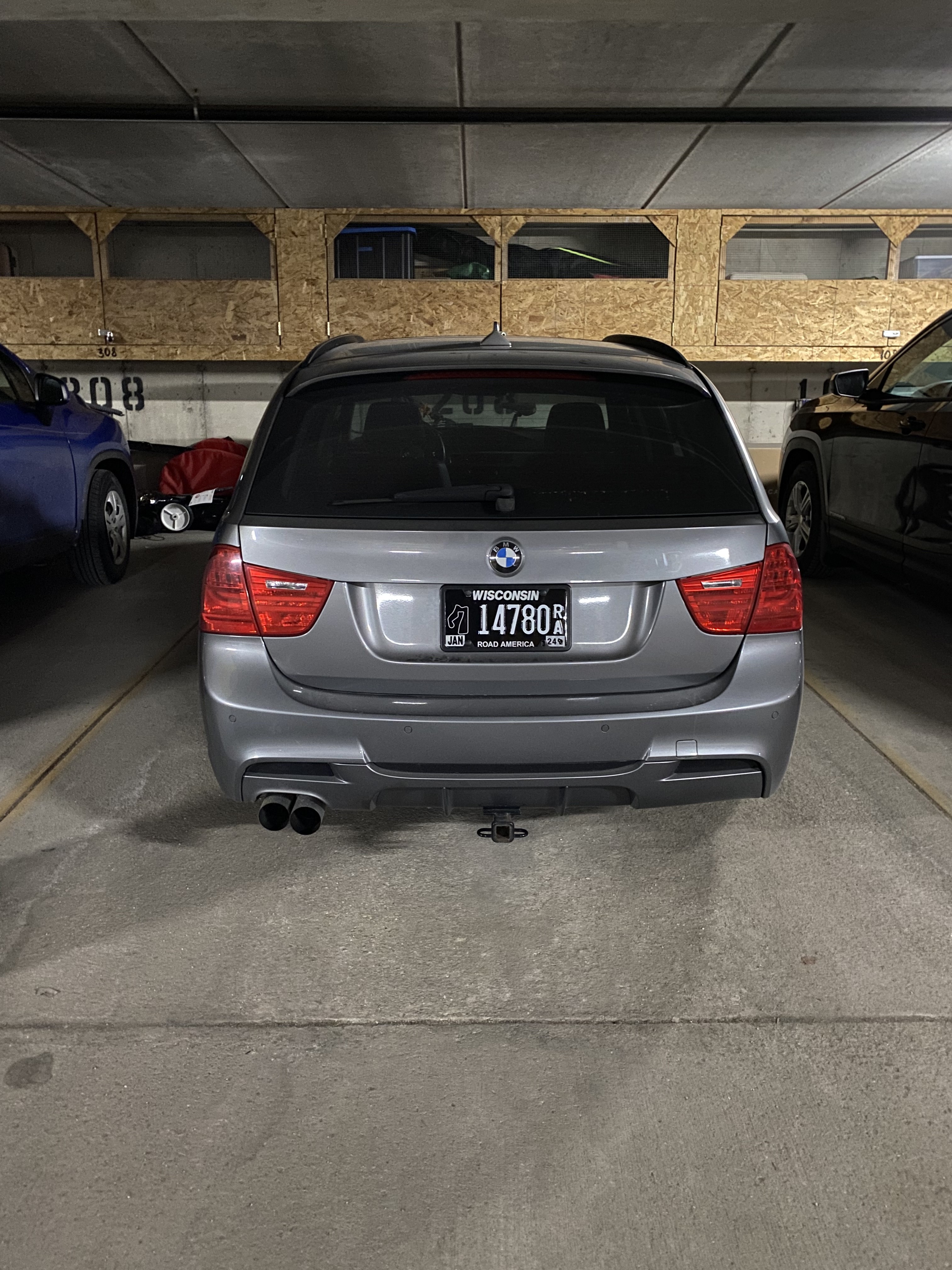

                                  Summer mode engaged!

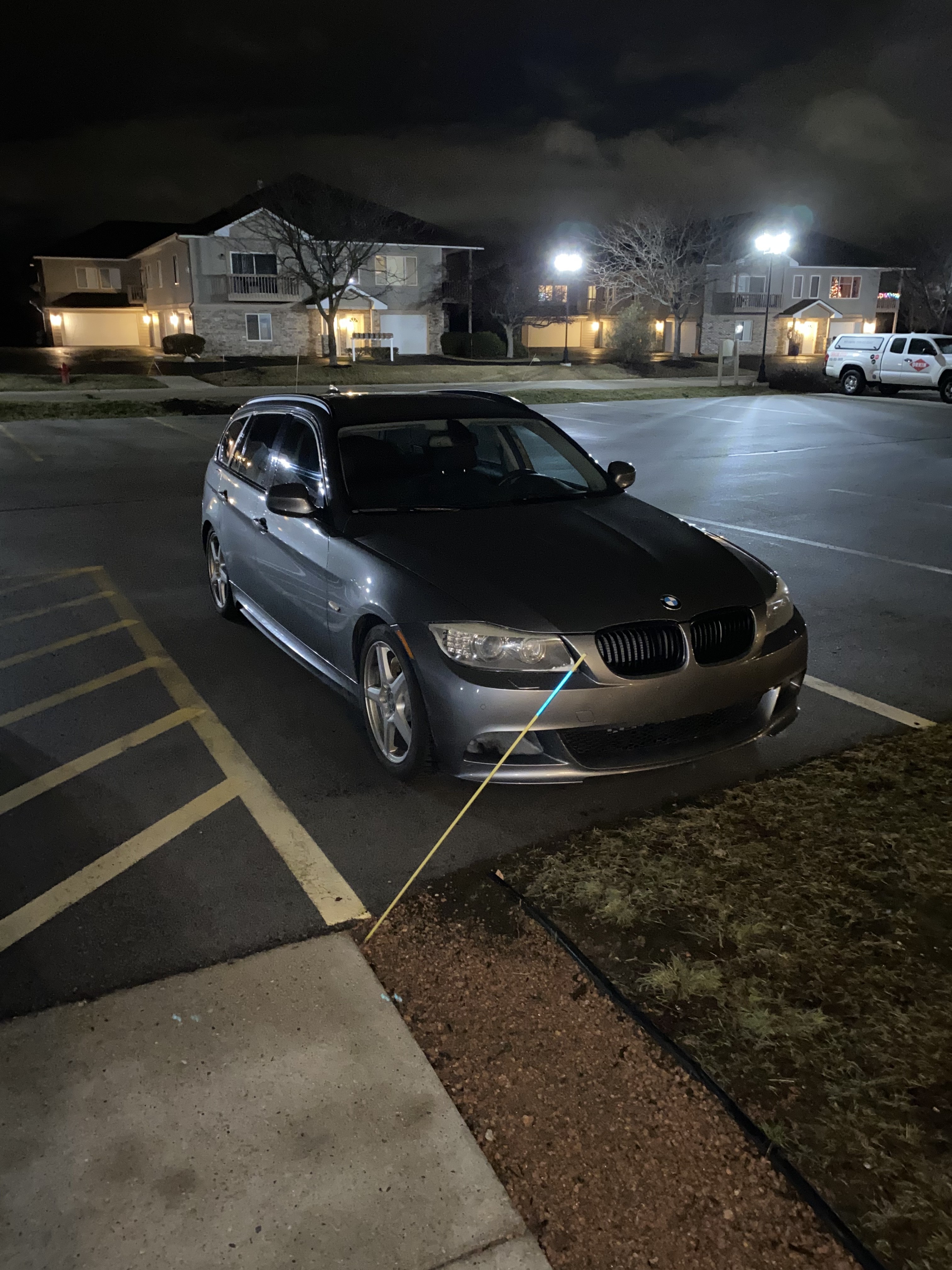

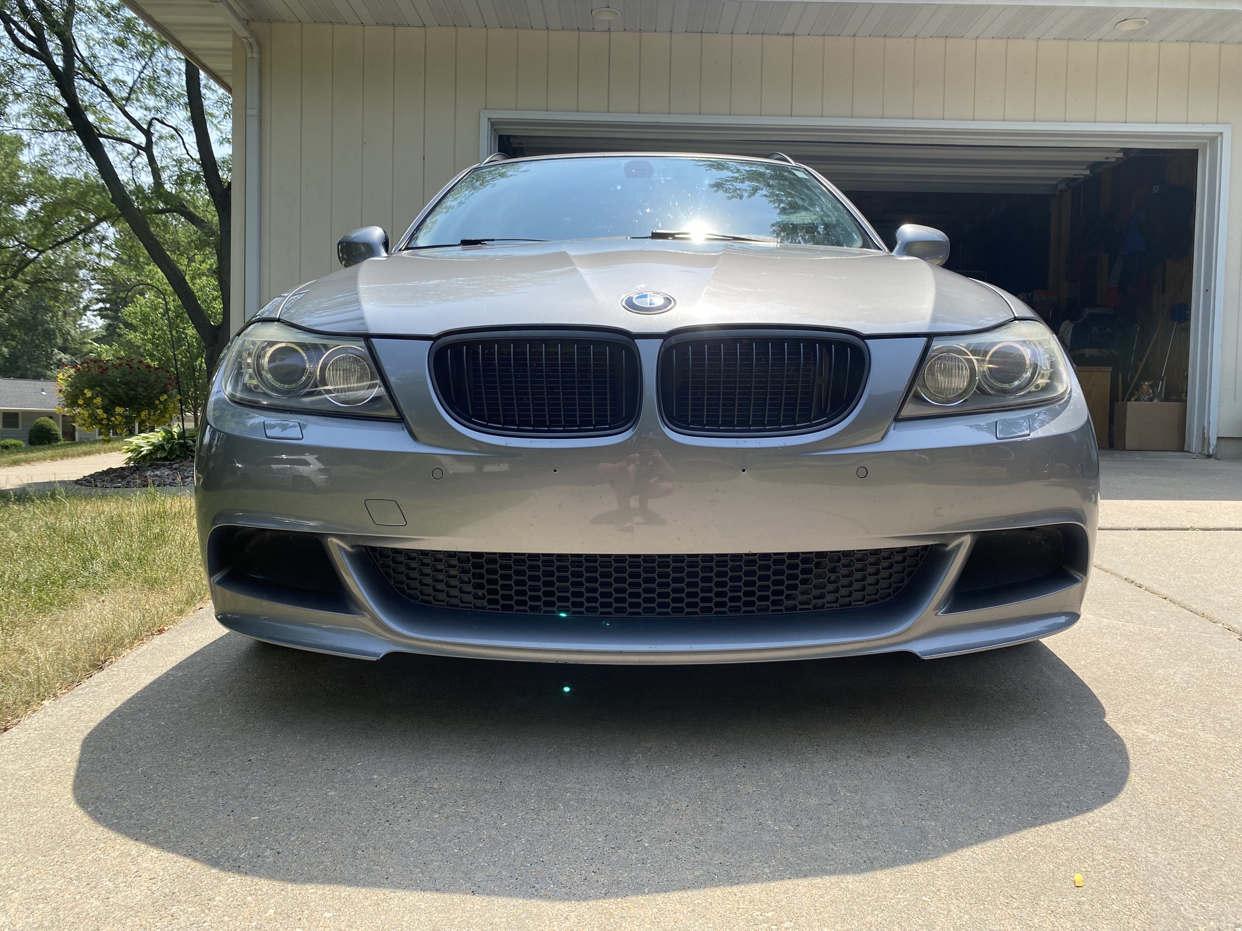

                                  Installed the only aesthetic mod I had planned, LED angel eyes. I didn’t like how the original halogen ones didn’t match the xenon low beams or the license plate/under door courtesy lights, I’m liking the LED much better. Not perfect in terms of color but pretty close and for the price I’m happy.

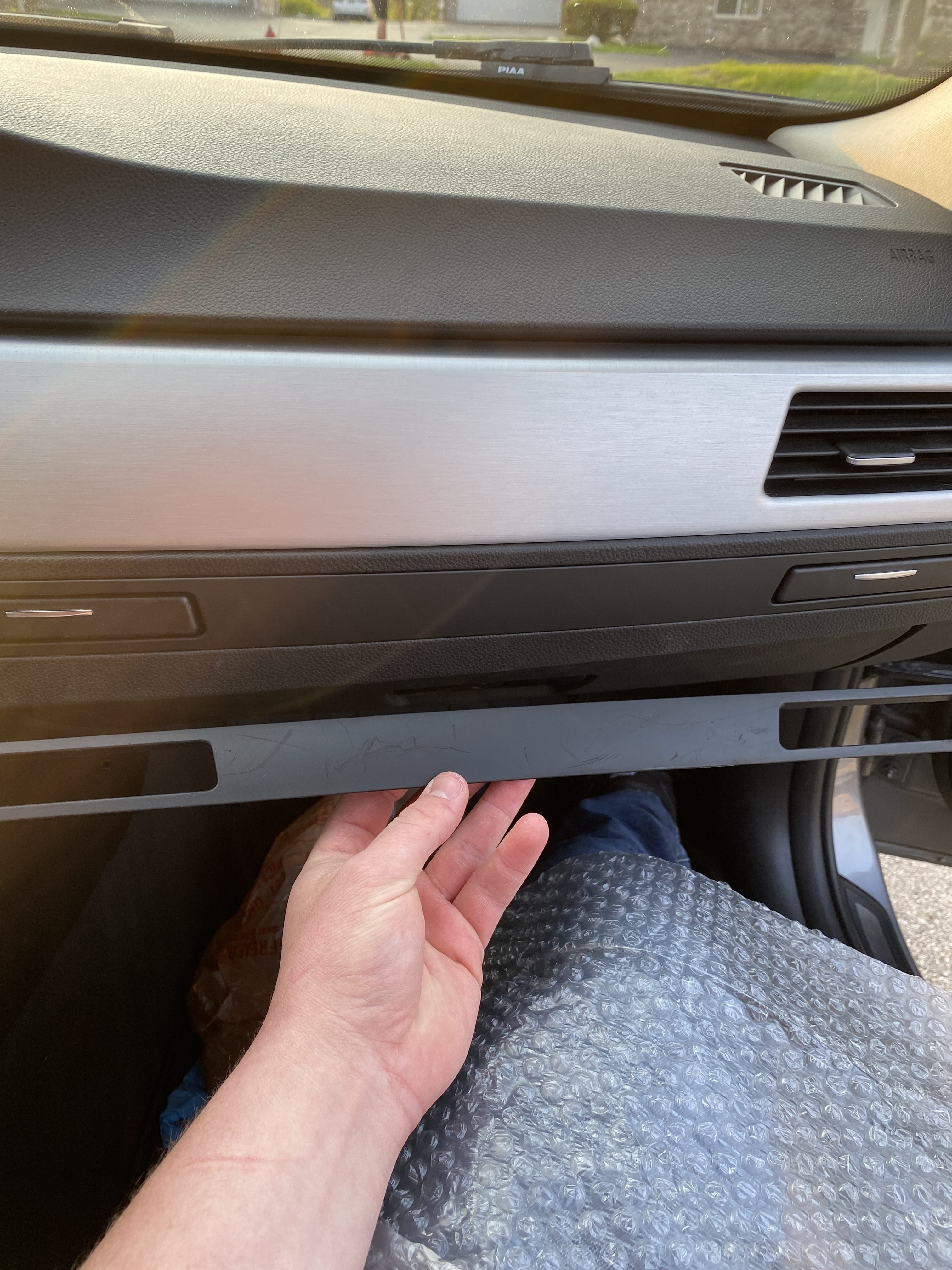

                                  Installed a new cupholder trim piece, only like $20 from FCP. Worth it.

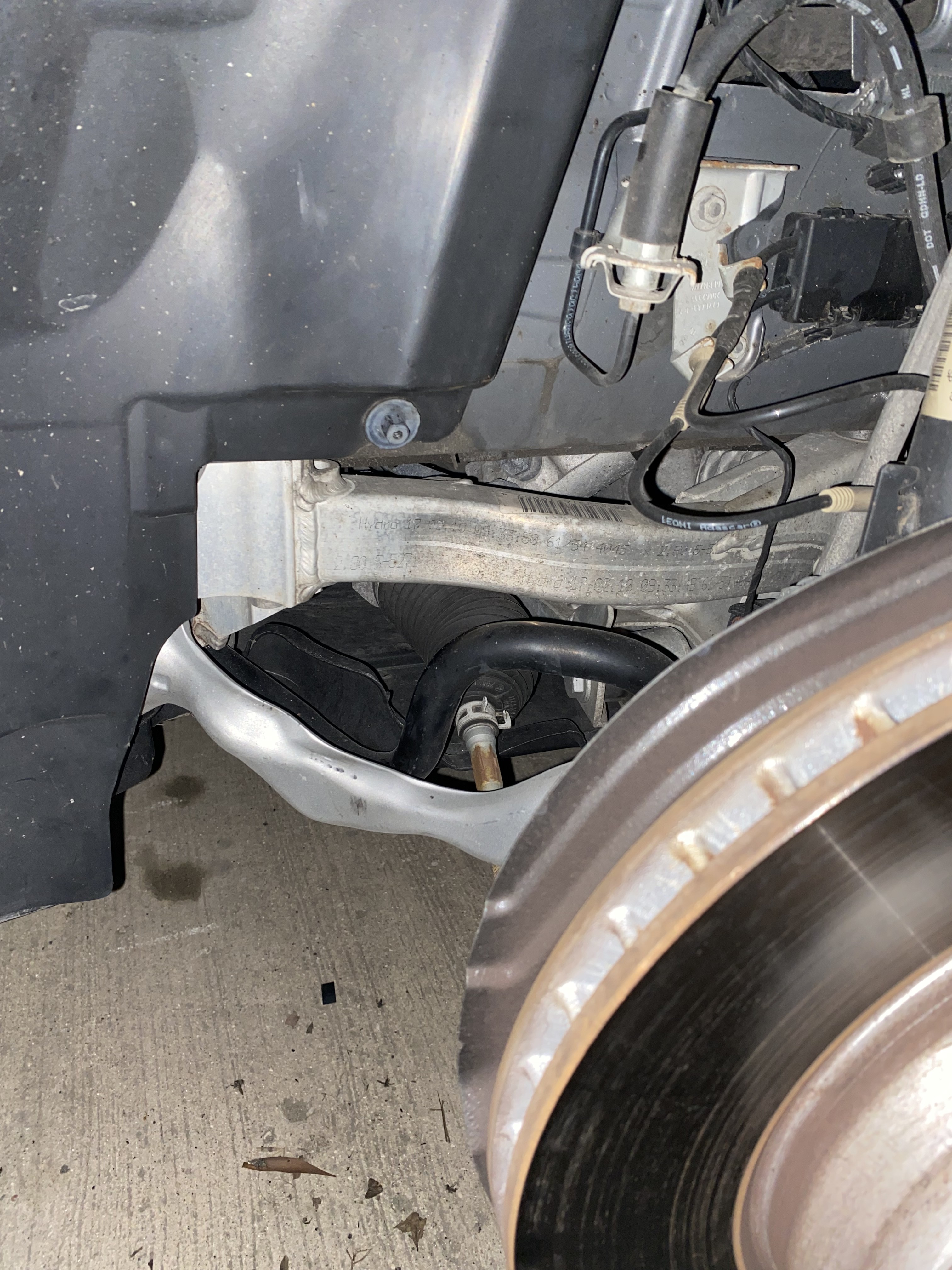

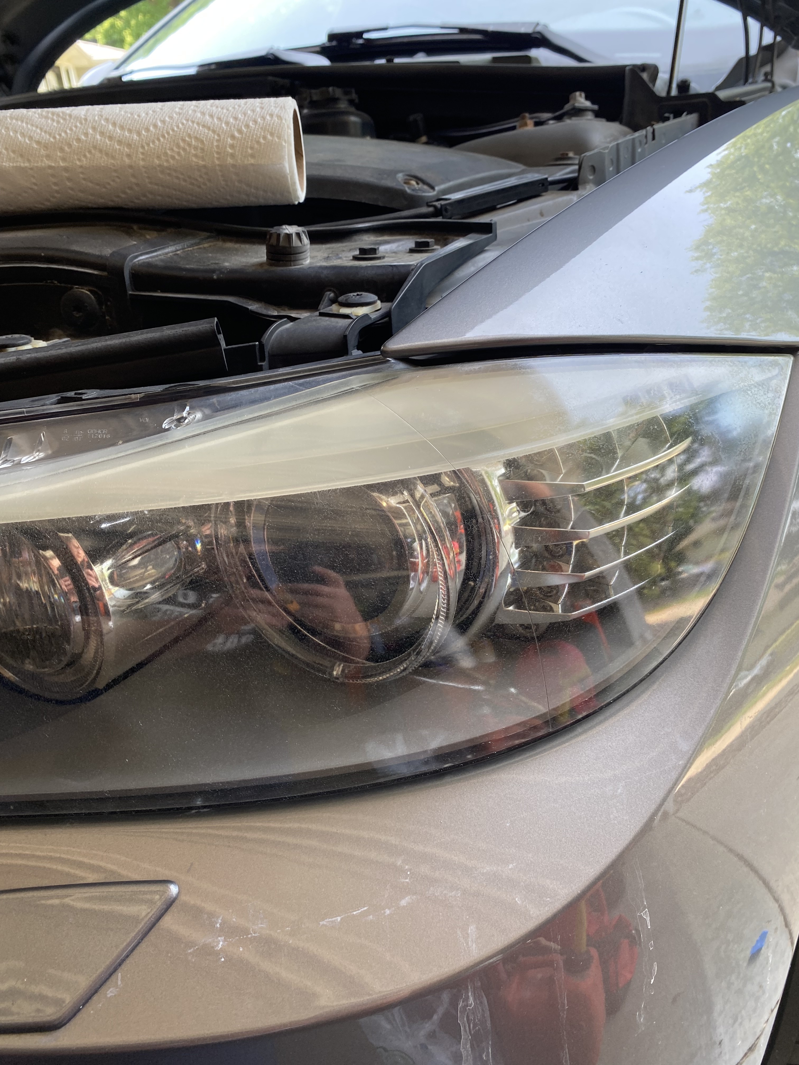

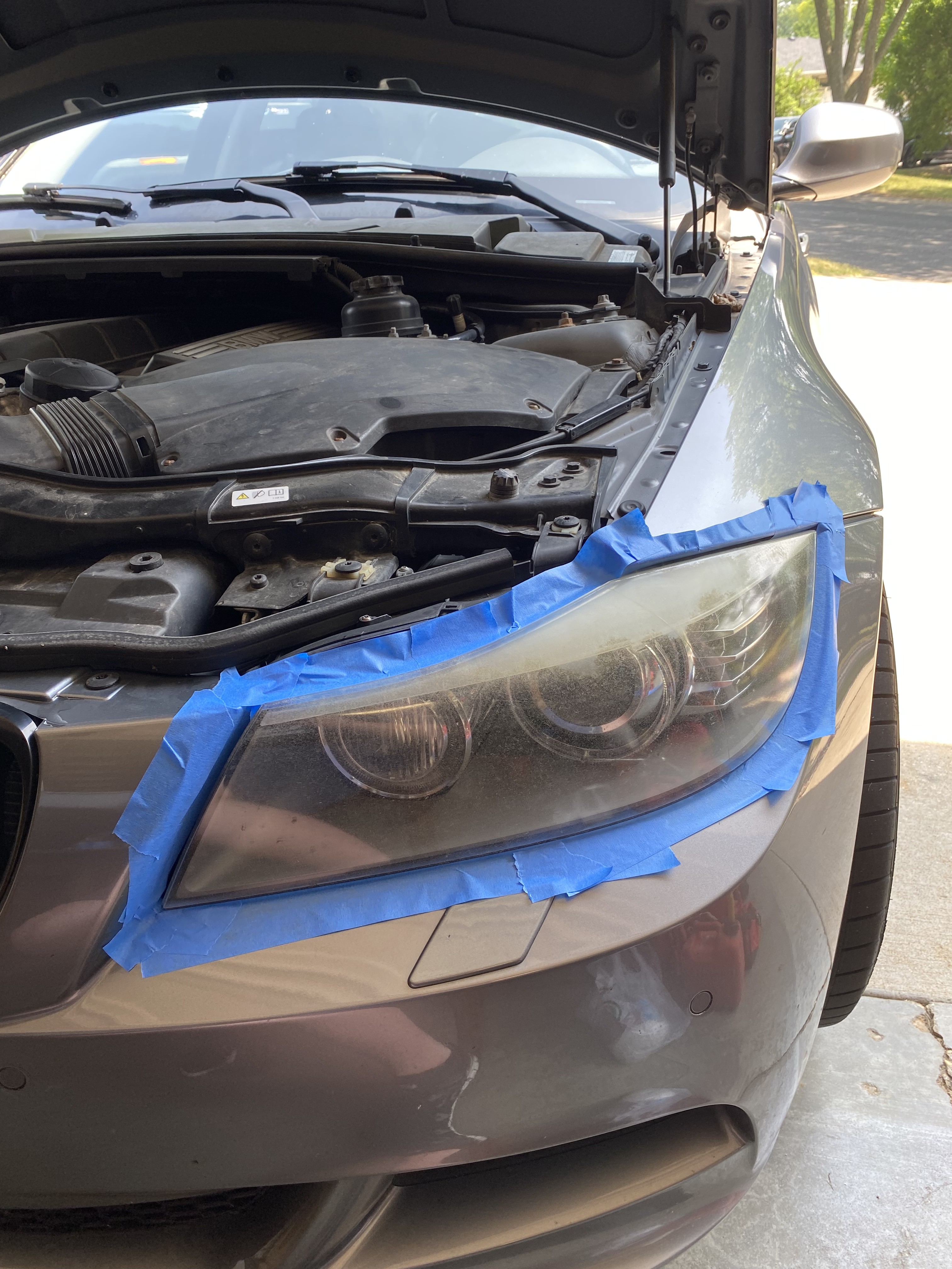

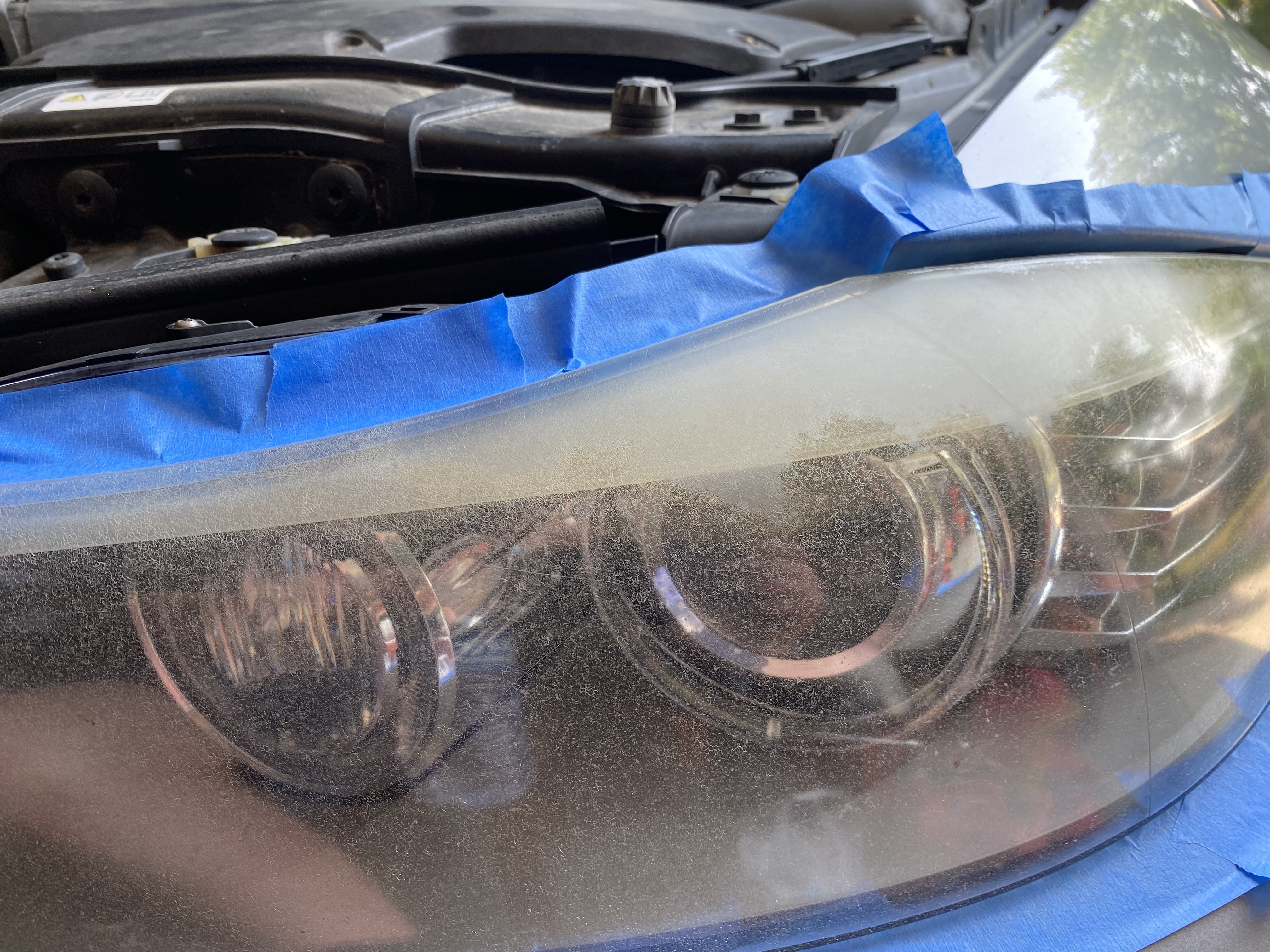

                                  Headlight 2K clear is on the way, that’s next on the list. I also have the M3 arms sitting in a box along with 3 cans of Pentosin, as well as the stuff for the diff service. Going to check the front left wheel bearing while I’m in there for the arms, that’s the only corner that is warmer than the others but it doesn’t behave quite like a dragging caliper.  Oil arrived as well. Just need to get the e34 VANOS buttoned up so I have something to drive if stuff goes sideways, then the e91 will get its attention.

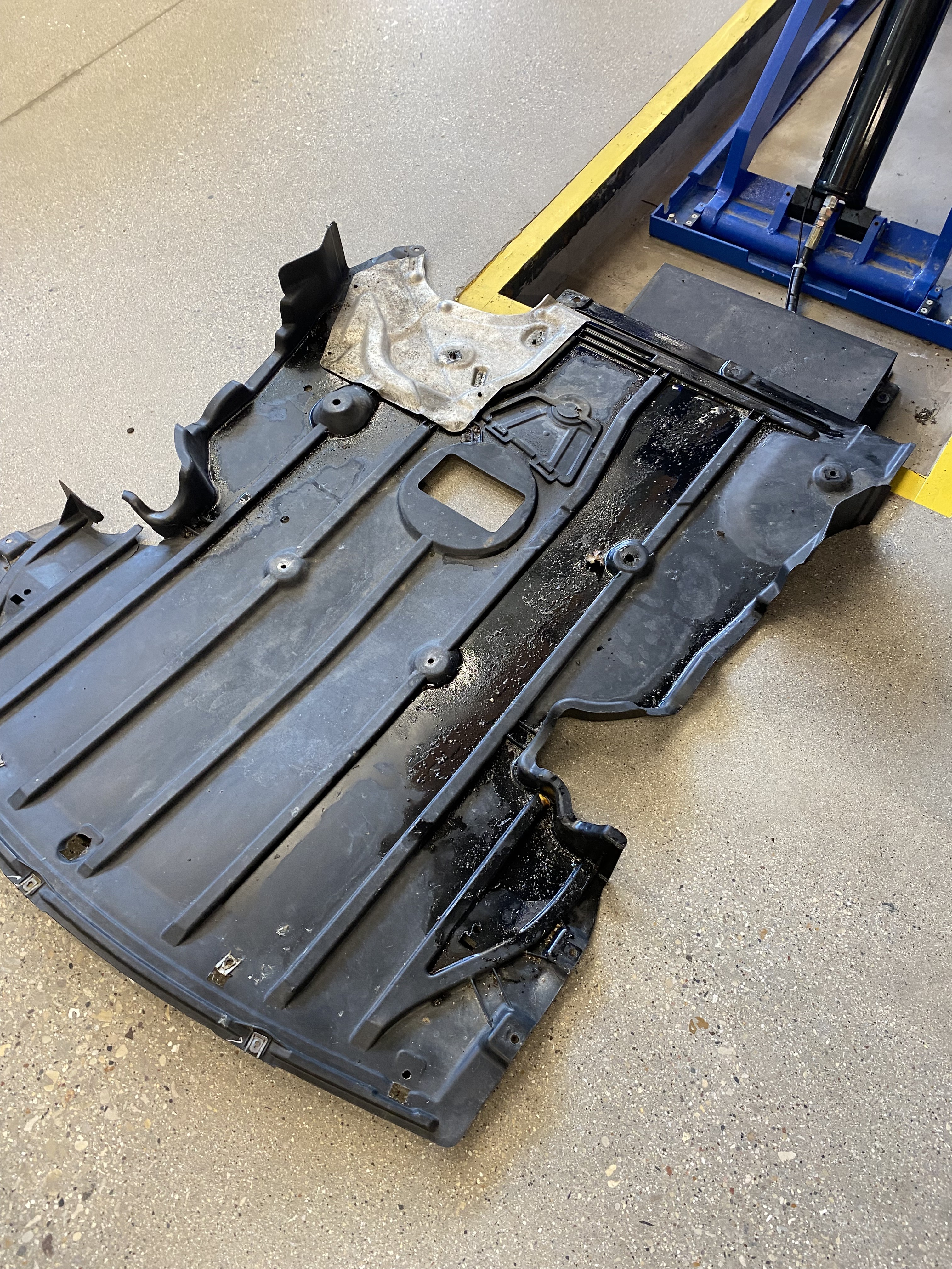

                                      I need to not get too far ahead of myself and actually finish the e30 manual swap, but I feel like it’s a good prep for one on this. I was shocked at how well laid out everything was once the belly pan came off, I think mechanically the swap shouldn’t be bad at all. The DME coding looks like a challenge, but I’ll figure it out.
                                        Believe it or not, the coding changes shouldn't be that bad. Bimmergeeks protool can change the vehicle order and then appropriately code every subsequent module to match.

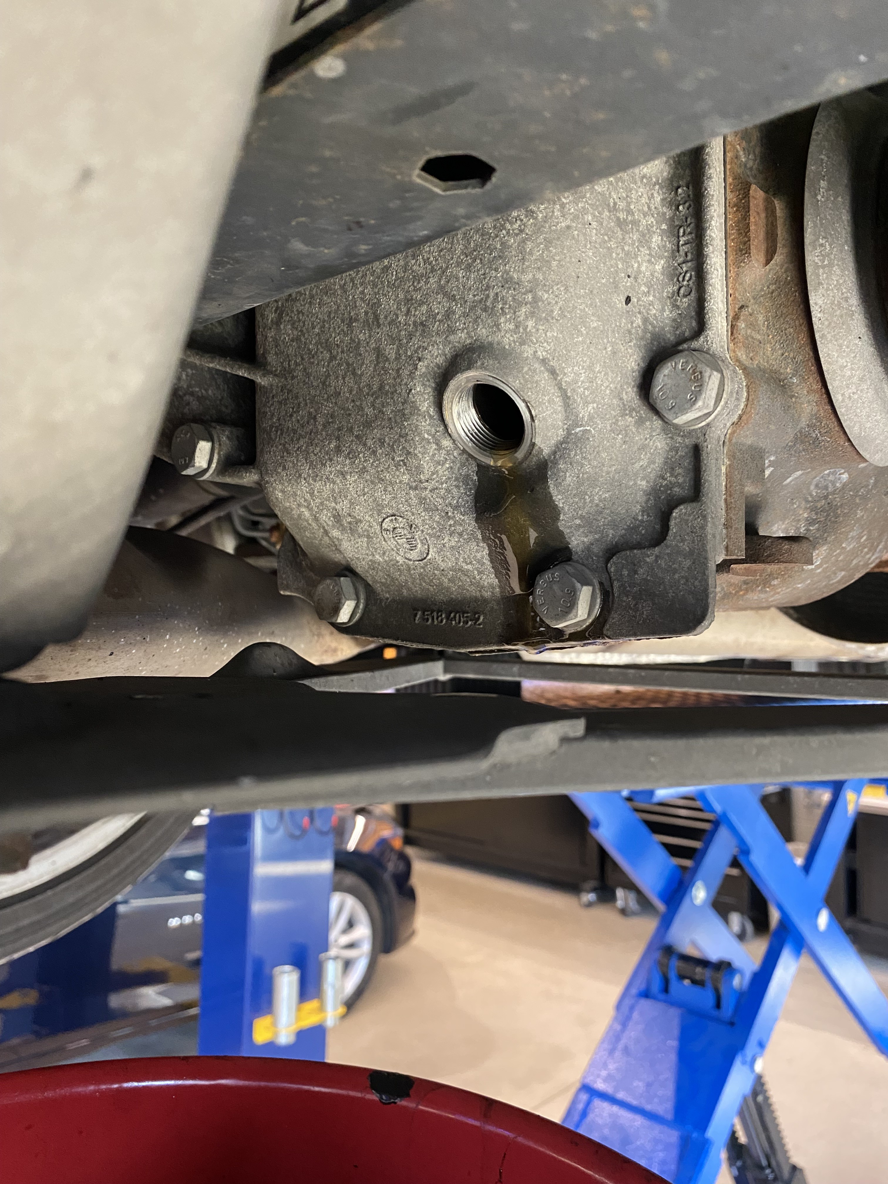

                                          127,140

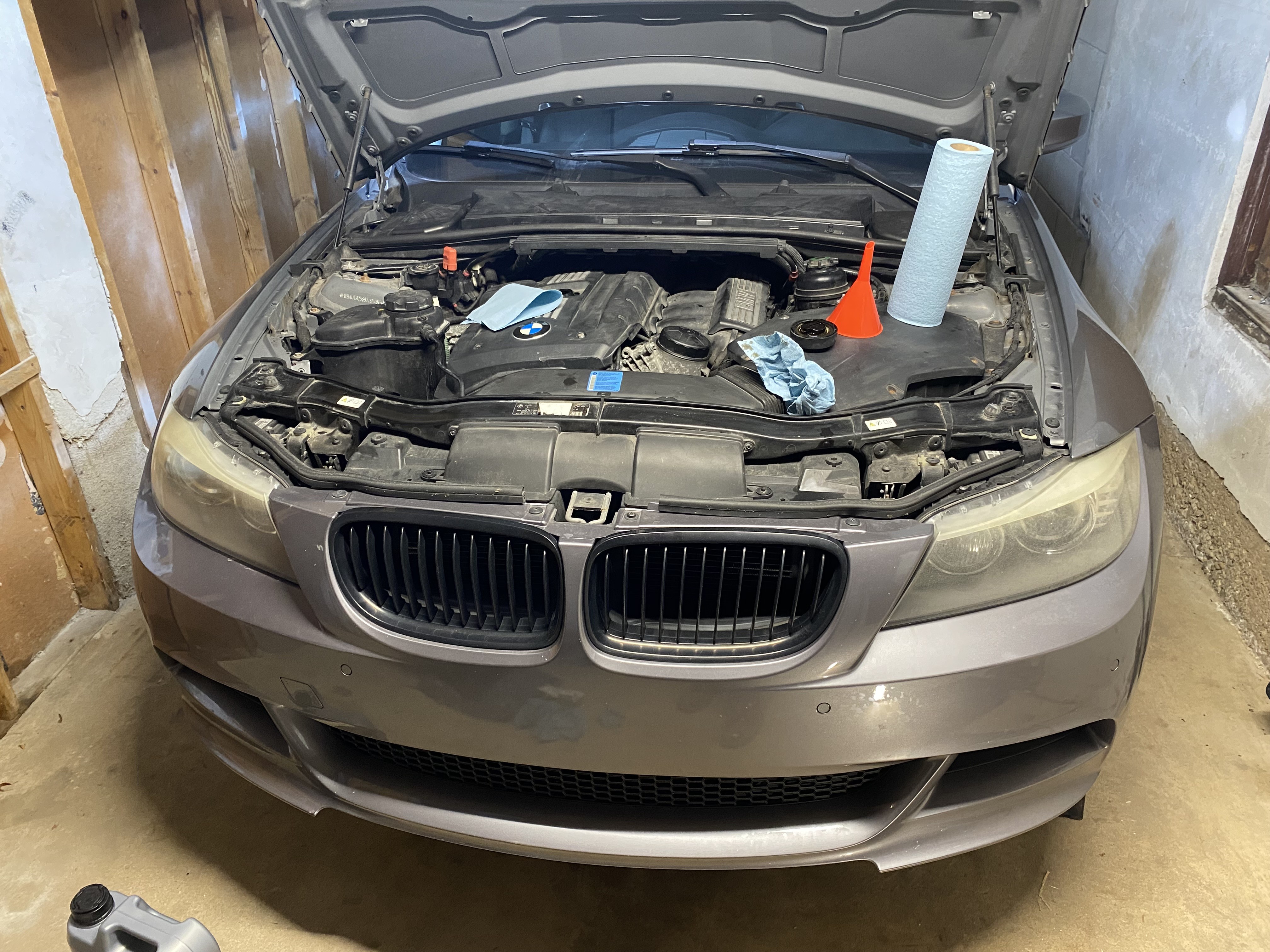

                                          Oil change, liqui-moly 5W-30 (satisfies BMW LL01)
                                          Working on the headlight sanding/respray, control arms, and possibly the PS flush this week. Really looking to get the braking vibration cleared up before a few long trips this summer. Fingers crossed!
