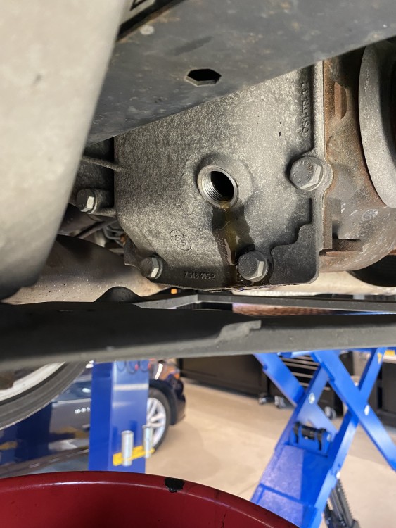

                                          133,400

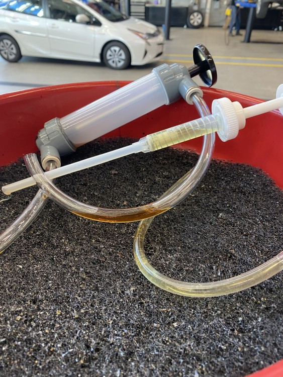

                                          Changed the oil in the rear differential. I used full synthetic liqui moly 75w-90 and a couple transfer pumps to get it done.
                                          Old oil was in quite good shape, I don’t recall seeing records of it being changed but it looks like it was. Still, the new stuff is way lighter in color and it’s good peace of mind. I only got about 3/4 of a quart out so I’ll maybe do it again in 10-20,000 miles once it’s all mixed in.

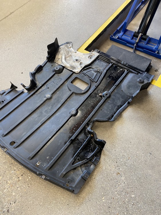

                                          I also noticed some coolant under the car the other day, so while it was on the lift I pulled the belly pan and took a peek.
                                          It seems like there’s two leaks:
                                          - One appeared to be a loose hose clamp on the water pump; I tightened it and will re-check in a few weeks.
                                          - The other seems to be either a leak at the seam of the radiator on the drivers side, or the o-ring on the upper rad hose. It kinda looks like it’s spraying, but I wonder if it’s wind blowing it off of the radiator as it leaks and spreading it all over the underside. I’m going to swap the o-ring this week sometime and see if that fixes it, and if it doesn’t I’ll get a new rad. I’m considering a full aluminum replacement to bulletproof it, but we’ll see. This one should be under warranty still but if it failed this fast I’m not sure if I want to put the same thing back in.
