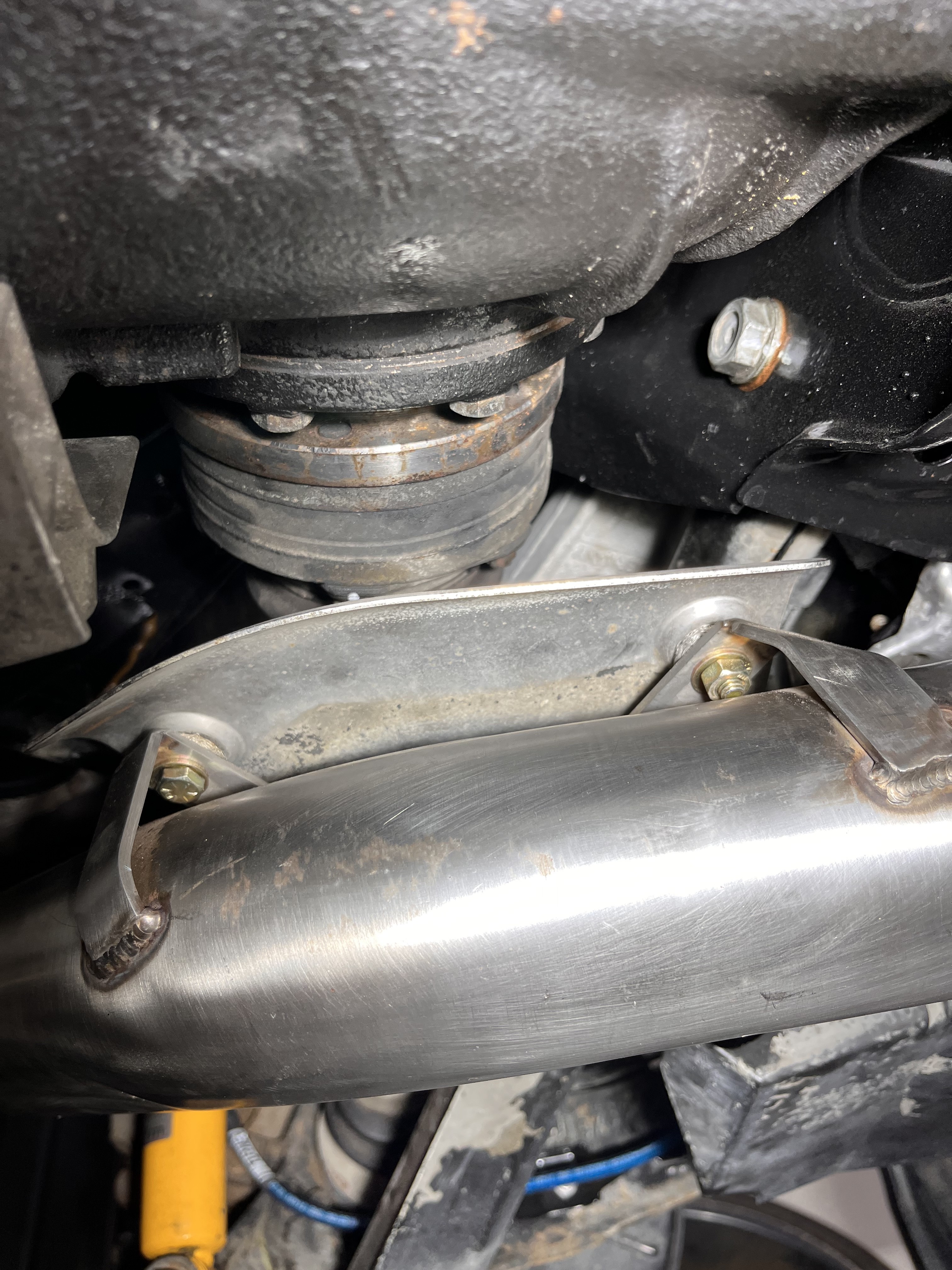

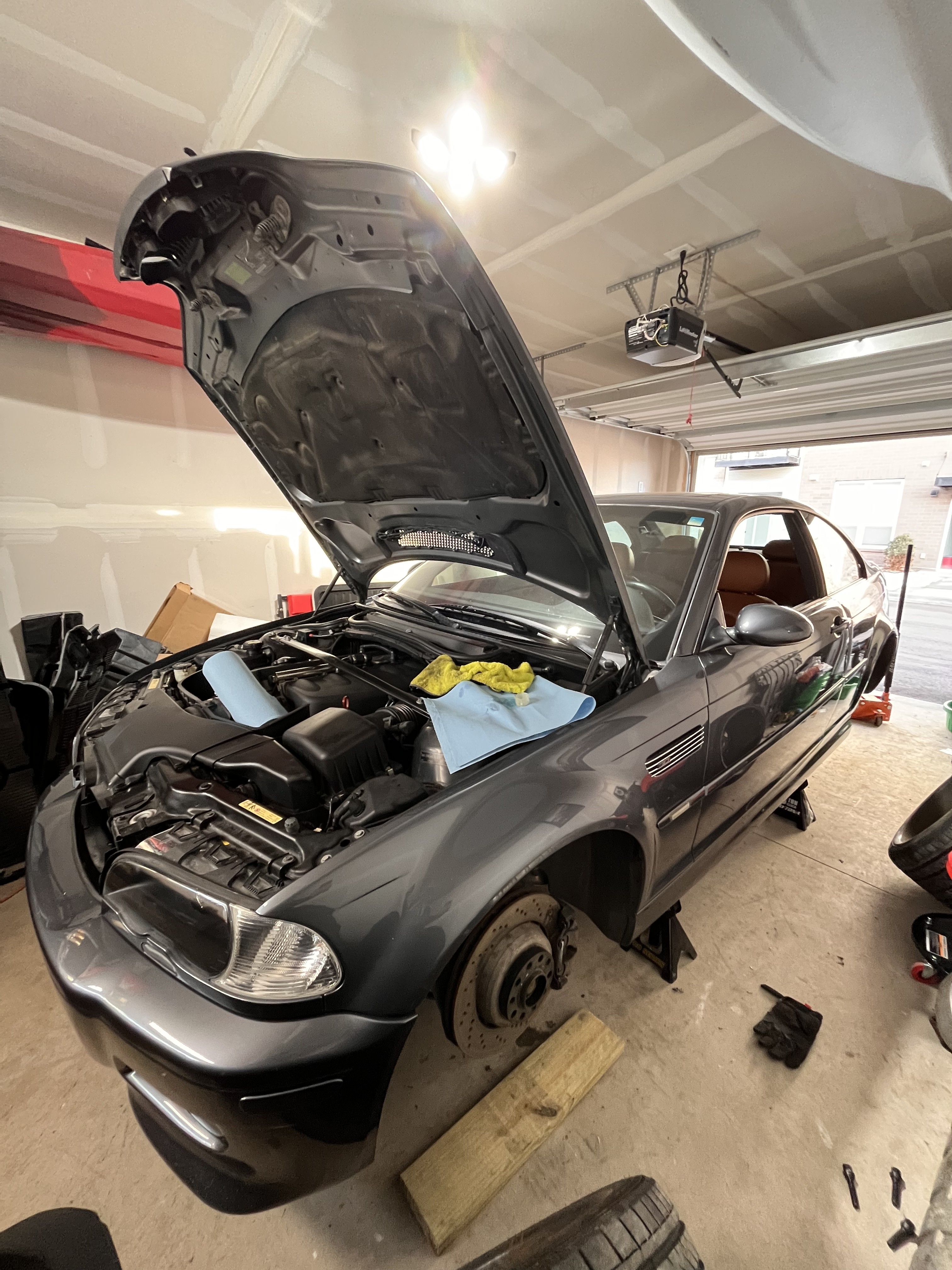

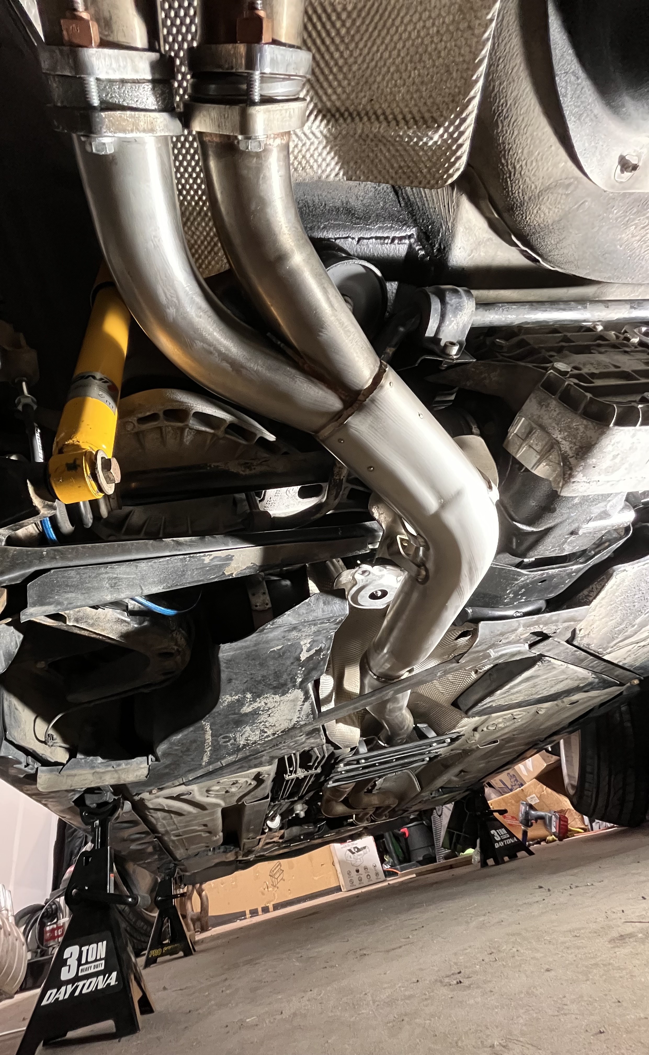

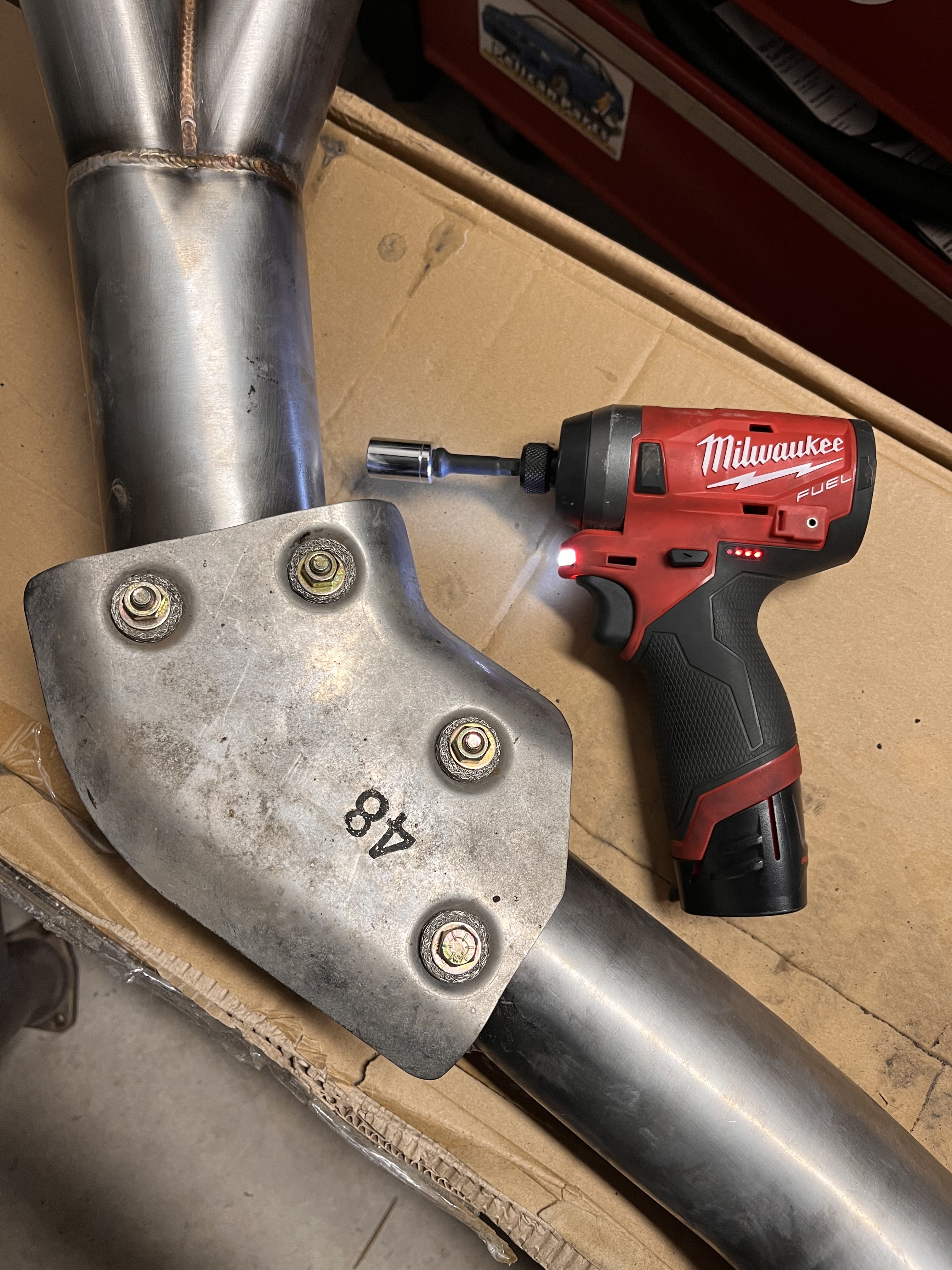

      Had to toss the car up on stands again to bleed the brakes since I messed with brake lines again. While it was up I decided to toss the new X pipe on. Overall was super easy to install, just tedious with all the metal braces that have to come off.
      Only hiccup was the pipe didn’t come with hardware to transfer over the factory pipe’s heat shield. If I’m going to do it might as well do it right so I went out and found some nice grade 8 yellow zinc hardware to attach it. One bolt had to go backwards because of the clearance, which bugs me, but oh well.

        I hope that you never forget that bolt is backwards.
          #124
          The concours judges certainly won’t

            Snow finally melted and we've had a few good rains in to wash all the salt away. Took the M3 out today and gave it a test drive after all the changes. Ran like a can of beans. Turns out I had crossed the two pre-cat O2 sensors when doing the header install. Finally got them swapped and it's no longer a can of beans. Tossing in a lil sound clip of the new X pipe too, sounds freakin awesome in person.

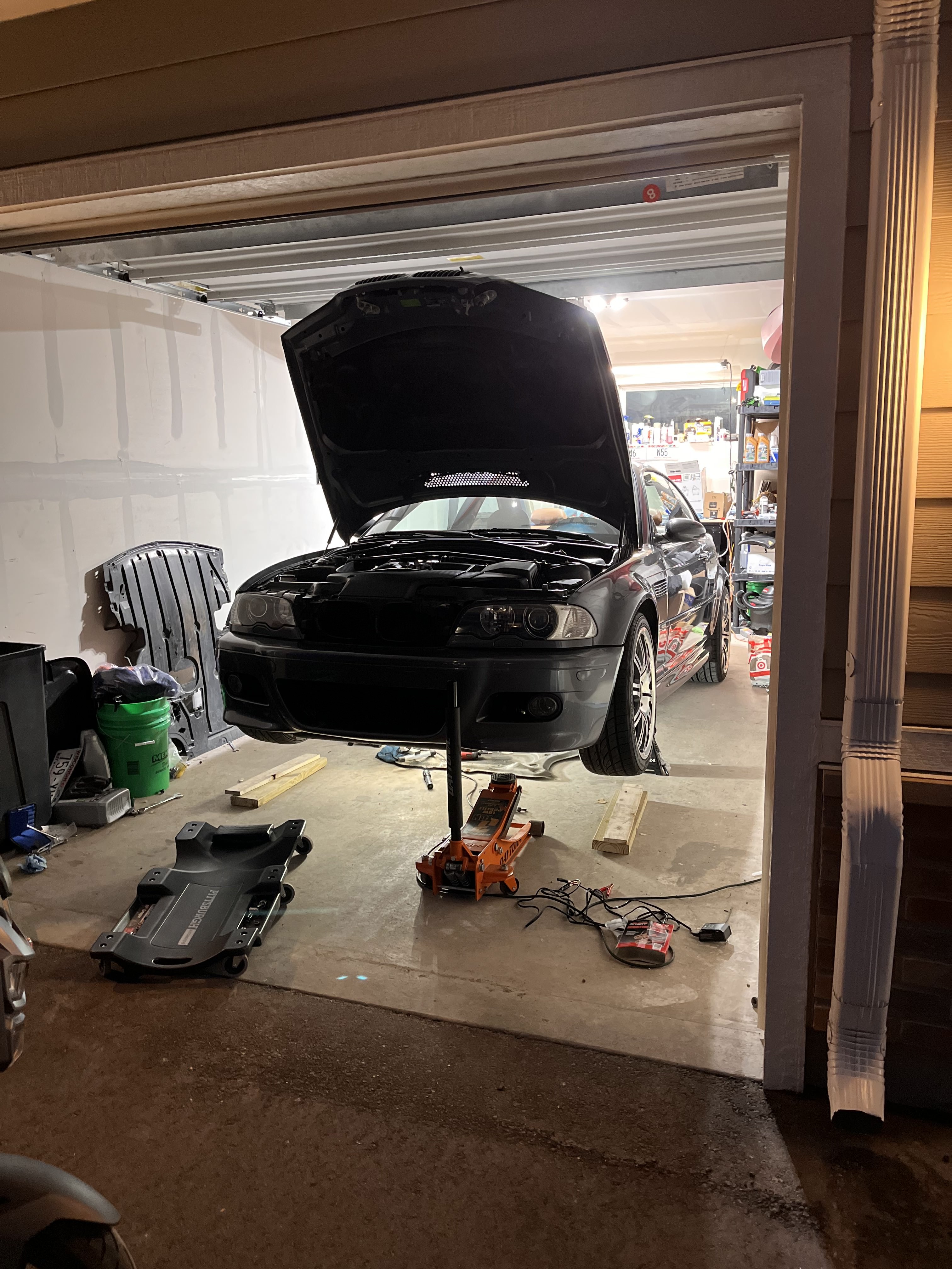

                                          No big update, but now that I’m in my own house and no longer a tiny apartment I was able to bust out the pressure washer again! M3 and E90 both got a much needed deep cleaning. M3 also developed an interesting issue with one of the brake pressure sensors, so that looks fun.
