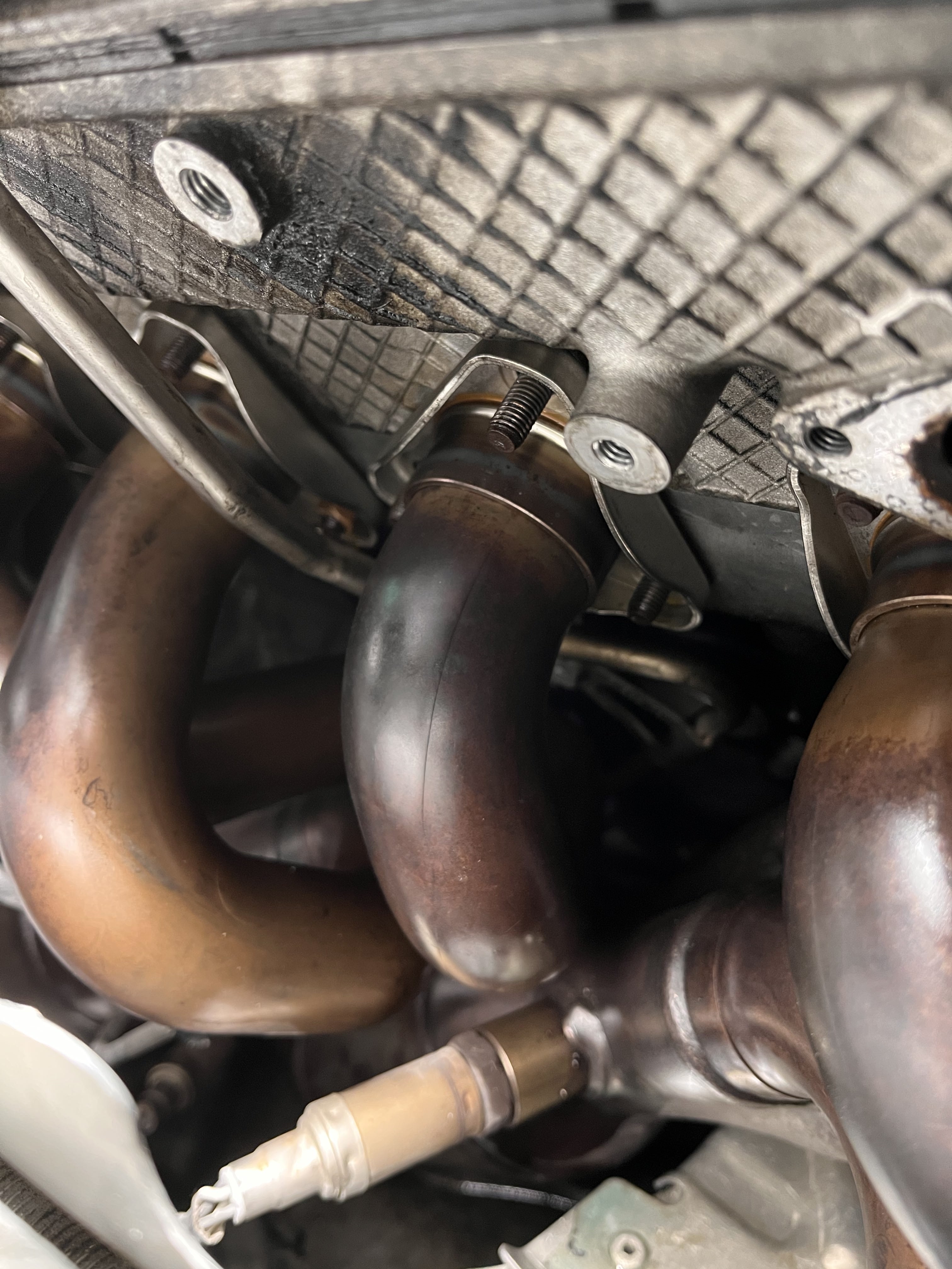

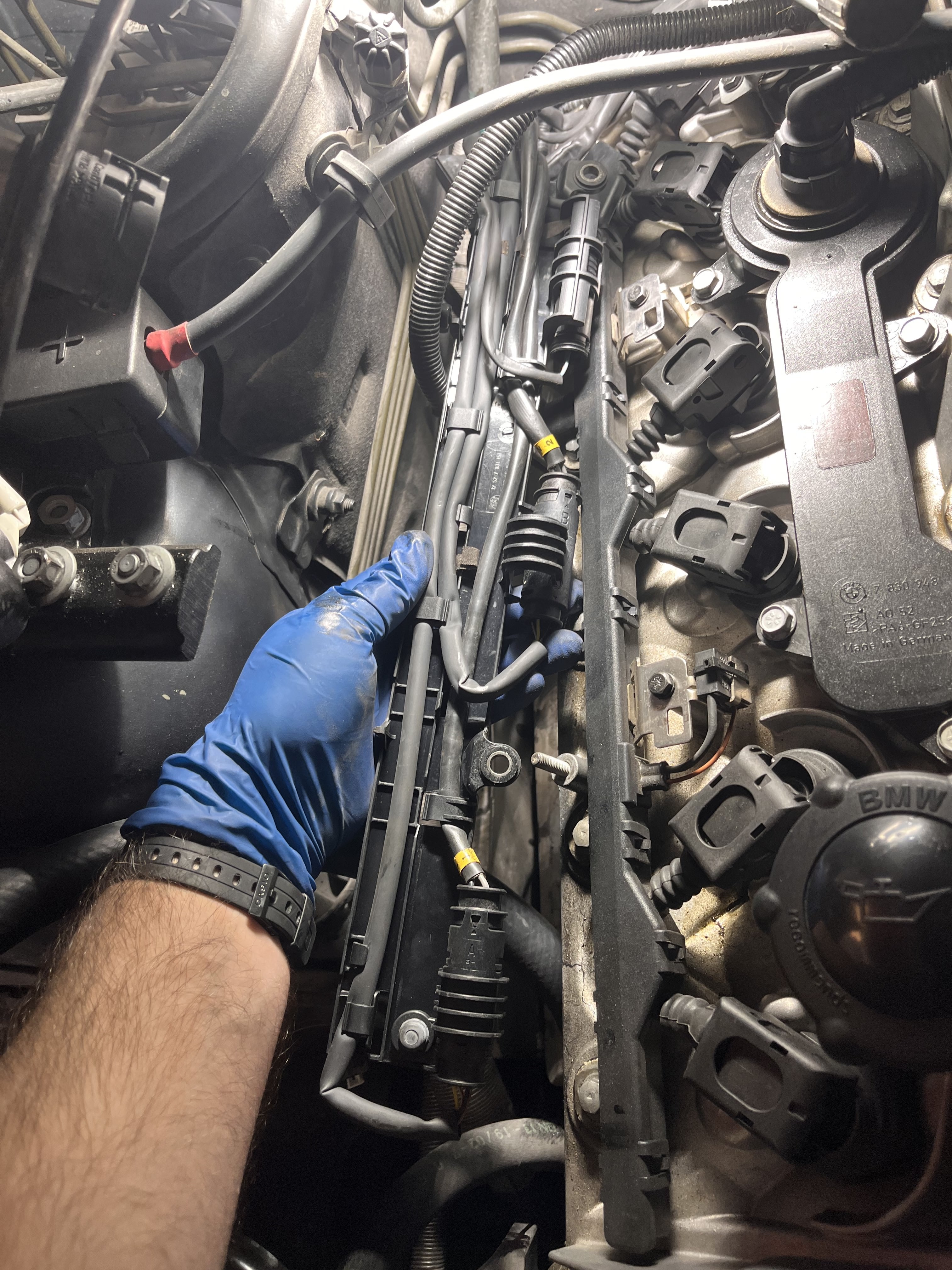

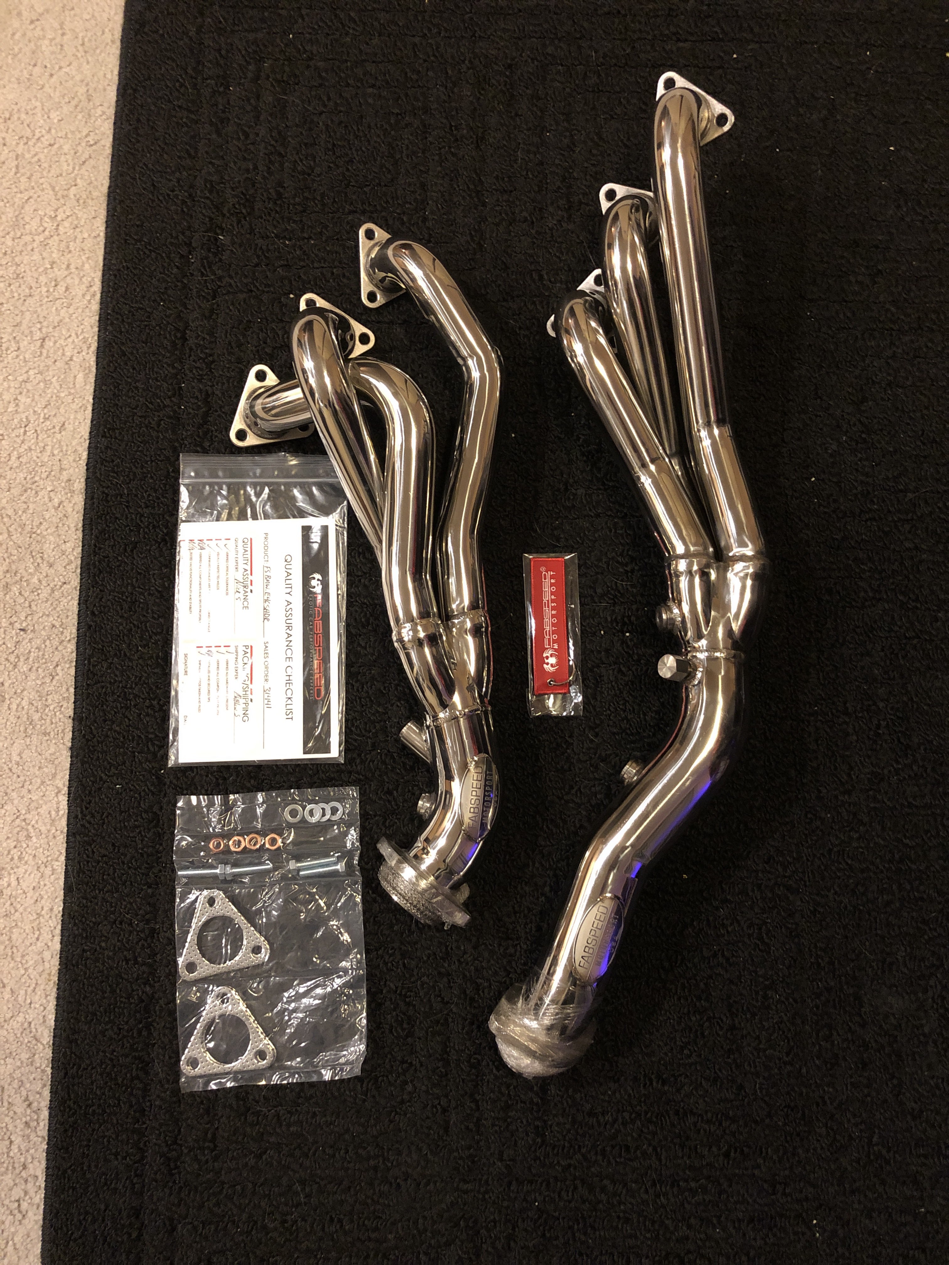

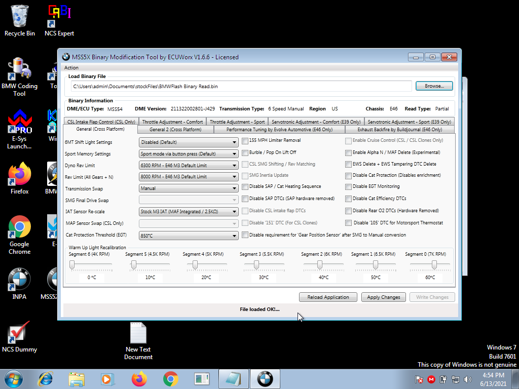

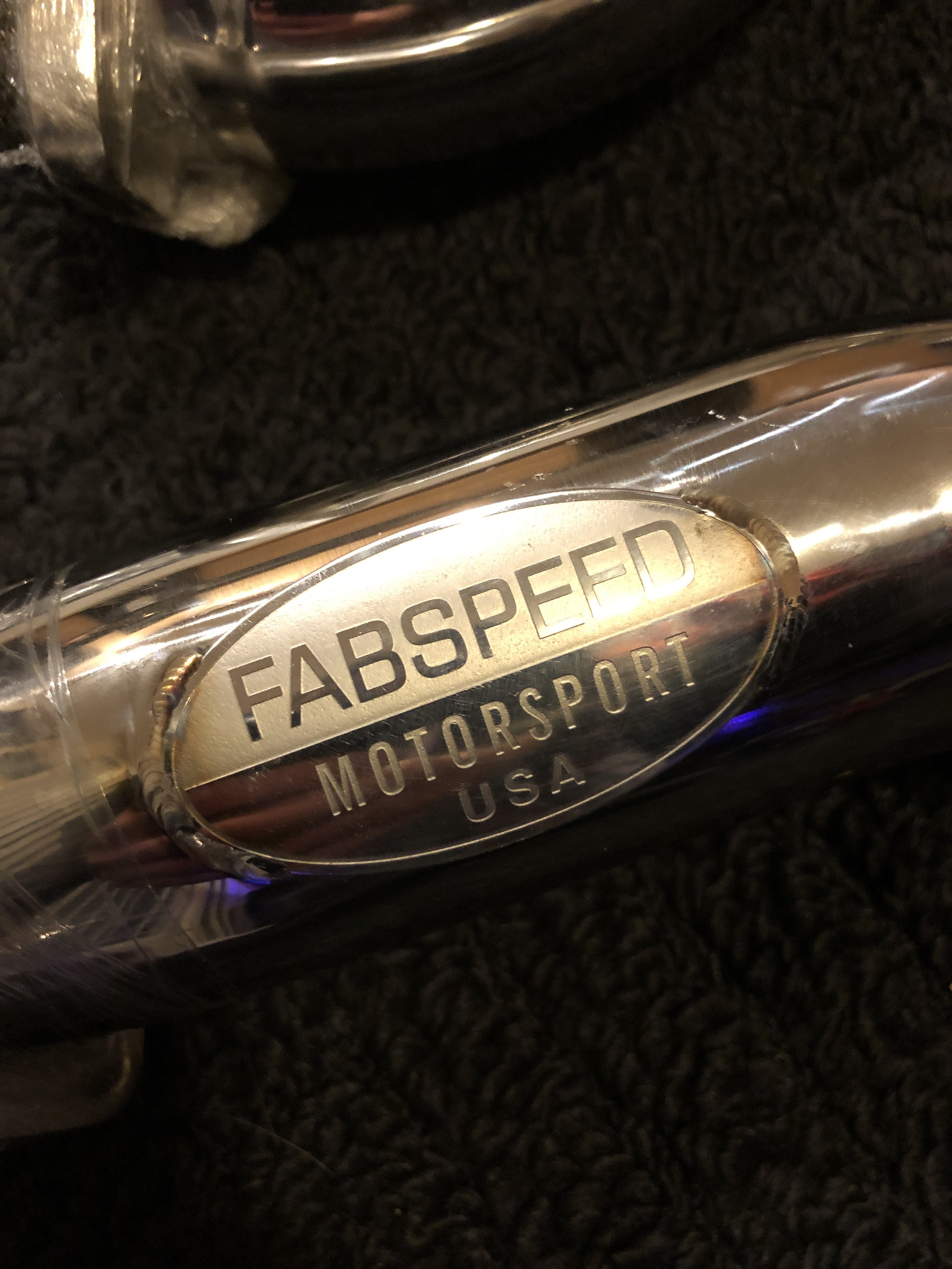

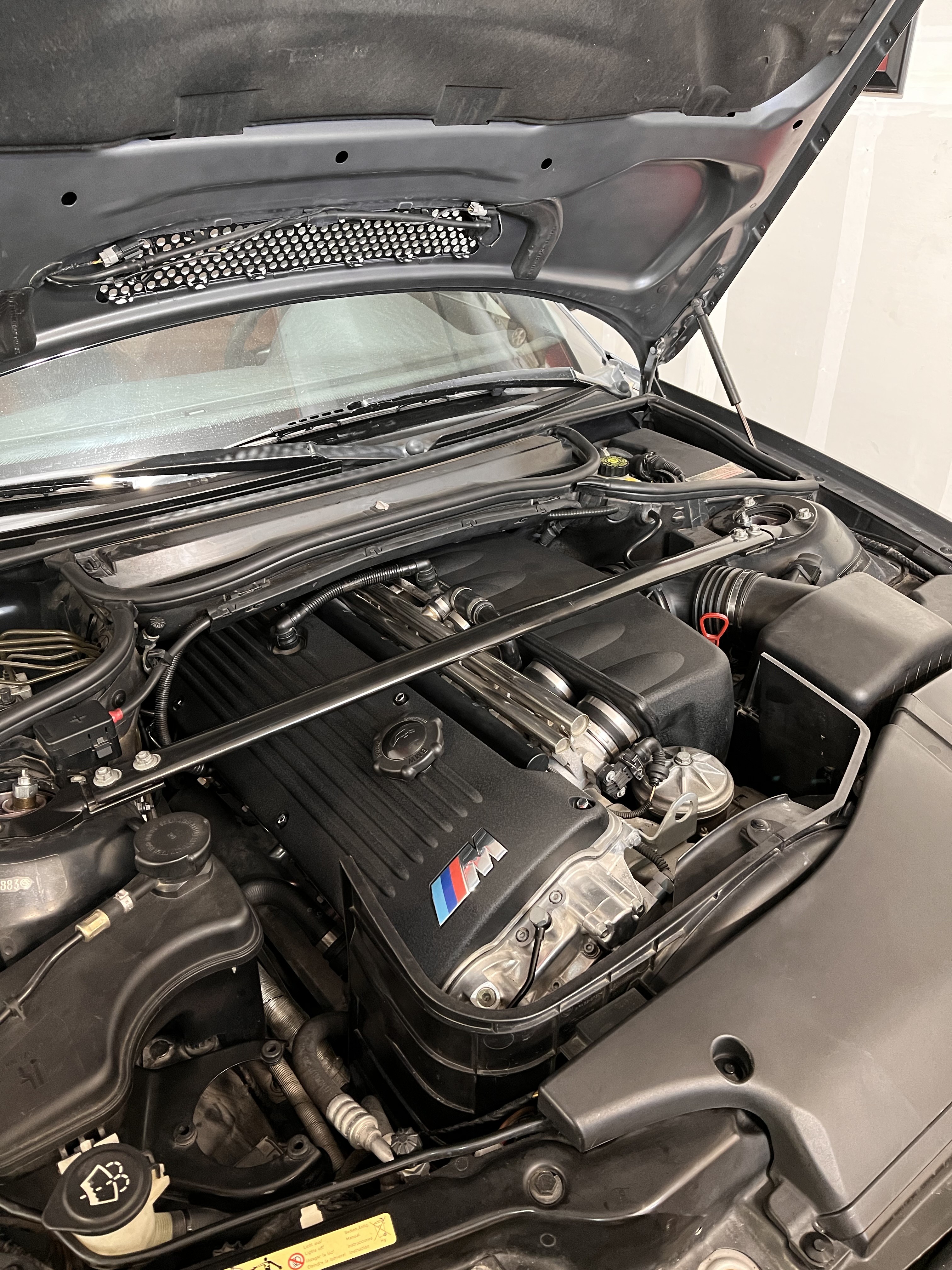

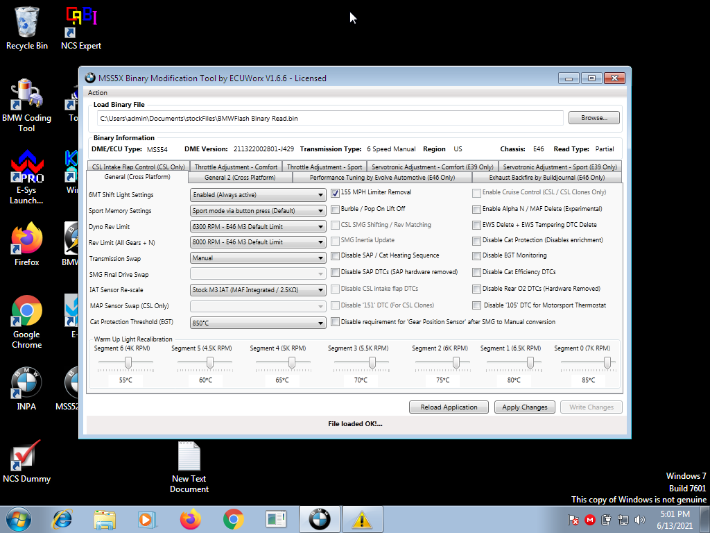

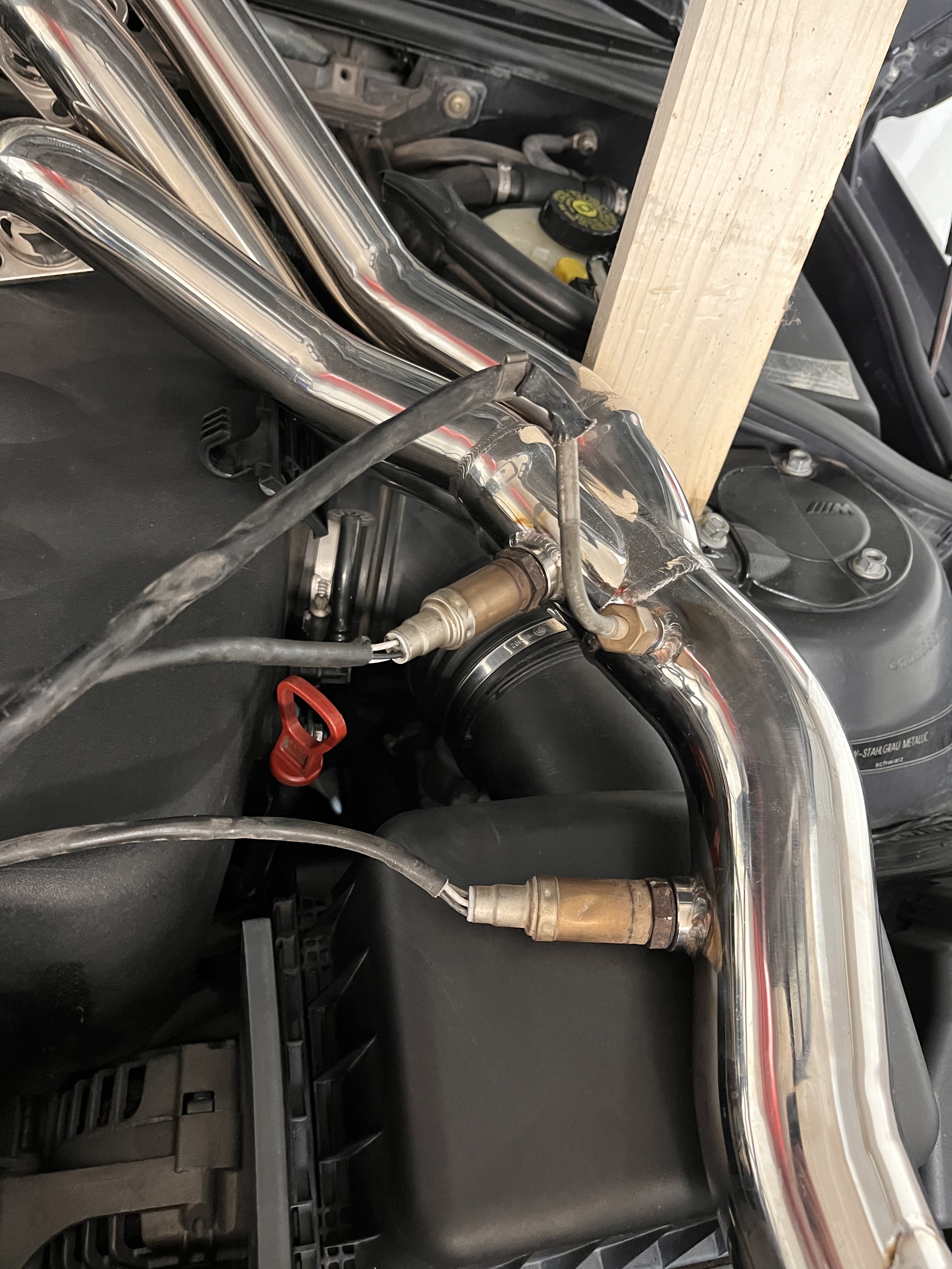

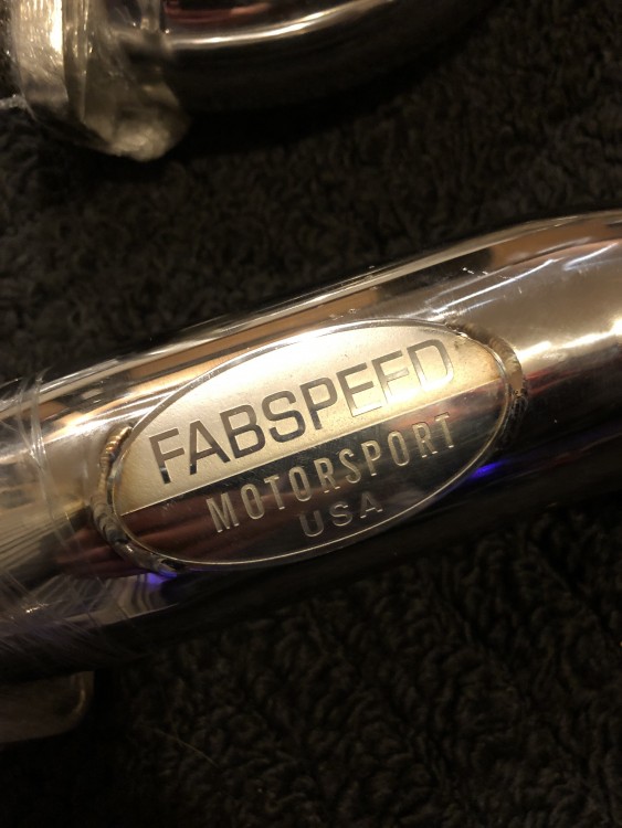

      Got the ports all cleaned, fresh gaskets, fresh hardware and the headers bolted up. Now just have to sort through the O2 sensor wiring because I’m an idiot and didn’t mark them. I'll have to fire up Ecuworx too and code out the downstream O2 sensor and secondary air pump so we don't get a CEL.
      • pynaclP
        pynaclP
        pynacl

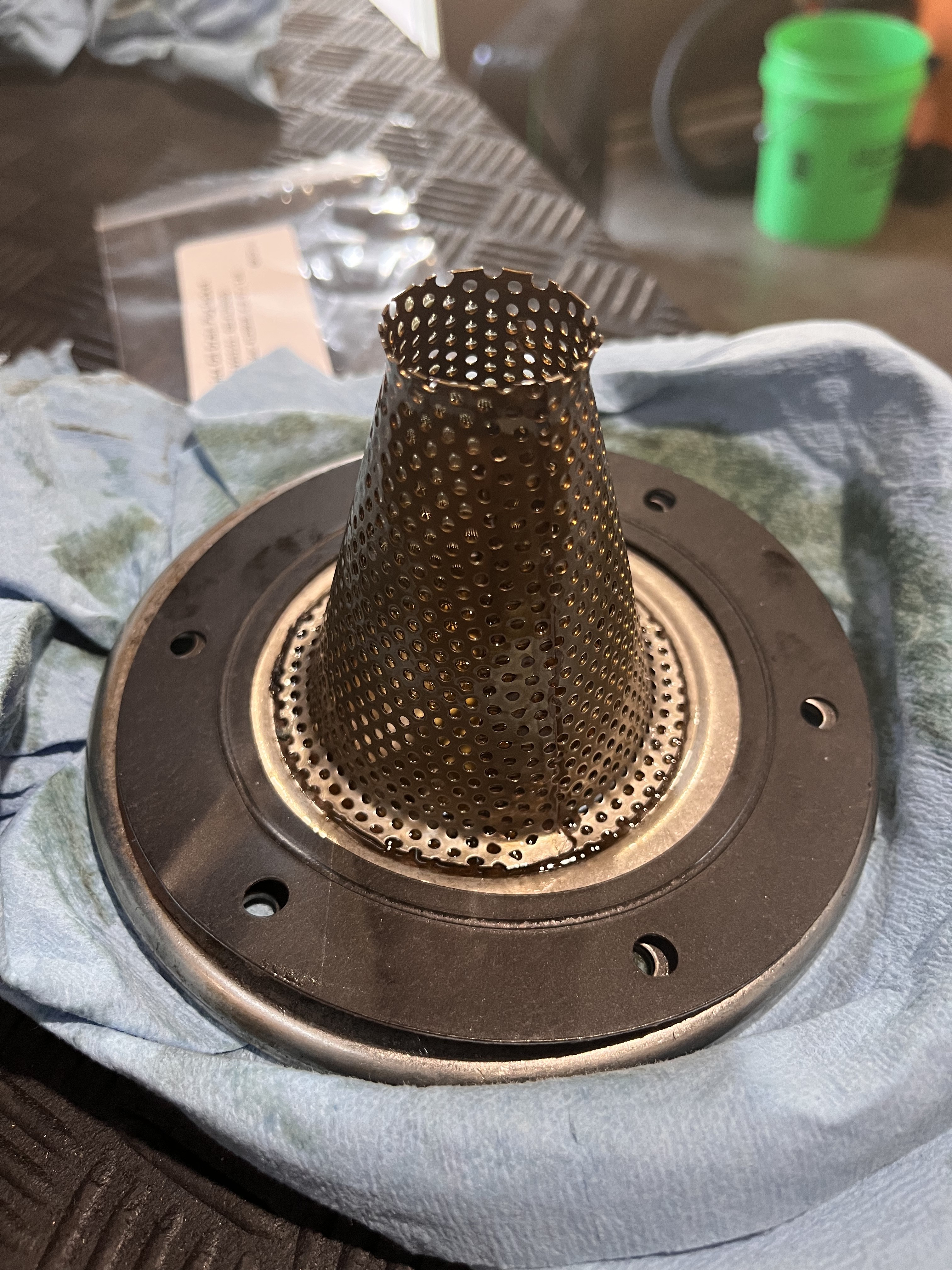

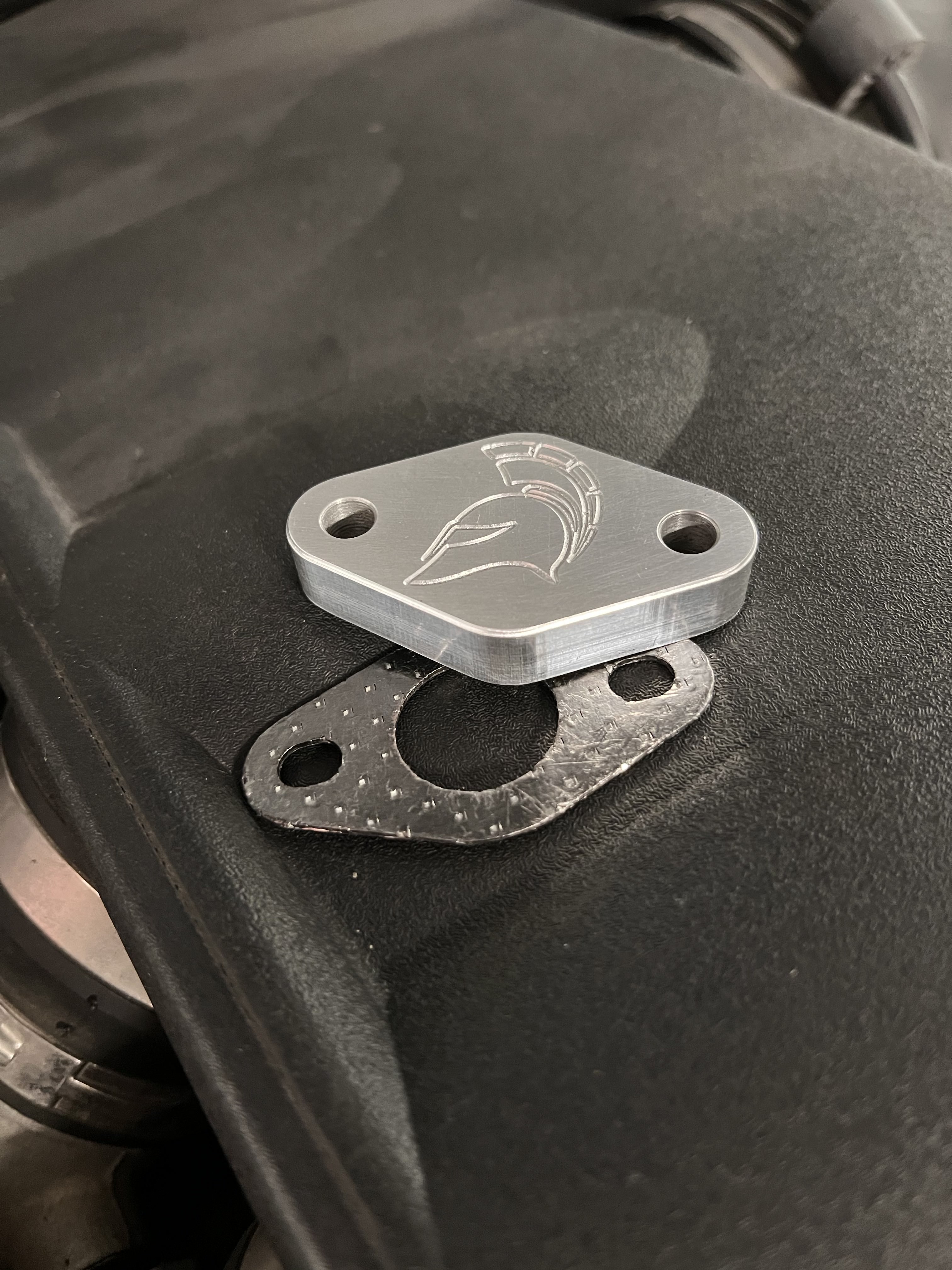

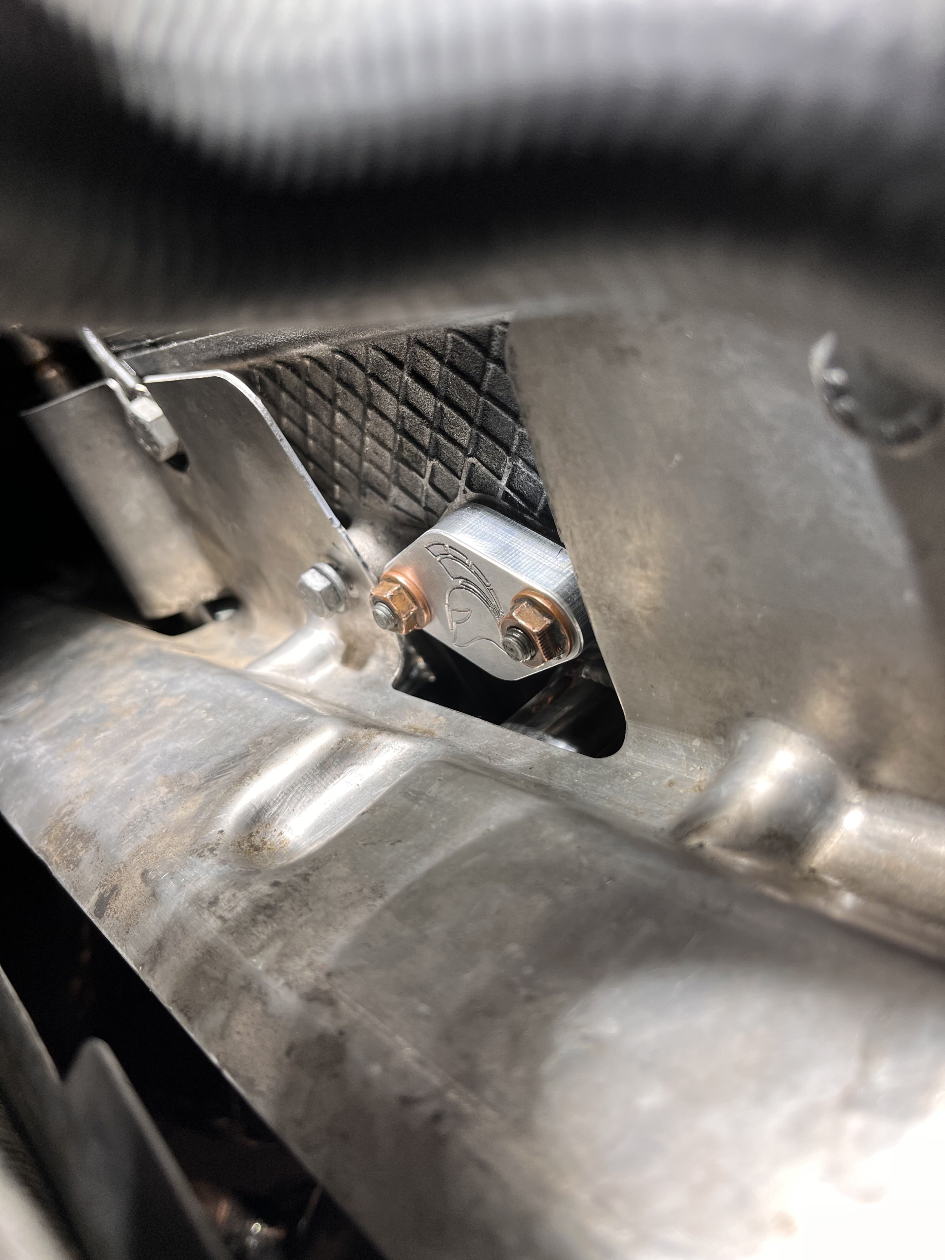

        Since I went with catless headers, I decided to delete the whole secondary air injection system since I don't think it serves any purpose besides helping in the cat heating sequence (saves 4lbs too). Got this nifty little aluminum block off plate from Achilles Motorsports that looks pretty sweet, even though it will never be seen.
        • pynaclP
          pynaclP
          pynacl

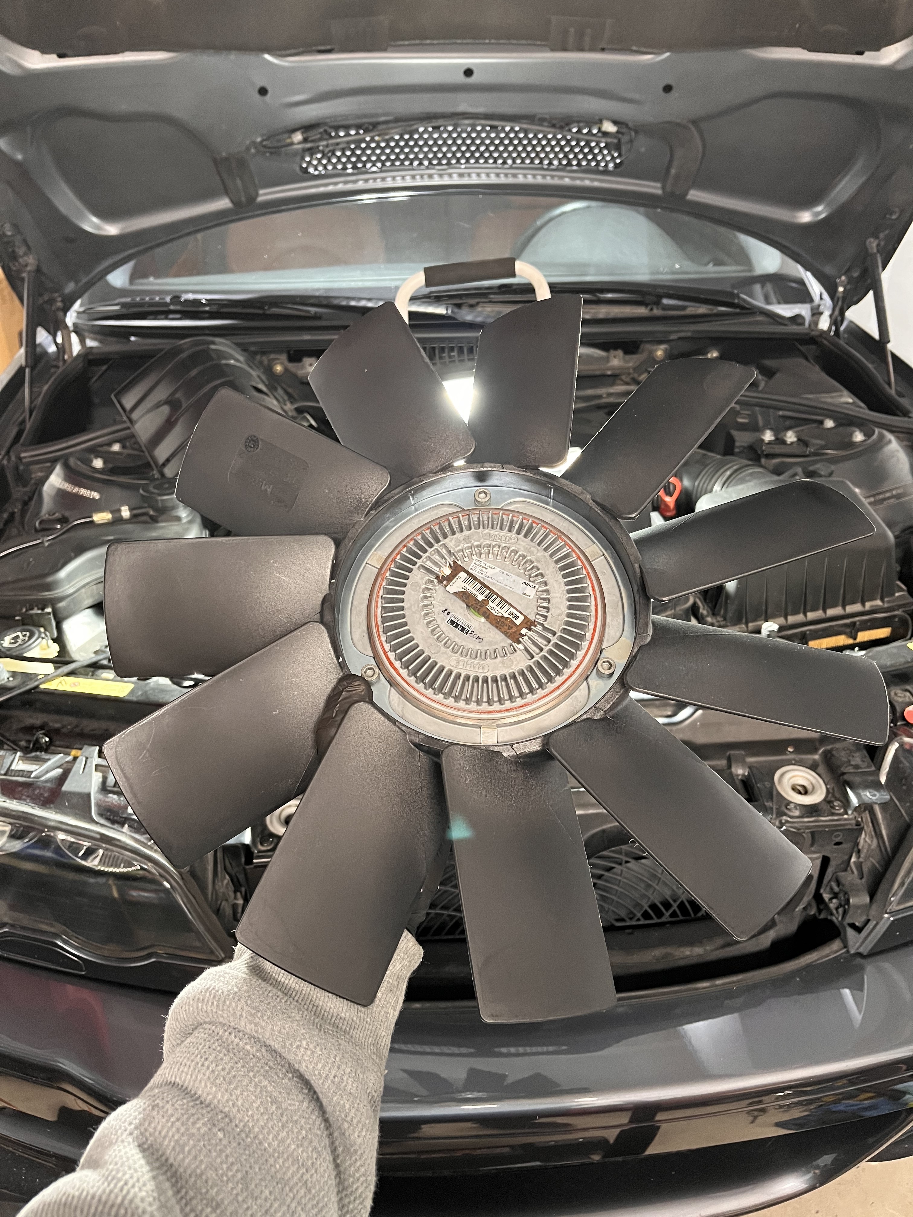

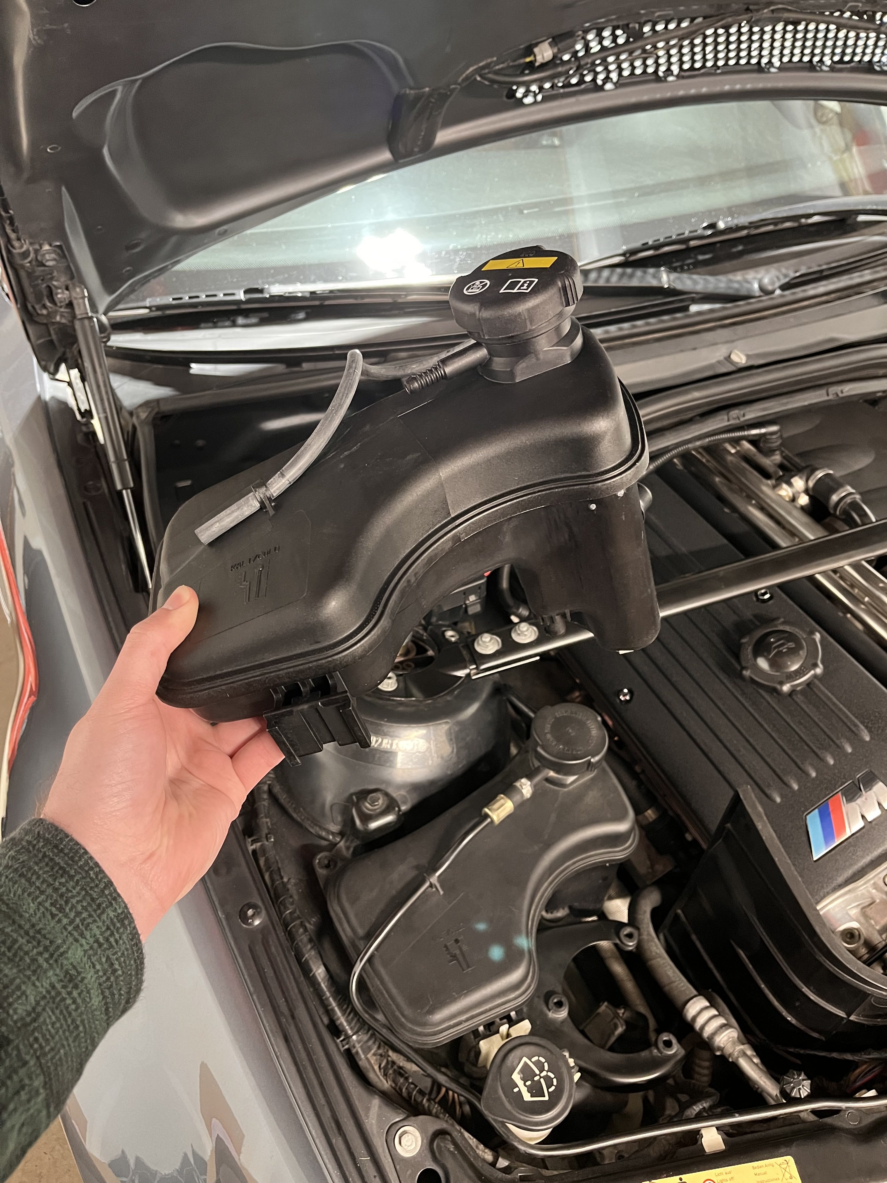

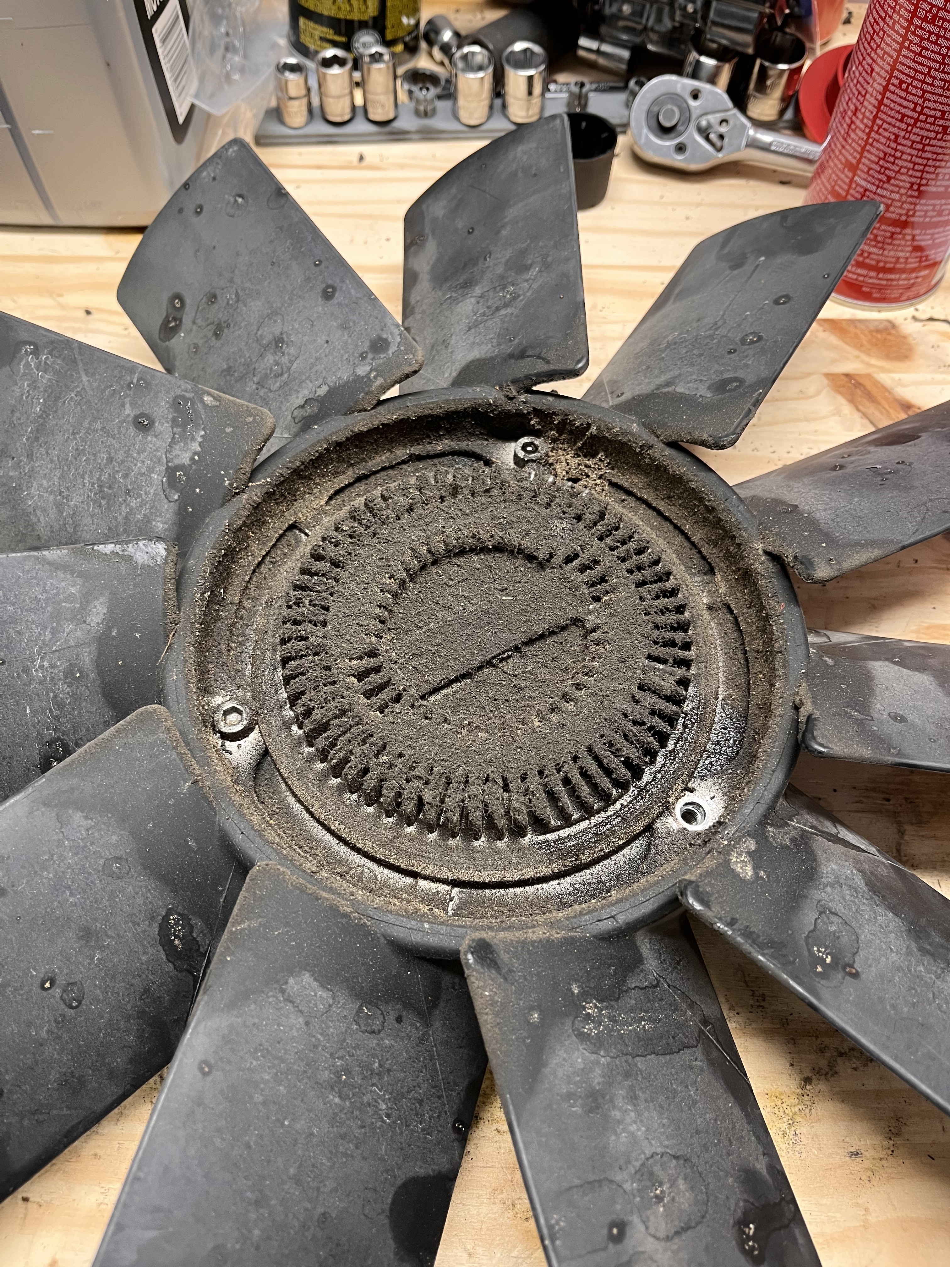

          Since it was looking pretty tired out, I decided to replace the fan blades and fan clutch with a new Mahle one. Better preventatively than to see it grenade and take out the hood or radiator. Personally prefer this setup to an electric fan swap, because it just works. No overheating in hot weather while stopped, no blasting heat in the middle of summer or messing with fan shrouds etc. Easy enough to service so I’ll keep it.
          • pynaclP
            pynaclP
            pynacl

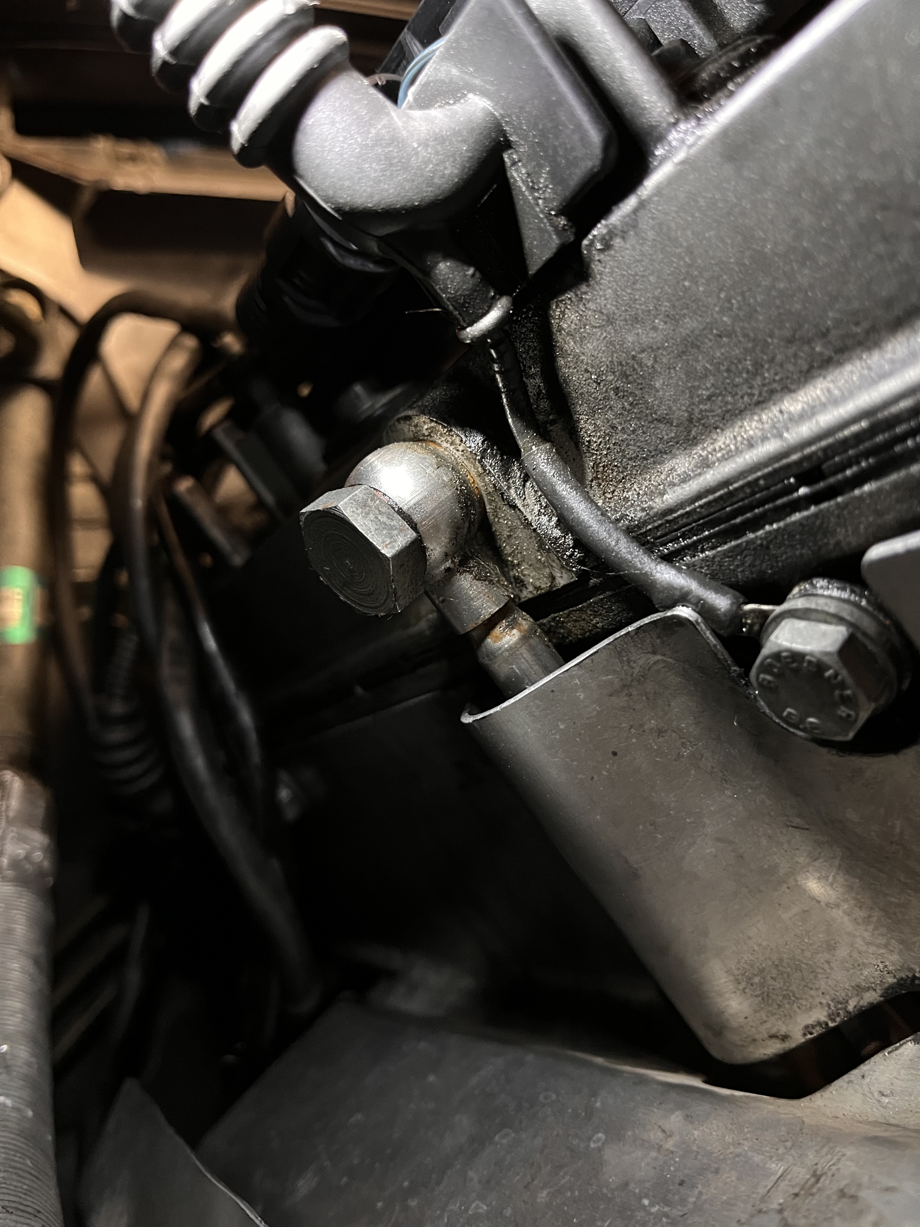

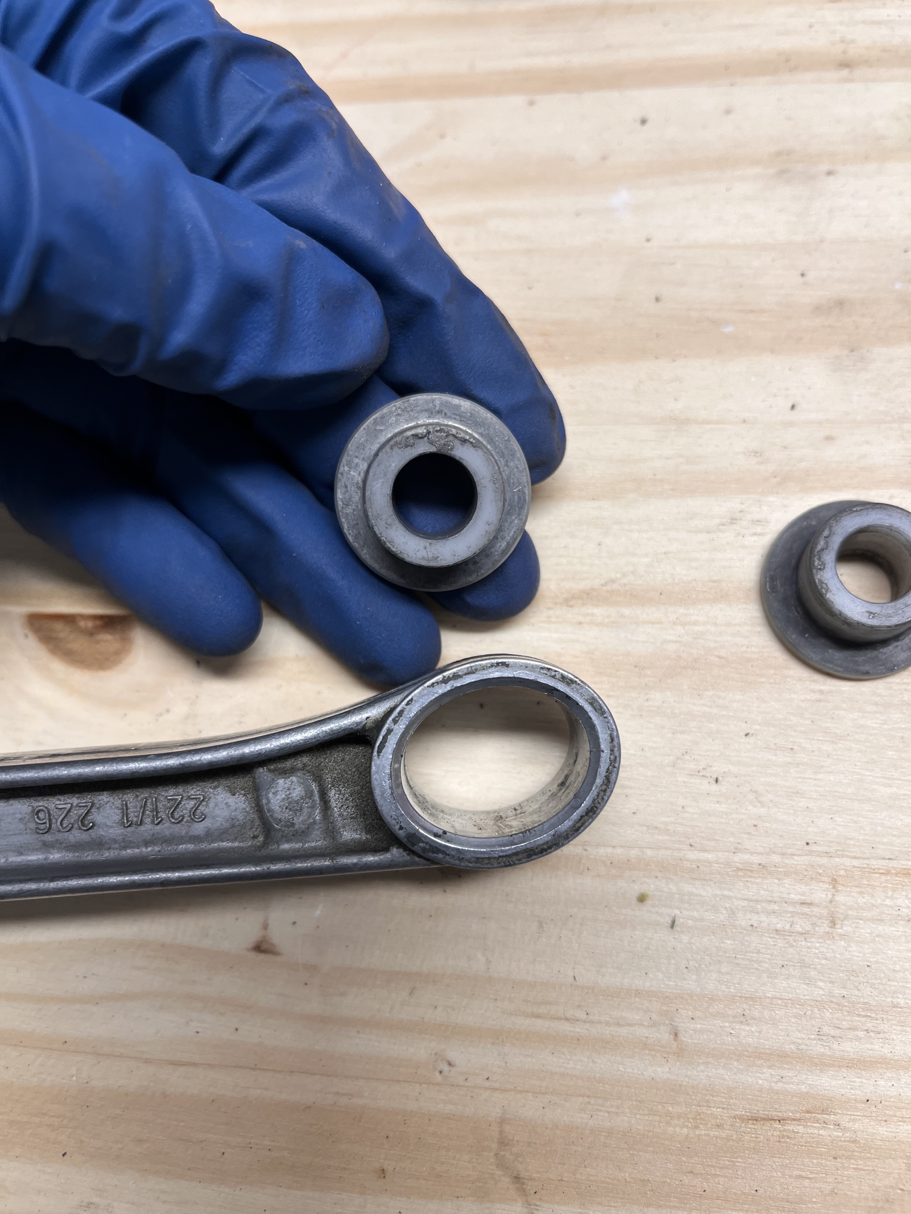

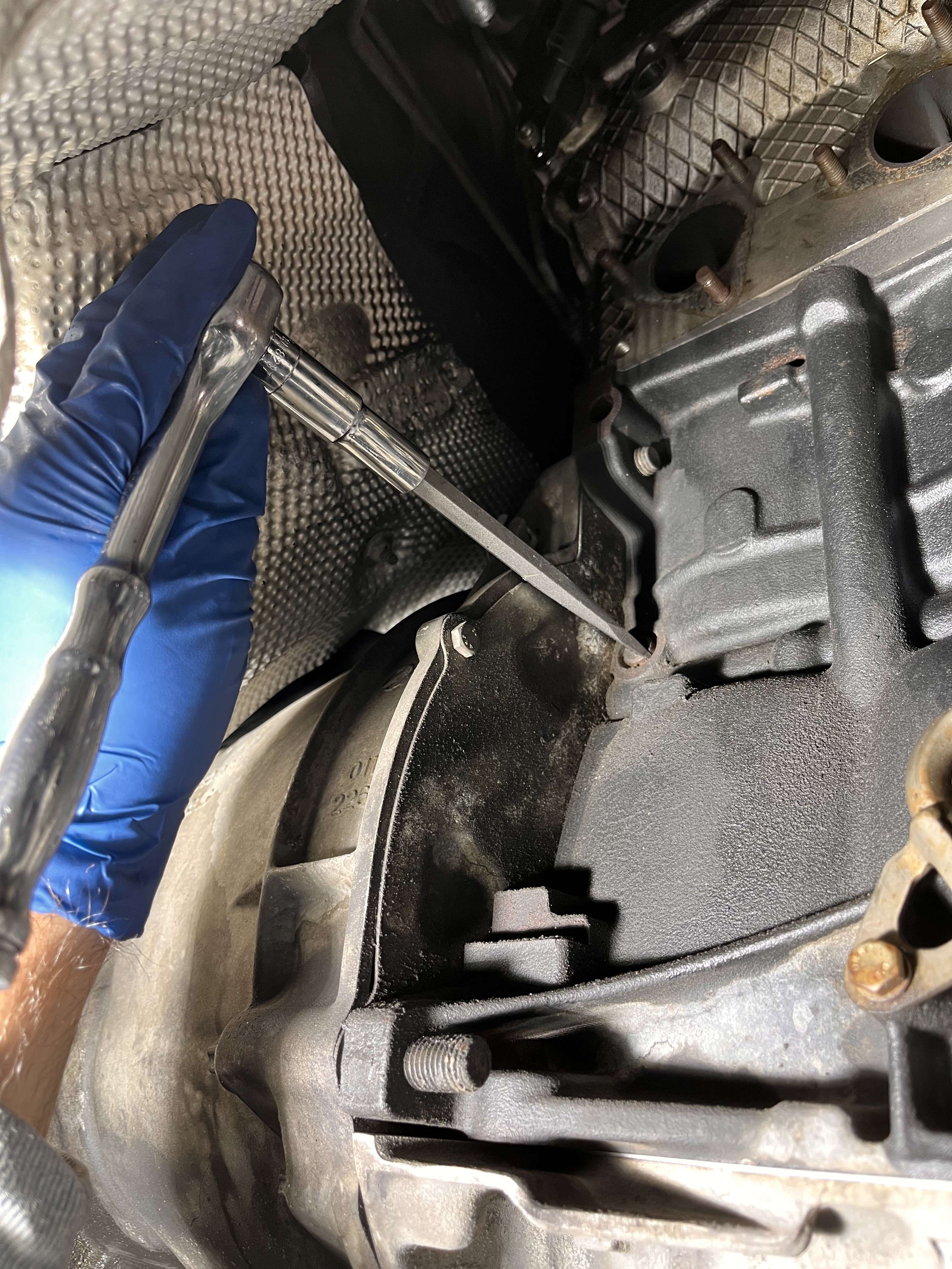

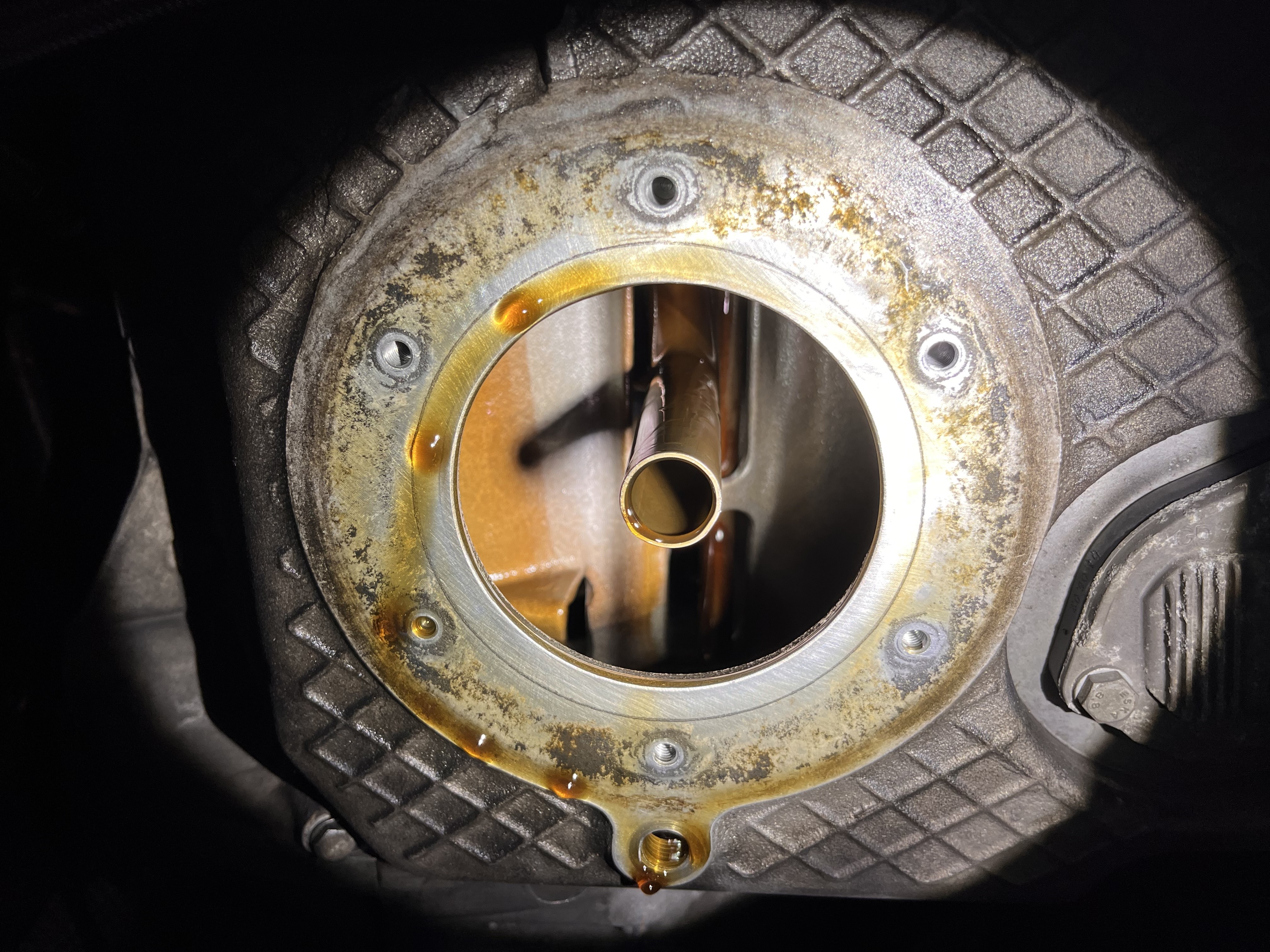

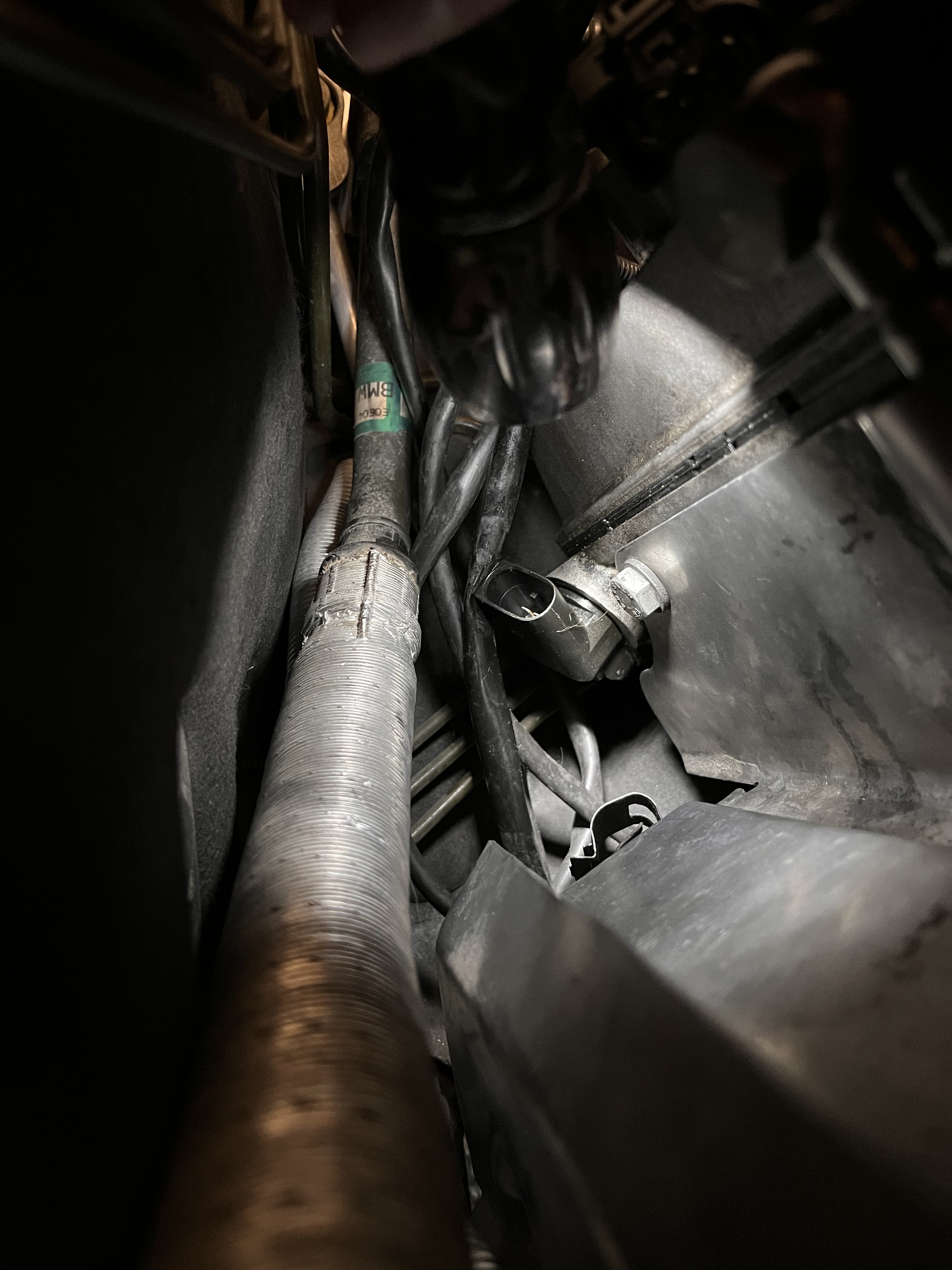

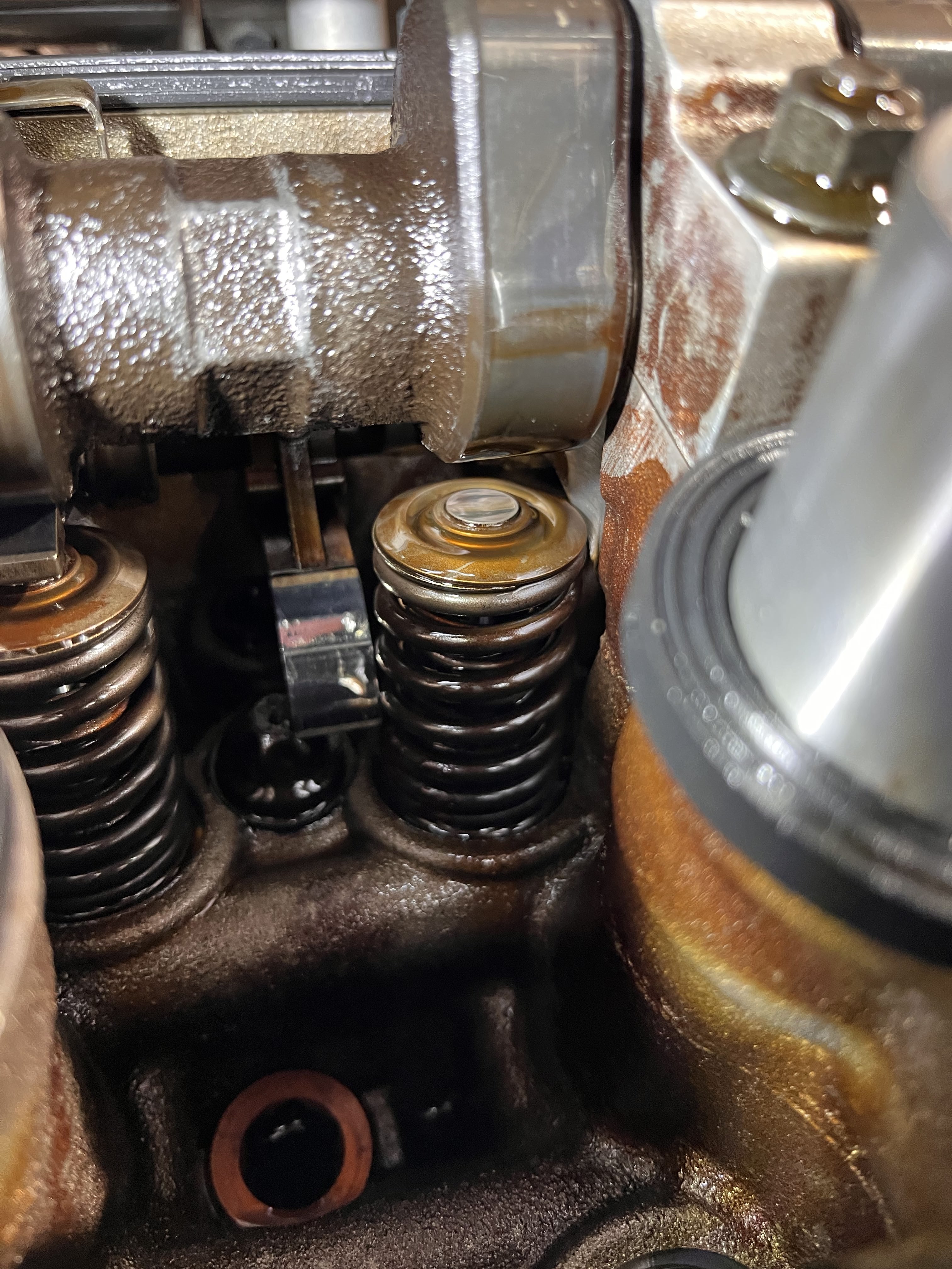

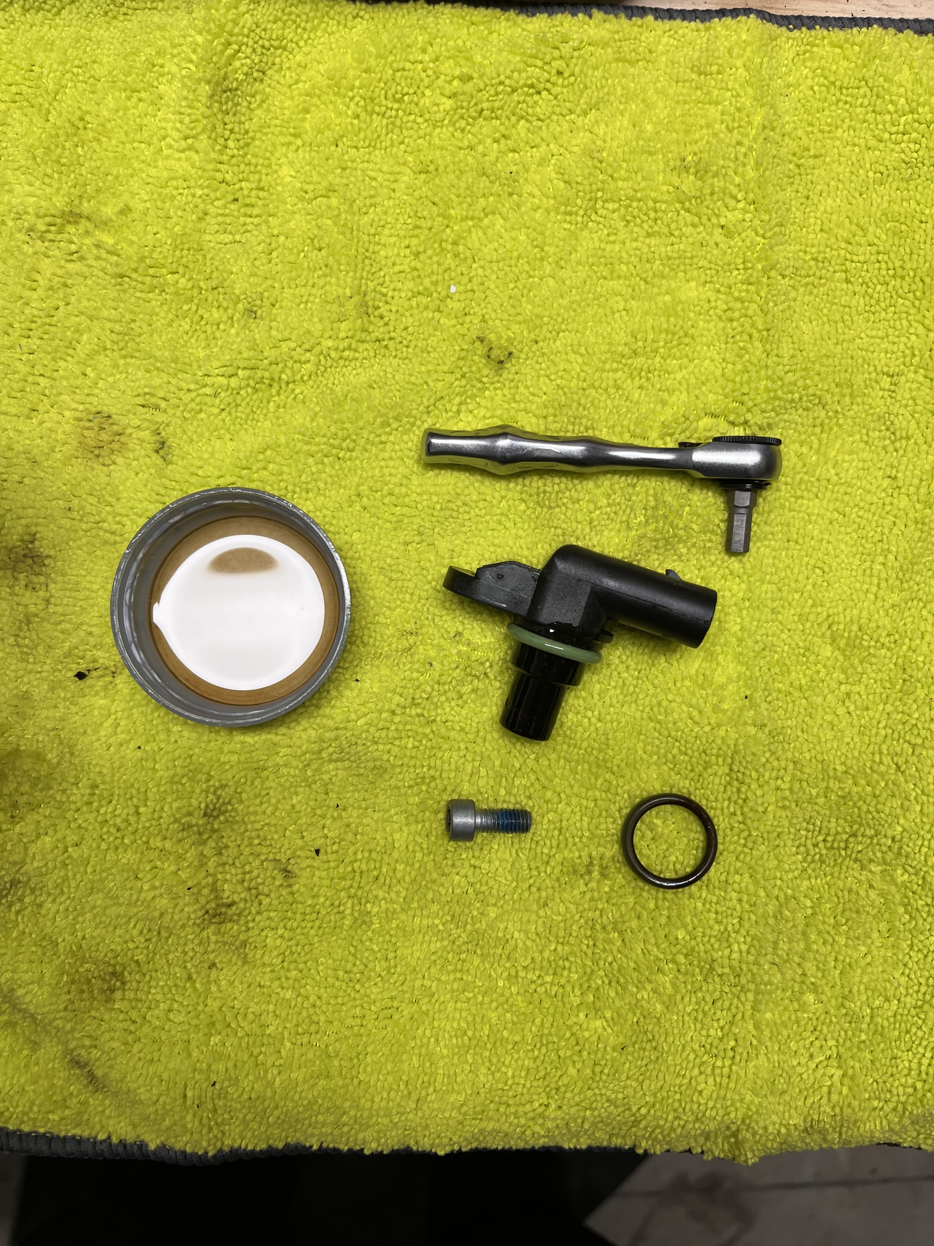

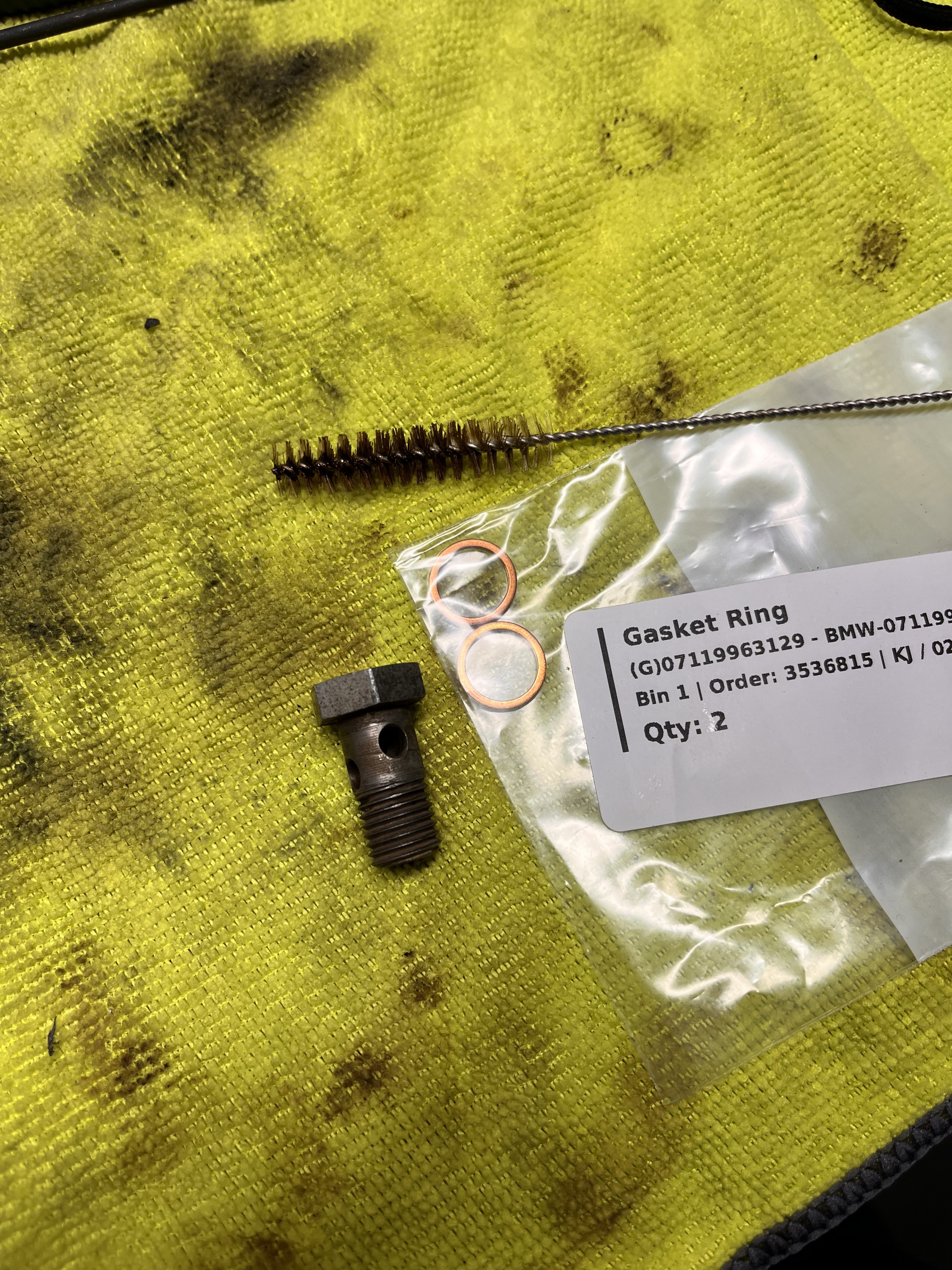

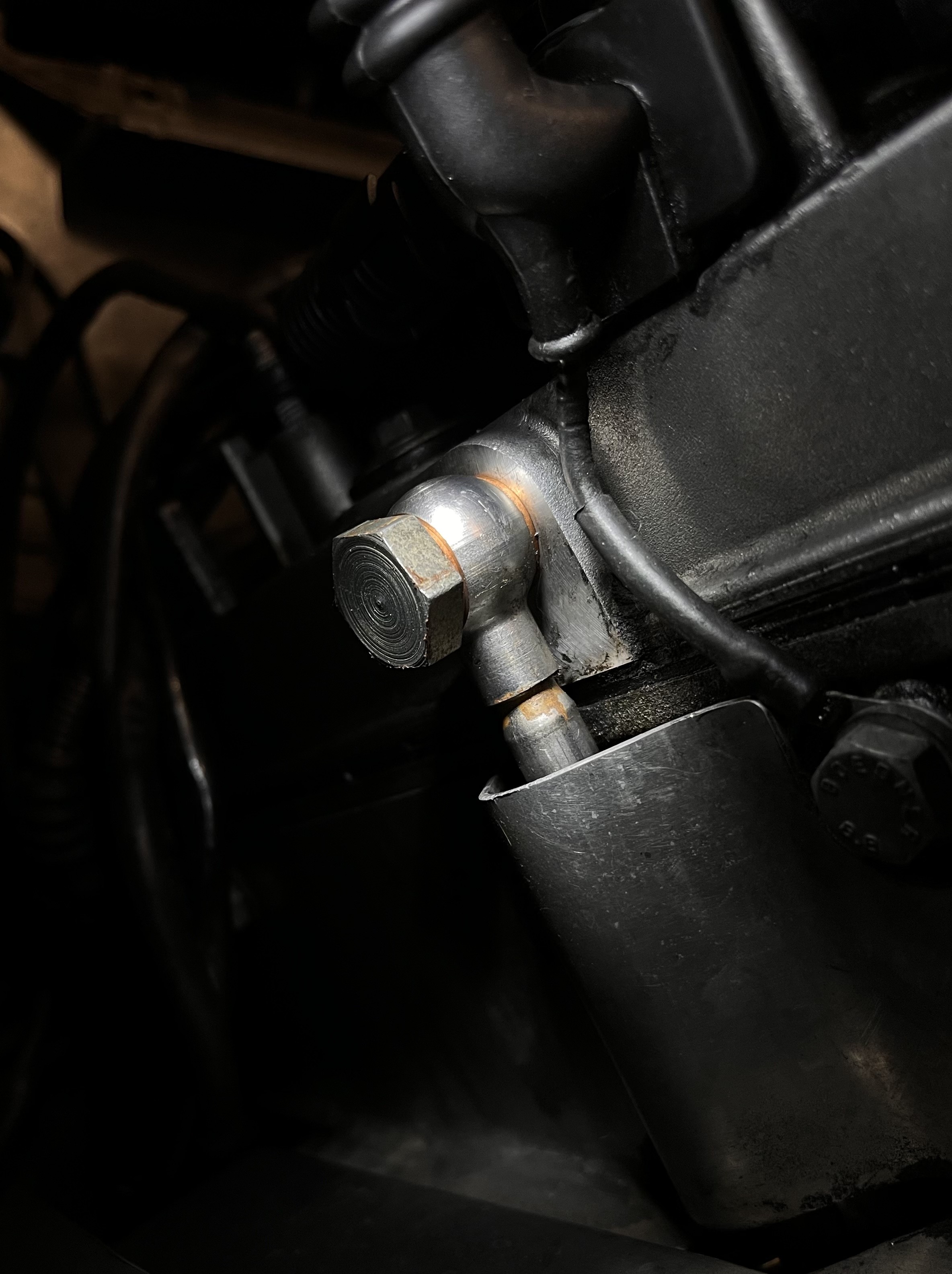

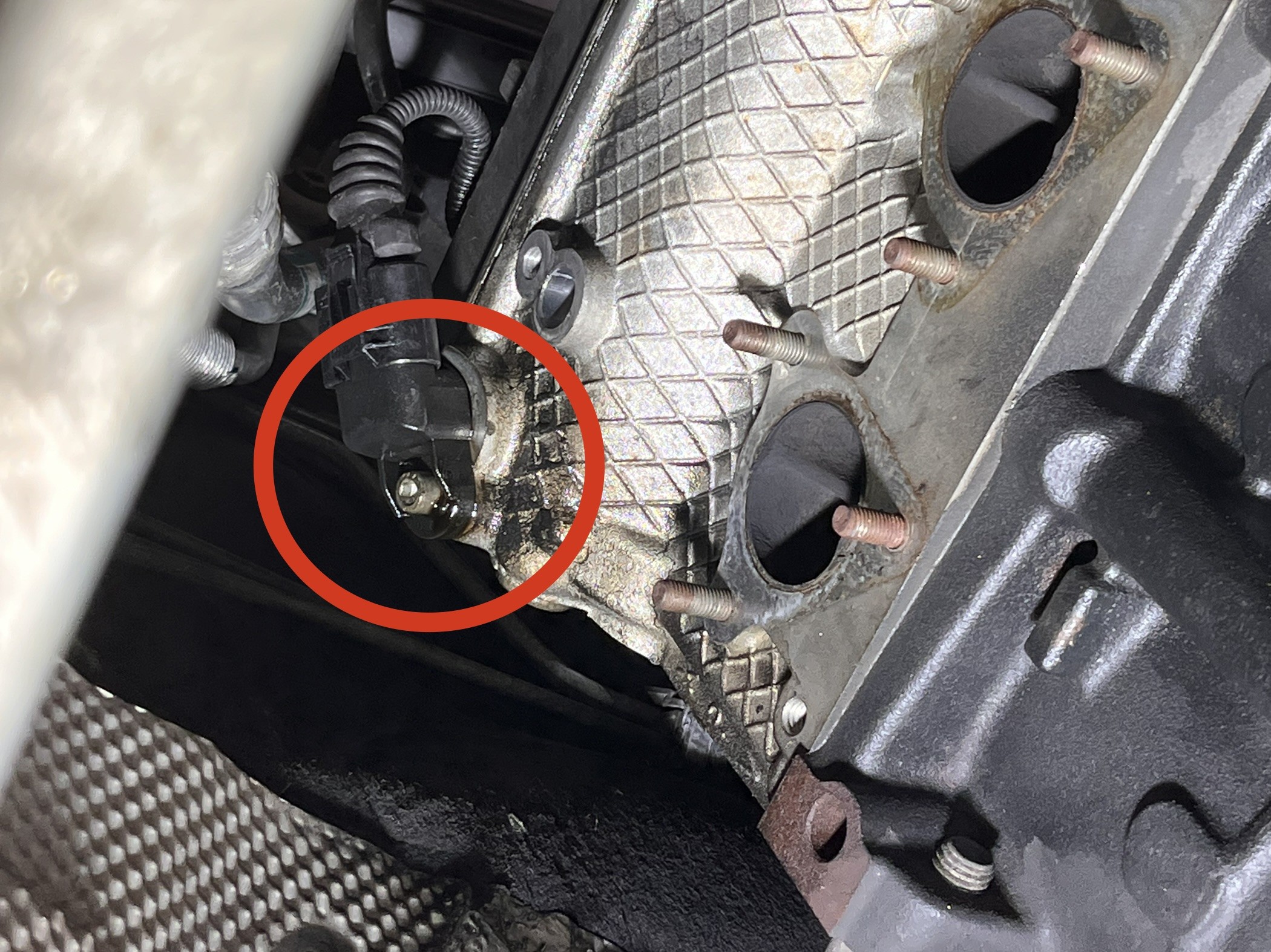

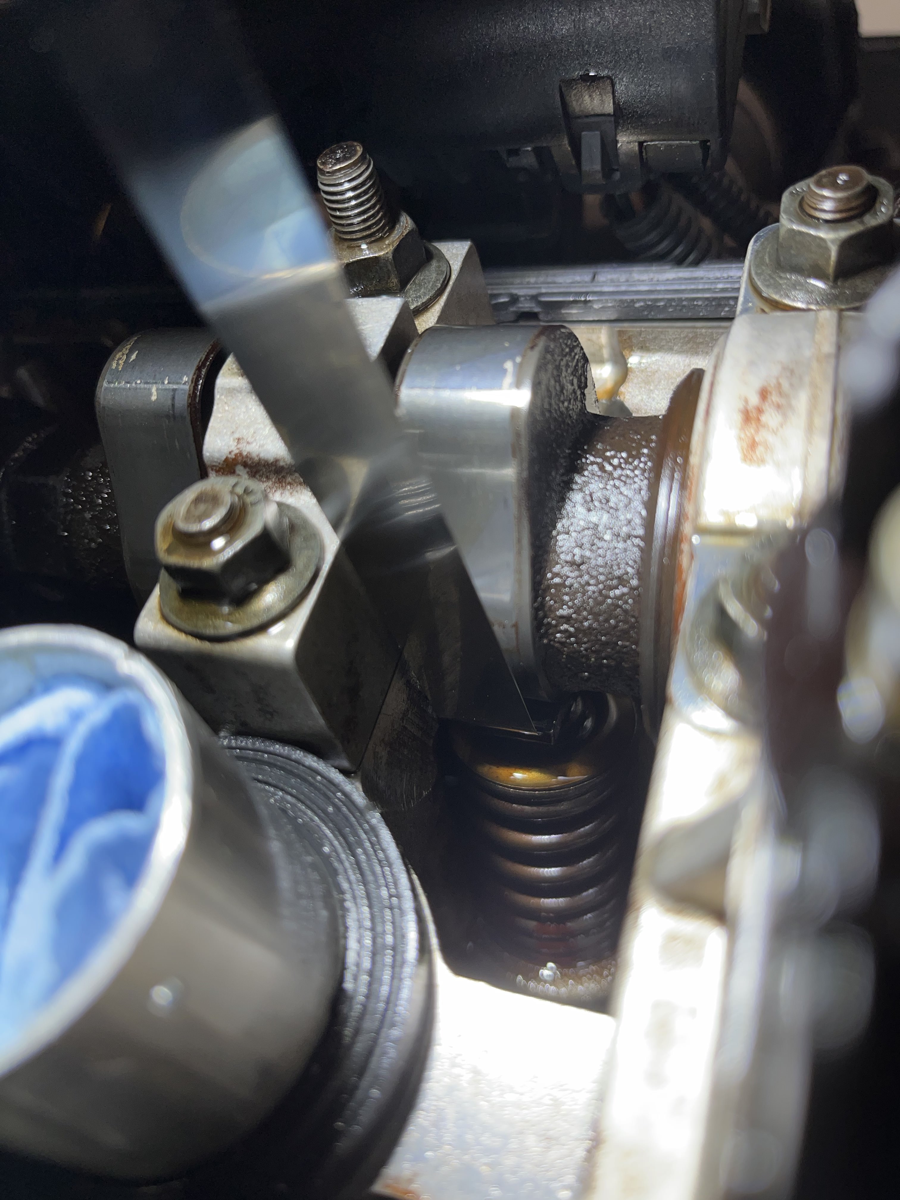

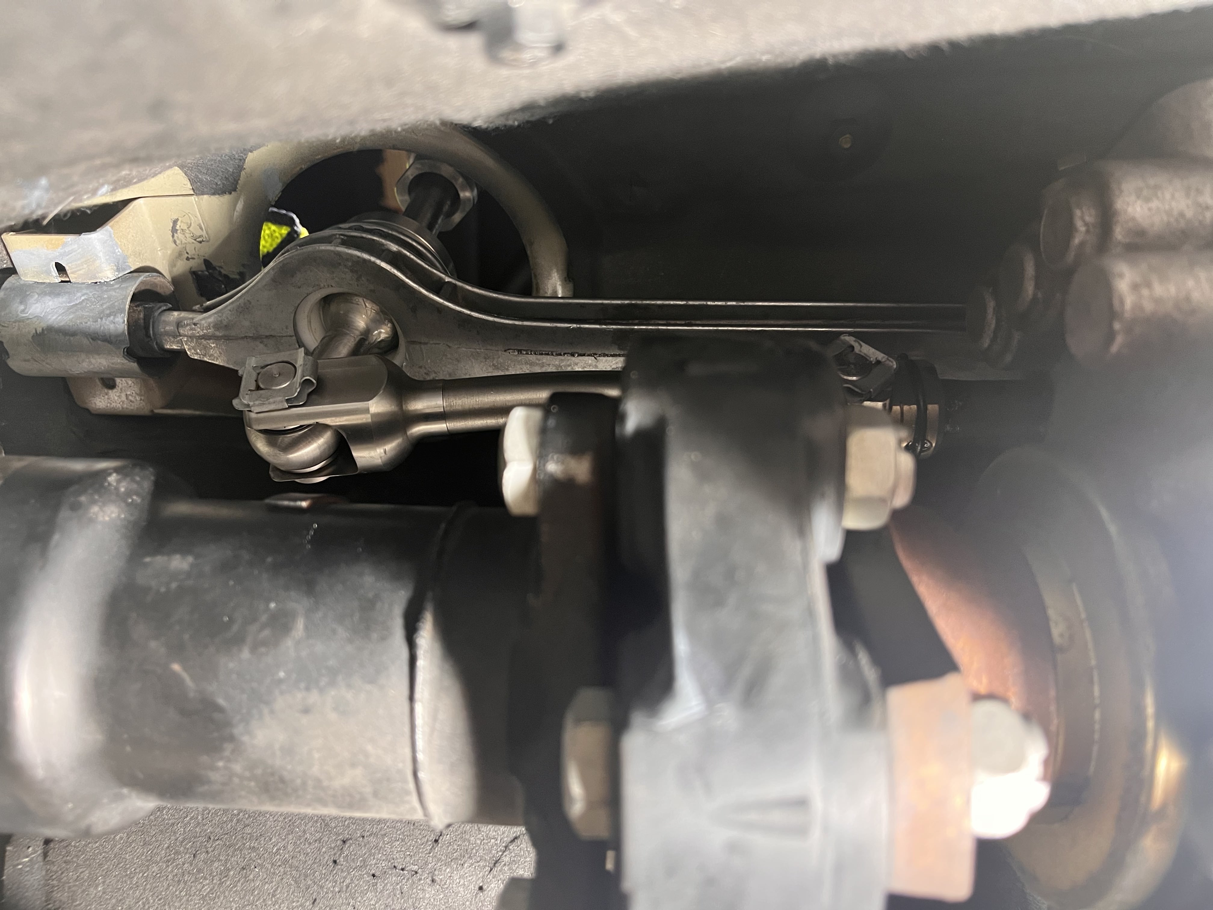

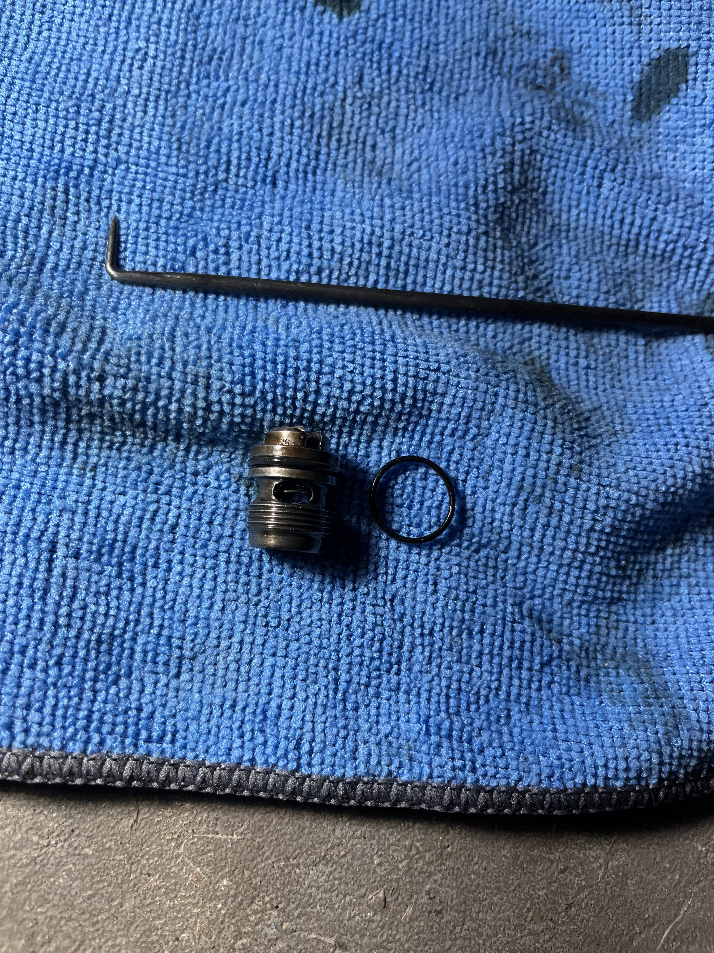

            Also got around to fixing some small oil leaks. One coming from the exhaust side camshaft position sensor o-ring and the other the oil return pipe crush washers.
            D987DCF1-B502-4FA2-9DE7-FA9D80030999.jpeg099DB5D9-70D6-4B45-B18C-9EF7C3A258D0.jpeg0F743750-1914-4546-A2D3-93B4EC8862A5.jpeg351FF038-1127-4A71-B905-A5CC68875DB0.jpegAA75009D-9CBA-4B36-B3B9-3B434E750CD4.jpeg
              Why do I feel like this is a jab at me.
              • pynaclP
                pynaclP
                pynacl
                Lol! The moment I saw you in 90 degree traffic with the heat blowing and your shirt off I said, that doesn’t look fun.
                  Is there not a good efan solution for those cars? Is it a space constraint?
                  • pynaclP
                    pynaclP
                    pynacl
                    Great question. Most run the 16" SPAL like the one in this BuildJournal thread: https://thebuildjournal.com/diy/n15-design-e46-m3-electric-fan-mount-diy/. It seems to cover as much as the clutch fan, but maybe it has to do with the fact it deletes the aux fan and the clutch fan? Not entirely sure.

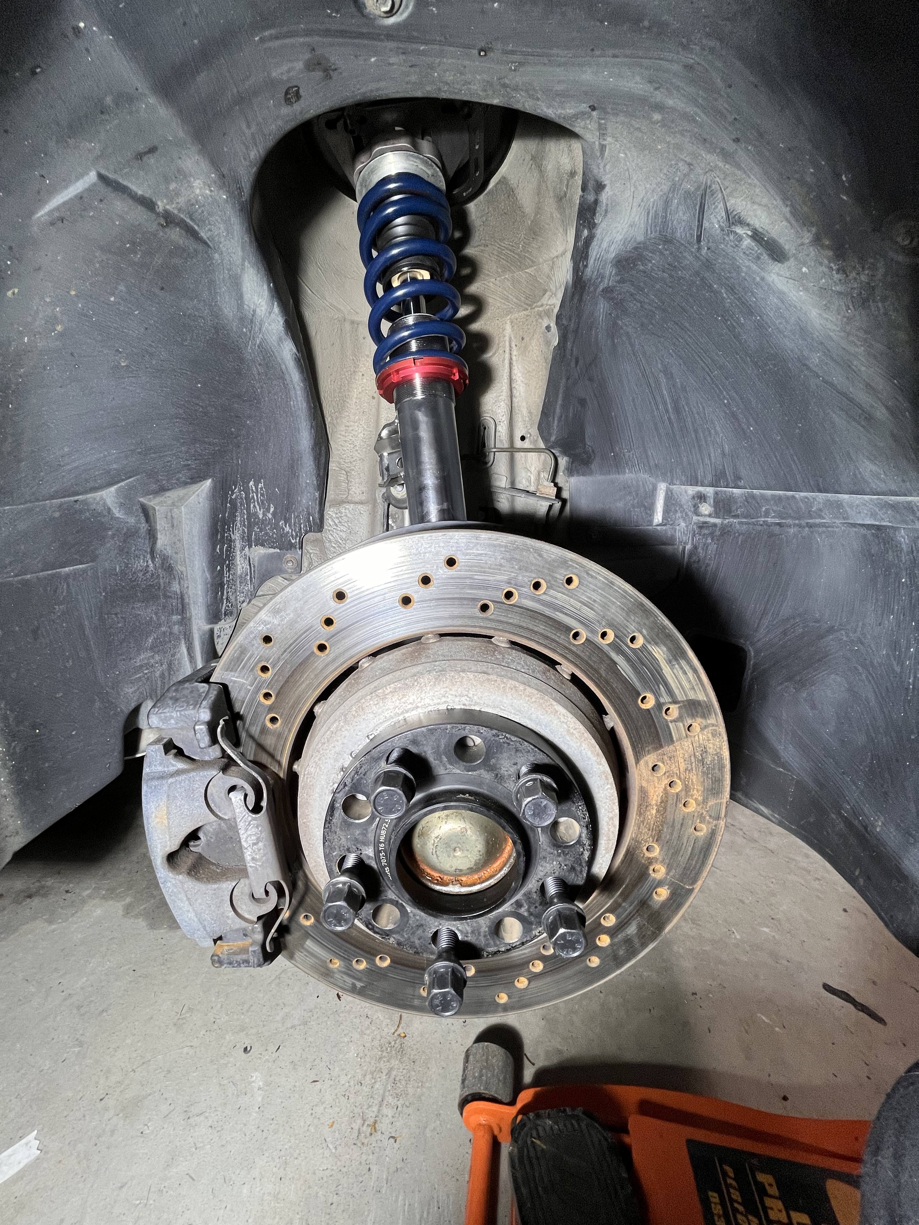

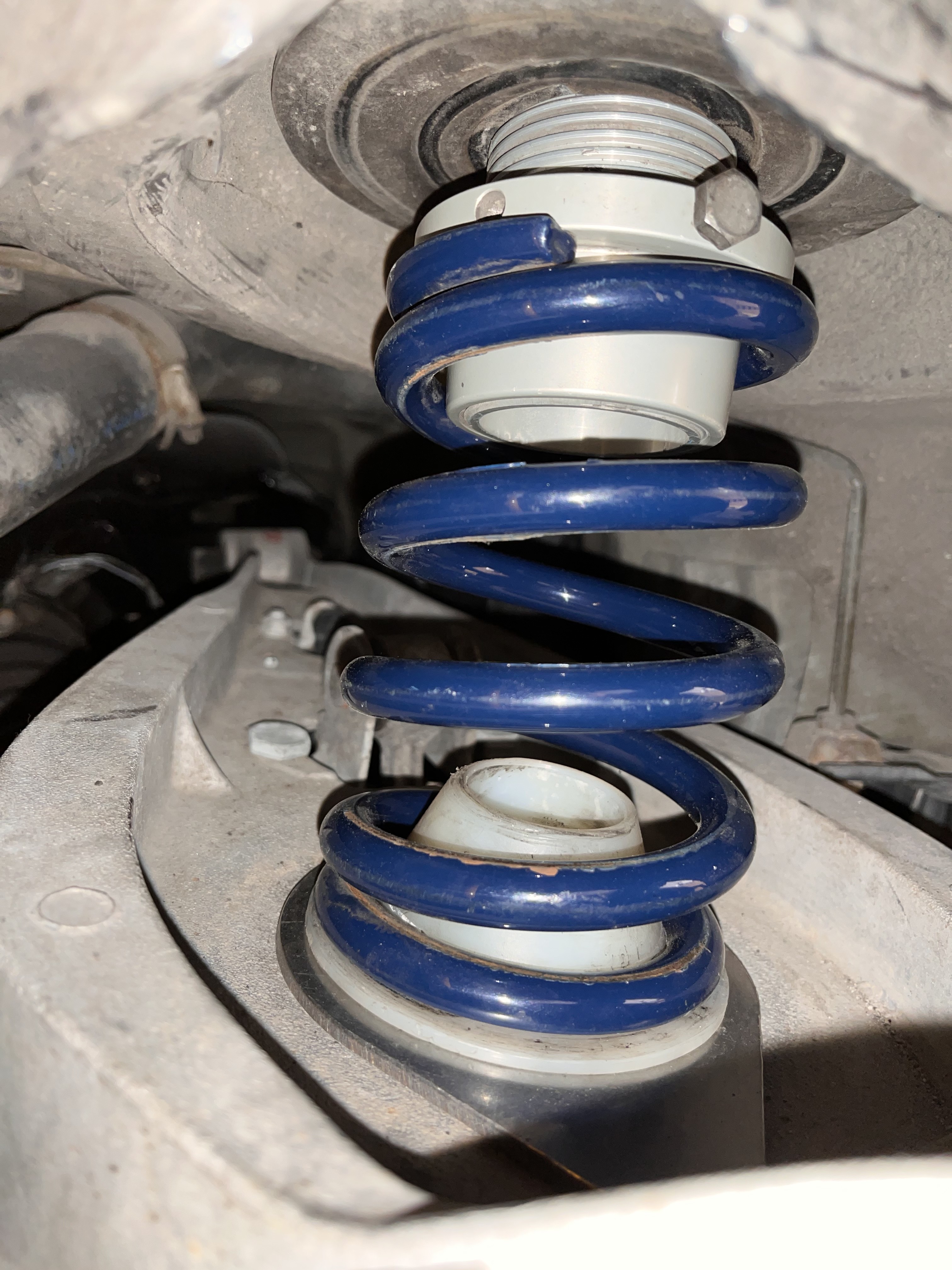

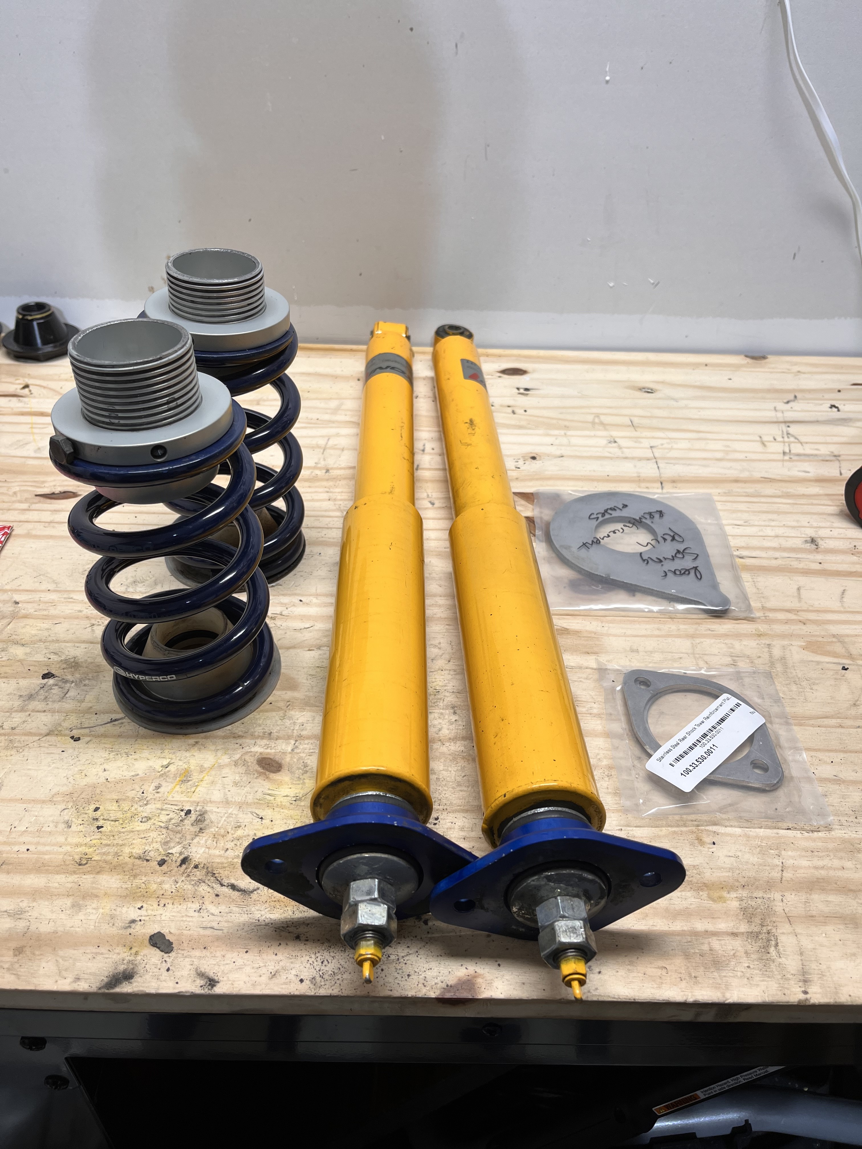

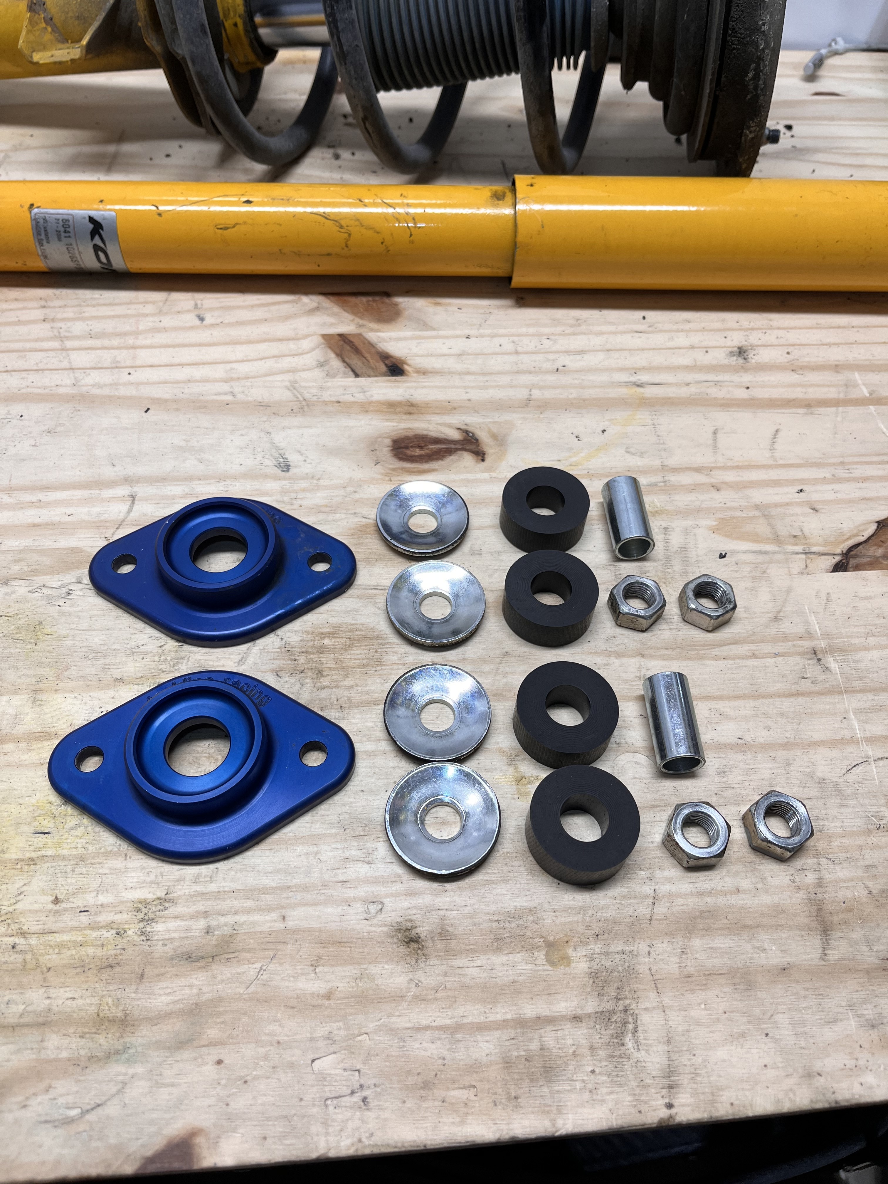

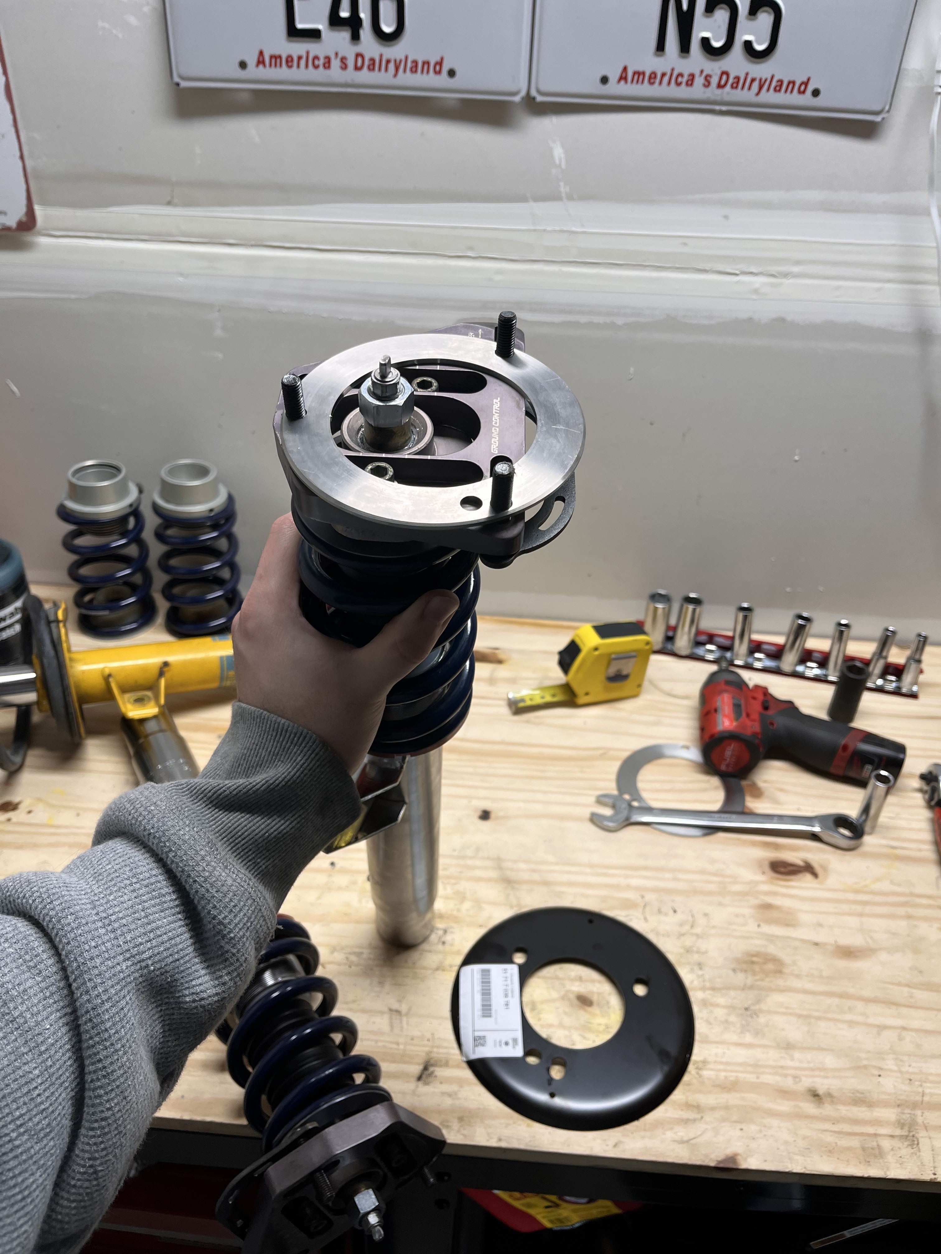

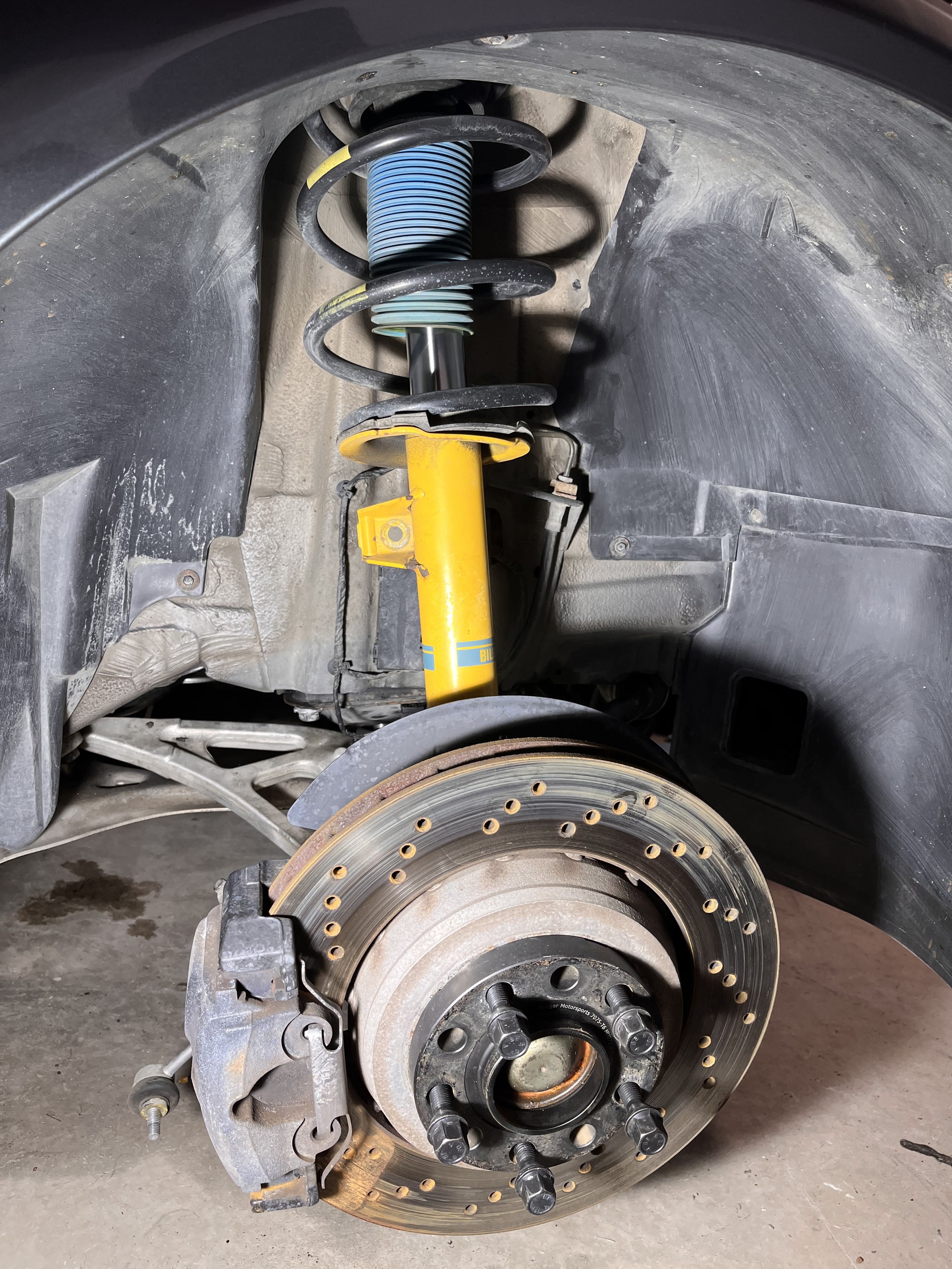

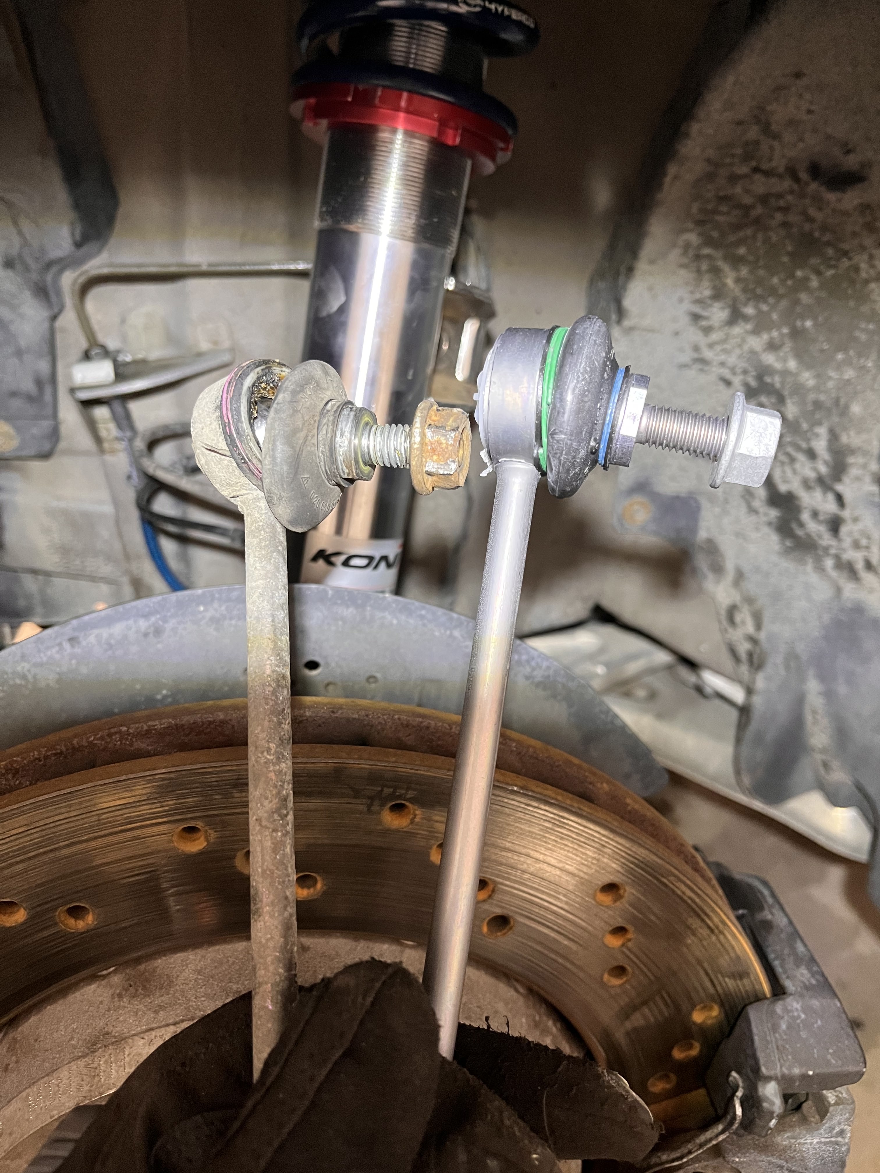

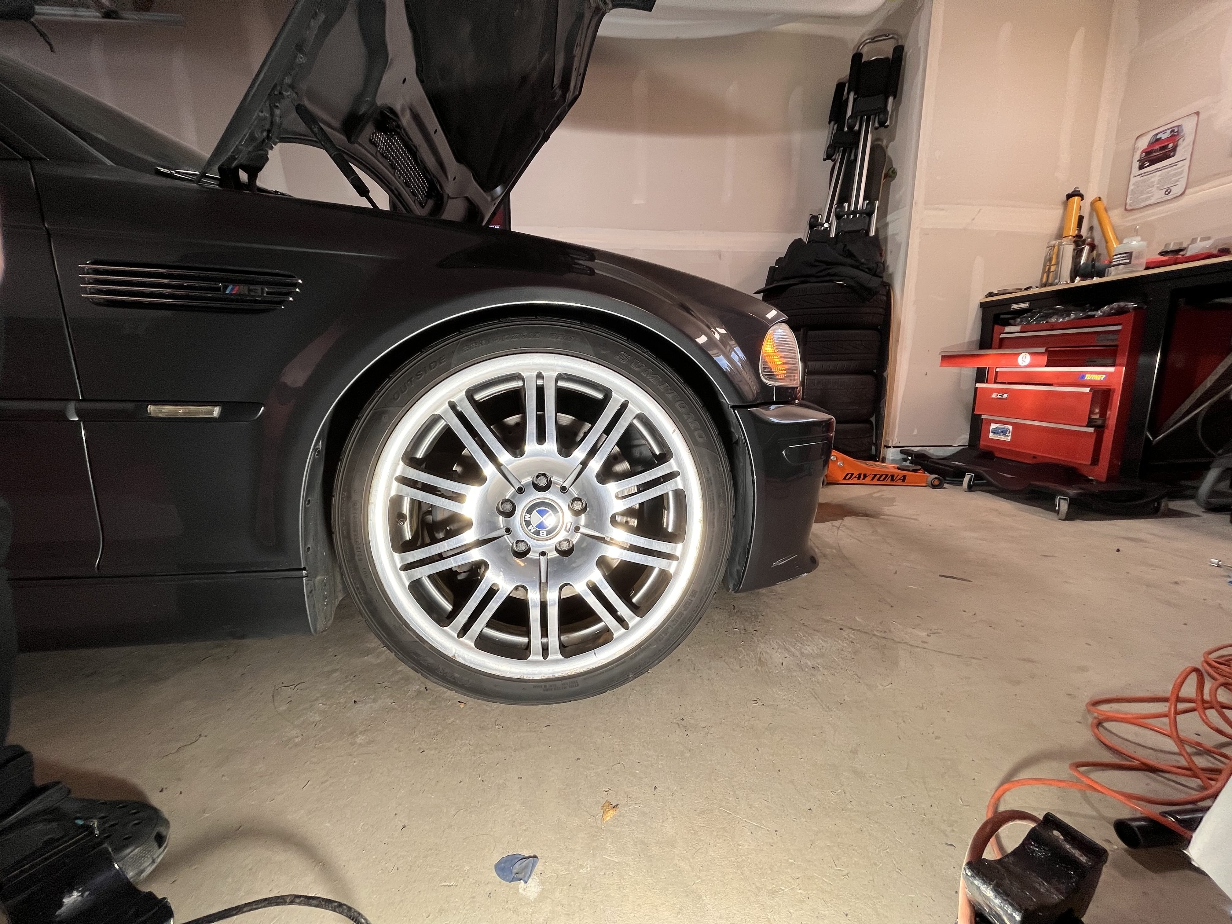

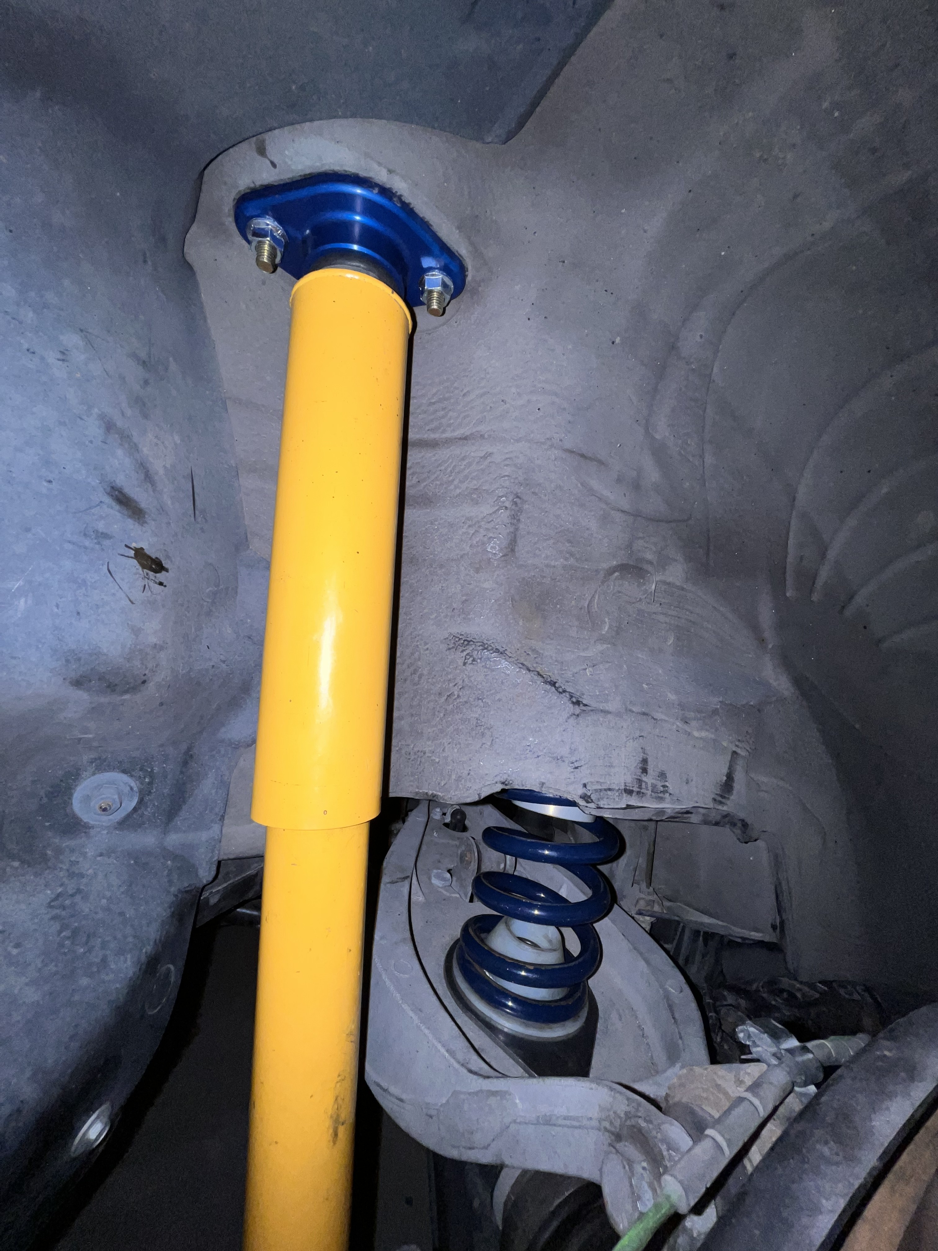

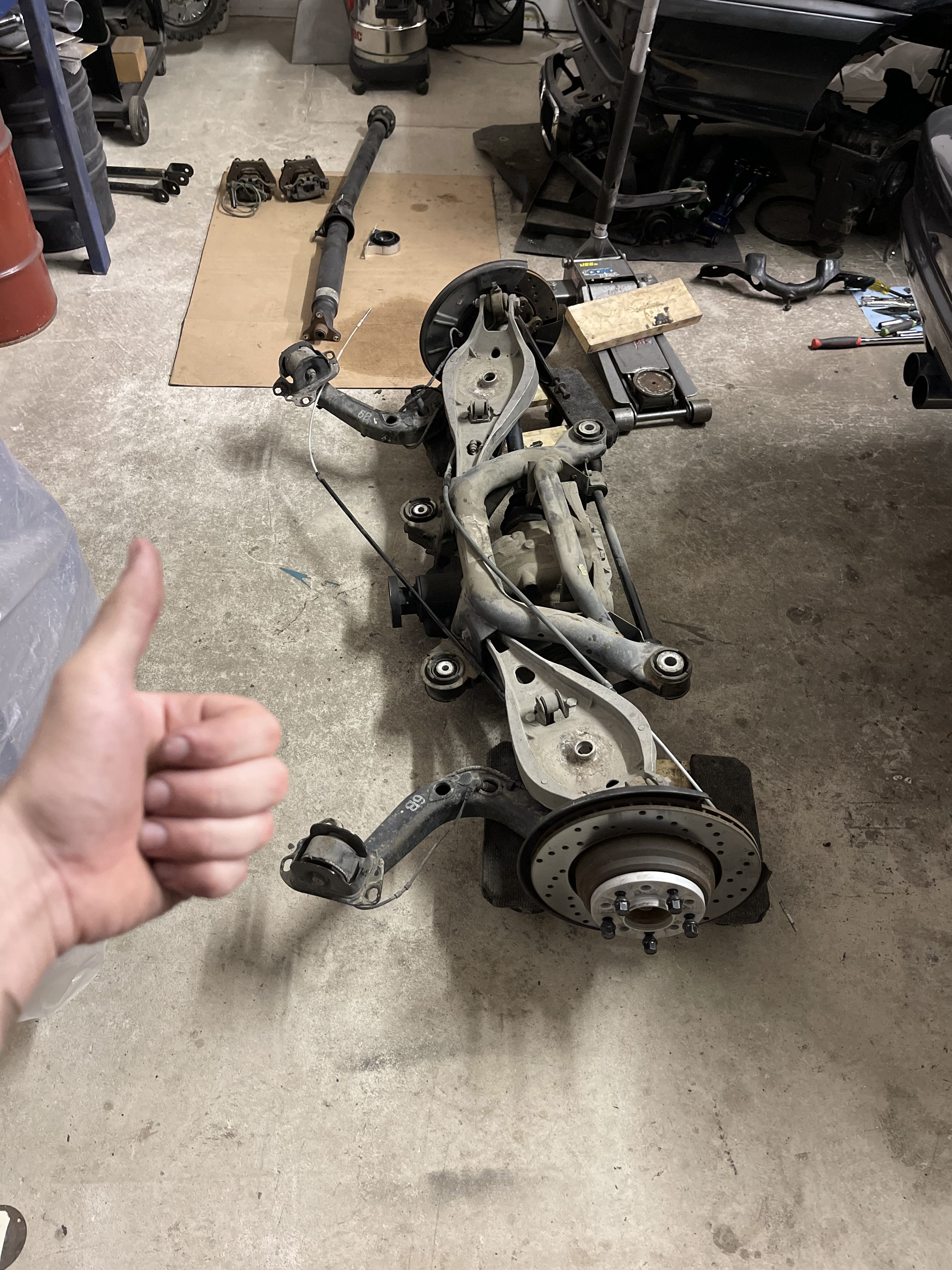

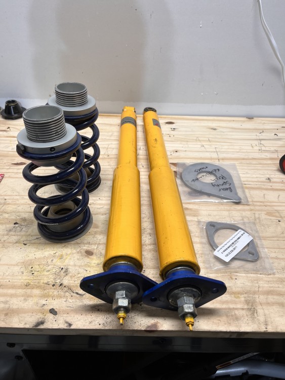

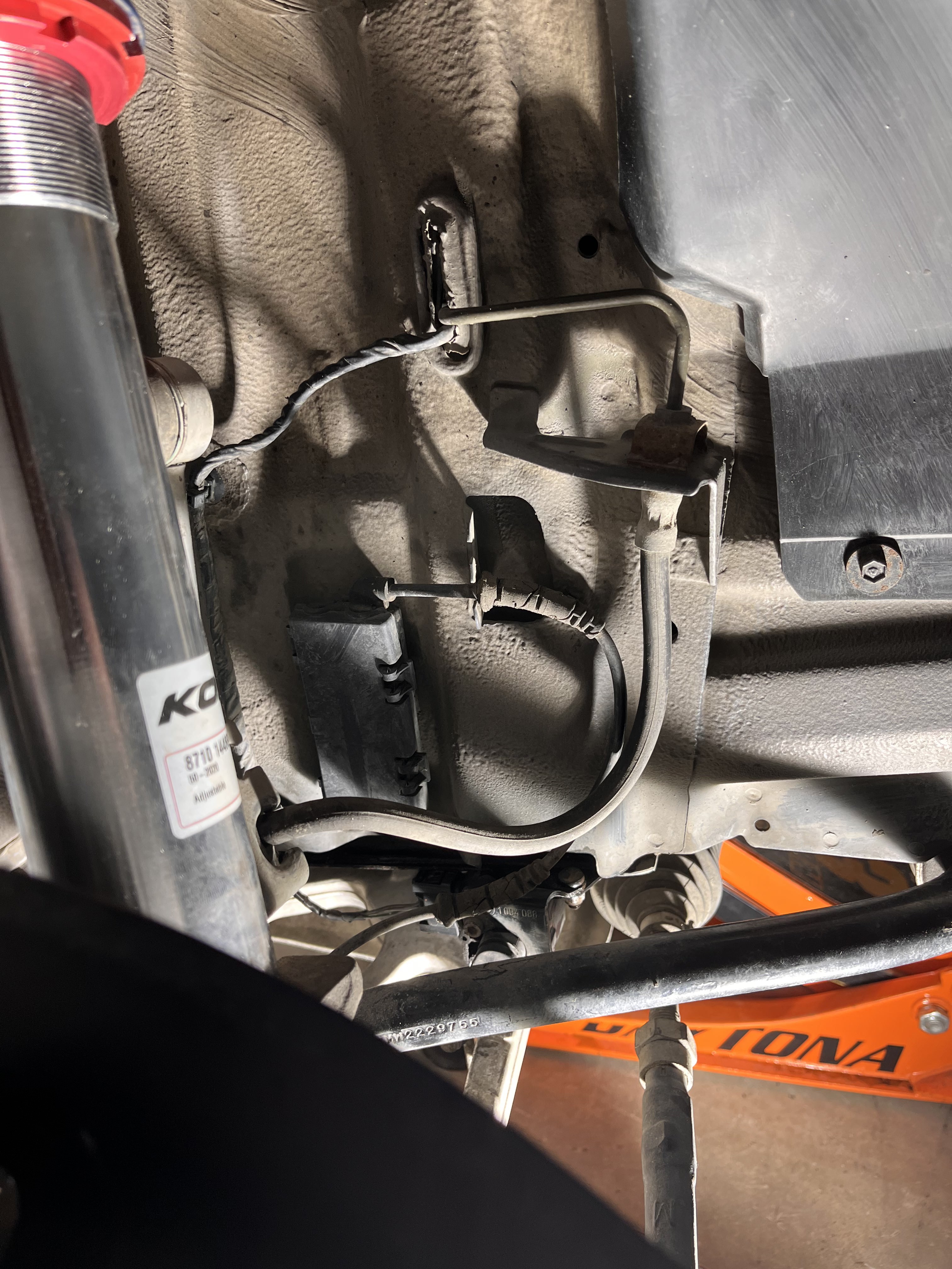

                      Got the front suspension installed with the reinforcement plates, replacing the OE Bilstein kit. Definitely a lot of stuff to balance together while you line them up by yourself. Set them as close to factory height as I could for a good starting point and -2.5 camber. Totally overkill for the factory wheels right now, but plan to get something else before I actually pull it out in the spring.
                      Full setup is:
                      • Front
                        • TC Kline Single Adjustable coilover (uses a Koni shock)
                        • Ground Control Race Camber/Caster Plate
                        • 500lb Hyperco Springs
                        • OEM BMW Reinforcement Plates
                      • Rear
                        • TC Kline External Adjustable Rear Shock
                        • TC Kline Buna Rubber rear shock mounts
                        • 600lb Hyperco Springs
                        • Rogue Engineering Spring Perch Reinforcement Plates
                        • Rogue Engineering RSM Reinforcement Plates

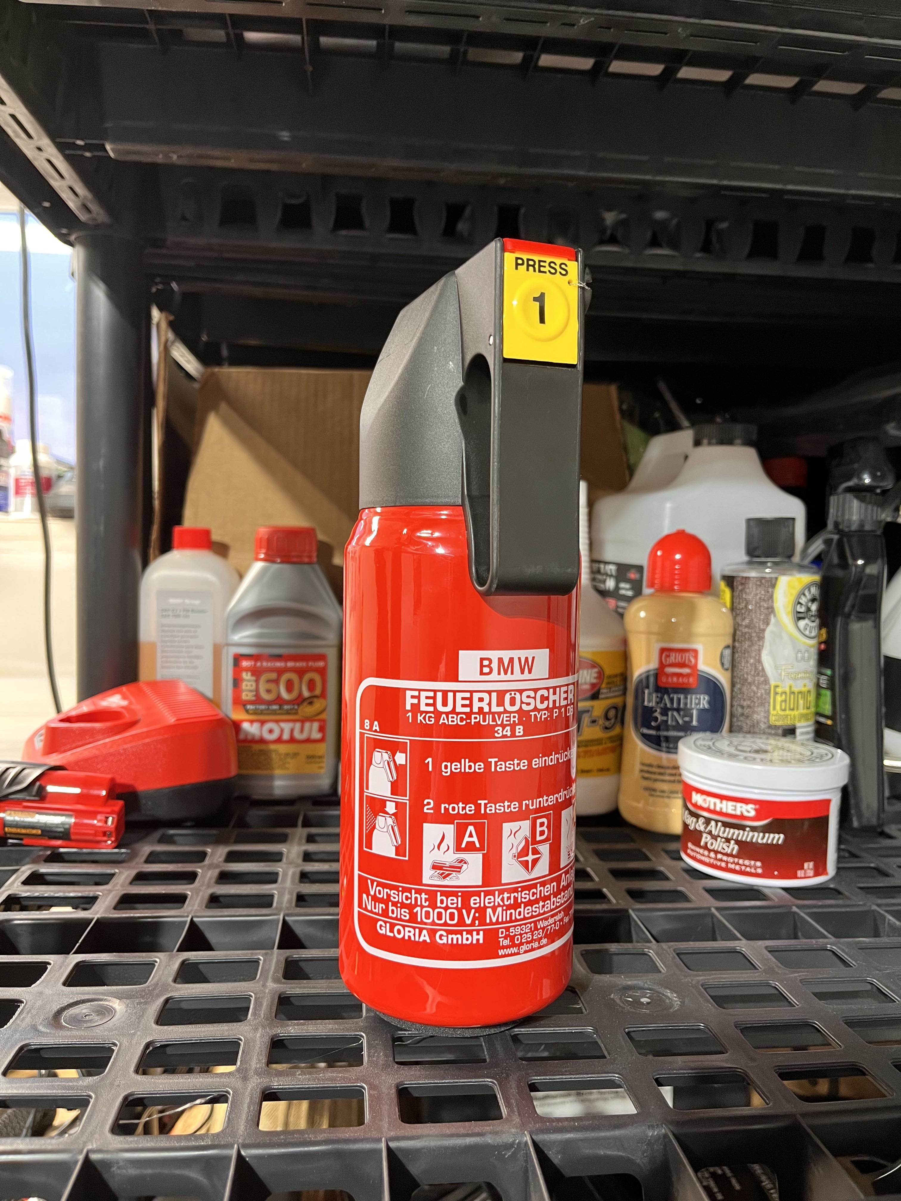

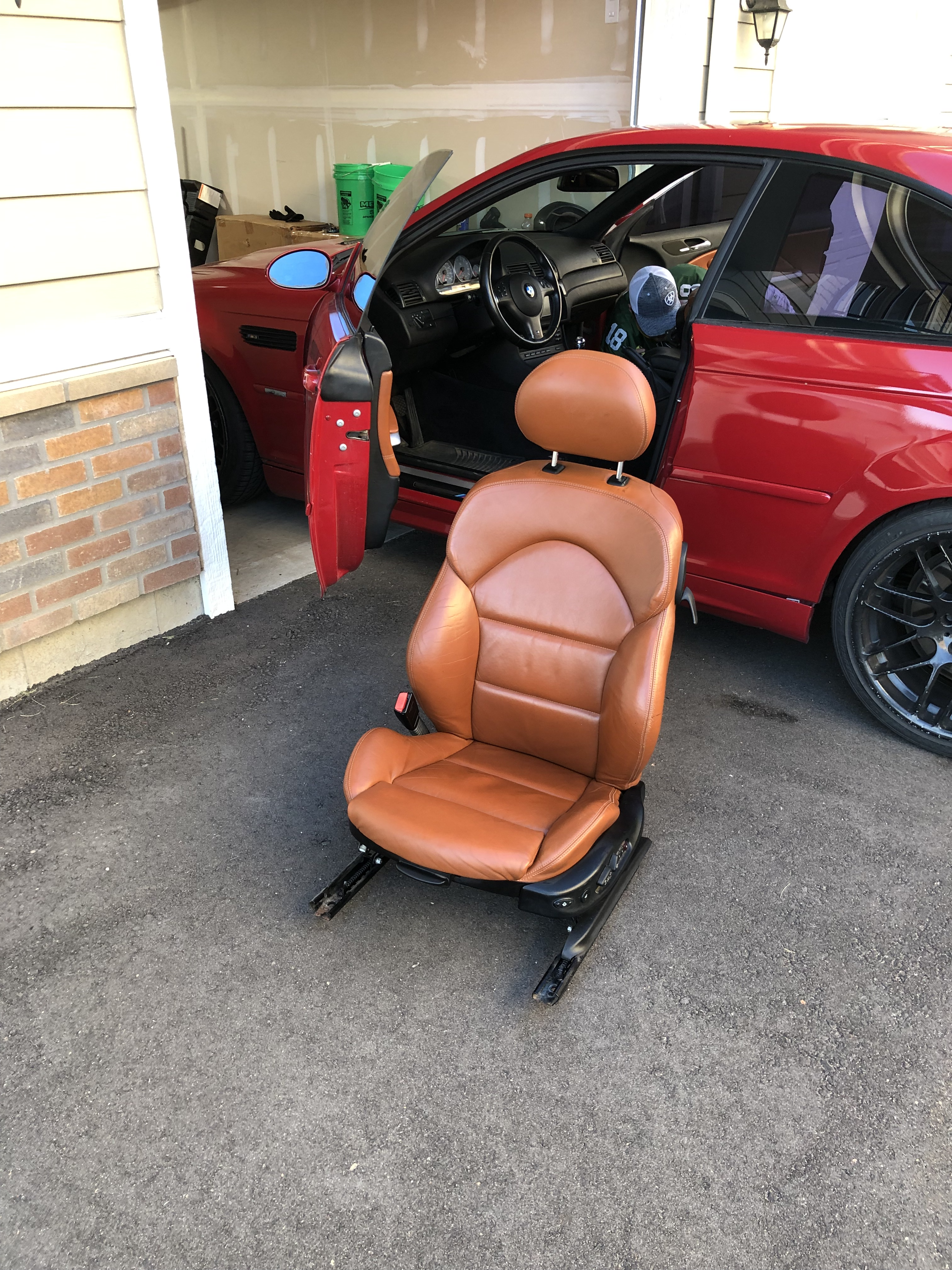

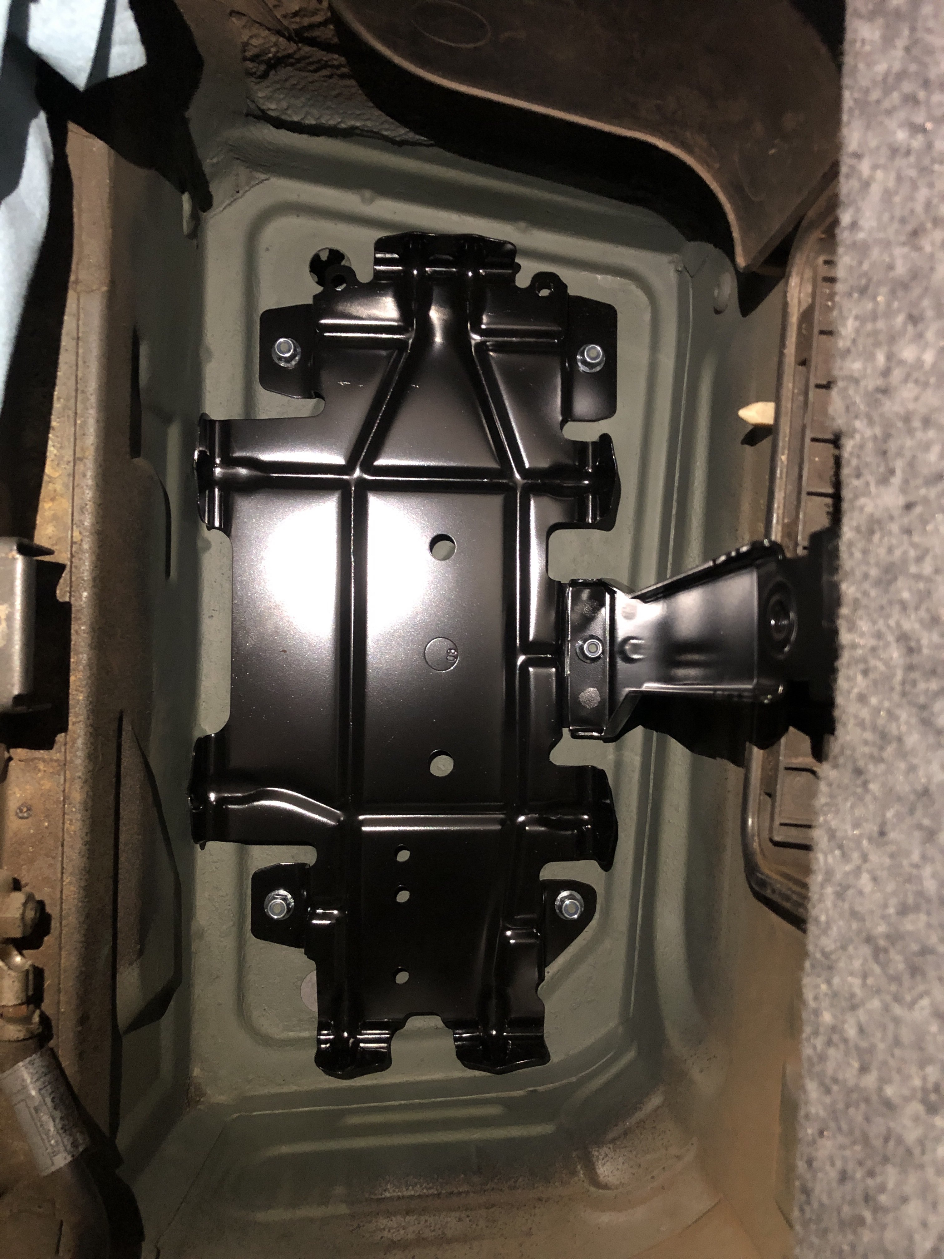

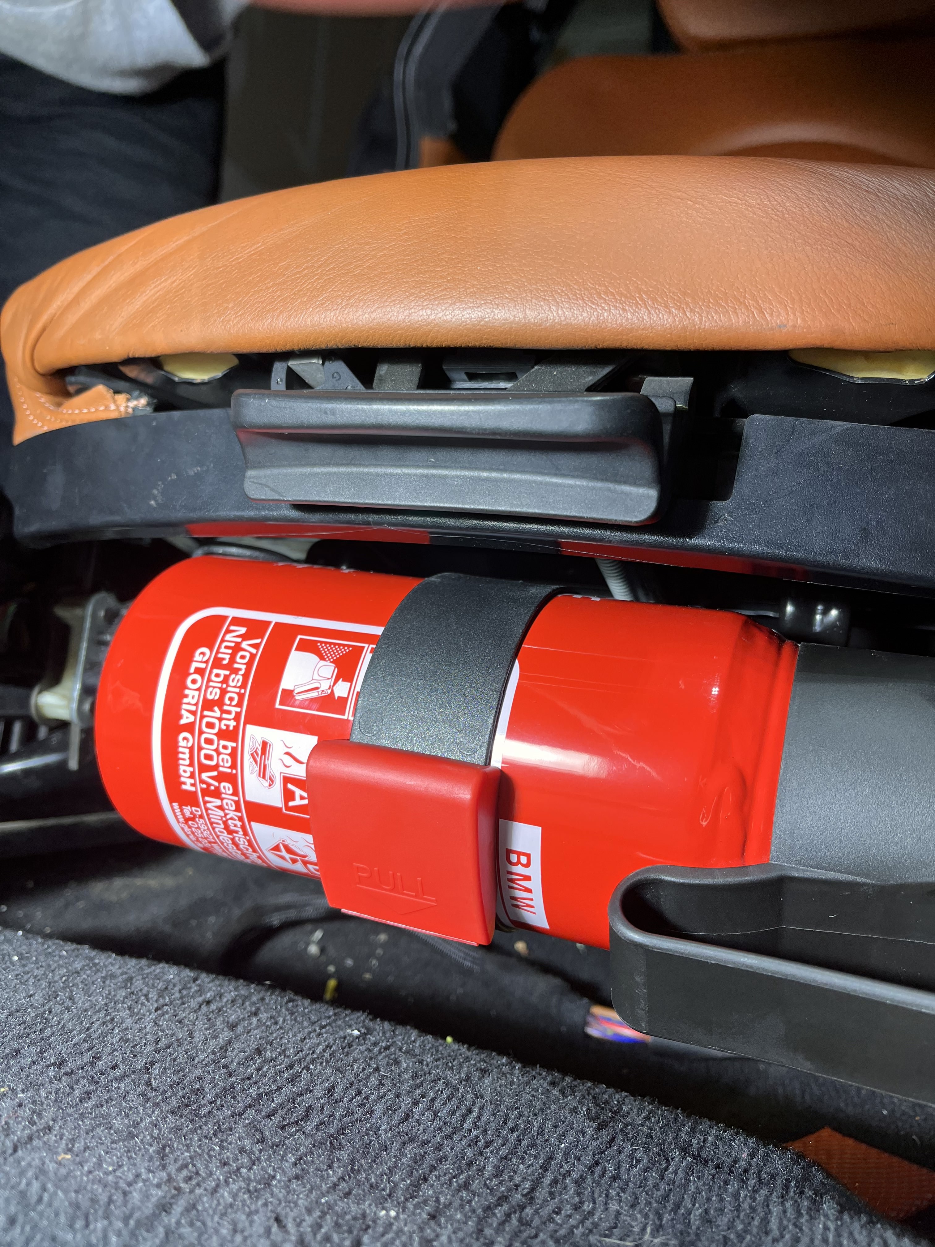

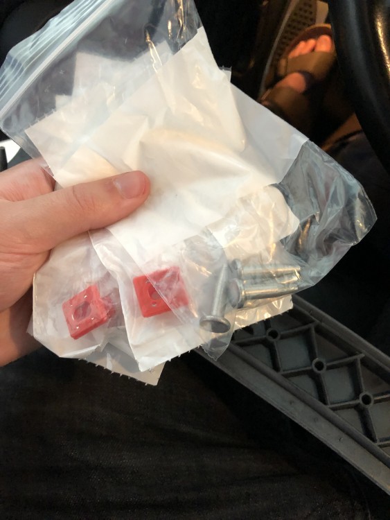

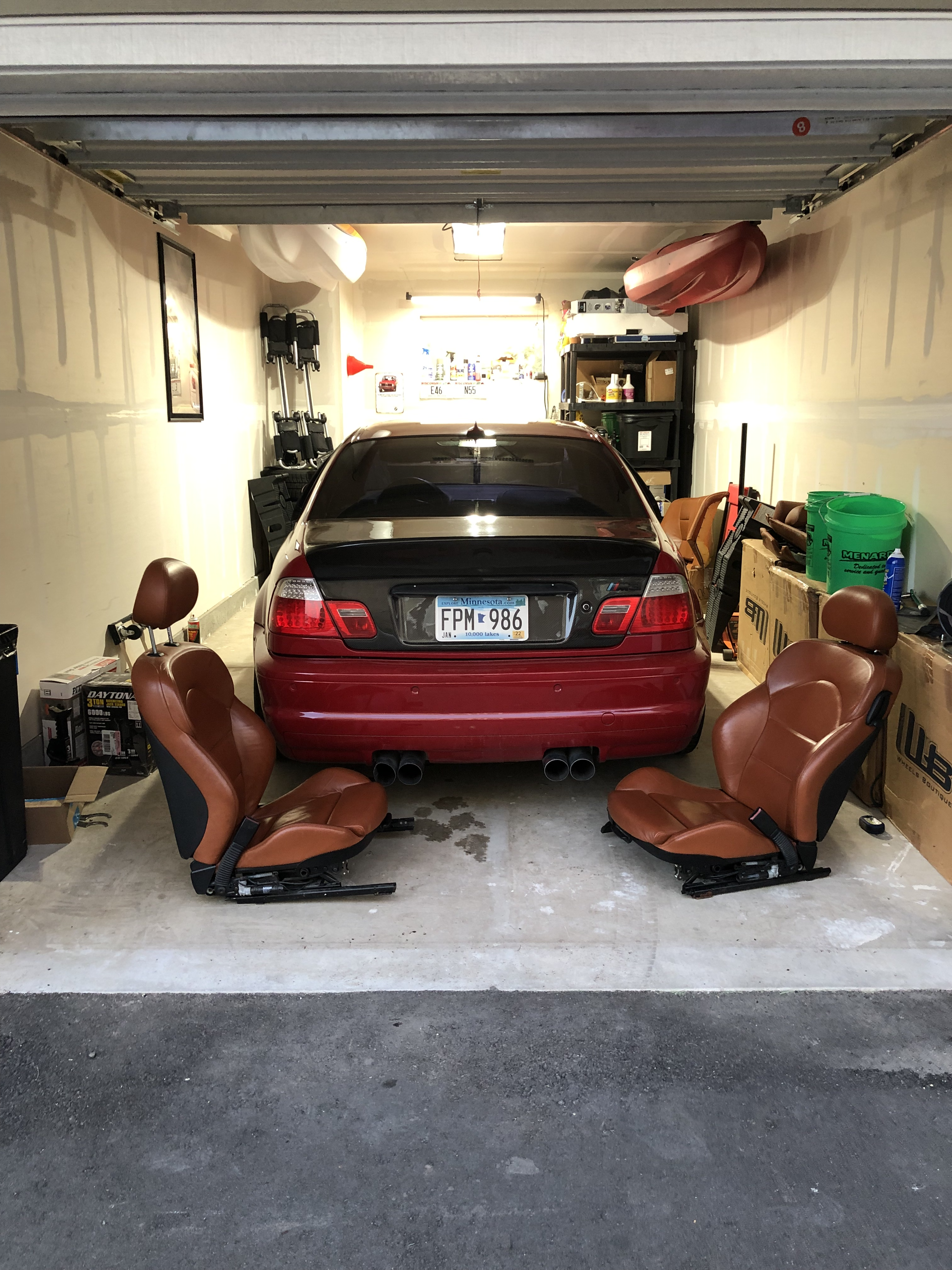

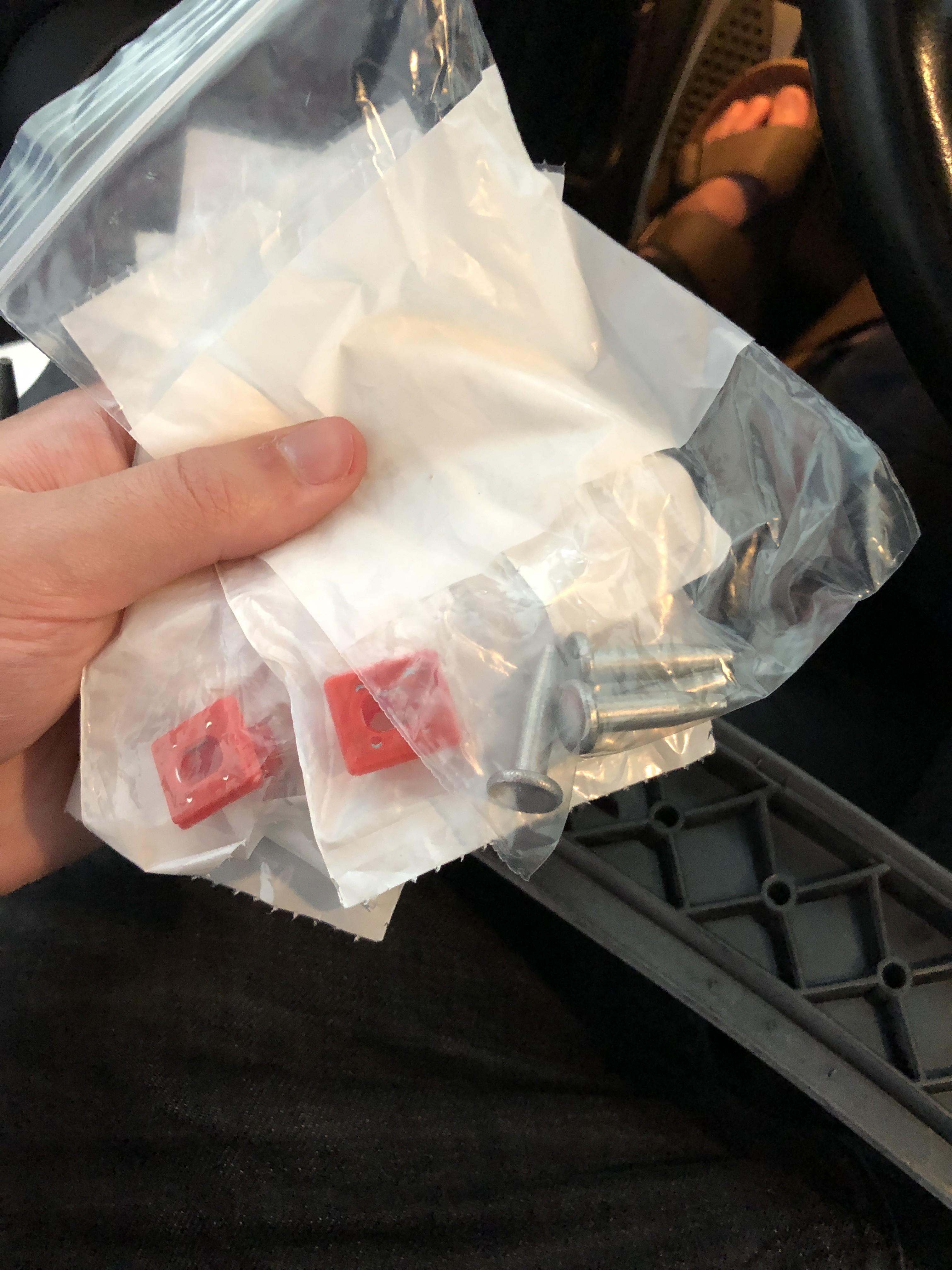

                        Got an awesome christmas gift from @Rekpoint, a genuine BMW fire extinguisher and seat mount kit. These are pretty dang hard to get into the states because they're considered a dangerous good with the pressurized canisters.
                        The brackets and seat are only drilled from the factory and require a M6x1.25 thread to be tapped. Luckily the included hardware is self tapping, just requires some pretty small tools to properly install everything.

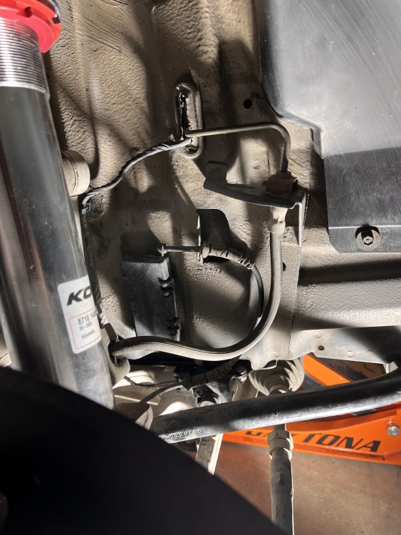

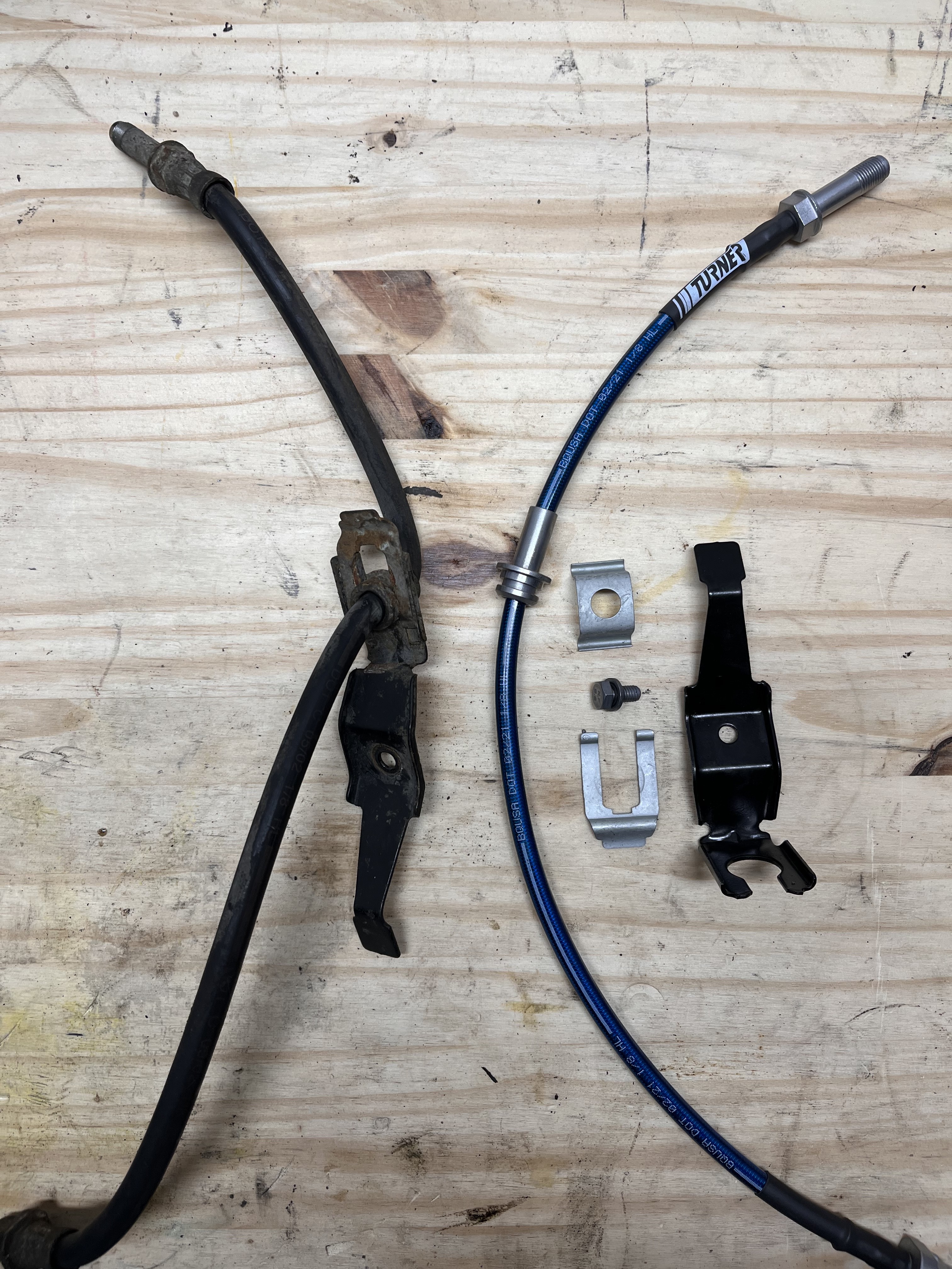

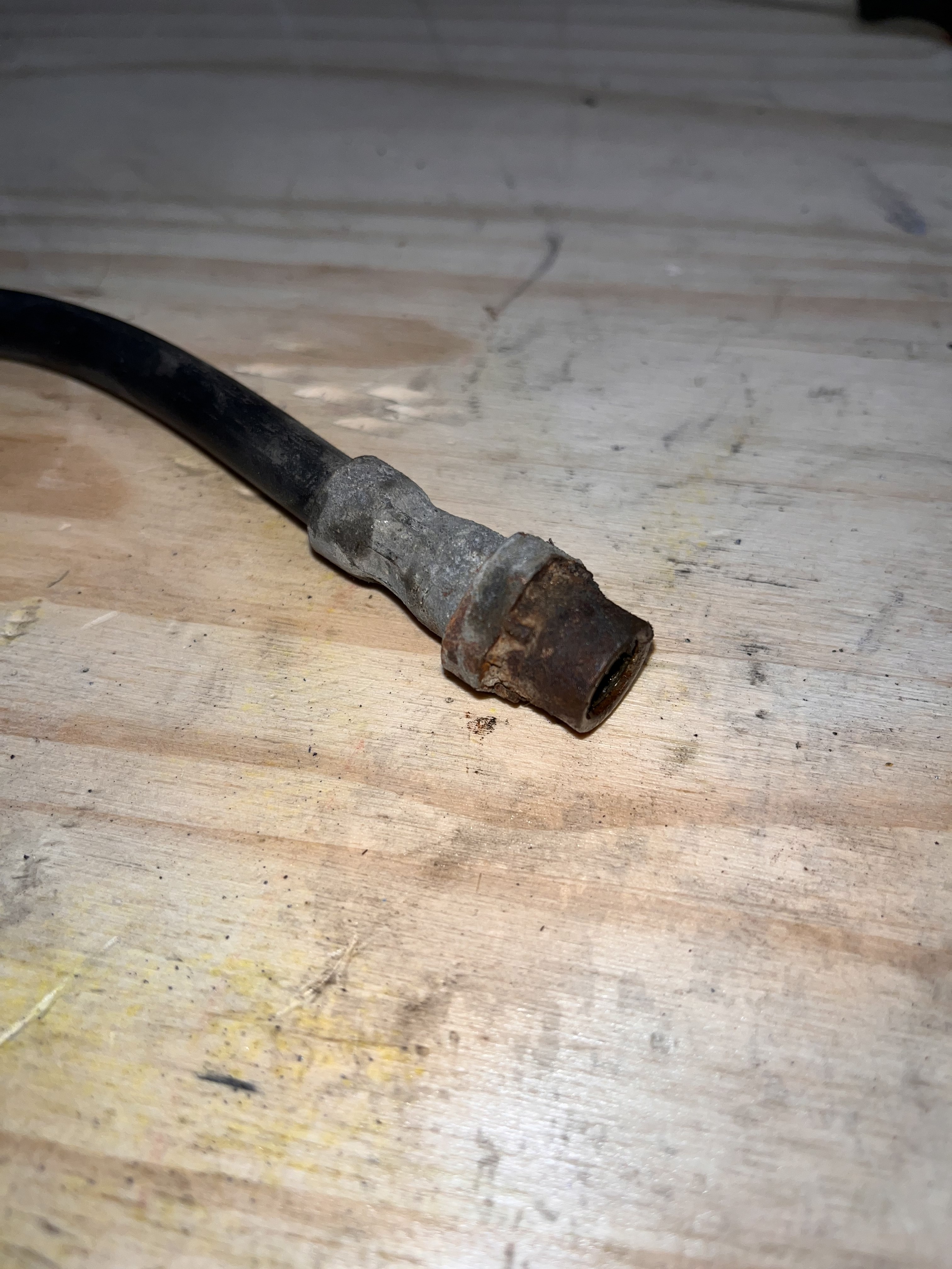

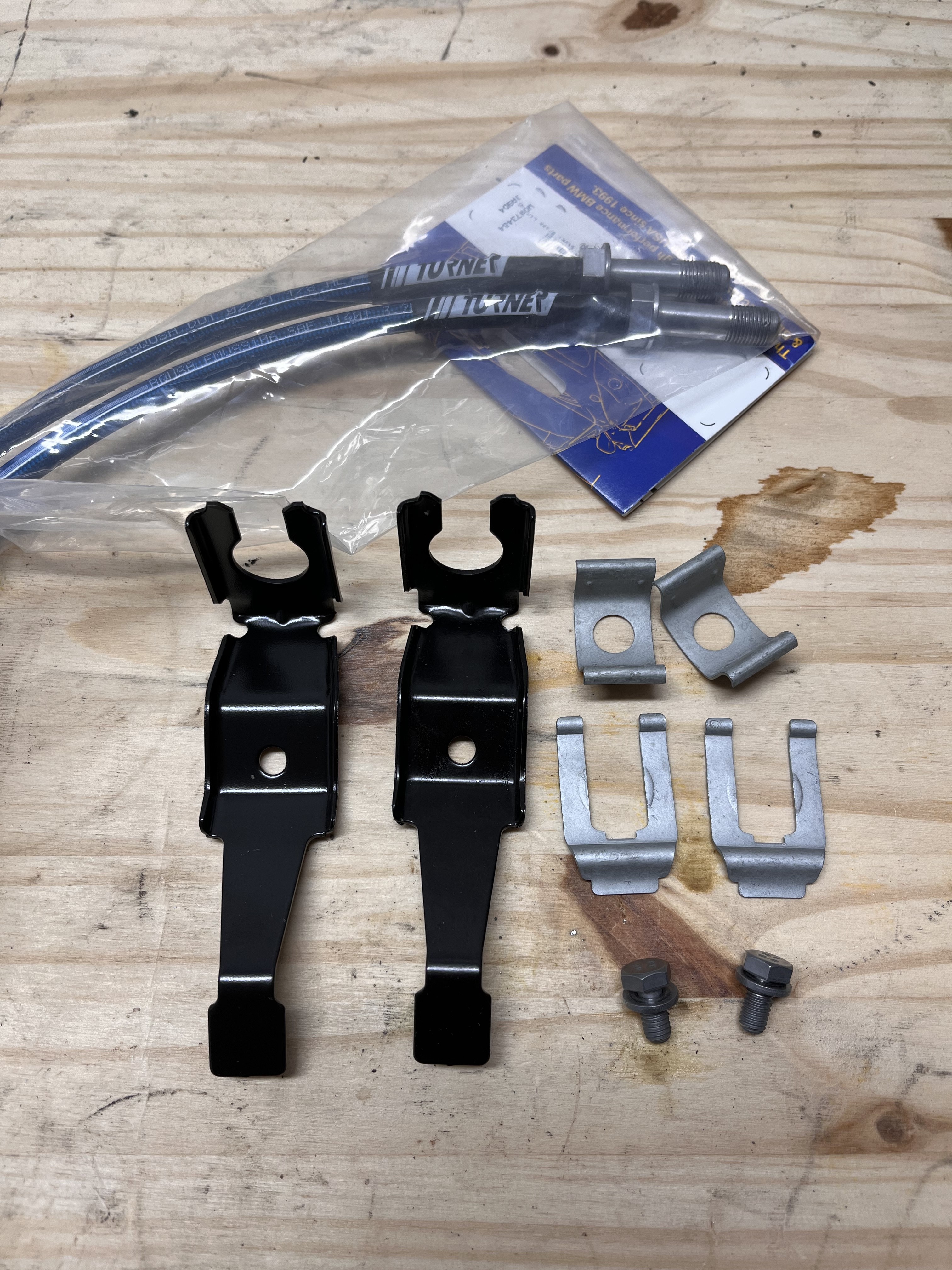

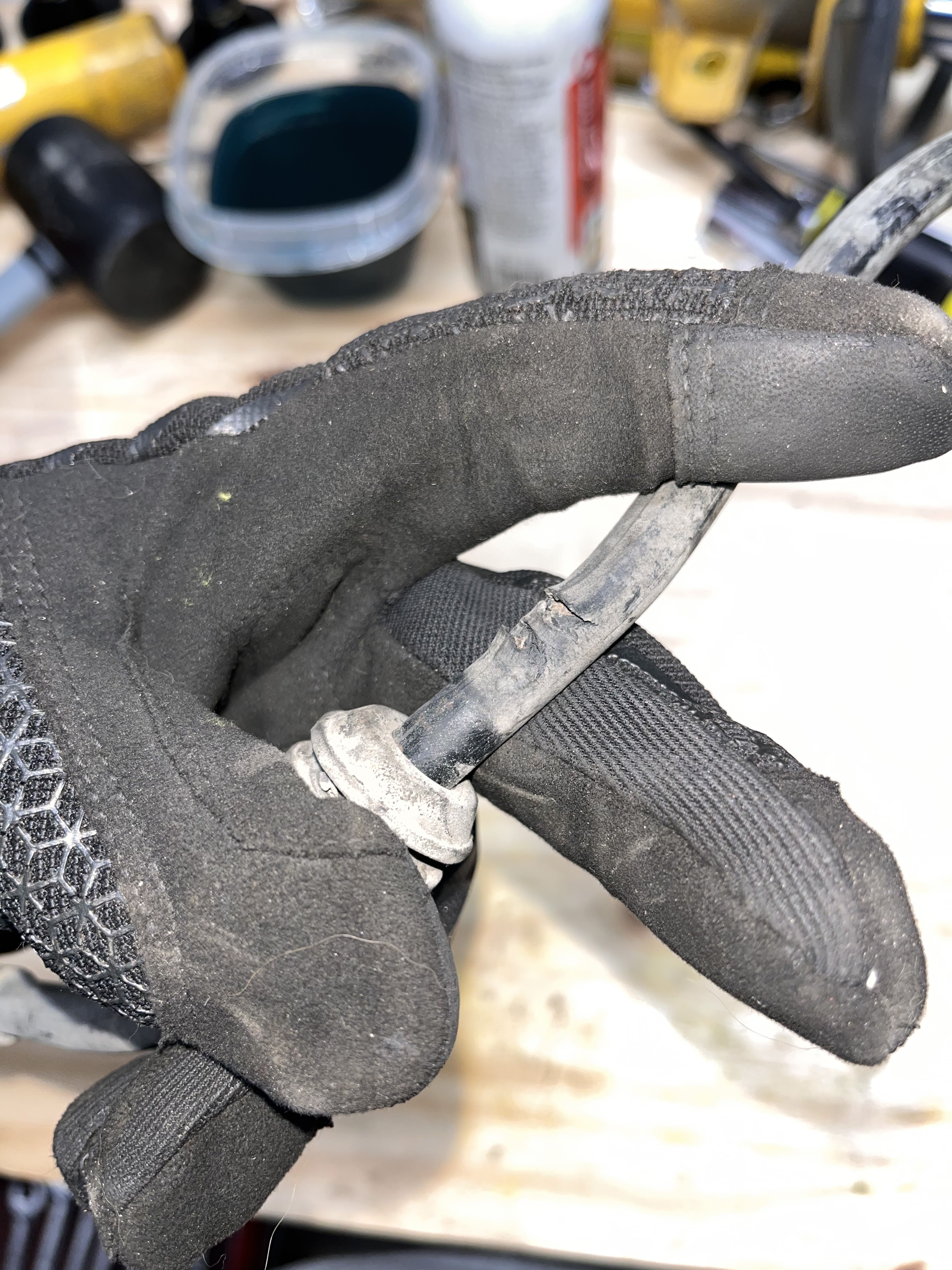

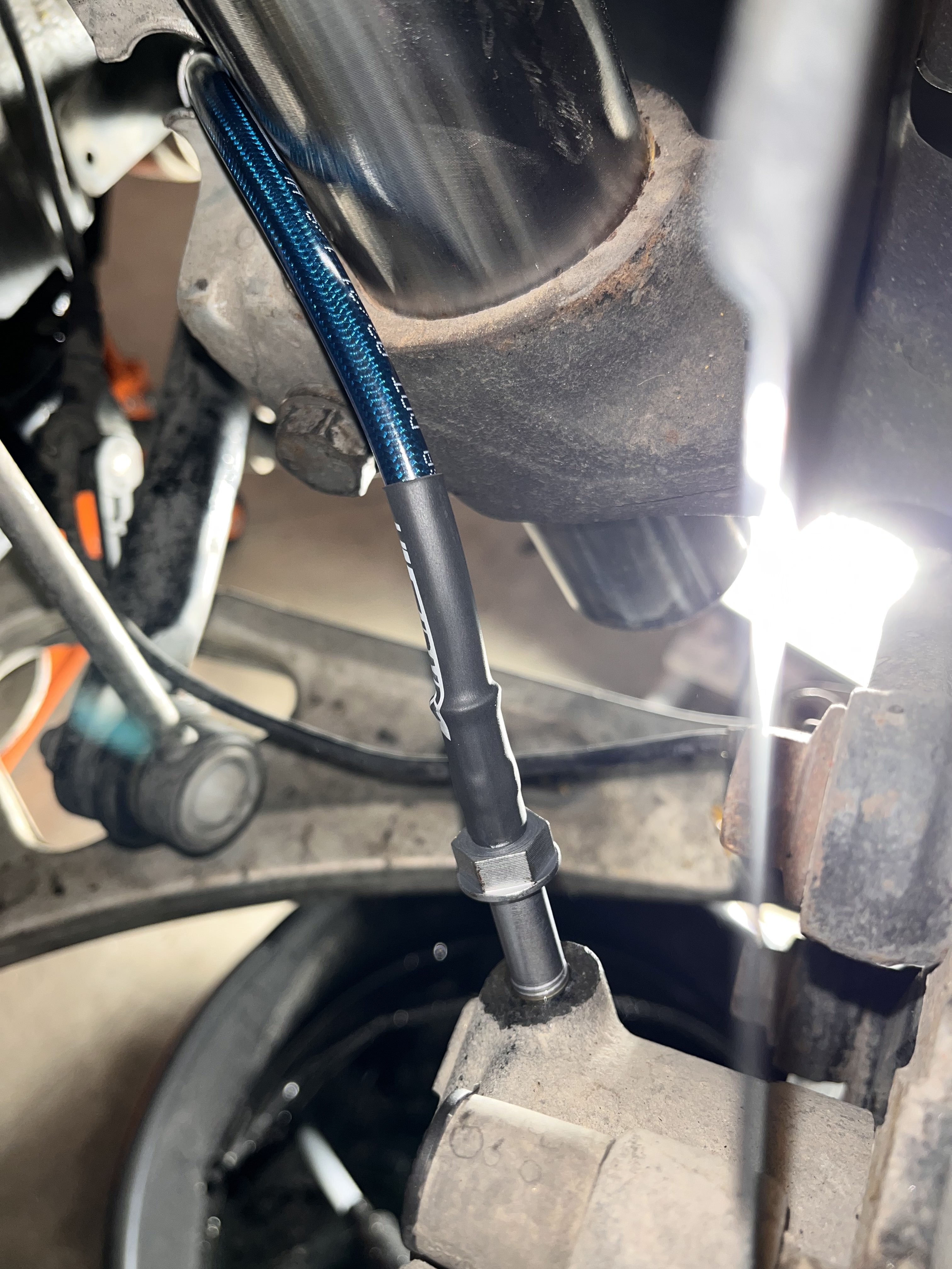

                          Saw Turner came out with a revised brake line kit that was stainless steel + zinc plated AND it was on sale over cyber Monday. Couldn't help myself. Finally got around to installing them tonight, and so glad I did because my factory line had a was pretty crusty and had a nasty gash in it that was probably pretty close to exploding! Bled the system with some fresh RBF600 after install
                          Oooo shiny

                            Very cool! Didn't know "newer" cars had the fire extinguisher option too. You could get them on E28's as well along with the spare mounted gas can too.
                              Definitely is! Seems like it's only a thing on newer cars in the EU, since I think there's certain countries that require them as part of inspection. Since the US doesn't have any requirements, they stopped offering them here and getting your hands on them is crazy hard. Although I know I could just get any generic gloria style canister, having an OEM one is cool!
                                #101
                                Hopefully you never have to use it
                                Or it’s one of those situations where it’s the only thing you save from a car fire because of how rare it is

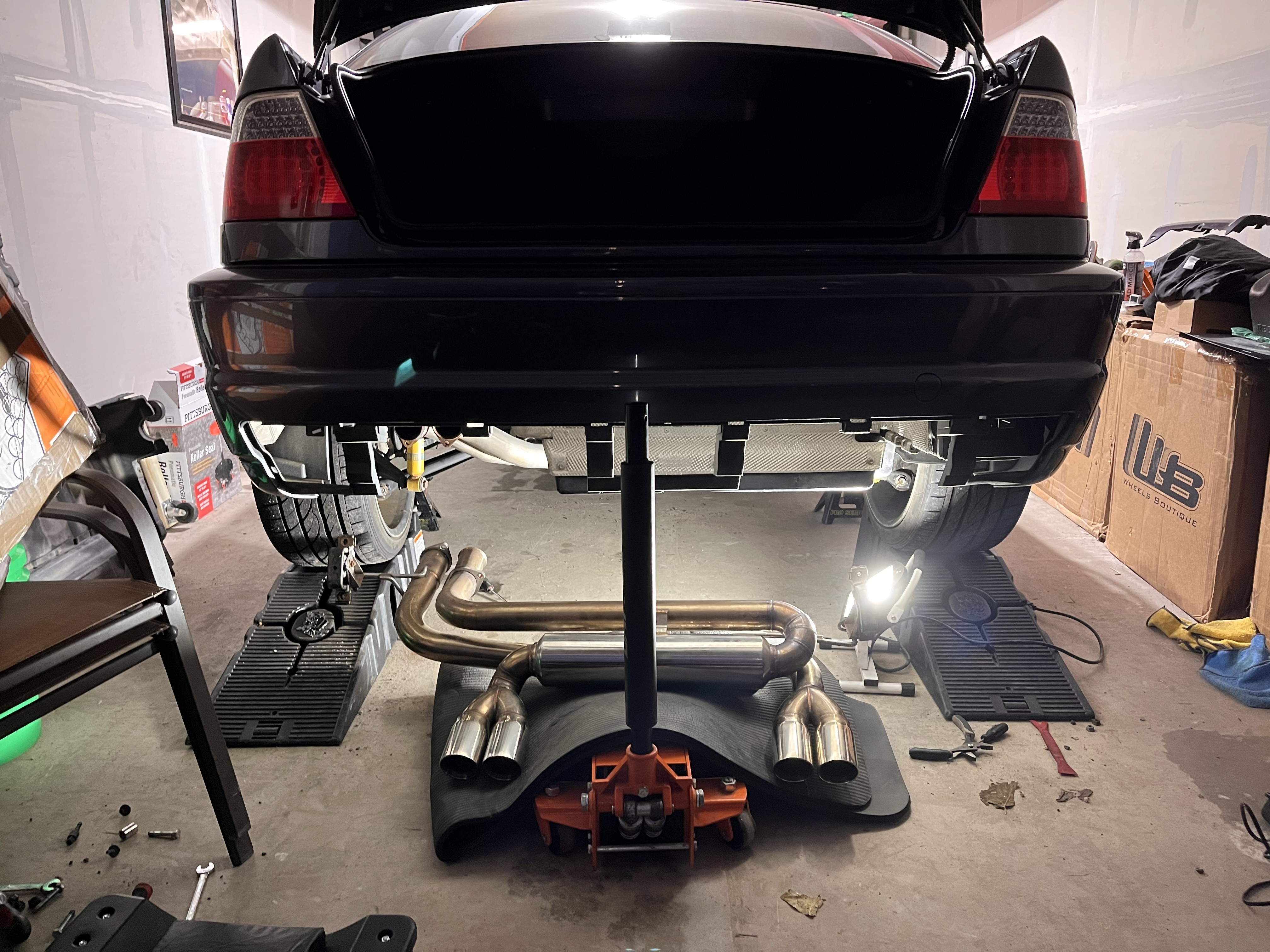

                                    #103

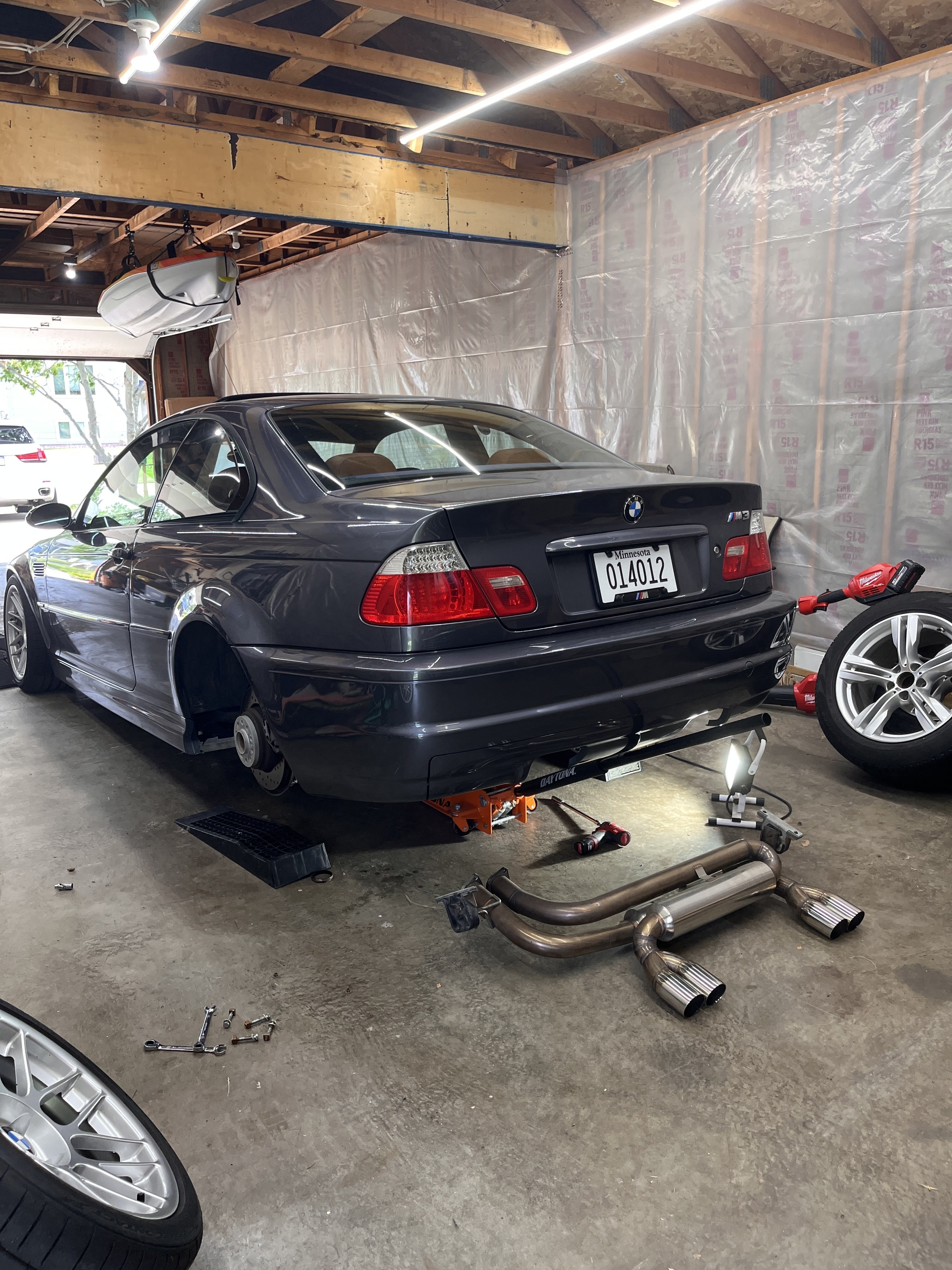

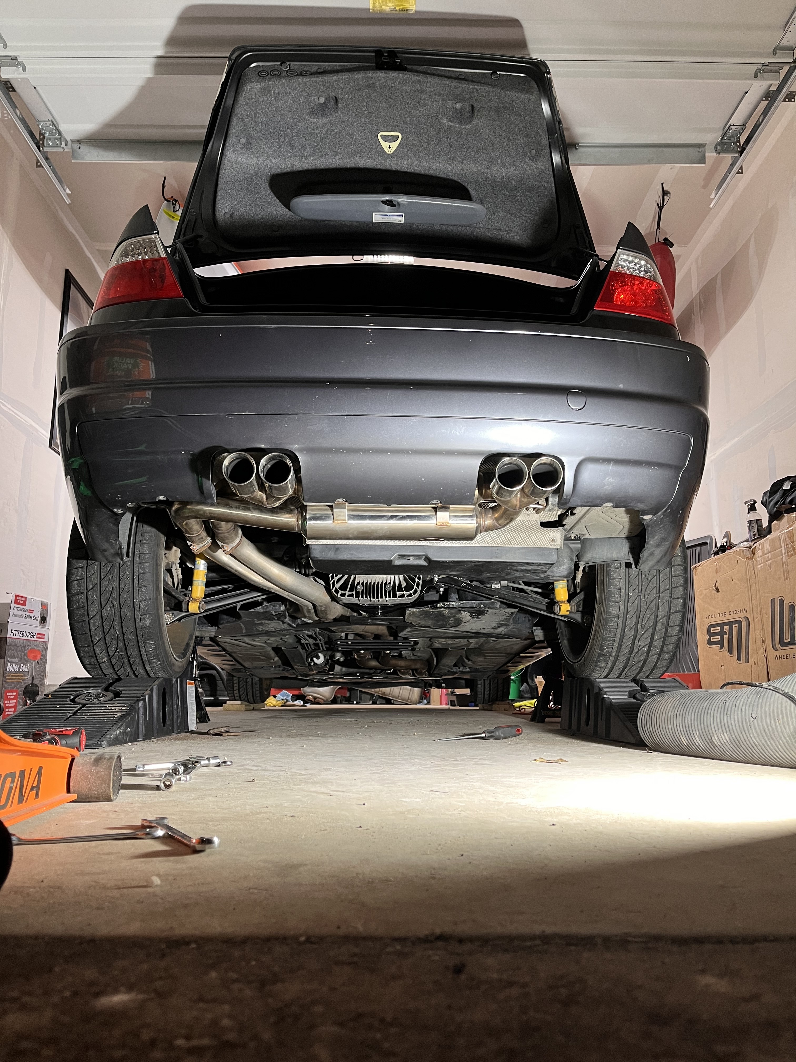

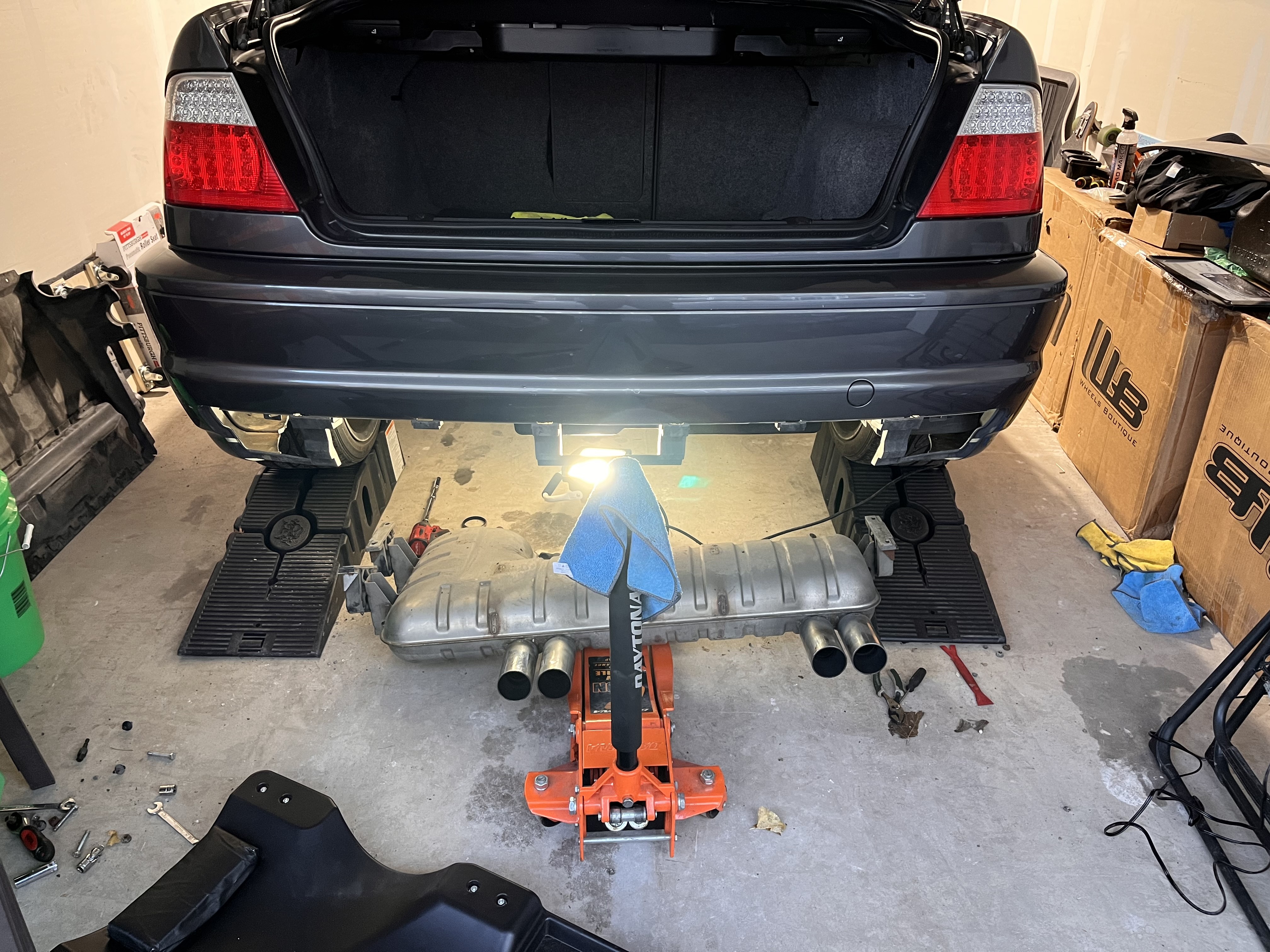

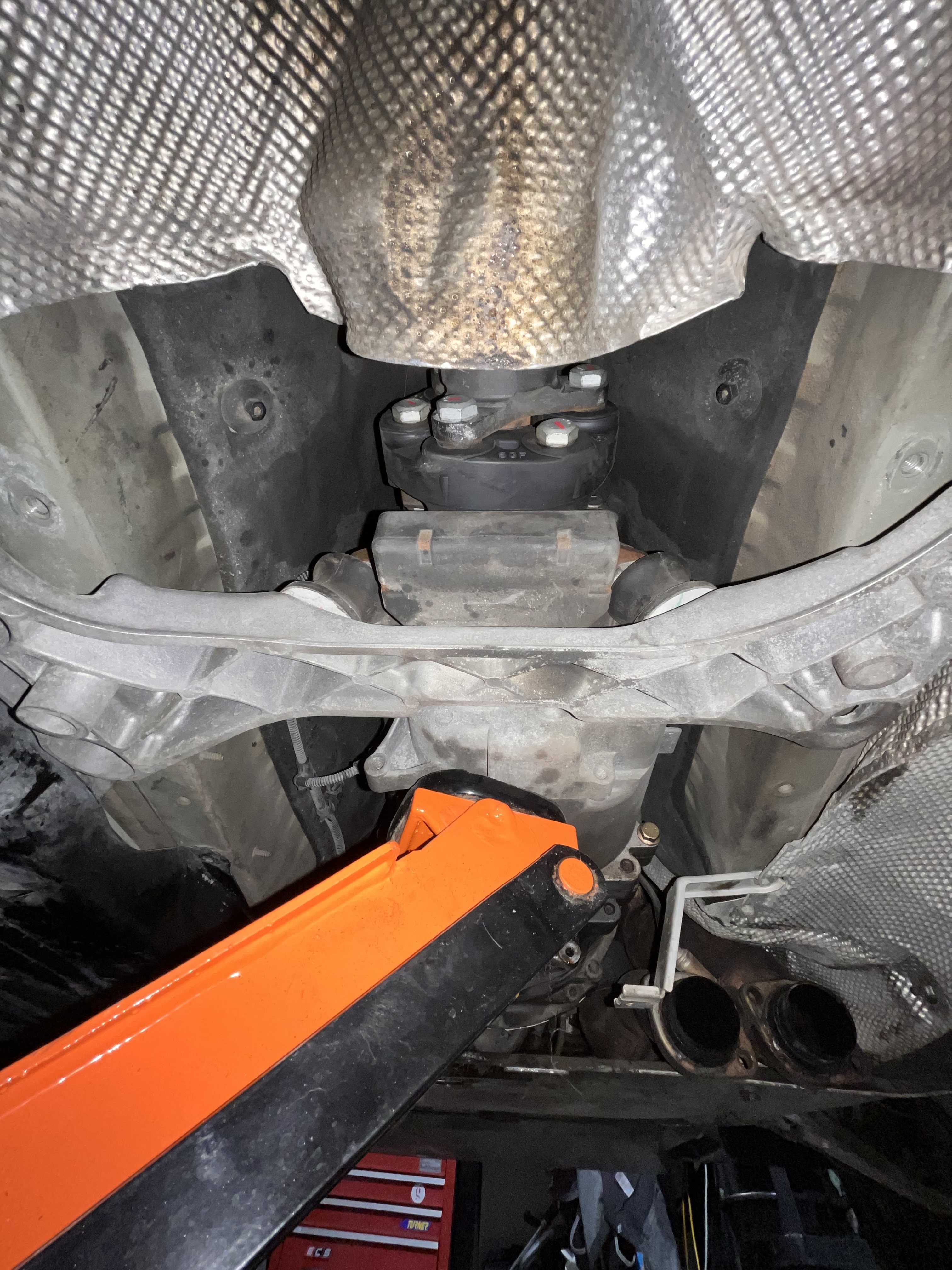

                                    Scooped up a top speed muffler for the M3 for a great deal. I know it’s not in the upper echelon of mufflers, but it’s all part of a combo I want to try out. Installation was super easy, just have to pop off the diffuser to access all the hangers. Stock muffler is a UNIT! Has to weigh close to 60lbs. Top speed one is about 20lbs, so should be about 40lbs off the rear end. Pretty happy with how it lined up too, tips stick out an additional 2” or so, protrude the same on both sides and sit at the same height.

                                      #104
                                      Here’s a quick startup clip of before/after the muffler. Both clips have the fabspeed headers installed, which honestly didn’t make a big difference in tone or volume in my opinion. Definitely feels loud, but didn’t test out revving yet since it’s in the garage. Will have to get some take off clips in the spring once the X pipe is added!
