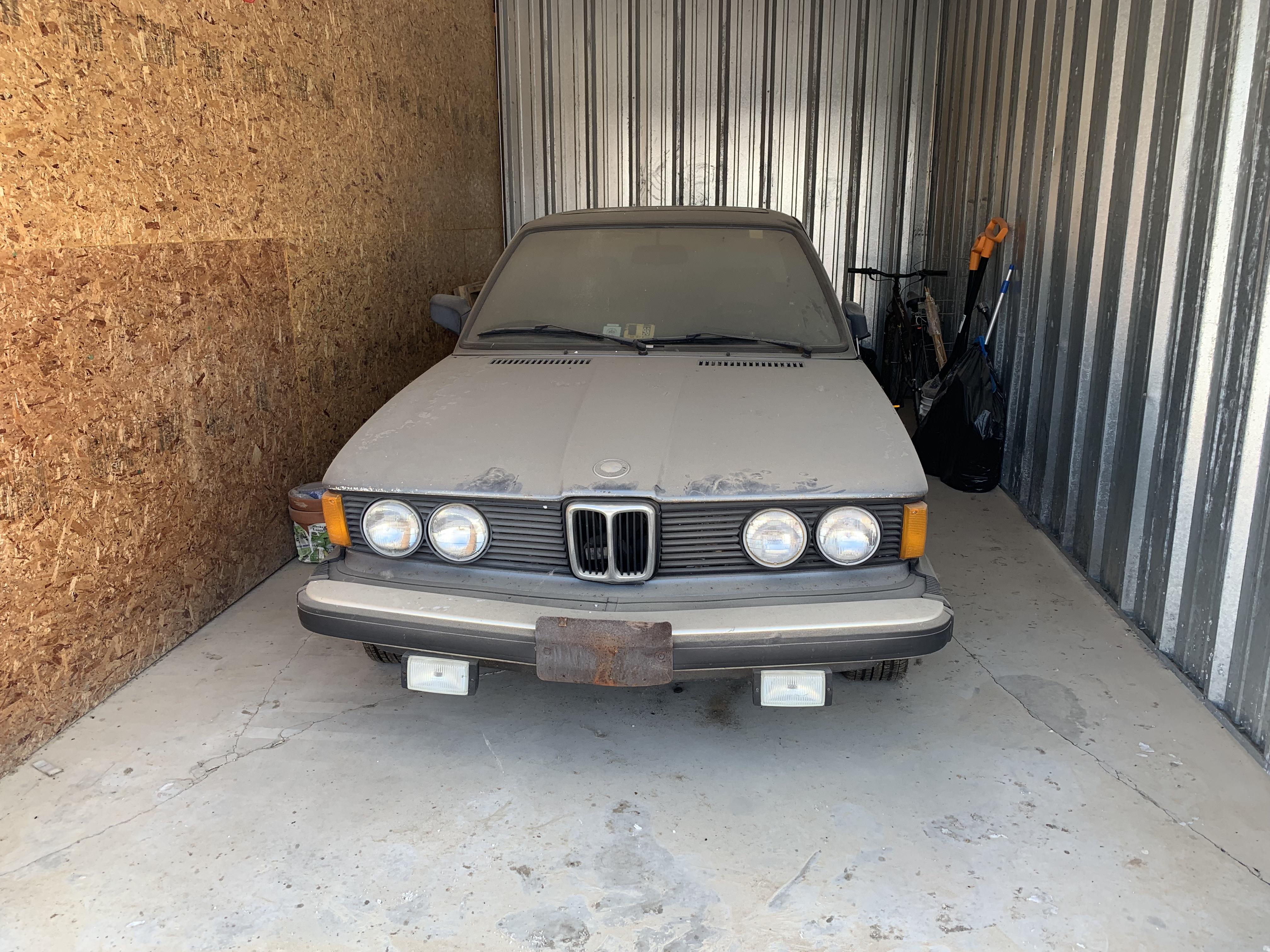

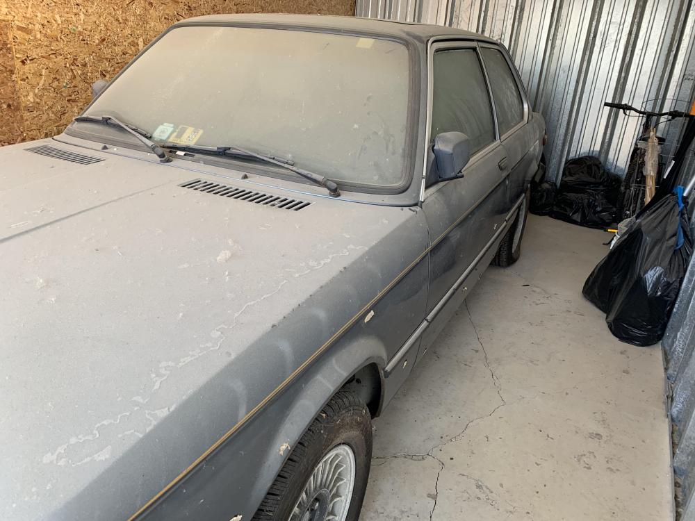

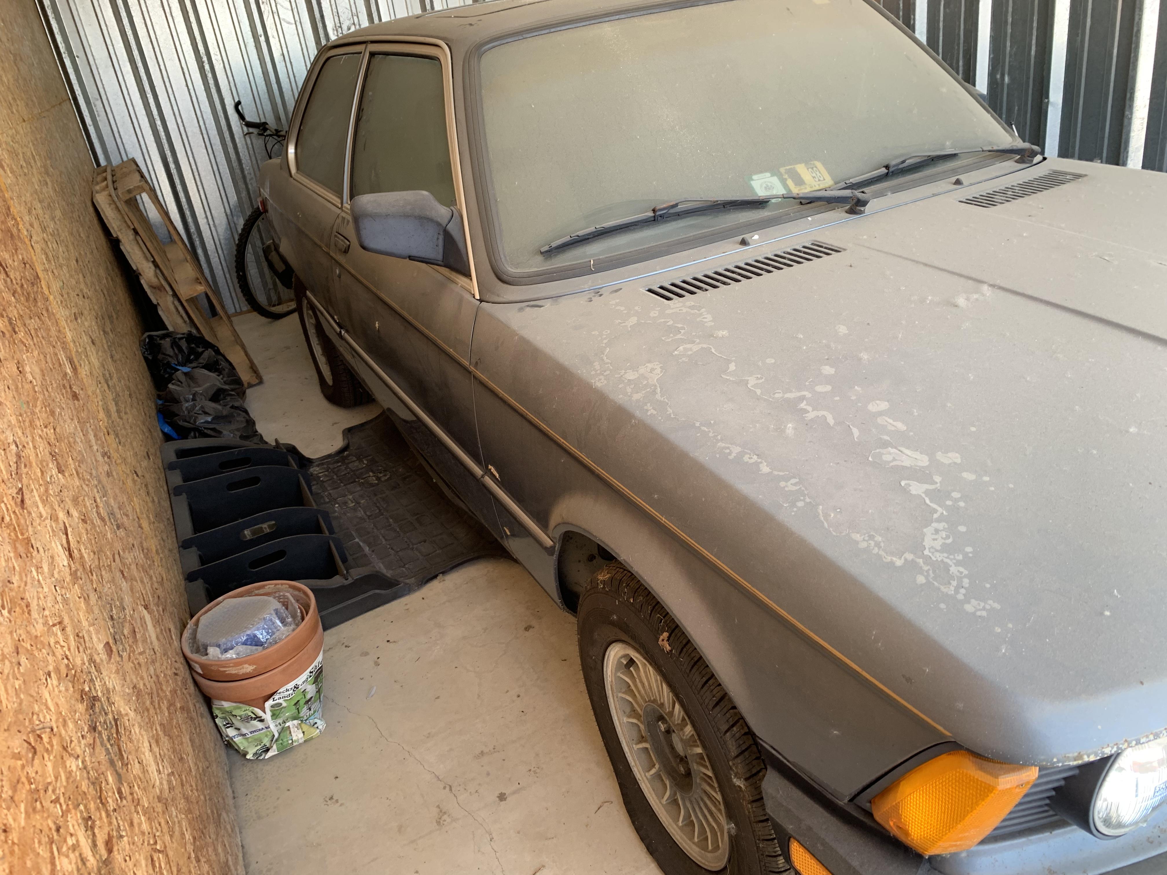

    The story starts when my wife’s boss lets her know about a storage unit auction that has an old BMW in it, and sends her a link to the website.
    So I check it out and find a 1982 320i; looks to be fairly straight, but hard to tell since the video and pictures were taken with a  playschool “my first camera”.

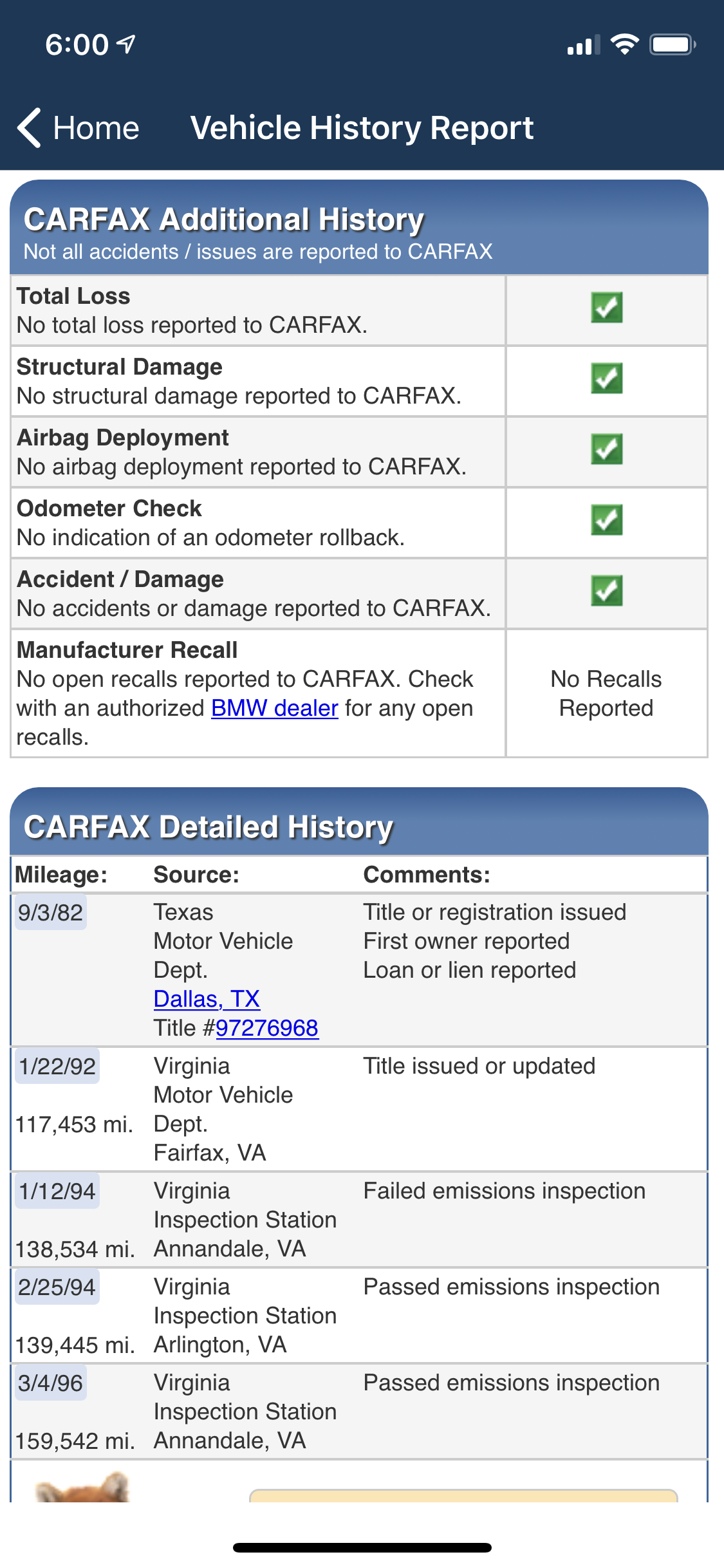

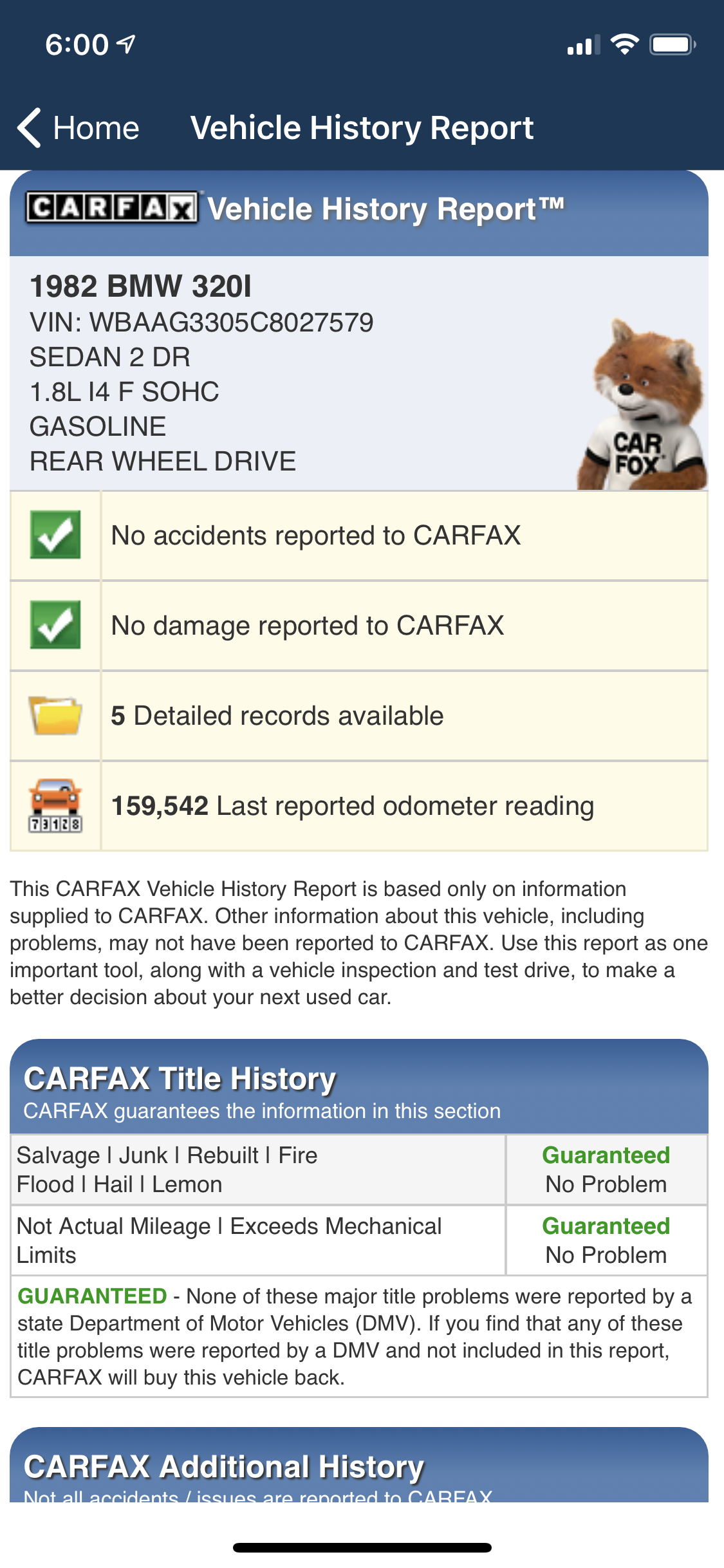

    I ran a carfax, and the last entry was in Virginia in 1996 for an emissions test, with no major issues.  As it sits there is no title, but it isn’t to difficult to get one as the car is considered abandoned.
    The current bid was at $61, so I figured I would watch it and see where it goes.
    As of 9:00pm last night, the auction ended, and I am now the owner of the storage unit contents  for the sum of $252.
    I guess we’ll see where this goes!

        Texas and Virginia car!! That’s got a lot going for it especially for $250. Excited to see how this story continues.

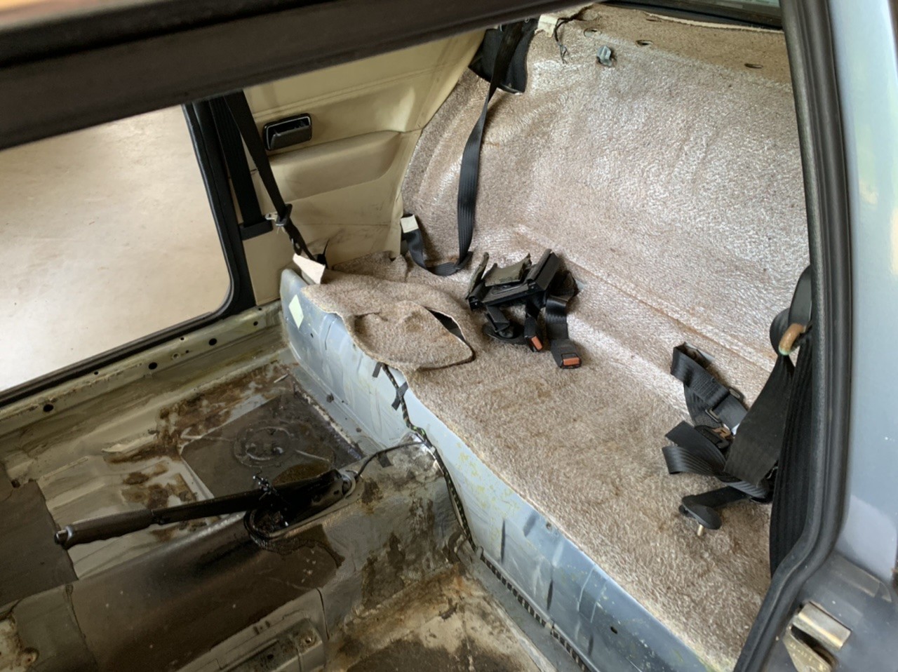

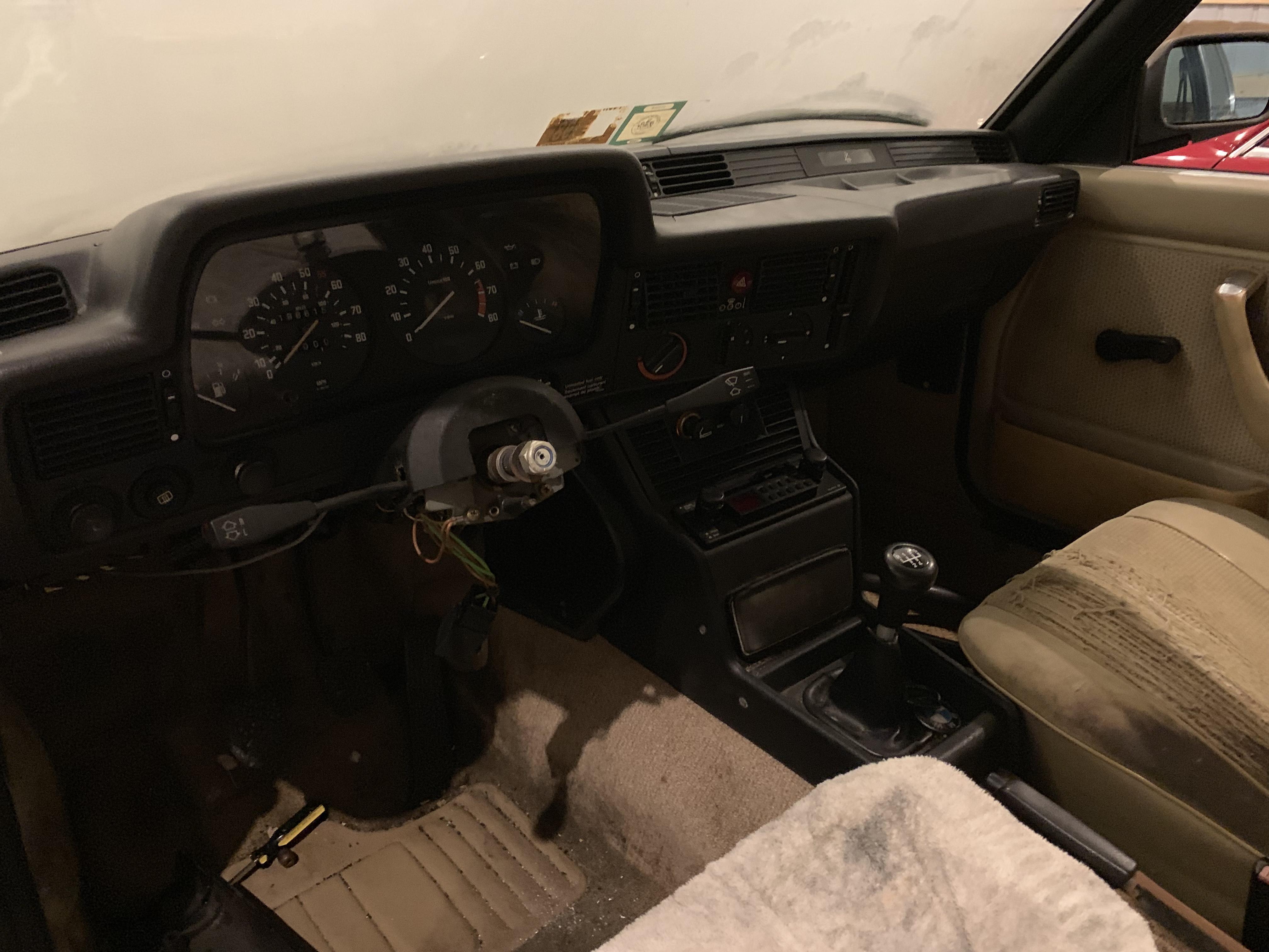

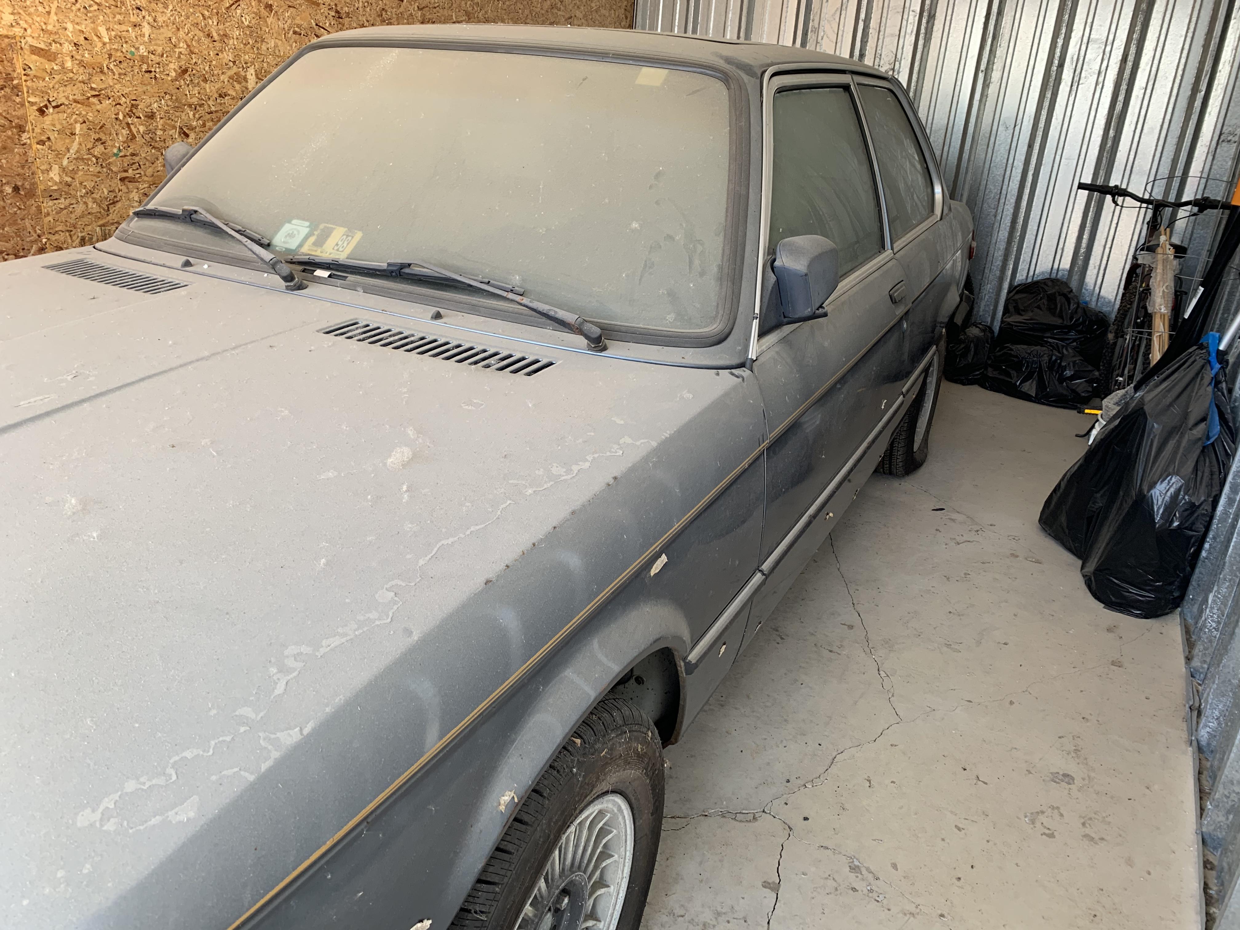

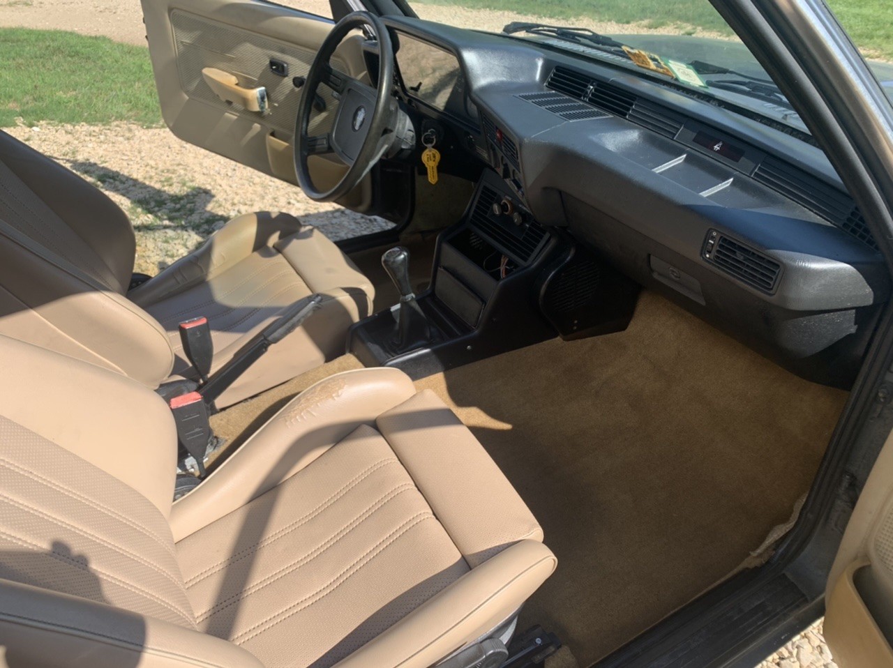

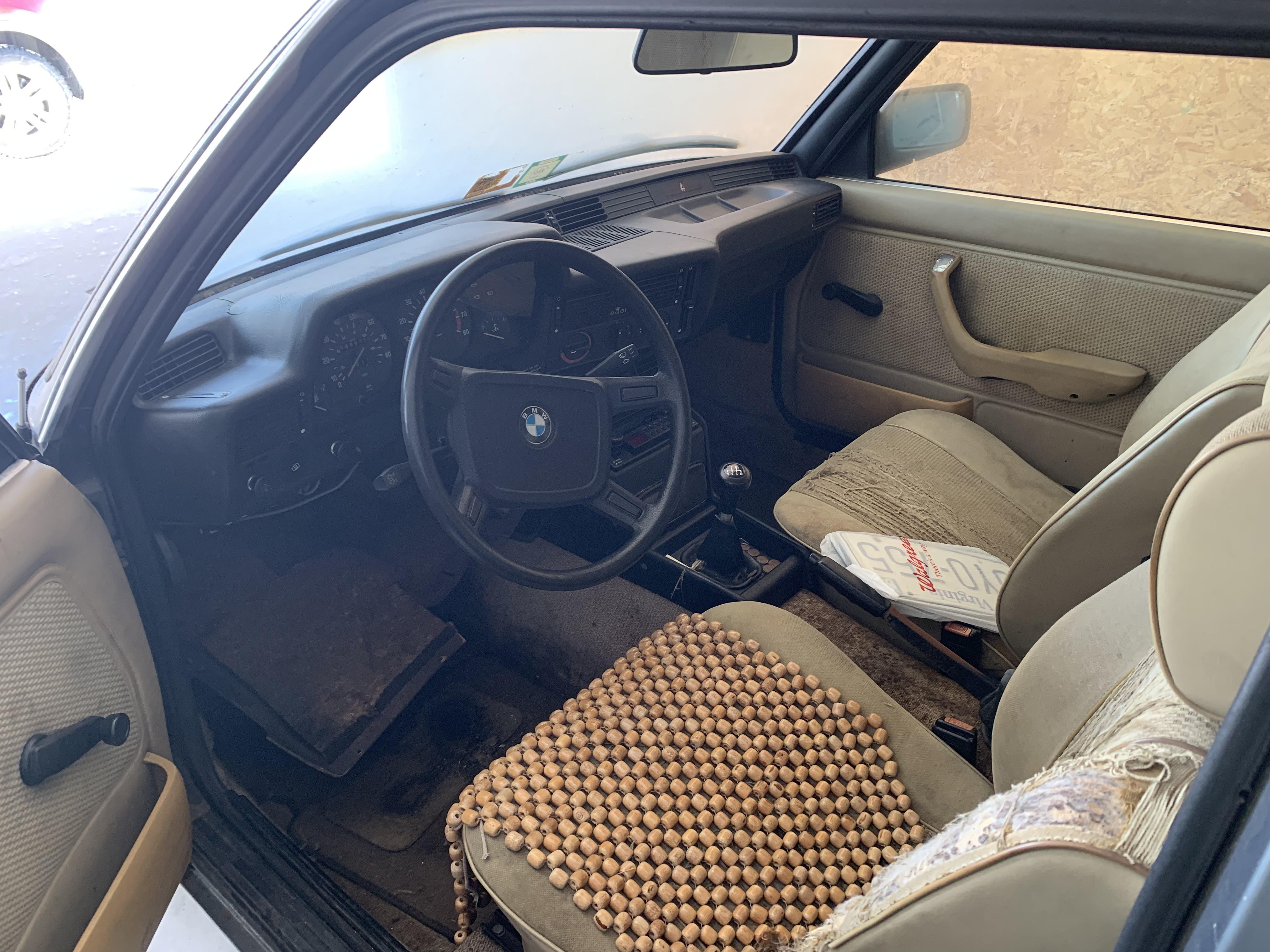

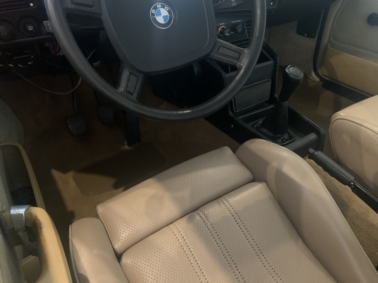

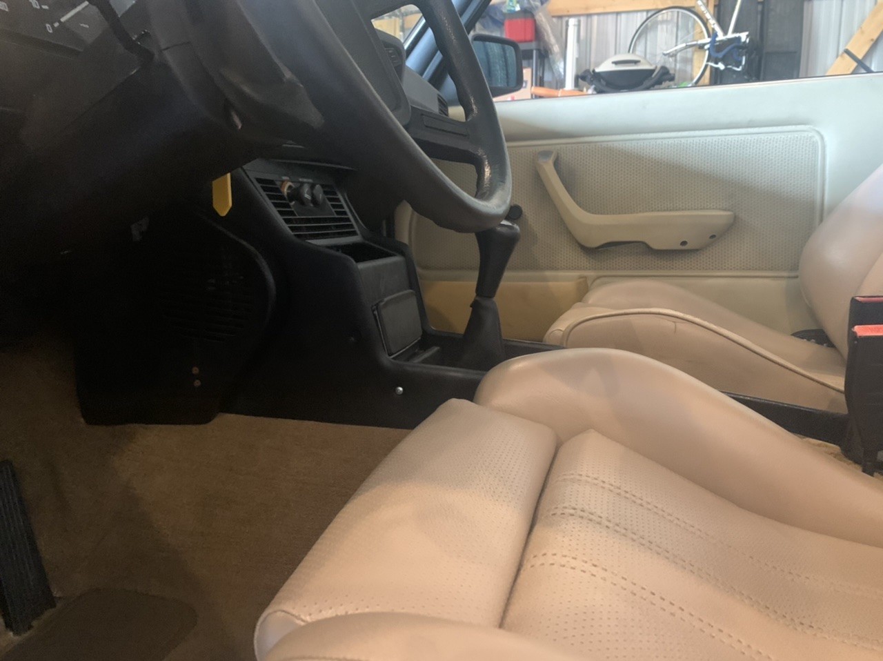

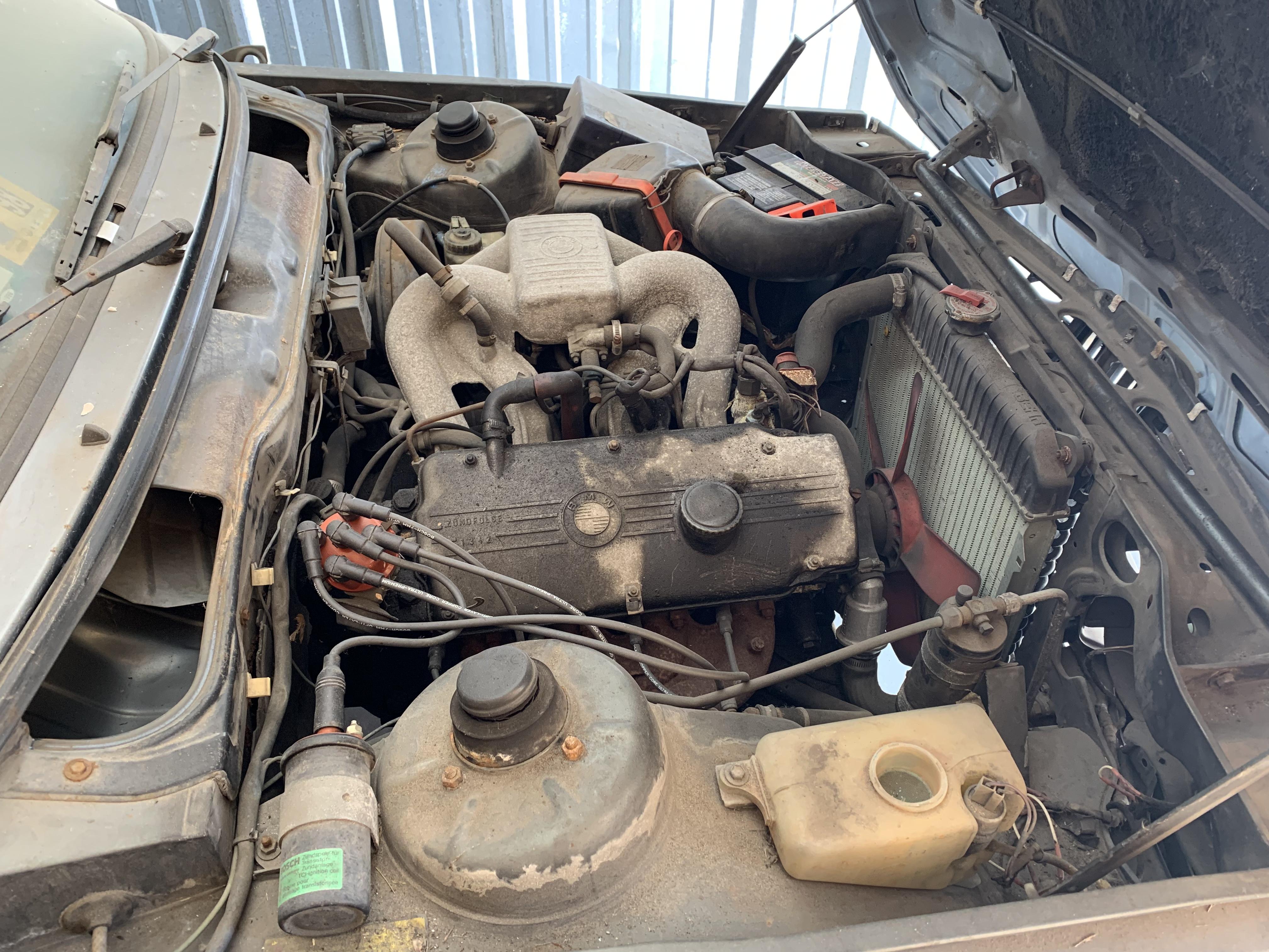

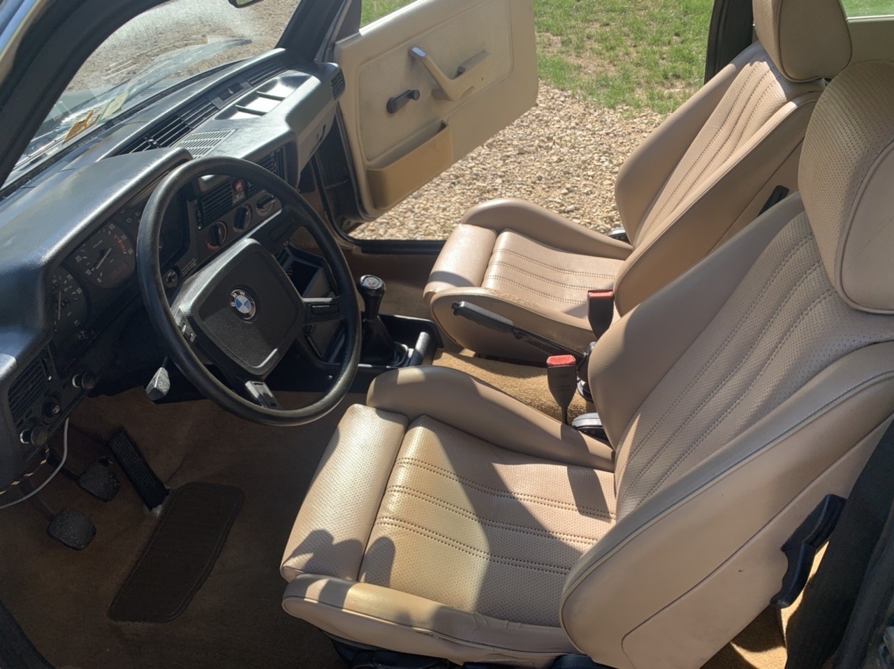

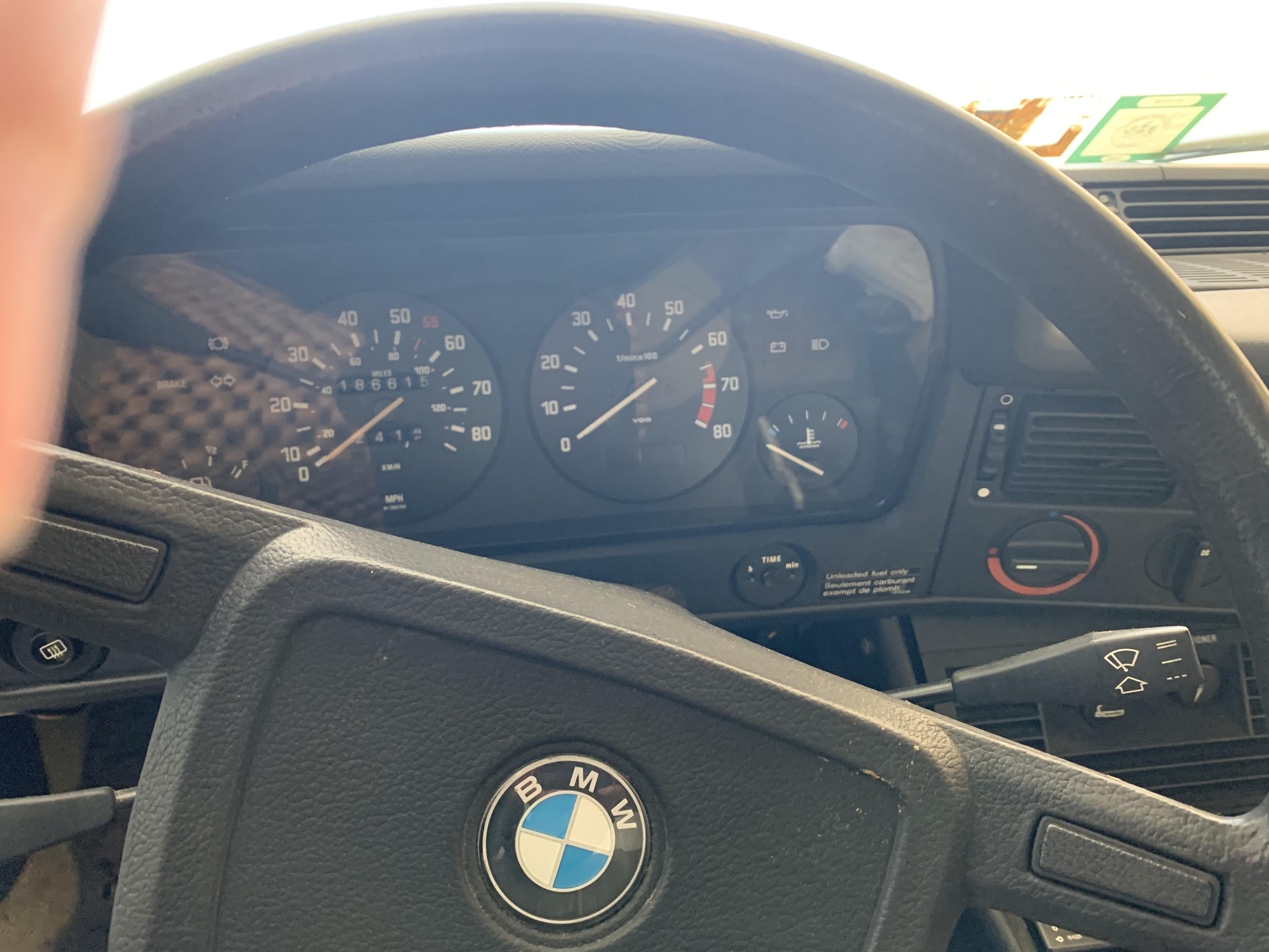

                  So I just got done peeking st the car, and so far, so good!
                  Interior is super crusty, no keys, paint is shot, brakes are froze... all thing that probably should be expected. Hopefully not too hard to remedy.
                  On the plus side; everything seems complete, no rust/rot that I saw, and the rental storage lessee is the owner listed on the registration from 1993 that was in the glovebox. The marks on the bodywork are little pieces of tape. ??
                  According to the property manager, the car  was running was parked decades ago.

                    these storage companies must have decided that using a potato for a camera makes the purchase more of a gamble, therefore harder to resist.
                      Re bits of tape: May have had a cheap cover, pieces of paper or cardboard taped to the body at some time so the car wouldn't get scratched by other things stored next to it in the unit?

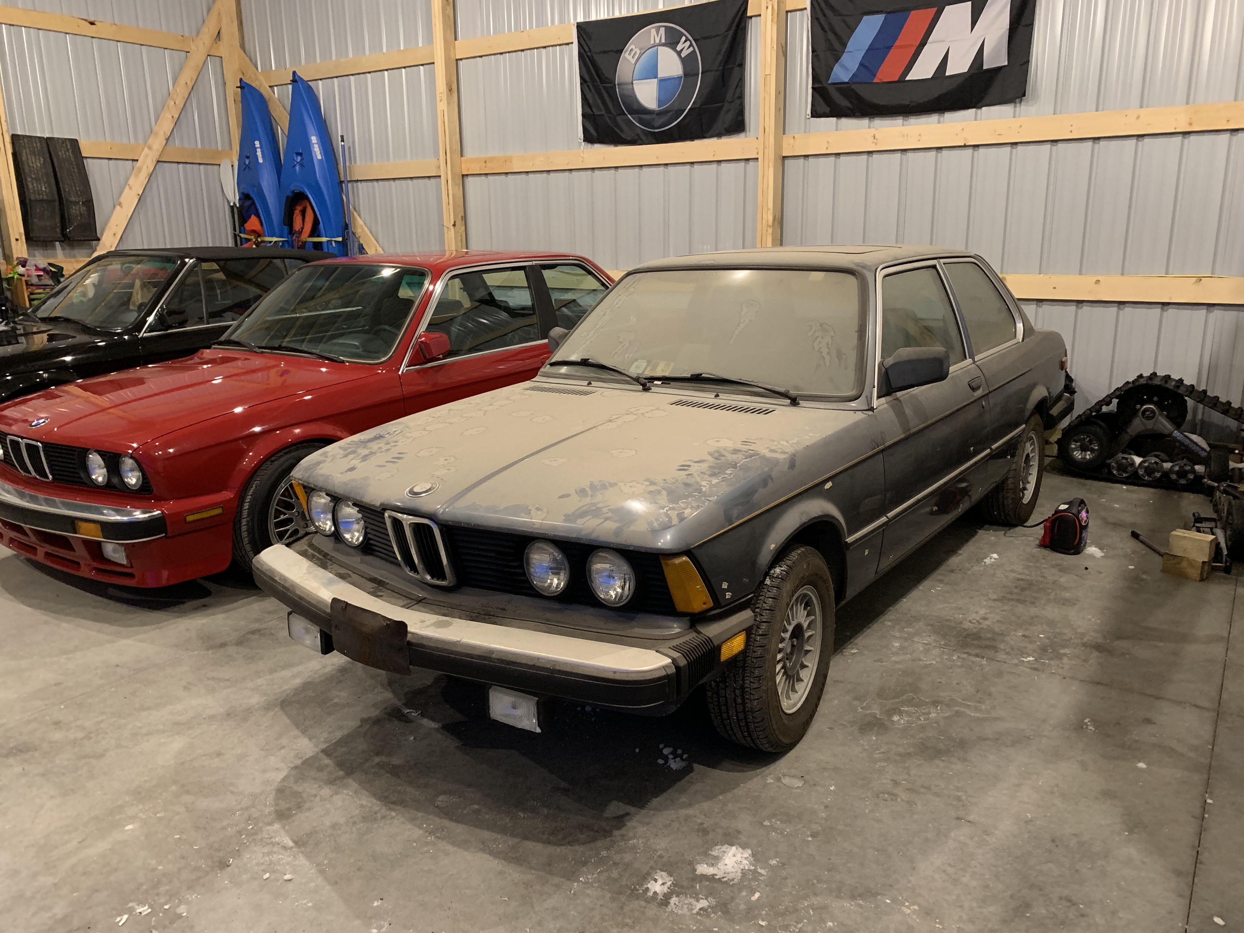

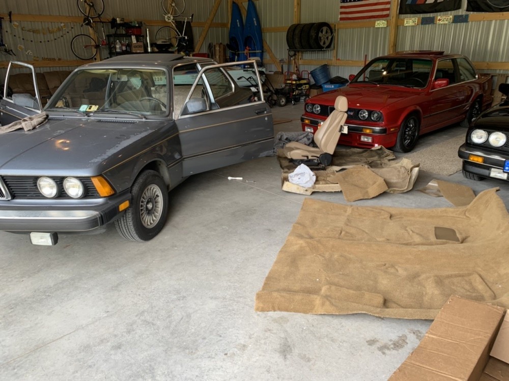

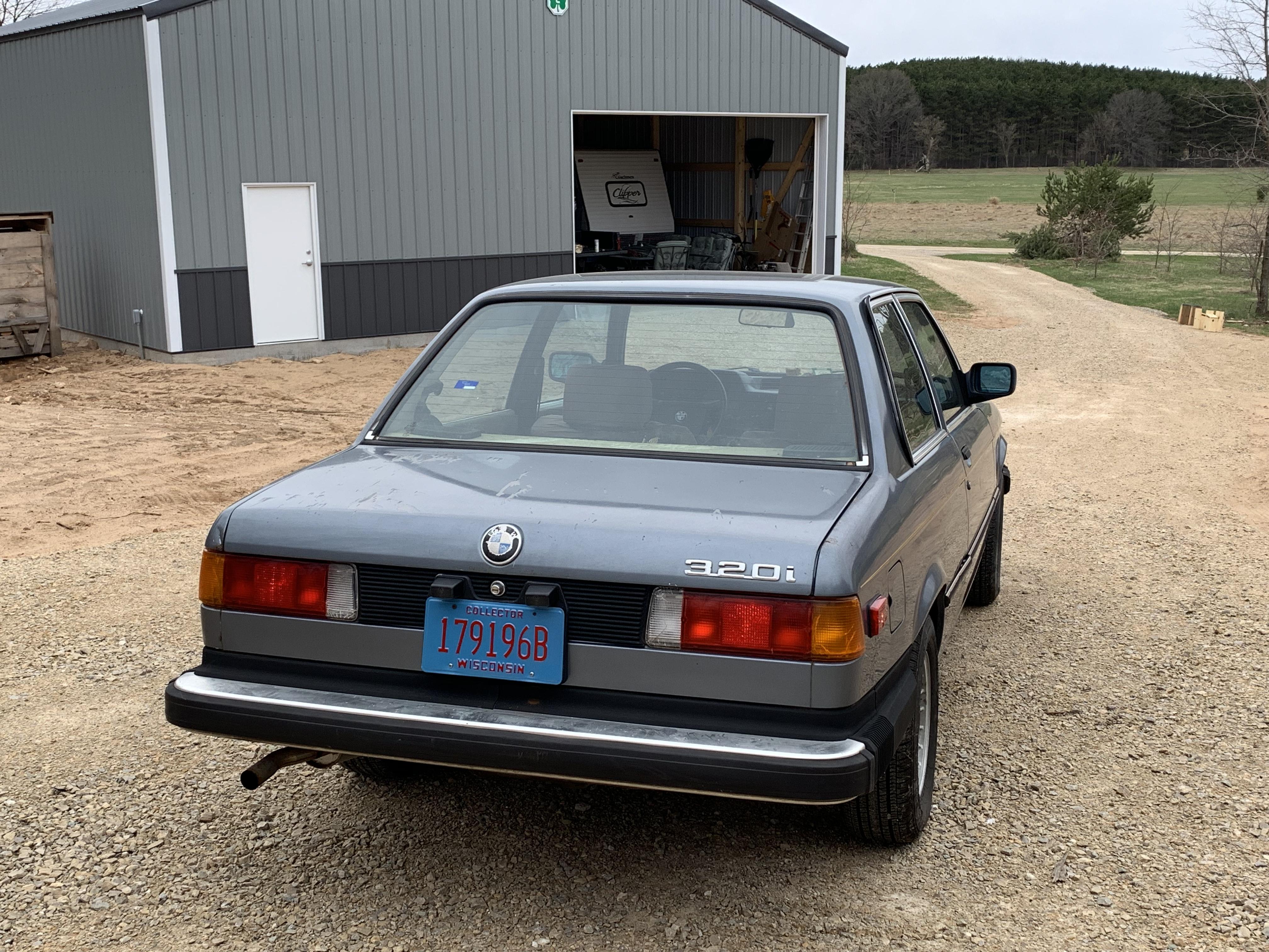

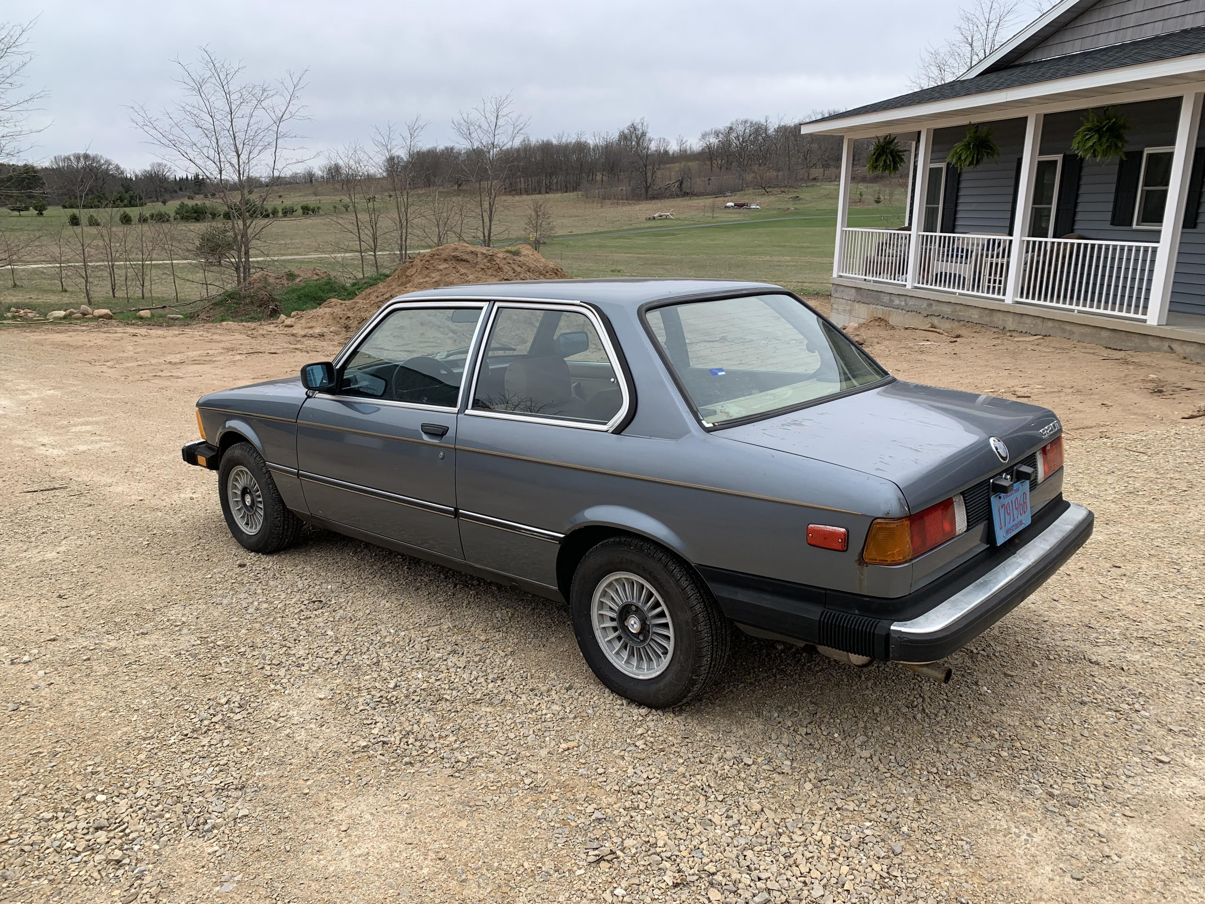

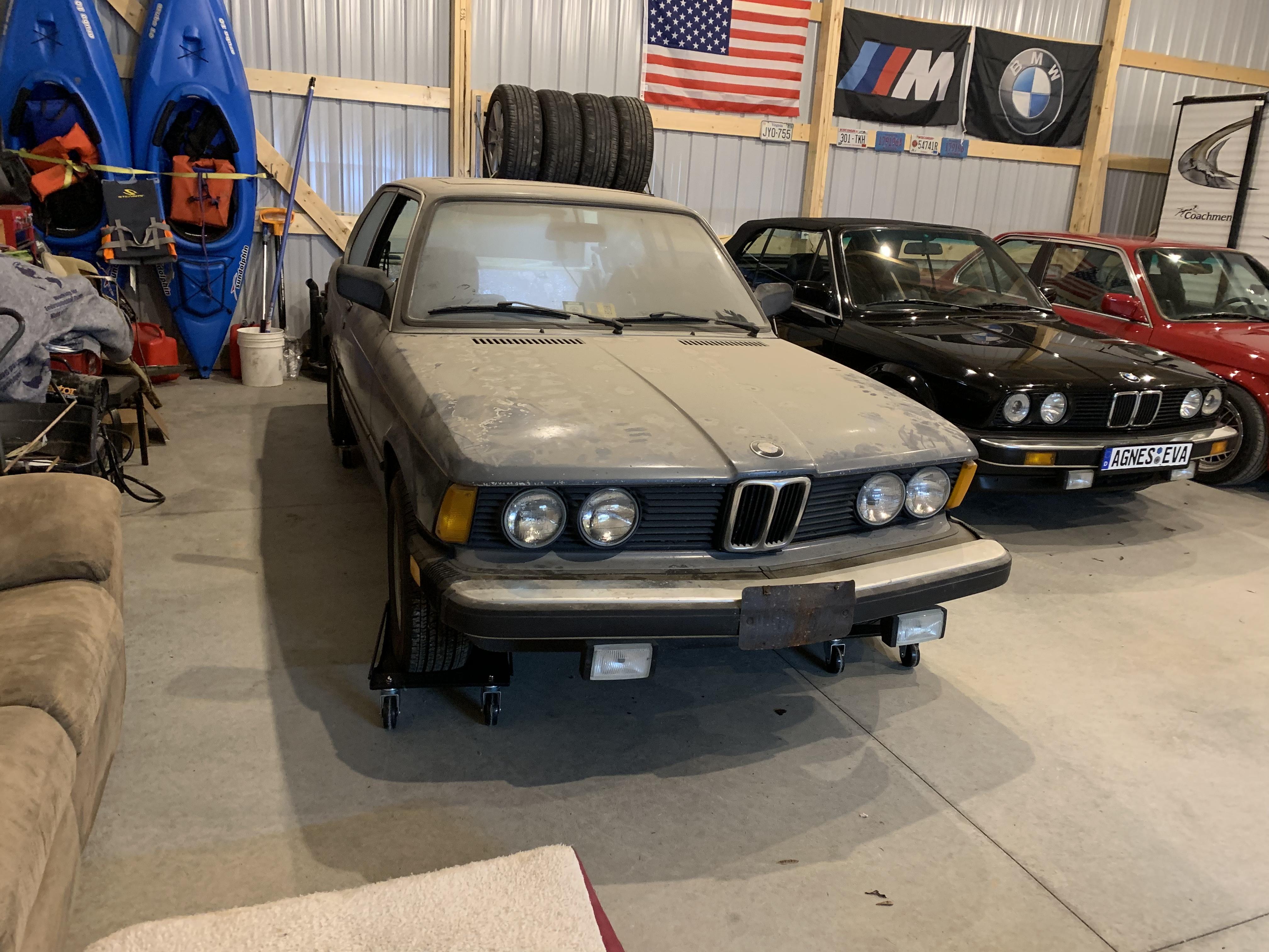

                        It made it home... 😄
                          Nice score.
                          Curious what your plans are... Make sure you take care of the fuel system before you start messing with trying to get it started. Probably obvious given how long it's been sitting, but I thought it would be worth emphasizing since the CIS system on these cars is a fairly complex and delicate mechanical/pneumatic system that doesn't take well to rust or old varnishy fuel.

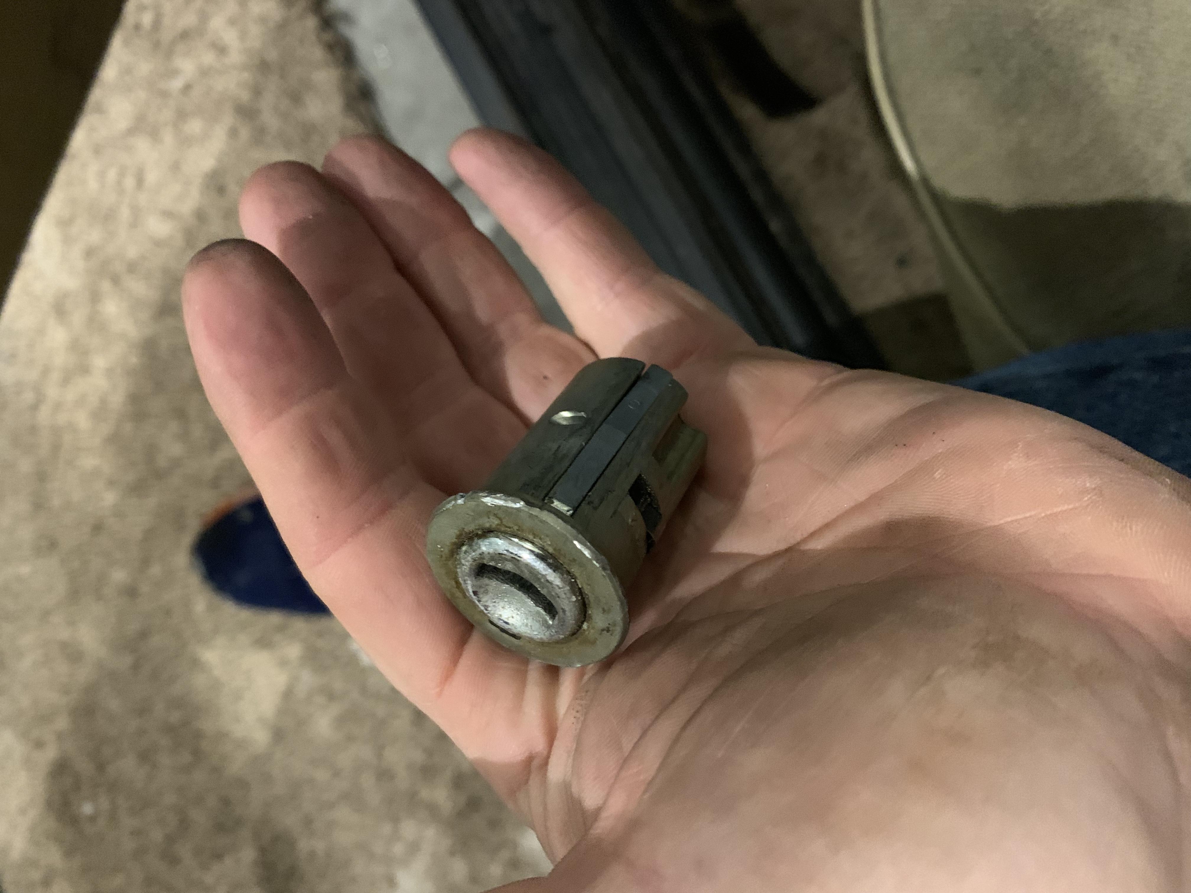

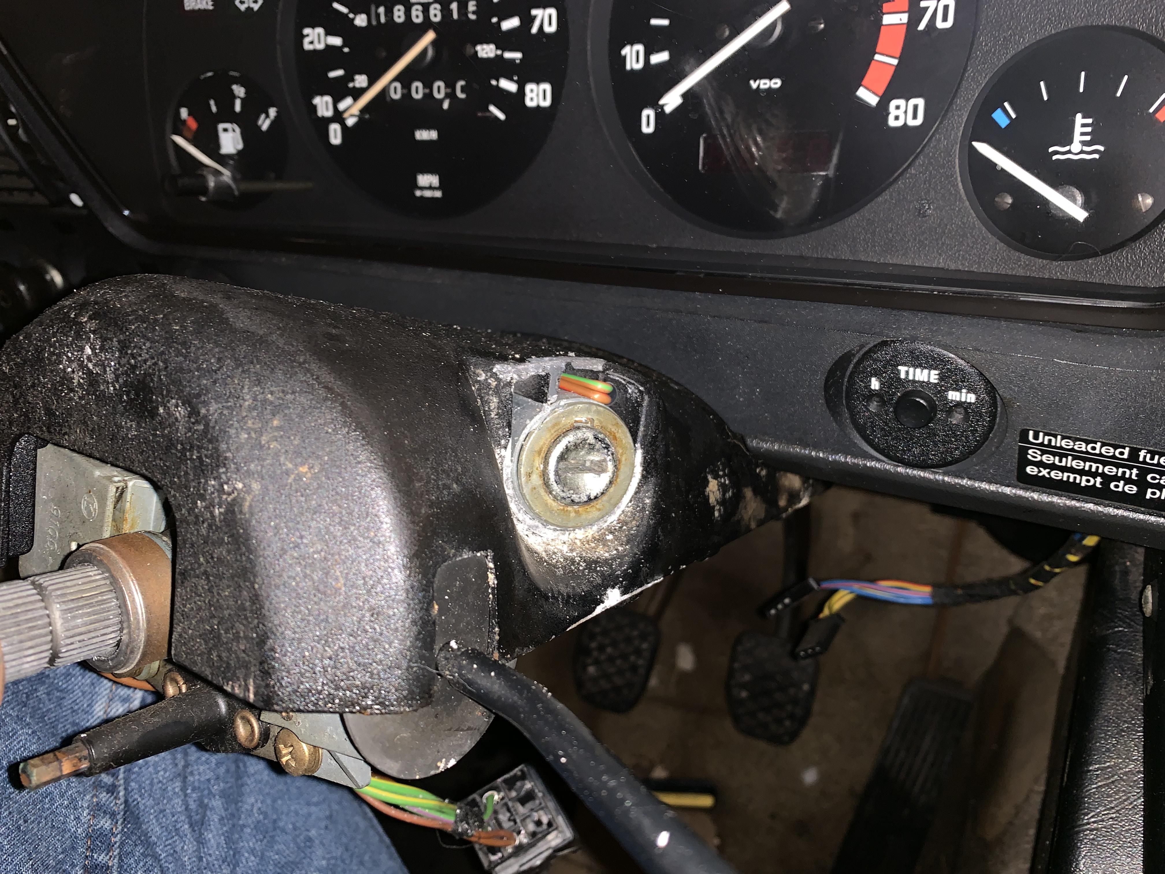

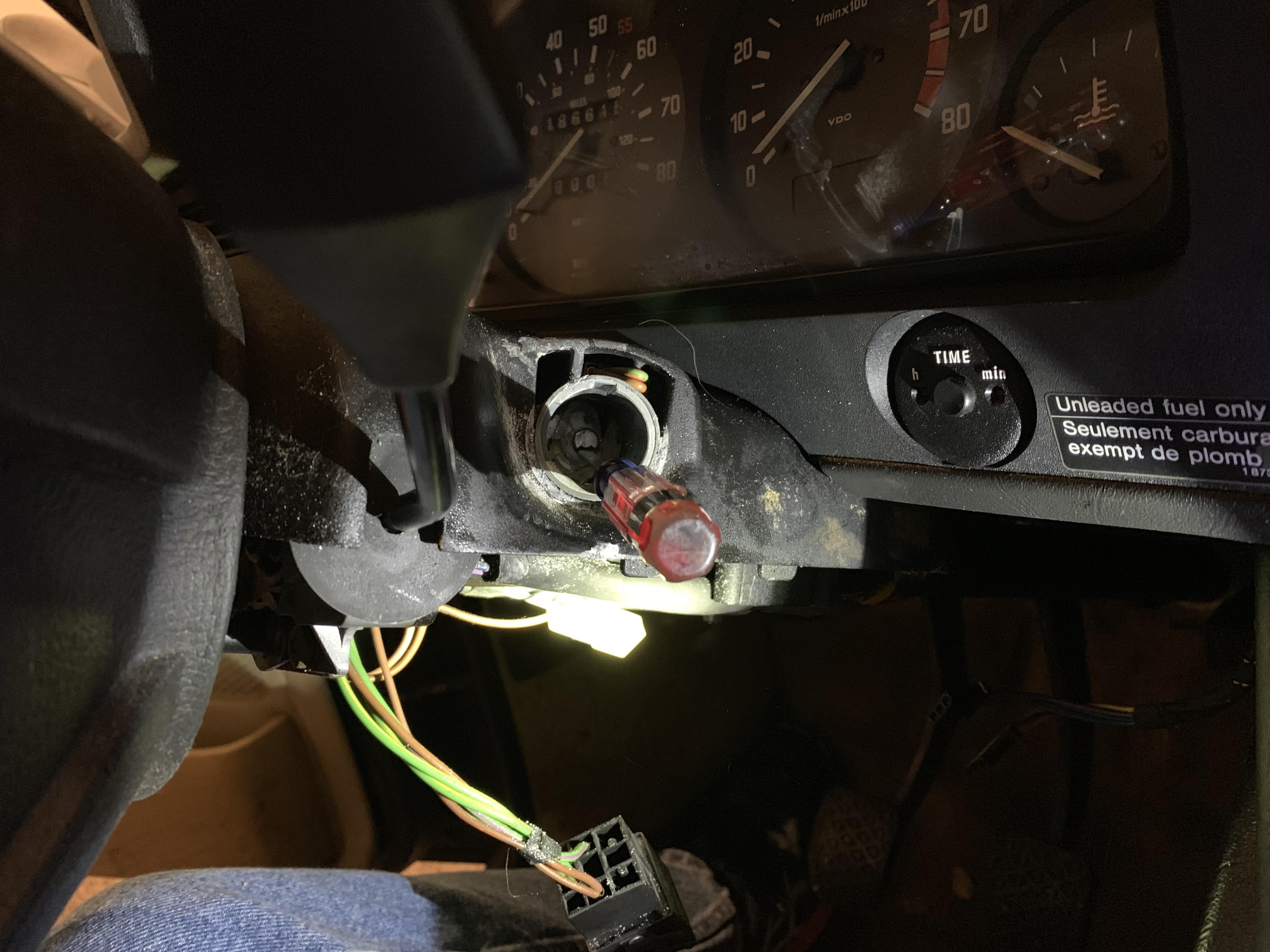

                              A little progress update as a result of not having keys...
                              Did I mention how fun it is to navigate a non-running car into a garage with the steering locked and the front wheels at a slight angle?  A wheeled floor jack under the rear end ultimately saved the day!
                              Got the ignition lock cylinder removed with a little persuading with the drill. Now to see if I can have new keys made to fit, or if I have to get new lock cylinders for the whole car...

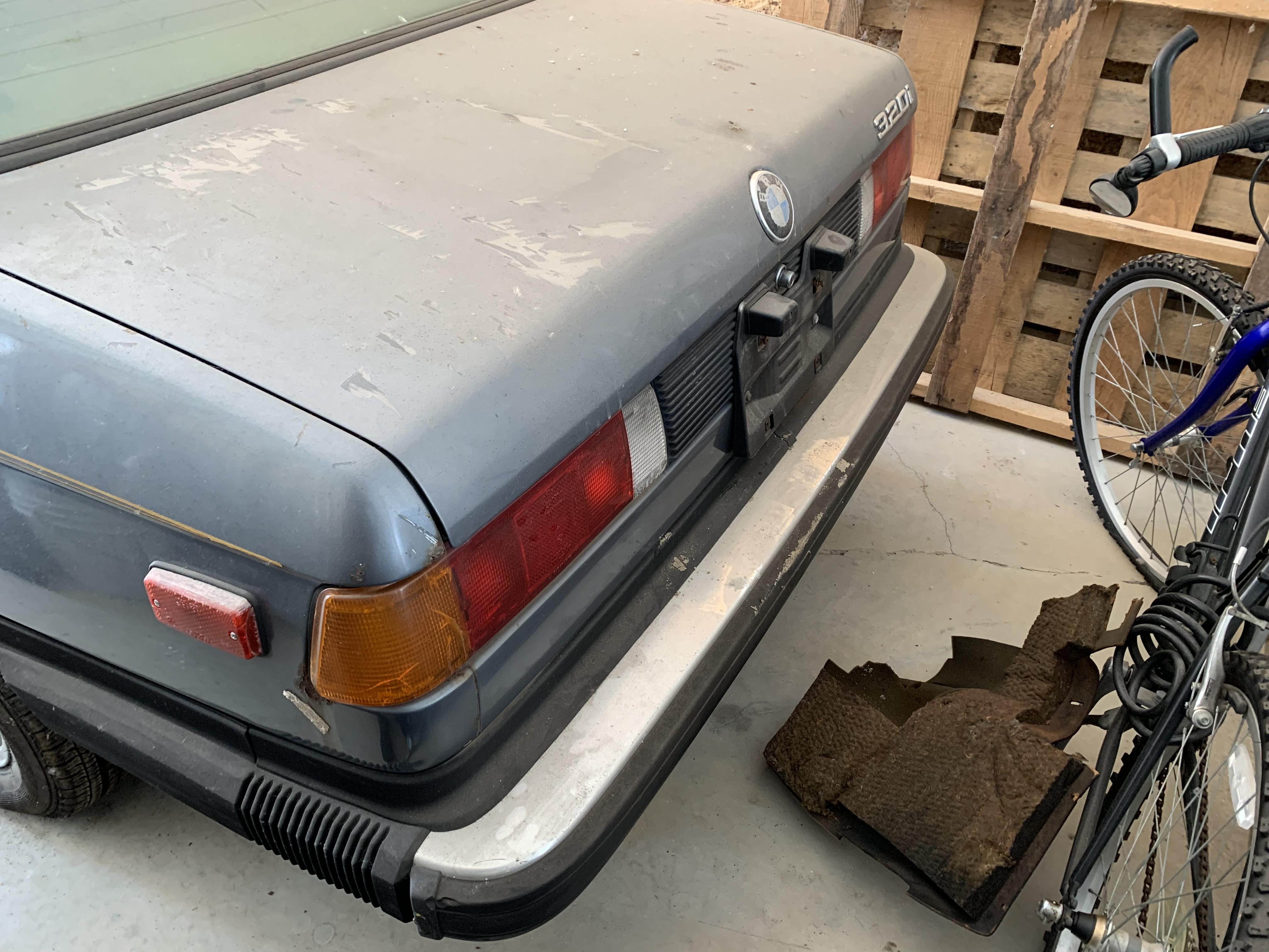

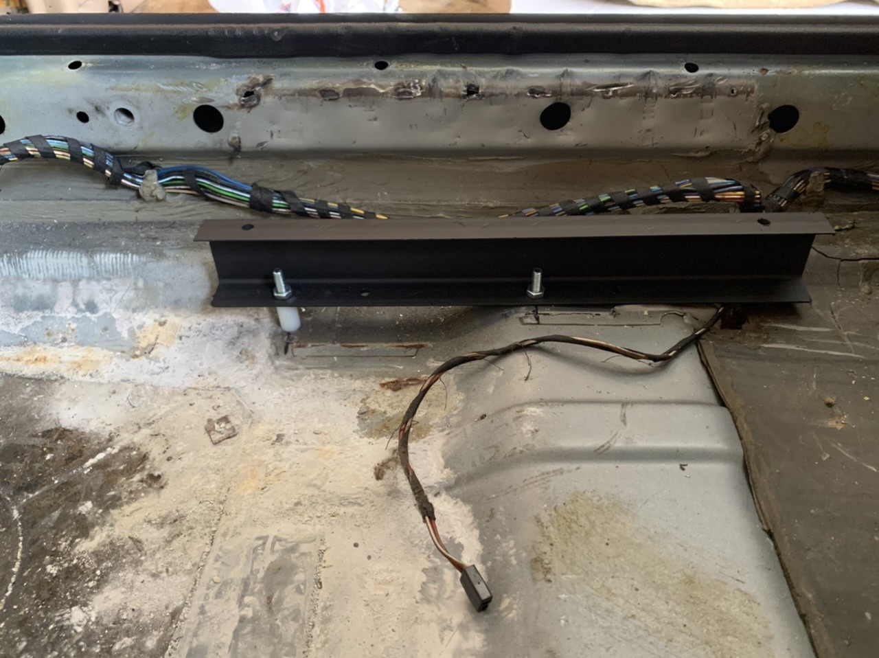

                              Meanwhile, the trunk is locked.  I’d like to see what surprises are in there!!  Anyone know of a way to get in?
                              -Timmer
                                BMW can cut you a new key from the VIN. I got one for my E30 a few years ago and it was about $40. I did need the title to prove I owned the car though
                                  Perfect, I’ll give it a try!  Is this something any dealer can do? The closest one is Bergstrom in Appleton for me....
                                  Thanks!
                                    Thanks!
                                    I would think so! I believe they just ordered it for me and I picked it up a few days later, I didn't have to give them an old key or anything. I'm sure if you called the parts desk they could tell you if they can get one or not

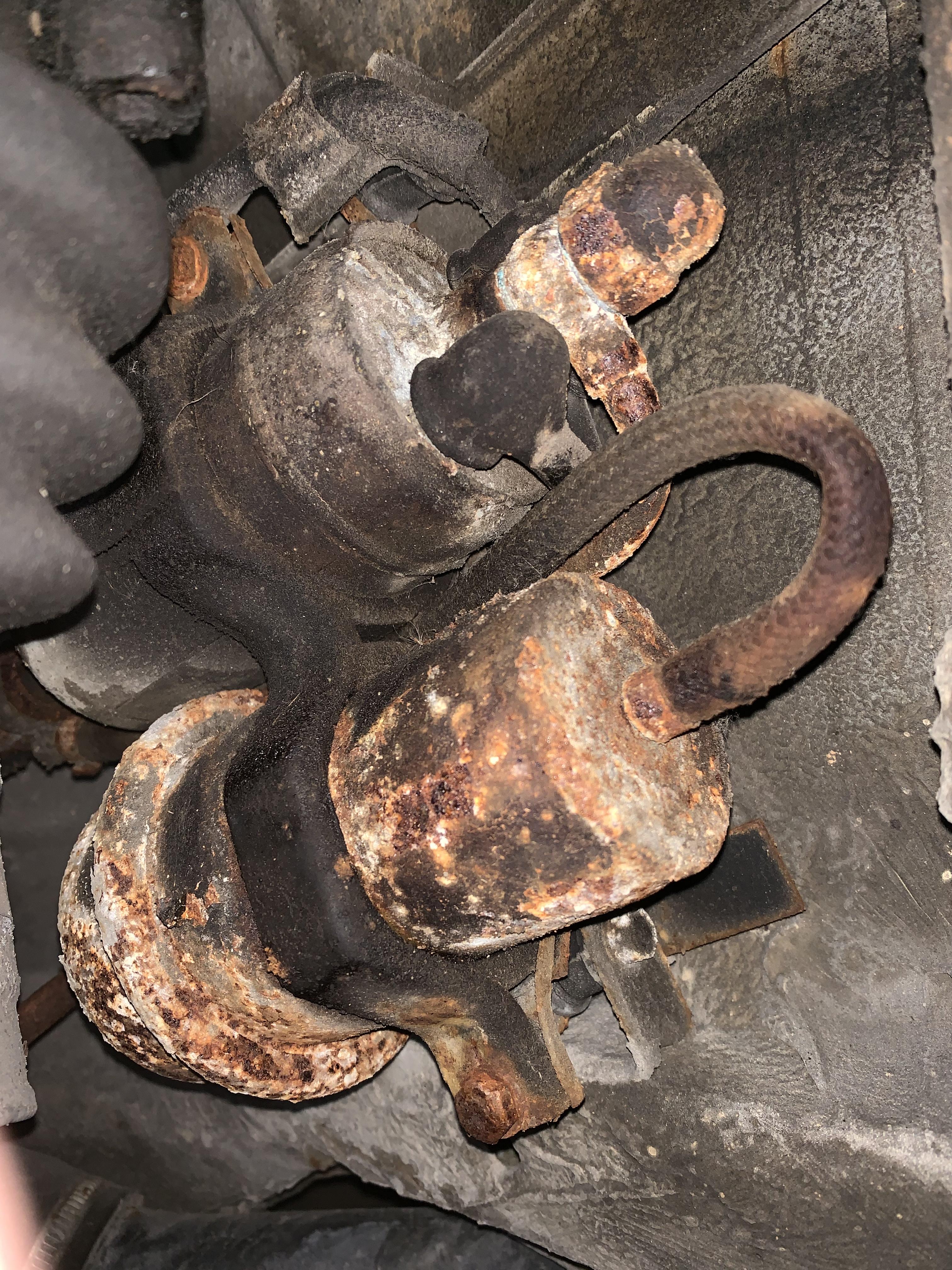

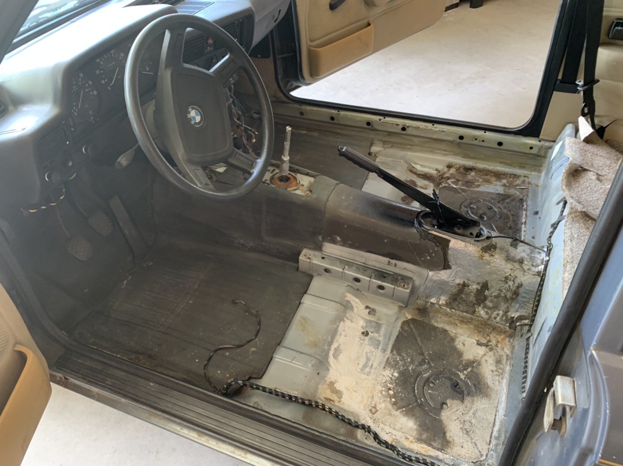

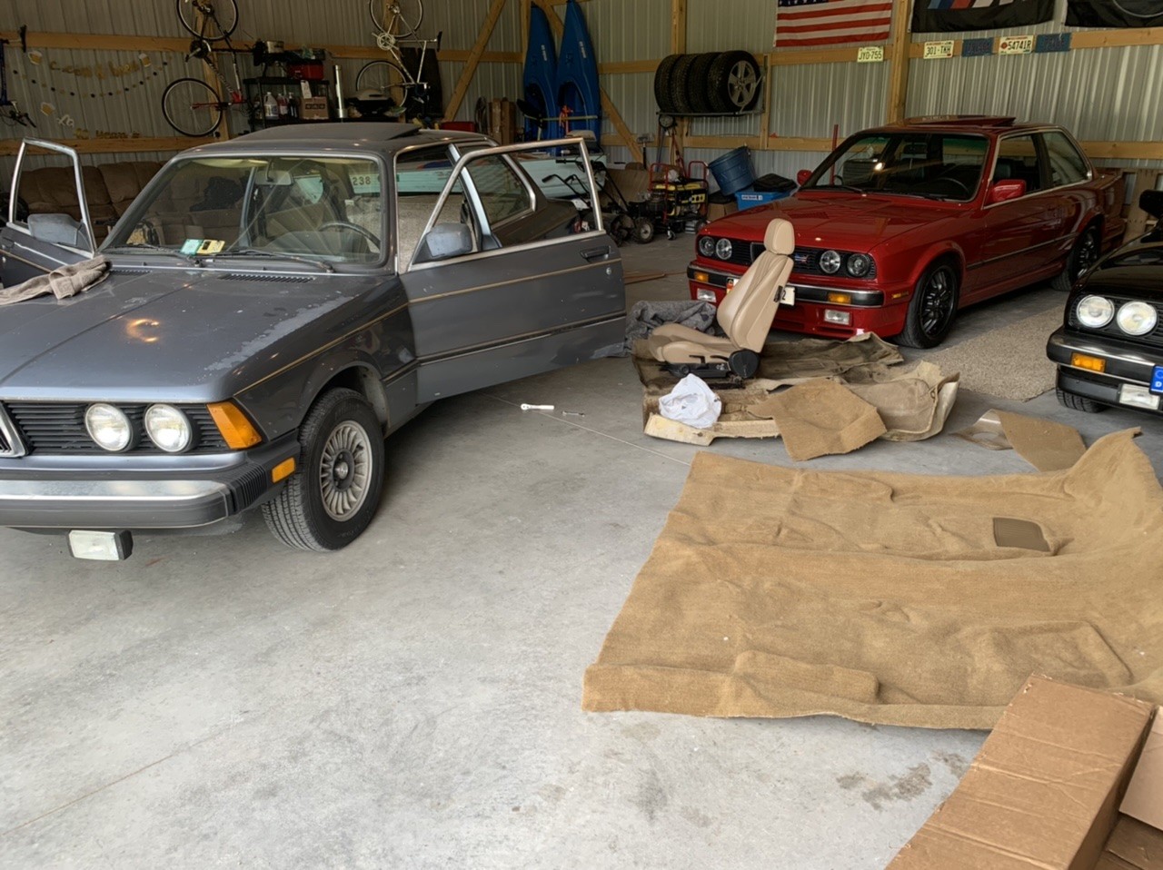

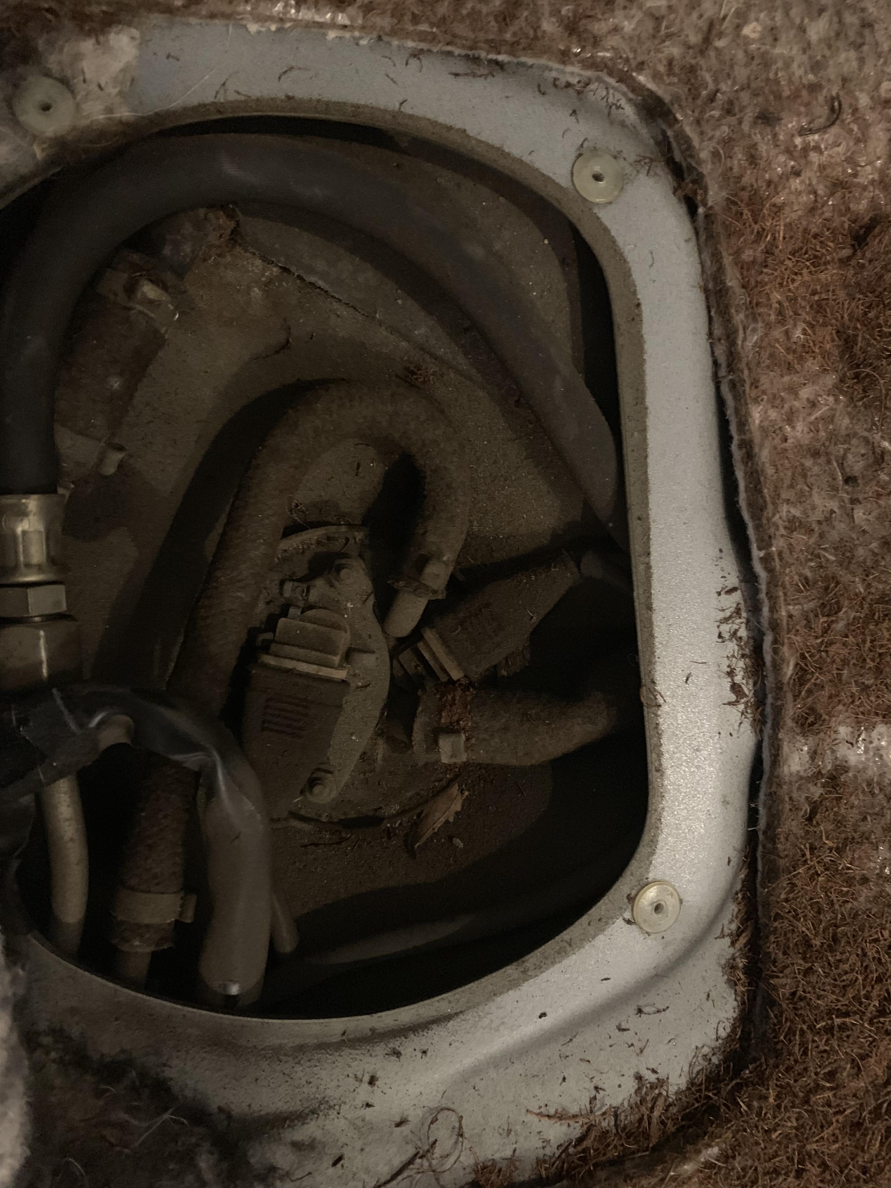

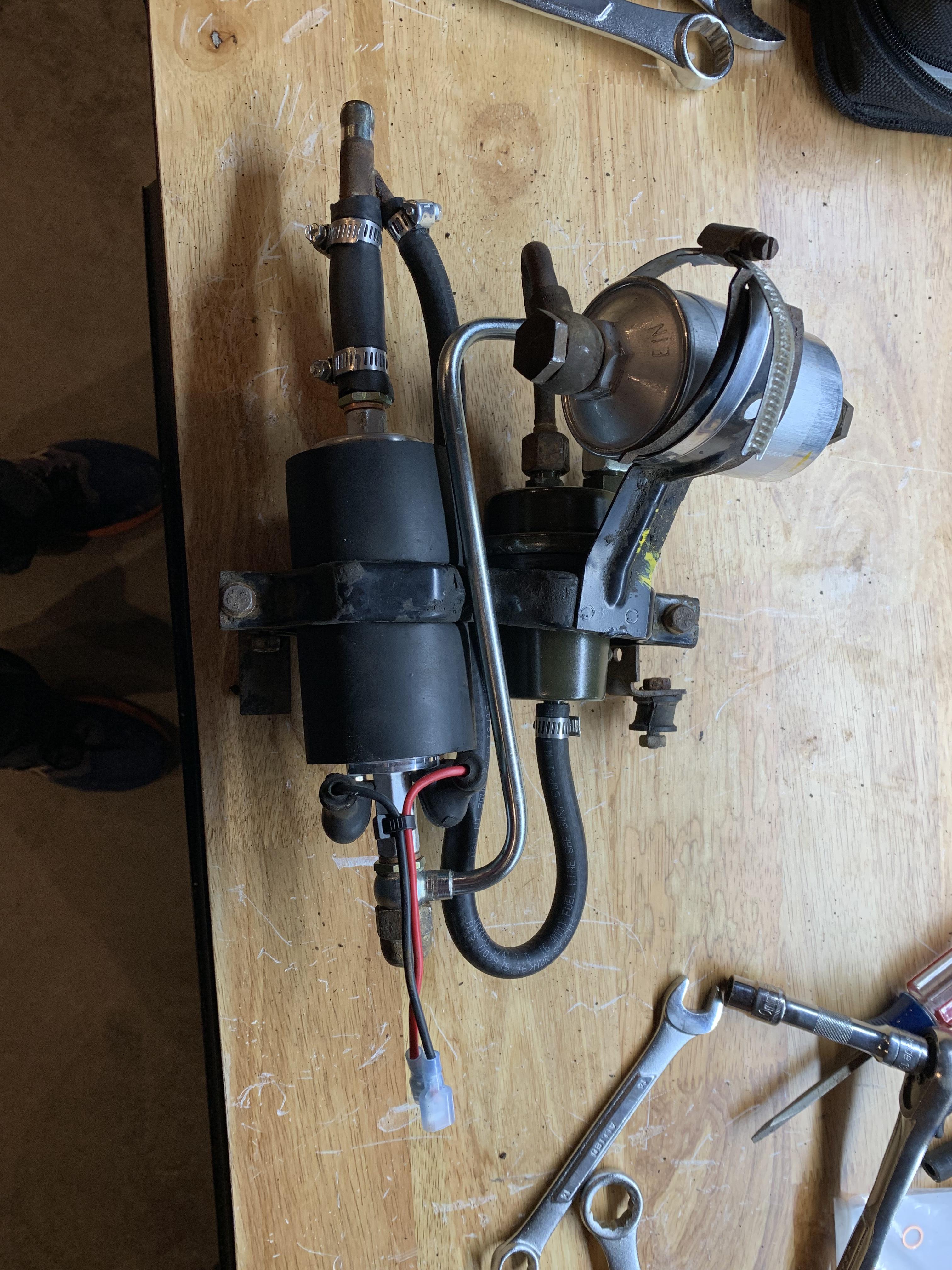

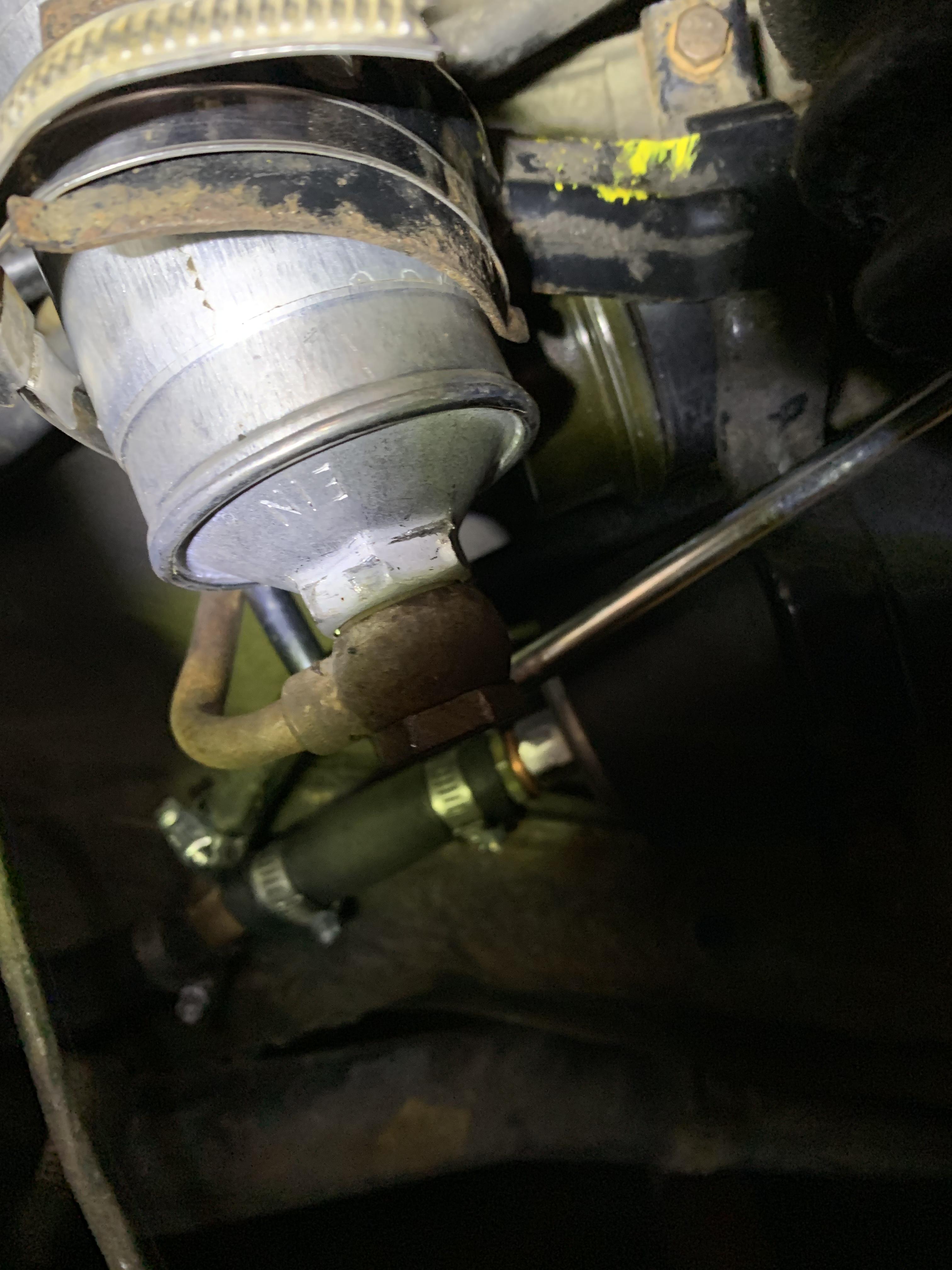

                                        *** UPDATE...version Winter Storm Wesley ***

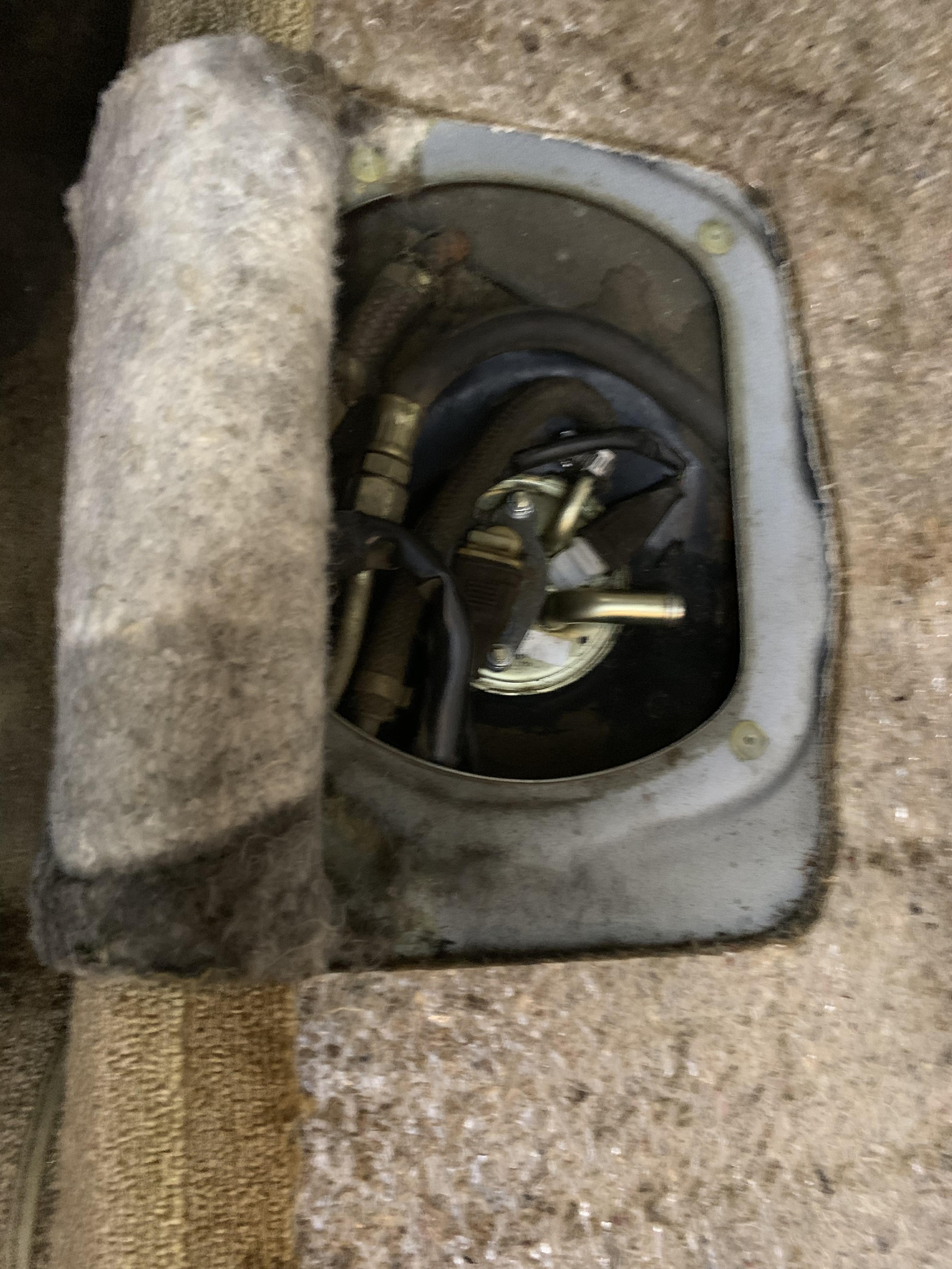

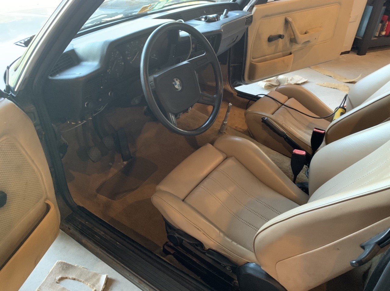

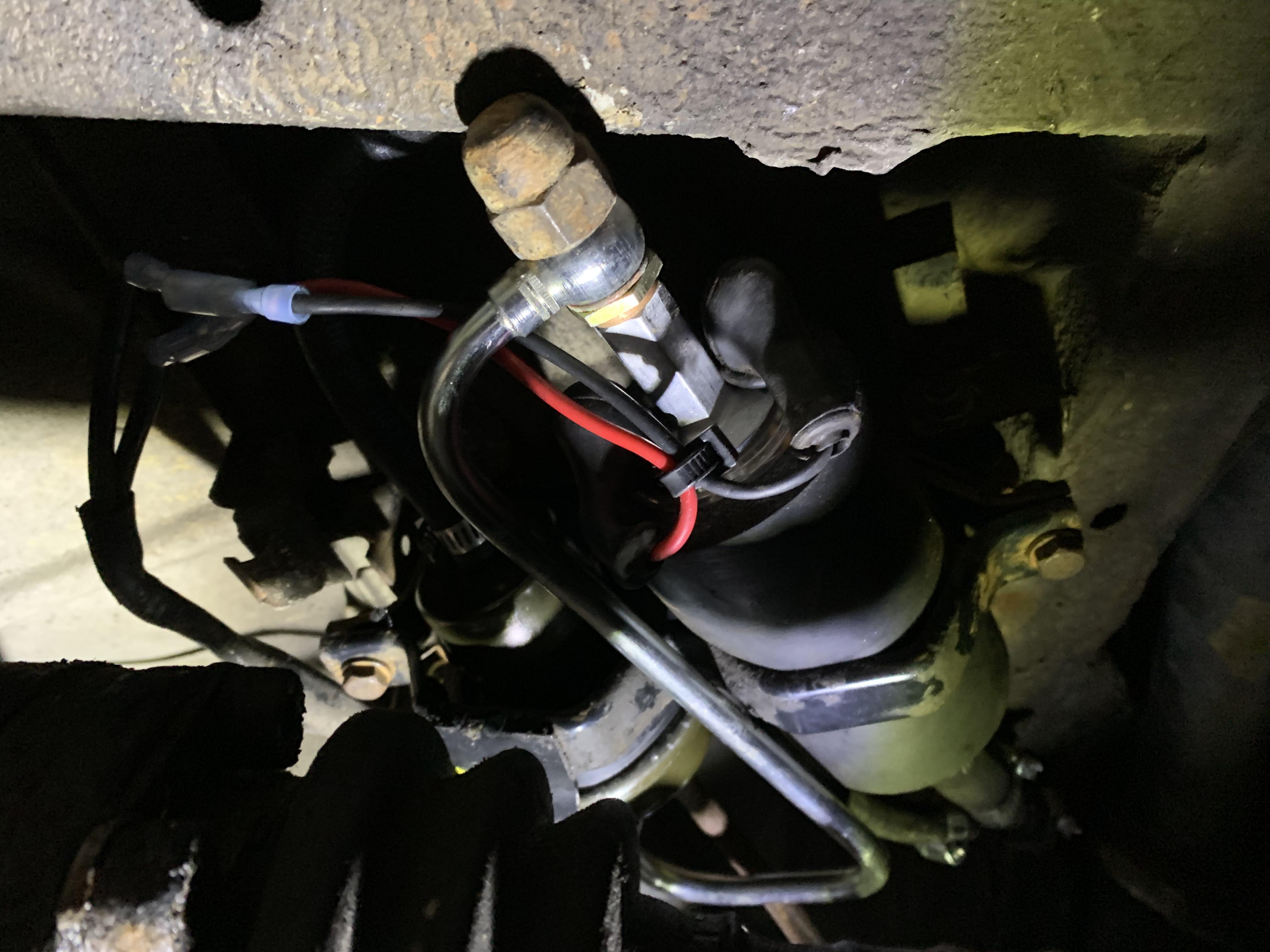

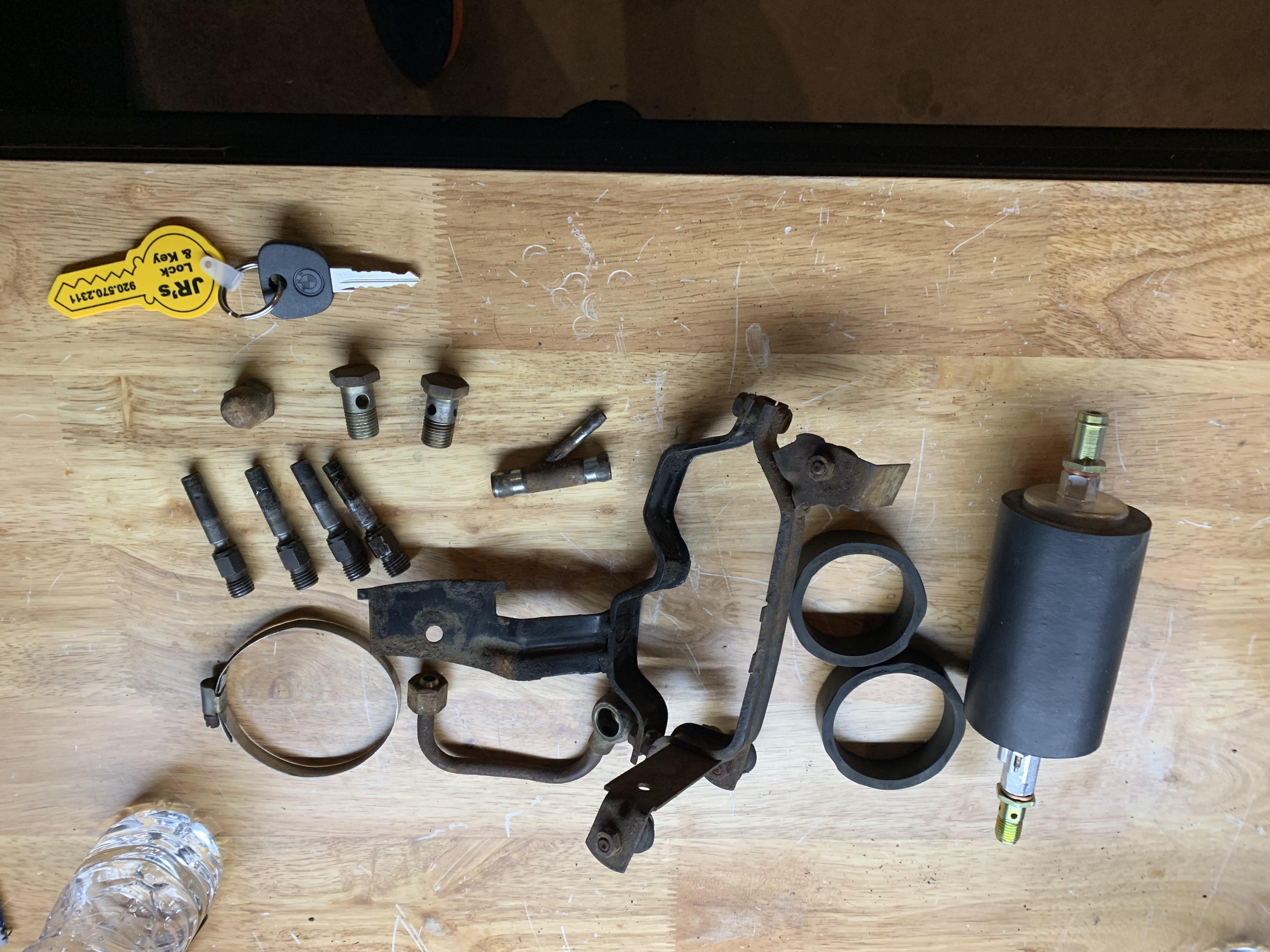

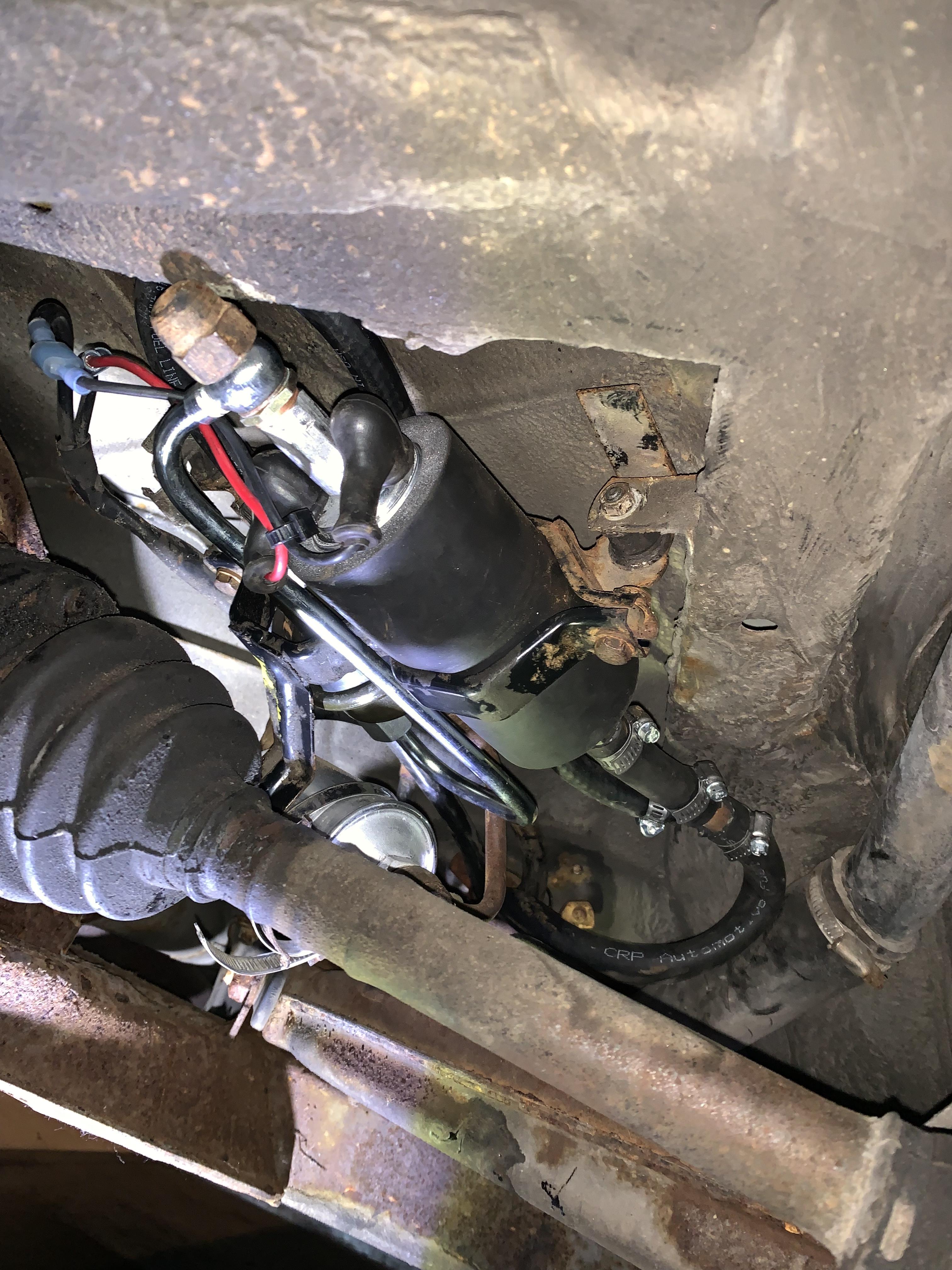

                                        Im hoping to have her running soon!  I’ve tackled the fuel system...what a mess. New key is cut courtesy of Enterprise BMW, and I started cleaning up the interior a bit.
                                        What the crap-wooly mammoth-fur stuff did BMW use to cushion the seats with anyway?  Years of sitting turned it into a crunchy, rust colored dust.

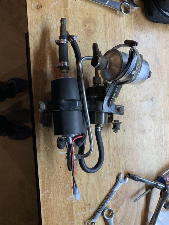

                                        She was diagnosed with two frozen solid fuel pumps, and every fuel line held as much fuel as a cheese grater.
                                        Luckily the tank is dry and in good shape; the new in tank pump is in, the external pump is out.  Just waiting for the fuel lines, fuel accumulator, and fuel filter to arrive to finish things up.
                                        Im confident she’ll fire right up once reassembled.
                                        Obligatory first fire up in 20+ years to follow.
                                        -Tim
                                          That fuel pump/accumulator looks like something from the great barrier reef
