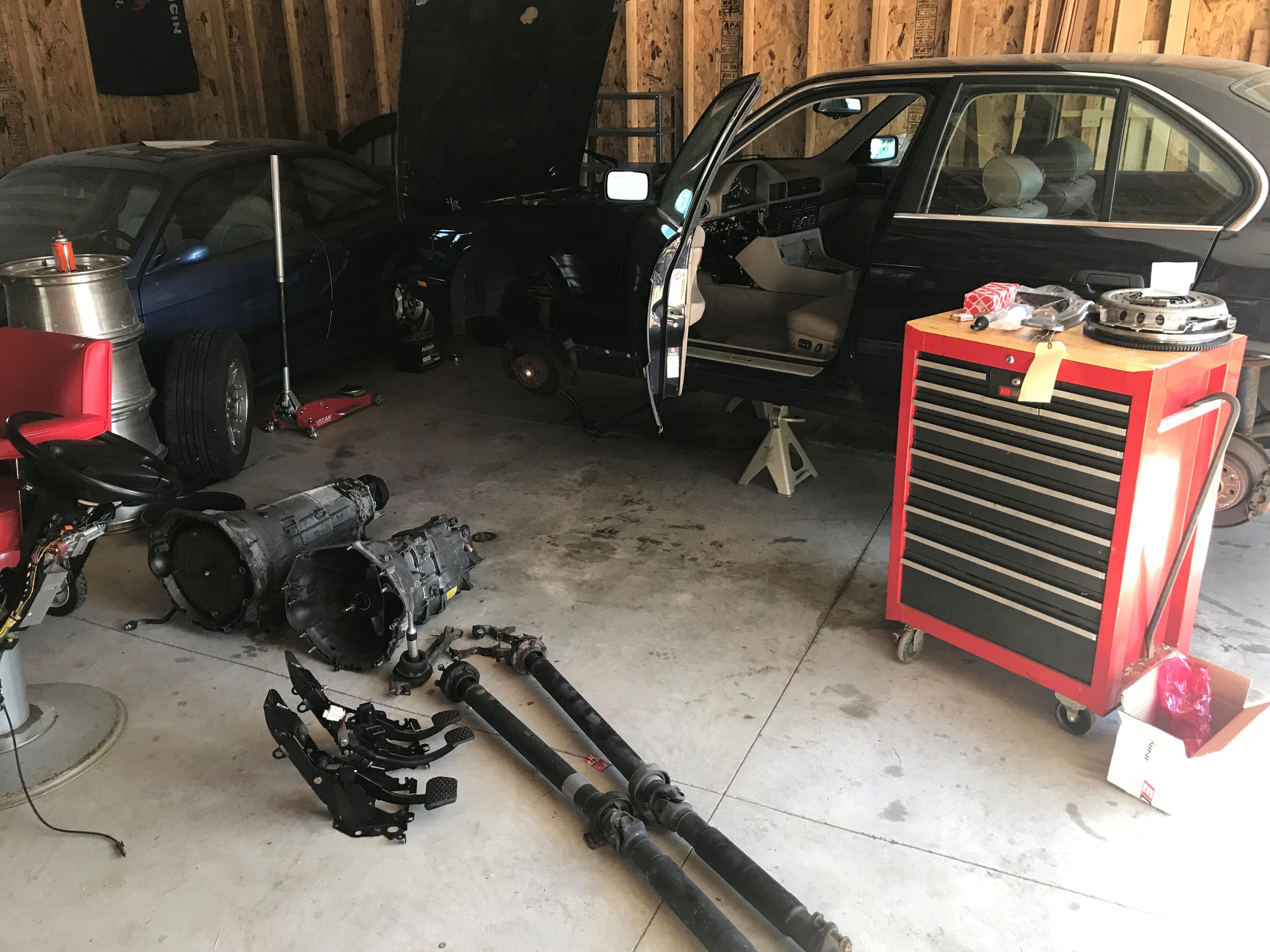

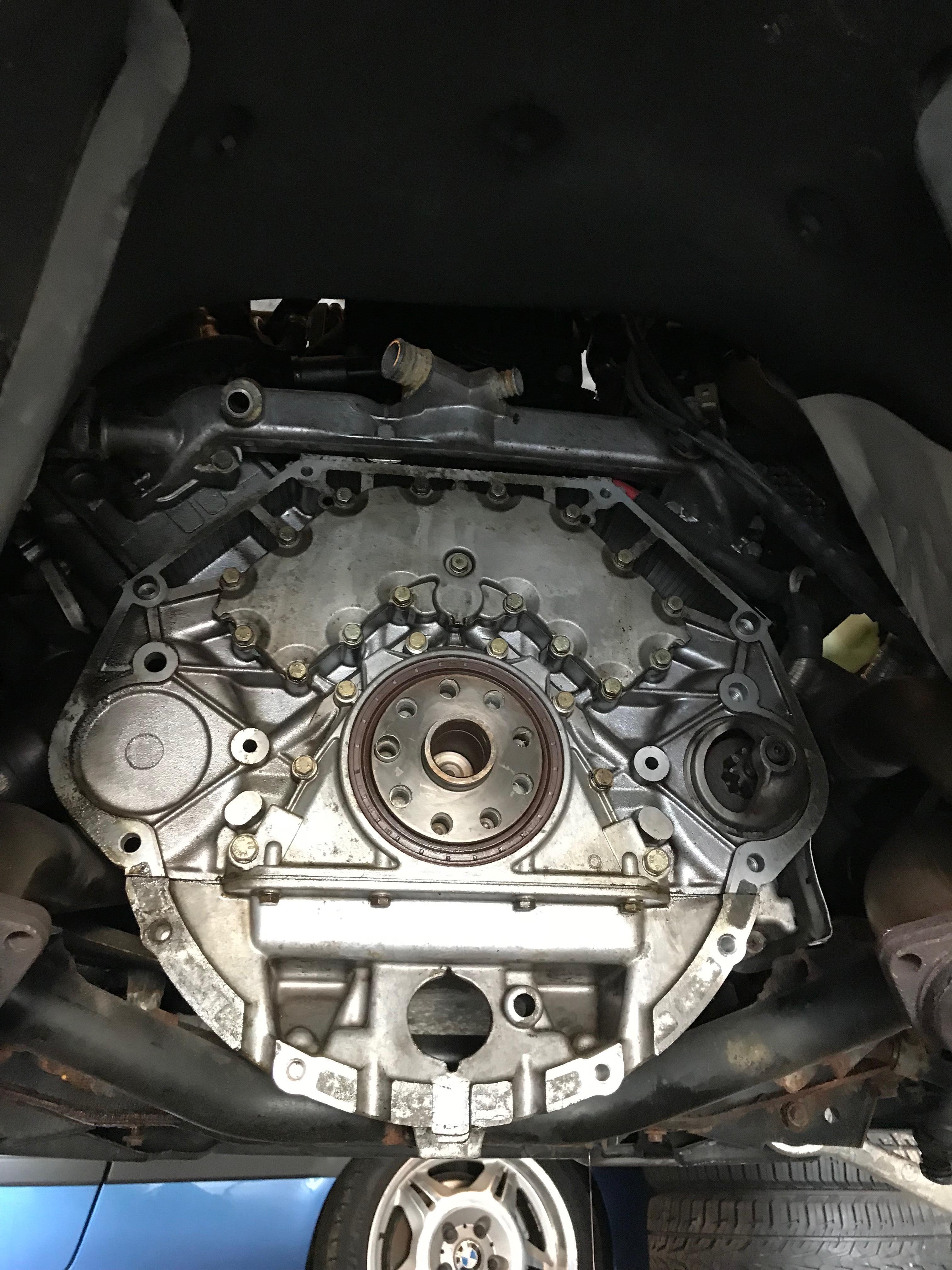

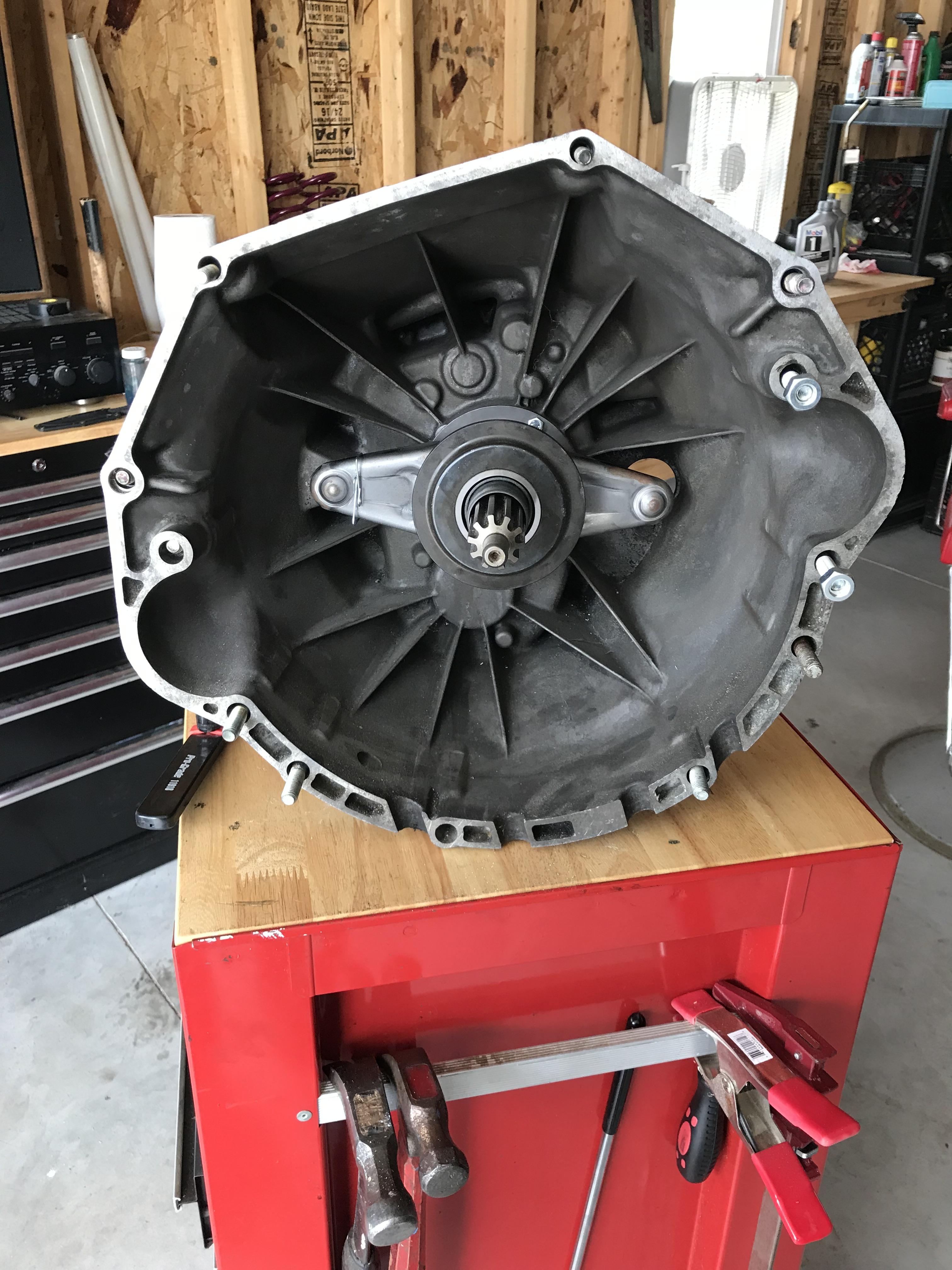

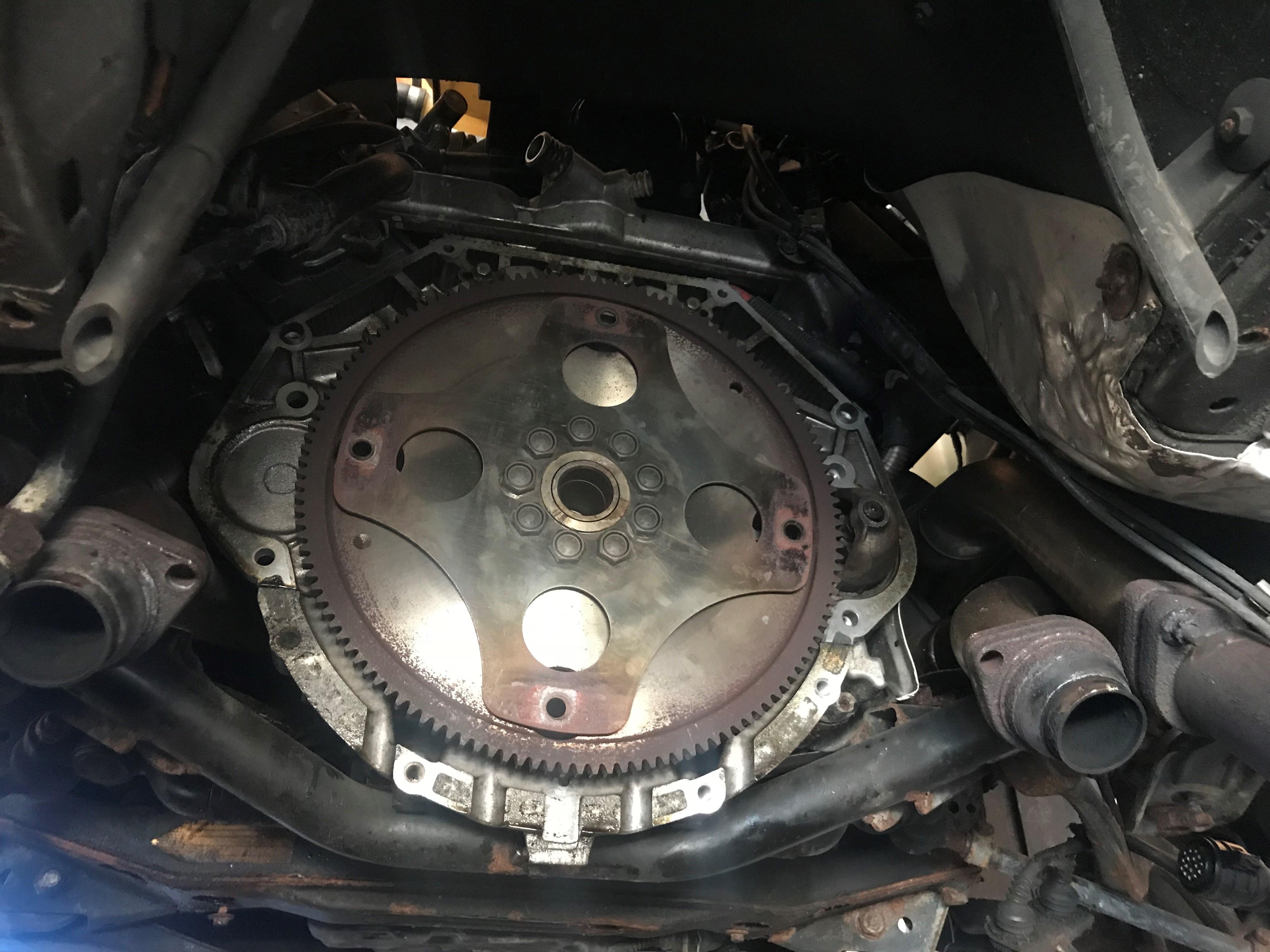

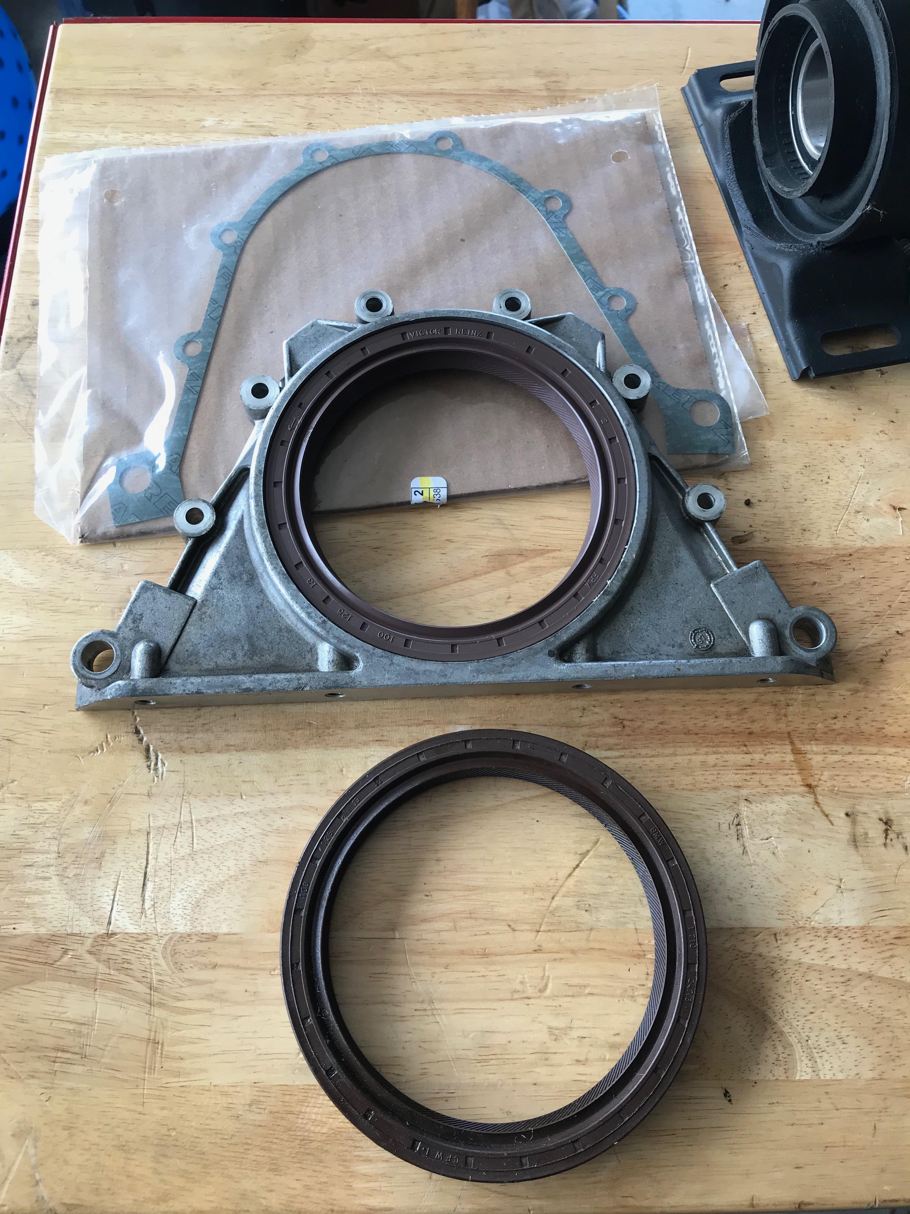

                Slowly plugging away at this project. I changed the rear main seal and gasket even though it really didn't have any leaks at all. In hindsight I should have left it alone because the upper oil pan gasket just crumbled when I gently pried the rear crankcase cover off. I cut it cleanly at the ends and filled it with OEM loctite 5970 differential/pan sealant. ¯\_(ツ)_/¯  Worst case scenario I have to drop the entire oil pan but it should be done anyways by the condition of the gasket piece that disintegrated.

                      I have 2 upper oil pan gaskets if you need one, I could bring one to the cruise Saturday.

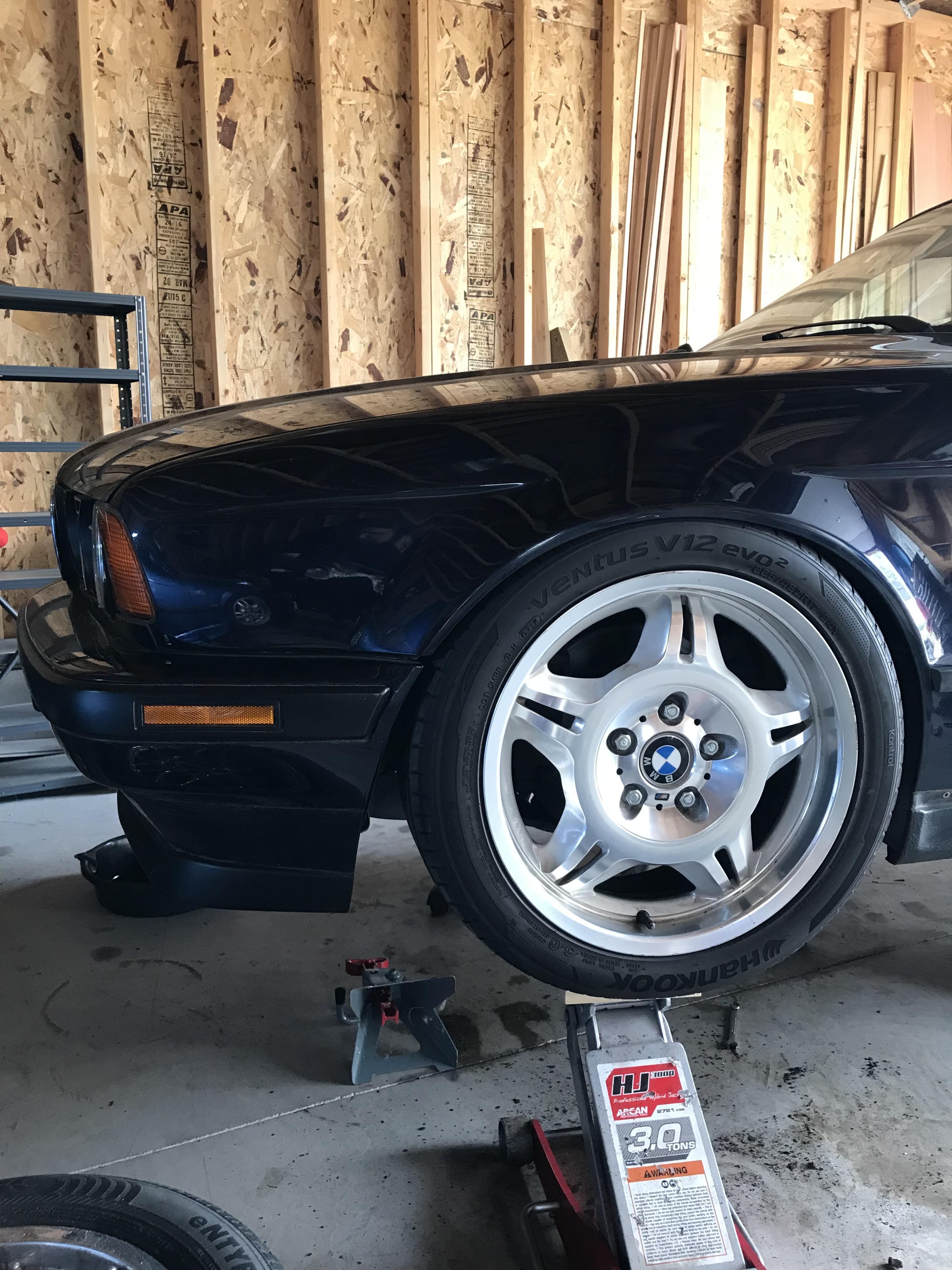

                        Update from last weekend.

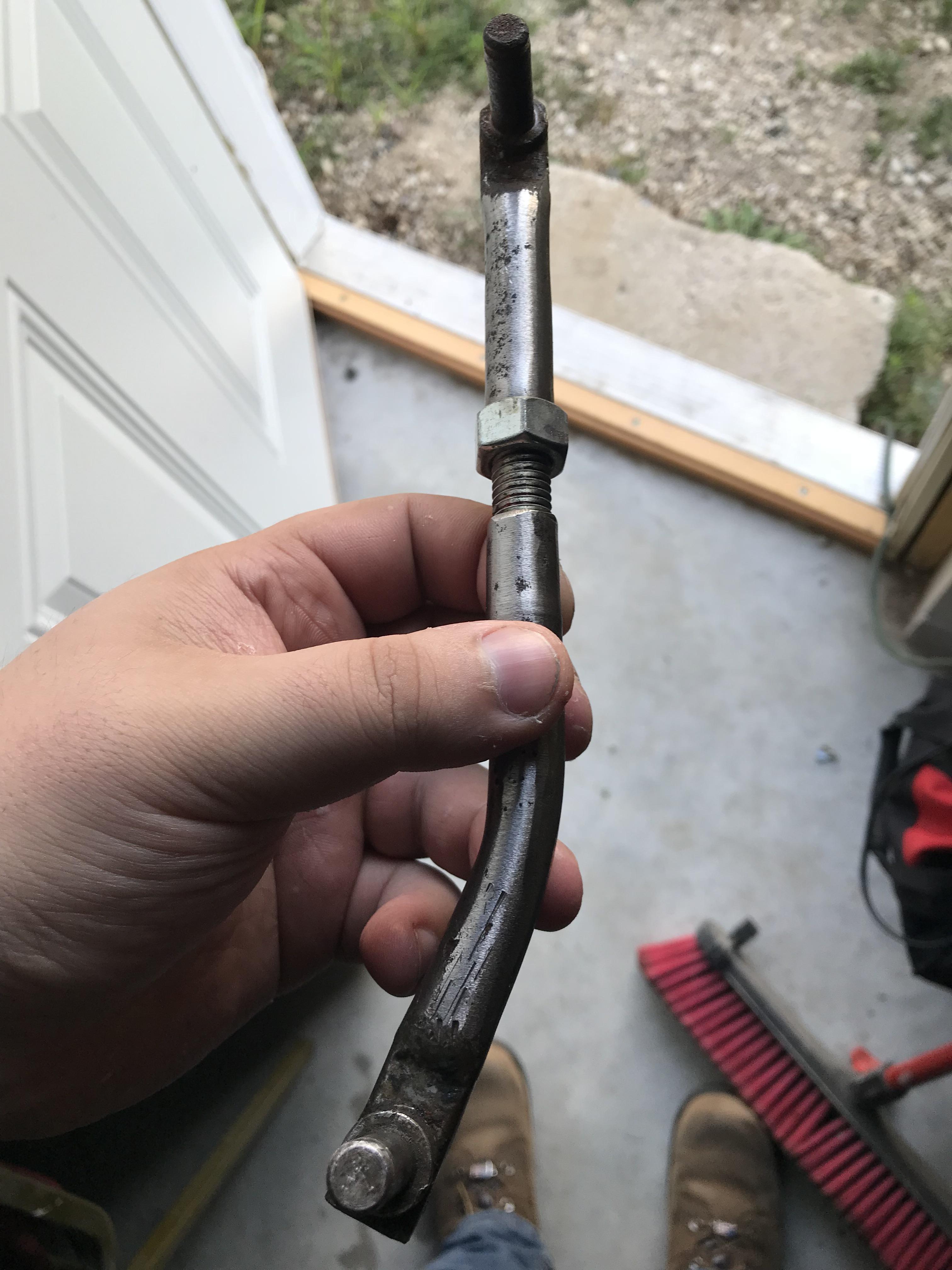

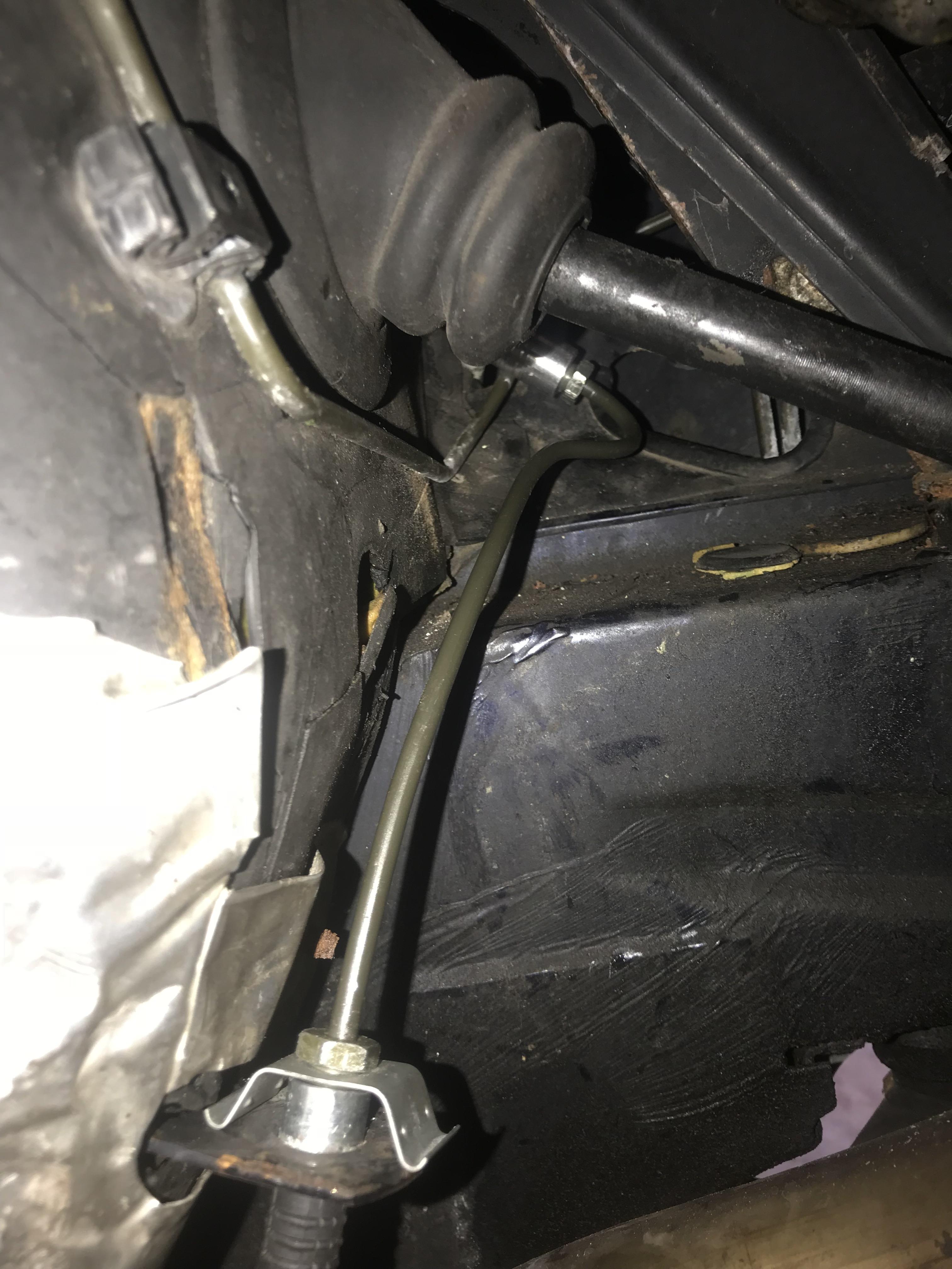

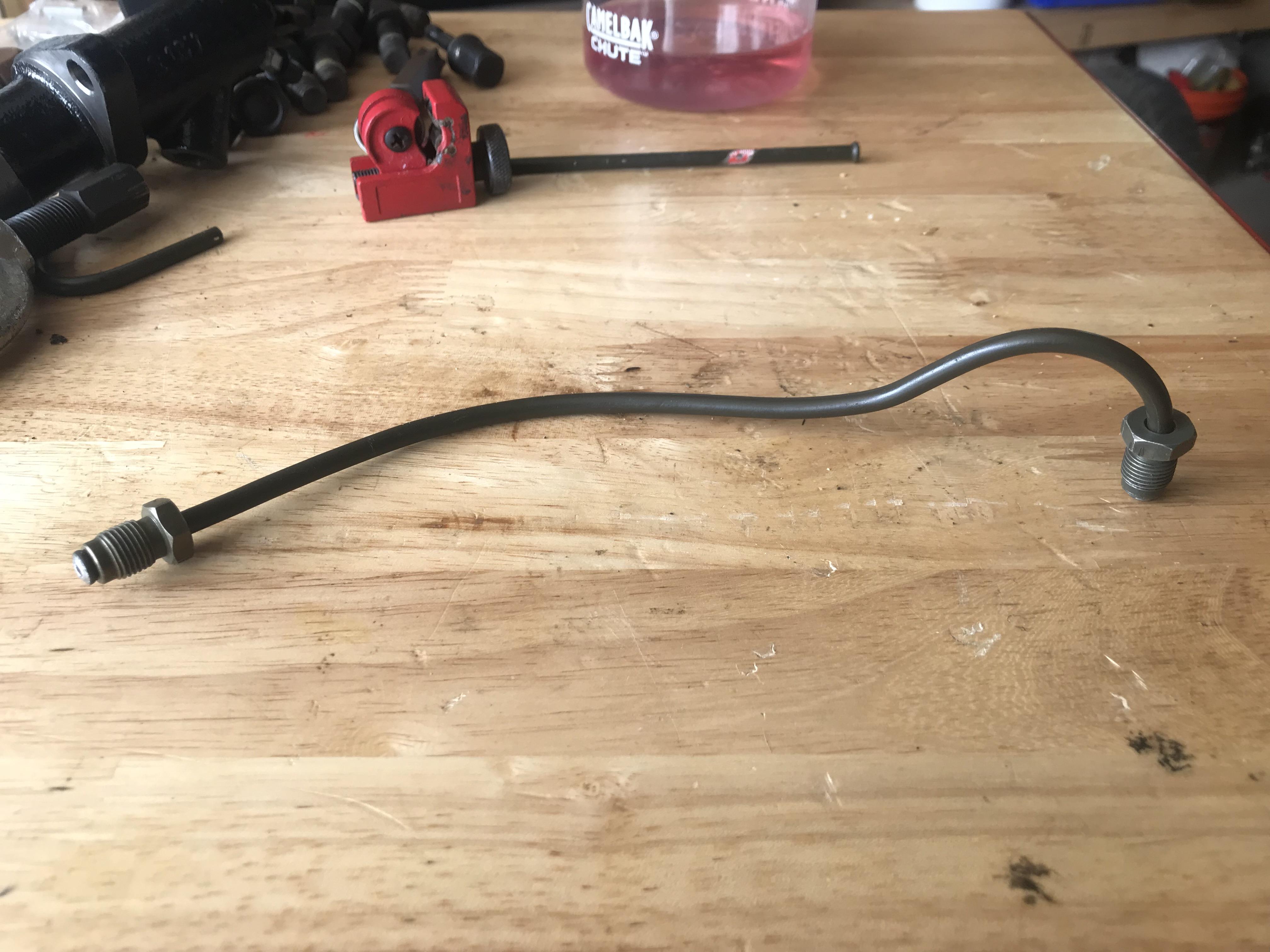

                        I was able to get just about everything installed including some vogtland springs. I didn't get the driveshaft put back in because the shift selector rod was too short since it did not match the gearshift rod joint that was recently replaced incorrectly (part number change in 10/1994) by the last owner. Instead of purchasing a new one I cut, tapped, bent, and extended the old one to work. Turned out "Meh" but now it is fully adjustable. I had originally purchased some fittings for the bend from the master cylinder but I ended up just making a hard line that worked out even easier. I jumped the starter relay, started the car and everything works great. I should have it all wrapped up next weekend but who knows.
                          Looks good!
                          • ChrisOC
                            ChrisOC
                            ChrisO
                            The style 24's look awesome. Never seen them on a e34 before
                              I looked everywhere on the inter-webs for example pictures and could not find anything. I see a lot of people running m contours but never the LTW's. I'm pleasantly surprised with how fitting they are on the vehicle.

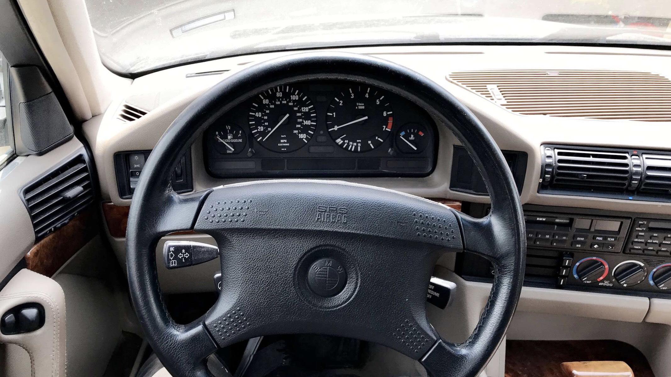

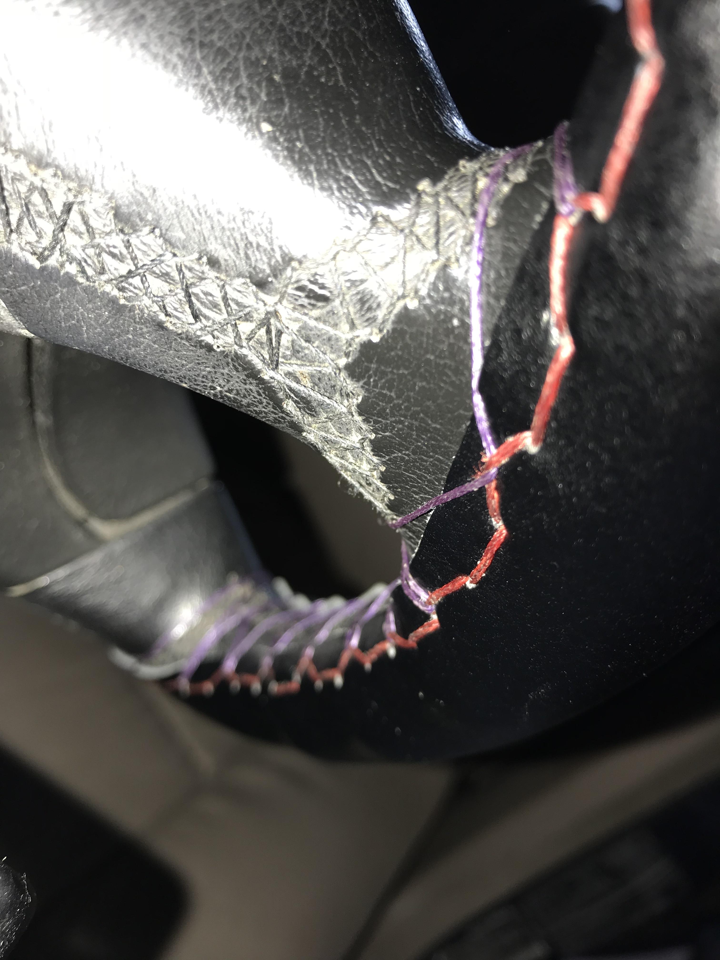

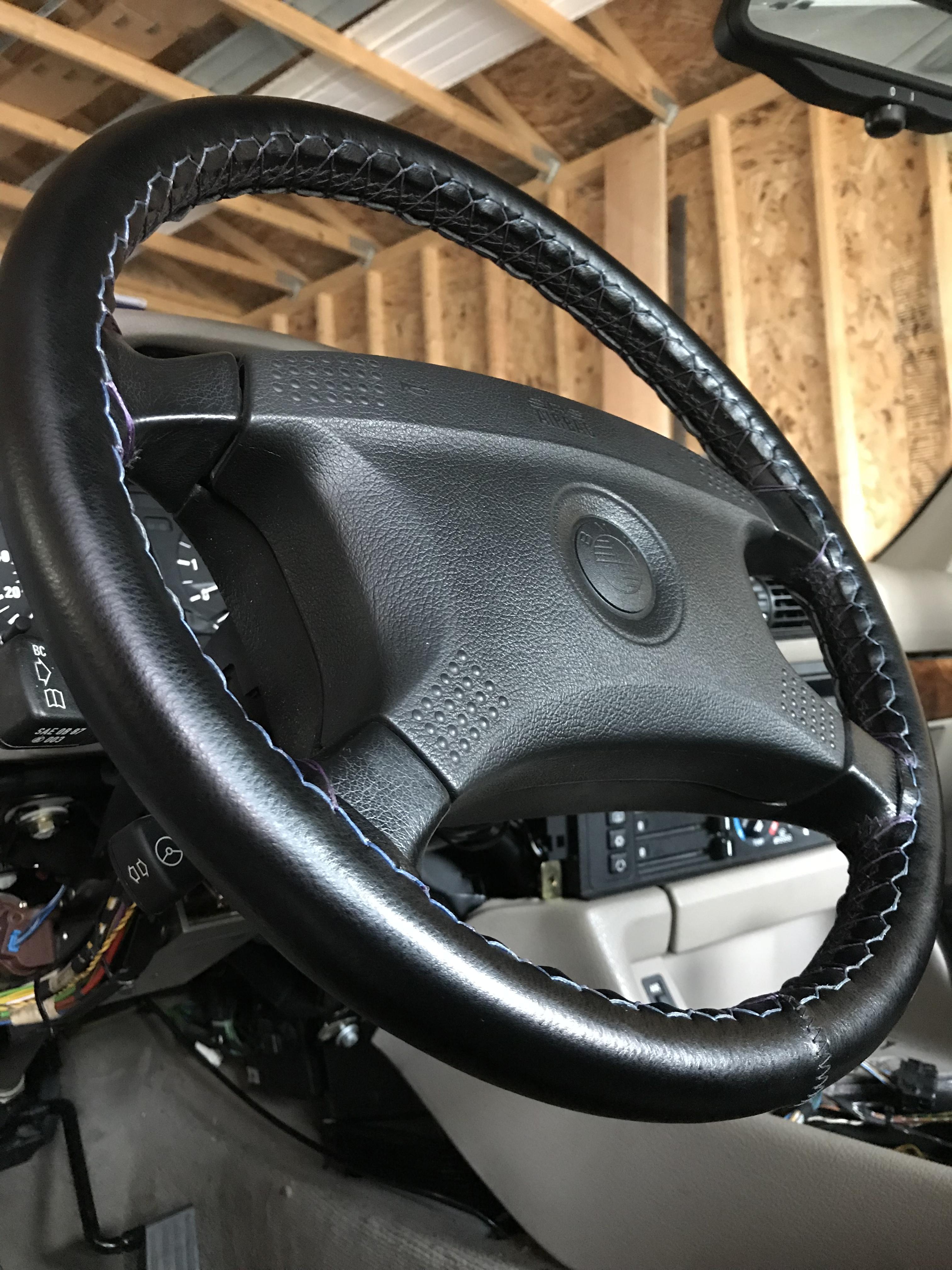

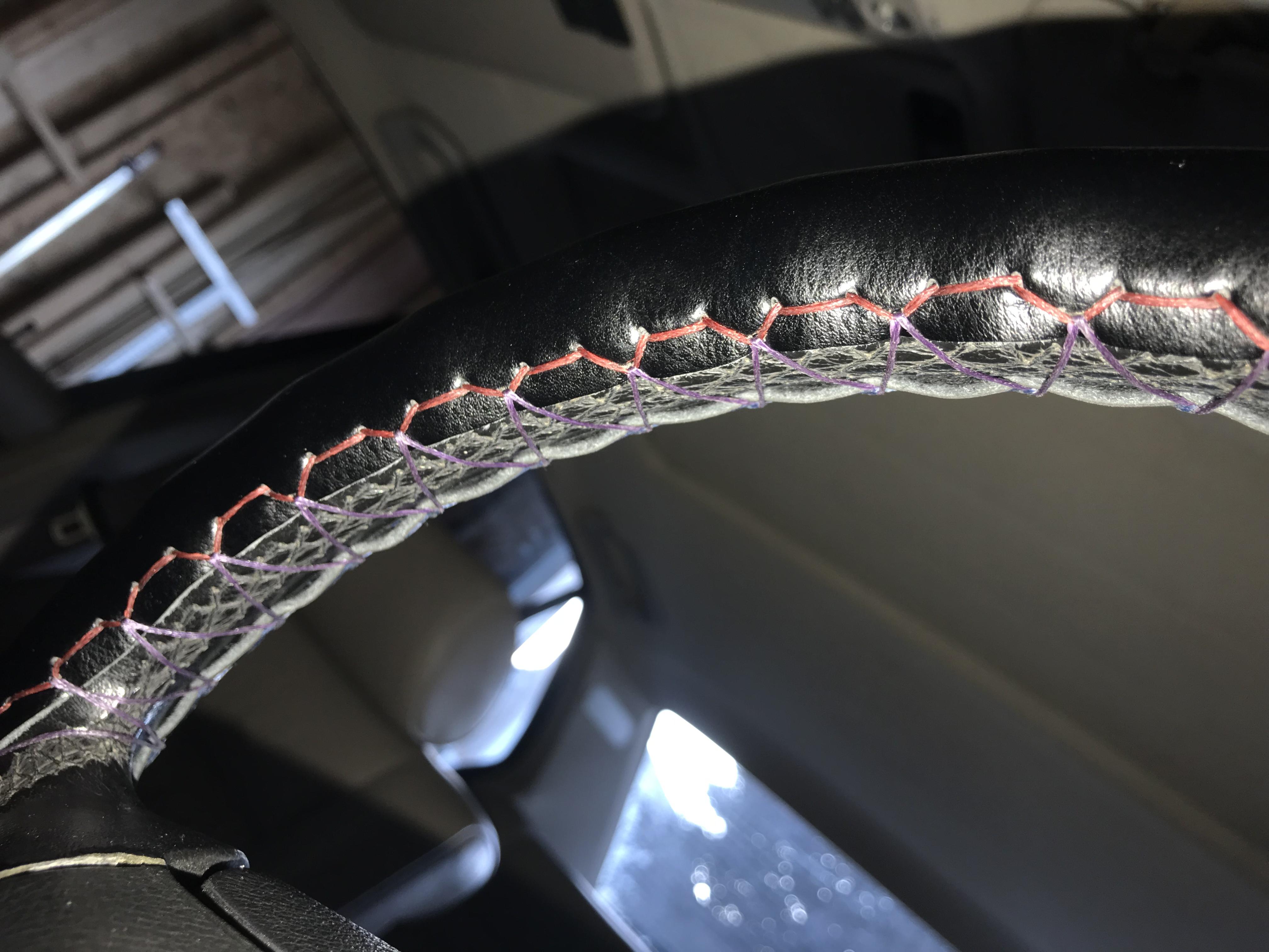

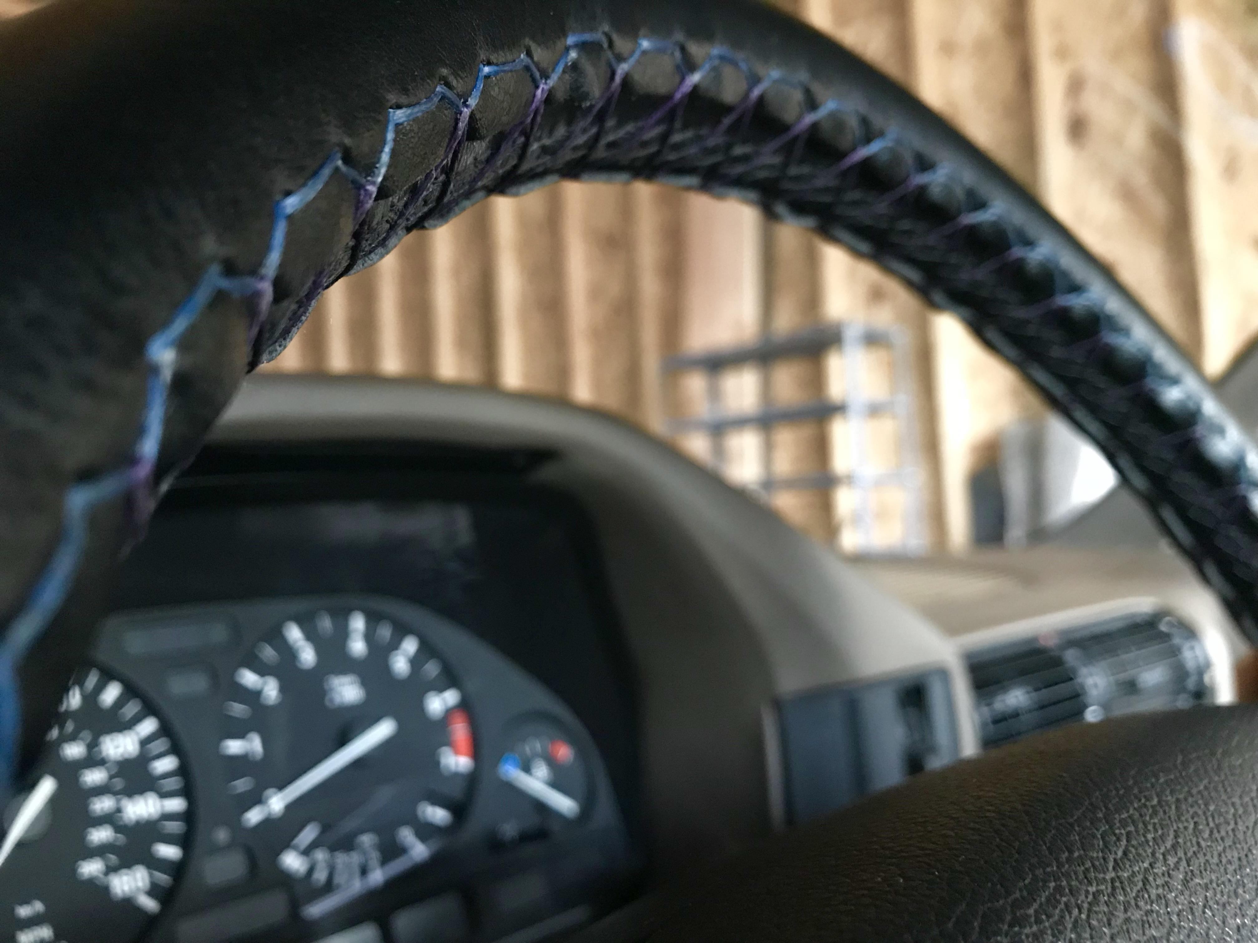

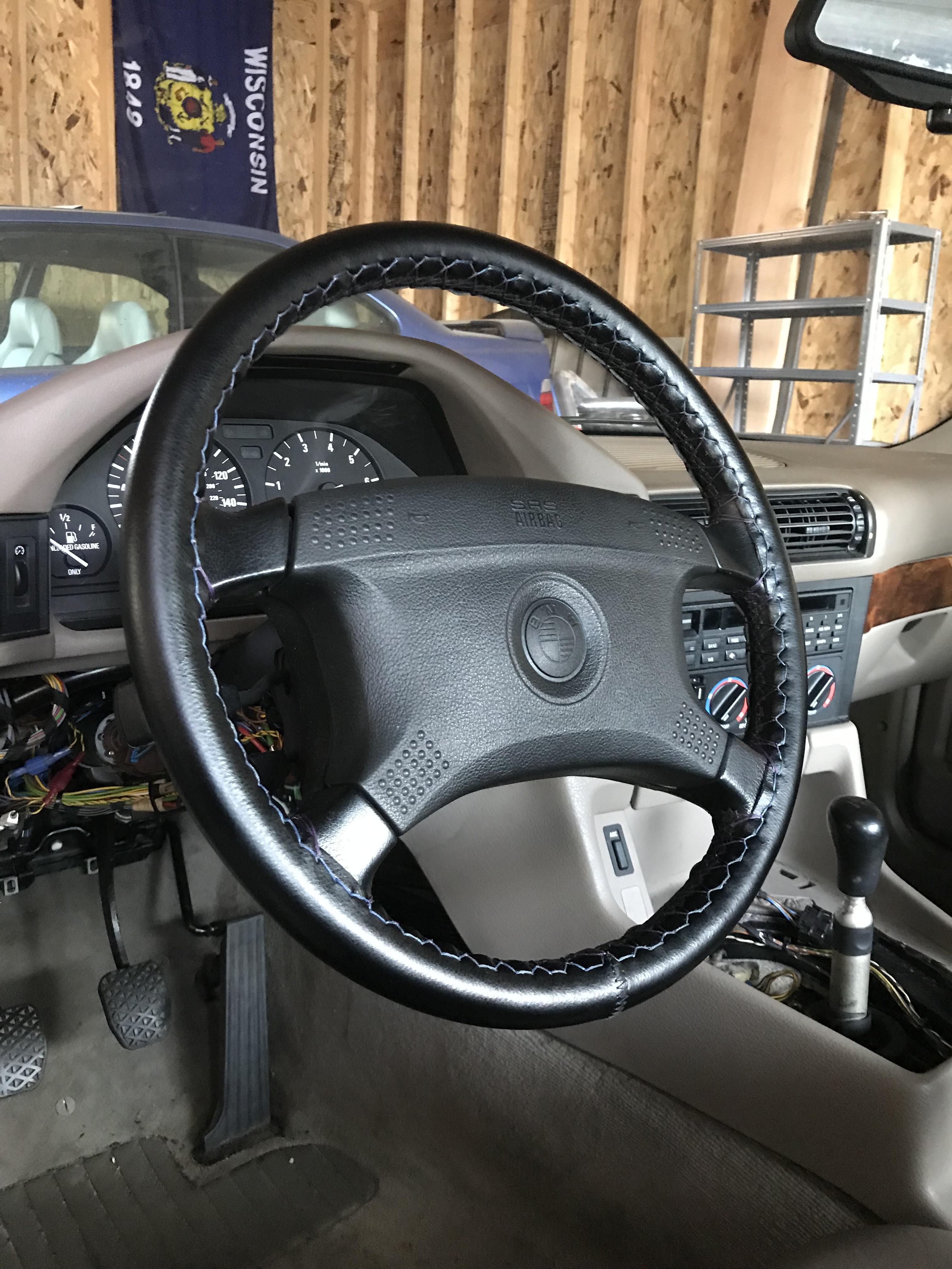

                                      I’m really not a huge fan of the e34 steering wheel but instead of replacing it with a better one I was able to spruce it up a bit. I used a universal genuine leather wrap from Amazon and stitched it to match the M pattern. I didn’t know if I would like the wide stitching at first but it feels amazing in hand because it add a bunch of grip to the leather. All in all not a bad look for $20 total.
                                        On a scale from 1 - 10, How hard was that?
                                        It looks amazing though!
                                        • StriggityStrackS
                                          StriggityStrackS
                                          StriggityStrack
                                          The difficulty was a 5 but it took a good hour and a half to complete. The leather was surprisingly easy to manipulate and the stitching stayed tight along the way which I did not expect at all.
