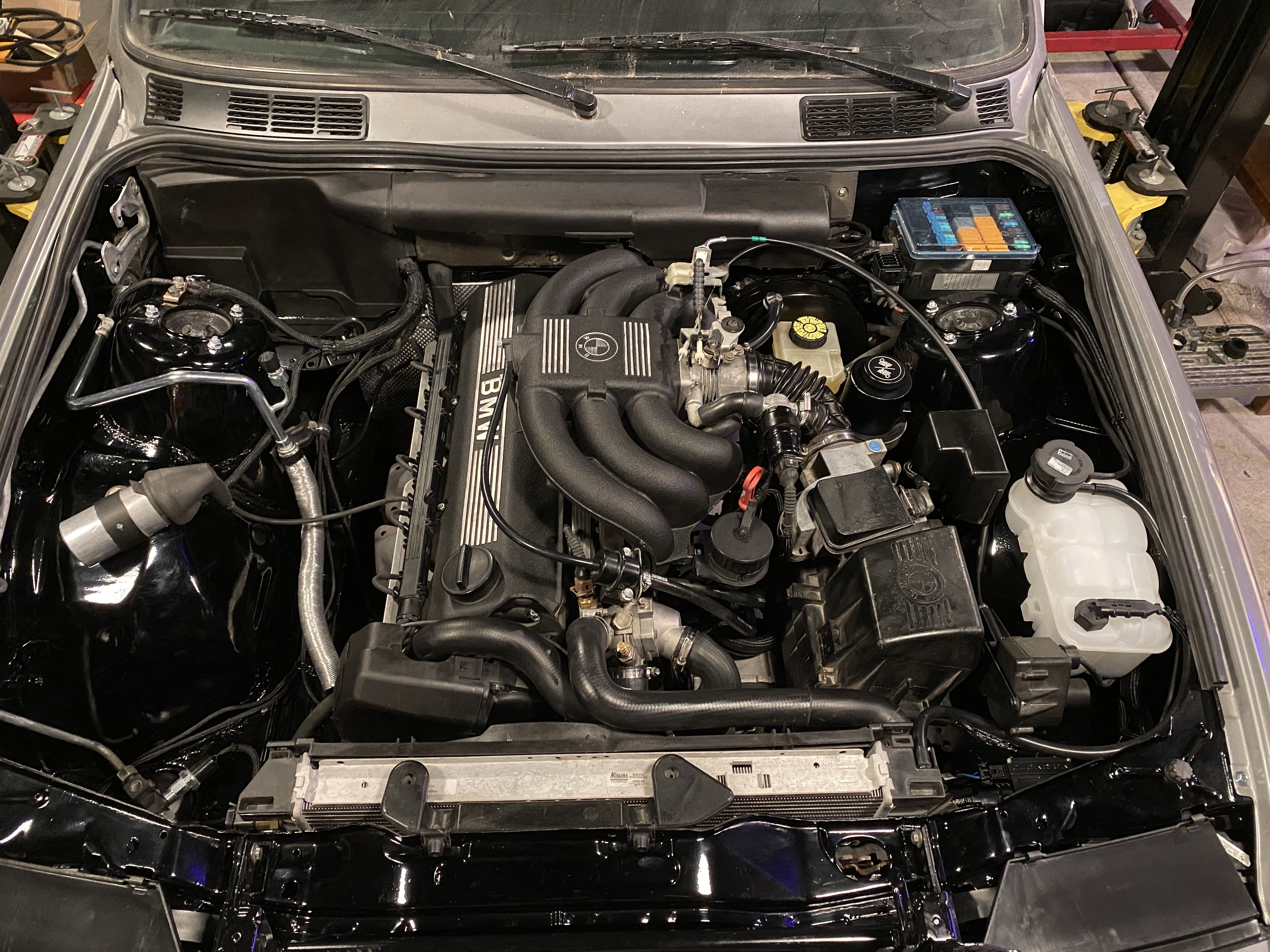

    The last month was pretty crazy figuring out this whole lighting biz. But I got caught up on the first wave of orders and had a night to just work on the car.
    It's back on the ground. What I've completed up to this point:
    • ABS Delete using the Chase Bays brake line kit.
    • Chase Bays power steering reservoir and hoses.
    • Patch some rust in the engine bay and paint it.
    • New water pump, timing belt kit, transmission input shaft seal.
    • Ditched the Garagistic DSSR in favor for the IE Motorsports DSSR and oem shift selector joint.
    • Rebuilt the HVAC box with all new foam on the flaps and the joints and fixed one of the recirc flaps.
    • Redid the body harness going into the engine bay (lights, fan, etc.) with new loom.
    What's left:
    • Finish putting interior back together and redo the gauge wire harnesses.
    • Paint a couple pieces.
    • Fluids.
    • Odds and ends.

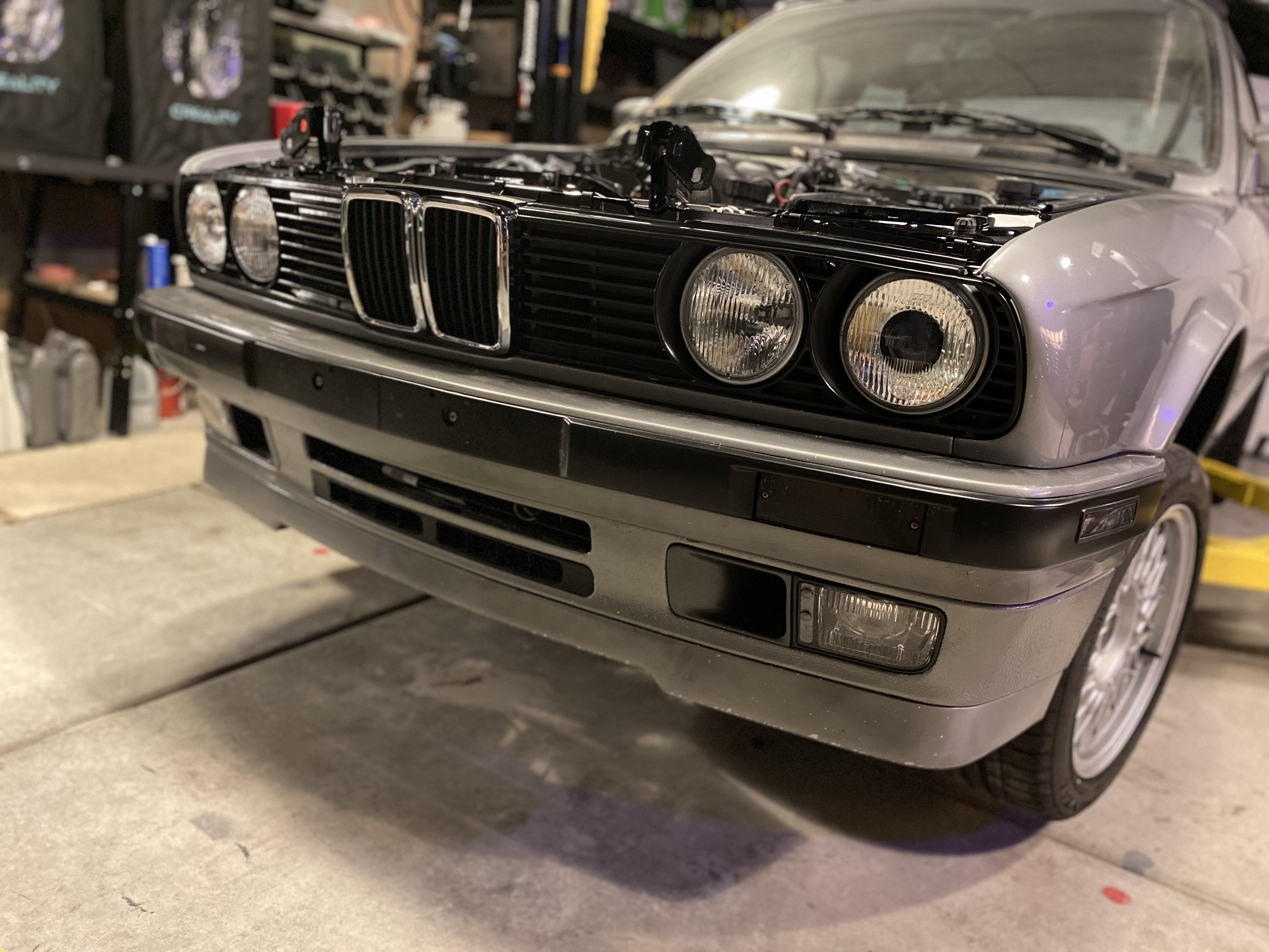

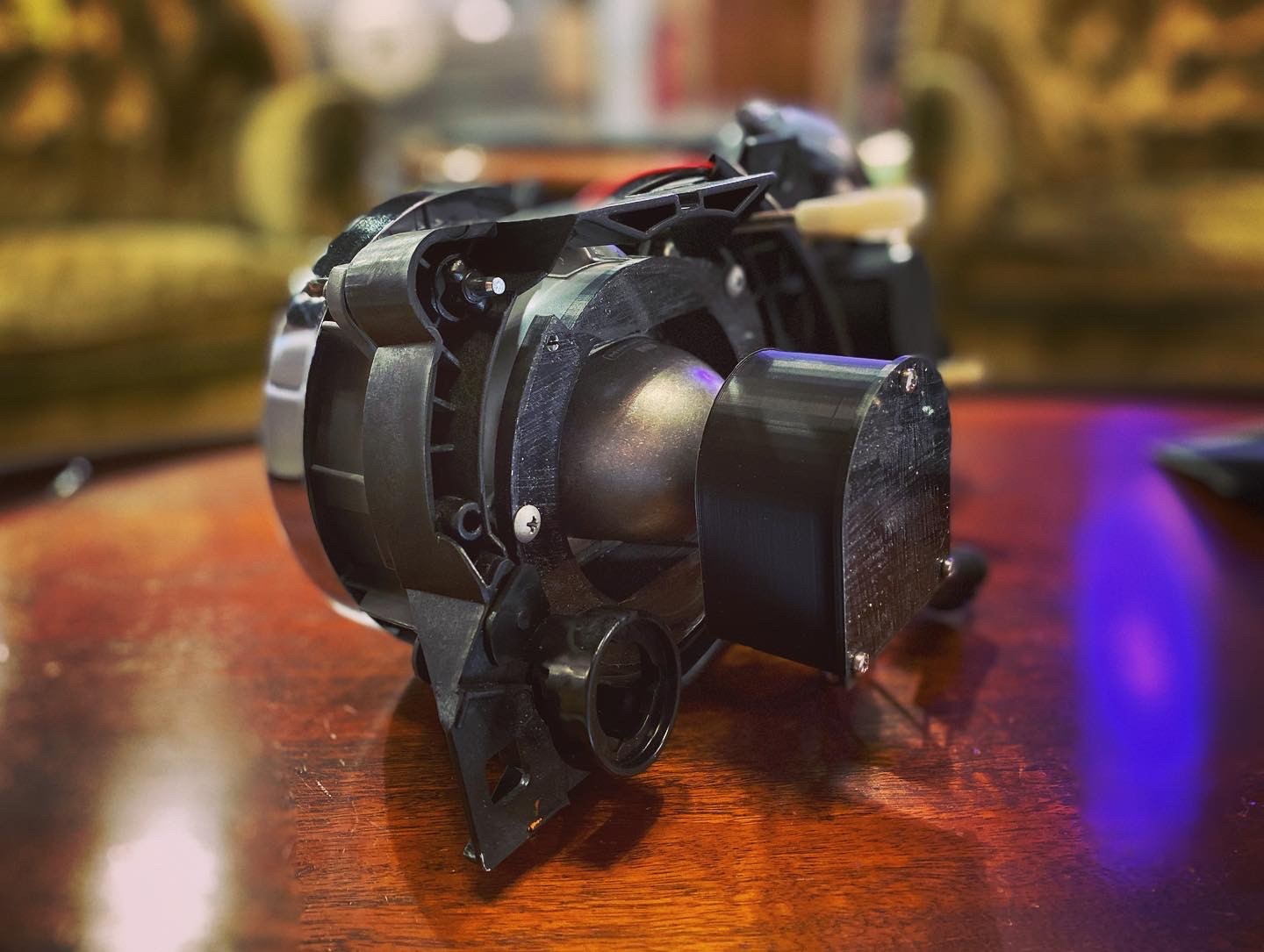

    My printers hard at work.
    These lighting adapters have been a lot of fun and really cool to see all of the reactions to them. I'm trying really hard to make them look and feel just as good as they do function.

      Dang you went all in on the print farm! That light output/cutoff looks super nice.
        #1103
        As I started making them I realized that a complete kit takes 24 hours of non stop printing to make with one printer. Since I really only have the ability to start a print on the morning and after work, it wouldn’t have been good business to do that. Plus, if the printer went down, then I’d be screwed. So yeah, I dove right in.

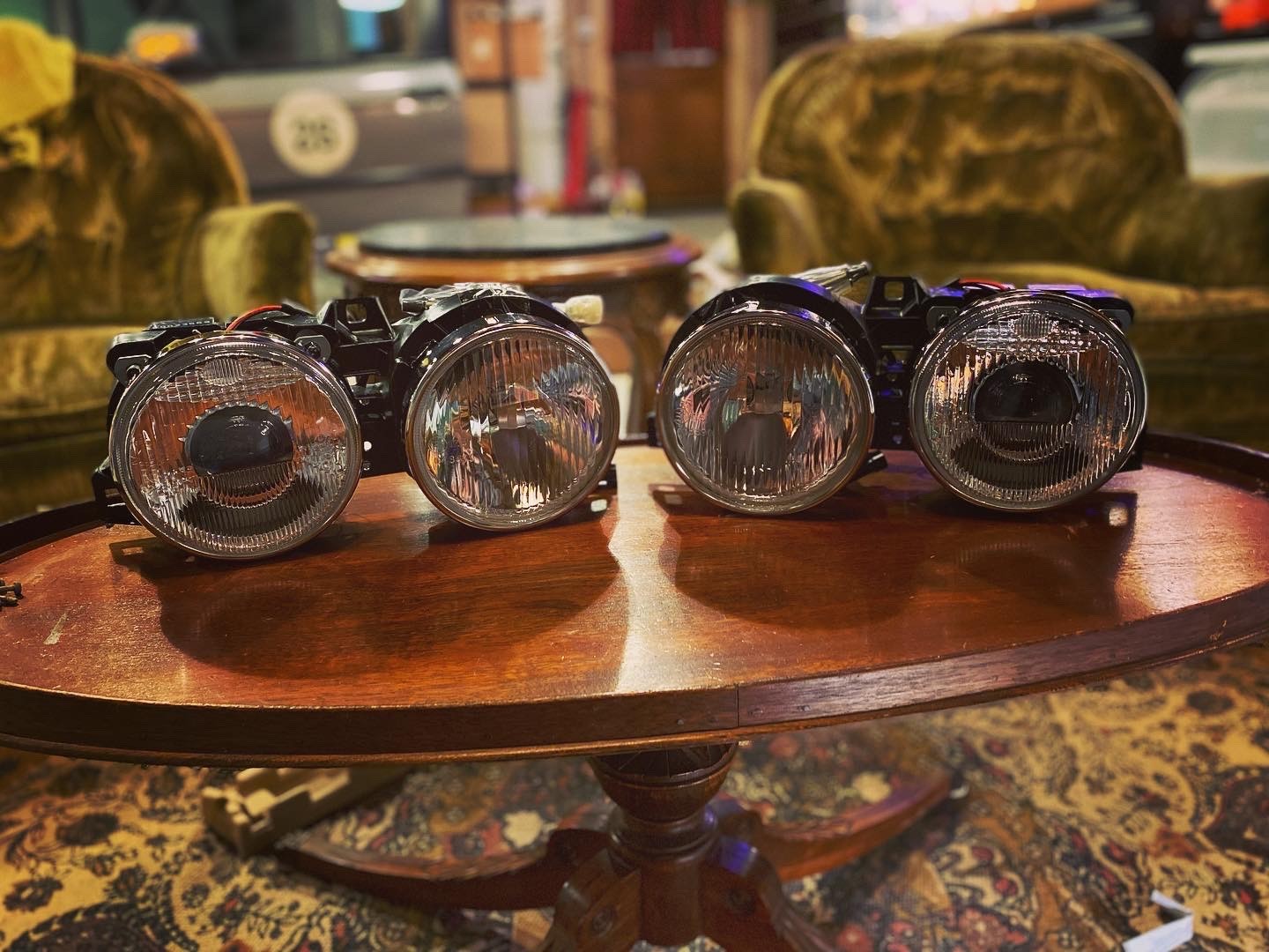

              i see you are reselling DEPO kits. just a fair warning - their quality is subpar. I can tell you are dedicated to selling a really great product, and the DEPOs are not up to those standards.  just have your customer service person ready to field those calls 😜
              a suggestion: be willing to open a set of the DEPO lights and sell replacement parts from it if someone requests. no other vendor does this. you may actually get business from this alone, and it would also support your own product. youll have to learn to disassemble (and/or make some special tools) without breaking stuff, but it doesn't take much practice.
              what i've personally seen/experienced:
              1. broken or stripped adjuster knobs (plastic is bad quality)
              2. broken glass (thinner glass than oem, cracks easier)
              3. leaking seals. (the gasket on the back bulb covers and the o-ring on the parking light are a joke)

                Yeah, I hear you. I added a note to the website reiterating that they're an aftermarket headlight and not an OEM replacement.
                I would like  to think that most people know what Depo headlights are and that they are an affordable aftermarket option/alternative to OEM headlights. The ones I've taken apart though, the quality seems fine. I'll mess with the adjusters some and doulbe check any that go out.

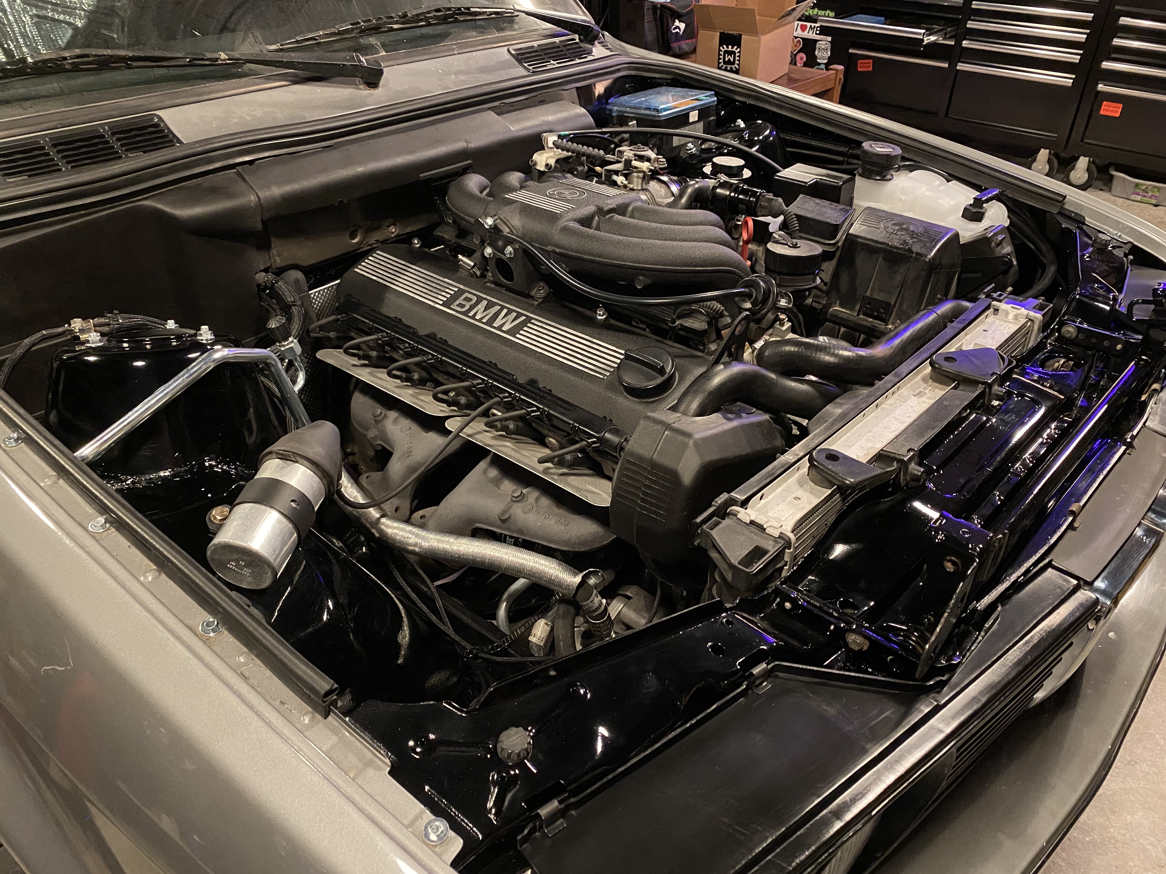

                    Not to toot my own horn, but I love how all of this came out.
                      #1110
                      It looks OEM.  Very nice job.

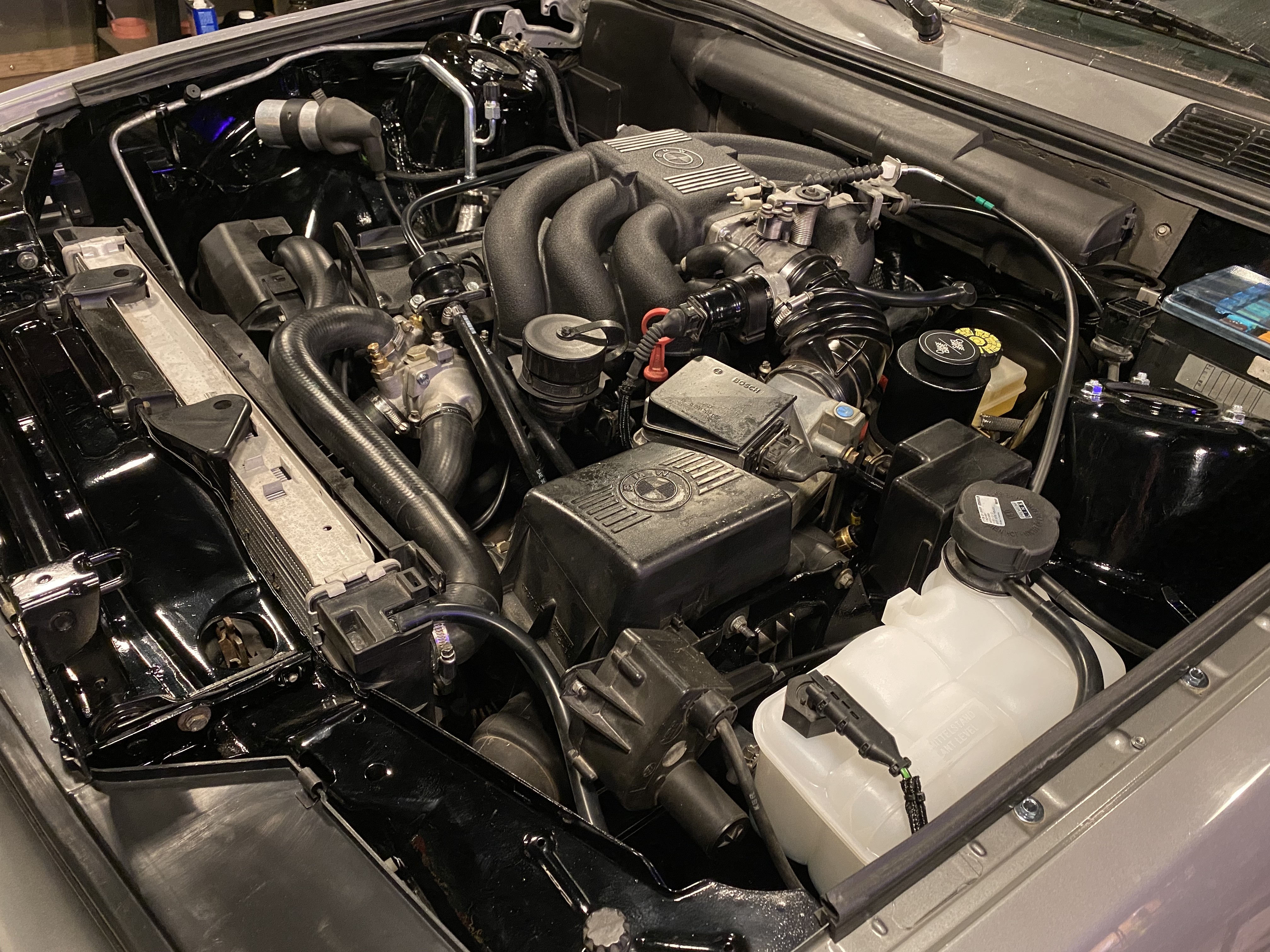

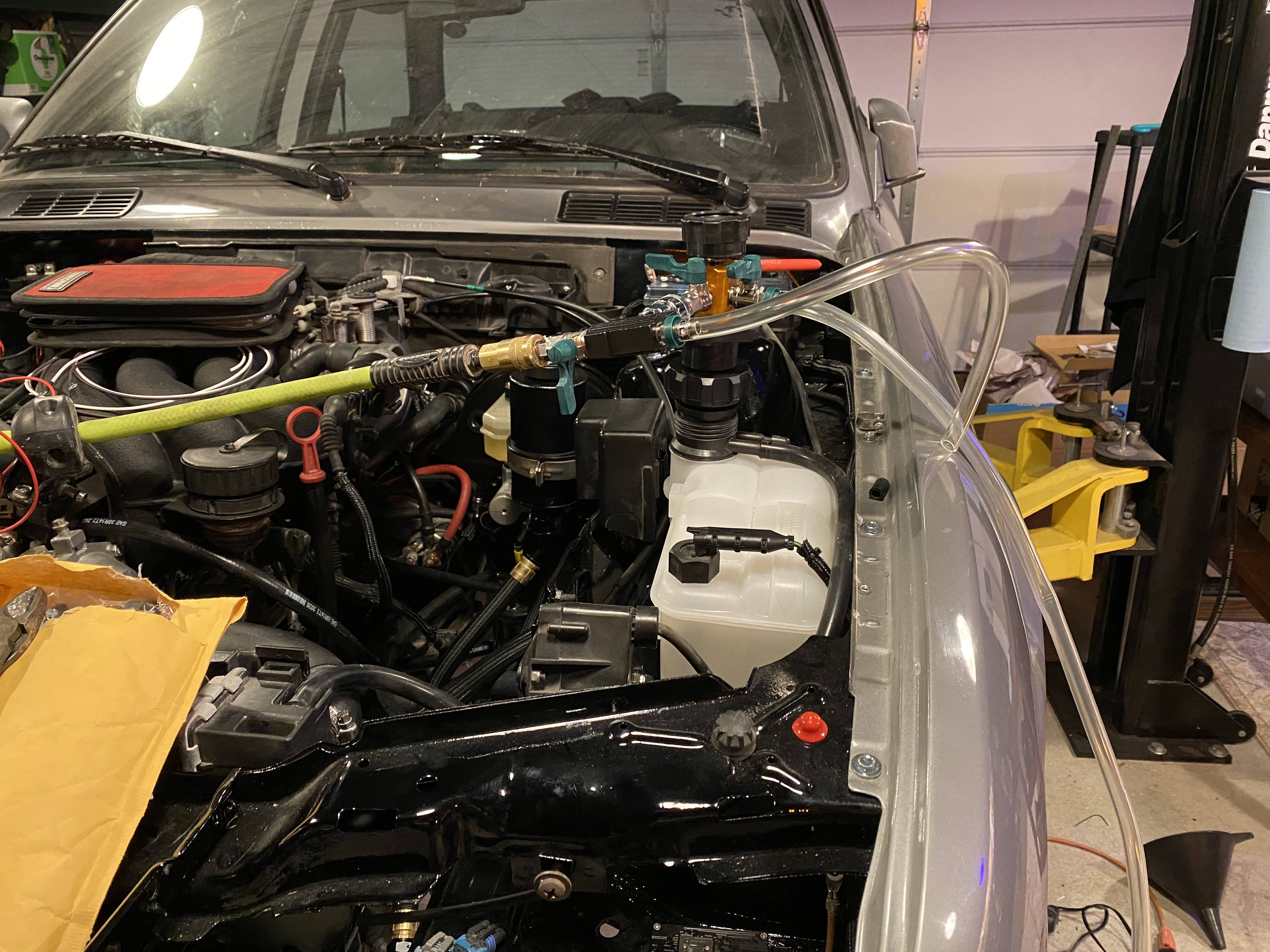

                        Tried this thing. It didn't work though due to the GAPING HOLE IN THE WATER PUMP GASKET I found after filling it up with coolant.
                        Replaced the gasket and then it worked and made filling it up really easy.
