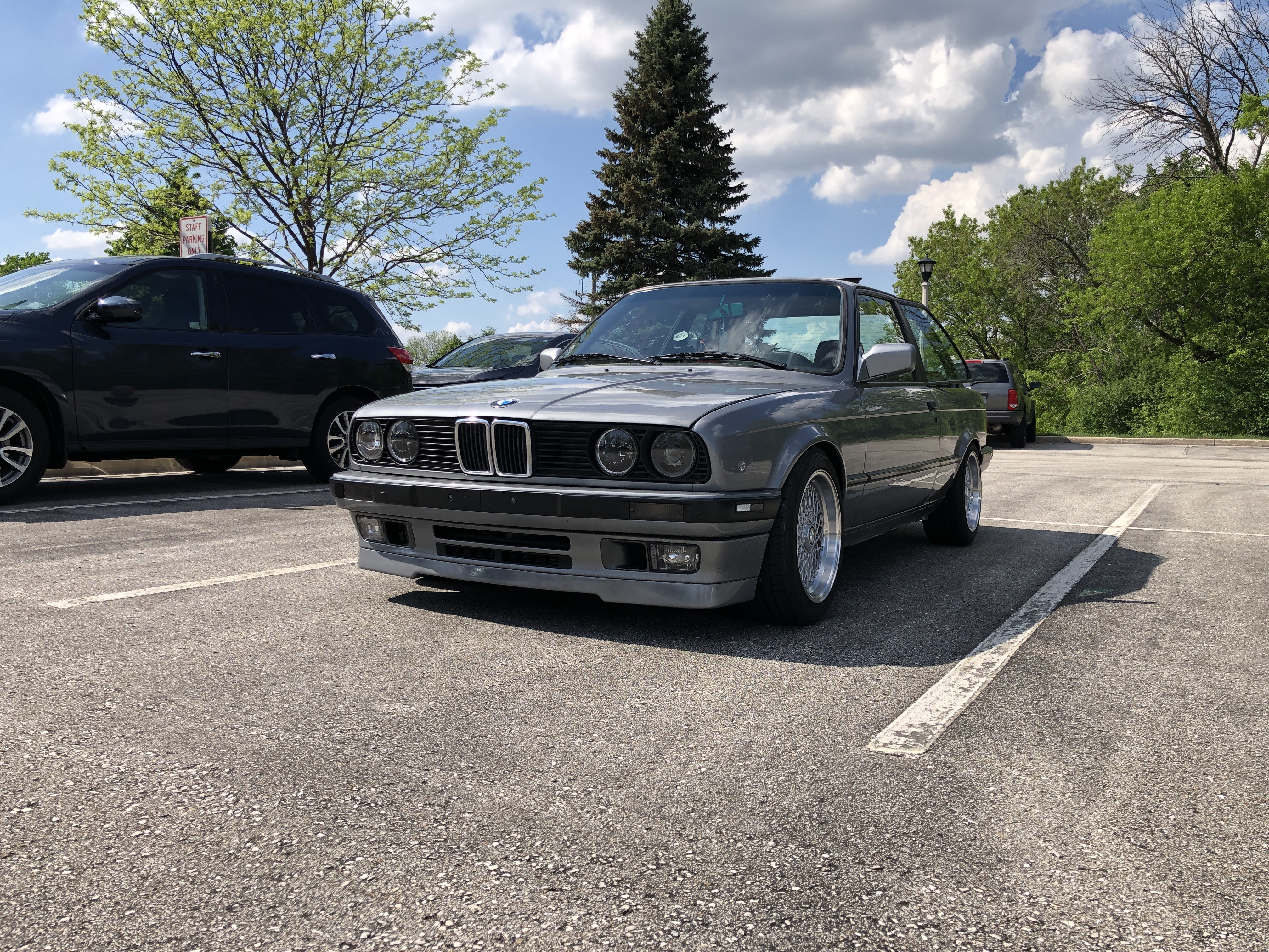

                                    Gooder picture with the new headlights.
                                    Ran great. Took it to Tom’s on Monday to align it in his garage and it turned out really good.
                                    Today’s thing was I realized the aux fan wasn’t kicking on at all. I also turned on the ac (it’s not charged yet) just to see if the fan would come on as it should. While diagnosing that tonight I realized I wired in the temp sensor plug into the cars harness wrong. Basically flipped the low and high fan settings.
                                    Once that was corrected, I could jump the plug and get high to work but not low. Started at the fuse box and traced it down to the fans wire harness. I have 12v at the body harness for the fan. But from the connector to the resistor it drops to .3 volts. Yes. Point three. The ohm readings was scattered all over but never got close to 0.
                                    Once again, a used part bites me in the ass. Now to source a new fan. I am ordering an ac manifold and vacuum pump so I can try charging it myself.

                                      Was the cut off I sold you causing problems?
                                        #899
                                        Not at all! The color of the wires are different and I wasn’t paying close enough attention and swapped the low and high signal wires.
                                          #900
                                          So you determined that the low speed resistor on the fan was bad?  I think I removed a failed resistor on an e30 once and just connected the wires.  Then when the temp sensor calls for low or high speed it will just run high speed.  Costs nothing and the fan runs on high speed right away.
