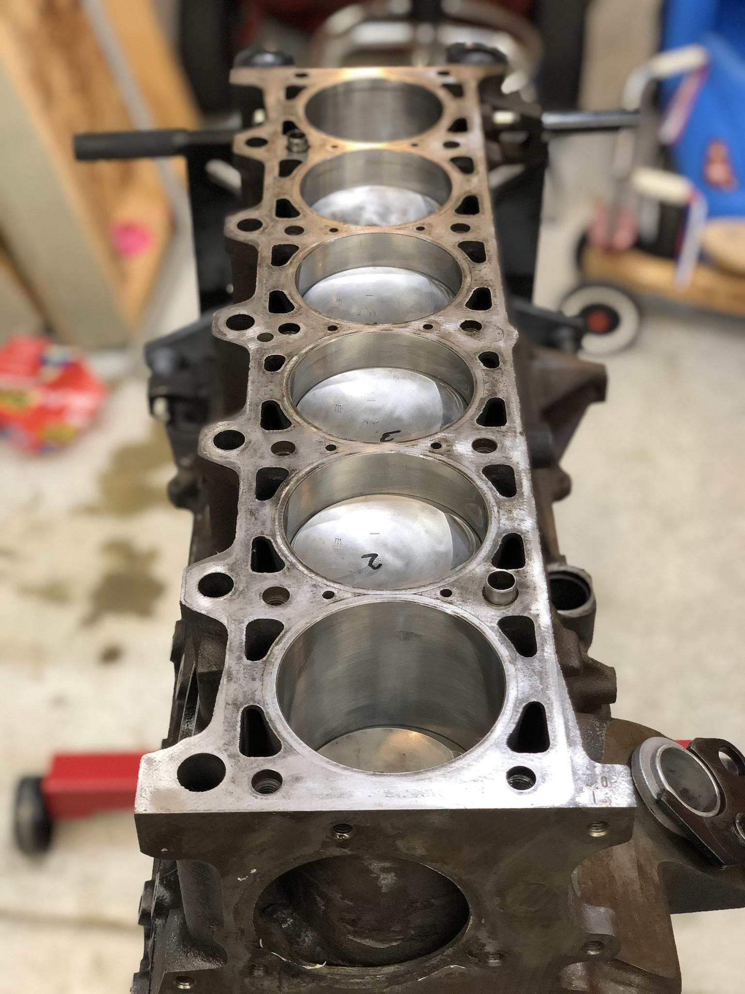

          Pulled the crank back out tonight, cleaned off the bearings, put it back in with plastigauge.
          .038 across the all 7 caps. Very healthy. At least I know now. Also got three pistons ready to go in.
            #445

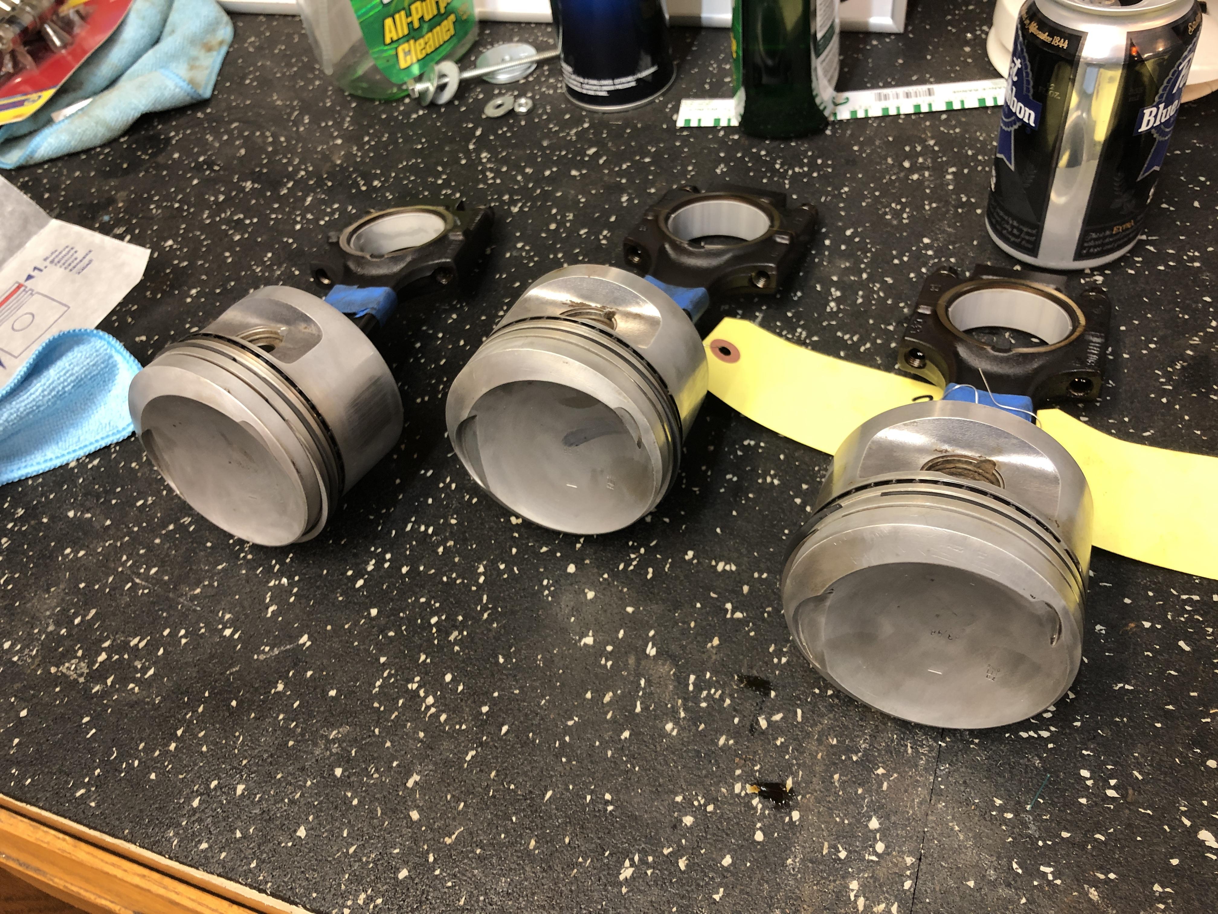

            Pistons back in. All clearances are on the bottom end of what is required in the manual.

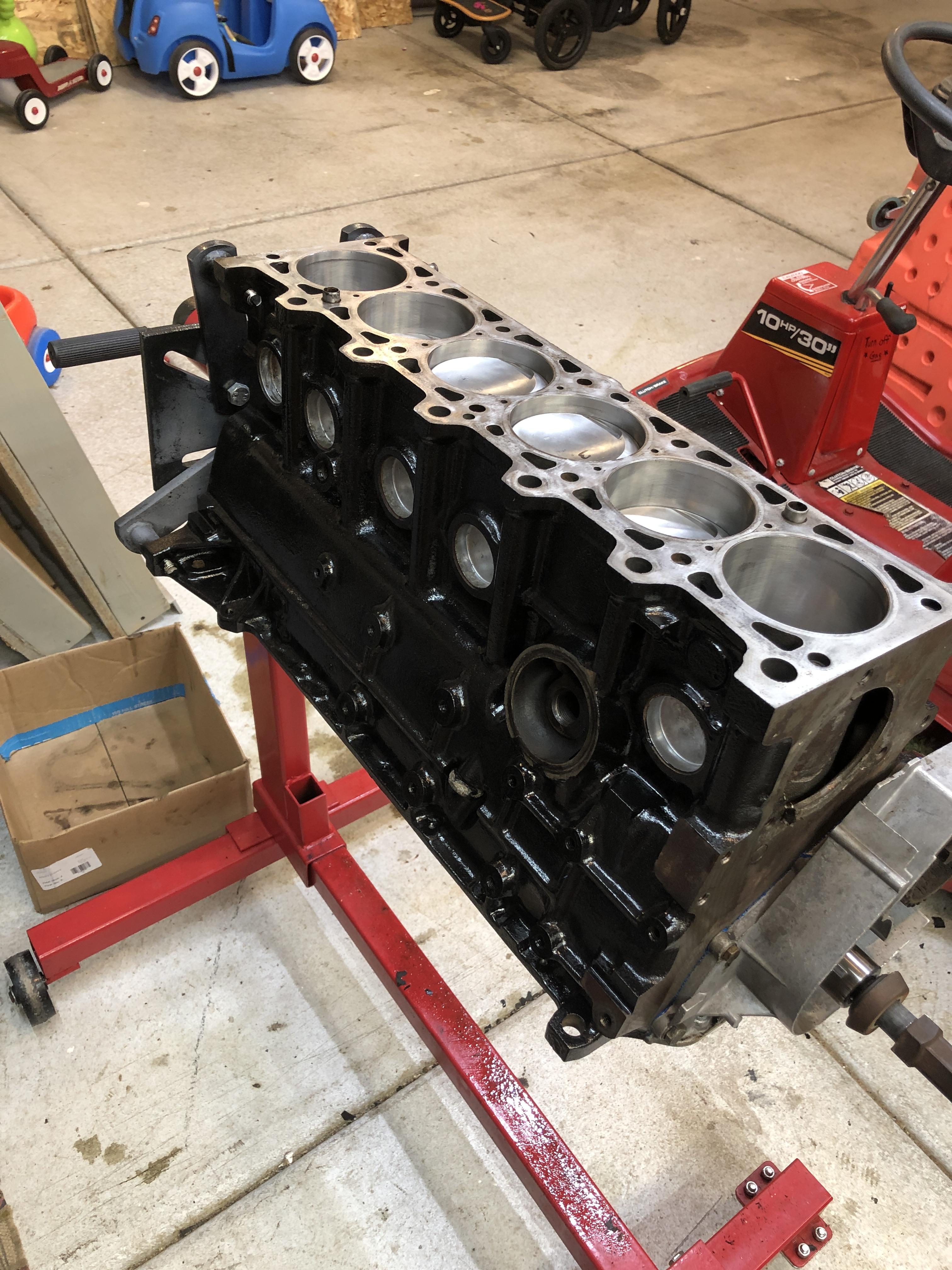

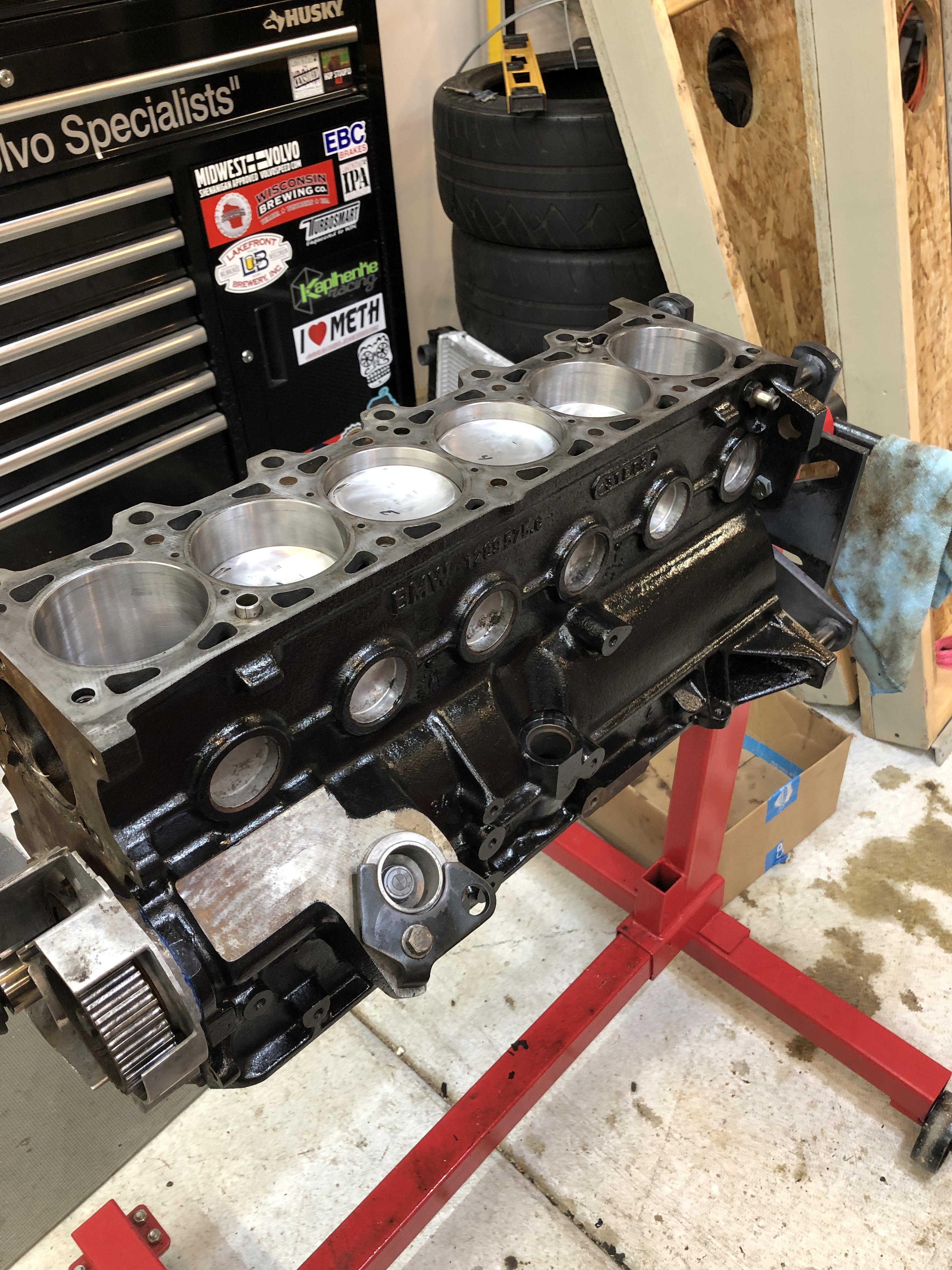

                          I wanna make sure this is right or wrong. I’m replacing the front crank seal and it looks like the outer lip of the seal doesn’t sit flush against the crank. Is this right? It doesn’t feel like it should be. It’s an elring seal.
                            #453
                            Thats fine, and on older engines it is preferable for the lip seals to ride deeper or shallower than normal to avoid riding in the minute groove that is formed on the shaft surface
                              #454
                              That outer lip doesn’t even touch the crank. The inner seal do for sure, just not the outer one. That’s okay?
                                #455
                                The actual sealing lip is further back like so.
                                Trust your gut, if you feel funny about it, redo it with a new seal and also check to make sure the aluminum seal housing is sitting flush on the block. Kind of a dumb suggestion but its the only thing im coming up with off the top of my head that could physically affect the seal position

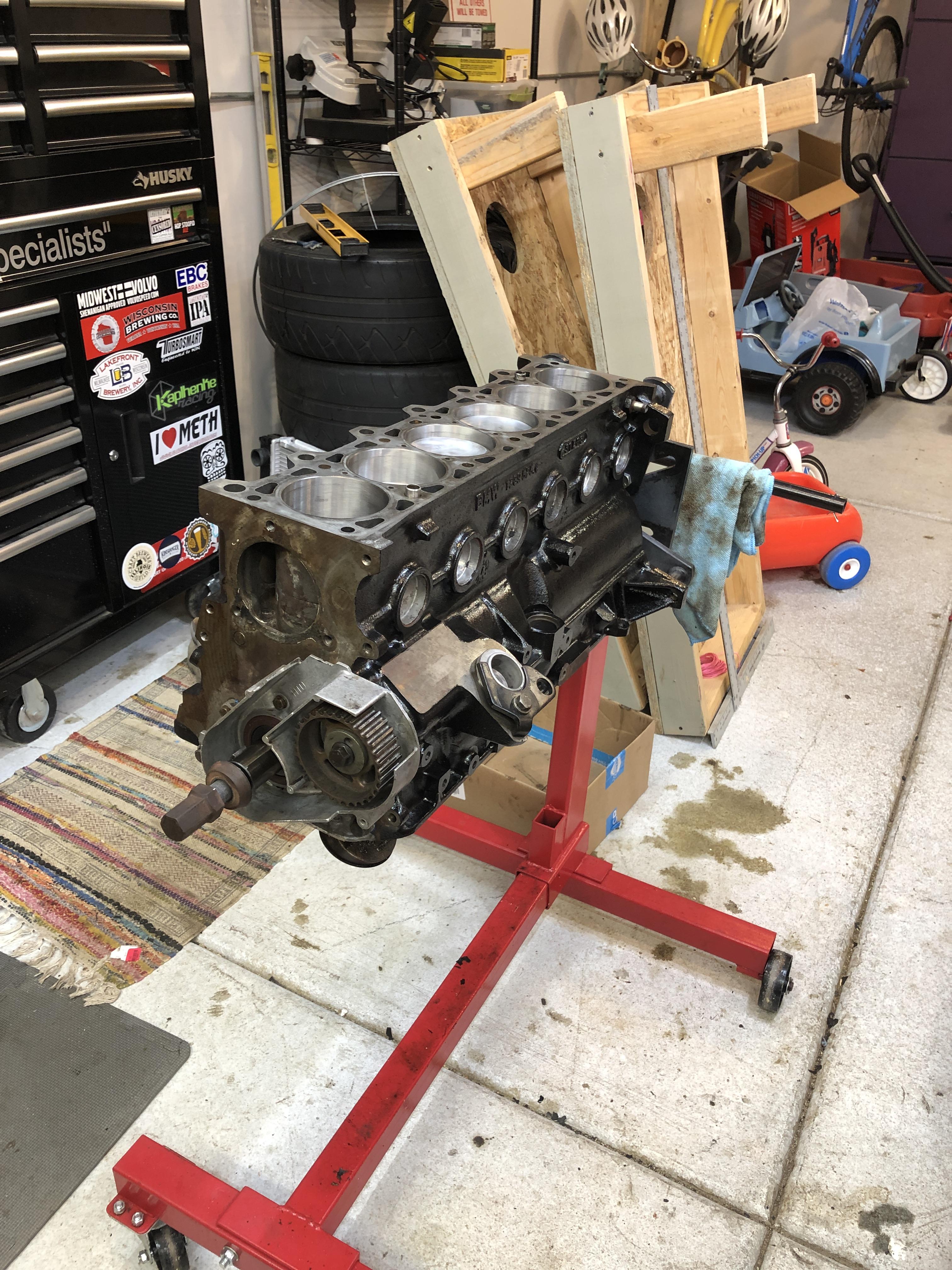

                                  Oil pump gear
                                  crank
                                    #457
                                    I took it out.
                                      #458
                                      gilber33 said:
                                      That picture helps. It’s weird to me that this one would have that gap around the outer lip but the others wouldn’t. That’s why it’s throwing me off.
                                      theres like 100 types of shaft seals, this should not be weird to you.
                                        #459
                                        This is the first time I’ve seen one that was “open” on the face like that. It’s the only seal on the m20 like that and I’ve never seen one on all of the Volvo’s I’ve owned.
                                          #460
                                          It's pretty common. A lot of hondas and aftermarket seals are like that.
