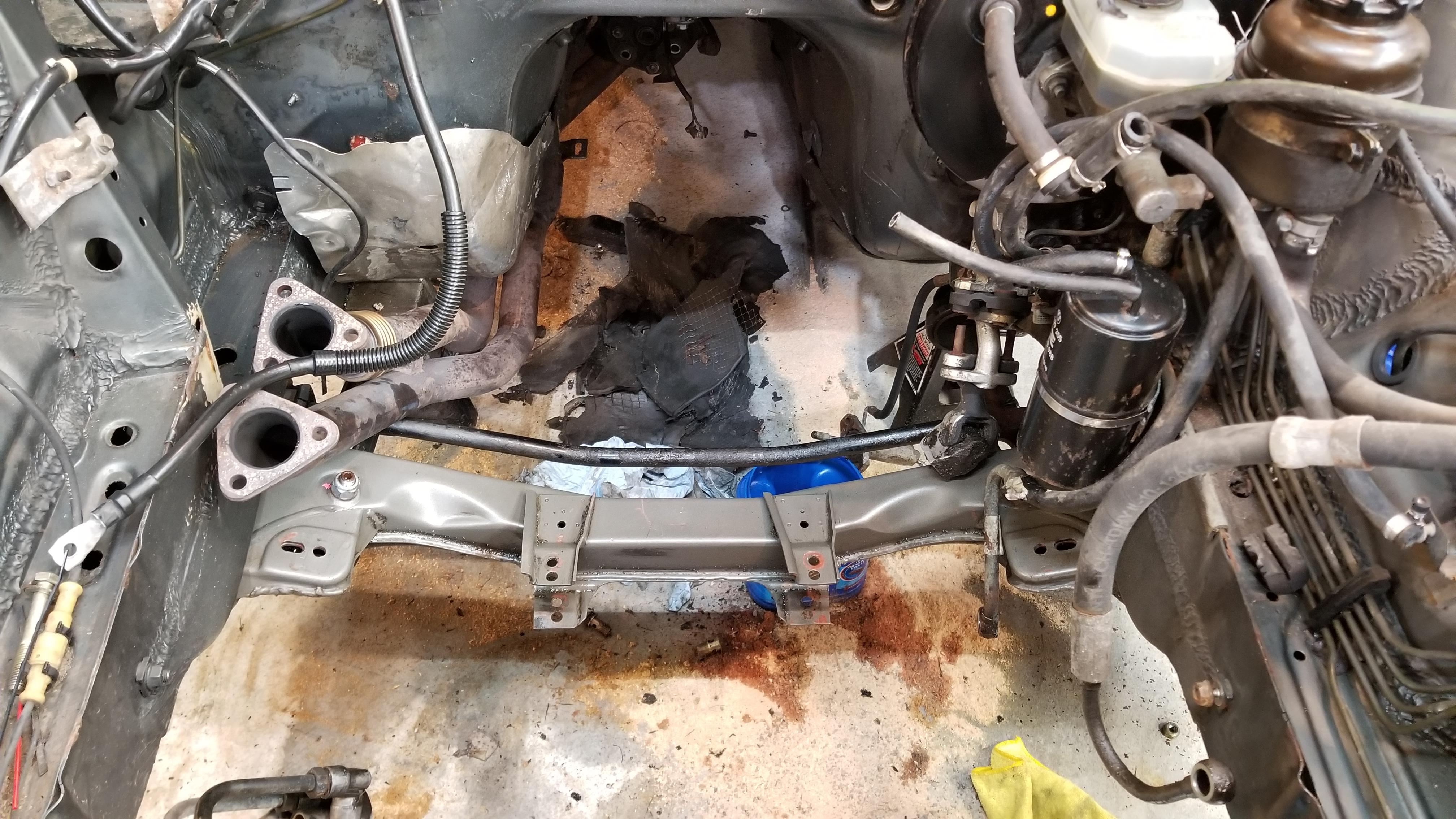

            All cleaned up. Going to spray it down with some brake cleaner and then paint it. Head is being resurfaced now, so once I have that I can start reassembling.

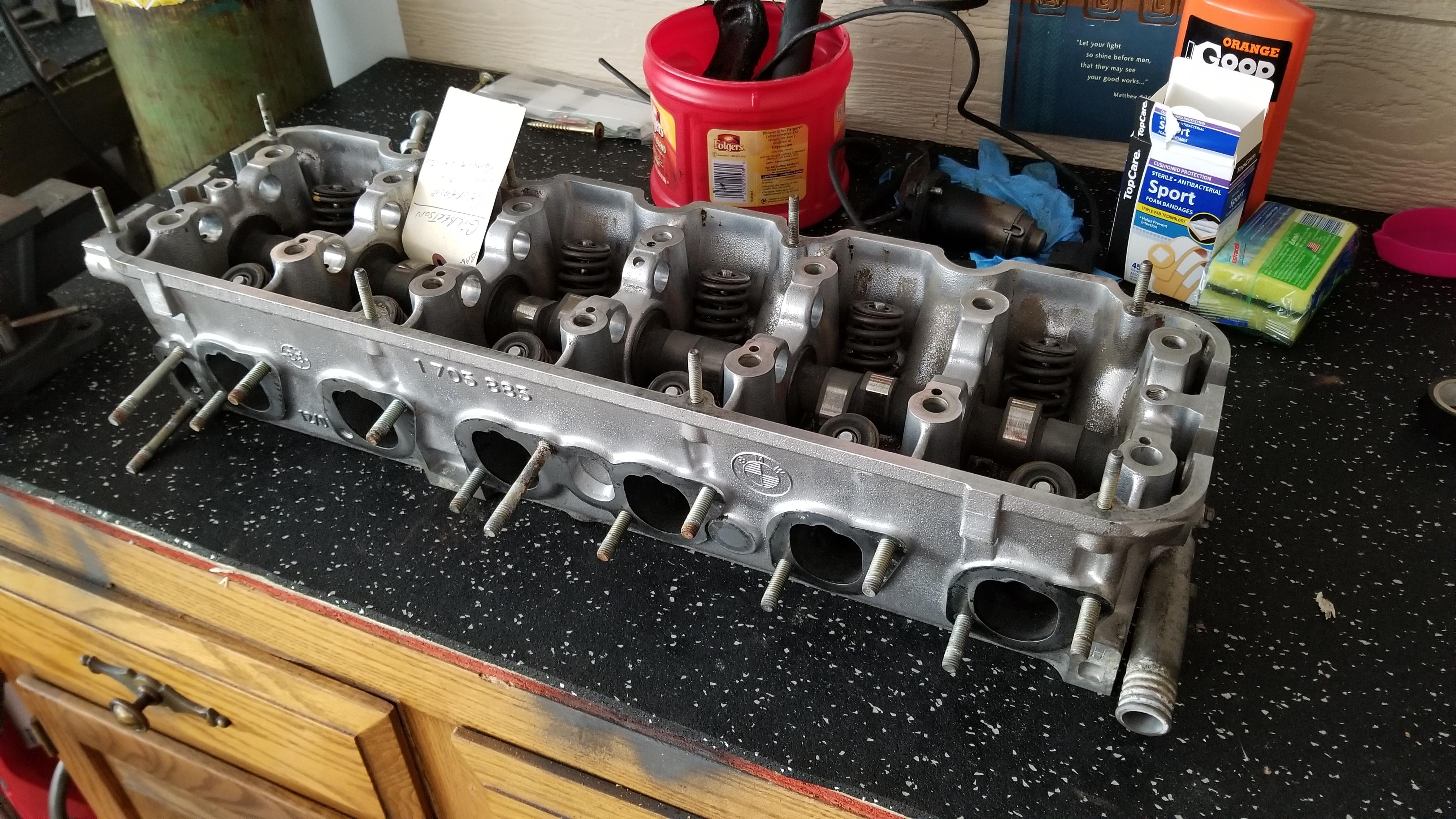

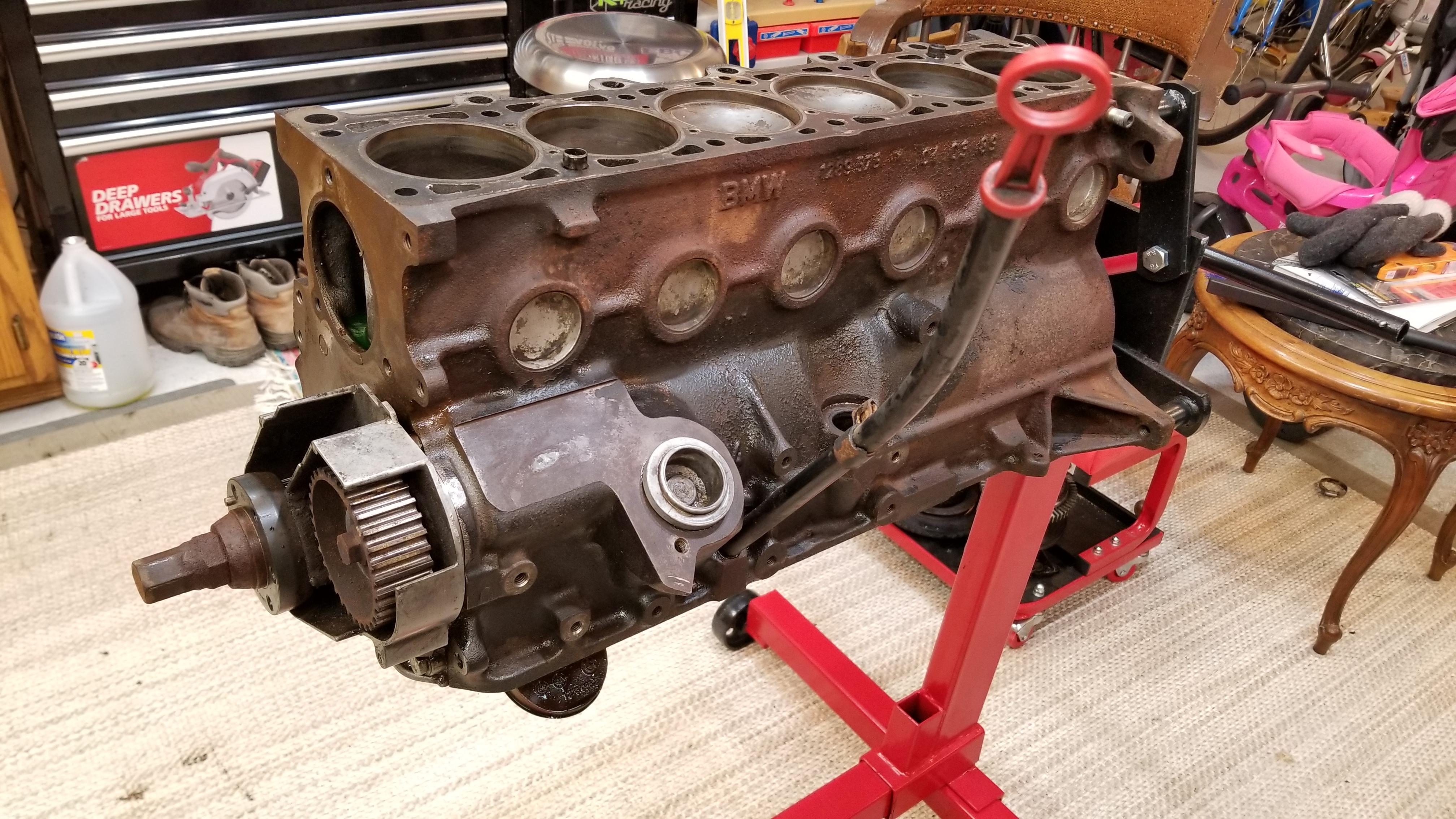

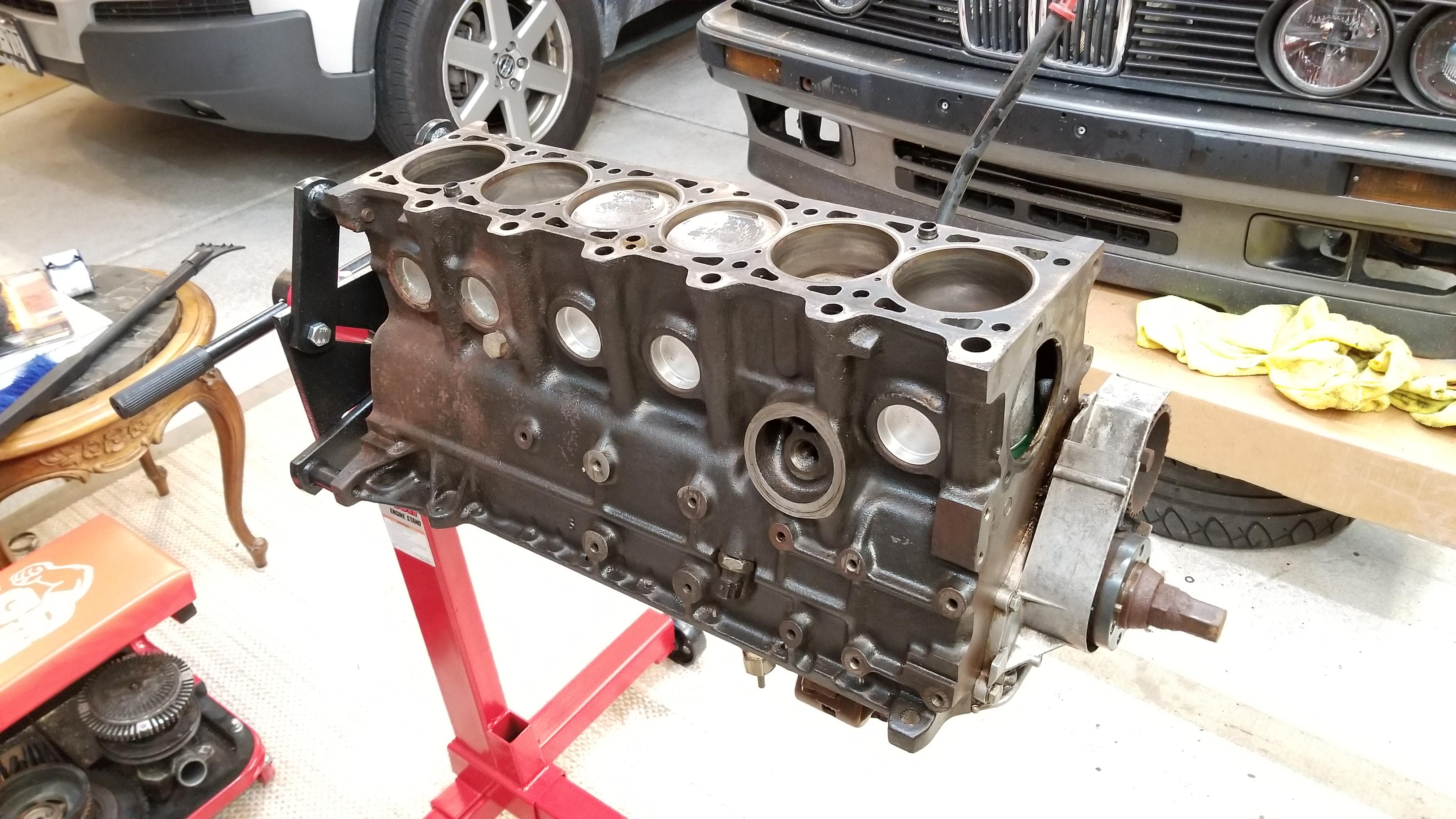

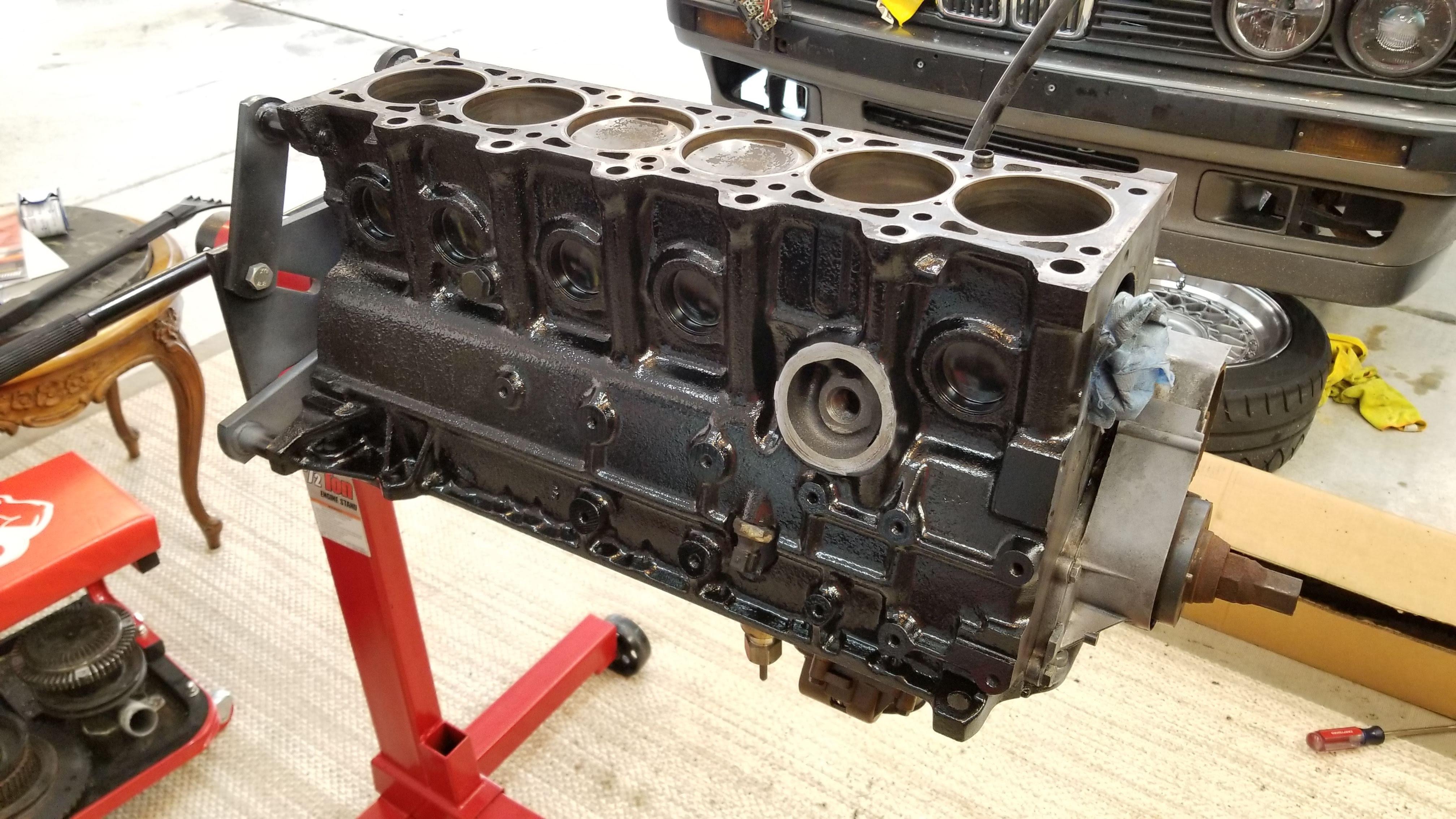

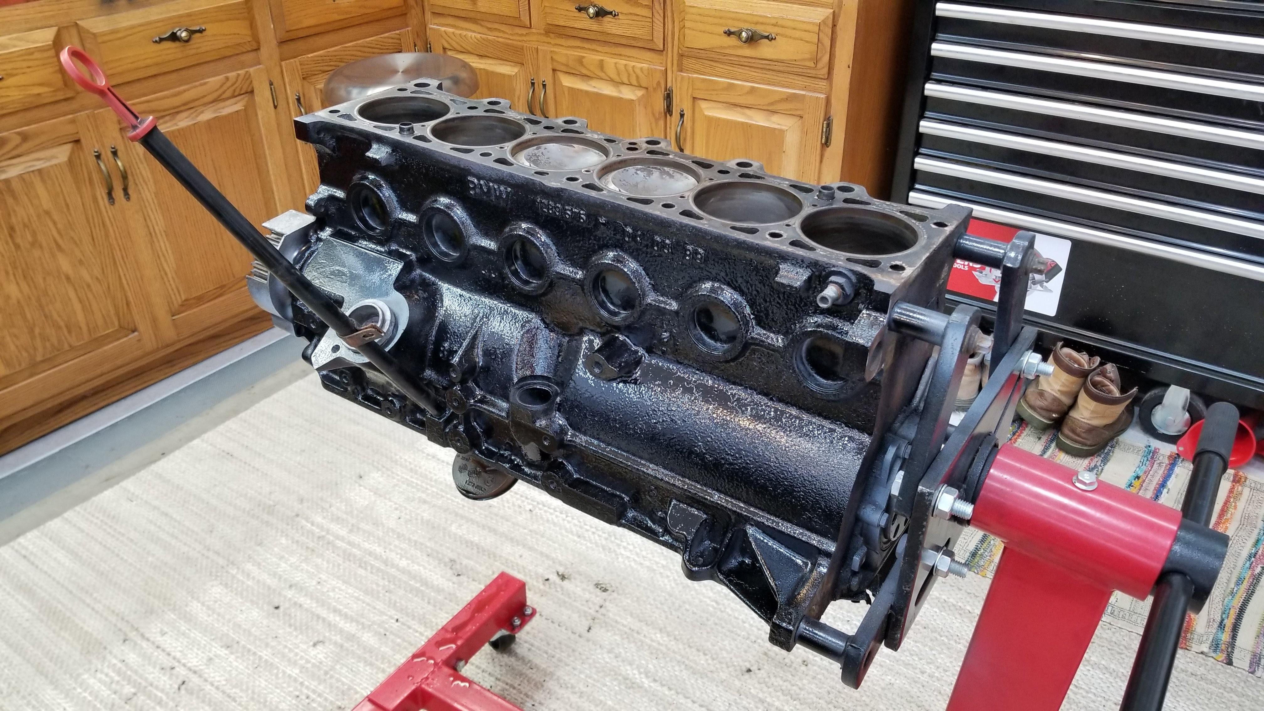

                      Block is painted. The head amid flywheel is ready to be picked up. Have a box of brackets off for cleaning and powdercoat. Need to order a couple gasket kits and then it can all go back together.

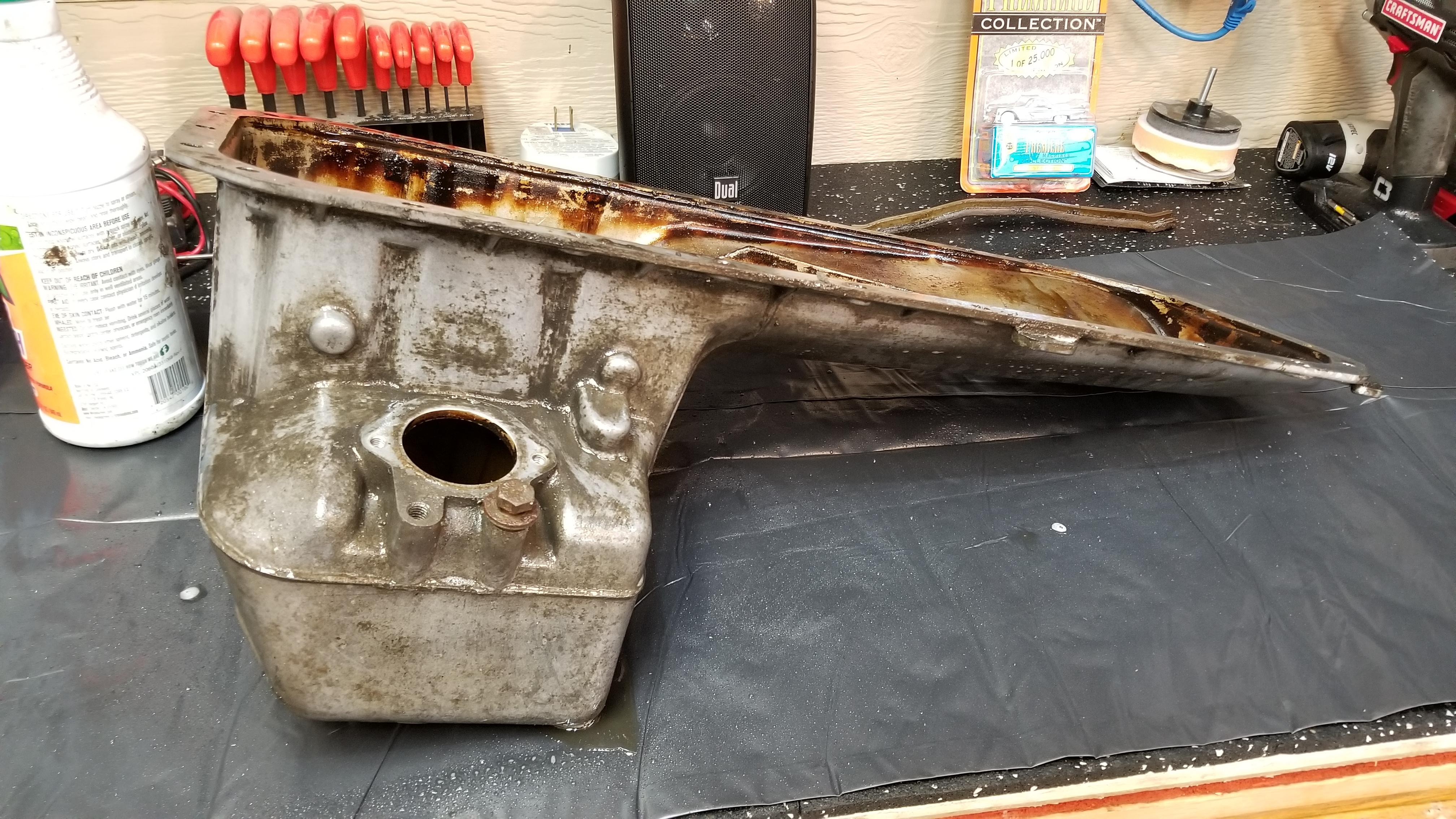

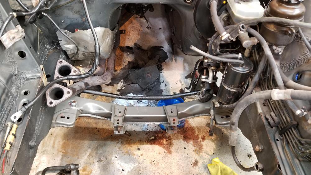

                        Just some more cleaning. Old steering rack out and deteriorated firewall insulation removed. Working on cleaning the oil pan now which is caked in oil from years of leaks.

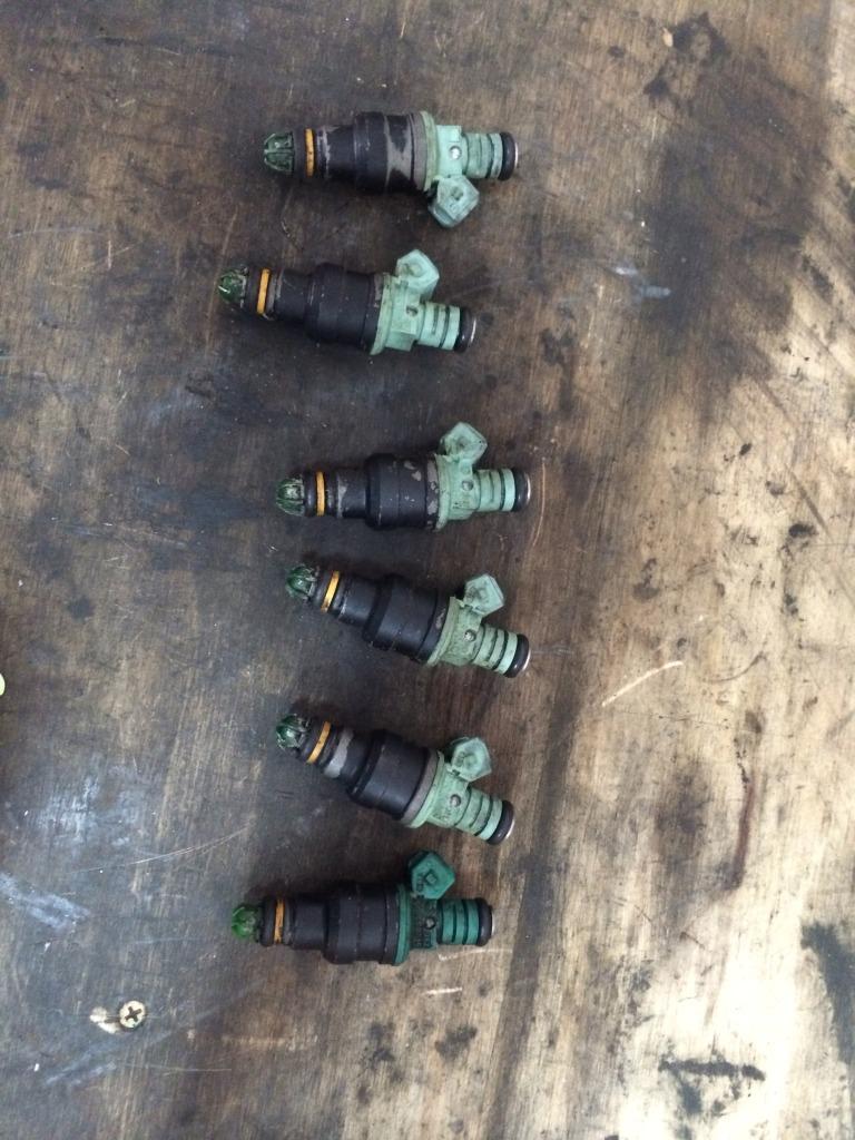

                                  So looking around at injectors I am seeing green tops and blue tops from the M50. Do you know which one I want?
                                  Edit: maybe there aren't two different colors, and the light blue I'm seeing is a faded green? I
                                    #37
                                    They are a light blue/green color. Similar color to the M20 injectors but not identical
                                      These are pretty green. Maybe it's just the lighting?

                                        I most commonly see them in the lighter green, but the darker green are also M50 injectors. Be advised that Volvo 32# also come in that dark green
                                          That bottom one matches what is in the ebay ad. That helps.
                                          The Volvo ones are a different "body". I've used them for a couple builds and that's what is stock in my R.
