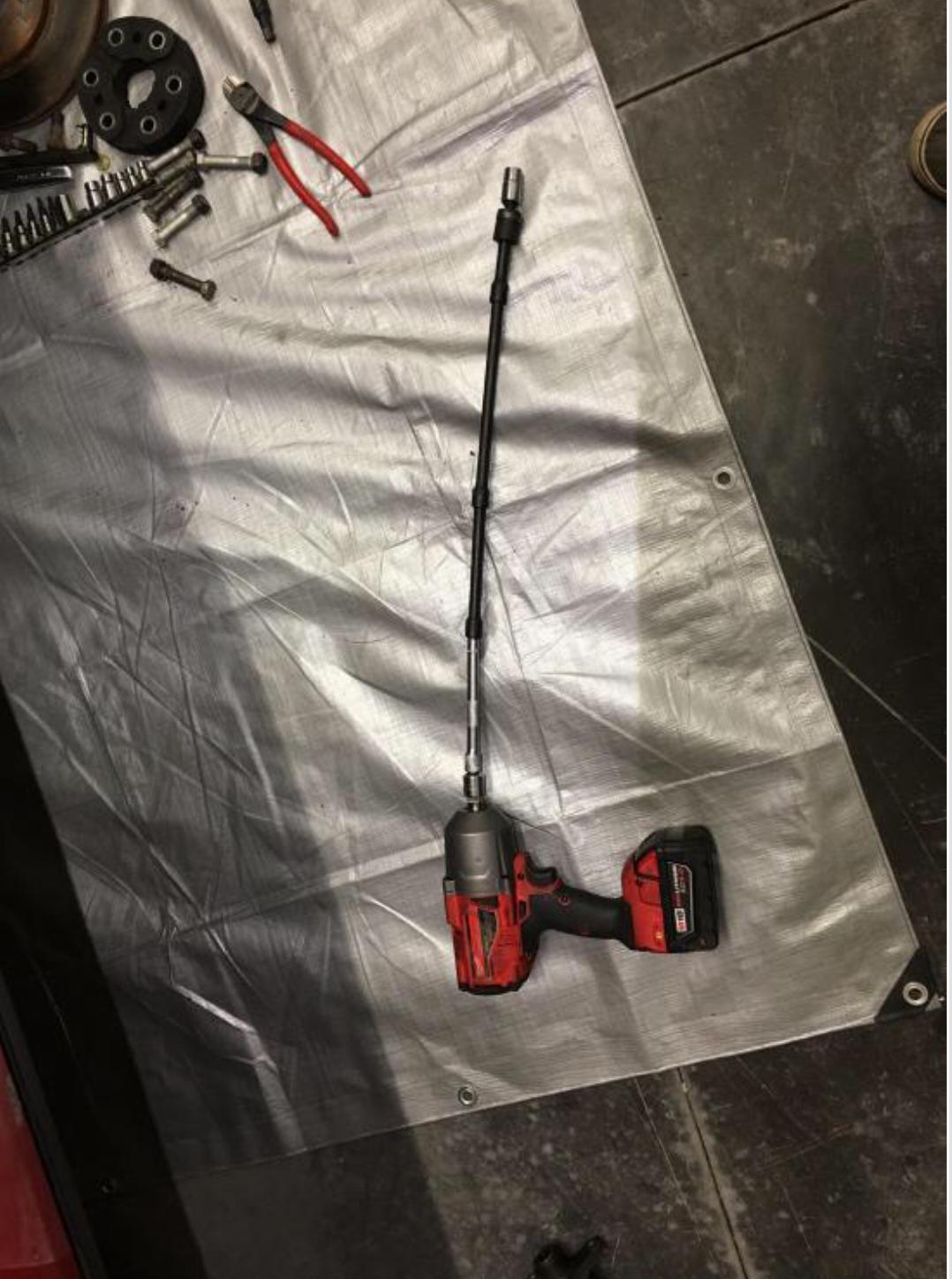

      The thing that will get that off is heat, penetrating oil, and an impact. You may have to run the nut on and then off a few times to get it to go. The other side with the stuck nut needs heat and you need a lot bigger hammer lol
      I'll give this a go. Didn't try going back and forth with the nut. Was going to use heat, but my torch was at the storage unit across town when I used it do remove the drive shaft.
      Wanted to save the control arms, so I'm assuming smashing the top of the stud with a big hammer will probably ruin those lol
      Boris3 said:
      This if you're just replacing the full control arm anyway.
      The Harbor Freight ball joint separator works on the outer instead of the fork if you want to save the boot.
      Re stuck nut: The jack under the ball joint trick works to stop the spinning but it takes a lot of pressure. Jack it up until it stops spinning (it might lift the car a bit). If the nut is rusted on solid then penetrant/heat and if that fails cut it off.
      Would like to save the control arms as the boots all look in good shape still. I had the car lifted off the jack stands with this trick, but wasn't able to apply any heat as I did not have my torch. I will give this method a try.
      Thank you for the help gentlemen.
        stuck nut: you don't want to reuse that nut, so you could just cut it off with a dremel
        stuck spindle: heat up the steering knuckle around the spindle, then strike the knuckle (not the spindle/threads) with a bfh.

            Don't hit the stud with the hammer. You hit the knuckle hard and rapidly to free up the corrosion and allow it to drop out as it is wedged in because of the taper.

              Judging by the rust around that stud, you WONT get this off without heat. There is also no way you will get this off without ruining the boot, ball joint, or both. You can buy replacement boots from the auto parts store. I got Energy suspension ones for roughly $10 for the pair I believe and the part number is in my build thread somewhere. They are much better than the oem ones.
                secondly, if you are ditching your cruise control, can I have it?

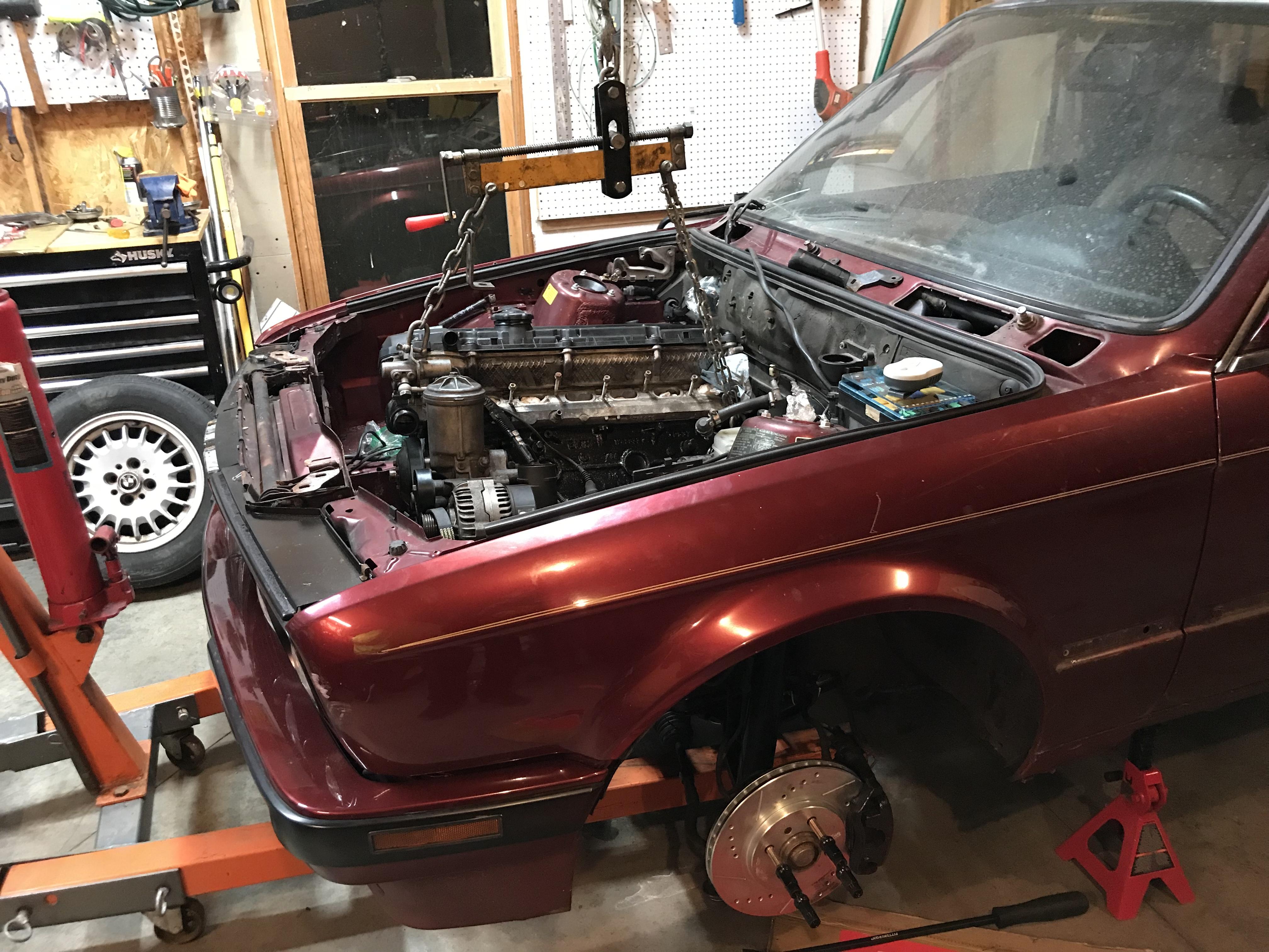

                            Made some good progress tonight. Struts, steering rack, and subframe dropped. Gonna clean up the subframe and paint it before it goes back in. Does this surface rust look concerning at all? Didn't break or crumble when I messed with it. Probably will wire wheel it, primer, and paint it. Same goes for the strut housings, it will be nice for everything to be cleaned and painted come time to reinstall.
                            Got some broken bolts to take care of now though. Broke one of the subframe bolts in the frame. Assuming I can use an EZ out or whatever that drill bit kit is. This shouldn't be that big of a deal with how space I have to work around it. I am ordering 4 new genuine BMW ones to replace them all.
                            The other ones are the ball joints from the lower control arms that have left some in the knuckle. I'm assuming I can use the same procedure for the subframe bolt by drilling it out or EZ outing it.  Is this portion of the stud threaded, or should I be able to just smash these with a hammer to remove them?
                            Pulling the steering rack, the spline came out with the steering knuckle that goes through the fire wall. Should this have been tightened at some place in there? It looks like there isn't a bolt in any of the "clamps". Maybe they don't require one, but I thought the M3 had bolts that needed to be loosened on the knuckle to pull it?
                            On the same note, is the E30 steering knuckle the one to use for the swap? or the one off the ZF rack? Watching this video on a ZF rack swap, this dudes knuckle looks completed different than what I had. I bought the spacer kit, did I miss something else?
                            Will be pulling the sway bar from the subframe so I can paint the frame. Is there any issue with giving the sway bar another coat of paint? Will also adding to the subframe bolt order are new sway bar end links and bushings to do while its all out and available. I hear the bushings can be kind of bitch...

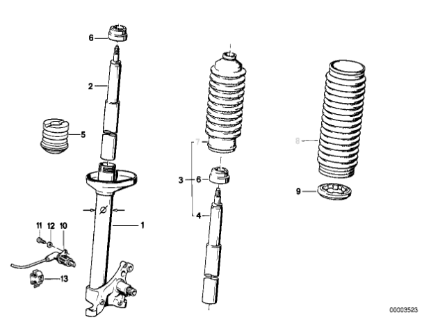

                                  Best way to loosen the locking collars on the strut housings? I was trying using a channel lock. Collars were pretty rusty so I hit them with a wire wheel to expose the threads and put some WD40 on there. Definitely gonna need my brothers help to stand on these while I try to break them loose, couldn't do it myself when I tried.
                                    #102
                                    Coilover collars?
                                    WD40 wont help much for penetrate. Grease or anti-seize would help about 1% on those ball joints. I assume by the time you revisit those anything you put in there will be gone.
                                      #103
                                      Jdesign said:
                                      Coilover collars?
                                      Apparently I didn't attach the picture.
                                      It's number 6 in this diagram. That threaded collar thing that holds the strut in the strut housing. Not sure what the best way is to loosen this up. I've read pipe wrench or channel locks.
                                        #104
                                        If you totally can't get it off you can always cut a slit in it to split it and get a new one.  Rather than damaging the strut housing trying to get it off.
