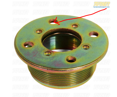

                        Best way to loosen the locking collars on the strut housings? I was trying using a channel lock. Collars were pretty rusty so I hit them with a wire wheel to expose the threads and put some WD40 on there. Definitely gonna need my brothers help to stand on these while I try to break them loose, couldn't do it myself when I tried.

                            Apparently I didn't attach the picture.
                            It's number 6 in this diagram. That threaded collar thing that holds the strut in the strut housing. Not sure what the best way is to loosen this up. I've read pipe wrench or channel locks.
                              #104
                              If you totally can't get it off you can always cut a slit in it to split it and get a new one.  Rather than damaging the strut housing trying to get it off.
                                This is what it currently looks like. Not sure where to cut to get access that would alleviate the situation. Maybe cutting the top off and then cutting it from the inside? Would like to bet to just unscrew it. Gonna try a pipe wrench, heat, and some PB blaster or something.

                                  The collars on my strut towers were pretty stuck, and a channel locks just chewed up the outside flange, didn't have a big enough pipe wrench, and I was scared to do any cutting. I secured housings in a bench vice so that they couldn't rotate, and used a chisel punch and a BFH after some extensive PB blaster soaking. You can get the corner of the punch into one of the holes on the collar nut, point it in the direction that your hammering will unscrew it, and then it should break loose with a few good whacks.
                                    I will have to double check, but the collar didn’t look like it have any holes or anything in it. Just like a thin hex pattern on the top of threaded part. I saw a video of someone doing the hammer method, but it looked like the collar had a groove in it that was design for that.
                                          ?ui=2&ik=183ae23c86&view=fimg&th=1649411
                                          I thought it threaded on the outside, my bad.  Don't pay attention to the e36 guy...
