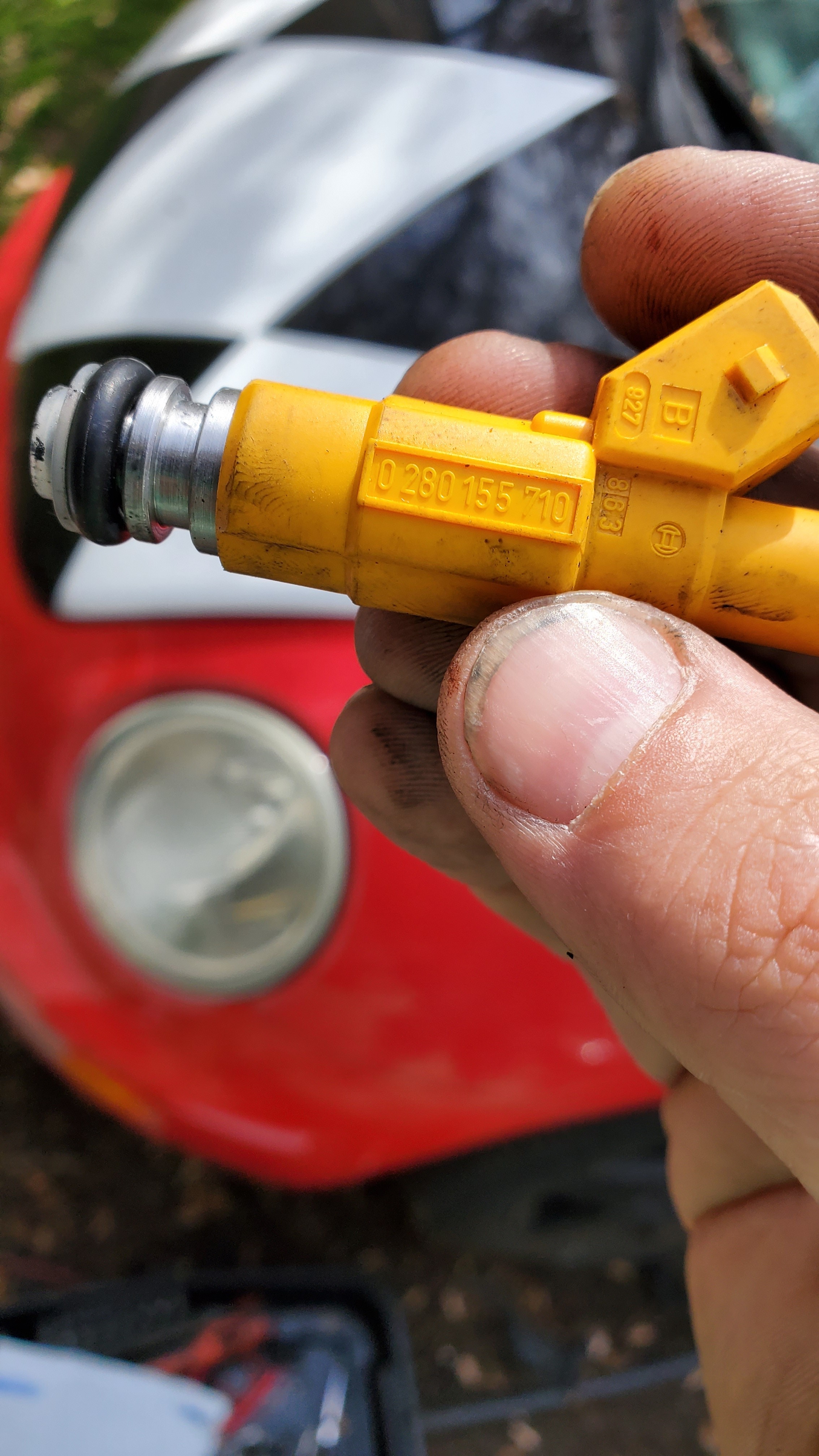

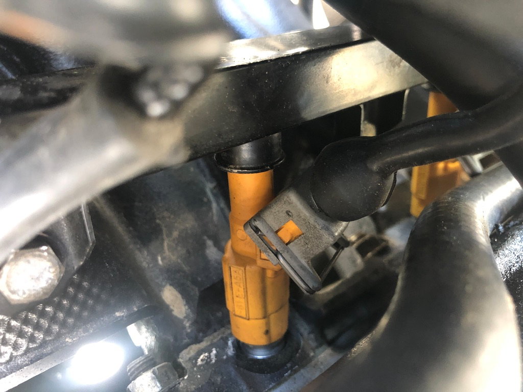

      @B C I had a mechanic friend install the injectors and chip today and we cant get the thing to start up. Any chance you have 15 min to chat tomorrow?
      Tune: http://www3.sympatico.ca/mdsylva/products.htm
      Injectors: https://www.ebay.com/itm/Set-of-6-OEM-Genuine-Rebuilt-Bosch-for-1987-1998-Jeep-4-0L-0280155710-/254466524692 . They seem to fit fine and have no leaks.
      same part number as: https://www.ebay.com/itm/BMW-E30-E34-E36-M20-M30-M50-19lb-injector-upgrade-Genuine-Bosch-/292975028671

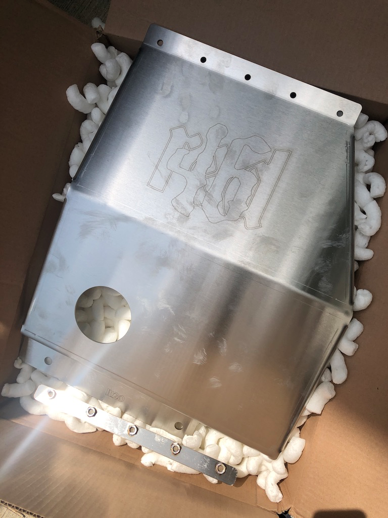

        How’s the Red 46 skid plate treating you? I’ve looked into, would be nice for piece of mind, but the M20 oil pan isn’t nearly in the way as an M50 swapped car is.

          my checklist in some kind of order of easiest to hardest:
          -press down on fuel injector electrical “rail” to make sure all connections are secure. If any preload exists in the plastic “rail” it may not snap down on all injectors or may pop up
          - if the round injector harness connector under the manifold was disconnected (centered below the throttle body near the block) check that it was re-connected
          - usually the pcv hose that runs from the throttle body to the valve cover needs to be removed to pull the fuel rail, ensure that is secured and not cracked/leaking
          - if the intake boot was removed to gain access to the injector harness plug, ensure the intake boot is on and the throttle position sensor connector on the underside of the throttle body is connected.
          - disconnect the positive terminal on the battery and touch it to ground to drain the capacitors, then reconnect to reset the ecu  to allow new fuel trims to be established with the new injectors

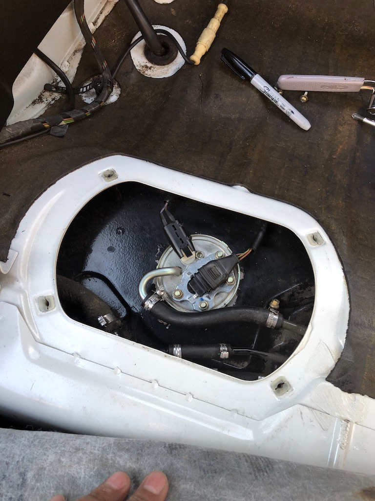

          -pull the fuel pump fuse/relay (either or). Listen for the injectors to fire by feel/sound to ensure they are all firing
          -if fuel hoses were removed for removal of fuel rail, remove hoses and verify feed and return lines were not switched

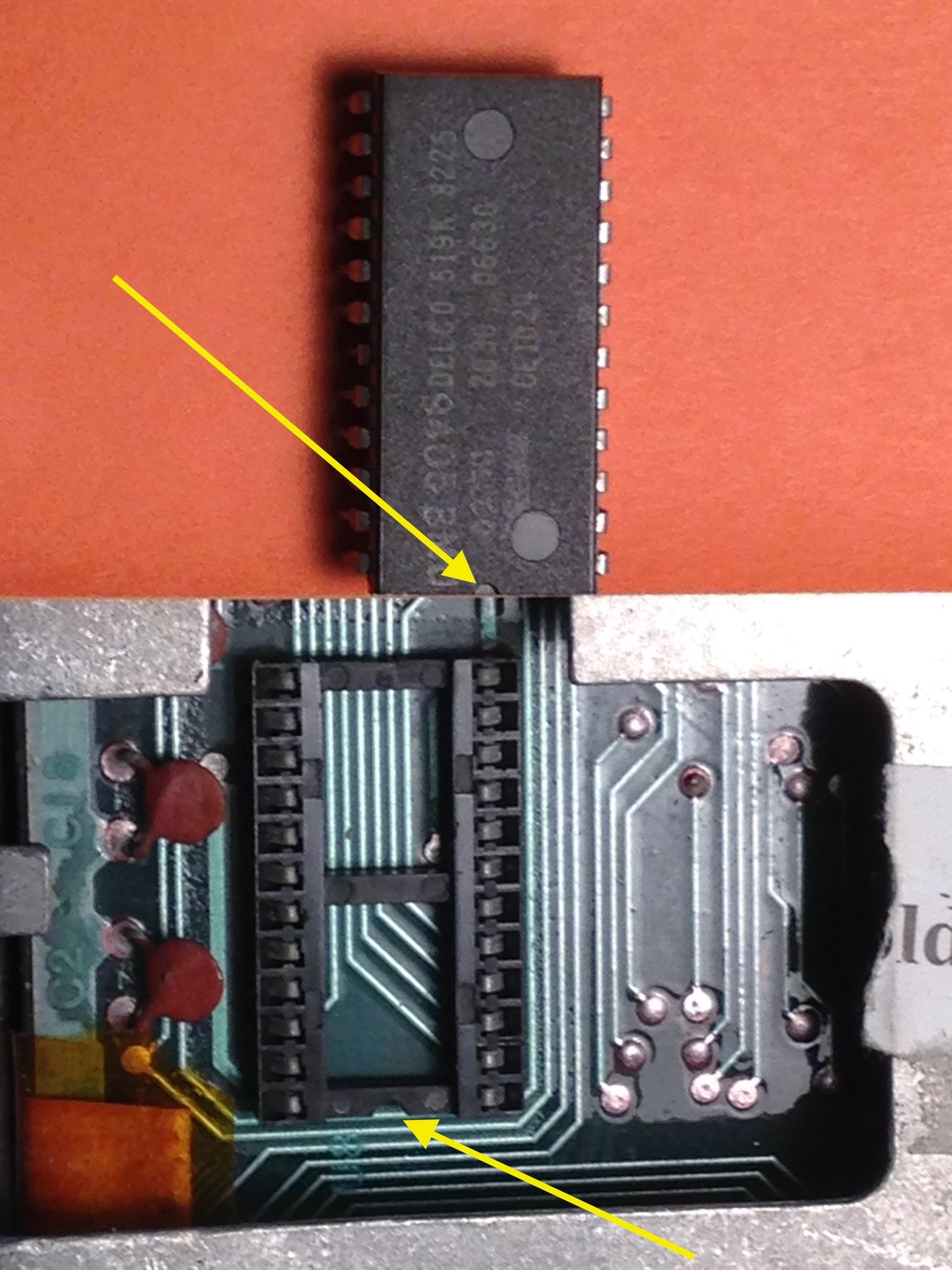

          -check to ensure the chip was installed i  the correct orientation. If instructions came with the chip it would likely emphasize the correct chip orientation. The EPROM and socket have a corresponding notch on one end that are supposed to match up.
          if its installed backwards, bad news, the chip is toast.

            I will go down this list tomorrow, a few of the checklist items that I've crossed off:
            Electrical connectors are all secure and in order, according to wiring diagram.
            Round Injector harness plug was never disconnected.
            PCV hose secure to valve cover(non-original, generic hose, with very slight kink underneath manifold).
            No intake boot removal.
            Fuel hoses were removed- return hose is about 14" longer than hose to regulator(can't mess that up)
            I installed chip according to specifications, however, I tried to start the car prior to chip install with no luck.  I figured, let me see if this idles, then install chip.
            I checked wiring diagram before installing chip in ecu.
            I will check the fuse and relay first thing in the morning, and disconnect the the positive terminal(only had negative disconnected due to very corroded 8mm @ positive terminal).  I didn't want to disconnect the positive terminal and have to replace that.
            I will also remove ECM for verification, but again, issue was before ECM removal.
            Thanks so much for the help, B C.  I am an Audi tech from BMW, Volvo and Porsche beginnings.  Glad to be here.  I may have one or two posts, from the before-time.  I am confident to get this car optimal, as I drove it in from Varun's place this morning, with no major issues (albeit a slightly lumpy idle).  It does need plugs, which I'll be sourcing from local auto parts stores(Bosch, or NGK, according to forum), and will update with results likely around noon.  I want to swap back in the stock injectors, and witness it fire up, after the other tests.

              to note: i bought injectors from ebay and received a set with multiple DOA injectors.
              also to note: if the car ran before you worked on it, than didnt run after, SOMETHING YOU DID changed the running state, so dont bother looking elsewhere. there are coincidences, but very very rarely.

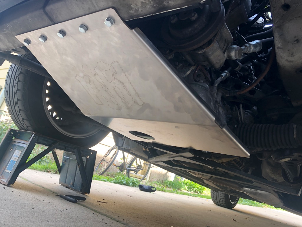

                Its been great. My car is lowered and I've definitely hit it a couple of times. I really like it because it works with the lower bracing I have in place.
                  #58
                  Do you have the x brace?

                    #59
                    Yeah Iv got this below: https://www.garagistic.com/products/garagistic-e30-x-brace-cross-brace?variant=31013538824291&currency=USD
                    And this on top: https://www.garagistic.com/collections/e30-performance-parts/products/e30-front-strut-bar
                      #60
                      Nice, I was thinking about going for the same setup with the x brace, strut bar, and oil pan cover.
                              So, I double checked that I had the ECU chip in correctly. That was good.  I went ahead and swapped back stock injectors and it fired right up.  I left my volt meter at work along with electrical test tools, but I am positive something is wrong with these injectors.  They definitely look like the Bosch injectors and have the same PN as the popular 19lb injectors for E30s, 0 280 155 710.  Also have a Ford logo on them.
                              She runs now, I have a few more little things to wrap up in this car and Varun told me I could take it on a short drive, I'll be begrudgingly giving it back to him today, as this is such a beautiful vehicle and drives so nicely.  Thanks again to B C for the checklist, as I triple checked my work, as any decent technician is going to think "what did I do wrong, what did I do that could cause this", a bad technician will blame the parts immediately.

                                  Ordered some E30 M20 specific ones from a known BMW injector seller. Lets see if round 2 goes better.
                                  https://www.ebay.com/itm/BMW-E30-E34-E36-M20-M30-M50-19lb-injector-upgrade-Genuine-Bosch/292975028671?ssPageName=STRK%3AMEBIDX%3AIT&_trksid=p2057872.m2749.l2649

                                      Quick update.
                                      Returned the injectors that didnt seem to work and bought a similar set from Bimmer Baron. Car fired right up after installing the new injectors on both the stock and tuned ECU. According to @jcw0101 there is a noticeable difference in power delivery and I cant wait to take it for a spin this weekend.
                                      Thanks for everyone who helped troubleshoot and provided advice. @B C, @straight6pwr, @jcw0101

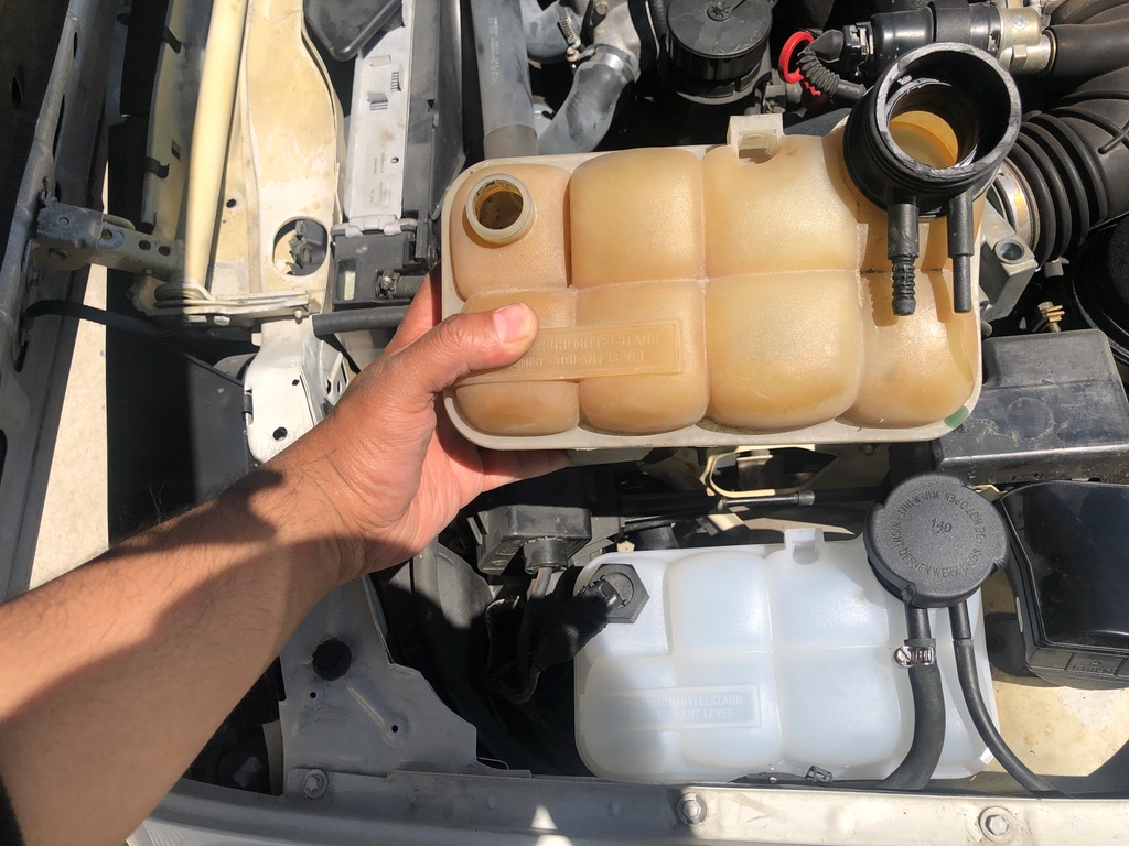

                                          Finally had a chance to drive and take care of some minor maintenance items.
                                          Tune: Wow, its freaking amazing. I wish I had done this 2.5 years ago when I bought the car. The tune/injector combination provide increased power throughout the rev range but especially below 4K. Its better everywhere without adding any harshness or reducing daily drivability.  (cant say the same for the M5 tune)

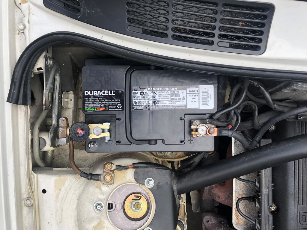

                                          Battery replaced: Finally I dont have to jump the car every time!

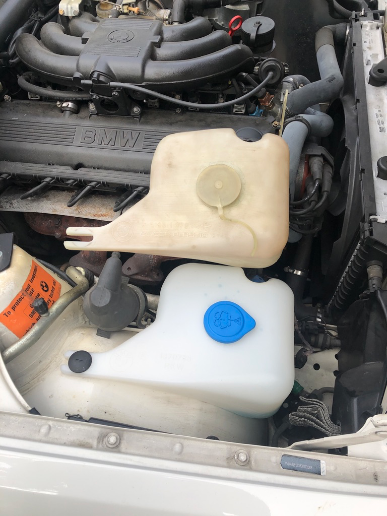

                                          Coolant Reservoir: 32 years is old enough for that plastic.
