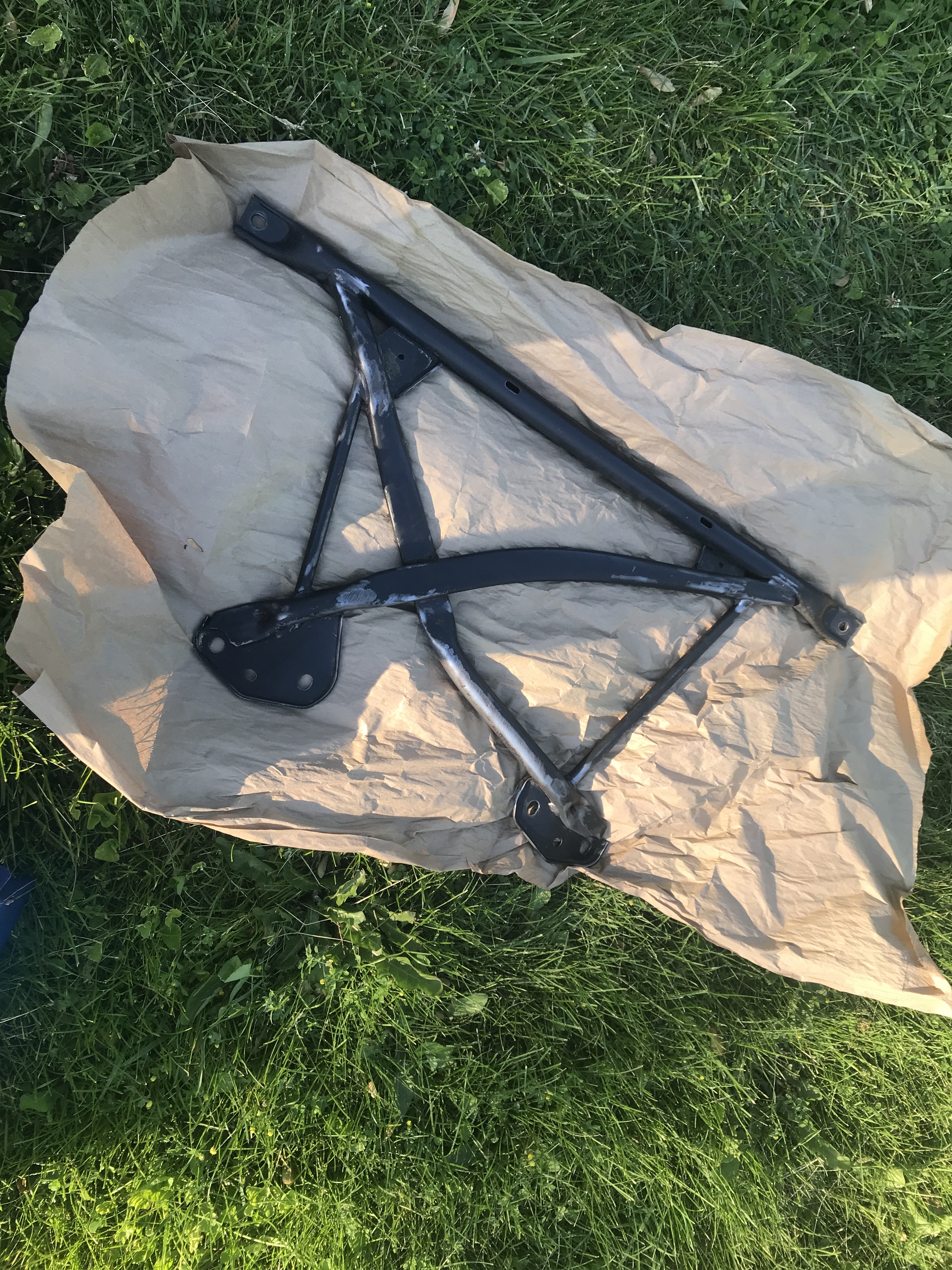

Went to the local pick and pull today to get some parts for my Passat, and found a 99 vert out in the yard. It was 100% rust free and I managed to snag the x-brace, the guy behind the counter let me have it for free
It had a bit of surface rust so I cleaned it up with the wire wheel and sanded it down for paint

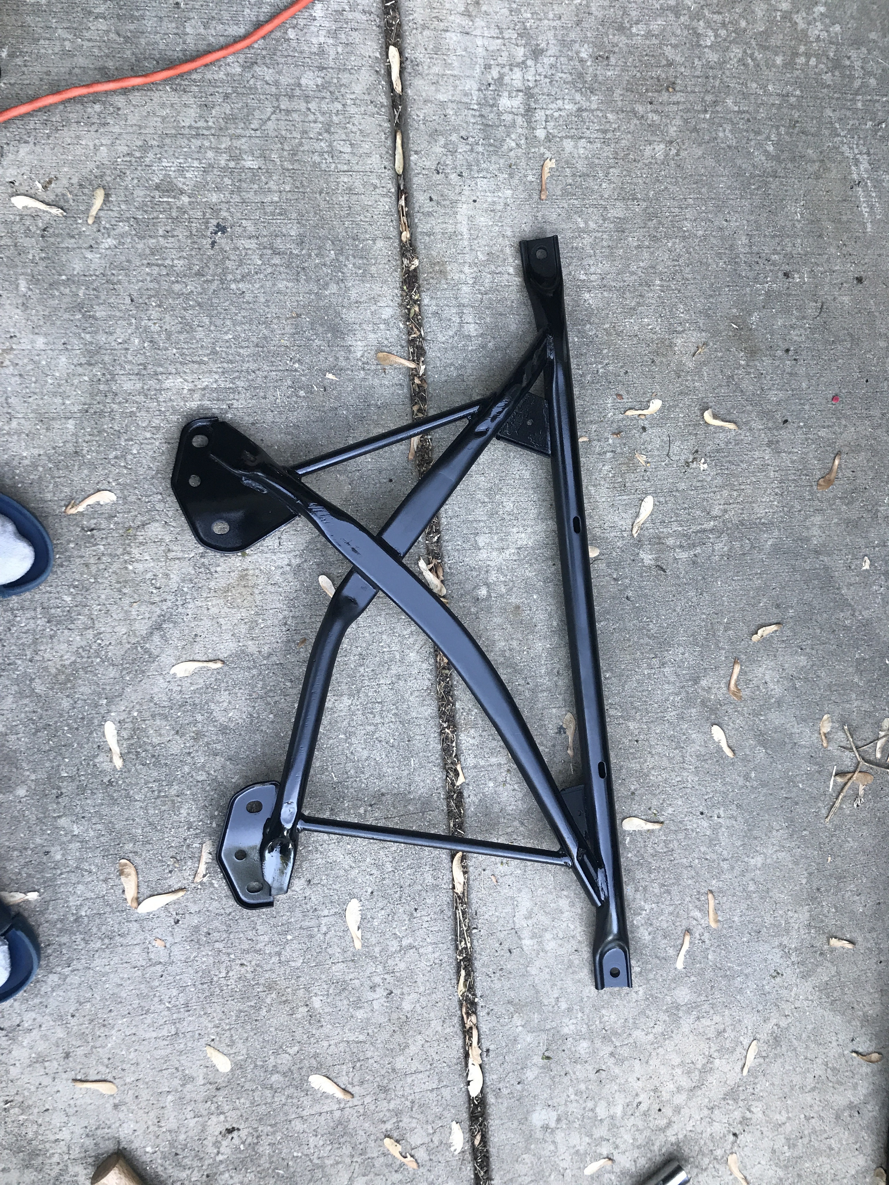

Painted it with some high temp caliper paint

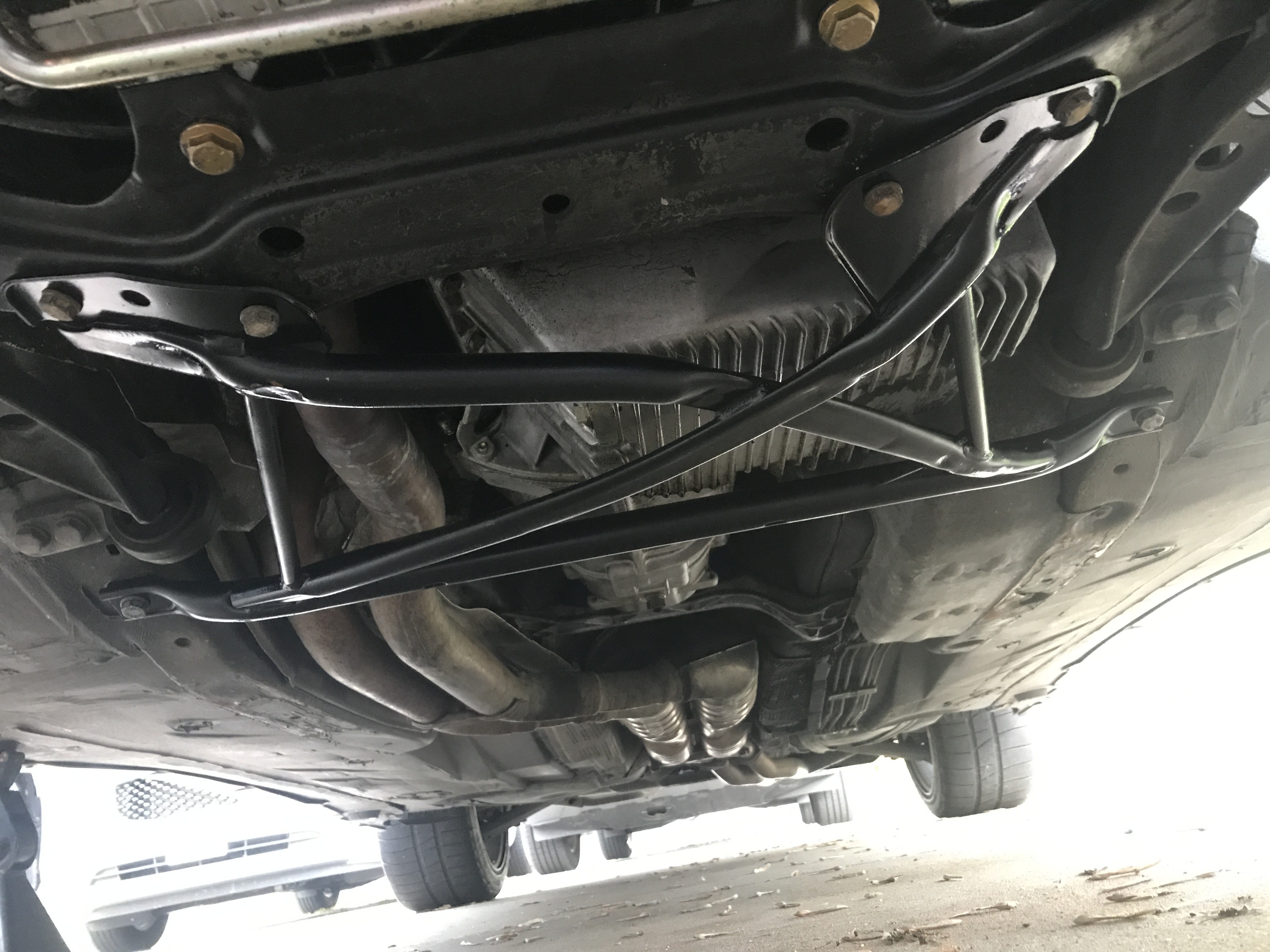

Nice that the M3's have the mounting threads in the subframe already, and thankfully all the holes lined up perfect. Took maybe 15 minutes to put it in, start to finish

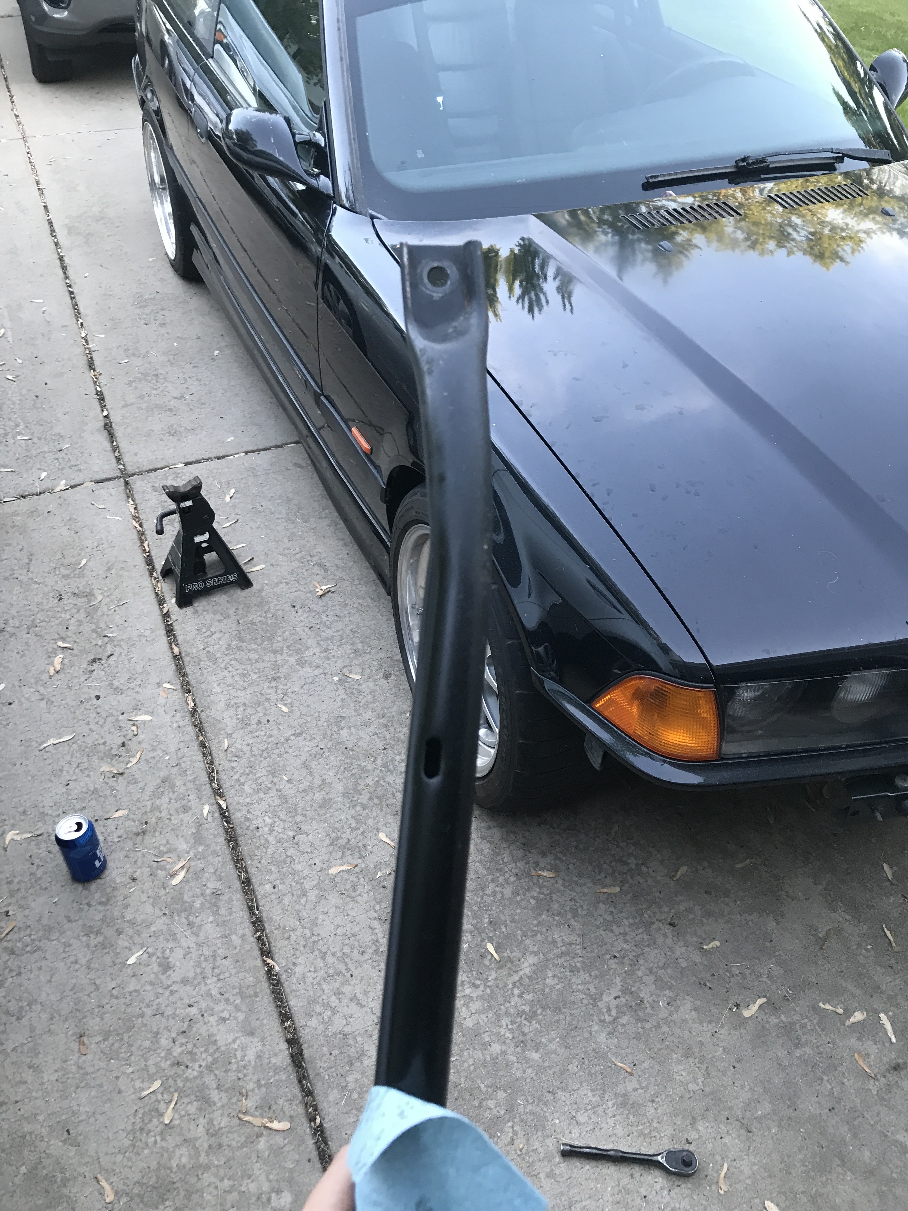

Pretty happy that I now have an x-brace and it cost me nothing and took little effort to put in!! I was also looking to get a x brace soon because when I dropped my exhaust I found that the OEM cross bar had taken a nasty hit at some point and wasn't even close to straight anymore
