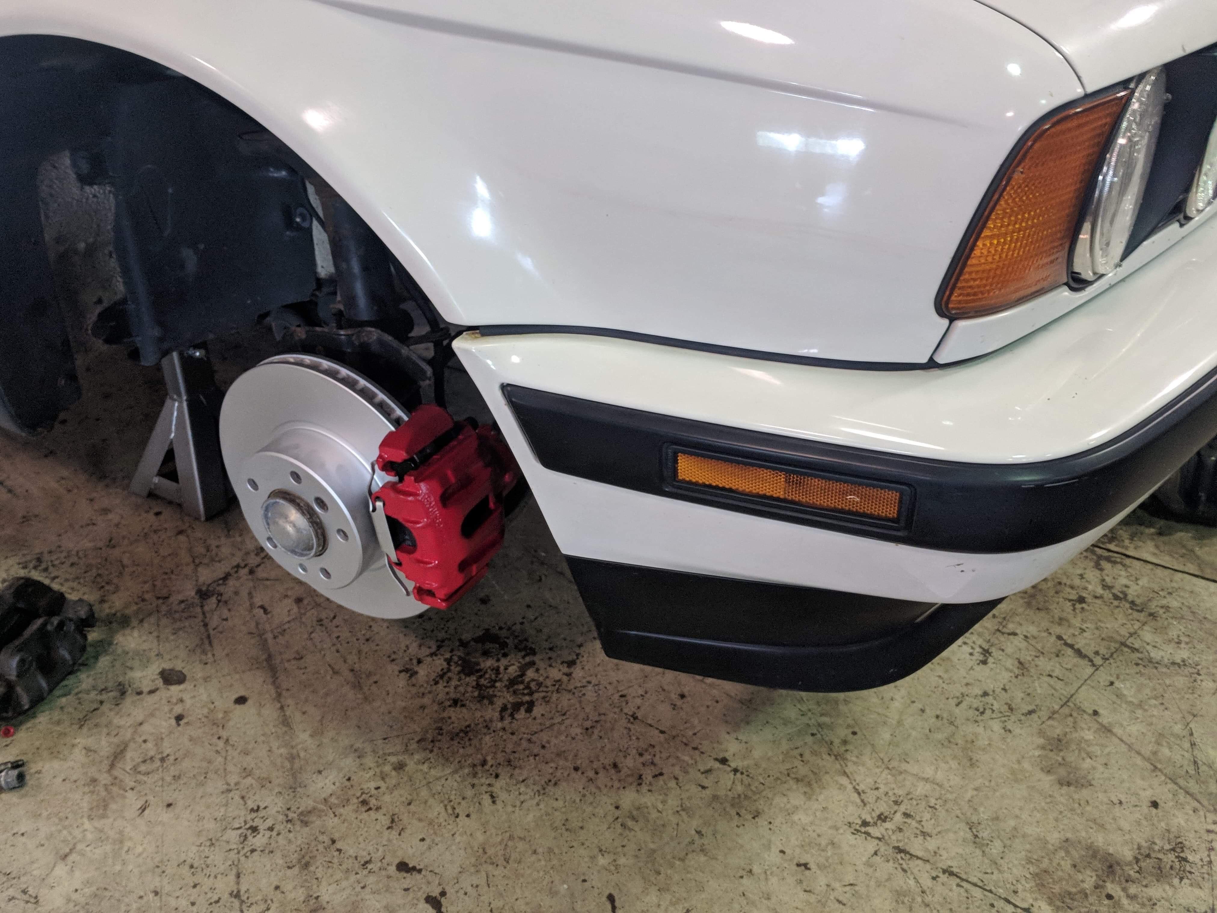

    thanks for the bump 👍 Forgot to update this a while back but before the last cruise up to RA I had done 1/2 of a 540i brake swap. Thought the rear calipers were going to come with brackets but they didn't. Didn't realize this until I was putting the rear brakes on and I couldn't find the 540i brake cores I had. The rear brakes were ok yet so I put those back on and just ran the new fronts for the cruise. The powerstop front calipers made quite a difference but the peddle pressure wasn't consistent in all types of driving. Gonna perform a full flush once I get the brackets and complete the swap.

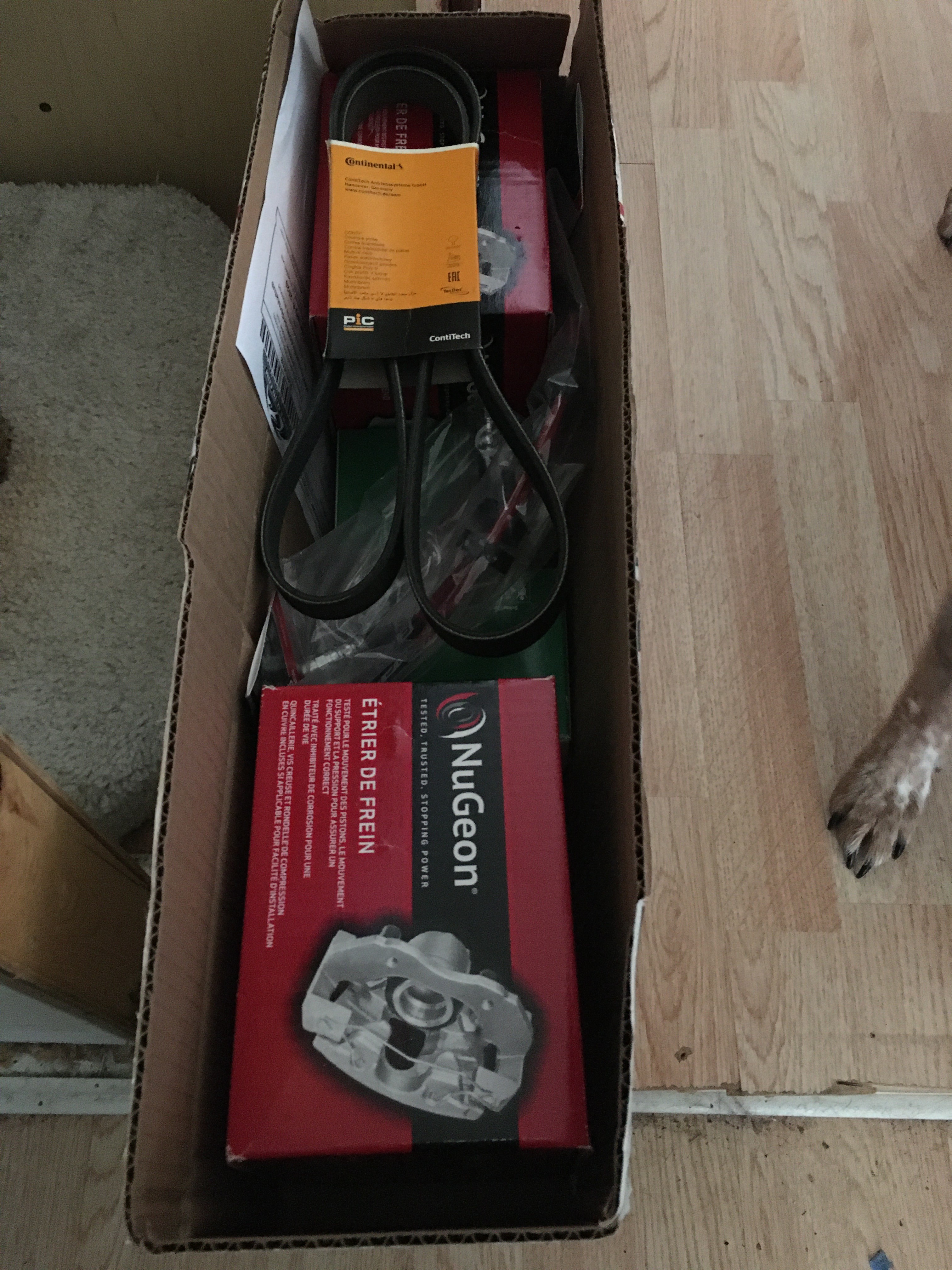

                                      The mild winter weather got me motivation to order parts from @patsbimmer1 last week and now winter weather has kicked back in since delivery 🙄. Ordered 540i rear calipers with brackets this time, ECS SS braided lines as the FCP kit I bought doesn't include the hoses for the rear calipers??. Also got both idler pulleys and a new V belt just in case as nobody stocks these locally. Yes this is all simple stuff as long as I can presumably get the ABS pump bled once the parts are on. The bigger task is really getting the car out from the middle of my storage unit.
