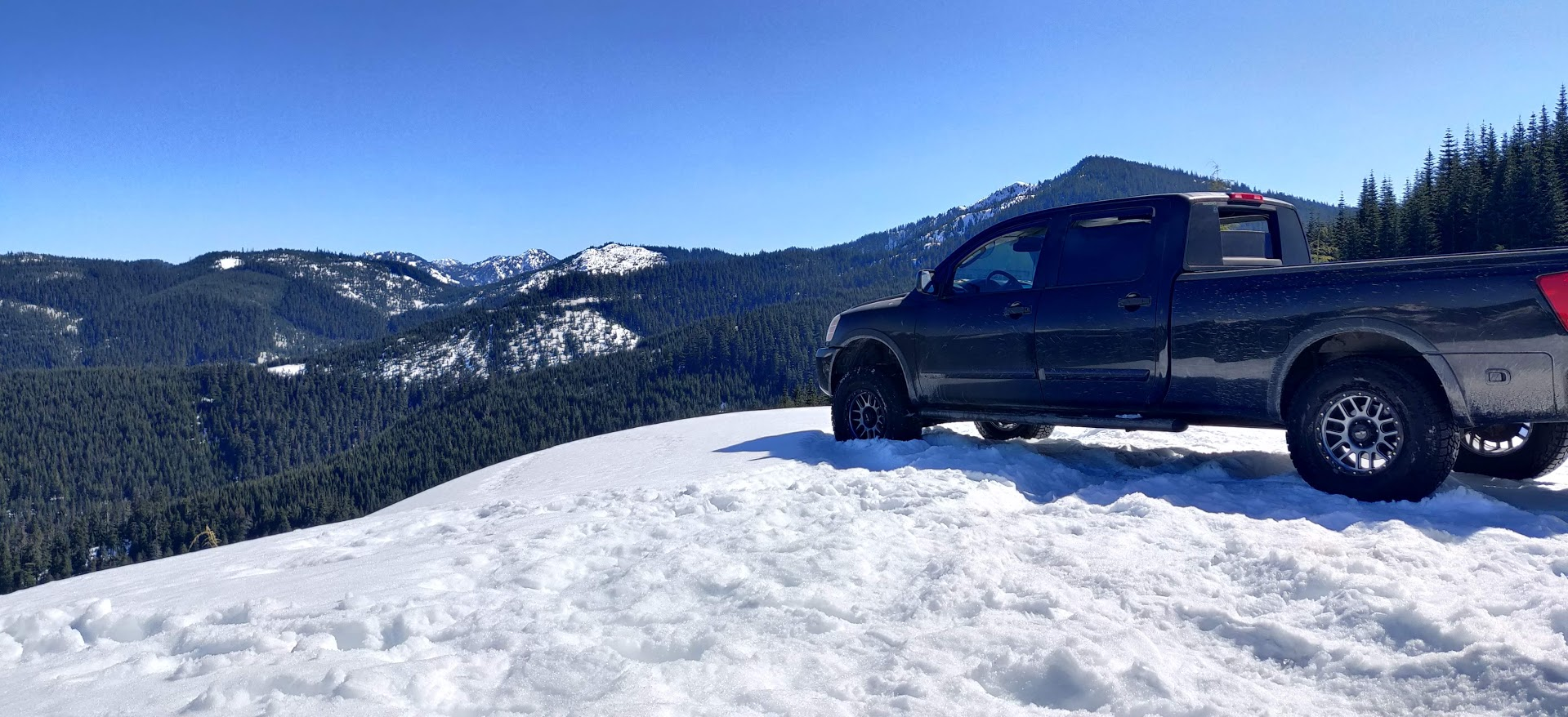

            Turns out this does snow fairly well, didn't expect it to float on top but it did!
            Mountain snow is wild, and deep as hell.
              #146

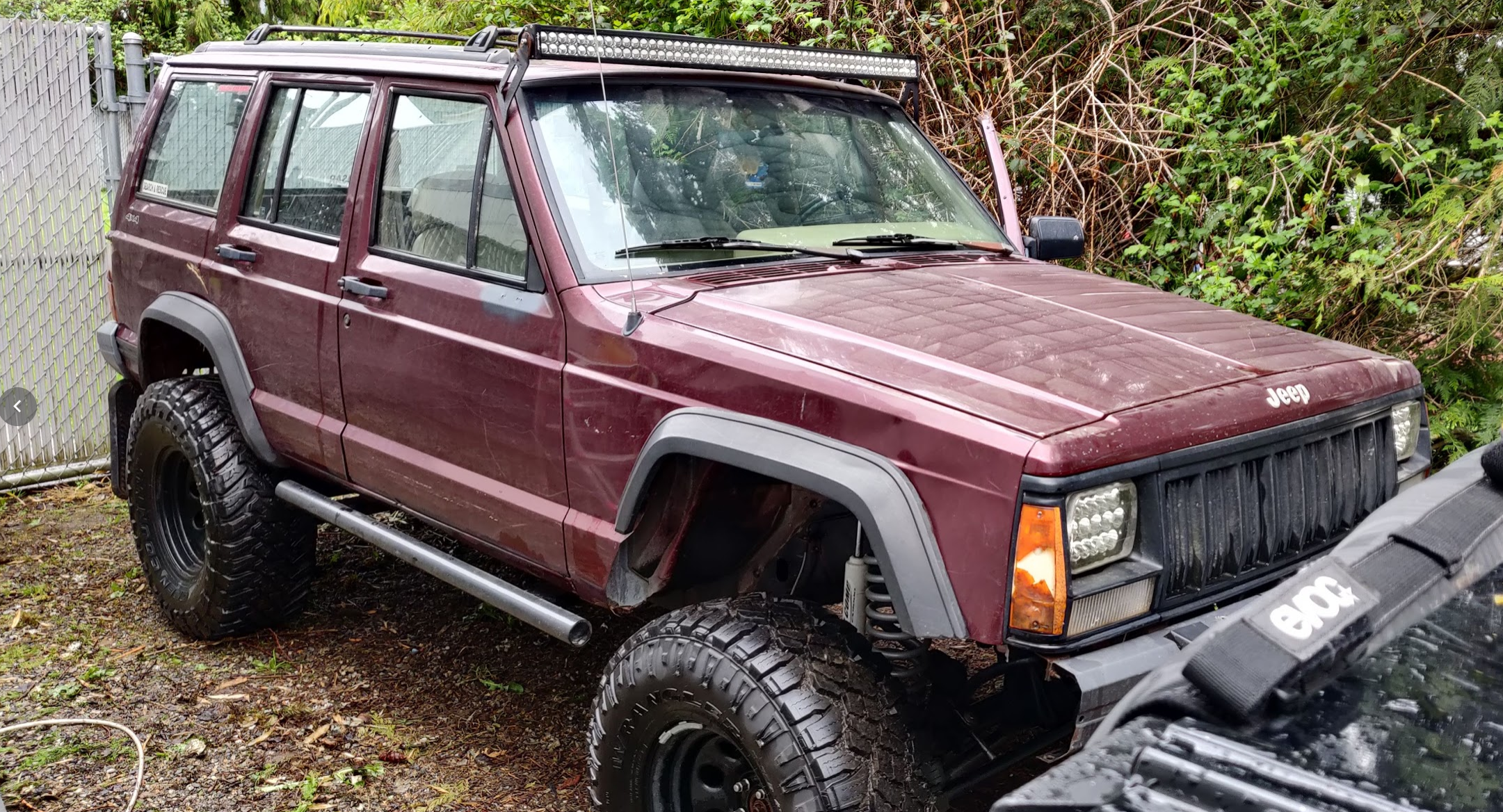

                Well she's no daily driver, but I still wanted to document this for later! My roommate has been building an XJ for a bit, and we've been meeting people that have land and off road trails on them, not to mention the places 30 min from the house that are stellar for wheeling. I quickly learned the truck doesn't fit on jeep trails, so there was only one solution!
                The $300 93ish XJ
                I don't ever name vehicles, but for some reason Ruby sticks with me, as this will be the red(headed) stepchild that always gets beat.
                It spent the last year of its life sitting in a barn at a friends house under the presumption of a bad clutch, and he had no desire to work on it (got it in a trade)
                He was looking to clear out space so it went real cheap.
                When I showed up there was a search for keys, and the conclusion that he didn't know where they ended up. I have never drilled a lock cylinder so I wasn't going to do that, but you can get a cylinder and key for the xj for $20 bucks which made it tempting. Mobile locksmith wanted $140 for 2 keys, but then stopped responding to me. Ended up bringing the keys to my roommates XJ and lo and behold the key for his door locks worked in my ignition perfectly. Convenient.
                This will be the third vehicle I have purchased knowing mice lived in it, and it makes me question myself sometimes. Oh well.

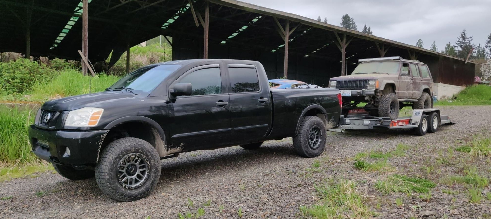

                Got it on the trailer using the hill to roll it as there was no battery.
                Got it trailered home (obligatory on trailer pic)

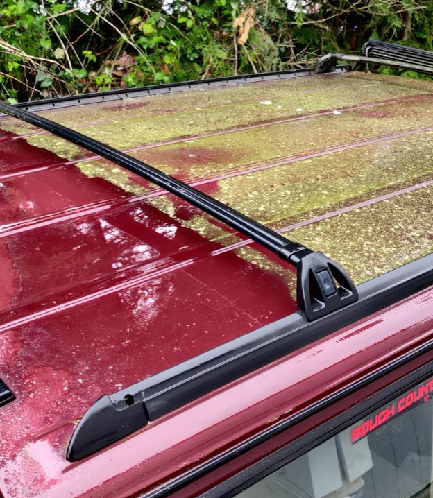

                The next day I got to cleaning it up a bit. The roof was amusing to clean with the pressure washer, as it had many much algae on it.

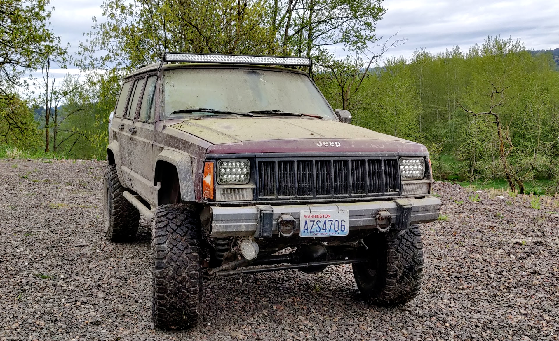

                After cleaning it in the little hidey hole I have it (I alone have 3 cars and a truck at a house that is setup for 4 cars, much less my roommates 2 cars lol) it looked alright, especially considering what it'll be used for.
                Turns out to have a handful of aftermarket parts in it, the front steering components have all been replaced with stronger pieces, the rear lift was done properly, slip yoke eliminator in the rear, adjustable upper control arms in the front, good tires, factory skid plates that are actually staggeringly thick, and a few other odds and ends.
                It should prove to be quite fun!

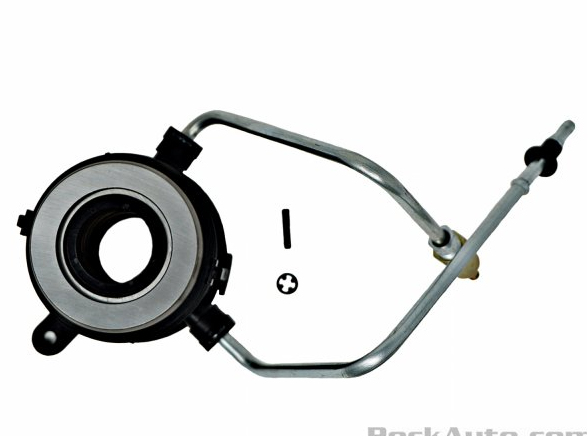

                        Played with the clutch stuff for a bit to see what I could find. I ordered a new master cylinder to see if the seal in that is weak.
                        I hope it's not the slave cylinder, as they use a "Tilton" style slave.
                        Getting access to that means pulling the trans and transfer case, which doesn't sound like too much fun!
                        They also use a plastic clutch hydraulic line that seals to the master with an o-ring, and is held in place with a roll pin through it. A genuinely wild setup.

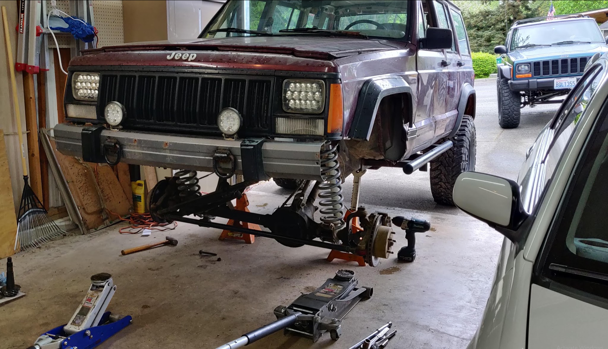

                                  Now that it drives it was time to turn to other things.
                                  The front had almost 6.5" of lift due to the 4.5" lift spring and a 2" rubber spacer. It looked stupid, especially on 33's with fenders that are trimmed up.
                                  Took the front axle almost all the way out in order to remove the rubber spacer on top of the spring. Realized the axle had been sitting about 2" toward the driver side because whomever put the spring spacers in never adjusted the trac bar. This style suspension is so much different than anything I've worked on, and luckily my roommate has been playing with jeeps for quite some time (his jeep in the back) so he can lend a hand when I get confused!
                                  Also realized it has very f*ing beefy steering, and is a good system that allows you to adjust ride height and such without needing to adjust toe again. Stock steering has the drag link and tie rod end going as one part.
                                  Now to clean up the rear shock mtg points and get some shocks back there!

                                    I absolutely hated aligning Jeeps or anything with this drag link style set up.  It's nice because you can ONLY adjust total toe and steer ahead but steer ahead can be a PITA if your steering lock is shit or you don't have a human holding the wheel straight while adjusting it.  That and rusted out sleeves/threads.  So many painful memories.
