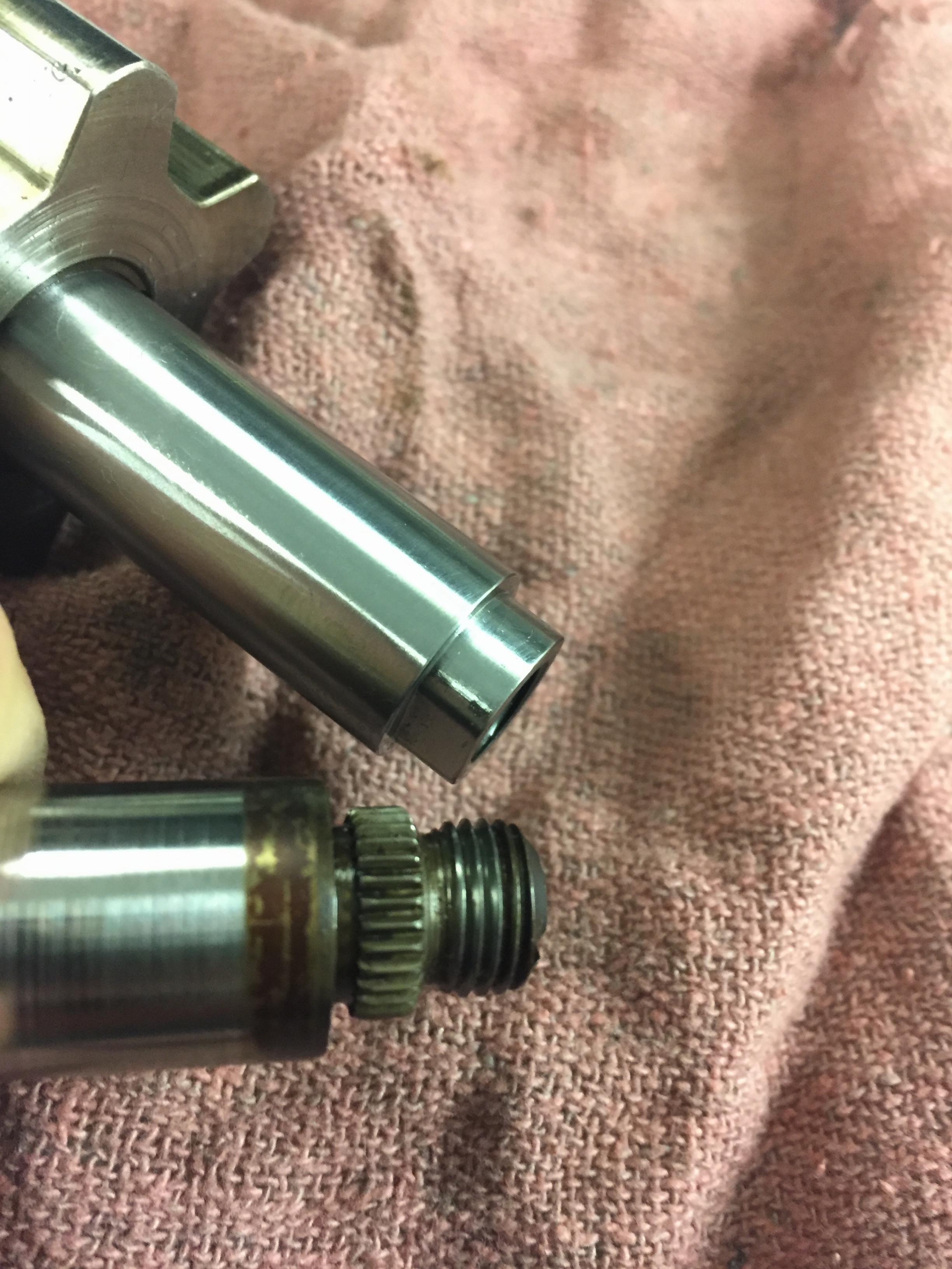

              Cutting and re-threading the rod on the e21 booster is a royal pain because of how difficult it is to hold the rod steady and keep it from rotating and wobbling
              But it is finished

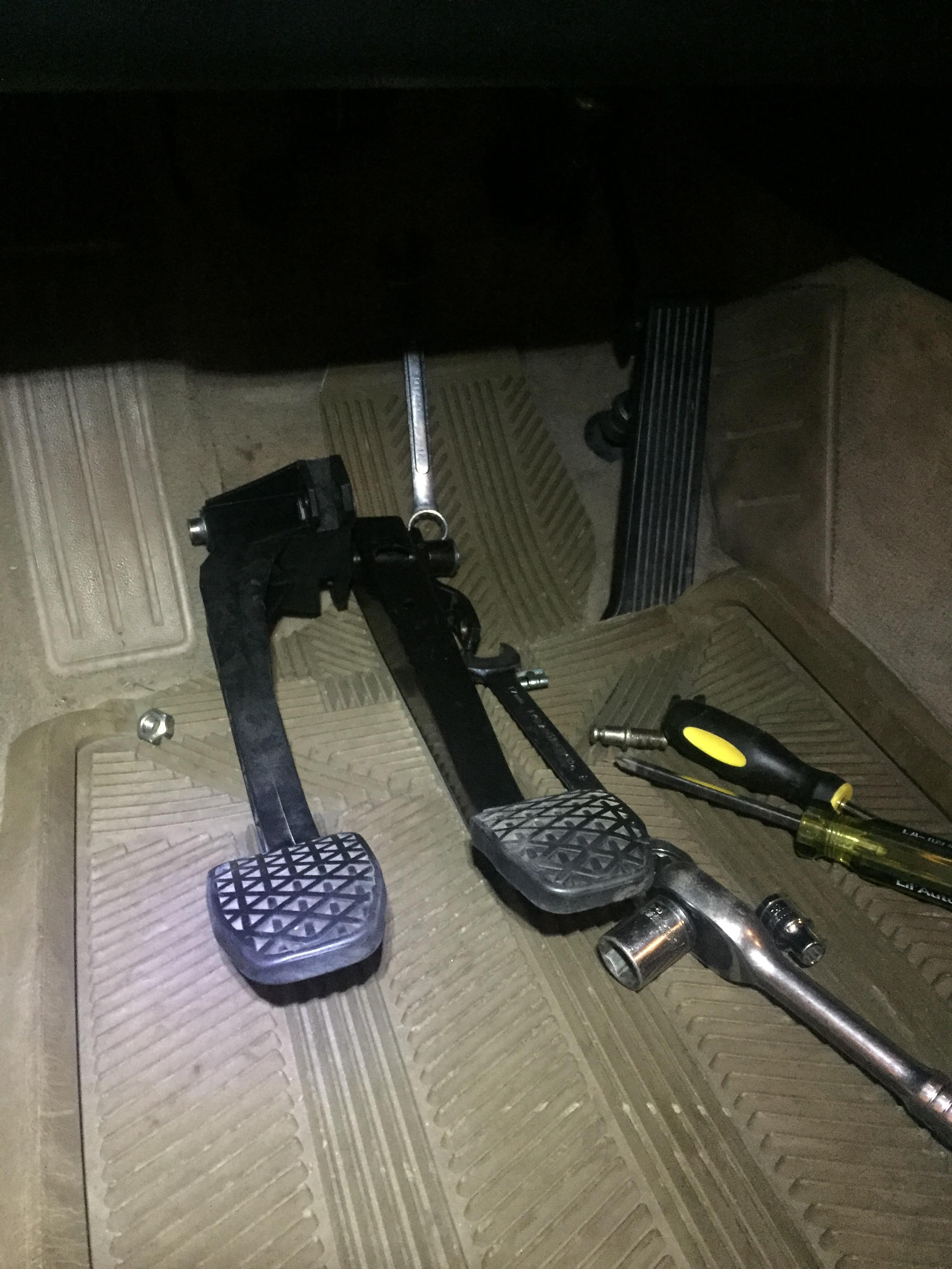

                              The brake hard line retainer needed some modifying in order for the E21 booster to sit flat on the firewall since it does not stand off as far as the E30 booster does. It looks like this may not be an issue if all the firewall insulation was removed but I like my firewall insulation.
                              There are two spaces for the hard line to snap into and one of them simply gets cut off with a dremel.
                              The firewall gasket is either NLA or im not seeing it on RealOEM. I gave it a go making my own gasket with some gasket material but ended up just running a small bead of clear silicone that wont bond the booster to the firewall
                              The booster is in and connected but I will leave the kick panels off until I can find a clutch return spring.
                              When I did my manual swap I dont think I had the clutch return spring, and it isnt really needed except to pull up a 1/4" of dead travel in the pedal when its disengaged. I find myself instinctively lifting the backside of the clutch pedal with my left foot. It isnt hurting anything but my subconscious mind obviously cares about it so I better install a return spring for it.
                              Its also possible that the automatic pedal box didnt have the provision for the spring attachment or something. I forget.

                                    #58
                                    DUDE
                                    THE DAMN LAST 1/4" OF PEDAL TRAVEL
                                    My car was also manual swapped at some point in it's life.
                                    I cannot stress how often I pull the pedal up with the top of my foot.
                                    Drives my OCD insane
                                      #59
                                      And I thought I was the only one [emoji16]
                                        #60

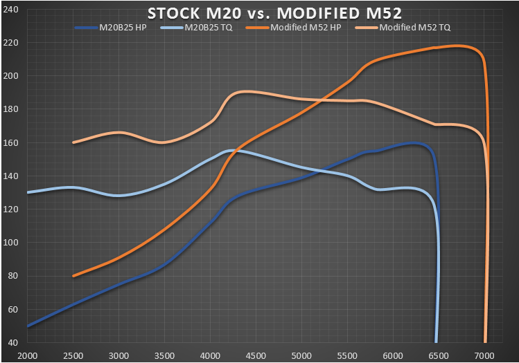

                                        Out of my own curiosity, I wanted to overlay all the BMW 2.5L engines: M20B25, M50NV, M50TU, M52B25, M54B25, N52B25 and see how the torque curve flattened over time with all the technology advancements. Instead I lost interest and threw the modded M52 data over some data for
                                        a stock M20B25 vs. an M52B28, M50 manifold, S52 cams, intake, exhaust, stock ex. manifolds, and tune.
                                        I remember having fun with my stock M20 so it appears there is a little more fun in store with the M52. Next week will for sure see some significant progress as I will have some extra time, but I will keep nibbling away at things this week like I have been doing.
                                          #61
                                          When the vanos hits!!  In all seriousness though it is interesting that the the hp and torque curves have a similar profile between the two engines.
