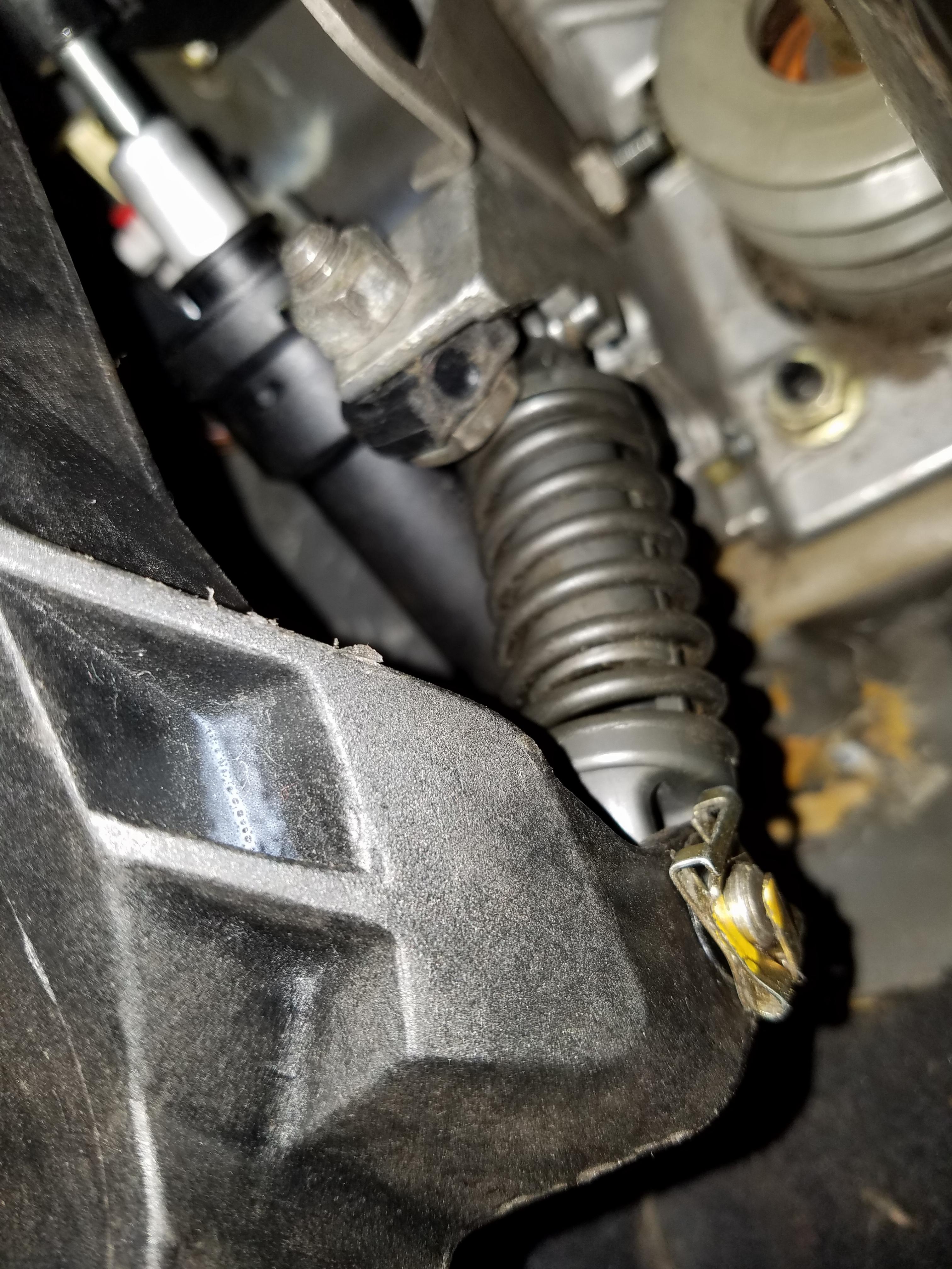

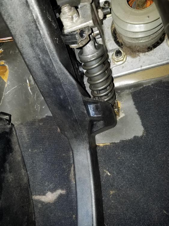

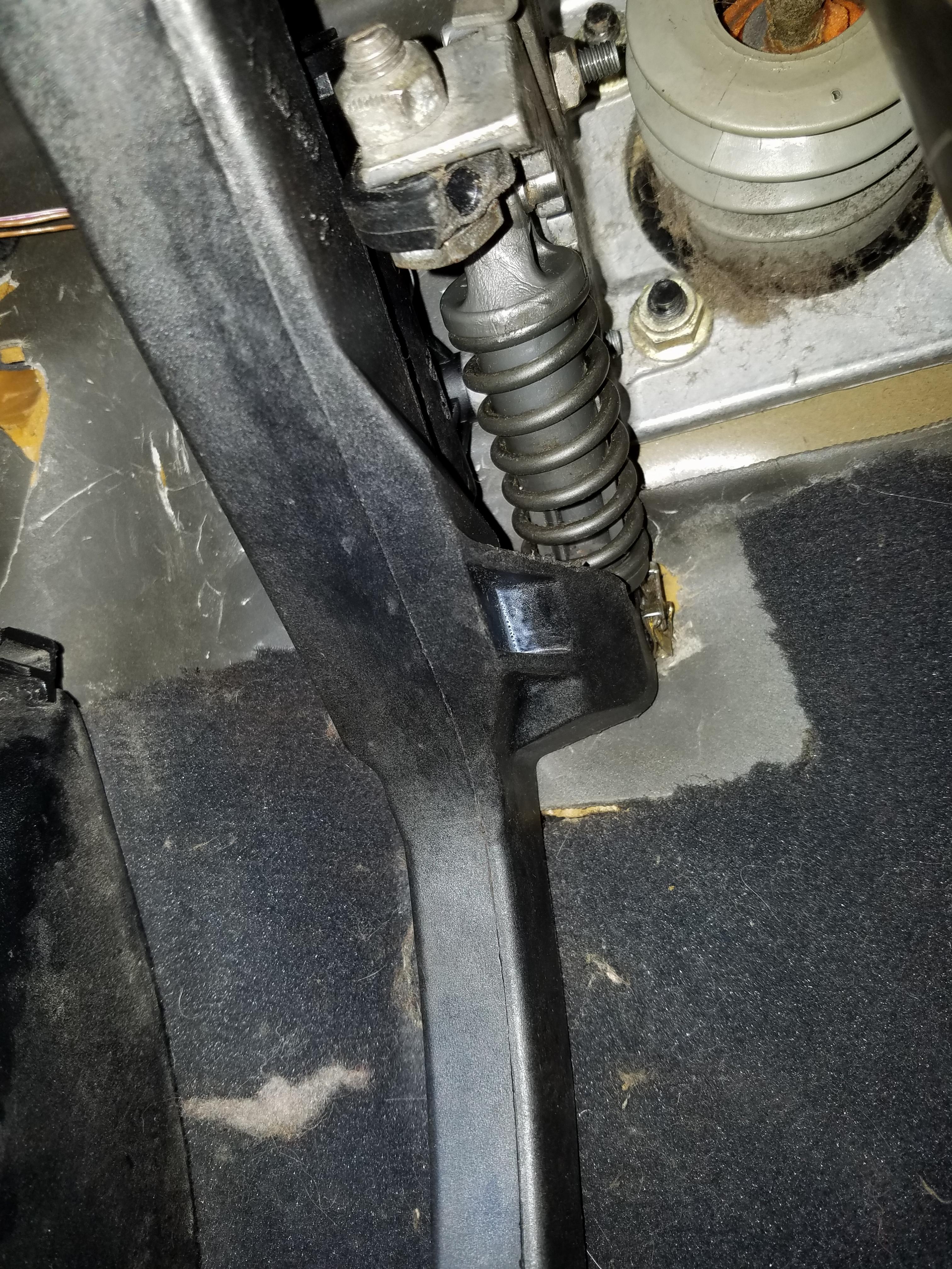

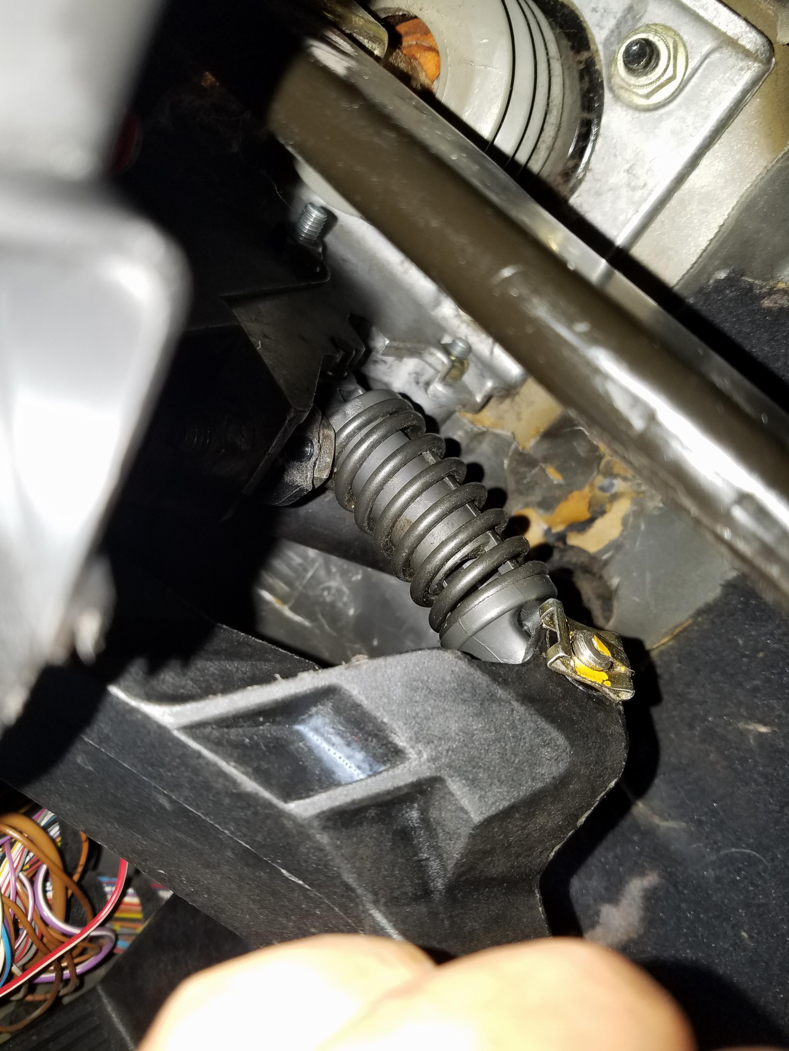

well, got the master cylinder in. That's not a job I want to do again. I'm having trouble with the return spring though on the pedal. It looks like it's in where it should be but when you push the pedal down the spring is actually pushing the pedal towards the floor. Once the pedal is past halfway the spring slams it down and the pedal won't return. I haven't bled the master yet but there's no way I could see it having the force to push it back. The spring is hurting, not helping in this case. It was also VERY hard to install. The only way it'd fit was to zip tie it still the spring completely bottomed out.
Here are some pics if anyone has an e36 they could snap a picture.
well Snap was right as usual! However, 1 step forward, 2 back. I was reverse bleeding from the slave. removed it and pushed the piston in a few times and then started adding fluid to the slave. Seemed like I was putting a lot of fluid into it but never did get the fluid level to rise in the engine container so i figured I'm still pushing air out. Felt the clutch and it was getting a little resistance, so went back under and added some more fluid. Went to check the clutch again pushed harder. BOOM - blew the slave cylinder out. Rookie mistake. Guess I needed to reinstall it first.

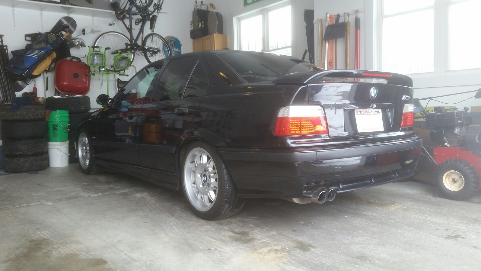

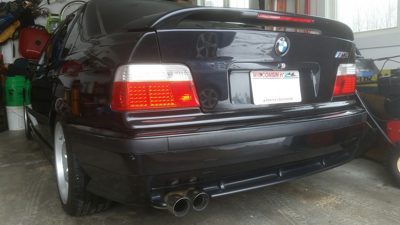

Finally got the clutch back up and running. So, figured I should show a few pictures after a wash and wax. No idea why they show up crooked. I rotated them and re-saved after uploading but they're still messed up. Oh well.

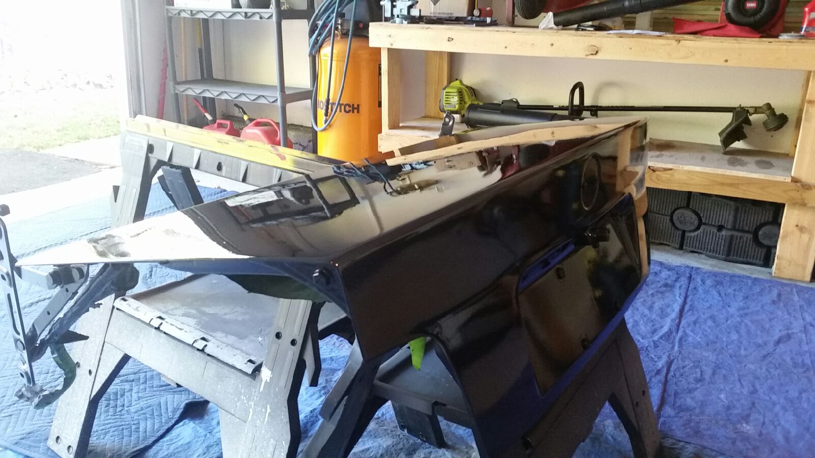

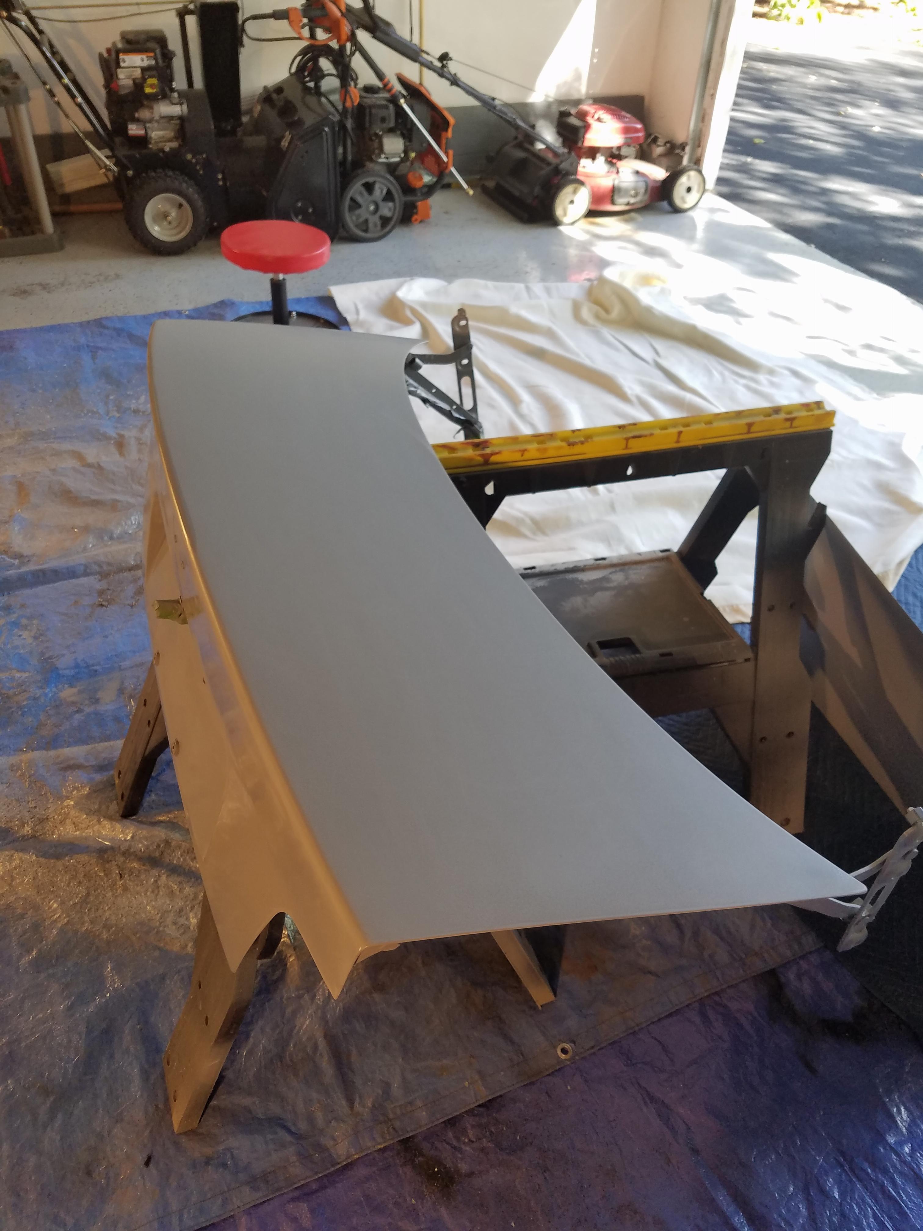

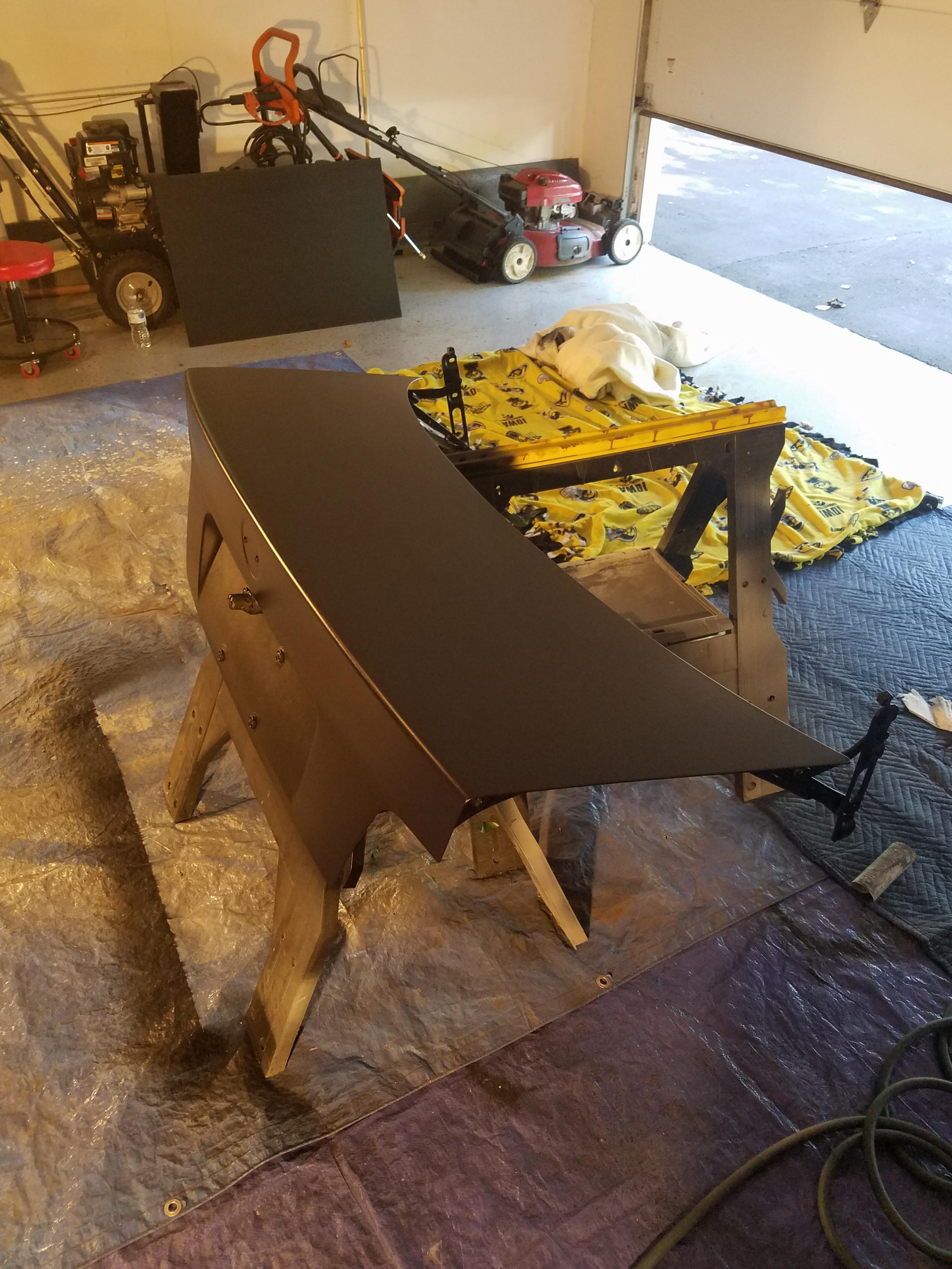

Next project is to get a new trunk on. I'm not a fan of the huge spoiler on there. I found a nice white one without a spoiler at the junk yard. Got to strip it and paint it then I'll go with that and a smaller m5 style lip like shown.

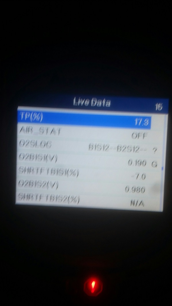

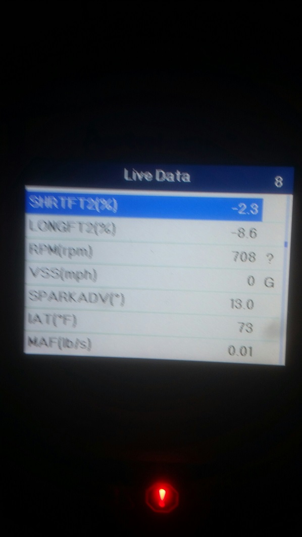

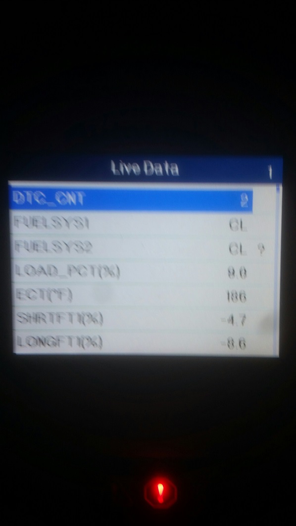

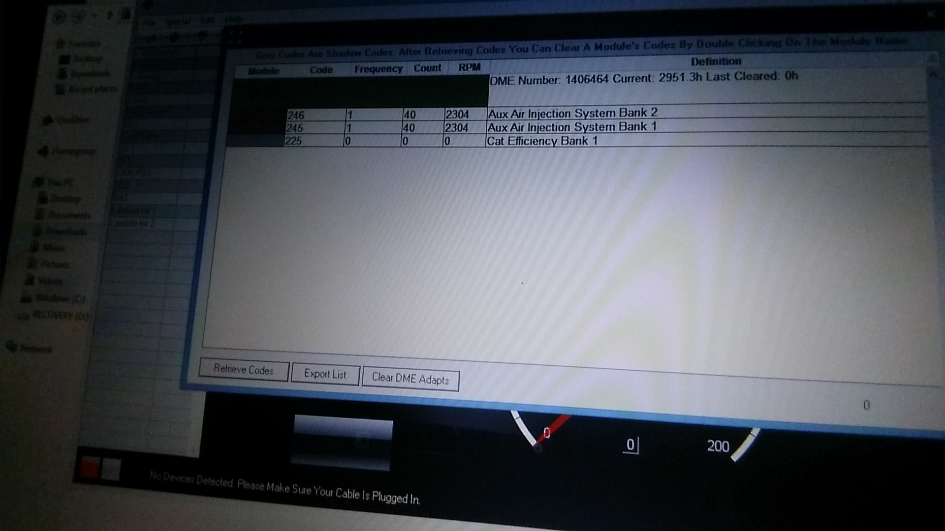

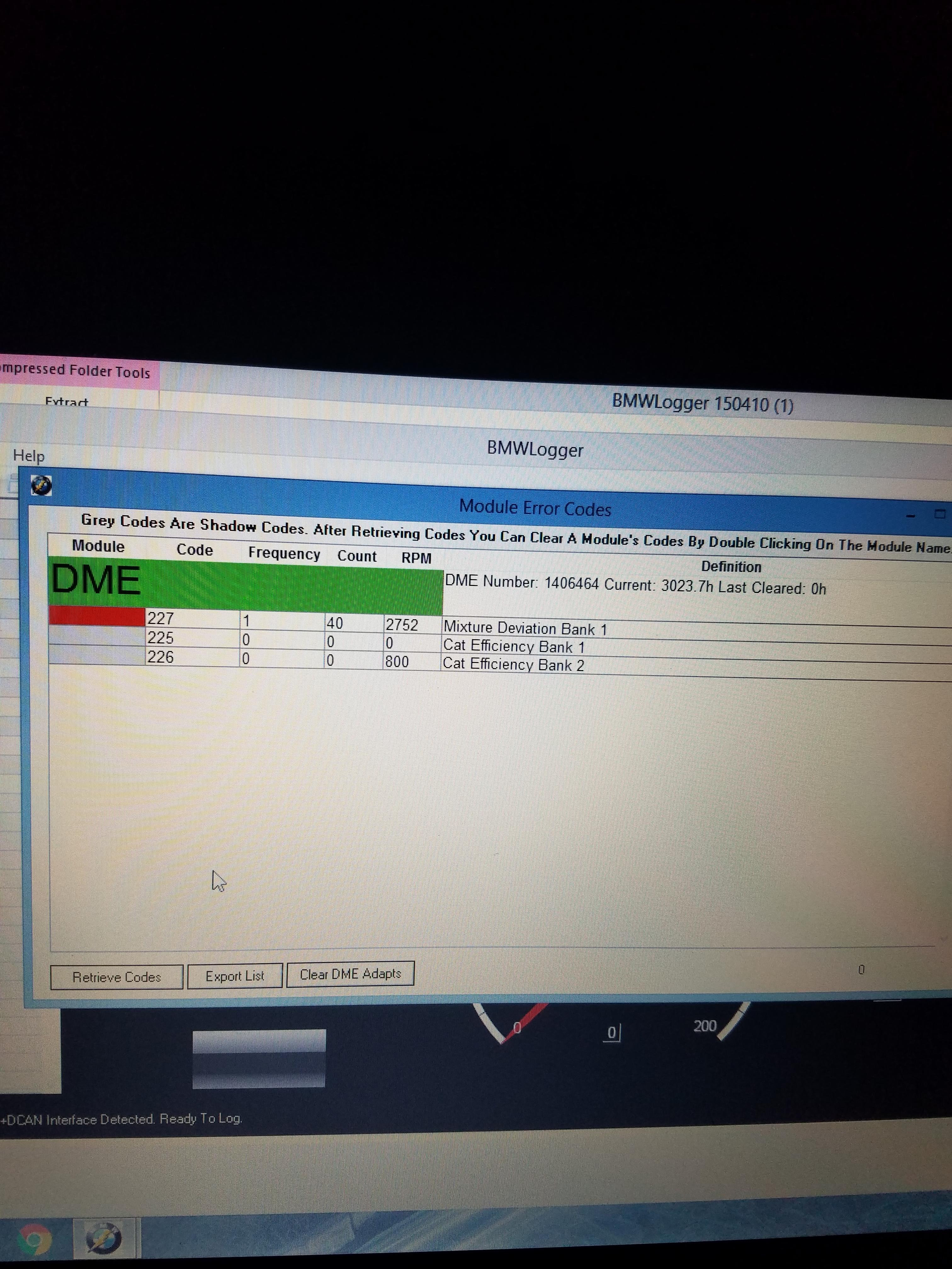

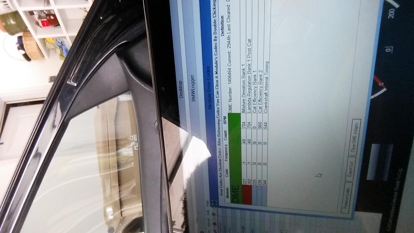

Since then I've been battling those codes you've seen in this thread. I've replaced all known issues for that; plugs, coil packs, o2 sensors, fuel filter, smoke test, etc. I planned to do all those anyway as routine maintenance as the new owner so that's fine. However, I'm still getting the code. So, that brings me back to my Vanos job as the only other variable that's changed. More I read I see people talking about it being off a "tooth" Are they referring to the splines when re-inserting the Vanos? After watching some video's I'm not 100% confident I had that in correctly. So, I'm re-doing it to double check my work. After seeing a few techniques on youtube i'm more confident I'll be sure it's right.

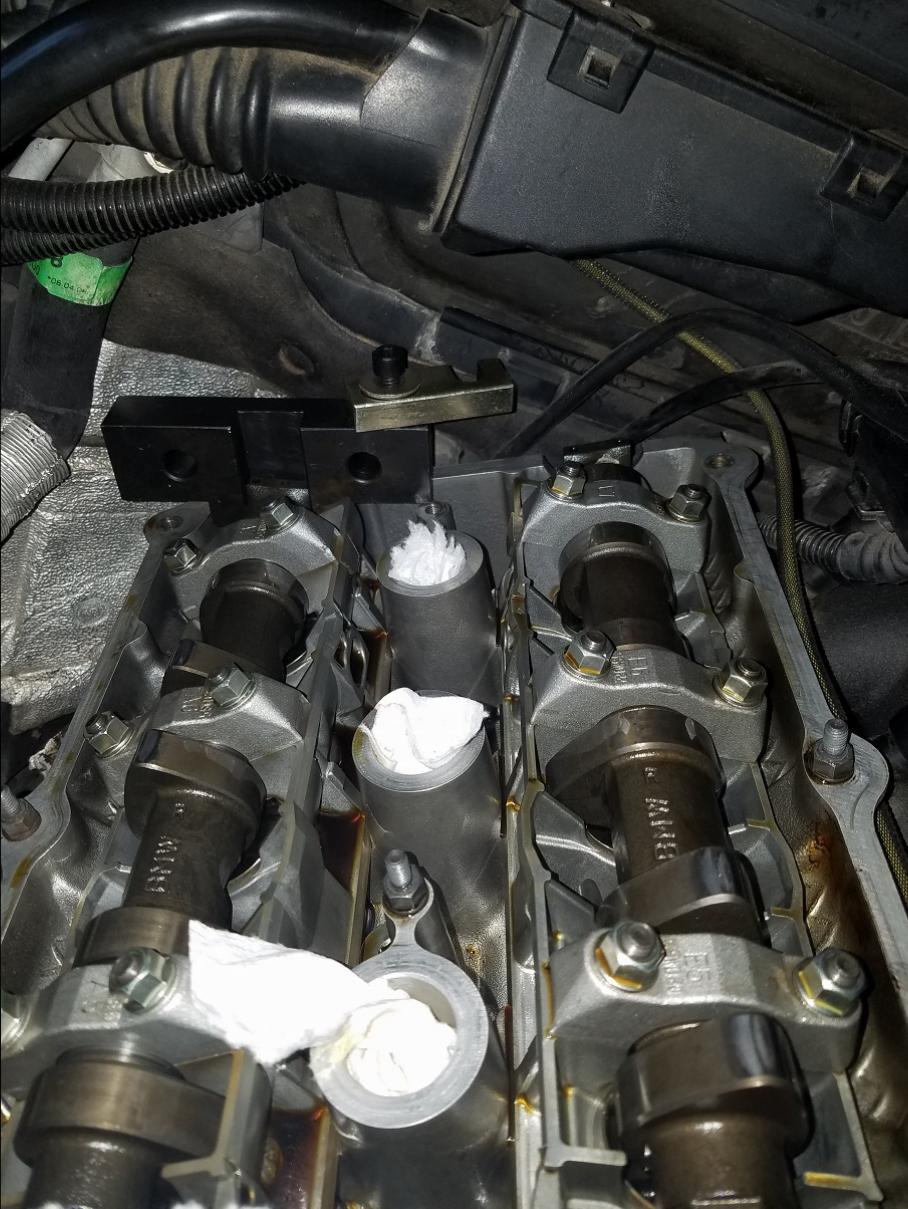

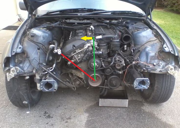

I'm at the point to lock the CAMs (with real cam locks this time). Here's a picture of my exhaust cam. Crank is TDC, lobes pointed at each other upfront and intake cam is pretty flush. Exhaust is off by a bit. I'm told to wiggle the CAM with a 24 mm wrench so it sits flush but I'm afraid of other things moving. I plan to have a friend hold a wrench on the crank to insure that doesn't move, but am I ok to wiggle that CAM around? I didn't want to take the Vanos out without knowing that first.

The crankshaft is at TDC. the camshafts are locked. once you remove the timing chains you must rotate the crankshaft off of TDC. Start the wrench at approximately the lifting hook (green line) and turn it counter clockwise to the opposite edge of the head (red line). Yes, it is horrifying to rotate the crank out of sync with the cams/with the timing chains off, but it is safe. Once the crankshaft is in this position you can rotate the cams all you want. You will probably have to rotate the intake cam independently to force the VAMOS unit off of the cam anyhow since you will notice that rotating the intake cam with the VAMOS unbolted results in the whole VAMOS unit moving axially in and out on the cam.
Definitely not timed right in the photo. The squares should be parallel You should be safe to turn it that amount without messing with the crankshaft but it doesn't hurt to be safe. Be careful not to drop the chain down the front of the engine. I usually tie a wire to it just in case.
The bolts on the exhaust cam should be loose while the vanos is installed so the sprocket that drives the intake cam can rotate as the vanos is pushed in so the cams don't move.
When you are all done assembling and turn the engine by hand 2 revolutions you should be able to put the cam lock tool back on. Then you know it is right. You don't need the lock tool, I use a straight metal ruler but if you have the blocks it's easier.

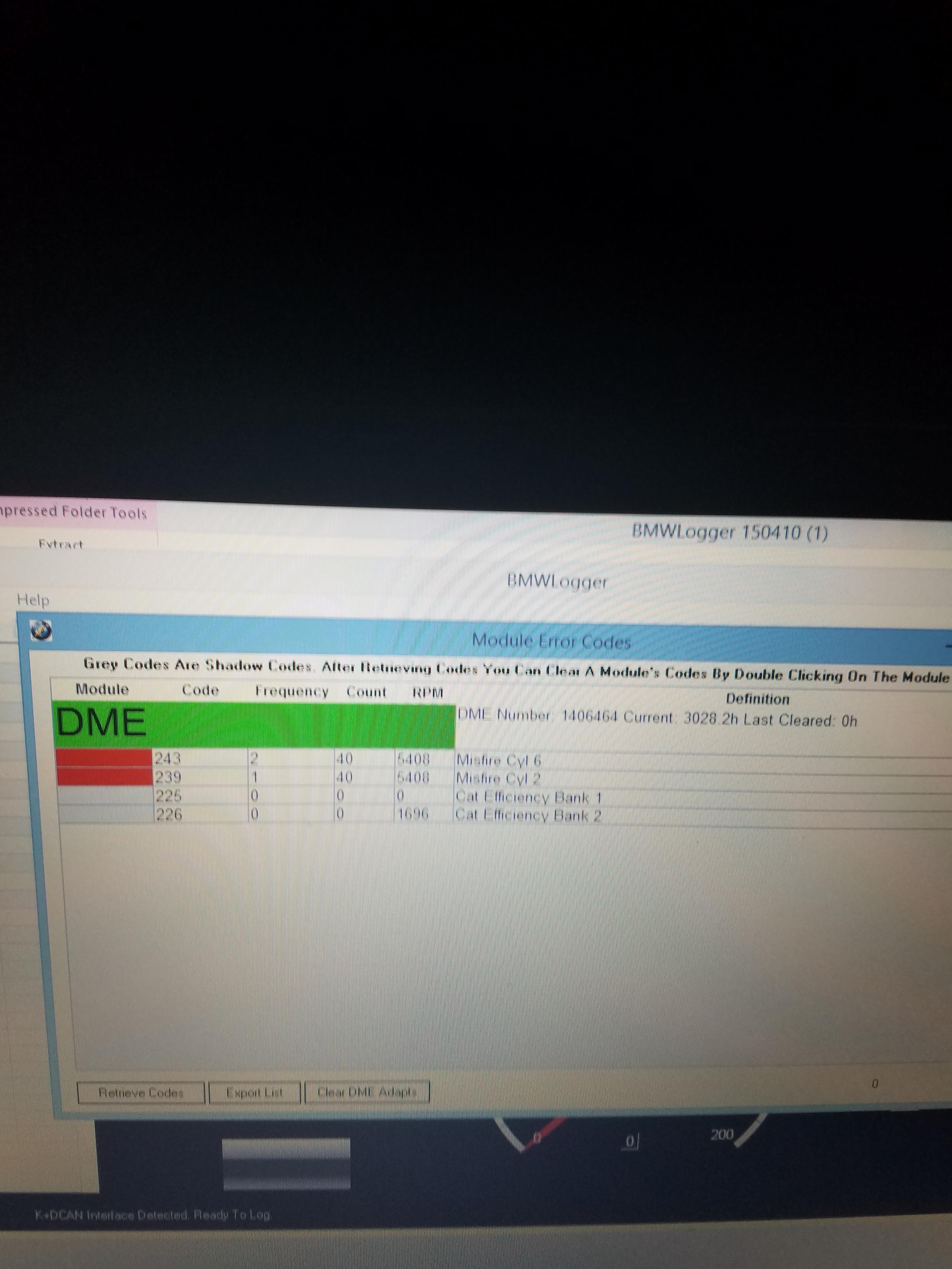

Took car for a spin now have a new gremlin. Car idles normally while cold and during warm up. Once the car is warm when coming out of gear into neutral the rpms start to flutter. Will typically dip to around 300 rmp then spike to 900 and keeps going back and forth. Doesn't do it all the time but is pretty consistent. My normal idle was around 650 rpm or so. On first trip out dipped low enough to kill the engine. Basically getting the same codes, now with the idle issue which is new. Perhaps I still have something wrong with my install. Not sure where to go from here.
