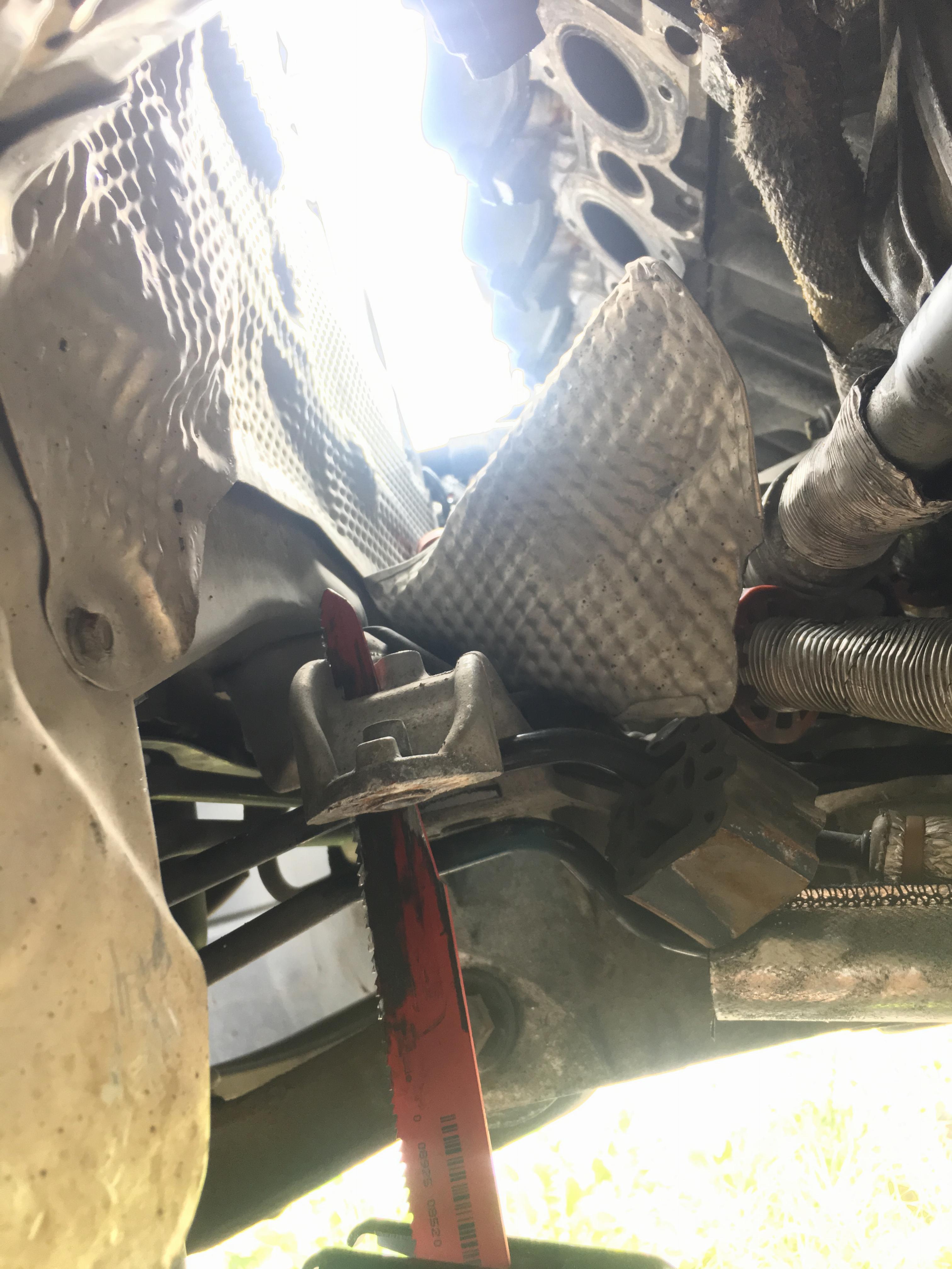

                    I'll do the headers first. To clarify these headers are for an e55, which is slightly smaller then my s55. The price tag for the s55 was 3.5x the price so I figured I'd make them work. IMG1141.JPG
                    this was the first issue on the passenger side. Subframe heat shield I was able to cut that out, the smooth one, and push down the ribbed one onto the subframe. It's not by any bushings or rubber so it really doesn't need any protection at all. Then removed the bolt and shaved it so it was flush with the nut and gave the pipe the one two with a hammer for decent clearance.
                    The end of the header was resting up on the bottom of the car. Used a floor jack on the floor pan to make some extra room. That's about as far as I got on that. I'll have pictures within a year.

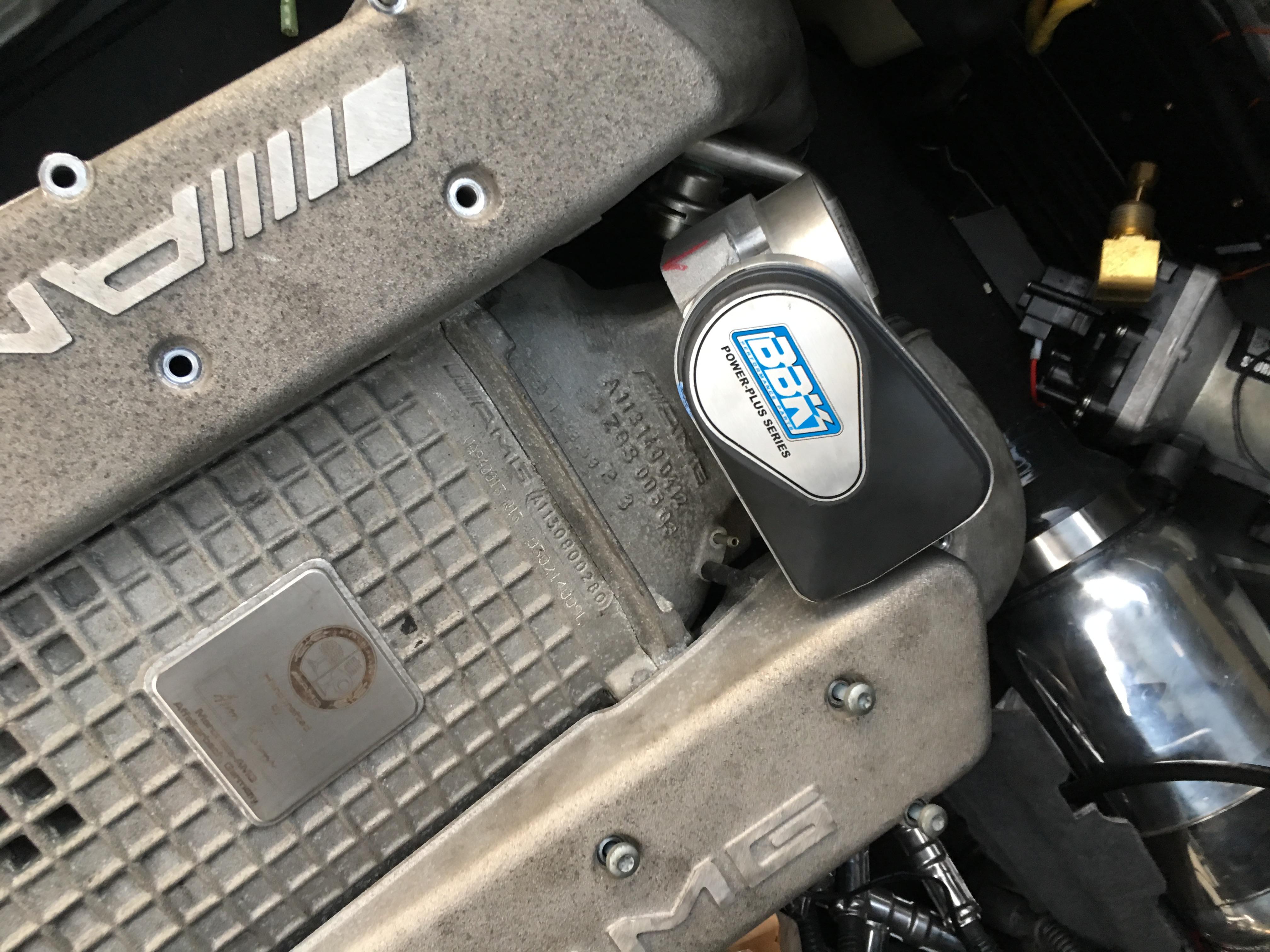

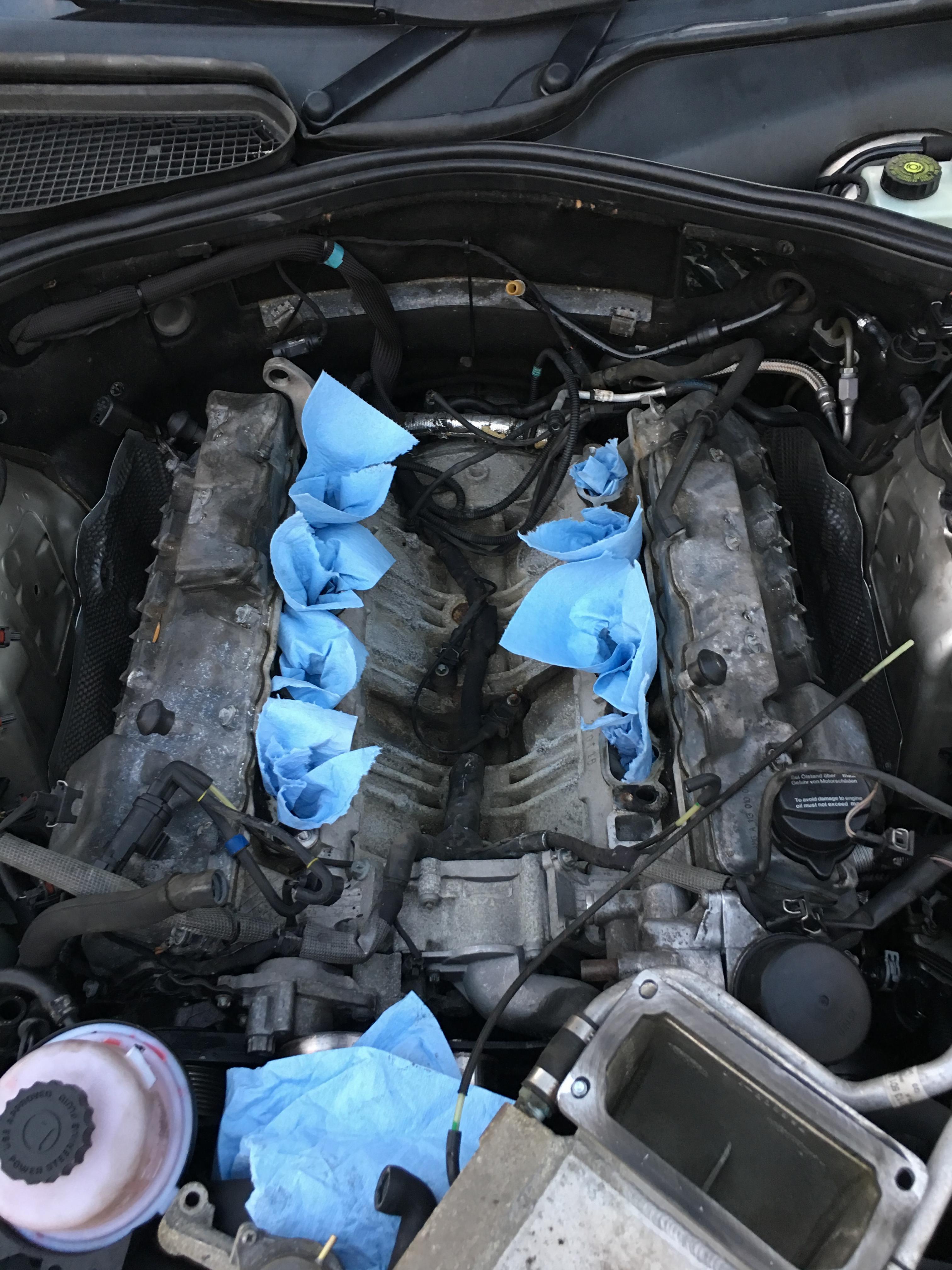

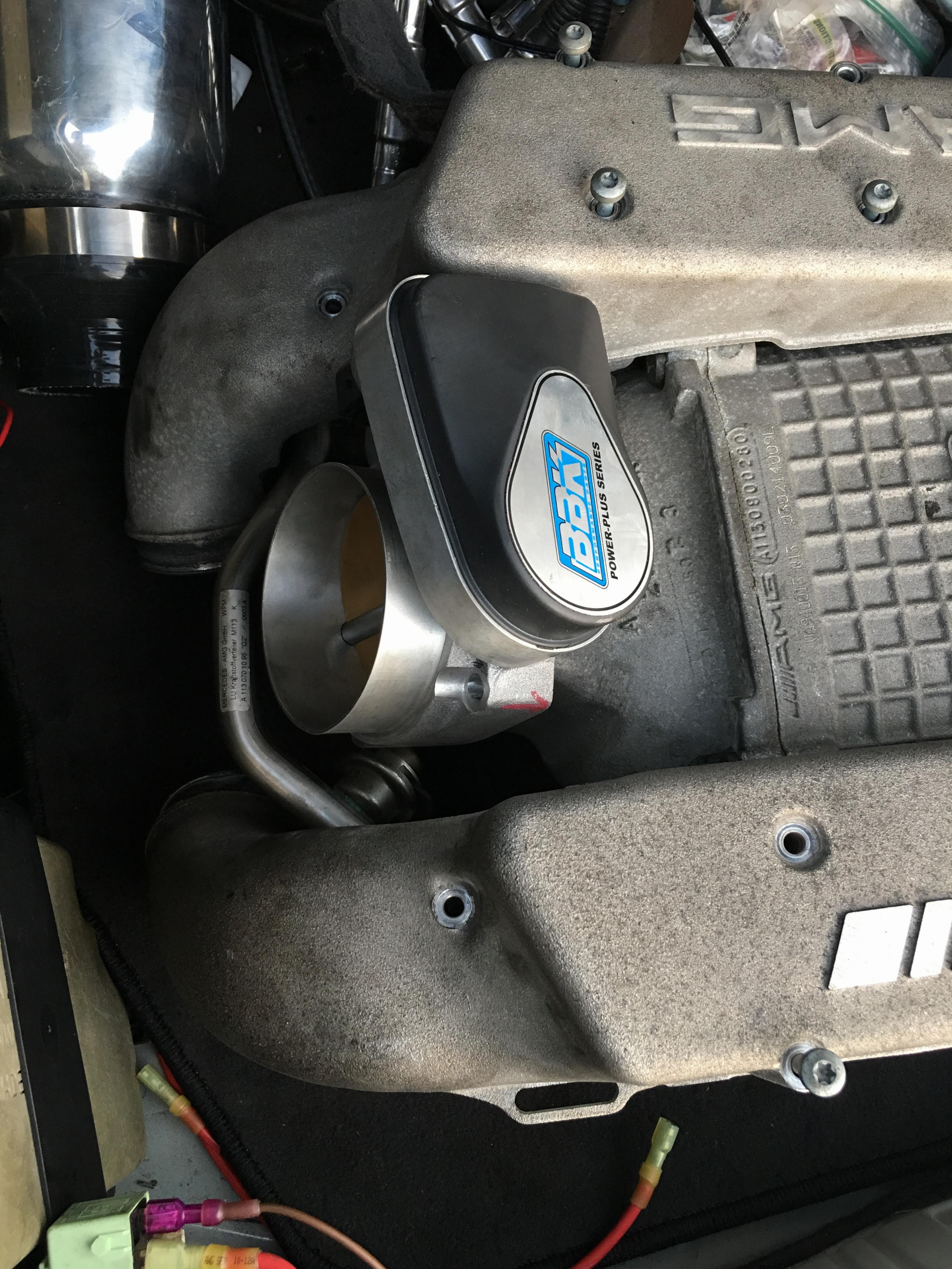

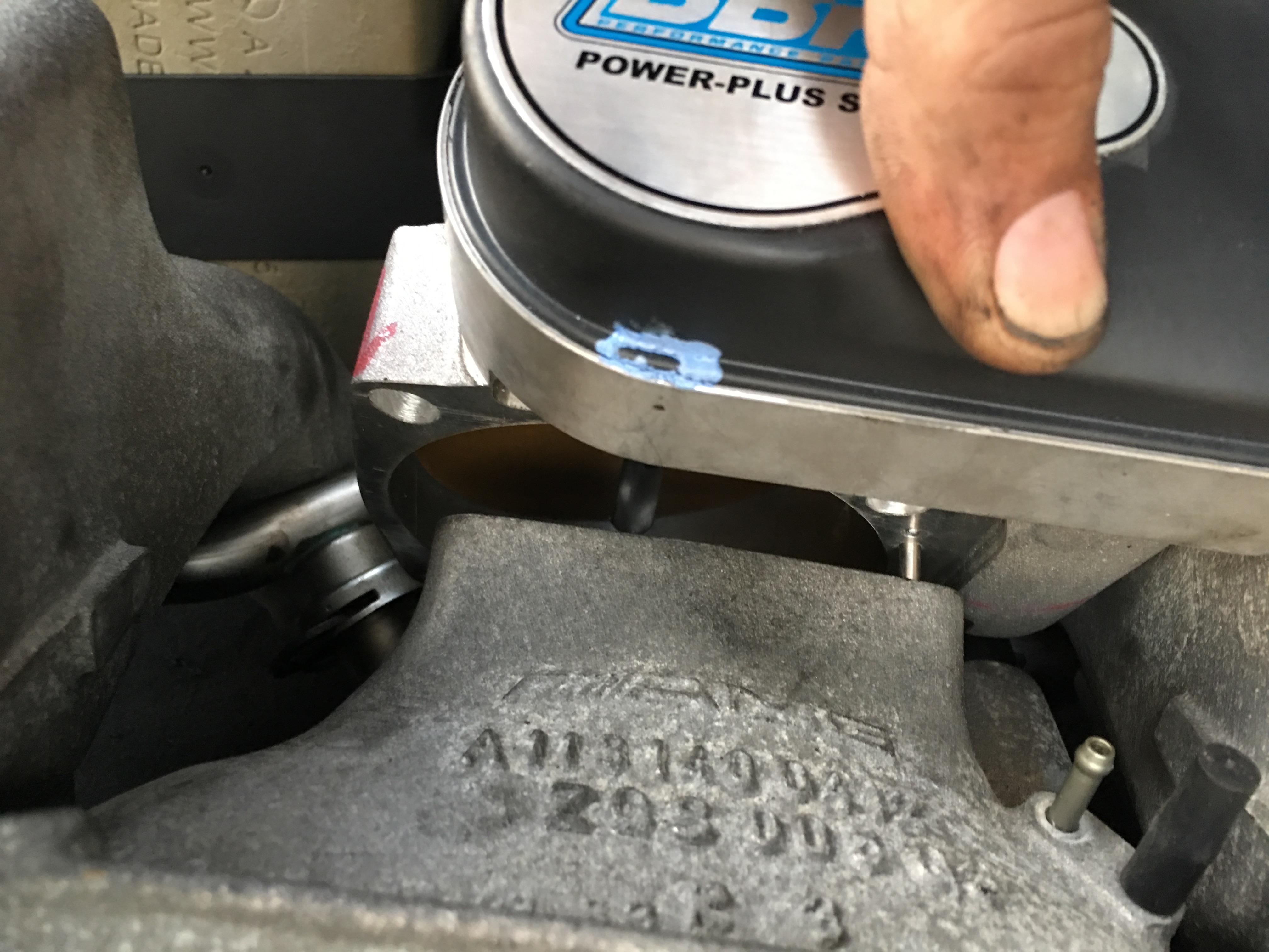

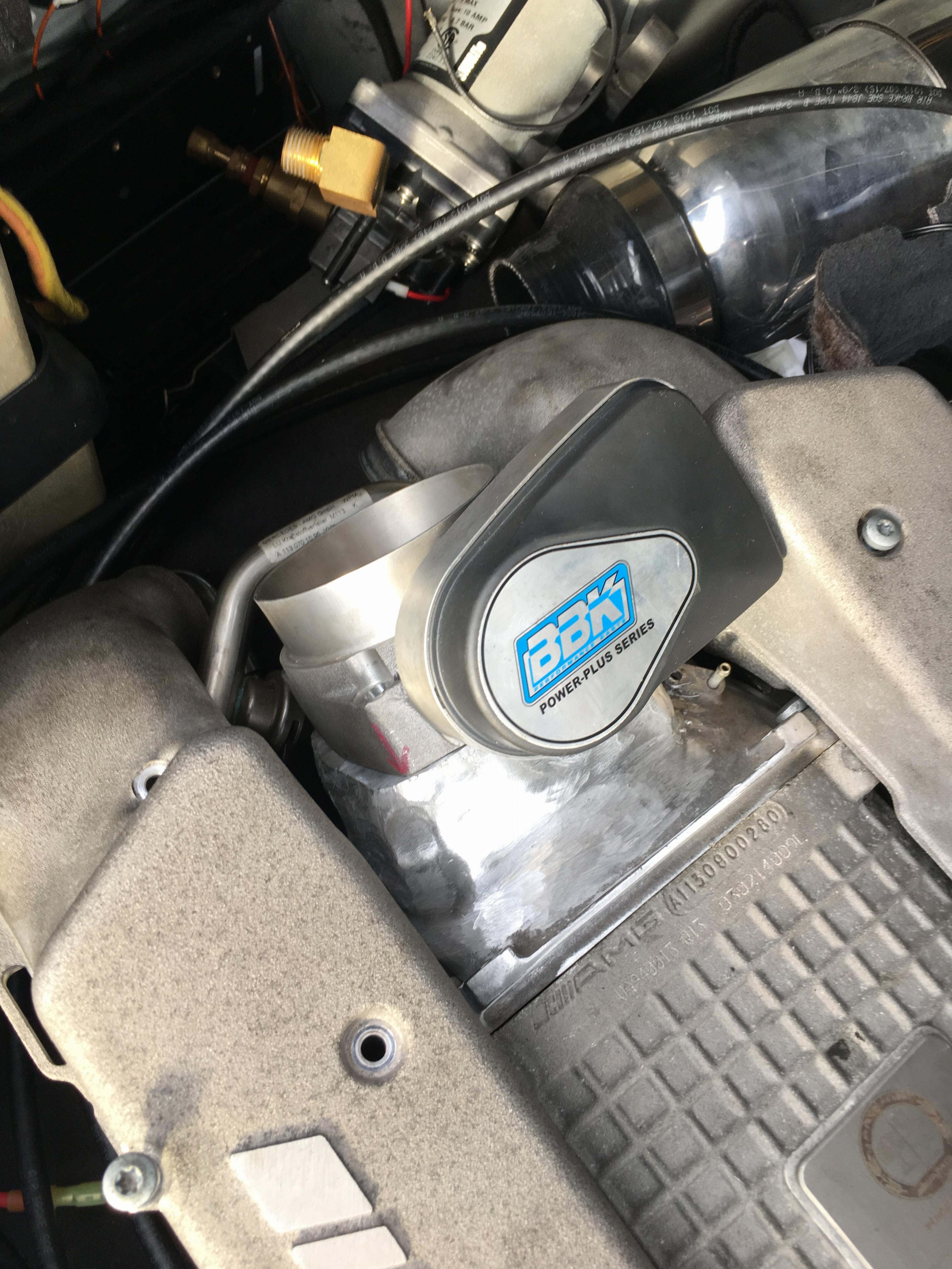

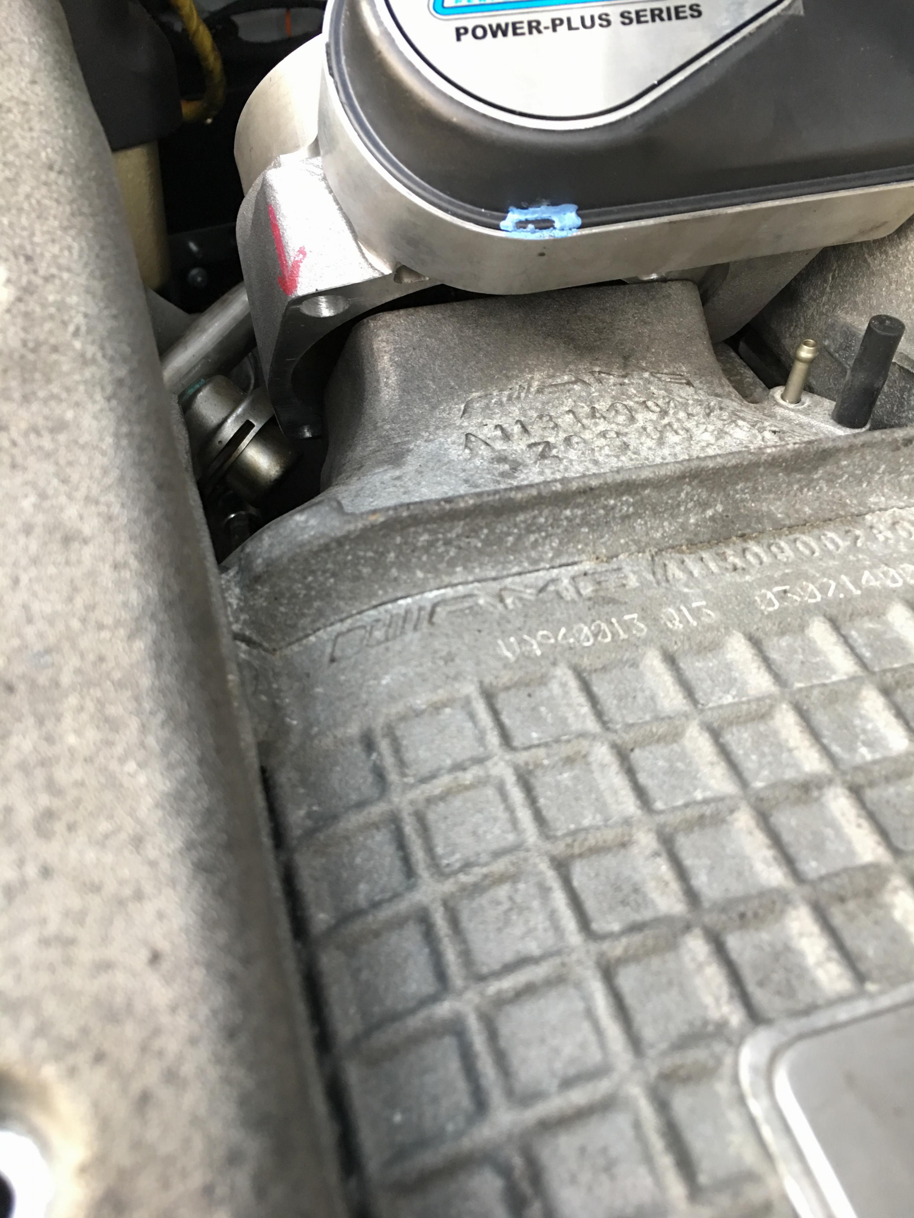

                    Got it mocked up where I want it, this BBK is a tight fit. Notice in the bottom left it is almost touching the fpr, on the right it is touching (what they call a surge tank in Mercedes land) but I would call intake manifold or intake runner. I have to shave off the protruding engraved bbk logo, very little, too fit.

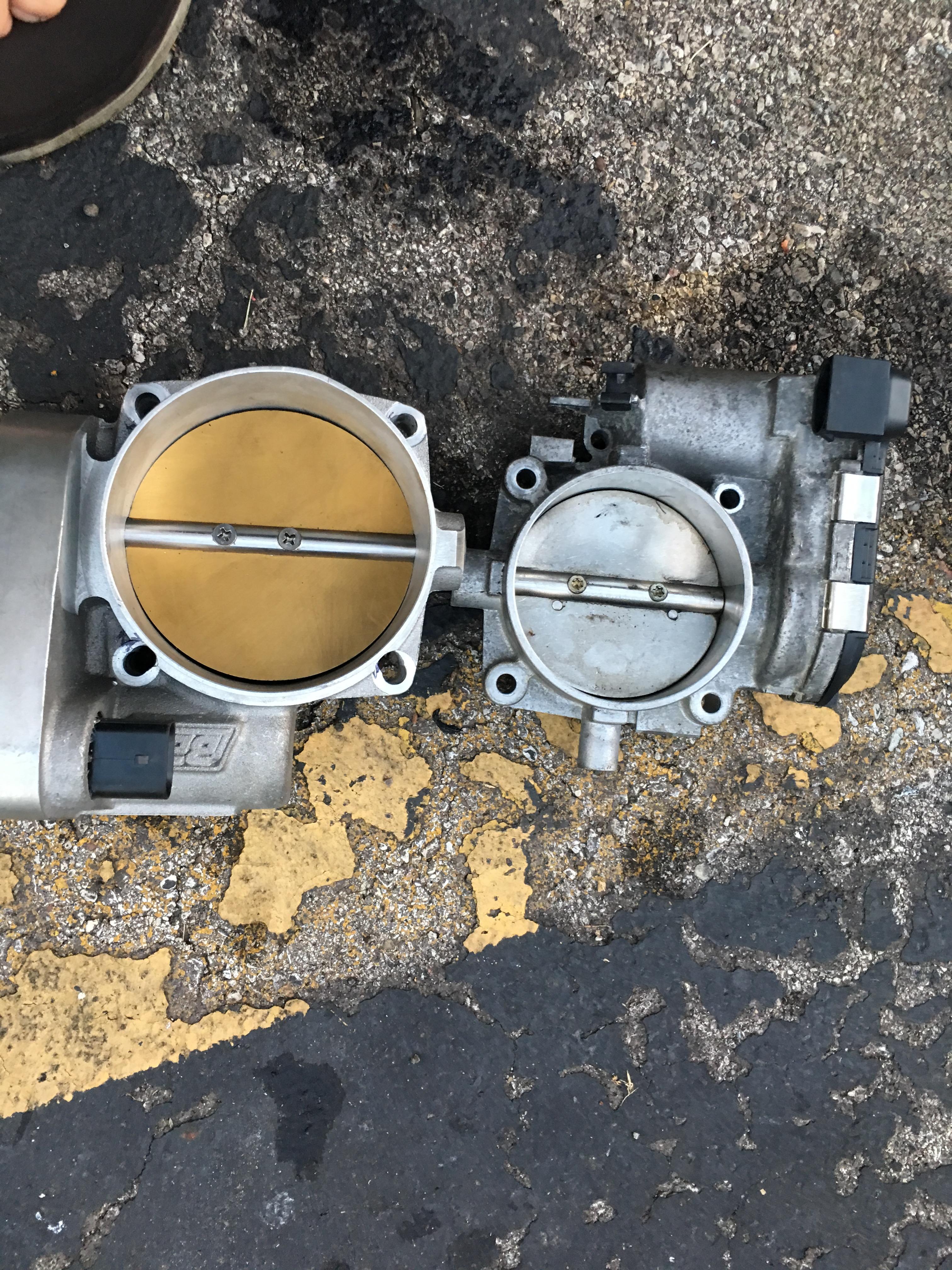

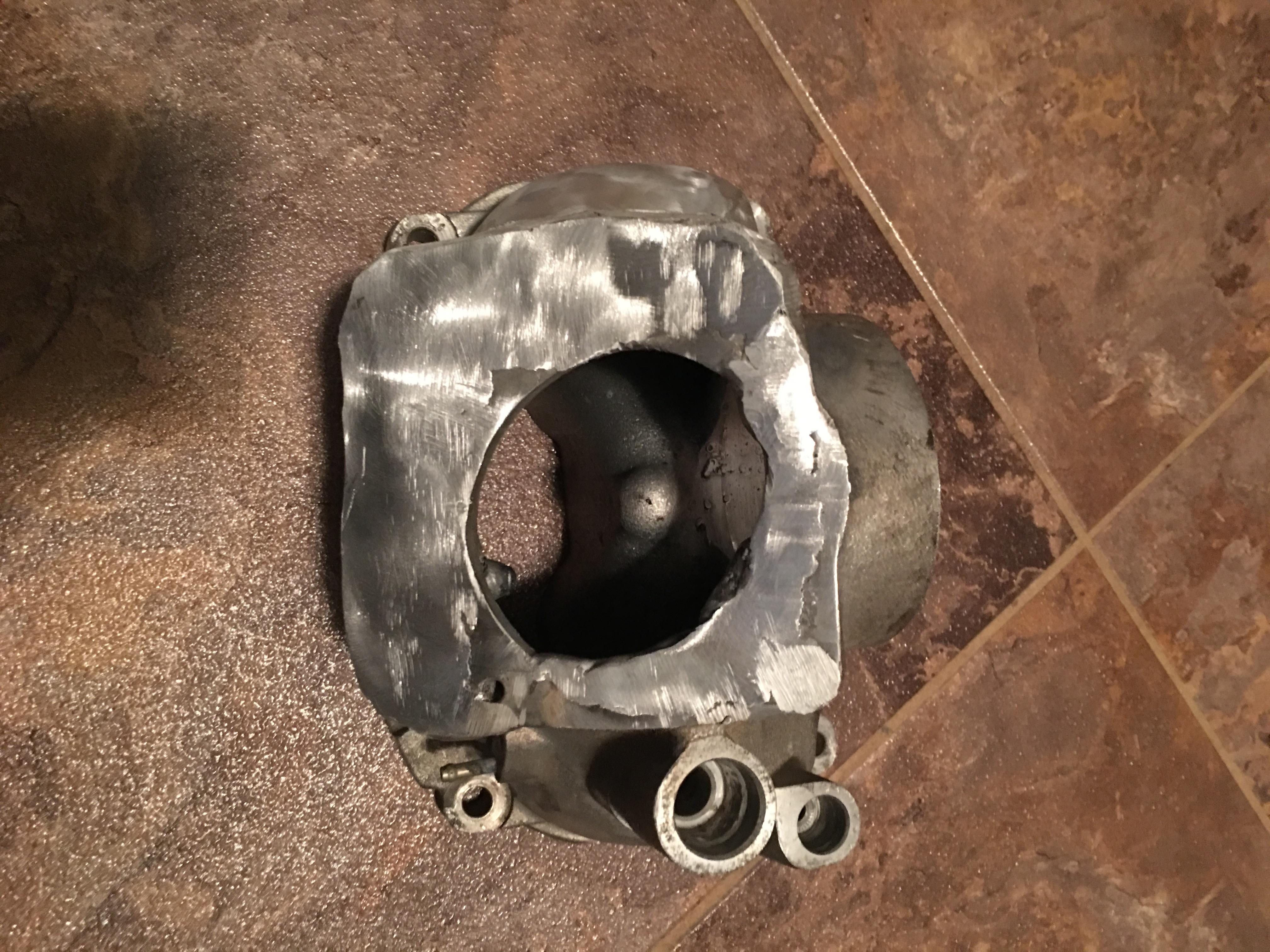

                    I'm basically going to fill the shit out of the little snout where the throttle body connects and have a machine shop bore it out so I can drill and tap mounting holes. Obviously I will have them machine the matting surfaces flat. Open to recommendations on machine shops. Comparison of old vs new.

                      Got the snout pretty much complete on my end, I'm going to bring it to the machine shop on Tuesday.

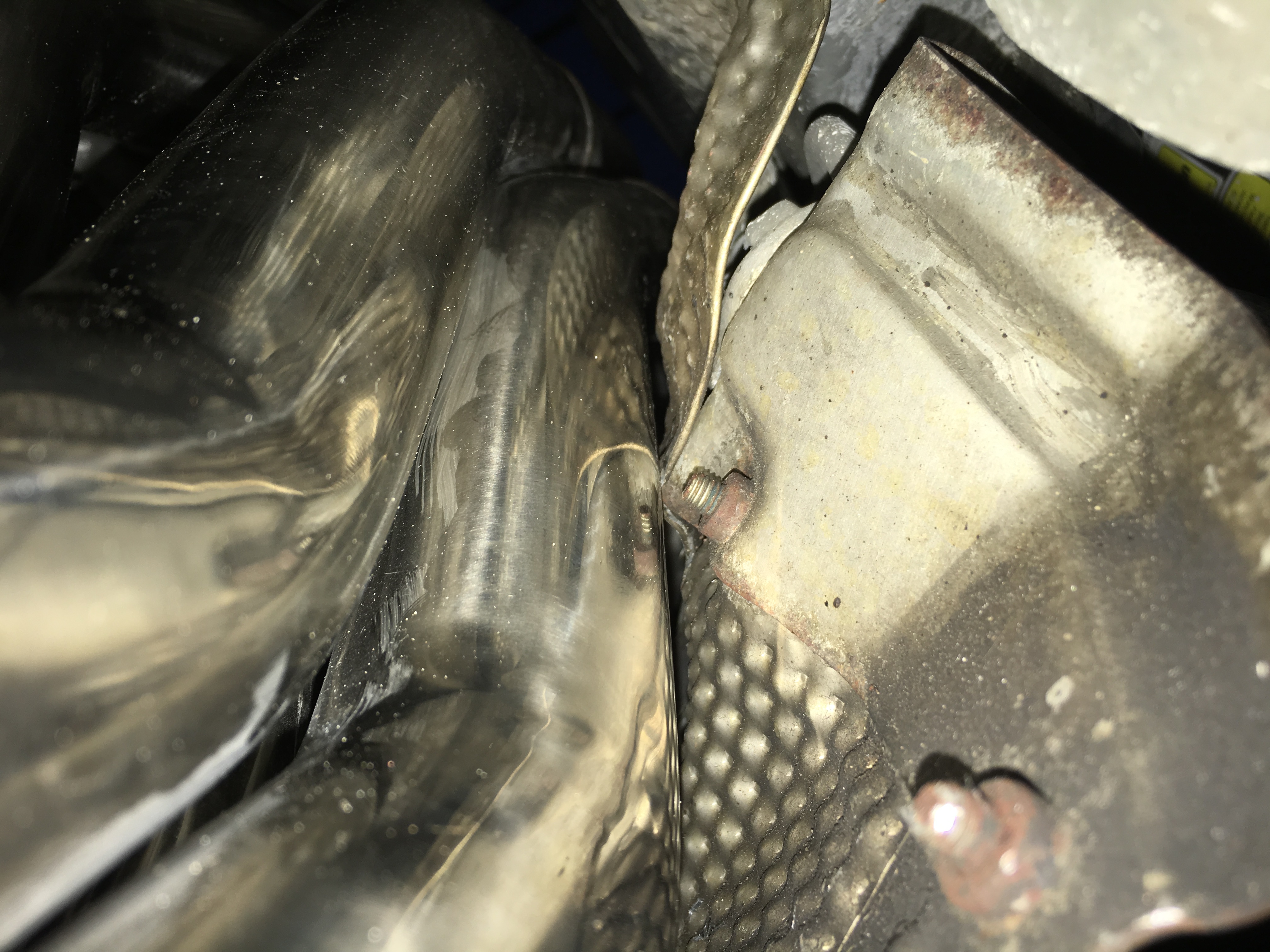

                      also had to make some room for the headers on the driver side by chopping a chunk out of the subframe. It was just an extra tab for mounting hydraulic lines so no structural issues. The driver side collector outlet hits the floor and I can't make any more room with a hammer so I'm going to be cutting it and welding it on at a downward angle.IMG1319.JPG
