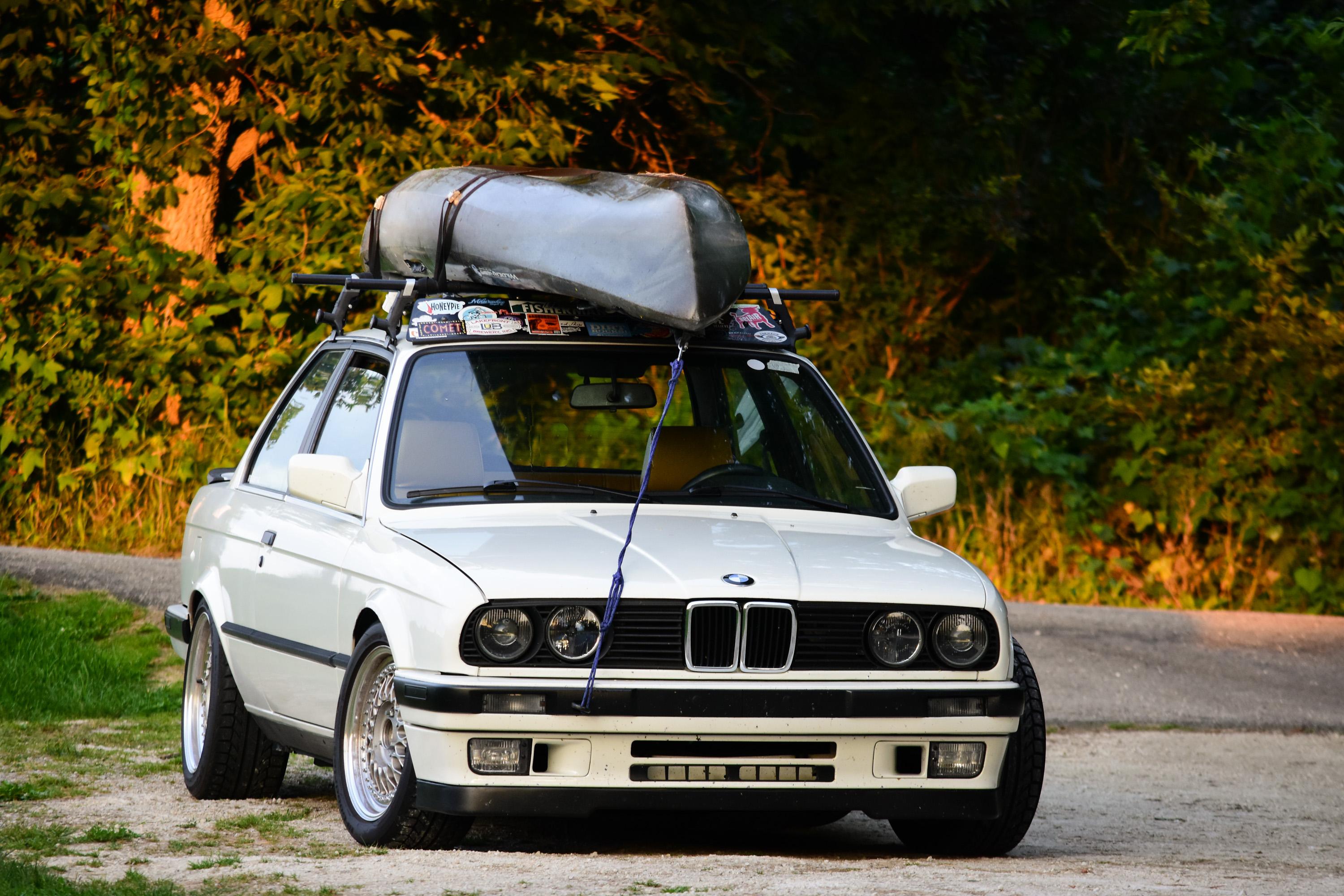

            been slacking on videos/photos from the summer. mostly because gopro changed their studio software and made it 100% useless, and the learning curve on free video software is steep enough to annoy me from finishing. anyways, snapped a photo I liked this weekend on a fishing expedition:

              Is this one of the few running E30s on here?

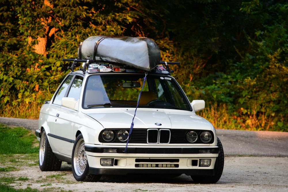

                  been collecting some photos of my car in its natural habitat from other photographers at autox days

                      This car is goals.
