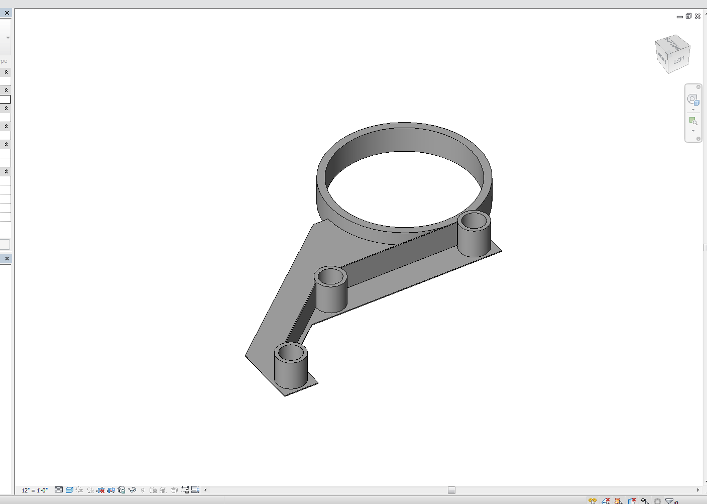

                                          Your secondary diff mount drawn up, my friend! Jut have to determine how long the 3 bolt spacers need to be to offset the mount the correct distance from the cover.
