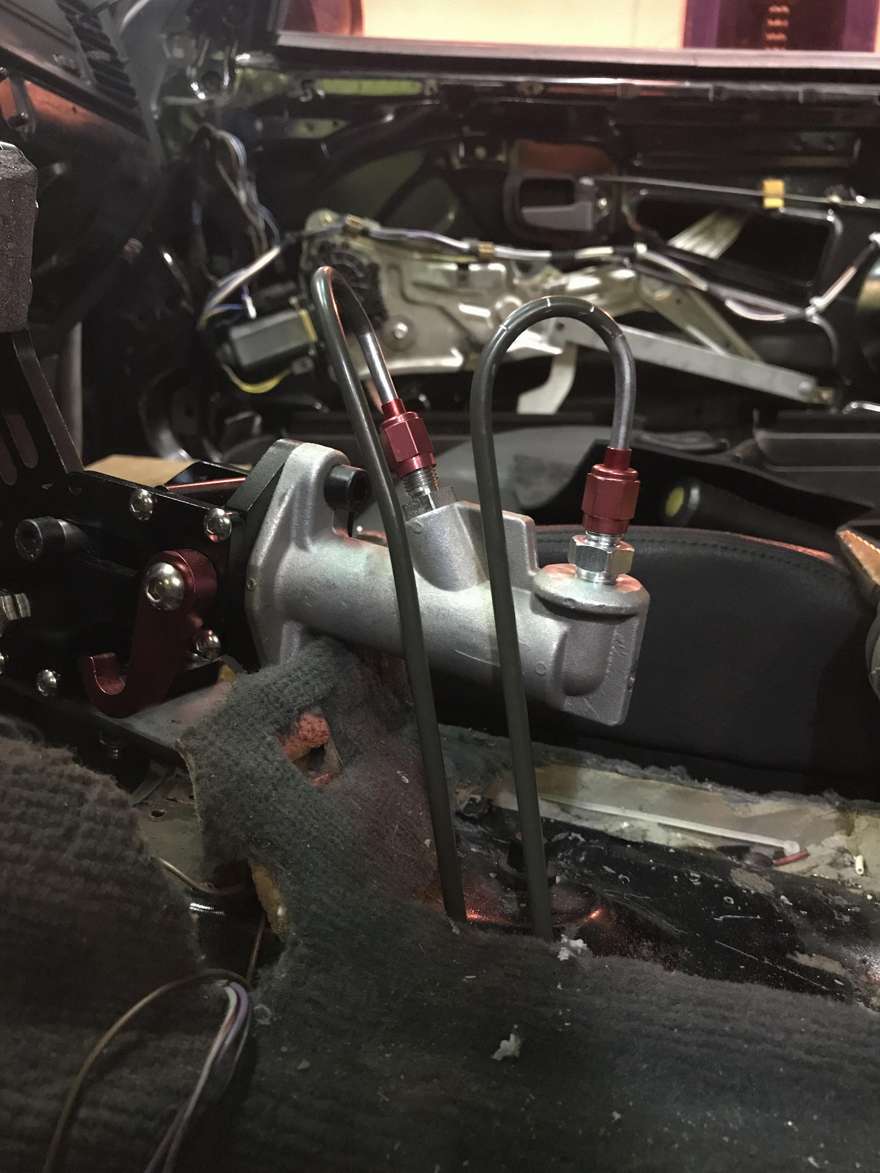

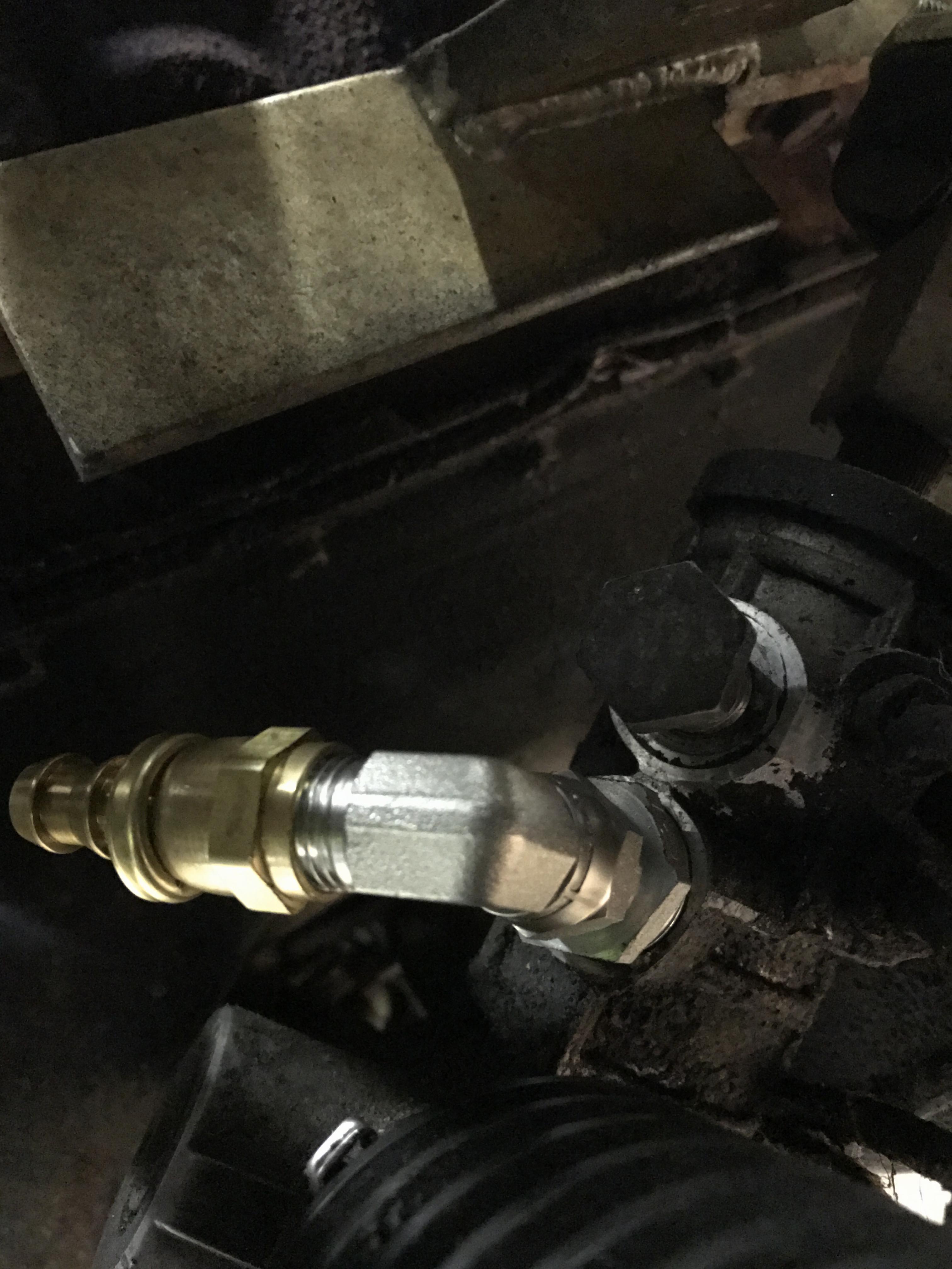

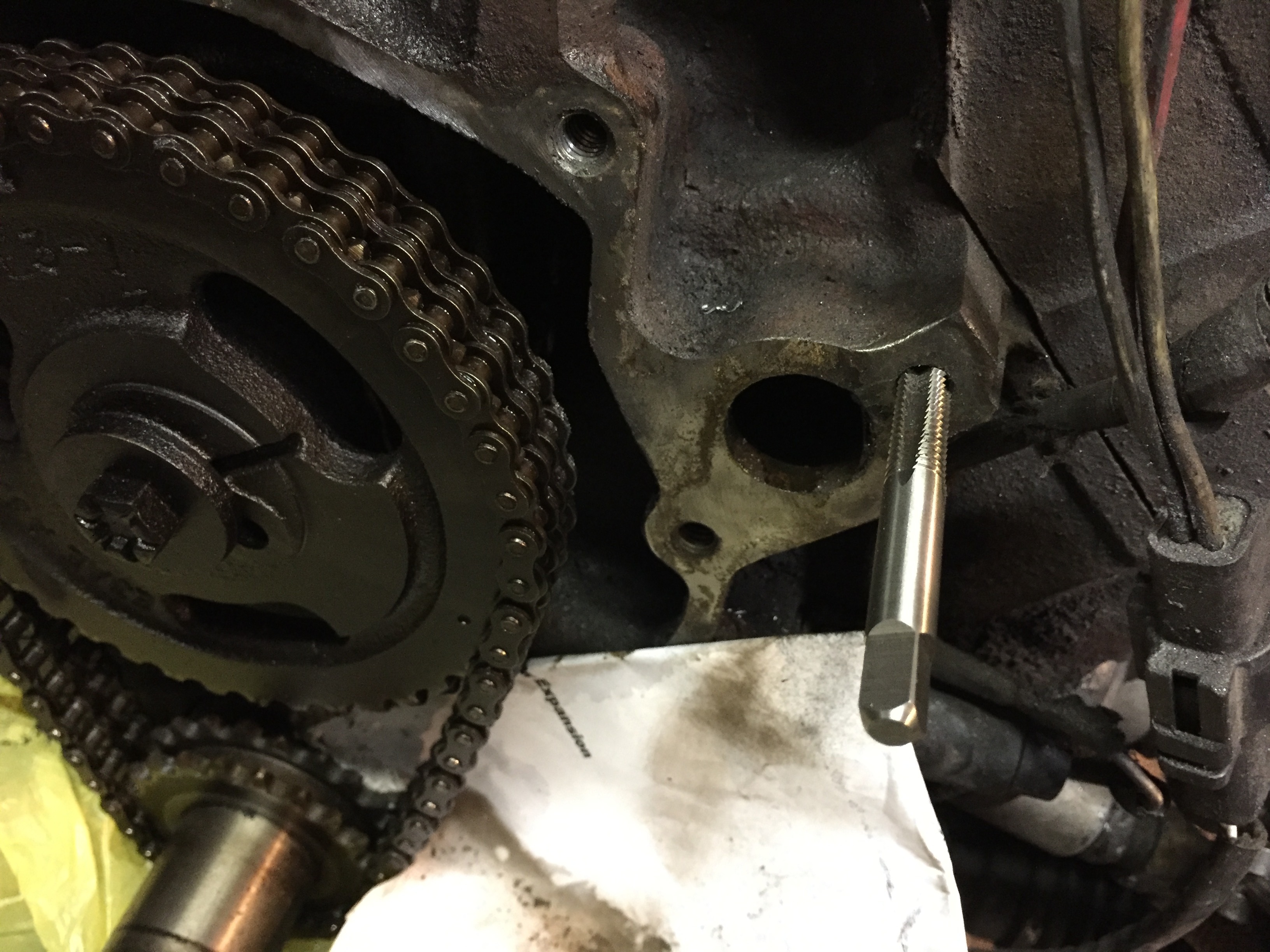

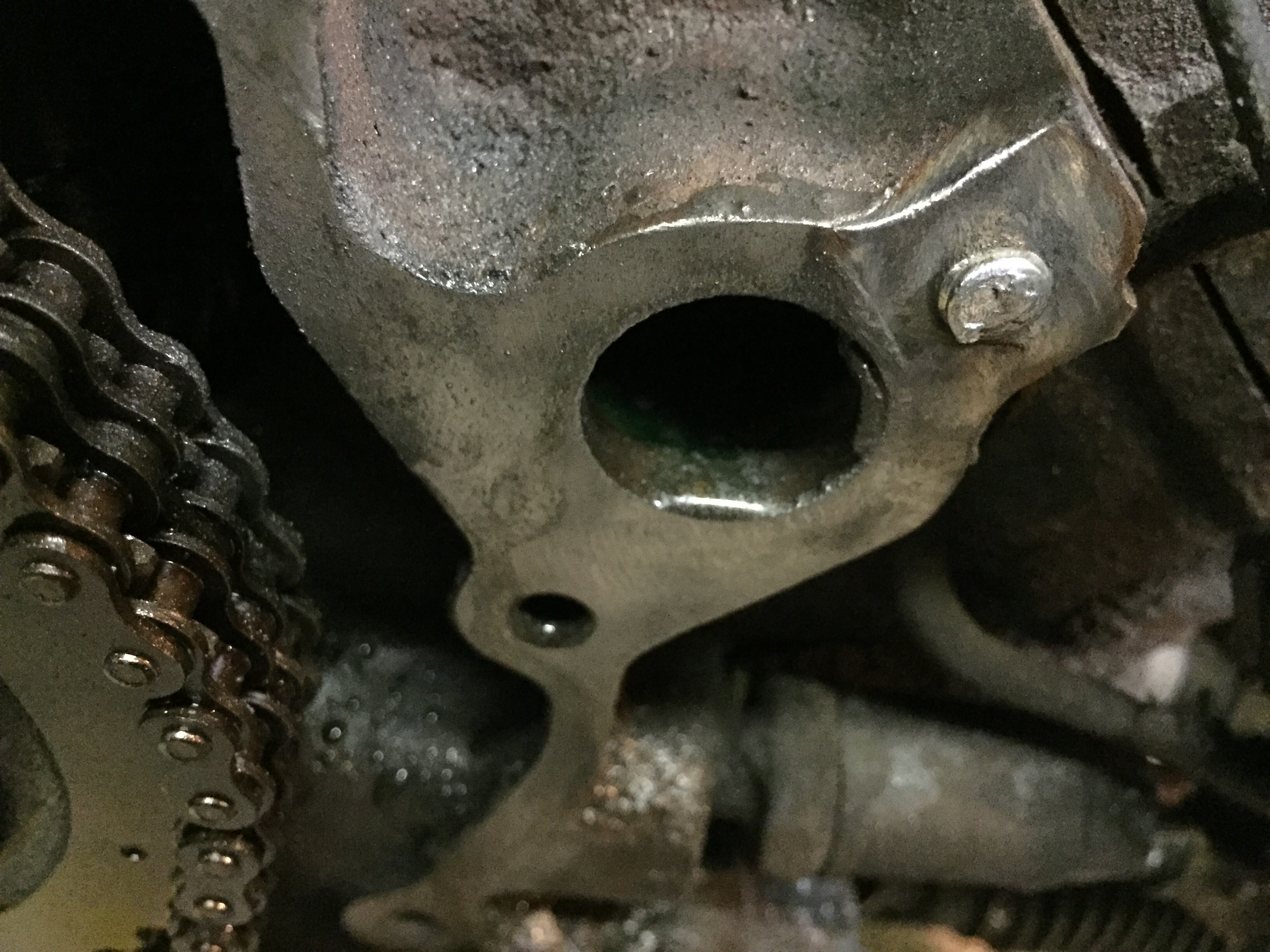

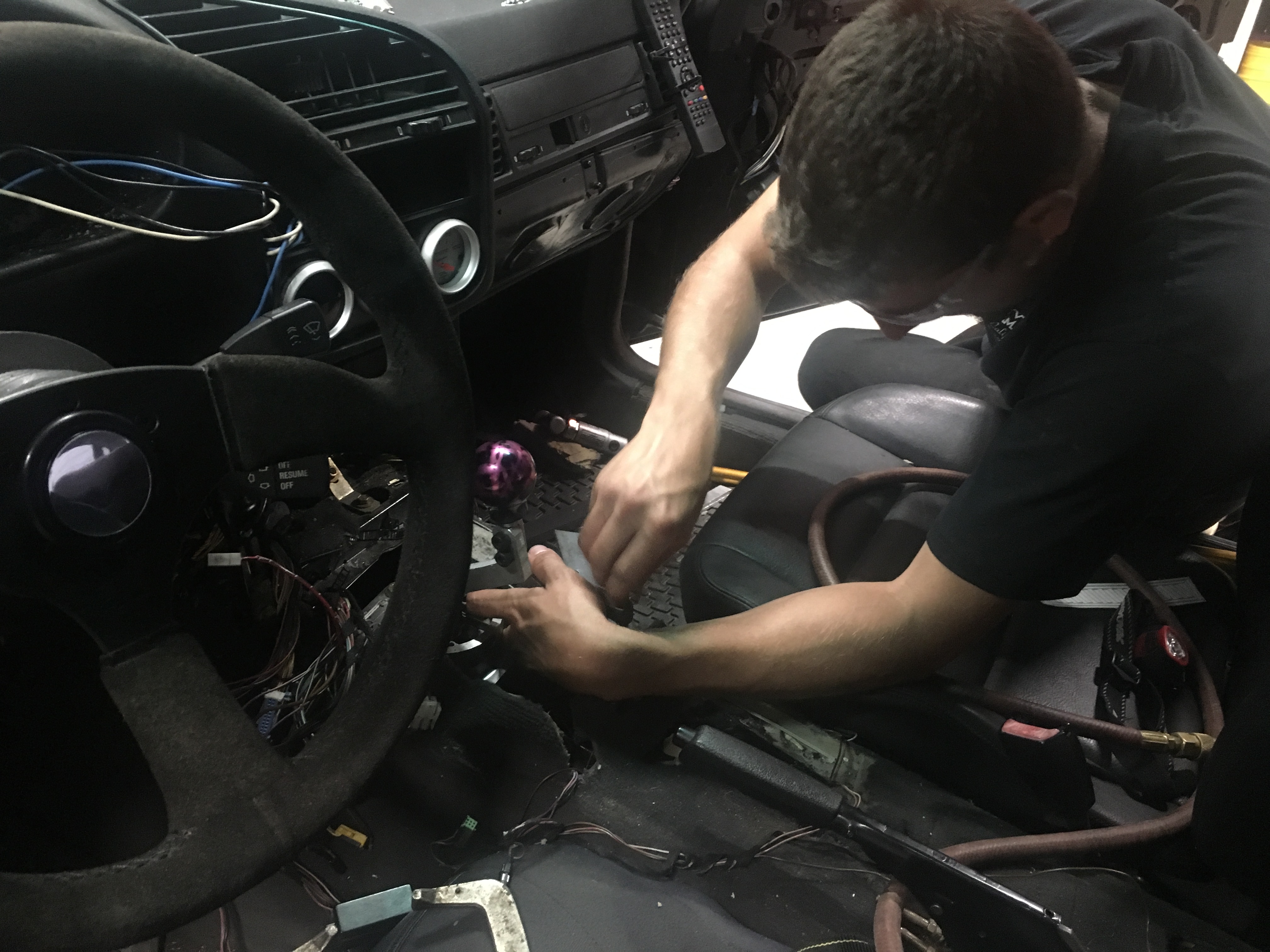

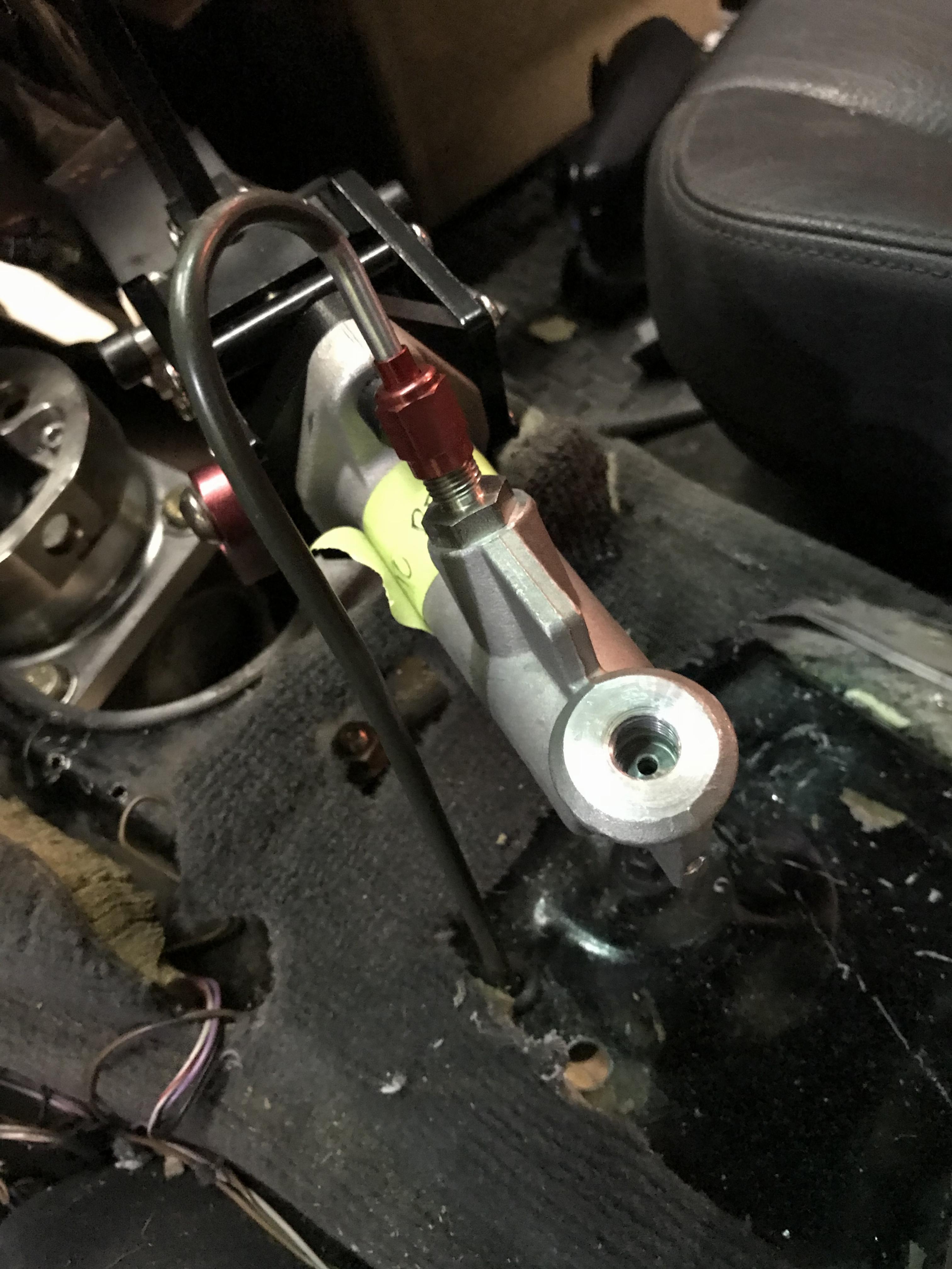

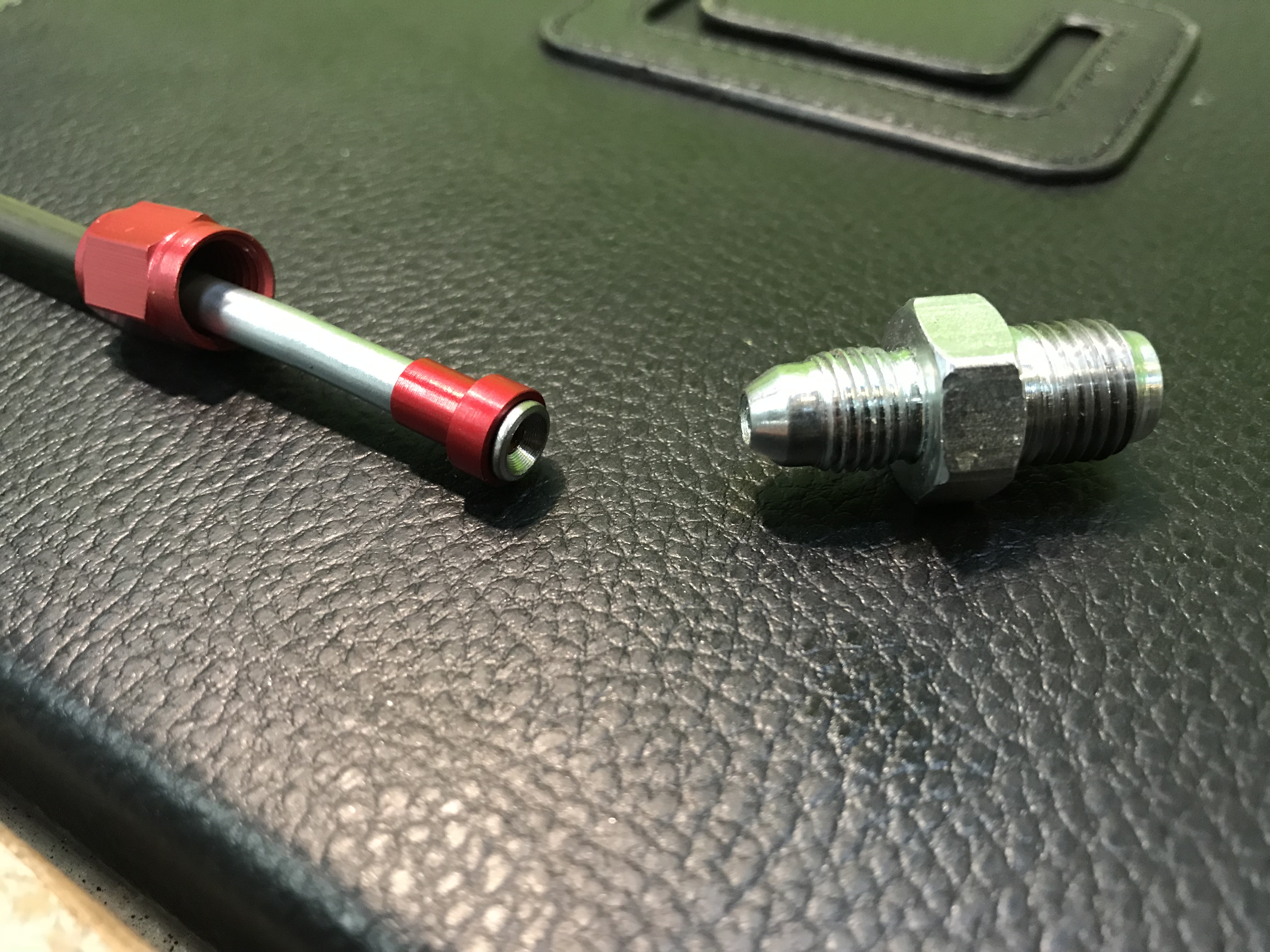

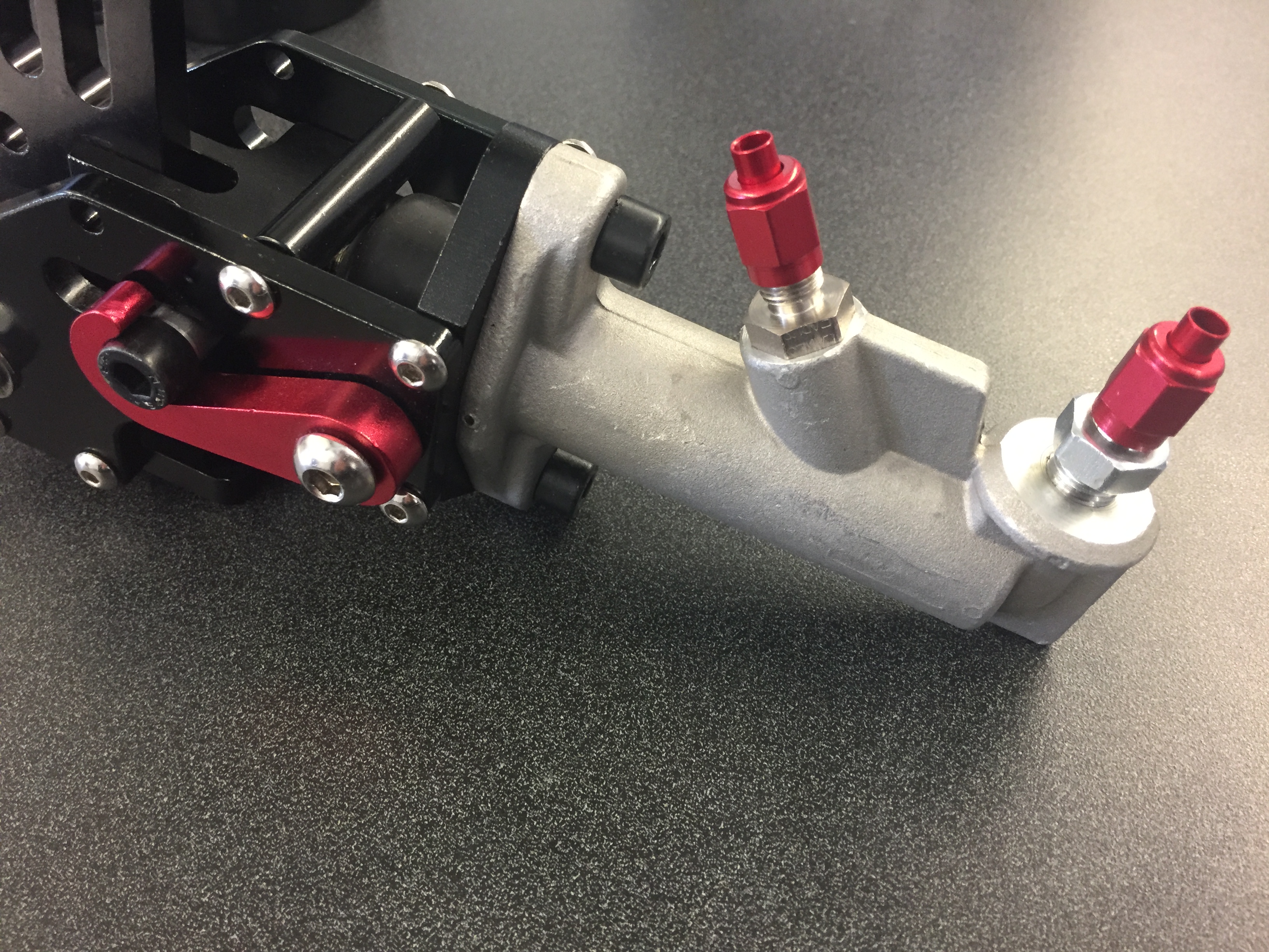

        Also, in further news, my drift stick came. It was half out of the packaging and the anodizing is scratched and banged up. Looks like it already knows the type of car its getting installed into 😎. I was able to use a thread finder at work and confirmed that the fittings for the cylinder are 3/8-24 for an inverted flare and 7/16-20 for a flare tube fitting. To my dismay, the auto parts store had neither. Guess I will have to use my internets explorer to find these such items.

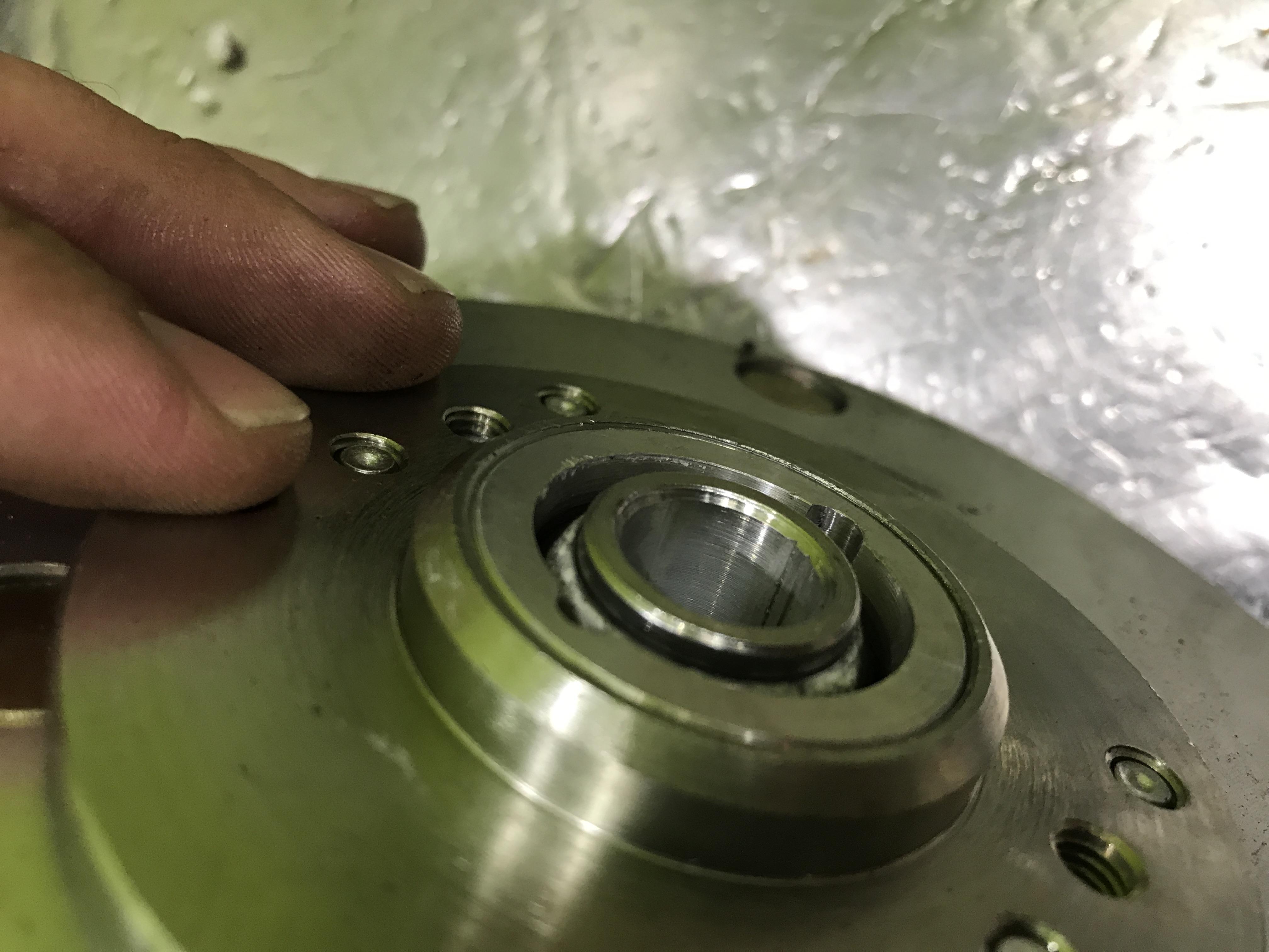

        On top of that, I also bought some allen key set screws for the two open holes on the timing cover. sealed them up and reassembled water pump. Boom, no more leaks, no more loud bearing noise, no more mis-matched bolts, and no more weeping. Drove it around the block, did some drifto's, parked it back inside, life is good. Now onto wangs, tint, and drift sticks.

                Yup. Gonna go tomorrow before 1pm when they close I think. I might have to use a AN adapter to the 7/16 because WHY ARE THEY DIFFERENT SIZES!?!?!
                Also this is the drift stick I got. it was $34 shipped. I already plan on making a new handle. I opted for this because it was cheap, I didn't have to mess with the pivots when making a new handle, and it has a lock for a parking brake.

                    From looking at the Pegasus website, it seams like they will have what I need. I just need to make time to get there.

                      UPDATE. I drove the car to work.
                      EDIT!  I tried to drive the car to work.
                      I got about half way and the watertemps started going to about 220ish. Boiling coolant spewed from the unsealed overflow and on to the windshield (luckily on the side that has a windshield wiper😎) I turned back around and put it back in the garage after pulling over every 5 mins to let it cool off. 😐 Neat experience.
                      ( I cant believe I haven't given up on this turd yet)
                      Tonight I plan on installing a new upper coolant house as the one on there is a shitty flex-fit, a new thermostat and gasket, and attempting to properly bleed the coolant system.

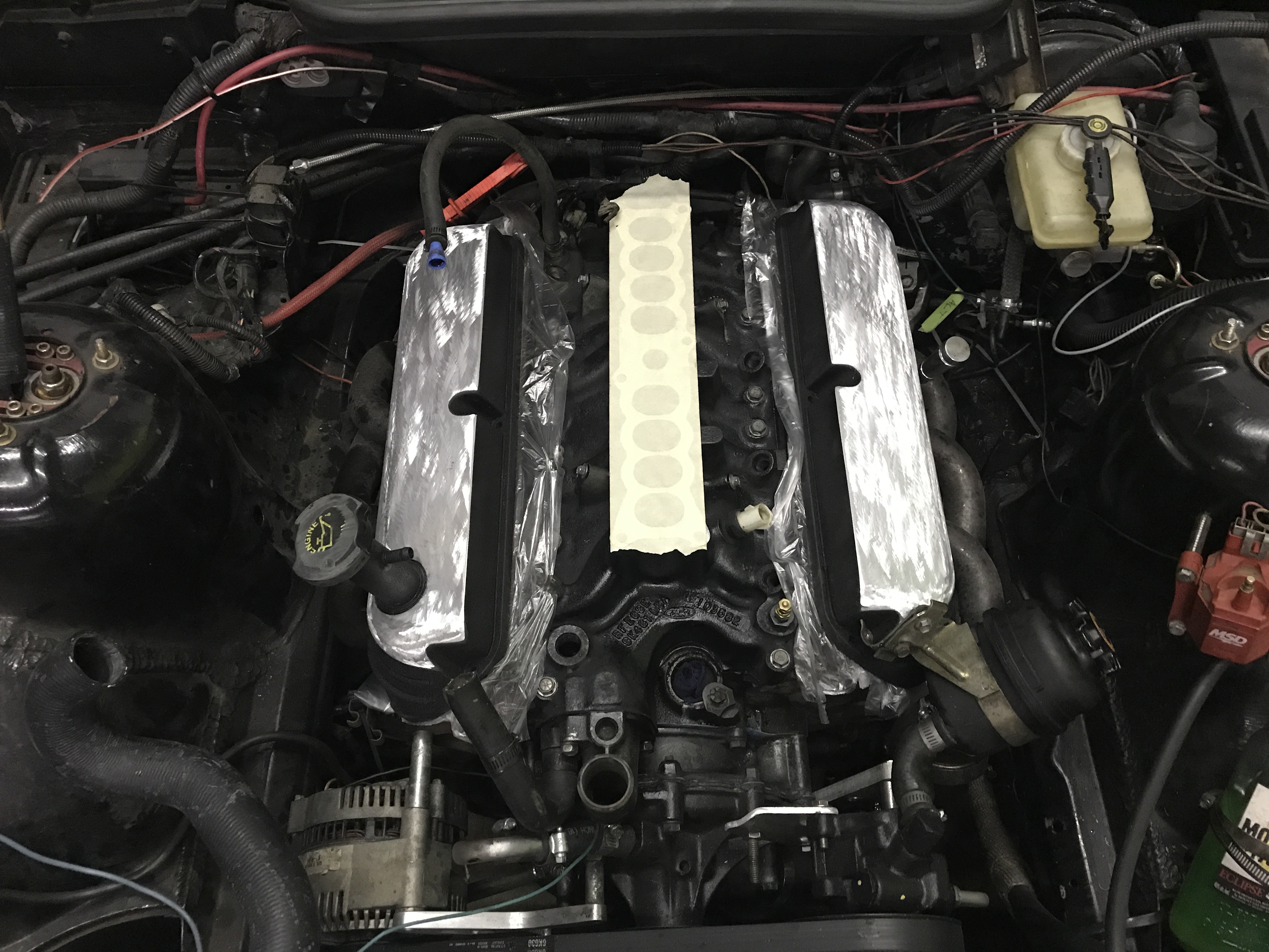

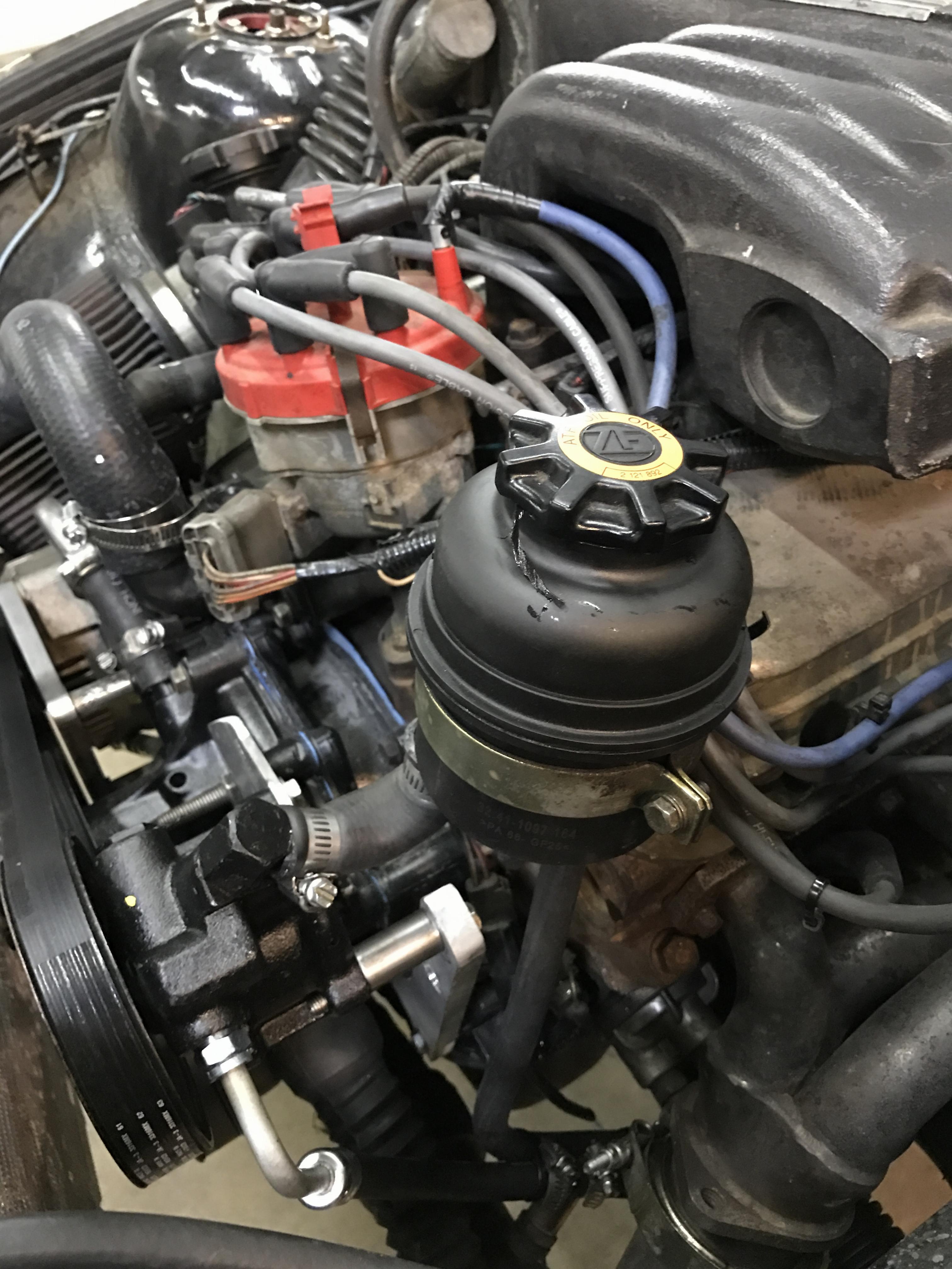

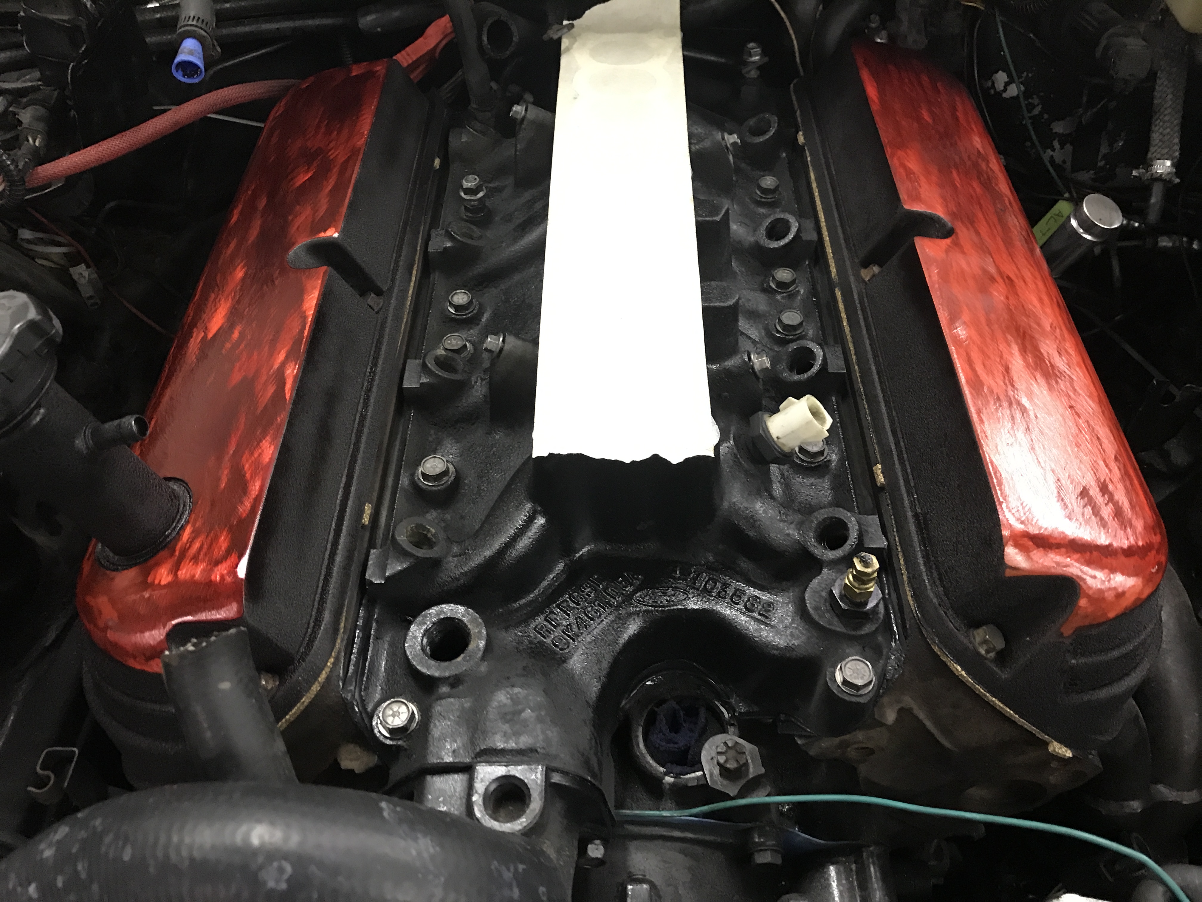

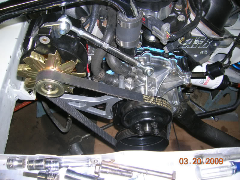

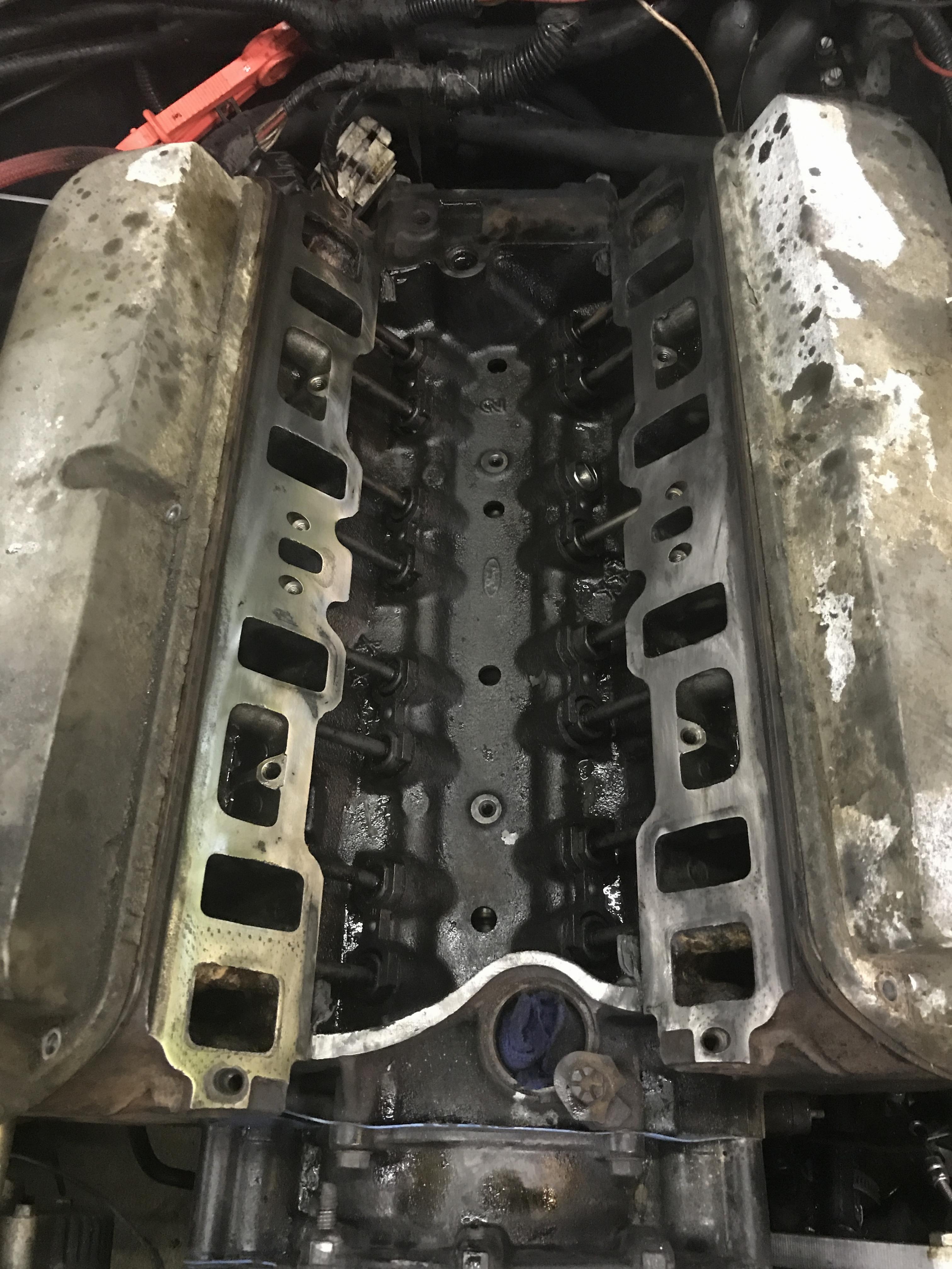

                            Well I discovered what my problem is last night. I sure am learning a lot about these here Ferd motors.
                            I got a new t-stat, gasket, and a new upper coolant hose I chopped up from a ford explorer to replace the shitty flex-fit one. I tried to bleed the system with the front right in the air and the cap as the highest point. It burped for awhile then suddenly tons of coolant poured out. Almost a whole gallon worth. Really weird. So then I shut the car down and topped it off again and let it bleed some more. This time I put the cap on when it started pouring out. Coolant gauge was reading a steady 180 at idle. I decided to go around the block and see what would happen. Here's where I noticed something odd. If I was on the throttle, temps would rise to 230 and continue but at idle they would slowly come back down.
                            Any guesses on what would cause this........
                            Okay fine I already know the answer. Since this motor has been around so long, components and accessories need to shift from the left to the right of the motor, depending on the car and the belt style. For example, a 1992 mustang 302 would have a serpentine belt spinning most of the same components in the same direction, where as a 1977 Ford F150 302 would use a V belt and have some of the same components mounted in different locations, and possibly have them spinning in the other direction.
                            Moral of the story? I have a counter-clockwise spinning water pump spinning clockwise. As exciting as this is, I might not have to swap it out. I can simply install a power steering pump that is not on the car and make the belt go under the pulley rather than over, flipping the direction in which it is turning. UGhhh isnt learning fun?
                              #62
                              Here is a visual for you guys to understand what I'm talking about
                              What I have now
                              And what it needs to look like with the PS pump added
                                #63

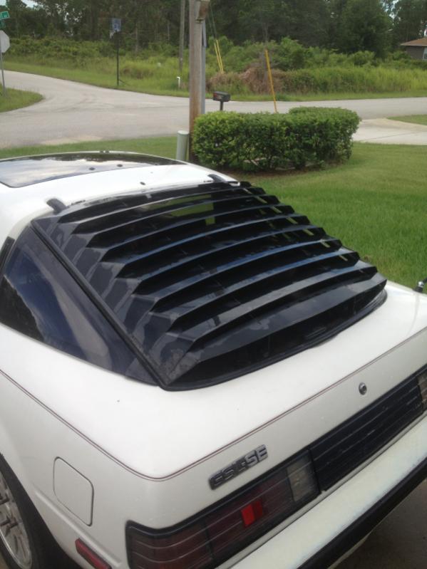

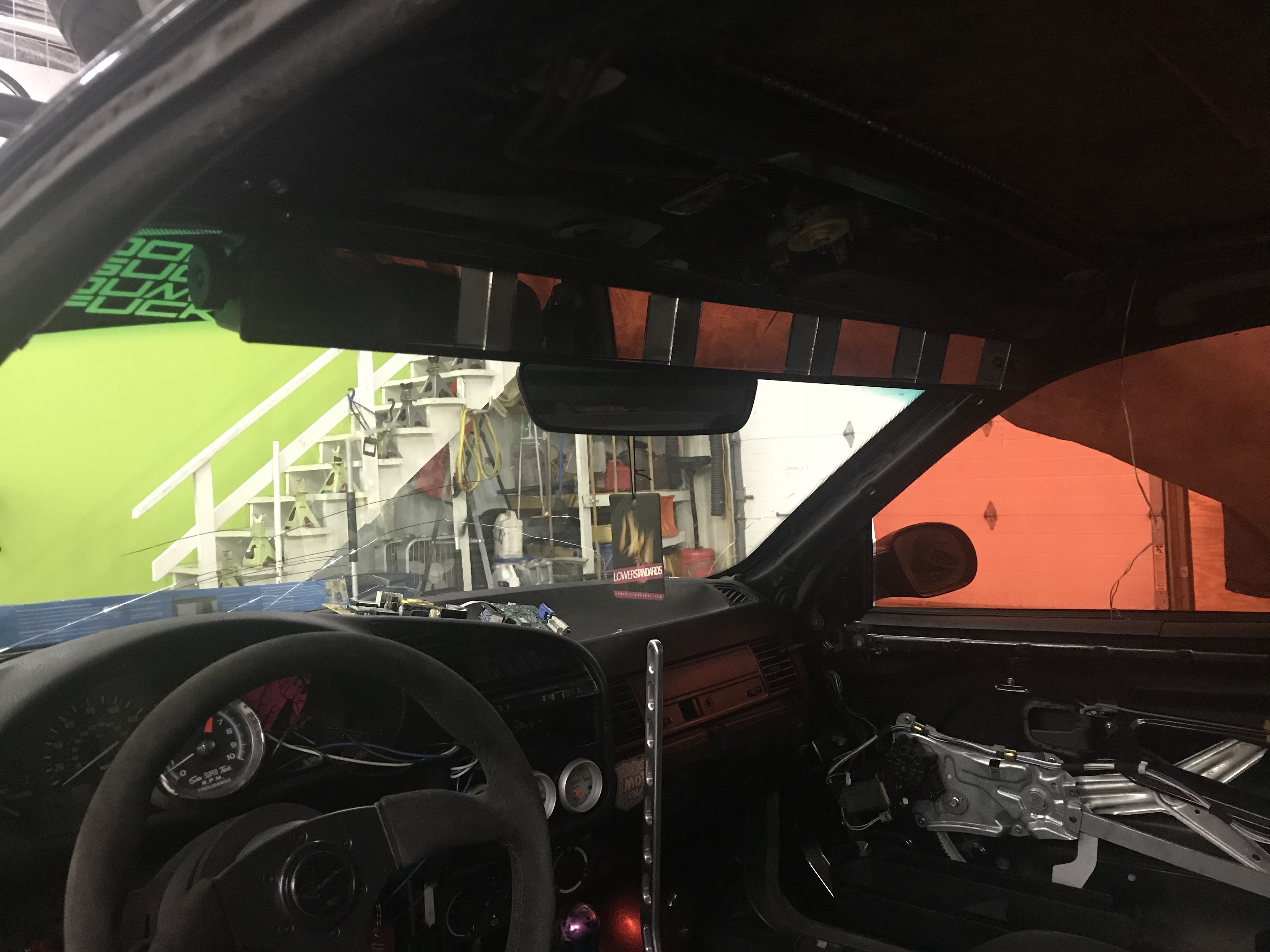

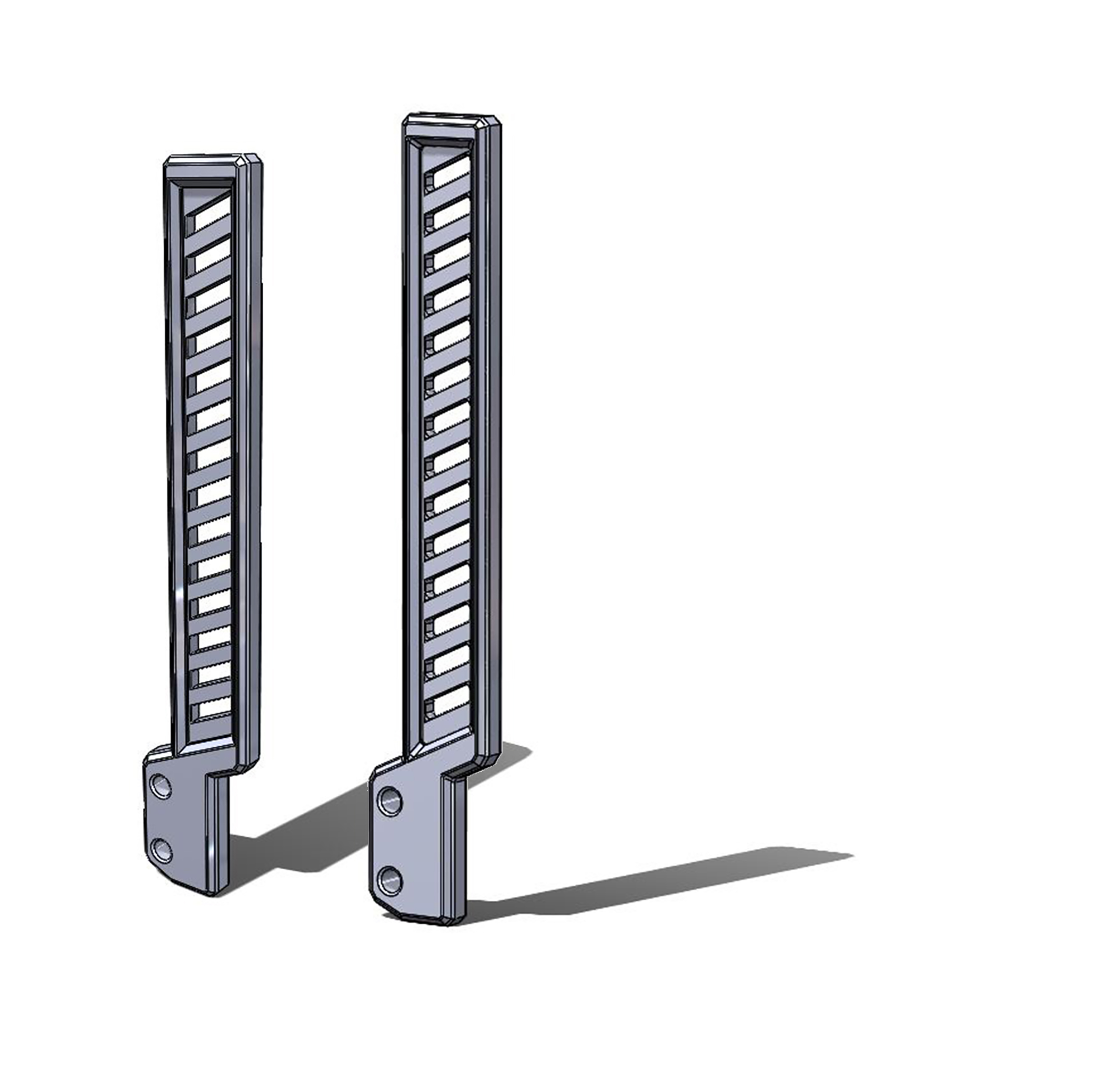

                                Also, on the more aesthetic side of things, as I patiently await my red window tint, I started to think about rear window louvers. Now there's a few threads out there on other forums about E36's with louvers and it just doesn't exist. And from what I gathered, the whole world will burn if I make it happen.
                                Well I guess I just want to make the world burn.
                                So if you guys have any leads on your brothers, or your cousins cousin, or your uncles Larry's bitching mustang that's been sitting in his yard with a set of window louvers hes willing to sell, send me in his direction. I want a set. I found a few on C-list, but im not 100% they are going to fit with my dimensions. I also have my eye on some of those roof visors that people put on civics. I figured maybe I could take 5 or 6 of those things and layer them giving the effect of louvers. Any ideas here are welcome as I want to keep this cheap, even if it meant I have to start making fiberglass molds.
                                Pics of said louvers:
                                AST10532-1.jpg0001917bmw-e28-e12-rear-window-louver.jpegacCFfn4.jpgimage-620569016.jpg
                                  #64
                                  I had a friend in California who is close friends with the guy that does louvres for 350/370z's and other newer cars. He had my friends m3 to make louvres and the shape of the rear window wasn't working for him to built a set that fit right
                                    #65
                                    Thats good to know, any pics of said car and louvers? I want some!!
                                      #66
                                      The guy I got my fiberglass hood and group 2 airdam from in Portugal now makes louvers for the e21. $250 + shipping. Probably nowhere near the shape you need and most likely more than you want to spend. Figured I would mention it anyways.
                                        #67
                                        The guy never made them because the shape of the rear window didn't allow for him to make it look right. Take a peek at the compound curves of the rear window and you'll see what I'm talking about=)
                                          #68
                                          Dont bring rain to my party. I think I can make it happen. NO MATTER WHAT. So many ppl hating it, or saying it isnt possible is making me want to make it a reality more and more. as a matter of fact, I just finished photoshopping it now.
