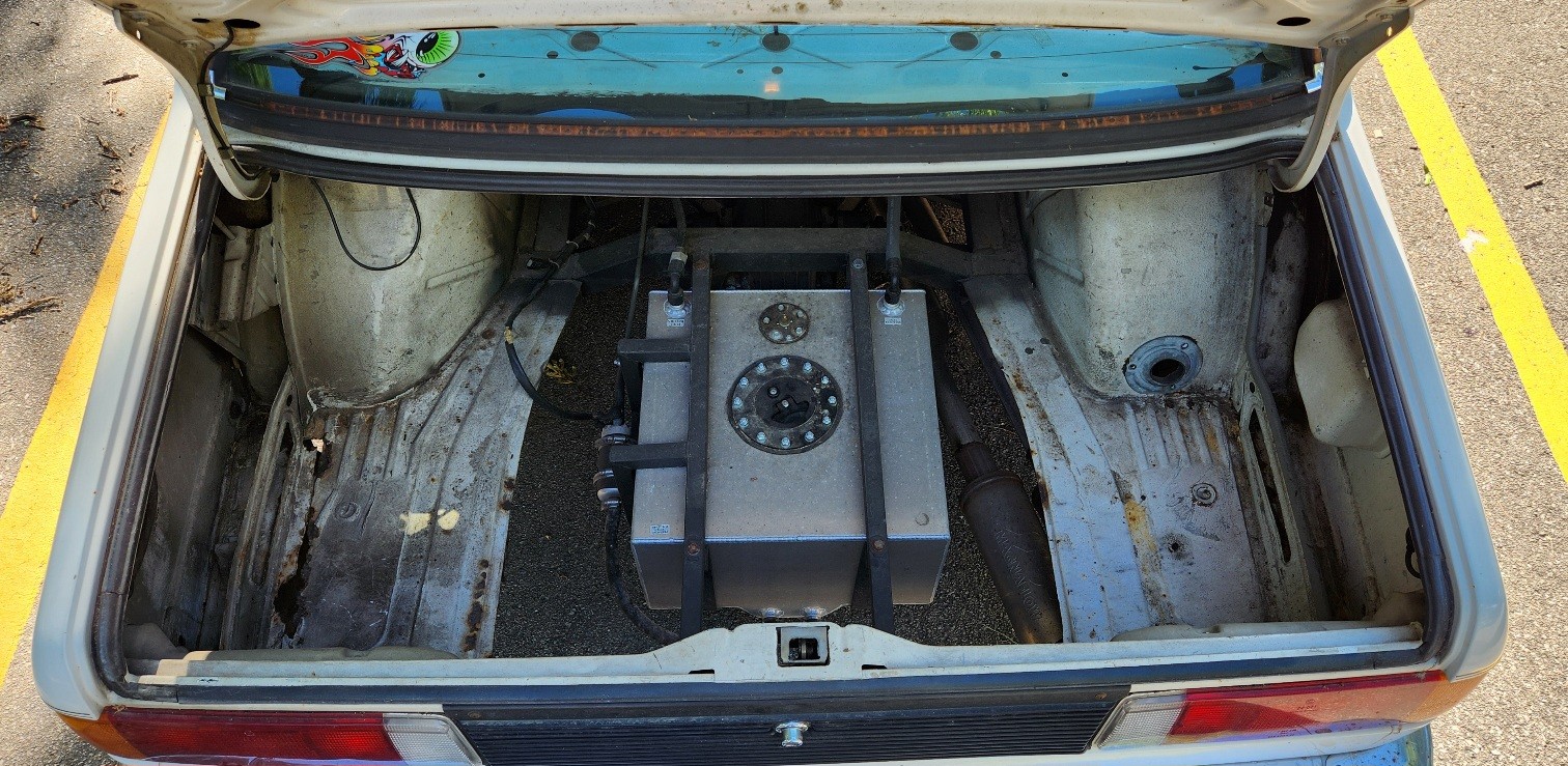

                Battery box:
                Wasn't really feelin it this weekend, so not a ton new progress. I got the fuel cell and pump mounting situation figured out, but my dumb self forgot that I needed to get the welding gas tank refilled, so everything is just tacked in place with flux-core for right now.
                I should have the correct gland nuts next week, which would allow me to set the car down on it's new suspension for the first time. I think that would bring the motivation level back up. It's actually getting pretty close to being functional again....
                  #51
                  Any progress is better than no progress. That battery box looks great. This might just be me not knowing that chassis very well, but that fuel cell looks really low to the ground.
                    #52
                    grounded to the ground

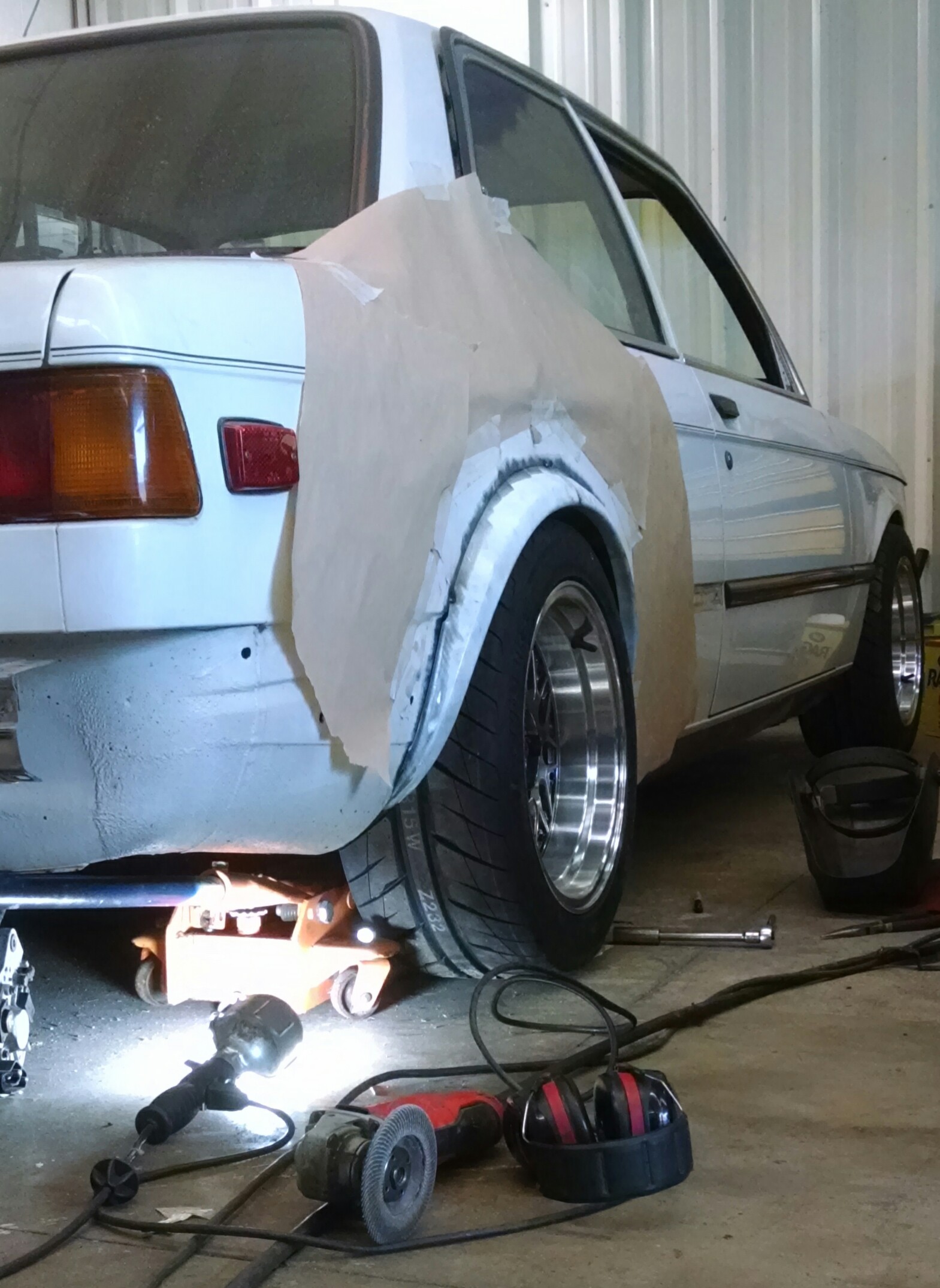

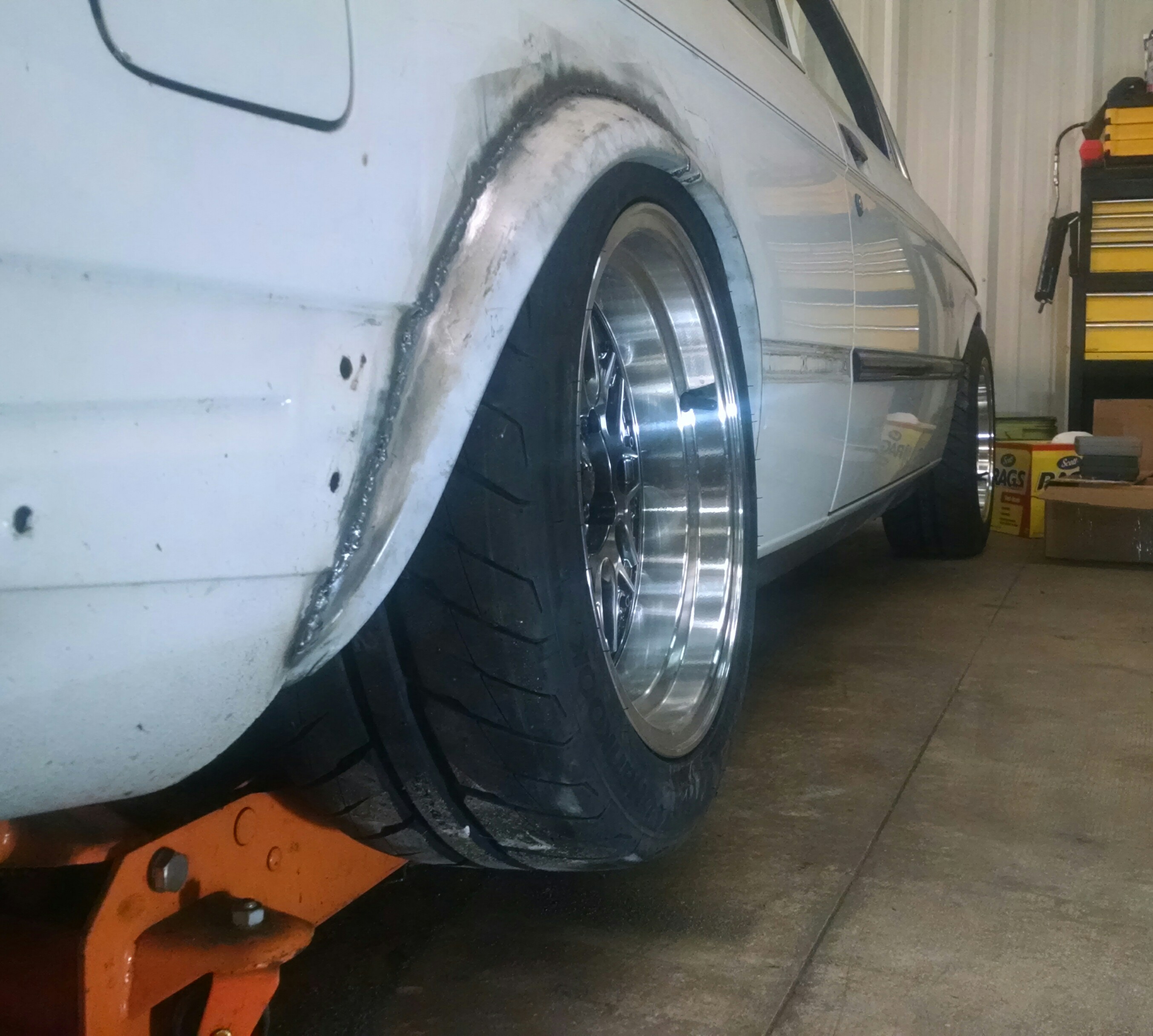

                                          #63
                                          Full compression achieved.
                                          I got about two thirds of the way done welding it before realizing that I was warping the crap out the quarter panel. It's more or less a big flat sheet once you cut the wheel arch off, so it's pretty flimsy and it doesn't take much to mess it up. Cut out half the welding that I did and started again. Ended up with a huge gap to fill between the wheel arch and quarter panel. Realized what I was doing was stupid and cut the whole thing back off. It took a lot checking, wedging, clamping, re-checking, and cooling the panel down after every quarter inch of weld, but I managed to get it on there while keeping everything pretty straight. Turned out pretty well actually.
                                          It needs a little rolling and/or trimming, but it should be a no-rub situation when it's done. Started working on reattaching the inner fenderwell to the outer, but haven't figured out how to stuff myself into the wheelwell so that I can actually see what I'm doing.
                                          Enjoying a well-deserved beer. Almost halfway done! 🍻
