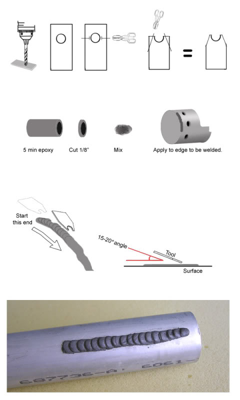

                        In for "simulated welds" im envisioning some sort of putty molded into the gap
                          #72
                          yup, been experimenting with what material will work best. and studying 'weld porn'. silicon sealant is too sticky for shaping. wood filler/wall putty is too gritty. going to modeling clay next.
                          don't think I'll get quite this perfection, but its what I'm shooting for, if possible:
                            #73
                            Im imagining JB weld putty + a shaping tool like a 3/8" round rod to knead it into the gap in steps which would simulate a fillet weld..... In my head at least
                              #74
                                #75
                                i searched for a long time to see if someone had done this full scale and couldn't find anything. where did you find that?
                                and thanks for sharing, that is a great place to start. the only thing different will be working in a corner, versus a flat surface.

                                        #79
                                        You can easily make a tool to do the pattern as well. Cut the half moon shape into any flexible plastic thing. A spatula, bondo spreader, etc.
                                          #80
                                          so, i tried a few techniques and the best turned out to be rolling the clay into same-sized balls (ha) and then pressing them individually into place. it was the only way that really worked with the fact that it was a T weld on a curved surface. i also tried to leave the edges over-exaggerated in case shrinking or paint layers hides it later on.
