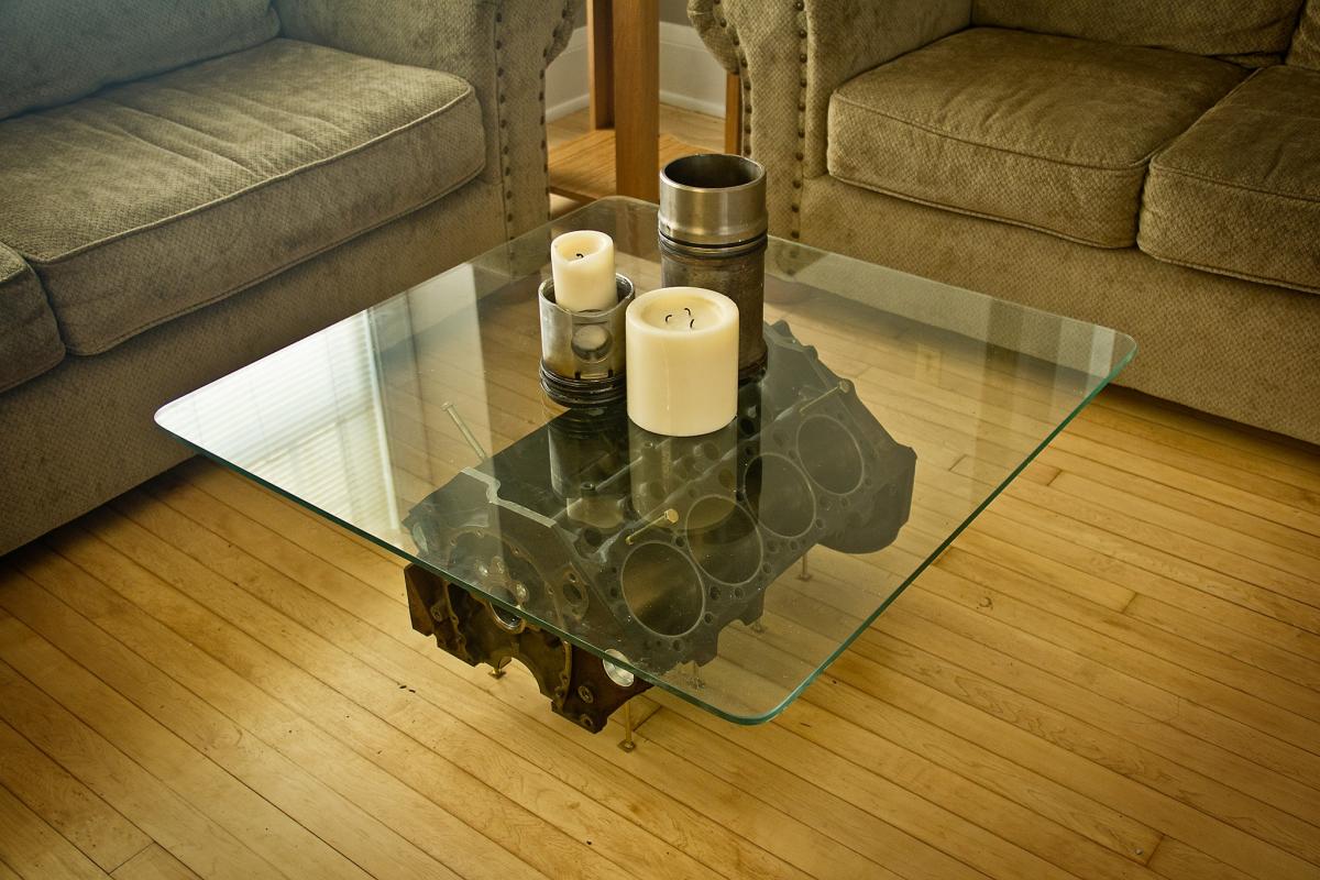

<p dir="auto"><img src="http://i.imgur.com/lVQOvxM.jpg" alt="lVQOvxM.jpg" class=" img-fluid img-markdown" /></p>
<p dir="auto"><img src="http://i.imgur.com/Mgpo9Np.jpg" alt="Mgpo9Np.jpg" class=" img-fluid img-markdown" /></p>
<p dir="auto"><img src="http://i.imgur.com/GELYYDa.jpg" alt="GELYYDa.jpg" class=" img-fluid img-markdown" /></p>
<p dir="auto"><img src="http://i.imgur.com/wl5T18e.jpg" alt="wl5T18e.jpg" class=" img-fluid img-markdown" /></p>
<p dir="auto"><img src="http://i.imgur.com/rra15sG.jpg" alt="rra15sG.jpg" class=" img-fluid img-markdown" /></p>
<p dir="auto"><img src="http://i.imgur.com/uvJnQgI.jpg" alt="uvJnQgI.jpg" class=" img-fluid img-markdown" /></p>
]]></description><link>https://wibimmers.com/post/70600</link><guid isPermaLink="true">https://wibimmers.com/post/70600</guid><dc:creator><![CDATA[straight6pwr]]></dc:creator><pubDate>Fri, 22 Jul 2016 01:27:33 GMT</pubDate></item><item><title><![CDATA[Reply to BMW v8 engine coffee table project on Fri, 01 Jul 2016 23:56:45 GMT]]></title><description><![CDATA[<p dir="auto">lol, leadballs.  apartment to apartment in the same building, so no agent. homeowner-ship? then I would have no monies for dumb stuff like engine tables.</p>
