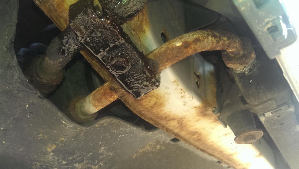

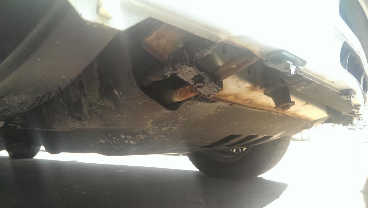

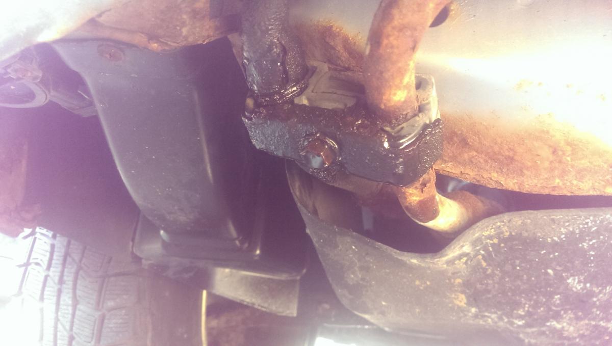

    My e30 has an oil leak in the very lower front left side. It looks like the source is two small pipes behind where the front spoiler would go. I have attached two photos. What part do I need to replace? Thanks

      Needs oil cooler lines.

        Thanks. Looks like that's exactly what it is. I'm reading some do an oil cooler delete and replace it with a threaded pipe joint from eta cars. Has anyone done this and/or can recommend it?
