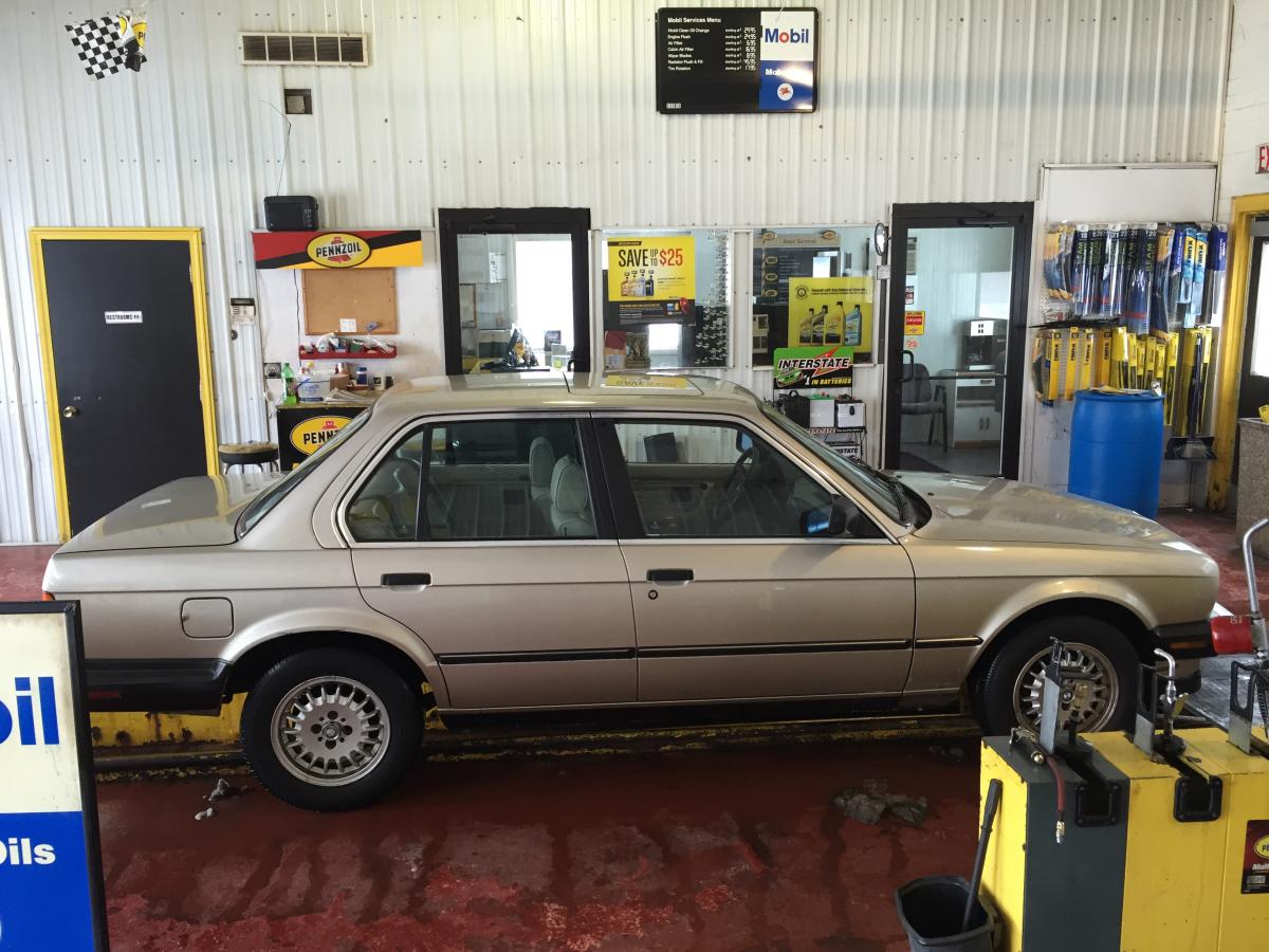

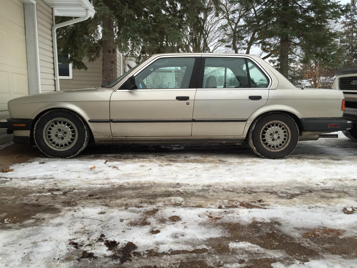

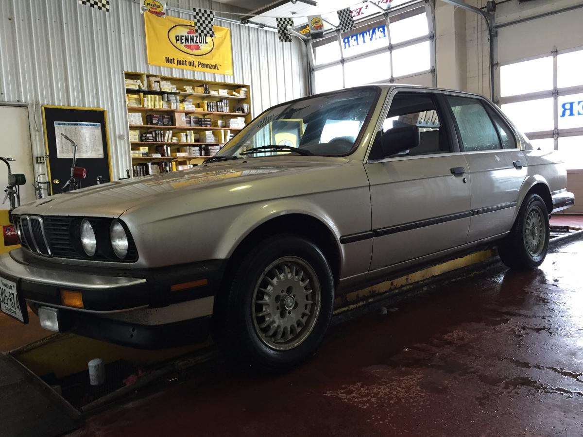

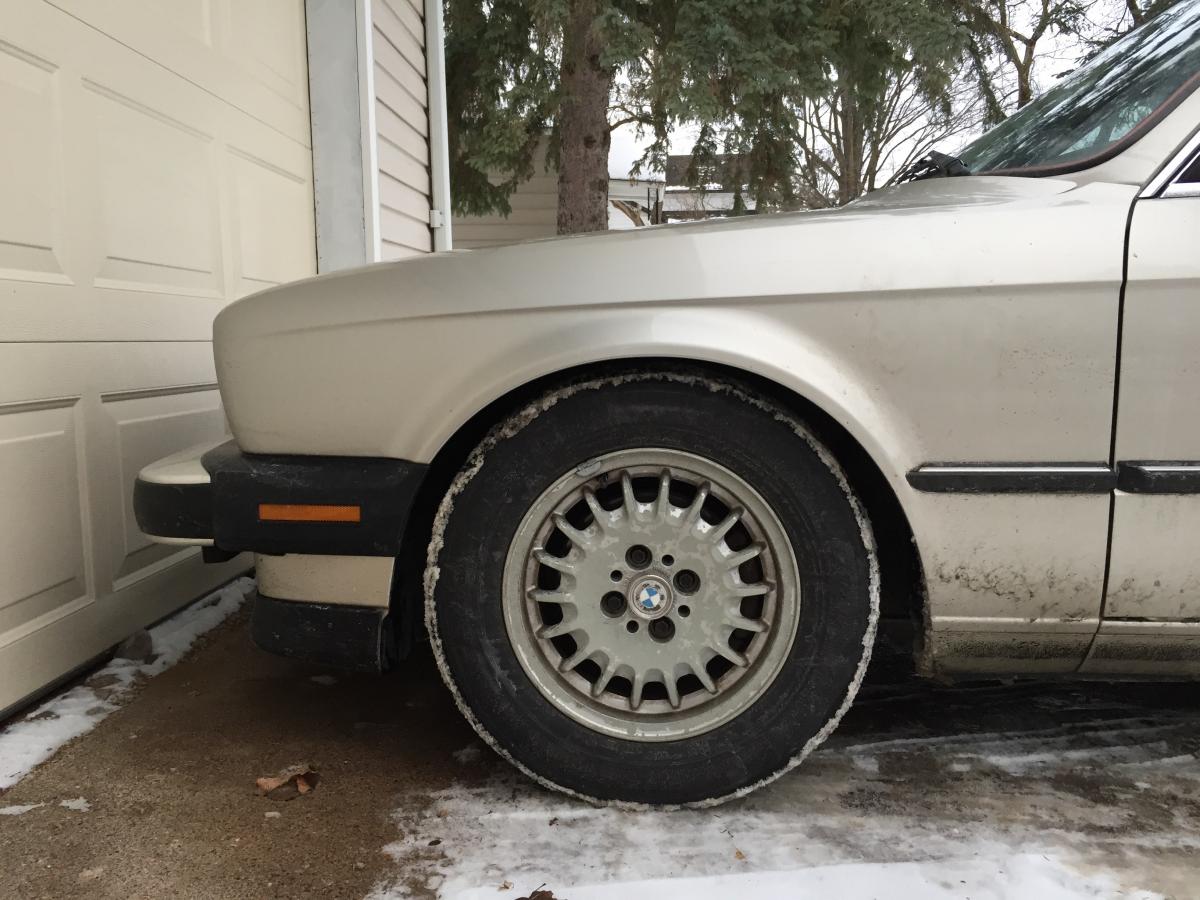

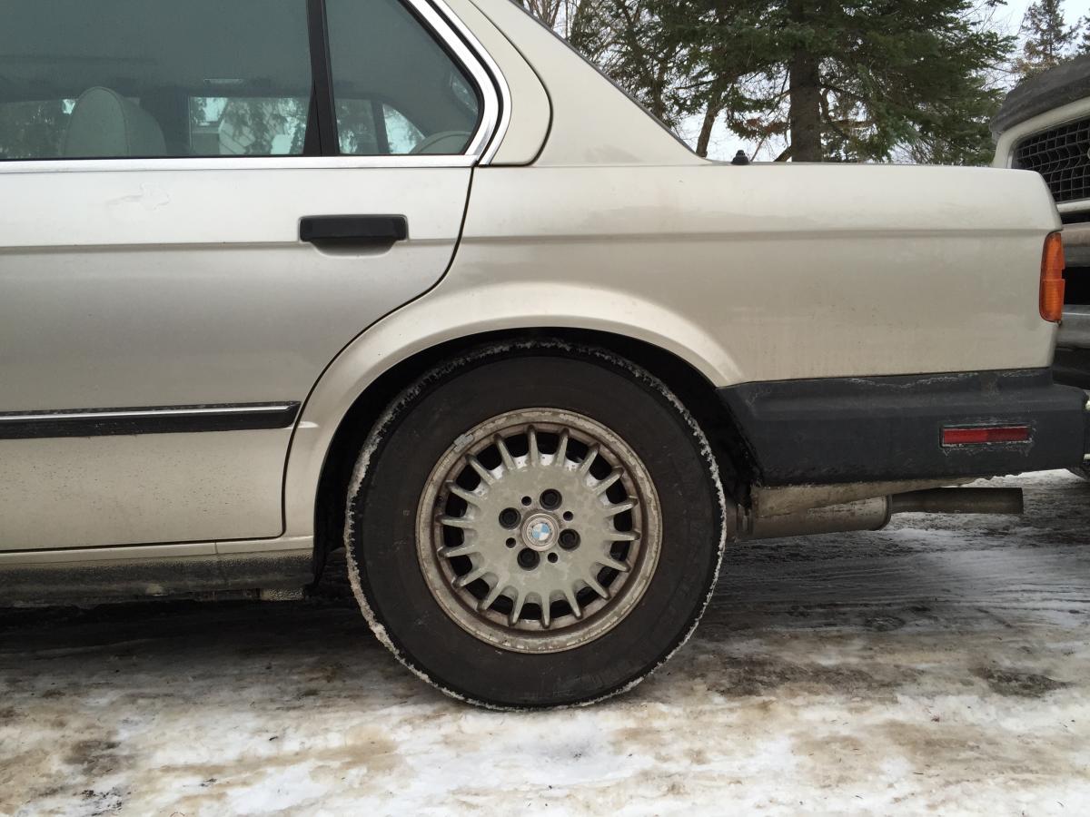

                                Lowered it yesterday on KYB struts and h&r race springs. E90 spring hats up front. I'm pretty happy with the results.
                                post-2797-0-16407700-1417995469thumb.jp
                                post-2797-0-42727800-1417995505thumb.jp
                                post-2797-0-63444600-1417995541thumb.jp
                                • M
                                  M
                                  michael1972
                                  #42
                                  Before pics

                                    #43
                                    Looks good! Now eliminate the trunk tar for 50 lbs of weight reduction
                                      #44
                                      That looks awesome! Great height imo.
                                      Sent from my potato phone
                                        #45
                                        Very nice!
