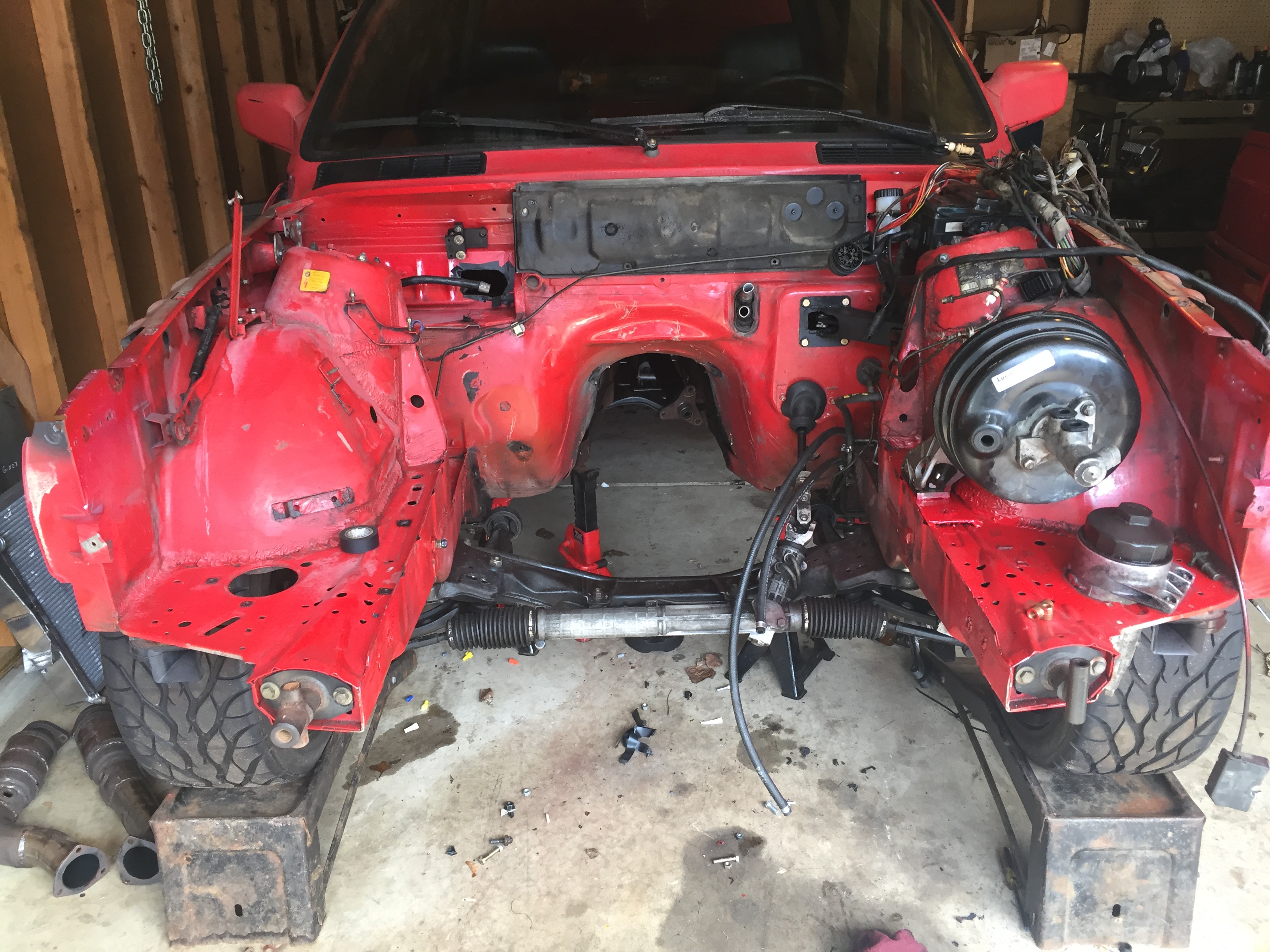

    Well I was able to get creative with some extra lines.
    Power steering is hooked up and the oil filter is relocated.
    Before picture - notice how cramped (the oil filter) that would be with the brake booster relocation
    And now:
    Now I am going to redo all the brake lines (in the mail), install the coils and BBK while I am at it.
    I got the wiring moved into the interior so that is progress, but it still needs to be cleaned up. Whole interior back in. I'll probably take the motor/trans out to redo the brake lines and clean everything up while its out.
    Then throw some miles to work any potential gremlins out, put it up for sale, and start work on the LS M3.

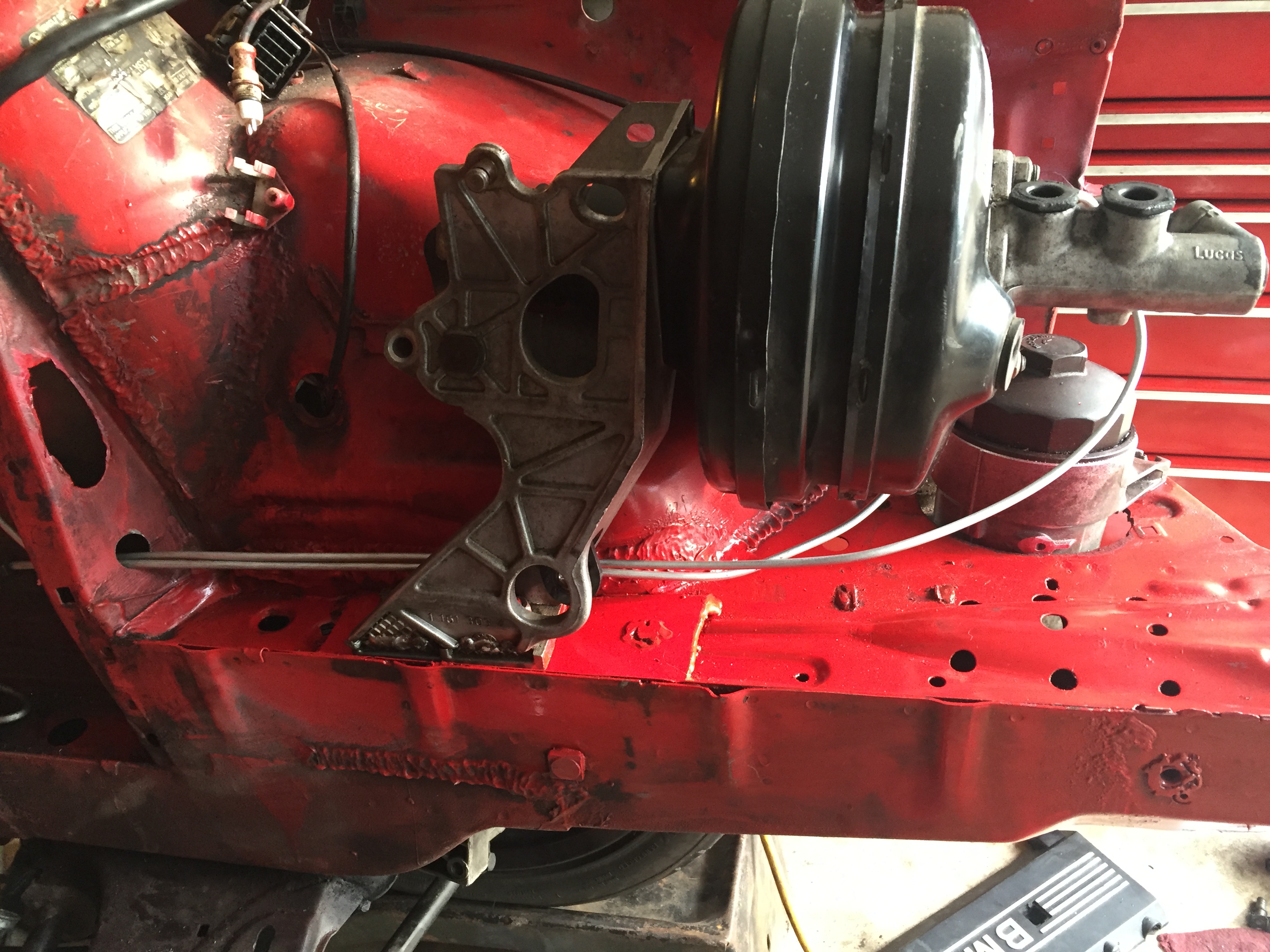

      Here is a better picture of the only place the remote oil filter fit with everything attached.
      Much better here now and still easy to access for oil changes.
      I'll probably wait until next week to pull the motor so more updates to come then.
