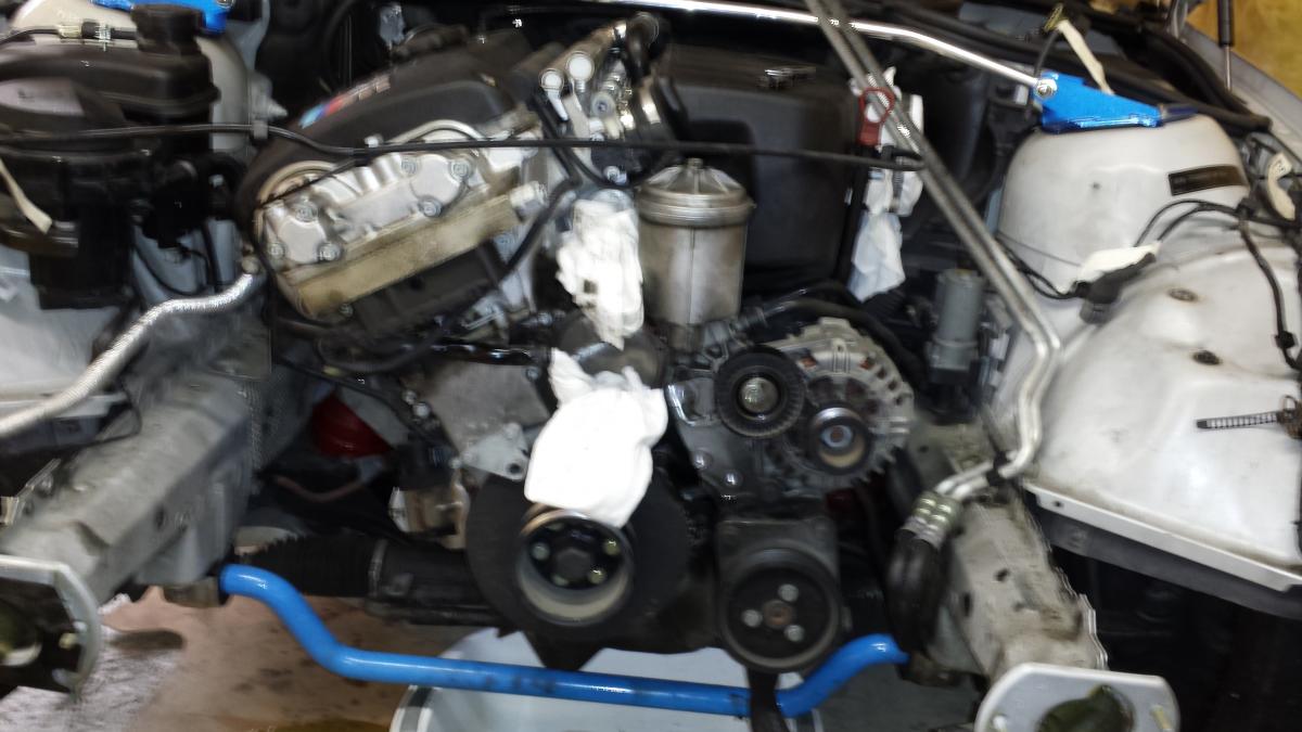

About to pop the vanos unit on and torque the exhaust cam bolts. Then pray as I manually turn the motor over to check for interference.
Just turn the crank twice and the cams should have the "#1 TDC" flats level parallel again. Just giver!!

In place on my engine for reference.

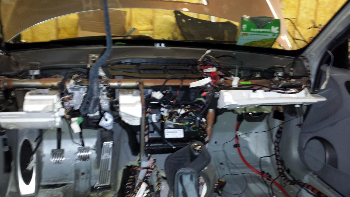

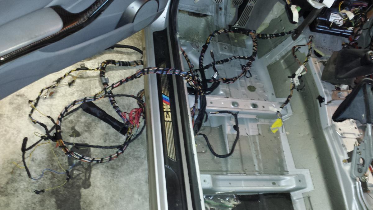

M3 ate a wall this fall... and got rear ended by a 350Z moments later... so the winter project is... an over the top rebuild.
Front
-Electric Fan
-Low temp thermostat
-New water pump (metal impeller)
-Power pulleys
-Brake ducts
-New hood
-New bumper cover
-Larger radiator
-New fender
Interior
-Full gut...
-New comp steering wheel
-Dash mounted battery cut off
-Cage
Suspension/wheels
-Adjustable rear control arms
-New rims / tires (at 265 right now... looking to see if 285 will work well instead)
Rear
-New trunk
-A lot of body work!
Sure I forgot some items... and it'll grow as I build
I'll have quite a few stock parts I'll be listing here and there as I go.
