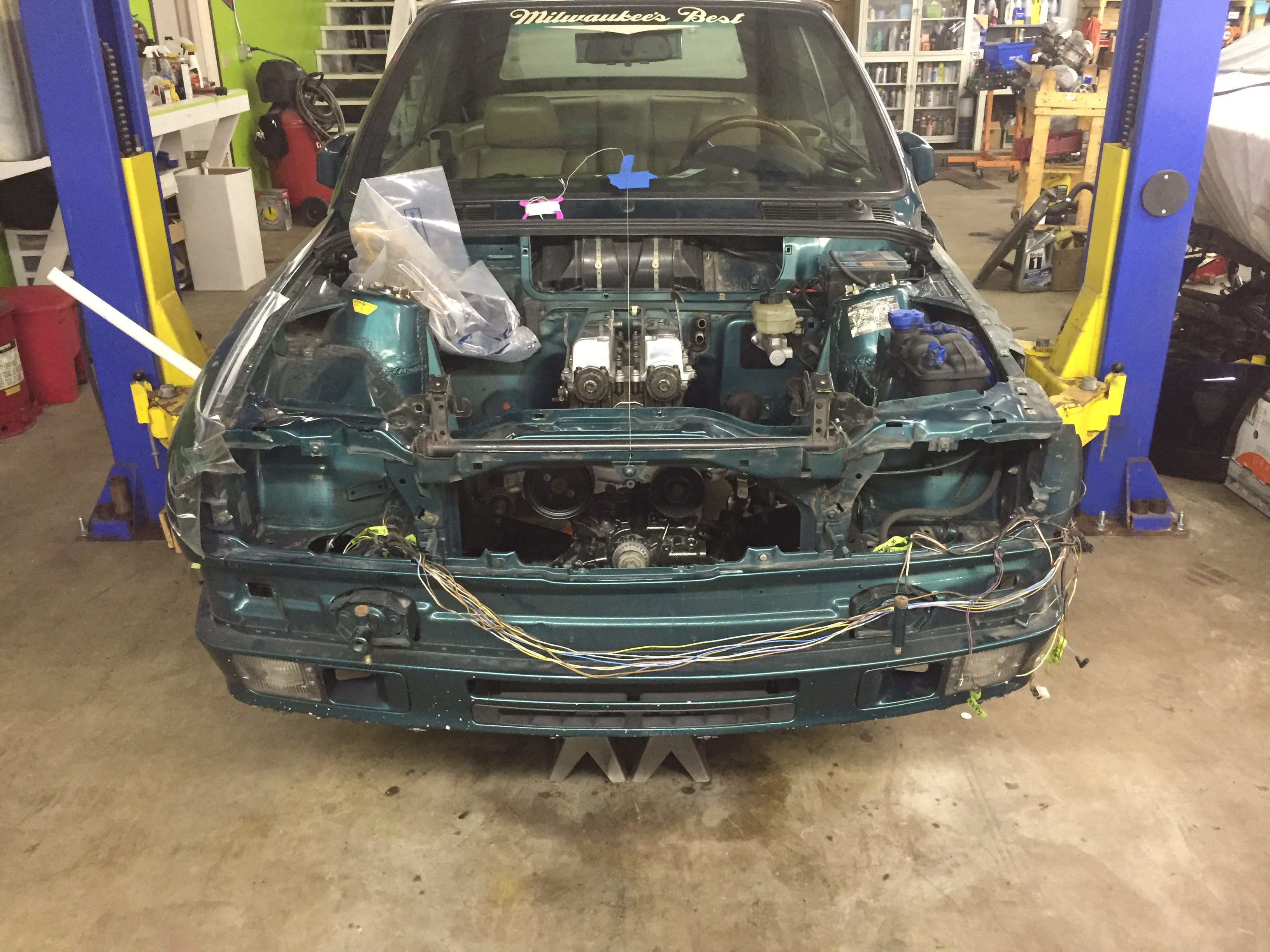

                          The dirty wiring nightmare begins. I am deleting my A/C and my ABS. Its completely insane how many wires are used for just these two items. I also am removing the SRS system since I have an aftermarket wheel anyways. I am taking the time to trace all the wires back to the dash and ECU's to make sure I don't have any extras floating around. Lees mess+ less confusion if I ever need to trace any issues.
                          After a quick rinse. most of the wires are labeled and removed here. I am starting to figure out how to run them all through the frame/fender for the headlights, horns, and other gadgetry at the front of the car. I hope to have only my fuse box and coolant reservoir left in the engine bay.
                          .....And done.

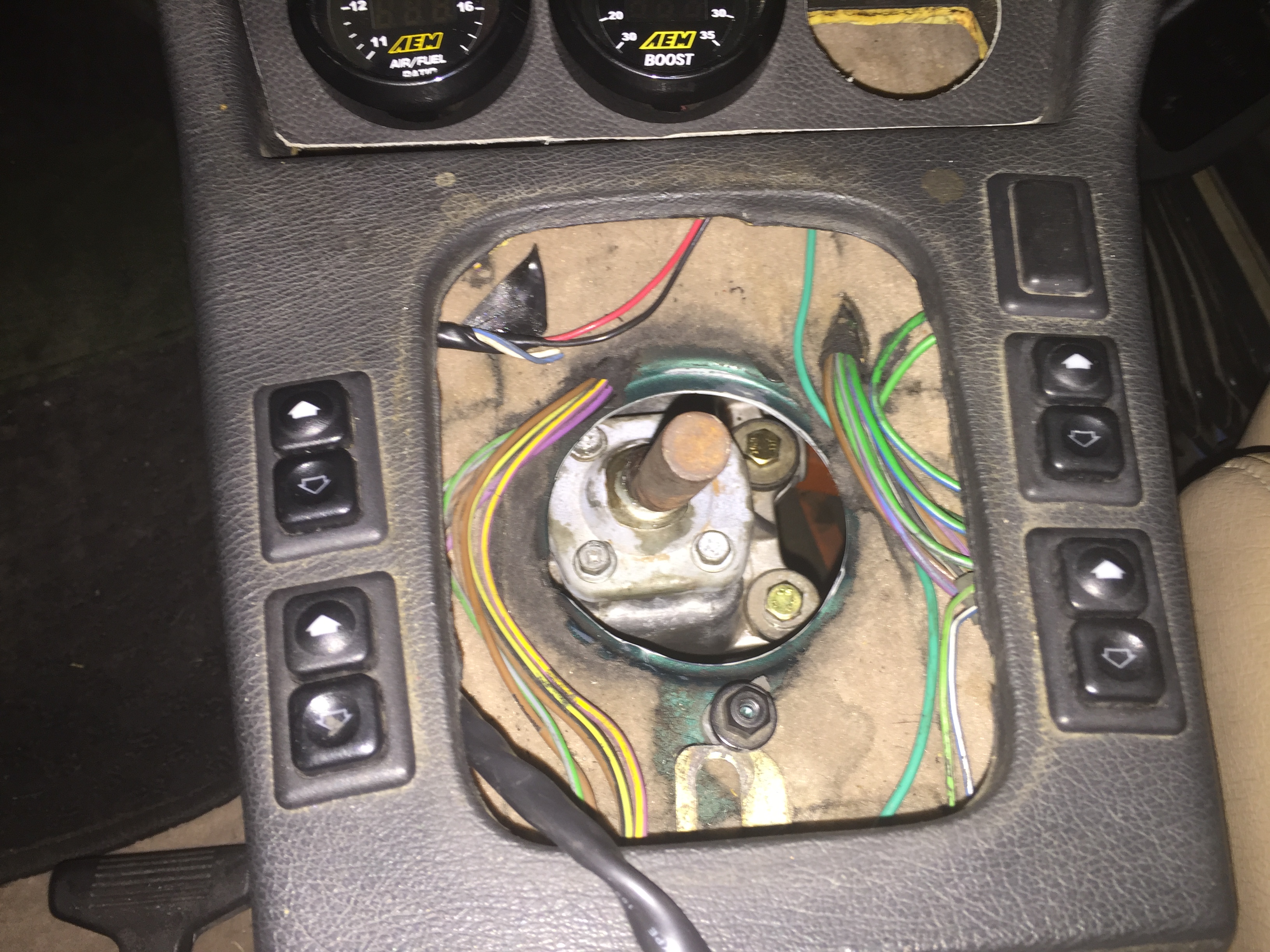

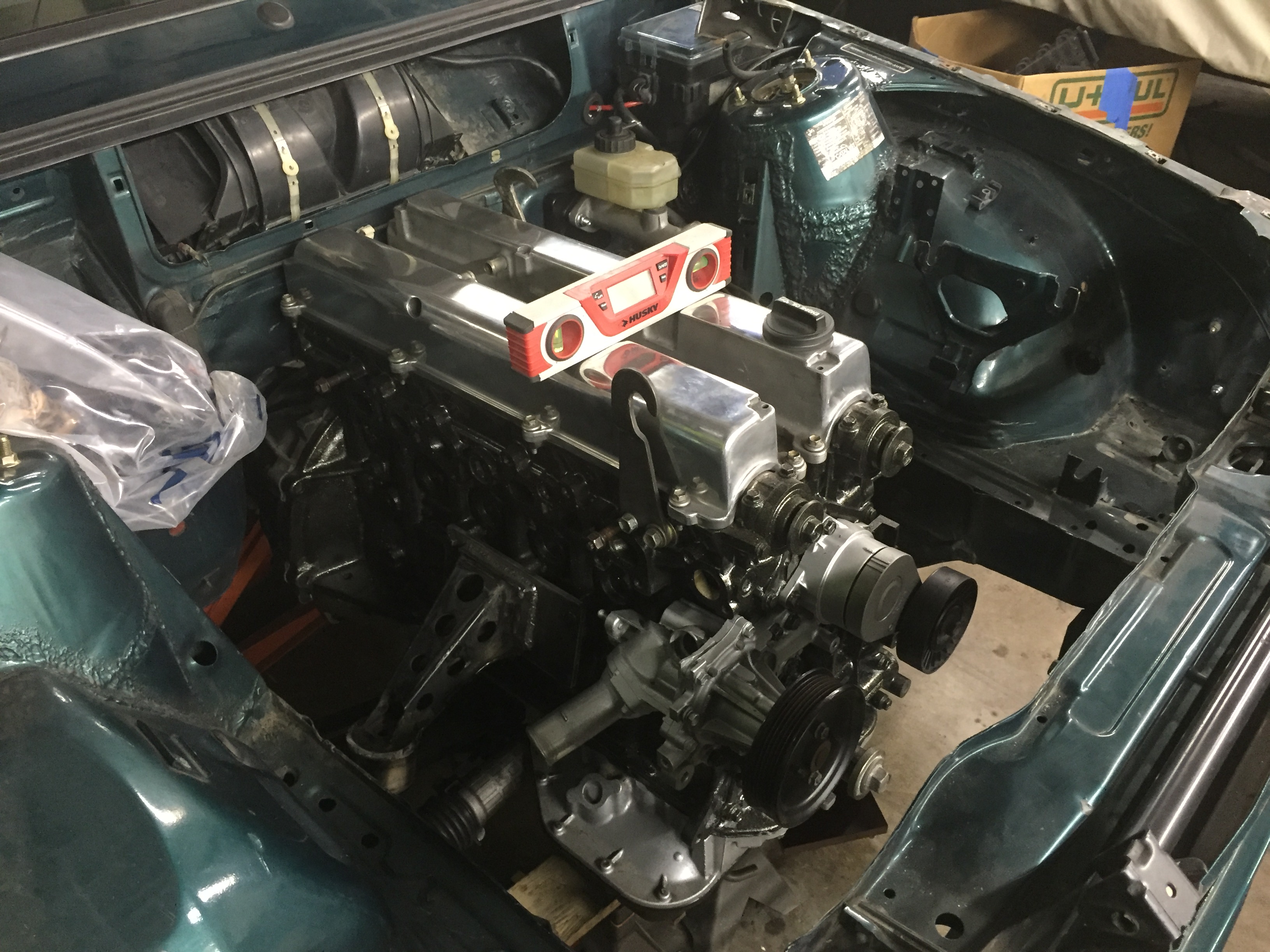

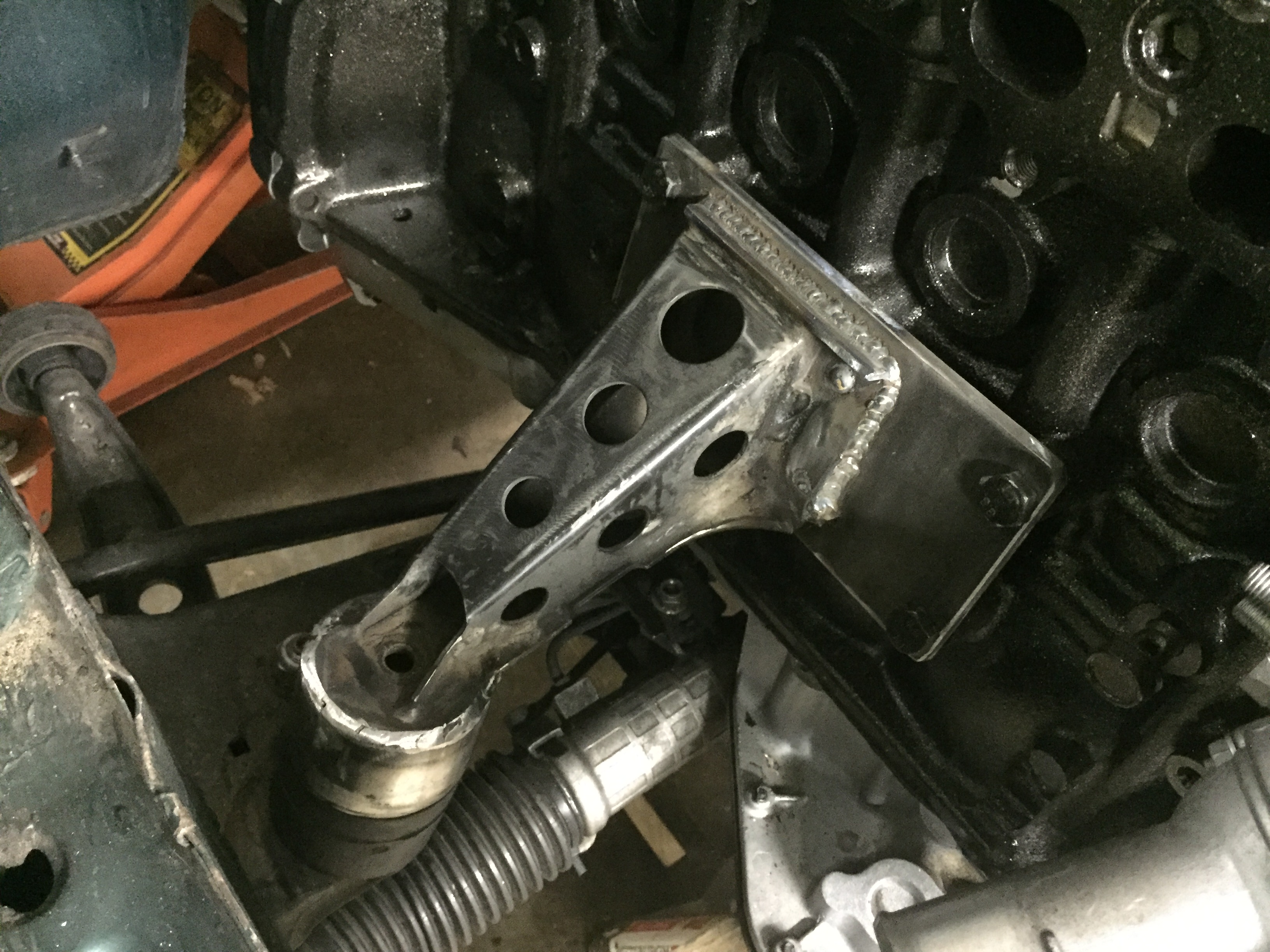

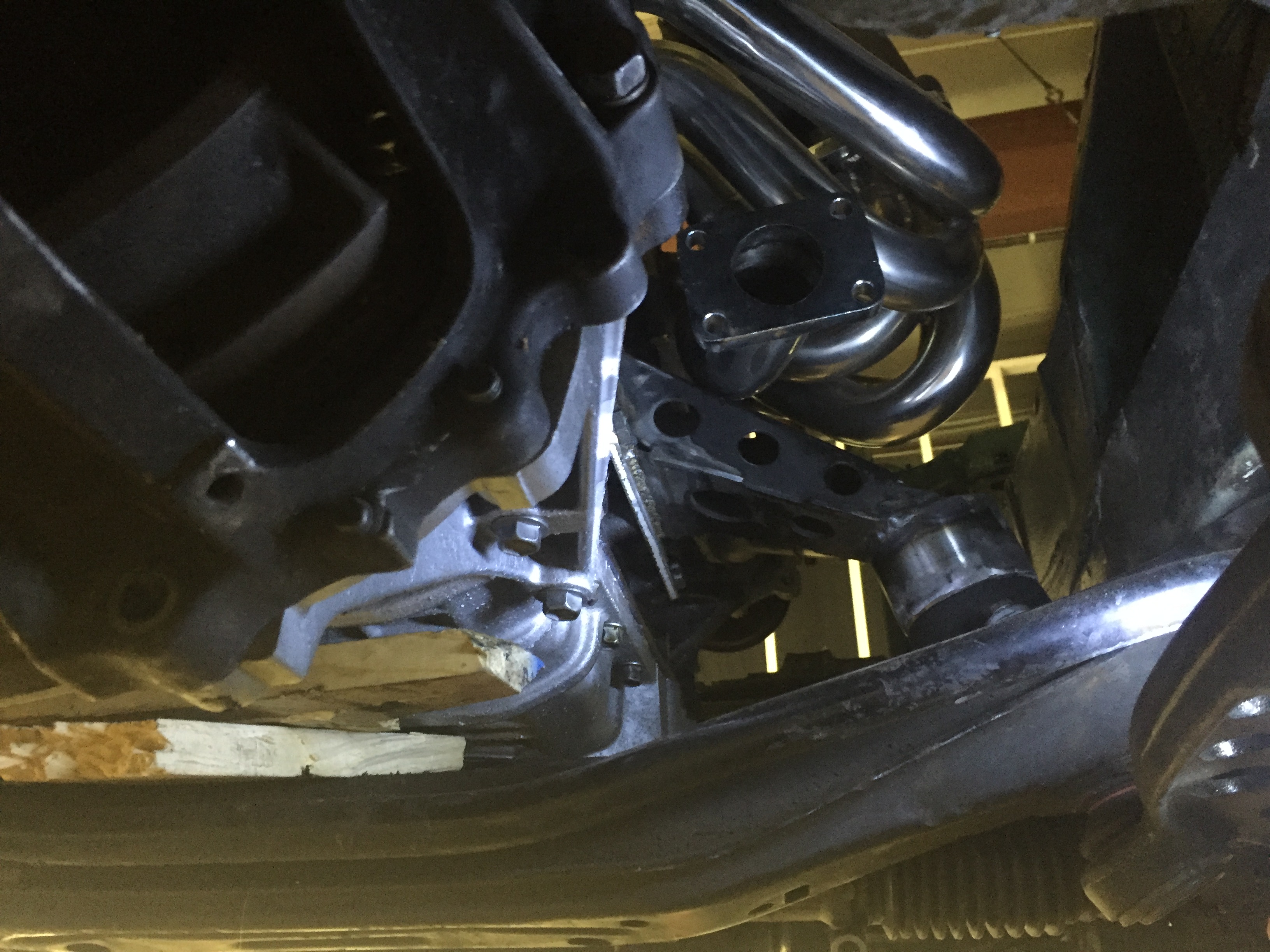

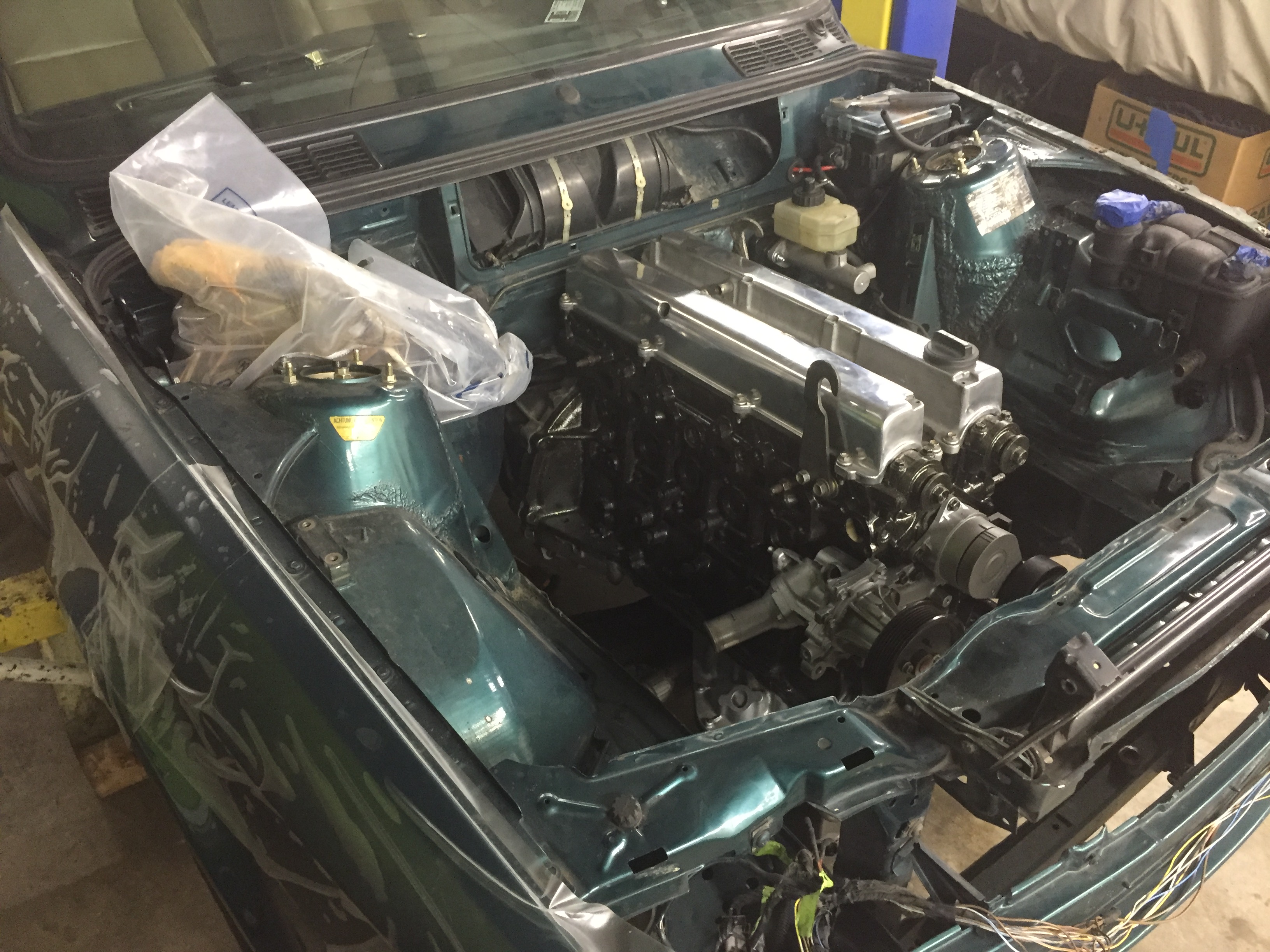

                                        I have been really really lacking on updates, So I am going to take the shotgun approach and share some of the progress I have been making. Here are a bunch of pics of the motor in the car. I used a level and a plumb bob to get the motor where it needs to be and Chris made some brackets out of the stock M20 mounts because we agreed they look awesome.
                                        On a side note, look how perfect the shifter fits in the stock shifter location!! It was meant to be!
