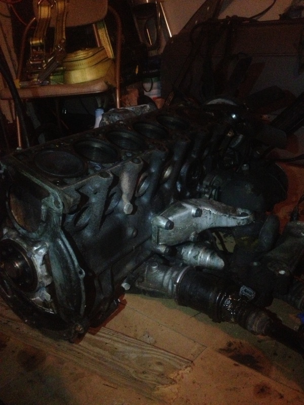

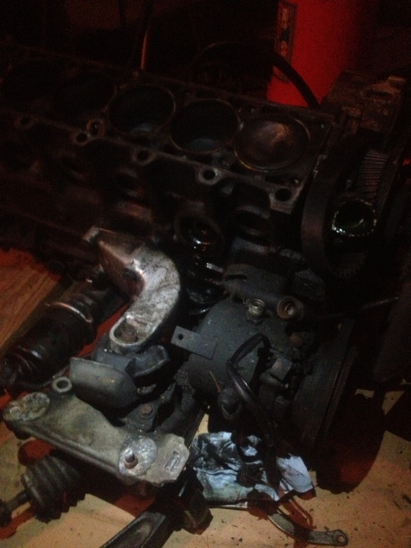

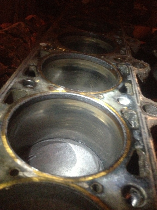

              I was able to buy basically the front of an ix for $100 off craigslist. Included the block, oil pan, front diff, sub frame, steering rack, new control arms, cv shafts, power steering pump, ac compressor and more. Kinda crazy lol. Everything supposedly came out of a 120k ix and judging by the original cross hashing I'd say it was pretty well taken care of. Still kinda debating whether to use my original engine for the stroker build or this one...

                            tore down my spare ix block
                            disassembled some spare parts
                            LOL one h&r one stock spring
                            m20 tear down

                              Is that scored bearing for the oil pump secondary shaft?  Those suck to replace, if they are in ok condition just leave them alone but obviously that one isn't.  Can you see how that happened or was that from taking it apart?
                                Also curious about that bearing bore.

                                  Yeah it's the oil intermediate shaft bearing. I don't understand how it happened the engine has 120k on it and everything else is fine, the second bearing behind it is perfect. I'm thinking the oil passage must have been blocked somehow? There was really no sludge build up or any other signs of excessive wear. I guess on the plus side I can now safely hot tank the block while its out.
                                  The odometer gears were a breeze, the hardest part of the project was getting the instrument cluster out/in before frostbite sets in lol no heated garage
                                    How does the shaft look?  I have the numbers for the bearings stashed somewhere, I will find them and let you know.  BMW will not tell you the numbers, and they will not show up on realoem but they can be gotten for only about 8 dollars each if you know the part number.  I would even leave the other one in and see how it does during cleaning.  They are a massive pain to reinstall, they are undersized and must be honed to fit after being installed.  Probably had 8 hours in fitting those bearing on the m20 I rebuilt and still don't know if it's right cuz it hasn't been started yet.

                                      The shaft looks fine, surprisingly. These are the part numbers I have for the bearings:
                                      11 11 1 264 196 - BEARING BUSH
                                      11 11 1 280 863 - BEARING BUSH
                                      If I'm not mistaken Bravauto actually sells them.
                                        Yep any place should sell it if you have the number.  I got mine from Pelican, have you looked into the honing process?  I did it pretty redneck style.
                                        • TehRaydarloverT
                                          TehRaydarloverT
                                          TehRaydarlover
                                          I was advised this:
                                          measure the shaft diameter
                                          throw the bearing in a lathe and machine it
                                          press it in
                                          use a brake cylinder hone to get it to tolerance
                                          touch it up with a green scotch brite
                                          .001-.0015" clearance,002" max
