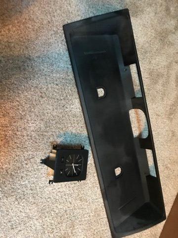

                                          Was having nightmares that my scene points were too low, so I bought a couple E U R O items to mend that.
                                          Got these at both a pretty good price.
                                          I picked up one of those wiring adapters for 6 button OBC to euro clock to make life easier for my self. Clock gets power as the light for it comes on, but when I use the set buttons on the front of the clock, the hands don't turn. I don't think I am doing anything wrong as this is pretty straight forward process, but I was under the impression I was buying a working unit. I have messaged the seller already.
                                          Are these repairable like the speedometers are?
