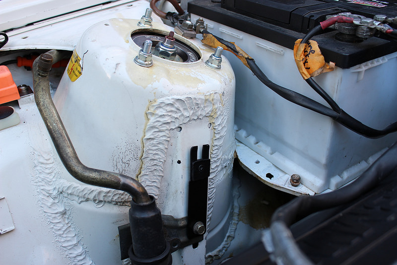

    Did you ever get the condor mounts to sit flat or did you just crank down on them?
    I used a different set of condor ones that I had laying around.
    I think there was issues with header clearance that may not have been noticed before, as the headers are up against the body. This would certainly cause some issues with motor mounts not wanting to sit quite right.
