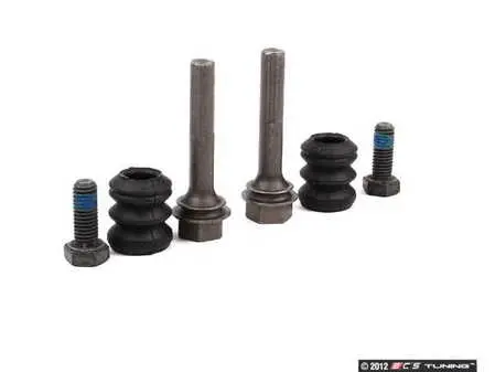

                                    Is there anywhere I can buy these boots for the caliper guide without buying the kit? Really don't want to spend $30 on some bolts...
                                    Mine are torn at the bottom, so they don't seal at the bottom but sill cover the exposed portion of the guide pin. Do I need new ones?
                                      #123
                                      If they are torn anywhere, I would assume that over time water and or debris will find its way. On the other hand, those are not oem E30 caliper boots, as they are normally straight with a plastic end cap. Like these:
                                      https://www.ebay.com/itm/Disc-Brake-Caliper-Guide-Pin-Boot-Kit-For-1998-BMW-528i-USA/251698410124?epid=1952015160&hash=item3a9a64f28c%3Ag%3AWW4AAOSwh1paHdGm&_sacat=0&_nkw=E30+caliper+boots&_from=R40&rt=nc&LH_TitleDesc=0
                                        #124
                                        ^I've seen them both ways on E30's.
                                        Not sure if the picture was ever OEM though.
                                        Both work
                                          #125
                                          The boots and double bolt setup were found on Girling calipers: https://www.turnermotorsport.com/e/p-5720-tms349099/
                                          And the straight tube with the plastic end cap are from the ATE calipers: https://www.turnermotorsport.com/e/p-3103-caliper-front-left-new-e30-318i-325e-325i-only-for-cars-with-ate-calipers/
                                          Both were OEM though I don't know if there was ever a definite split on when either one was used, I had Girling calipers on my 318is with that accordion style boot.
