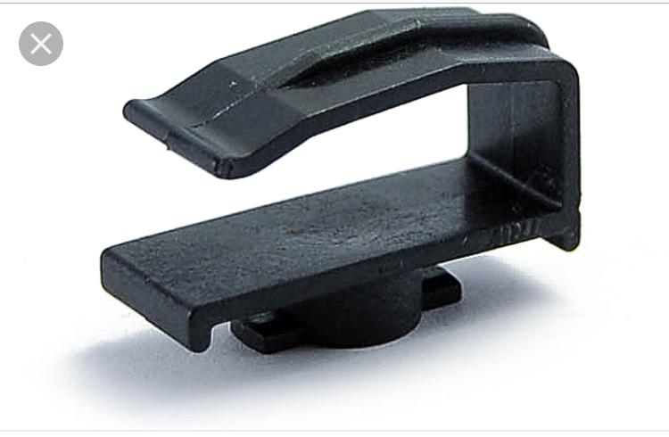

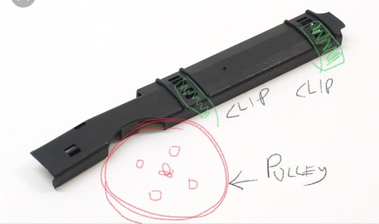

                              So, I know this is where the two sensors run across the front of the engine and there's a plastic cover for them. I assume this is where they go, but I dont remember how that cover or wires are secured to the front timing belt cover, but I assume it has something to do with these two holes. Any direction?
                                #64
                                8031DE04-6311-442F-9AFC-83FA4BF86AF8.jpeg.8cc28253a4dfbac7161515e5b2d5f3bb.jpegC37C33D4-308A-41C7-B676-D48E9942658D.jpeg.ce003bb109ead89ac5c7170f962c22e6.jpeg
                                  #65
                                  That is EXACTLY what I needed. Thank you!!!
