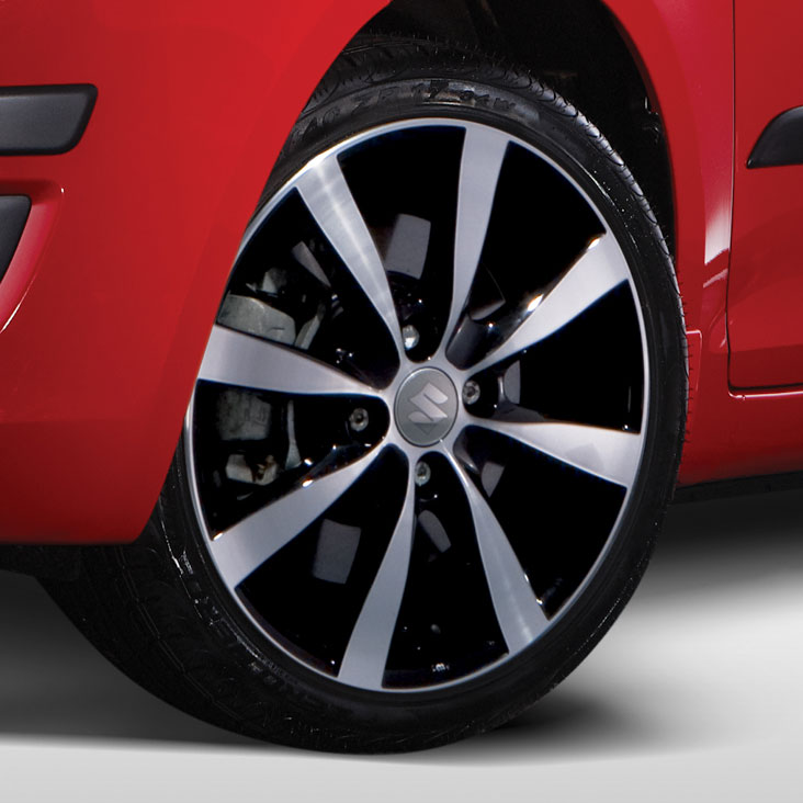

      You could do like gloss lips/barrels and matte spokes, or maybe like a gloss transitioning to a matte on the different surfaces of the spokes, similar to how some modern wheels have silver surfaces but then black/gray sides to the spokes, kinda like these.
