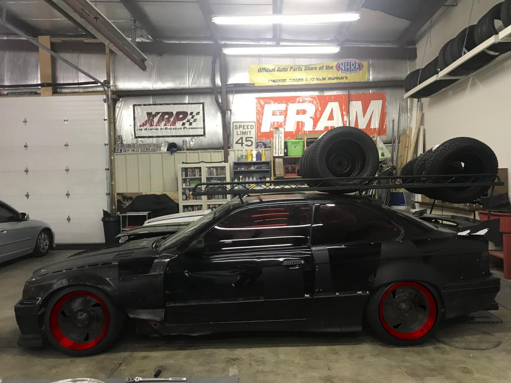

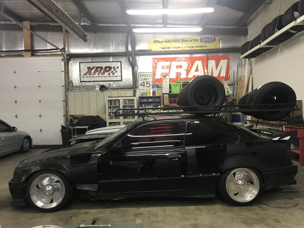

    I just stopped in this thread to realize I never mentioned that I bought Earls centerline Hawks off of his daily. As some of you may know I already had a set of the same wheels but in 3pc rivets. I originally was going to use these but the rear are not as wide as These 1pcs Earl had. I have intentions to mount them to this car but I think I need to paint or plastidip them. The polished look is obviously "too much" for this car and the theme I have going. So I photoshopped some color ideas after I test mounted them to the car.
    **Note the images are compressed and the quality is suffering from this**
    1.Spray the whole wheel with transparent red and put a red pin stripe on the tire
    2.plastidip the whole wheel with black and put a red pin stripe on the tire
    3.Spray the wheels with a matte black face and a gloss black lip
    4.Spray the wheels with a full gloss black or a transparent black
    5.Spray the wheels with a transparent red
    6.Spray the wheels with a matte black face and a transparent red lipWHUT6.jpg
    What are your guys Thoughts?

      Out of the choices, #3 looks the best imo.

          Should I consider red tire letters this time around? I feel like need to toss some red on the wheels somehow/where.
            #415
            Yeah I like the idea of gloss black wheels with the red tire lettering.
              This. Or matte black. Or make a couple matte and a couple gloss to go with the paint scheme
              Or just do em blaze orange or something lol

                Yes!!! Black wheels with red lettering. Red stripe makes it look too toyish, like a hot wheels car.

                  You could do like gloss lips/barrels and matte spokes, or maybe like a gloss transitioning to a matte on the different surfaces of the spokes, similar to how some modern wheels have silver surfaces but then black/gray sides to the spokes, kinda like these.
                    #419
                    Looks like a gloss/matte black combo with red tire lettering. Now I have to decide what the tires should say....... Maybe just the crazy font I used on the door?

                                  I dig the translucent red wheels!
                                    #427
                                    Too late. The mass majority voted black with read tire letters
                                      #428
                                      Too late. The mass majority voted black with red tire letters
                                        #429
                                        Dont get me wrong, I like all of the ideas I proposed, otherwise I wouldn't have asked.
