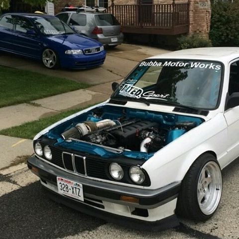

                                Been awhile since ive made an update but have done a few things here and there with the car.
                                After getting caught in the rain a few time i decided to finally make my sunroof brackets and got a hood for the car. Neither stayed on very long but at least i can use them. Ironically i had to leave The Brew Haus car show early because i decided to drive out their without the sunroof and hood when it started raining.
                                Locally i found someone selling an SLR angle kit for my car and picked that up. Was imaging it was going to be a simple install, I was wrong. The SLR arms are much longer so I had to find extended brake lines. Turns out I could only find them from WiseFab (another steering angle company) and that was out of the UK so i went off on my own. A couple fitting and some steel braked line later everything was great. Then the kit creates a stupid amount of angle and before full lock the inside of the wheel hit the control arms so i had to make rack shims. After it all i am extremely pleased with the kit just wasn't expecting so many unseen issues.

                                  Motor started knocking last week and came out. Turns out rod bearing #6 spun but once we started grinding the crank down the journal on #6 was cracked which we believe to be the culprit. Motor should of been rebuilt and back in the car in less than a week but was sent rod bearing for a euro s50 not us. Motor got all new bearings, rings, new gaskets, new oilpump, one rod, dual valve springs and titanium retainers and keepers, and a whole lot of cleaning. Timing was very inconvenient but shit happens.
                                  Snapchat-5509061912480845091.jpg20160827171425.jpg20160827171435.jpg20160827171458.jpg20160827171506.jpg20160827171430.jpg

                                      Finished assembling the motor and got it back in the car this weekend. Drives perfect just doesn't idle and wants to shut itself off when coming to a stop.
