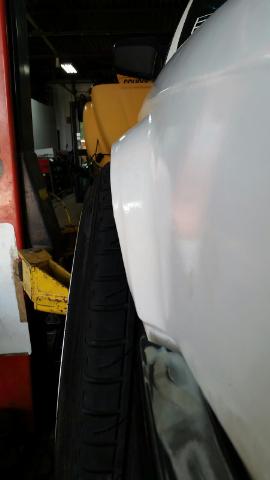

                                          Been awhile since ive made an update but have done a few things here and there with the car.
                                          After getting caught in the rain a few time i decided to finally make my sunroof brackets and got a hood for the car. Neither stayed on very long but at least i can use them. Ironically i had to leave The Brew Haus car show early because i decided to drive out their without the sunroof and hood when it started raining.
                                          Locally i found someone selling an SLR angle kit for my car and picked that up. Was imaging it was going to be a simple install, I was wrong. The SLR arms are much longer so I had to find extended brake lines. Turns out I could only find them from WiseFab (another steering angle company) and that was out of the UK so i went off on my own. A couple fitting and some steel braked line later everything was great. Then the kit creates a stupid amount of angle and before full lock the inside of the wheel hit the control arms so i had to make rack shims. After it all i am extremely pleased with the kit just wasn't expecting so many unseen issues.
