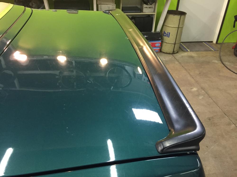

                                This is a hilarious, yet not so hilarious spoiler. I bought this wing a few years back and was always to much of a wuss to drill into my trunk too mount it. Well...... when we had my car on the lift in Chubs shop, you can only lift a car when the garage door is closed(obvious interference issues) Well, Chubs hearing isnt the best, and I wasnt paying attention but we manged to lift the car into the garage door completely twisting the door and bending the frame. My car on the other hand only suffered minor injuries..a small scratch no bigger than a nickel. I had just the solution to cover up our mishap......image.jpeg
