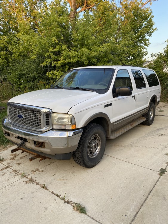

                                In other news, I bought a truck!
                                It’s big and very rusty but was very, very cheap. It’s a V10 4x4 limited, so pretty capable, shockingly comfy and full of features, absolutely massive inside, and gets somewhere around 10mpg. Did I mention it has a lot of interior space? It’ll fit 4’x8’ plywood sheets with the 2nd row folded and the 3rd row removed 😂
                                Long story on why it was cheap, but it very much figures that the day I bought it, I got it the hour home and was running to the post office to mail the registration documents and the power steering box shit a seal. It emptied the contents of the reservoir in about 20 seconds and left a very nice snail trail in my wake from work to the O’Reilly’s parking lot. Still working on fixing that, but getting closer. Need to get one line off of the pump, then it can all go back together.
                                Side note, I’d like to punch the engineer who put this hose outlet in the spot he did right in the mouth. Can’t get it off with the pulley on. Ugh.
                                Brakes are sticky on at least one corner too, but otherwise it seems pretty okay. I’m fully expecting other things to crop up, but it was driven regularly and maintained well before I bought it so the hope is that it doesn’t become too needy. Verdict is still out on what I’ll do with it, I bought it to tow and promptly found a hidden rust hole in the hitch receiver. Tank has to be dropped to replace the receiver, so I may just do that in the spring once it proves whether it’s going to be reliable enough to invest the time into for that. Stay tuned!
