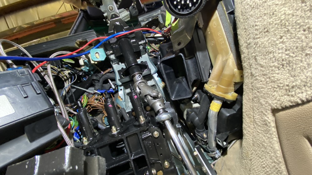

              Well I spent most of my saturday trying to sort out my steering column issue. It turns out that none of my current options left me a happy camper. I did get myself an early model non-airbag column but the way it fit was very unfortunate. not only did it put the steering wheel angle back at the bus driver position that I hated, it also pointed the face of the wheel a good 5-10 degrees toward the drivers door. Apparently the hole in the firewall is different on the late model airbag cars.
              Here is the two columns side by side
              Here you can see how dramatically left the column faces
              Here is the bus driver angle
              So my plan from here was that it would be easier to make my airbag column work. Below you can see how close one of the masters is to the splines of the column. I drew a line in red that shows where the shaft needs to go. Notice that my line is a "Z" as it not only has to go to the right, it also has to pivot down.
              This is my solution; use a flaming river double U joint to make the "Z" and then a D shaft through the firewall and a second U joint to mate it to the Z4 rack. the second part im still not sure I have all the puzzle pieces yet. I previously made an adapter a few pages back in this thread to mate the Z4 to my column, but now I am using a D shaft, I will likely have to make a different adapter. I just ordered everything and will have to figure this out when I have everything in my hands.

                    The new joints showed up, and to my surprise, the second time is a charm. Everything fit perfectly! (Minus the fact that my D shaft is about 4" too short, HEH )
                    Under the dash its REALLY REALLY tight to the master. I actually had to shave the mounting bracket for the pedal box and the master itself to clear, but it looks like its going to work!
                    Here is the engine bay side of the D shaft and the new U joint to replace the one I made previously. It looks much nicer and is a lower profile than what I had. B2C91909-F778-4ABB-AD08-B55288D1733A.jpeg

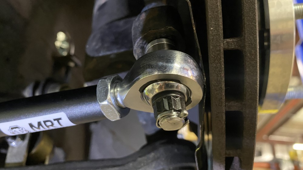

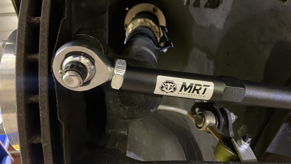

                              On the exterior of the steering issues was something I didn't mention previously. The new Wilwood rotors sat much further inward to the hub and were very close to the heatshields. So close in fact that with the factory tie rods installed, the boots pushed the shields into the rotors and would cause them to rub. I tried to get different tie rods and even shave them down, but that didn't help. I then bought an cheap angle kit like the one on my E36 to move the pivot inward and away from the rotor. The kit I bought didn't quite fit the hubs I have, so I had to mill them down on the Bridgeport. This was a fail, as even after machining them, I would need additional spacers on the brackets and special hardware. Ultimately I caved and bought a bump steer kit that uses Heim joints in place of the tie rods that allowed me the extra space. I figured these will also help with bumpsteer (duh) and the car being so low and not having power steering anyways.
                              See failed E36 bracket below
                              And the MRT bumpsteer kit installed. Note the space between the heatshield and rotors.28184179-68B1-4558-818A-BA5993D3A928.jpeg5119B449-B521-480C-AA13-F5AE7224B5BC.jpeg
