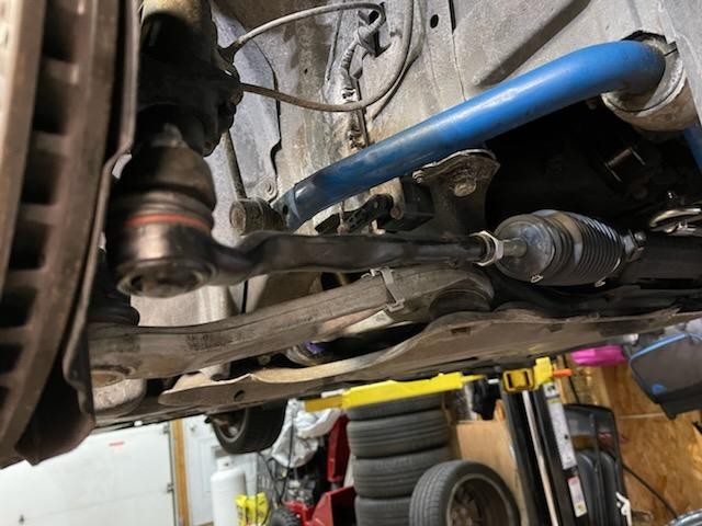

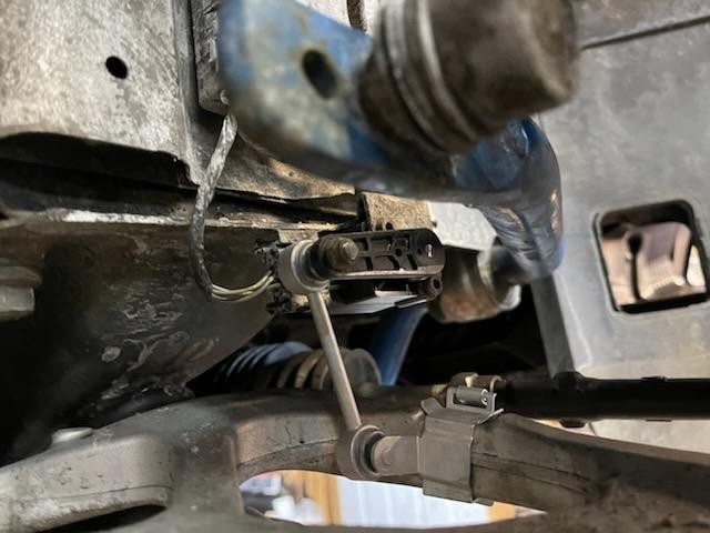

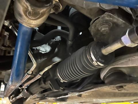

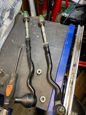

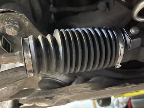

        Mike installed new control arms, poly lollipops, new inner & outer tierods, power steering line, new steering wheel, wired up heated seats, new head light adjuster & mount and getting an alignment tomorrow.
