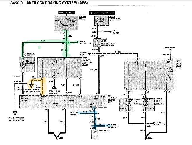

                                  Cut the ABS harness on the engine side and pulled it out through the firewall inside the car. A few wires left that go into somewhere else:
                                  red/yellow on engine side. appears to go to the ABS relay. however, it didn't go through the firewall and looks like it went into the twist lock connector that engine harness connects to.
                                  blue wire inside the car. wire diagrams says it makes it way to the alternator.
                                  green/red wire inside the car. power from the ignition.
                                  Red wire on the engine side. Diagram says it goes to the relay, but it seems like it goes straight to the power junction block where the main battery lead comes into the engine bay.
                                  The good news is that it seems like none of the ABS wiring is integrated into anything else. Other than receiving power from the car, it stands on its own. So these wires will likely get clipped and then heat shrinked over the ends.

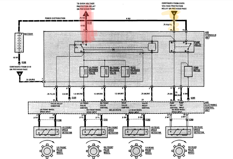

                                    #1096
                                    Found what the red/yellow wire is going to the C101 connector. Just another power supply for the ABS.
                                    Which is good news because that was really the only one I was concerned about.
