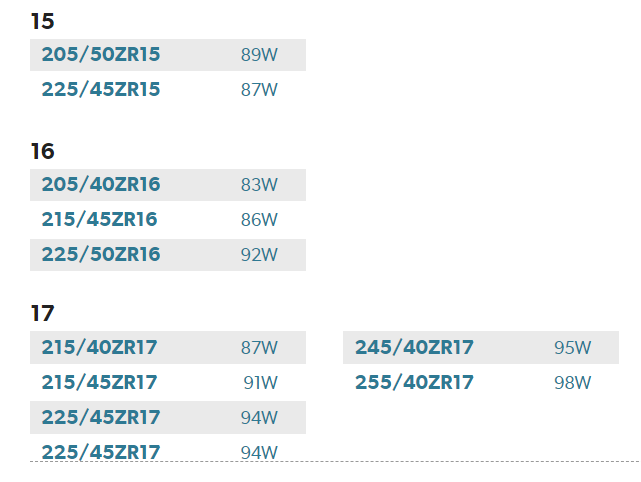

Found the sizes on tirerack, a few options for us e30 folks!
Yes the 225/45-15 is calling my name. Supposedly more sizes are going to be released as well
That option is making me consider 15's again. Price is decent too.
