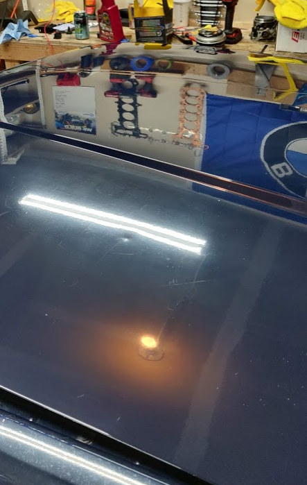

                                      I spent some time the other day with a clay bar and some paste wax. Certainly helped the paint out a fair bit! It's not perfect but it'll do.

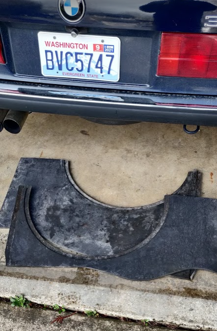

                                       I've found this specific chassis to be fairly terrifying to drive, the rear end is clearly significantly lighter than the front so it is always looking to rotate around in any non straight situation. I was at the junkyard looking for some other parts and came across an E30 where the trunk tar was completely loose and intact, so I got that for $15 and will be throwing it in. I also got a battery cable from a late model (and all the fixings) and will be converting to a rear battery setup to help with weight balance further. Battery cable was only $15 too which was awesome.
                                      Note the two tone trunk to plate area, as I haven't finished yet!

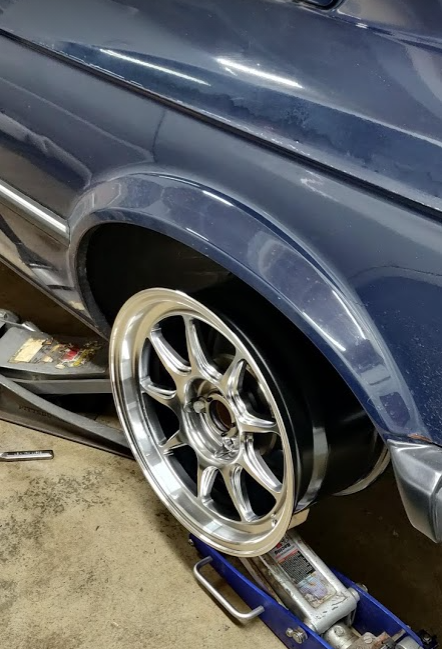

                                      The piece of the puzzle that I have been waiting for! Konig countergram's in hyperchrome which have been backordered since October, one place got a handful in stock and I managed to grab a set. 15x8 et25 and will be running a 225/45r15 likely with an rt660 for fun.
                                      Rears look like they will fit beautifully (IX rear end) and may have a smidge of room to go out further.
                                      Fronts have the rim .05" off the strut tower, so I will need to space that out. May end up grabbing camber plates for the front to make things more proper and fit easier.
                                      I'm stoked with the way they look in person!

                                          you might need a 10mm spacer for the front. If I remember correctly, my first wheels for 16x8 20ET and needed a 5mm on the front to clear it.
